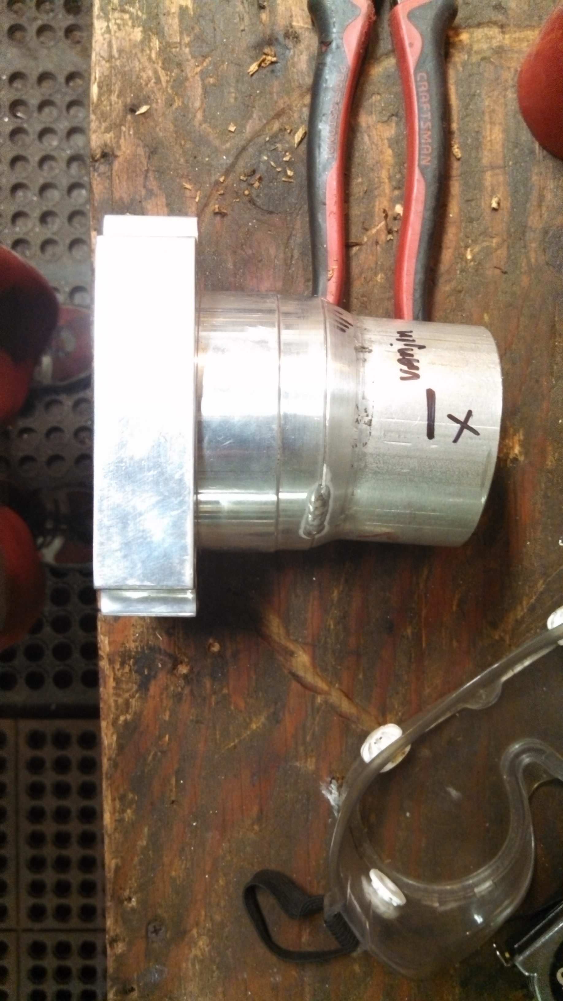

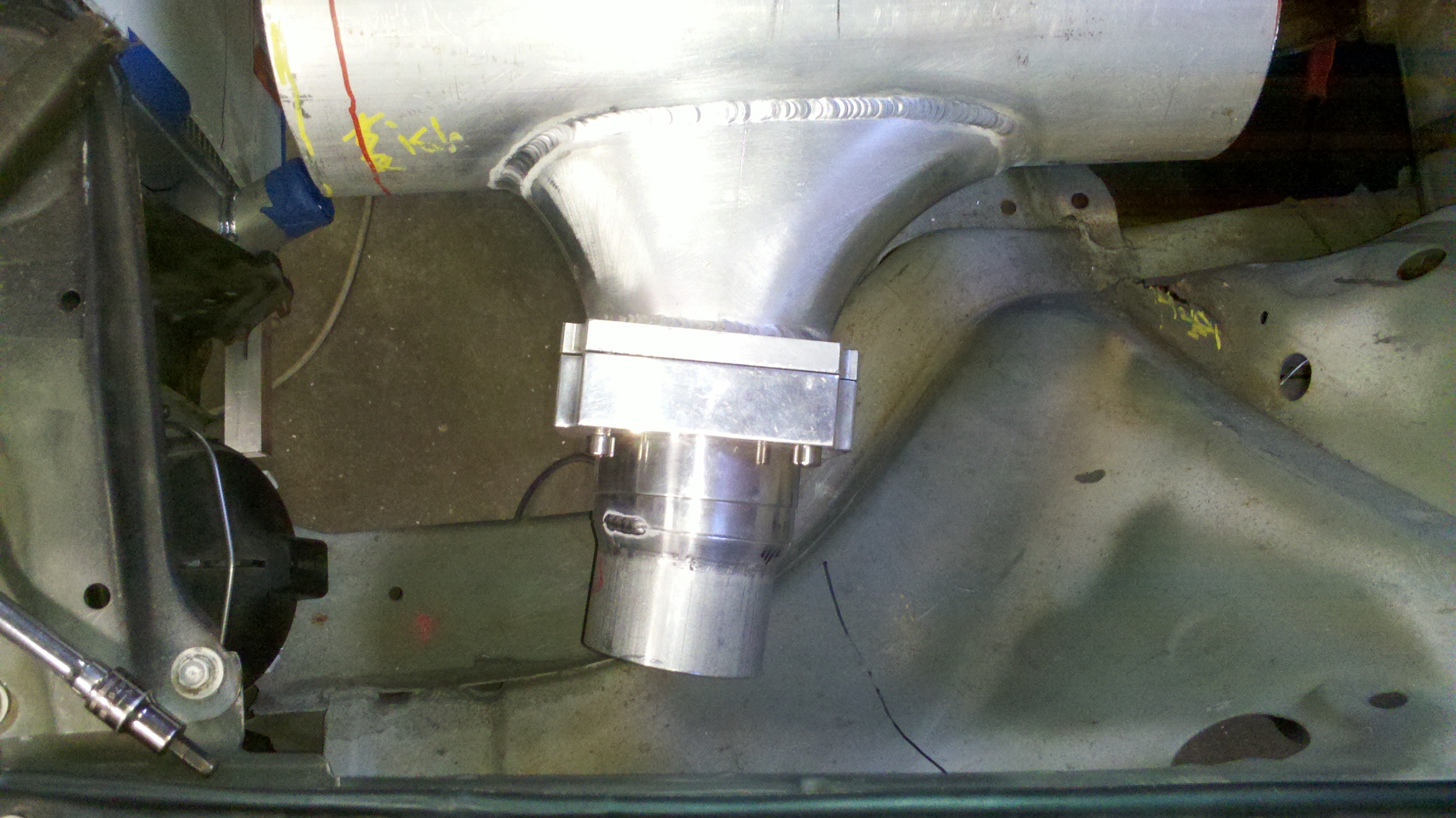

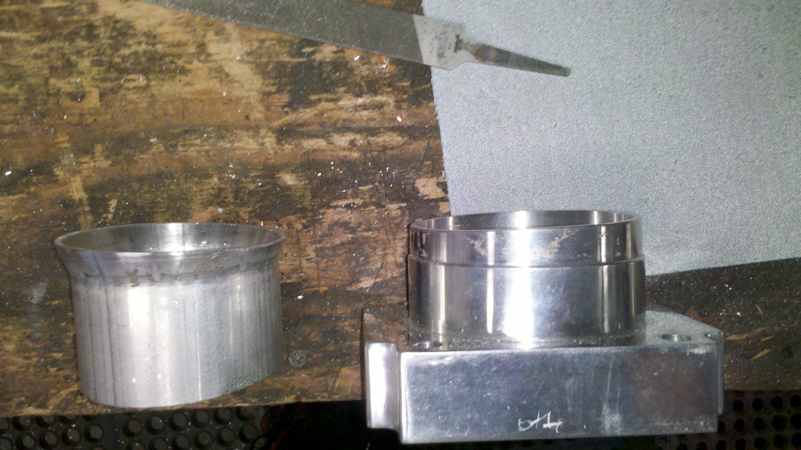

Ok let’s get caught up. I had decided early on to build a silicone coupler-less intake tract. Ive seen enough melted, popped off, torn etc couplers to not want to have to deal with that. Ahaha I had been undecided on whether I wanted to use Hartgett clamps or get the Vanjen clamps from Vibrant. After seeing Ed’s video, I made up my mind. Get me some VANJENS!!
I now have a 2.5” for my compressor outlet, a pair of 3” for my IC inlet/outlet and a 3” for the TB inlet. The clamp kit is very nice, and seems very failsafe if built with piping that is fabricated correctly to allow for some play in the interfaces.
The throttle body is a 90mm godspeed unit. I cut it at a sliiight angle and shortened the mandrel transition so it matched the TB inlet. I had Ryan TIG on the taper from 90mm TB to 3” and the Vanjen o-ring receiver.
PICS!!
tb cut with taper@angle.jpg (1.41 MiB) Viewed 38341 times
Re: 24vVR6T CQ Project: EATSGTR, UPDATED!!!
more pics
tb and taper tacked together.jpg (1.13 MiB) Viewed 38339 times
ready to cut tb for vanjen clamp.jpg (1.46 MiB) Viewed 38339 times
inside tb transition.jpg (1.63 MiB) Viewed 38339 times

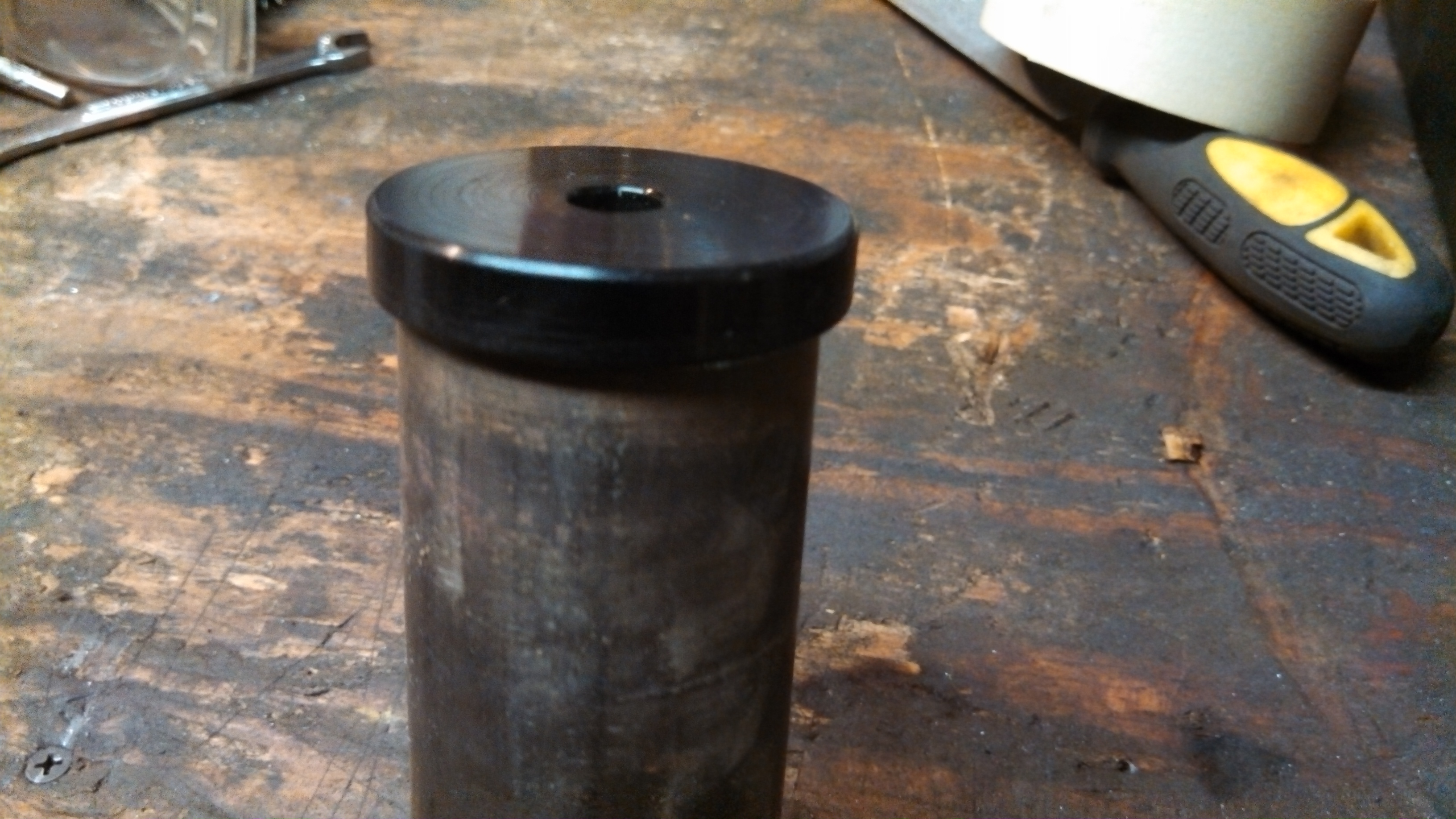

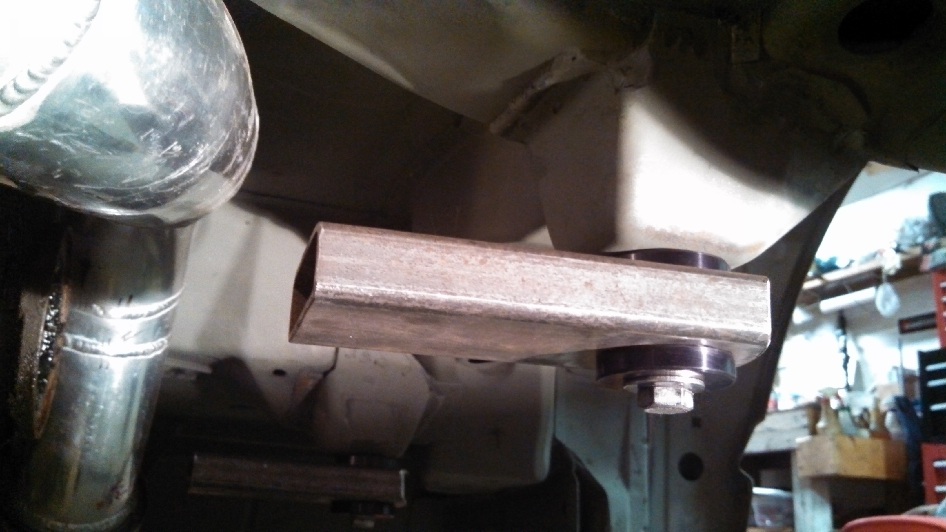

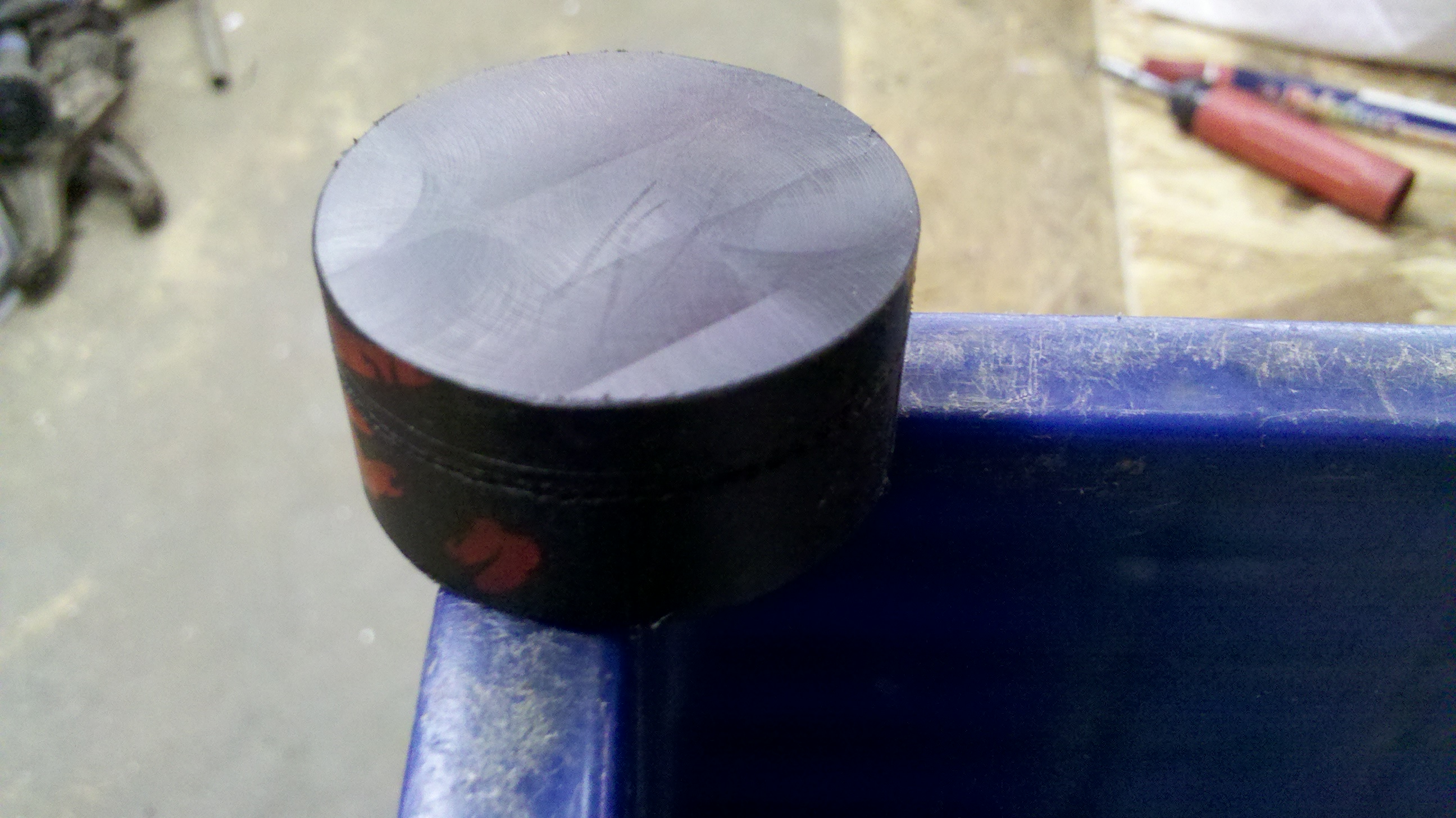

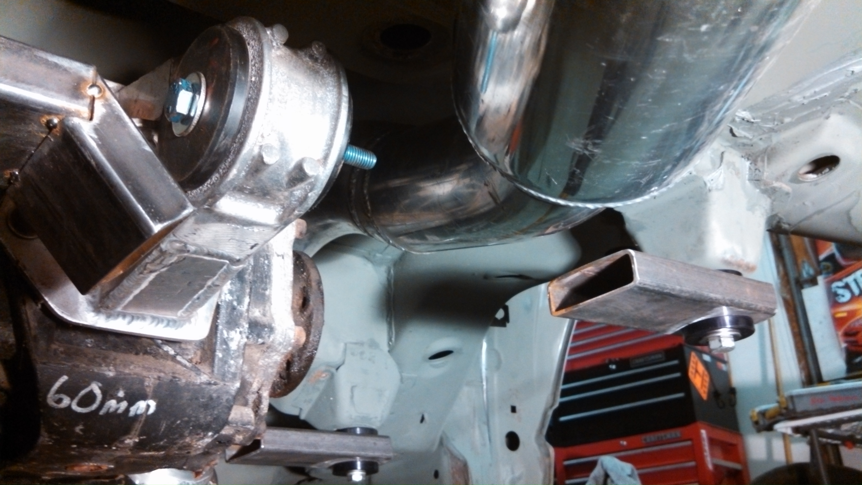

Ryan @ Higbee, made me a few spacers out of Delrin to replace the hacksawed versions I had earlier, much nicer and well, precise too.
I should've snapped some pics after the through hole drilling but ha
rear diff spacer bushing.jpg (965.2 KiB) Viewed 38337 times

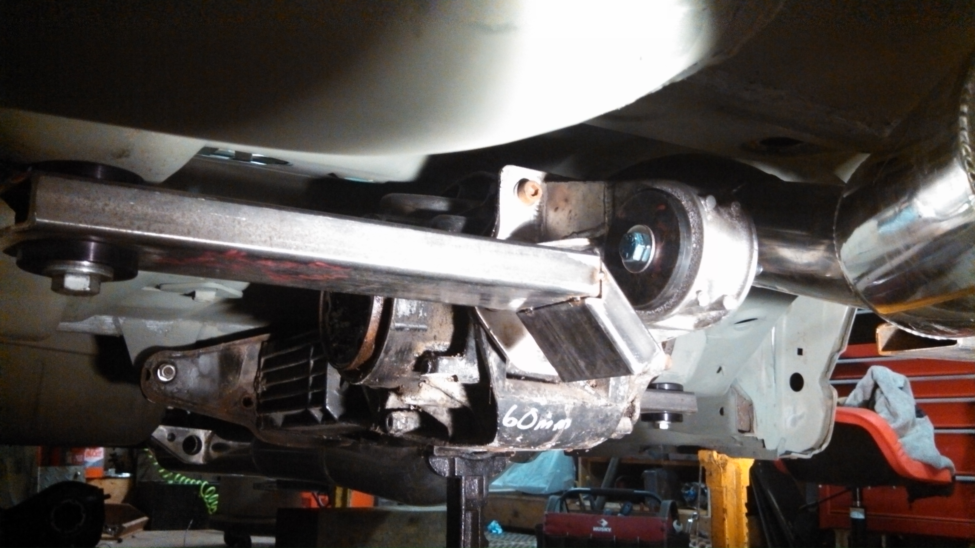

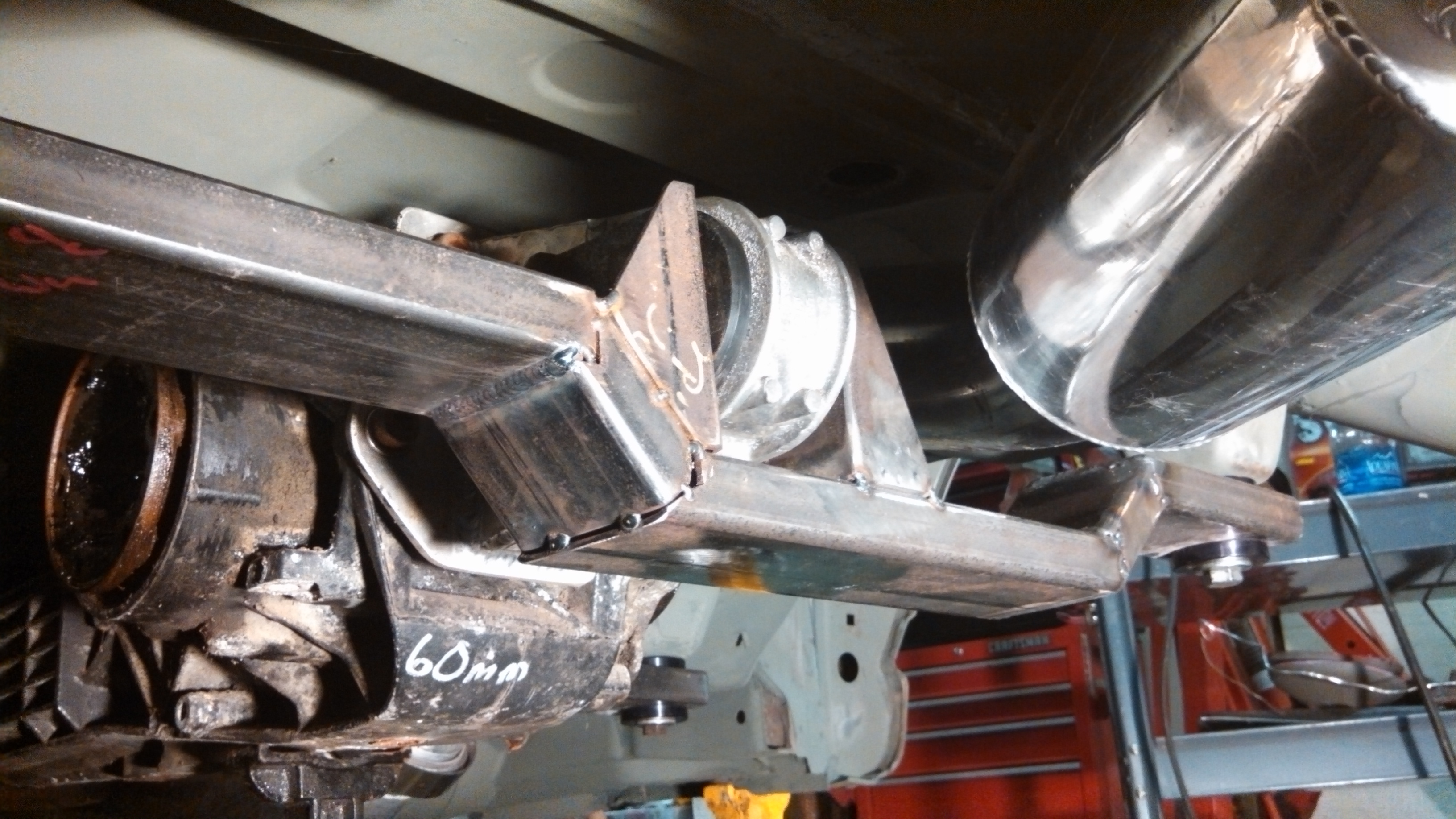

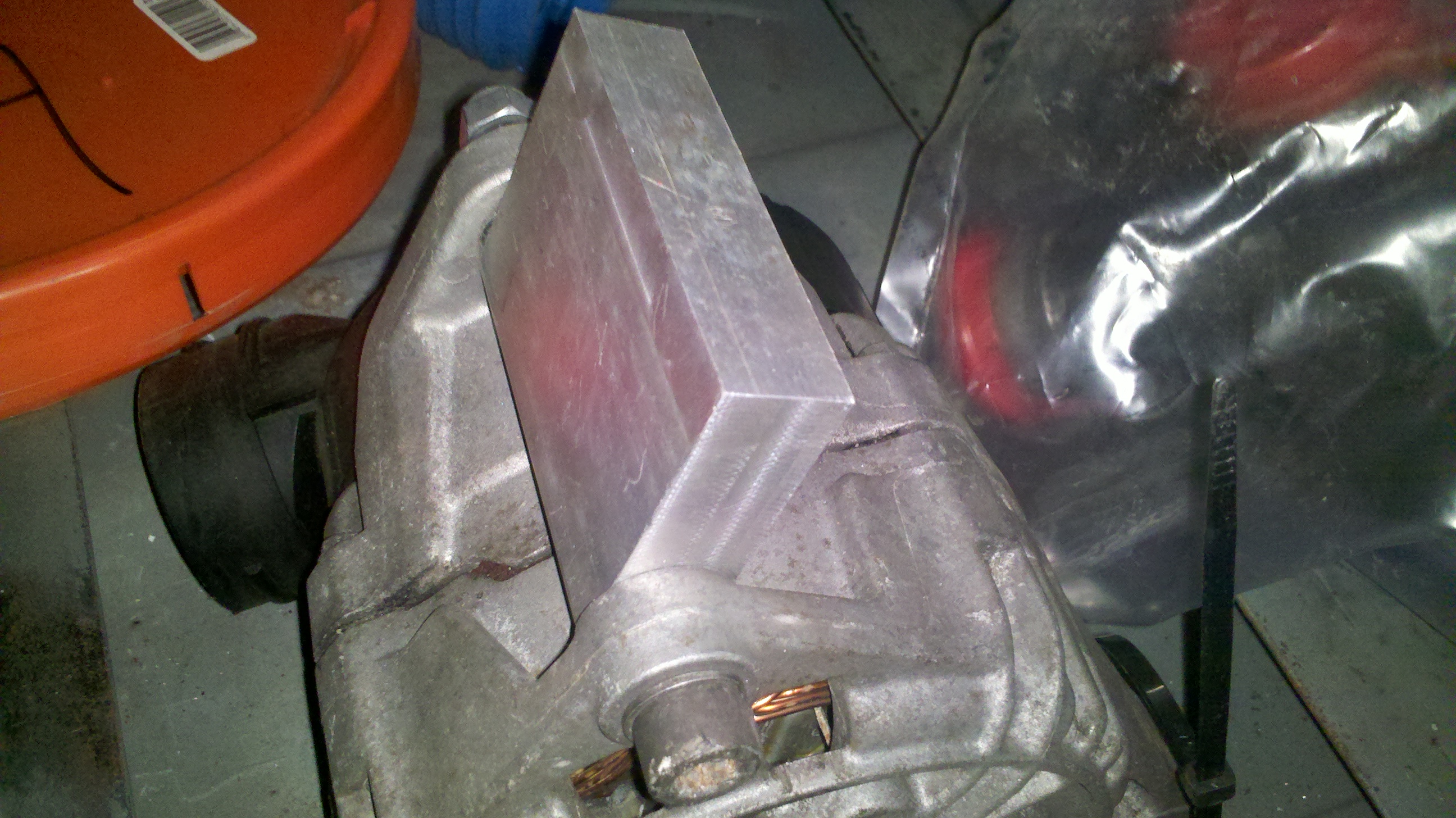

He also machined a piece of alu. down for mounting the ABZ 150A alternator on the rear diff mount. More on that to come.
abz alt mount machined.jpg (1.1 MiB) Viewed 38337 times

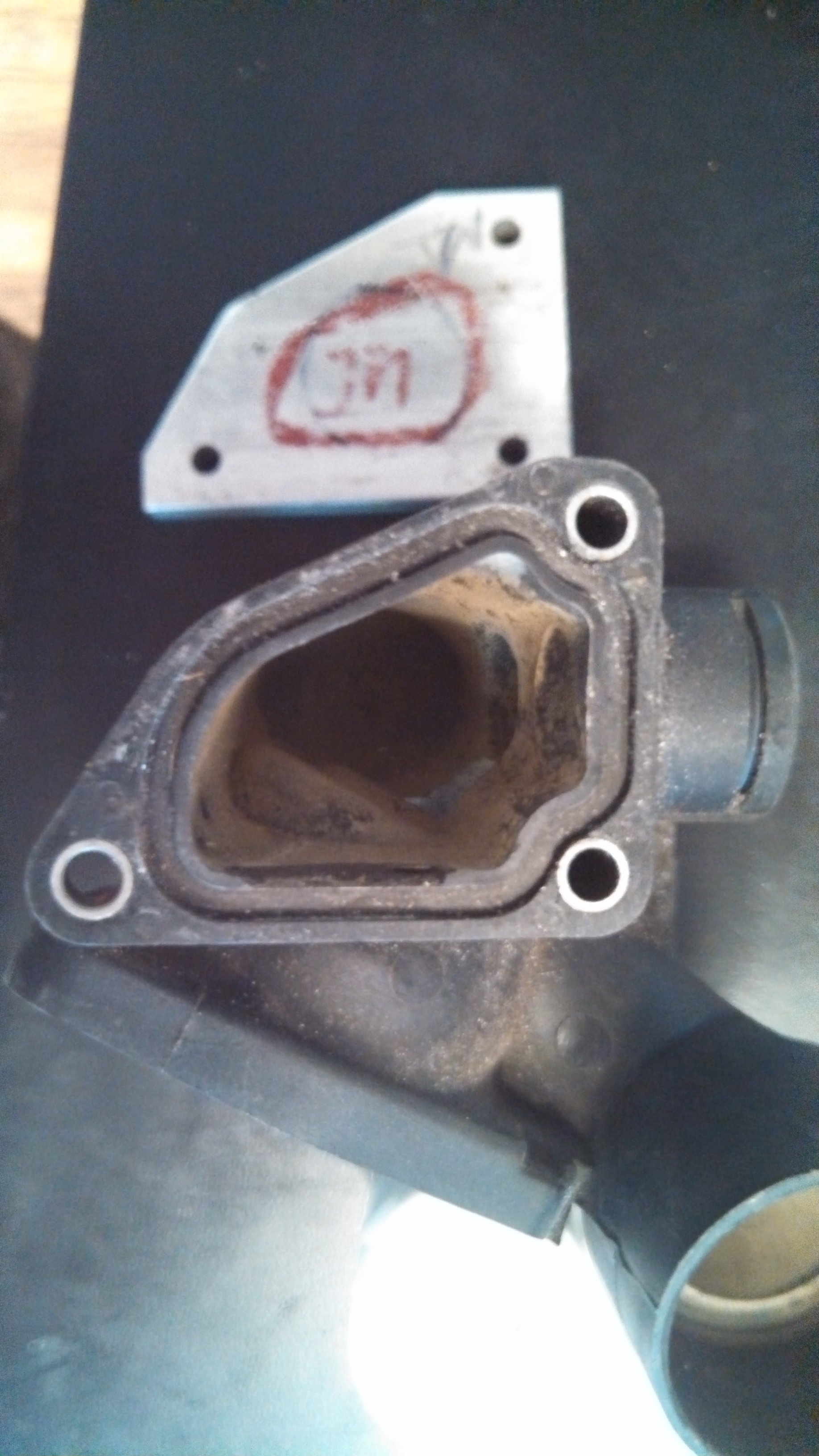

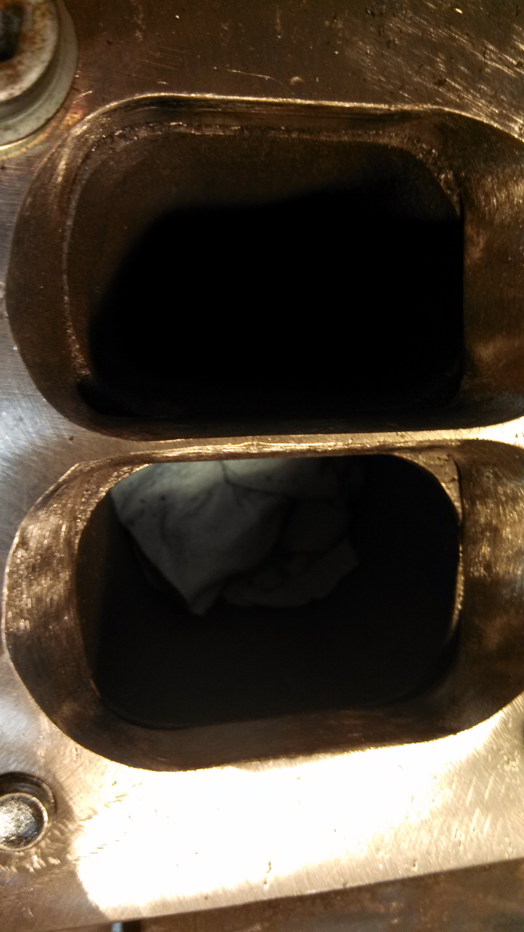

I also will be making a custom coolant flange setup to replace the bulky oem plastic piece. I’ve sent Hank @ Iroz Motorsports the oem flange and my flange to have the oem o-ring cut in. the custom coolant plumbing will gain me a lot of room that we lost when we scooted the motor back.
24v rear head coolant flange oring seal.jpg (1.28 MiB) Viewed 38337 times

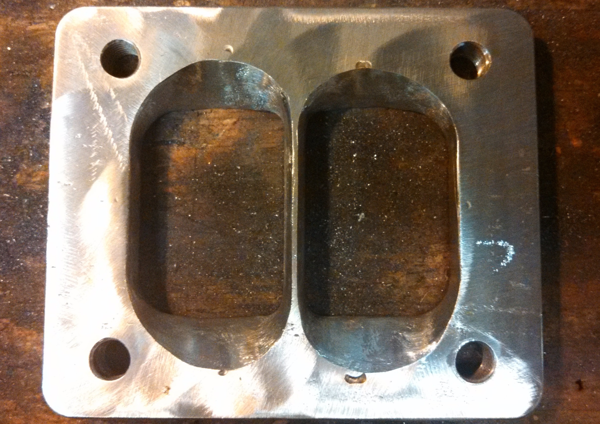

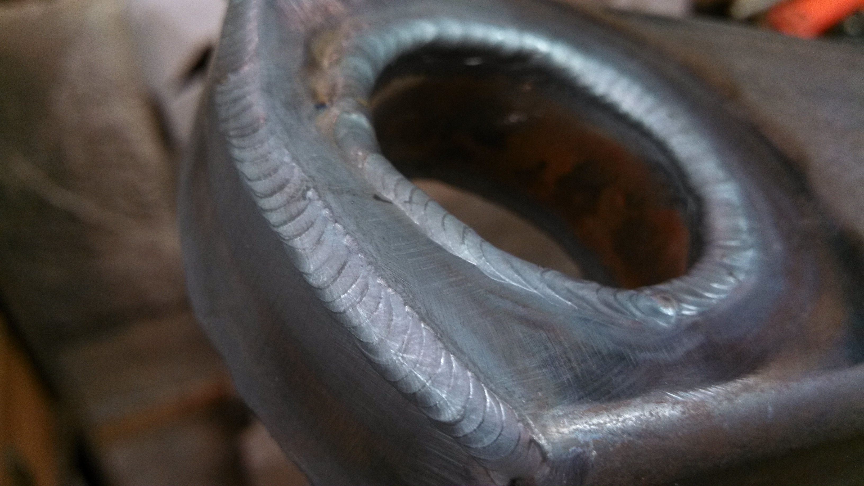

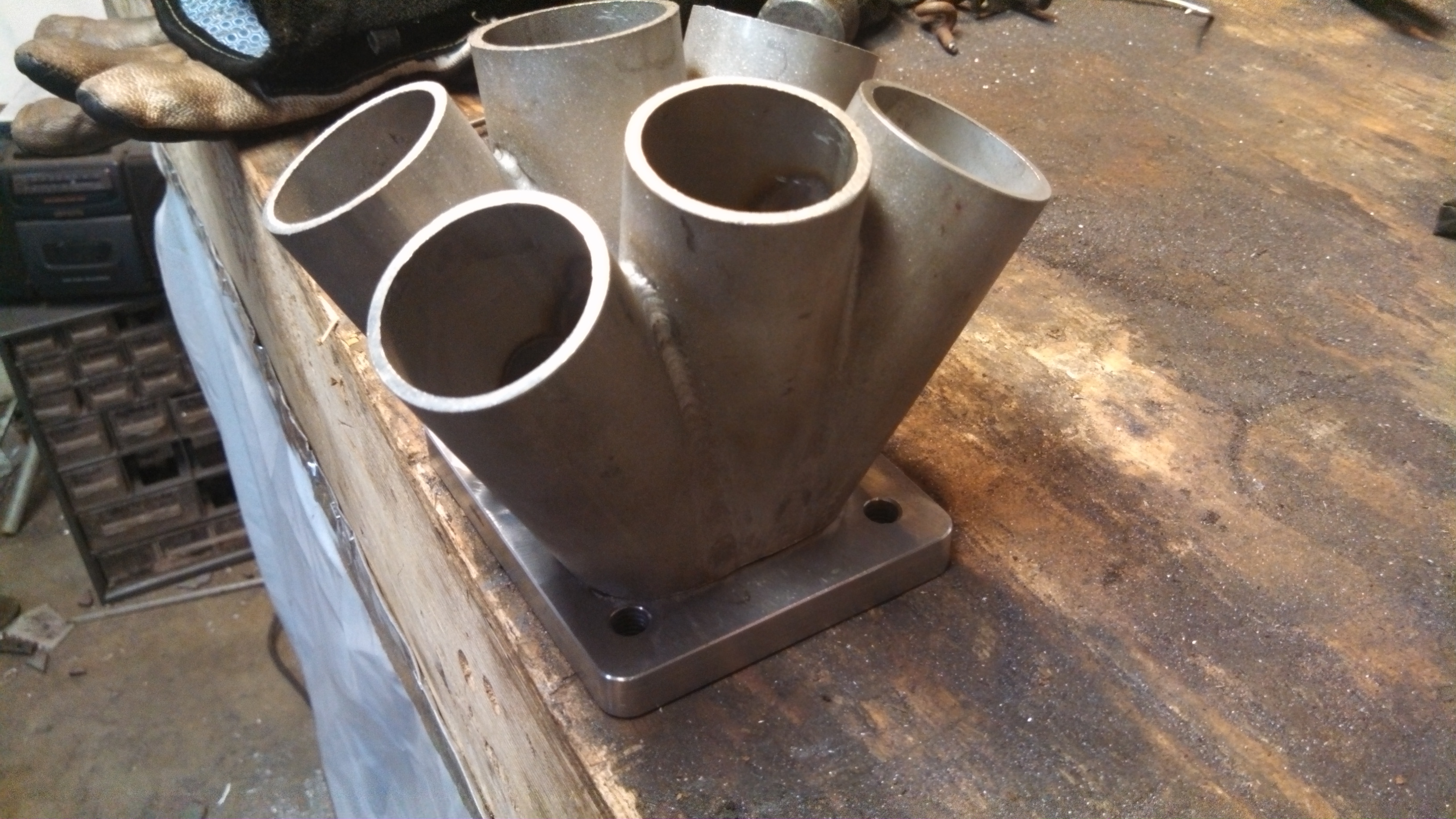

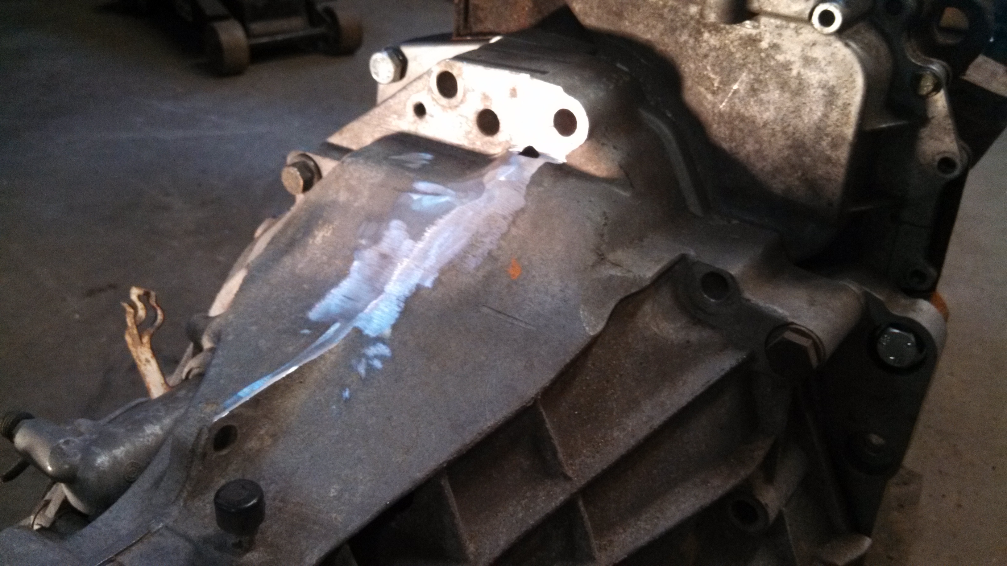

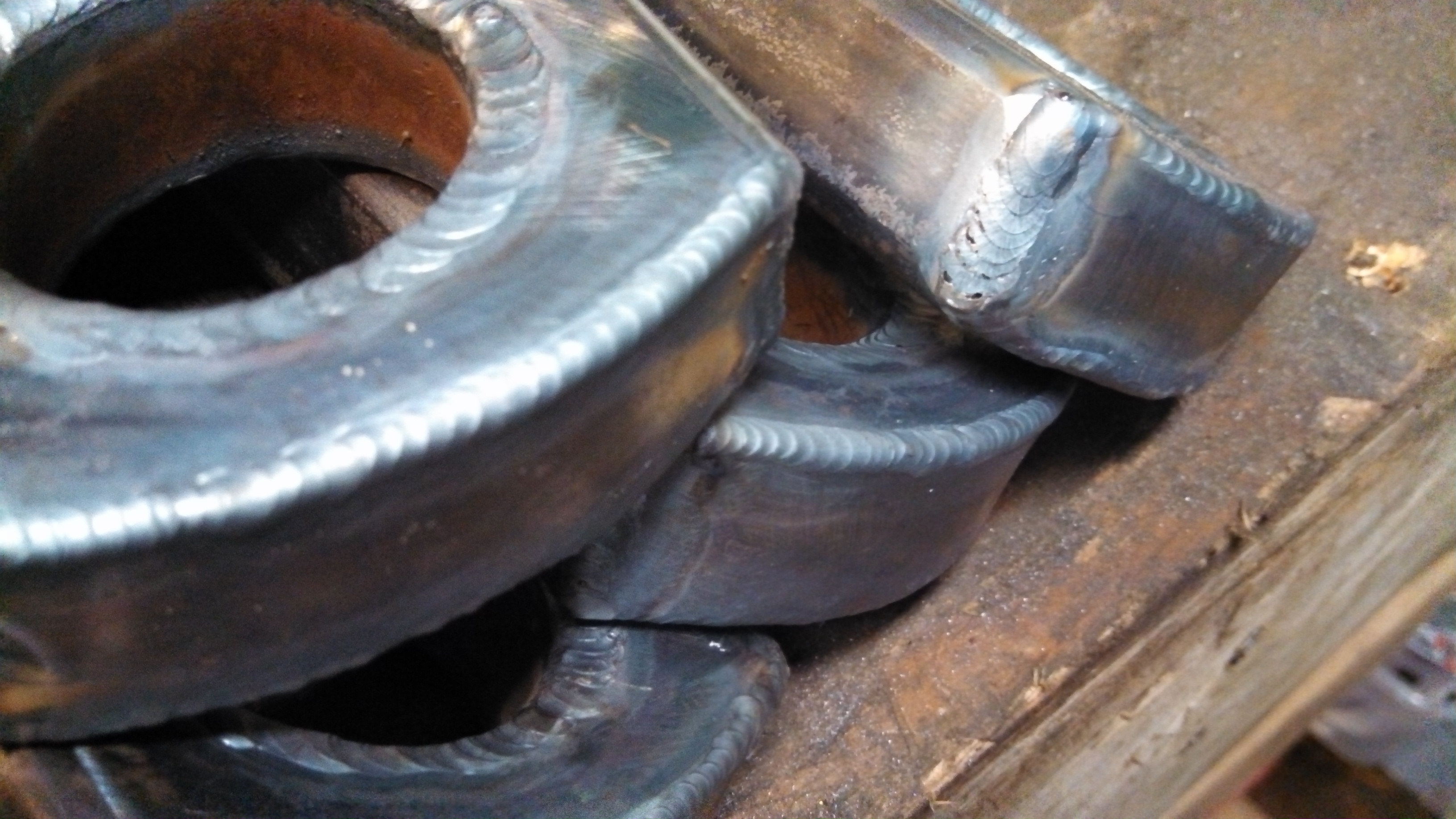

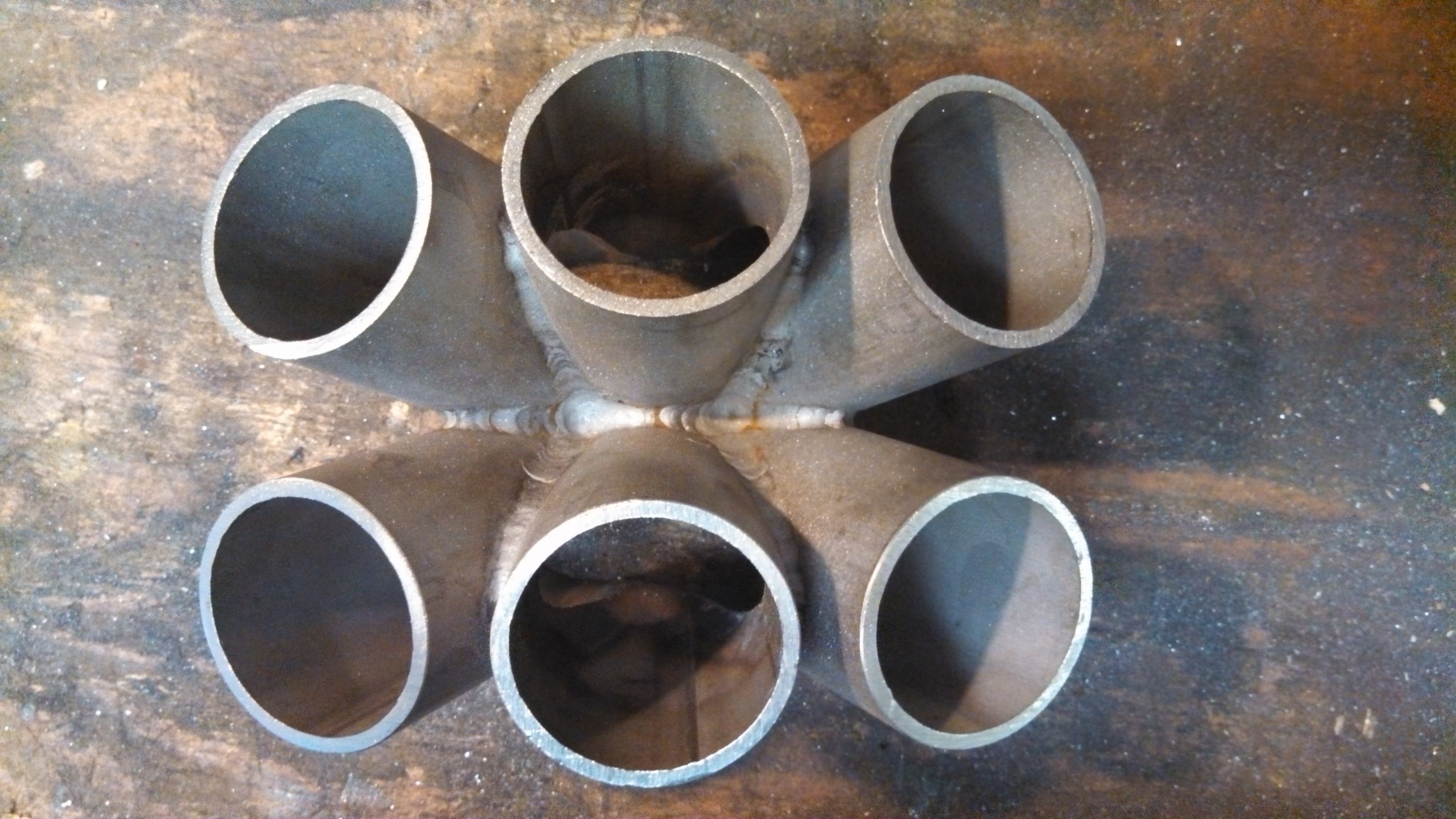

Ryan got a chance to seam weld the outer part of the exhaust manifold together. It needed to be about ¼” shorter on the tapered side and I really thought it would be a lot easier to hold in a vice and get shortened if was more than just tacked together. After seam welding I cut the collector down.
welded collector 2.jpg (1.67 MiB) Viewed 38336 times
welded collector and matched flange.jpg (1.7 MiB) Viewed 38336 times

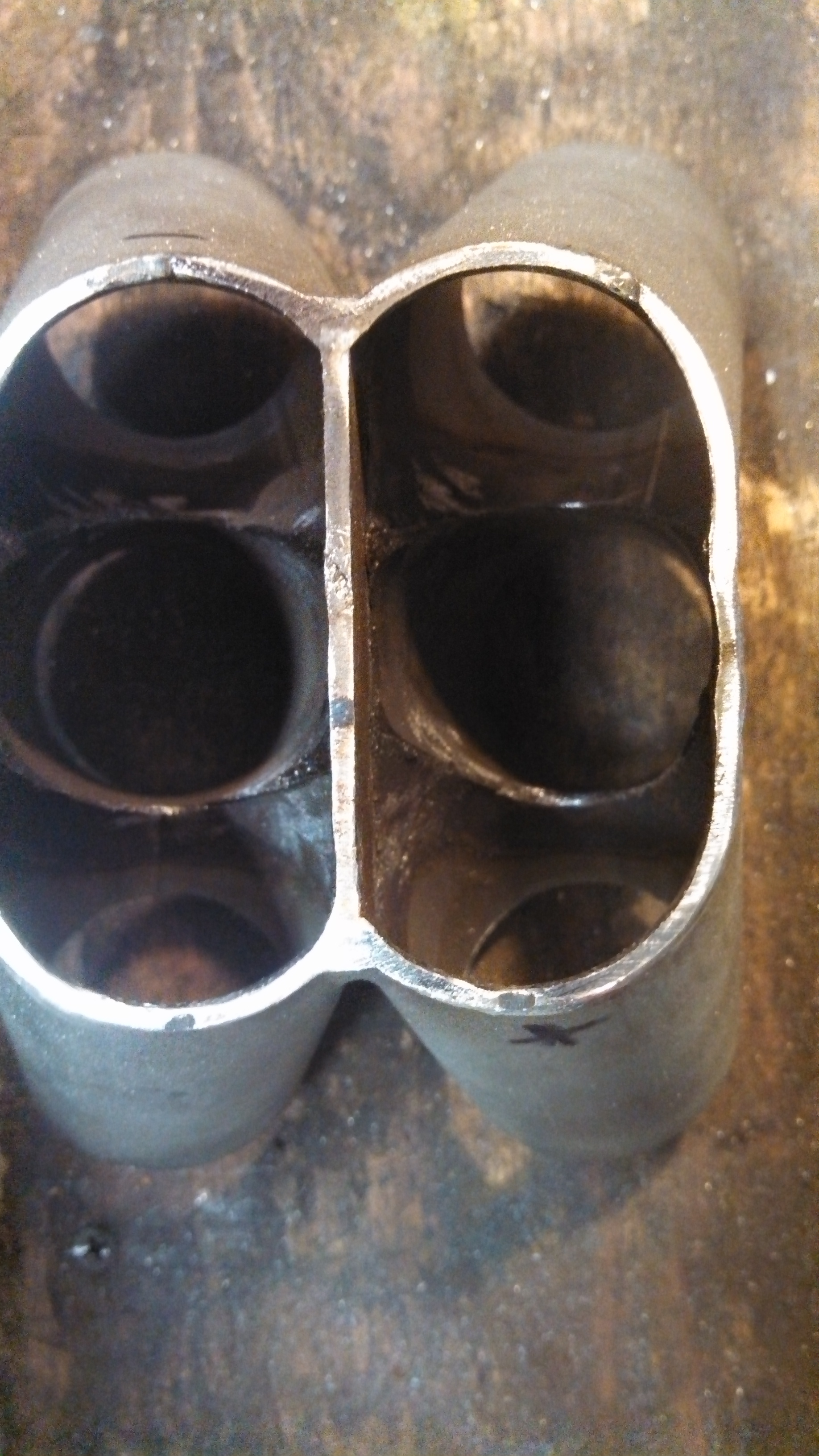

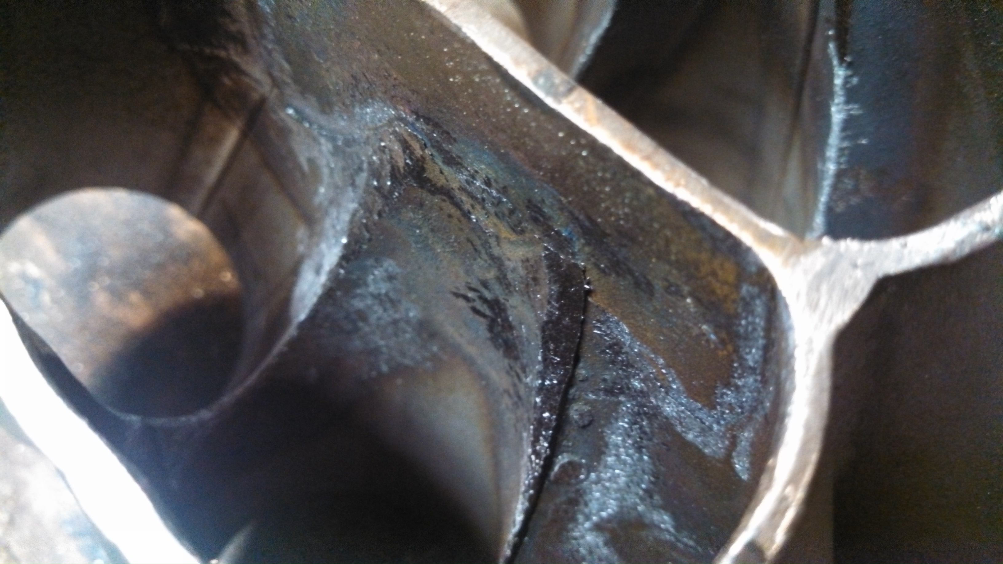

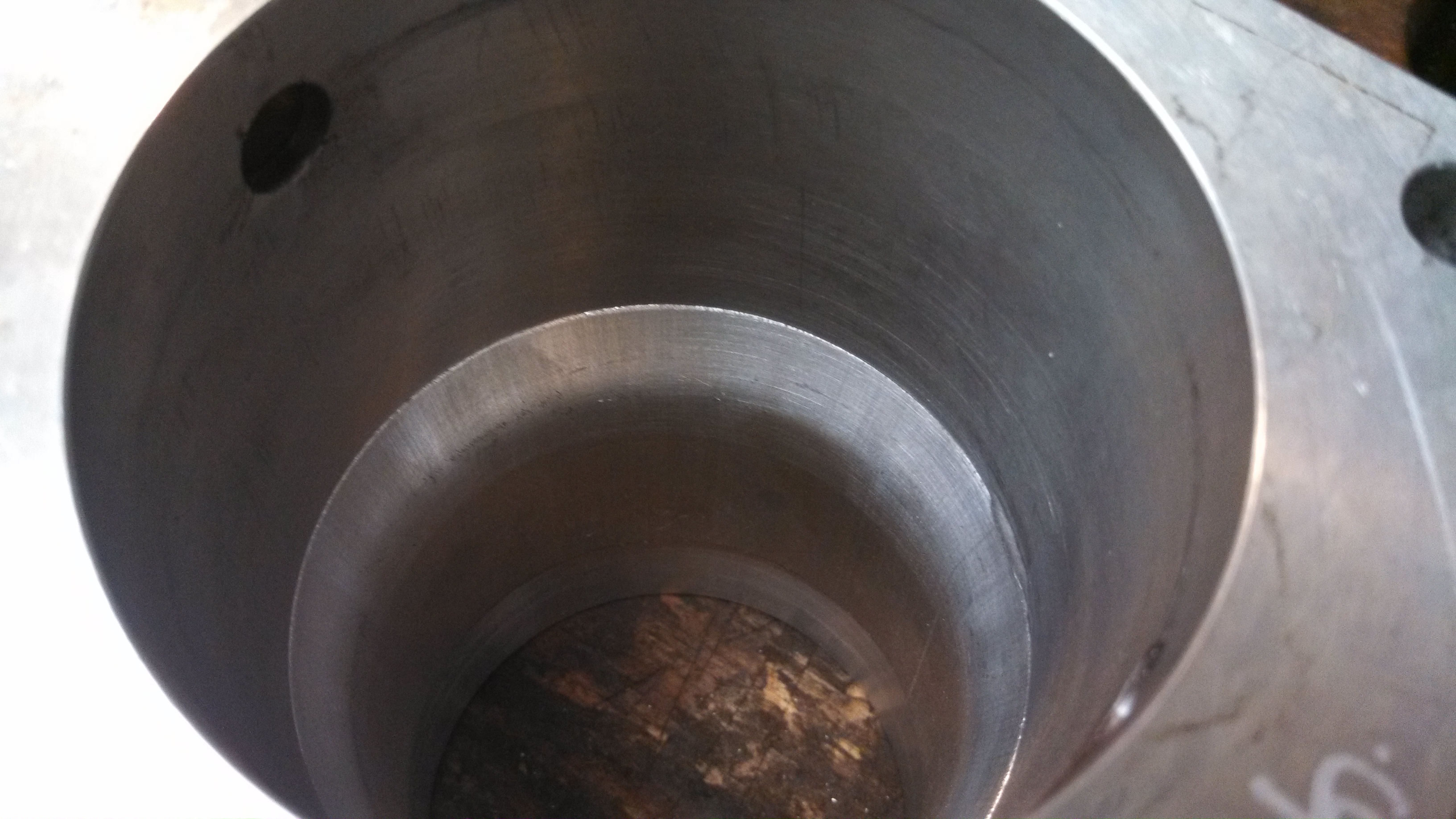

I used a set of fresh carbides to really clean up the inside of the collector for interior seam welding. It will be one sexy piece, that’s for sure.
cleaned up inner collector prior to inner seam welding.jpg (1.43 MiB) Viewed 38336 times
t4 divided collector down inside.jpg (1.42 MiB) Viewed 38336 times

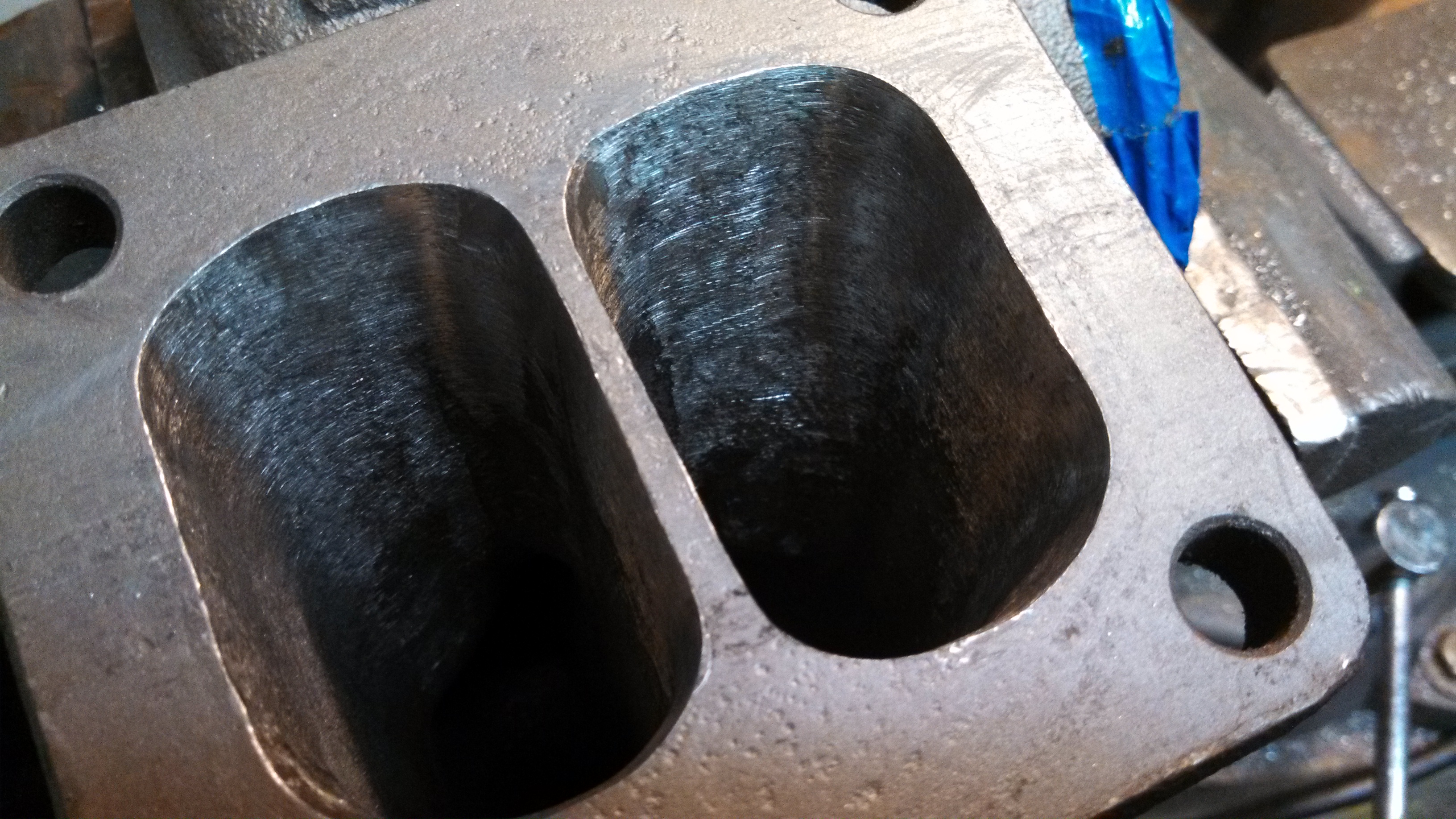

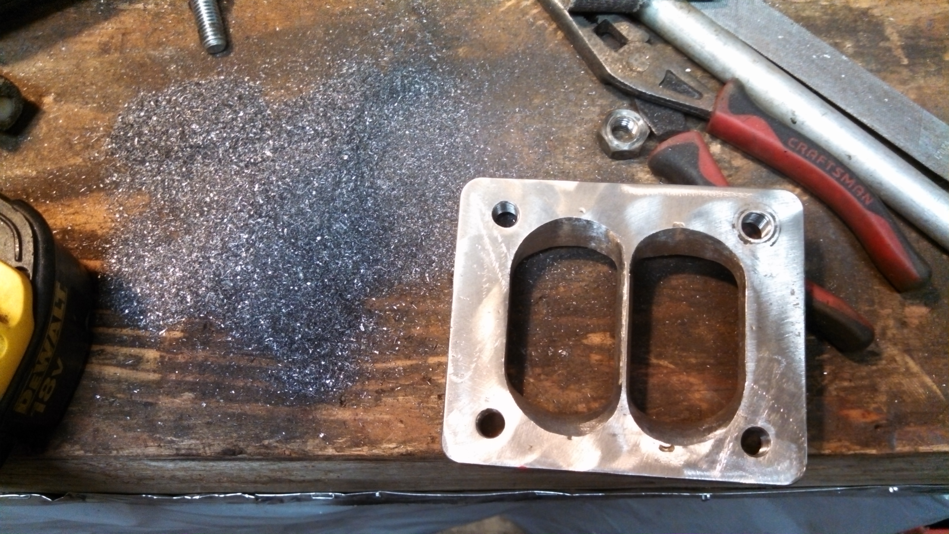

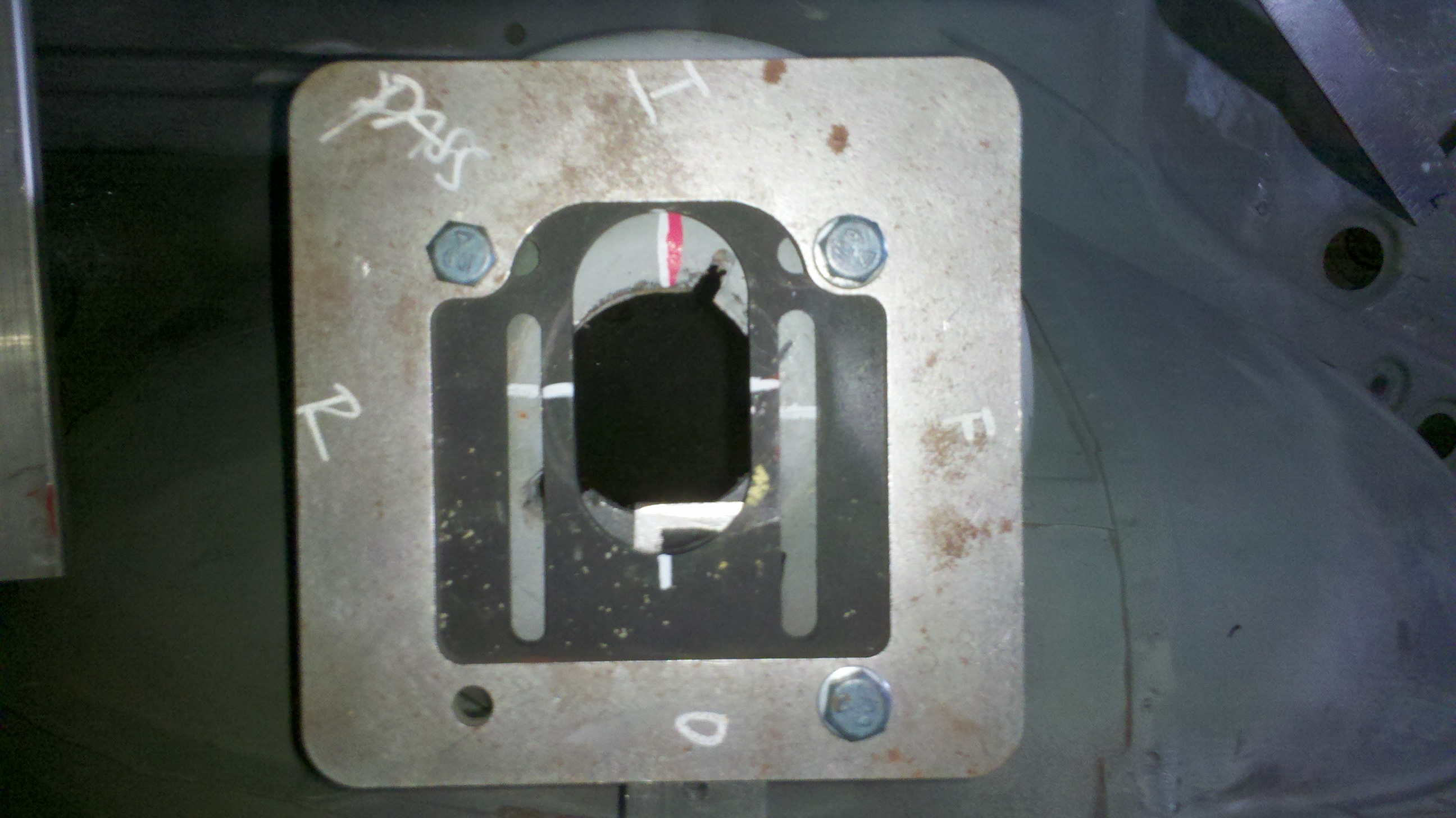

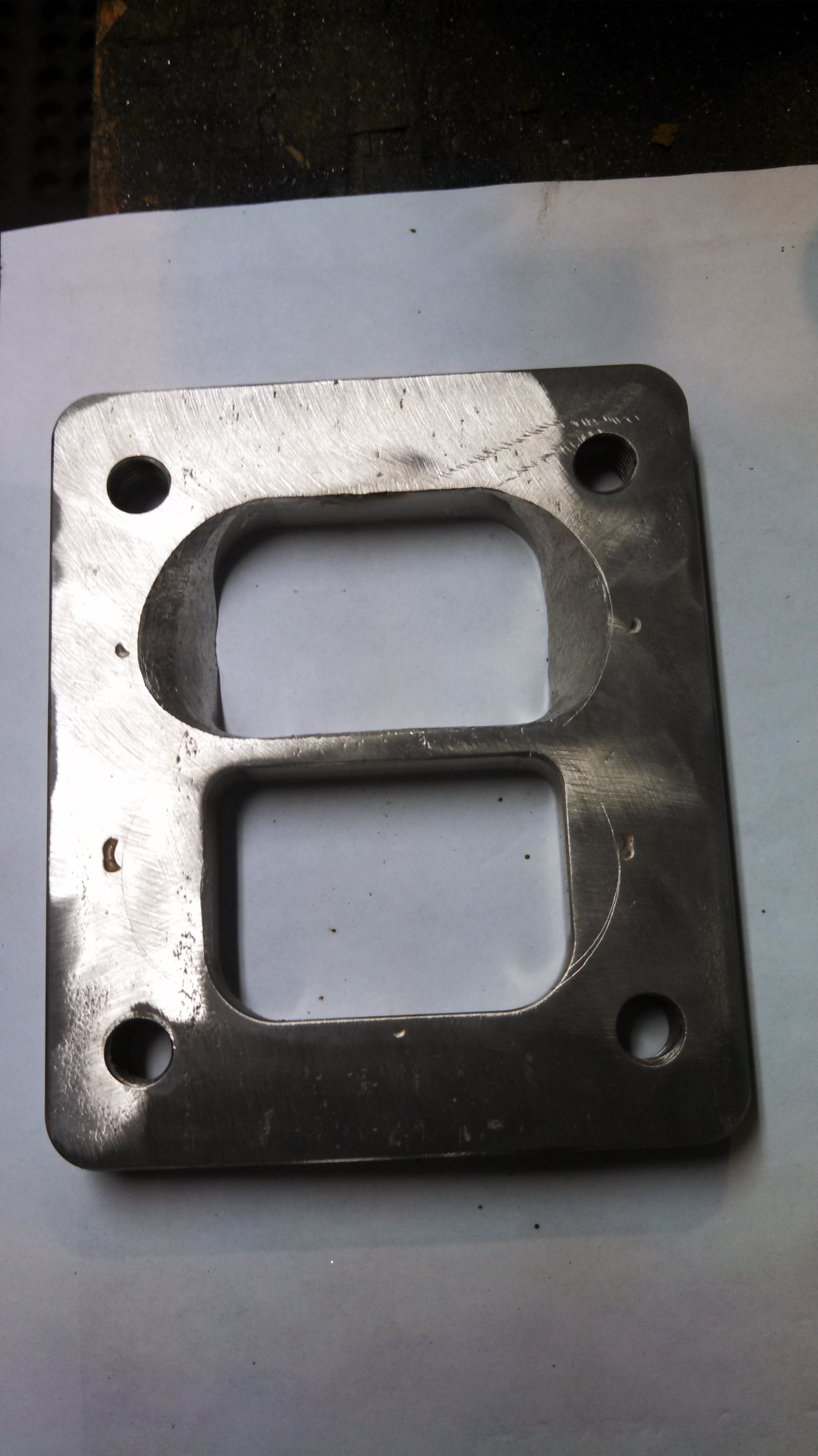

Then I matched/smoothed the t4 divided flange to the collector as smooth as possible. You can see there is quite a bit of flow to be gained by going the extra steps.
t4 flange matched.jpg (1.47 MiB) Viewed 38335 times
t4 flange matched to collector.jpg (1.84 MiB) Viewed 38335 times

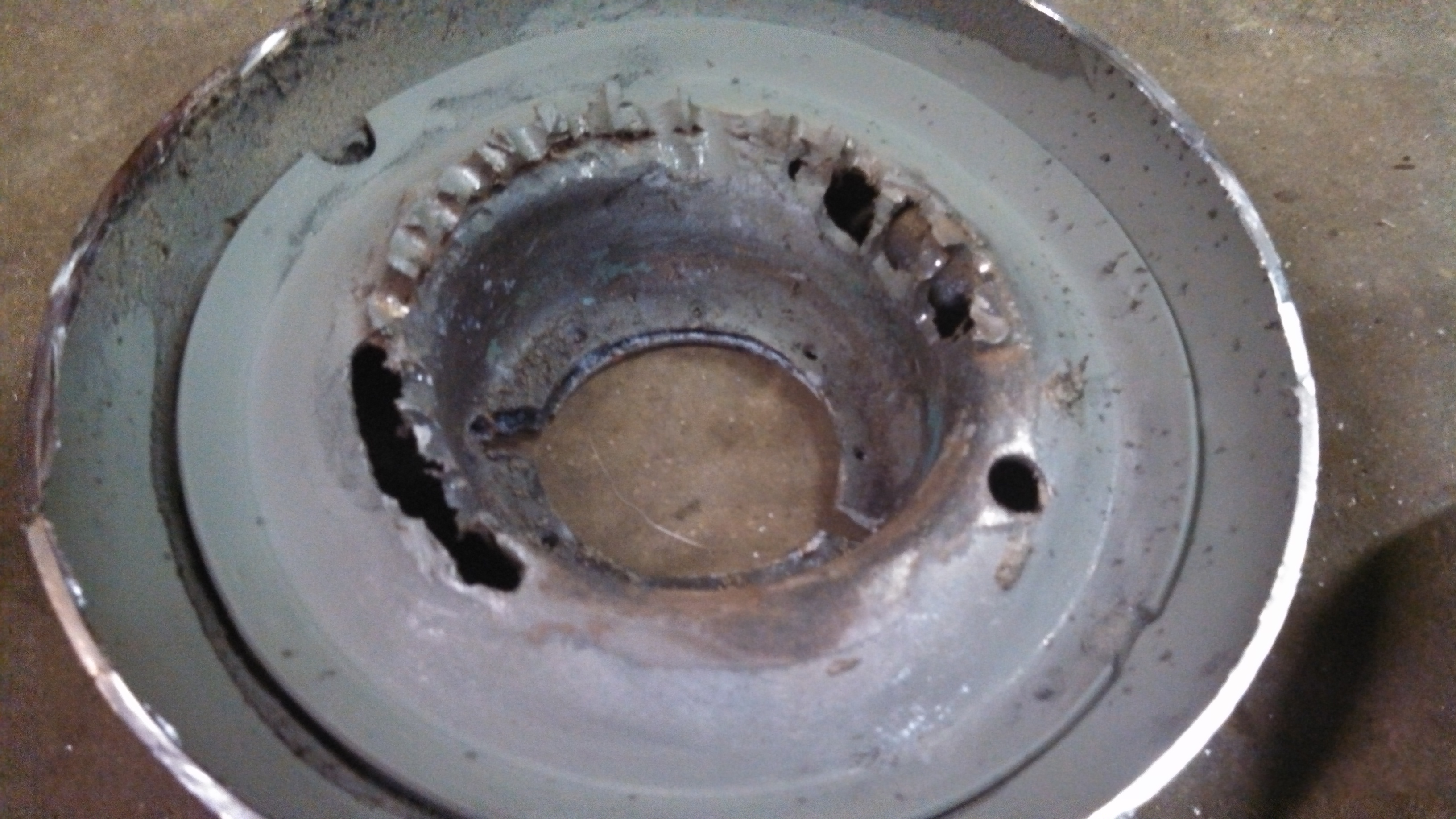

The t4 flange to hotside inlet transition has also been cleaned up. I’ve added a small anti-reversion lip which also helps the small bit of stud/hole misalignment, so there is never a sharp edge.
need to match t4 flange to hotside inlet.jpg (1.27 MiB) Viewed 38335 times

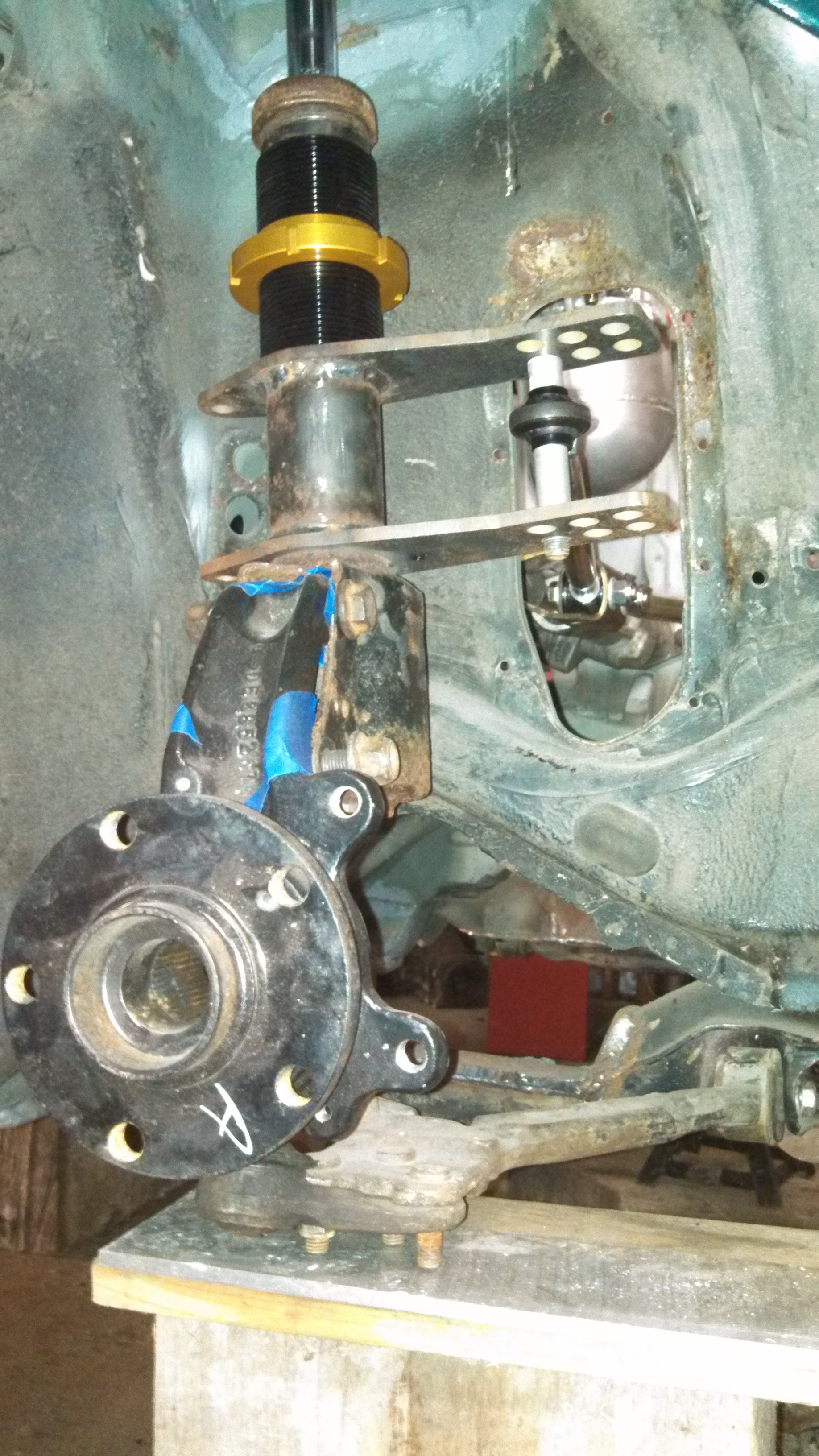

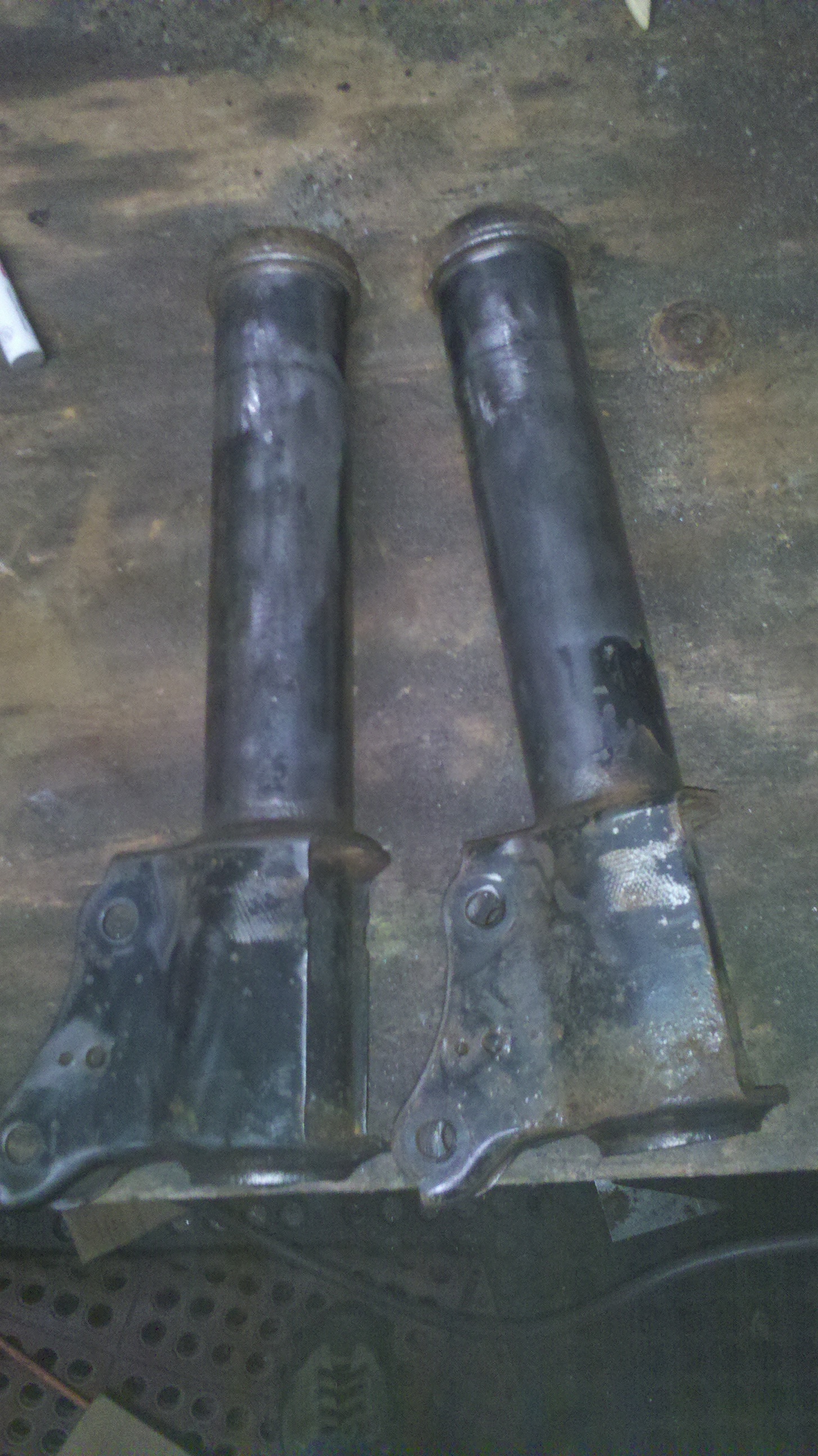

I’ve had all these strut tubes collected for a while and it was time to put them to use. I am using 2 pairs of b3 20v 90q/cq rear strut tubes, they are the larger diameter tubes that don’t taper at the top so you can run the larger inserts.
I cut all the spring seats off and got the cleaned up and prepped for welding.
rear strut tubes all cleaned up.jpg (1.07 MiB) Viewed 38334 times

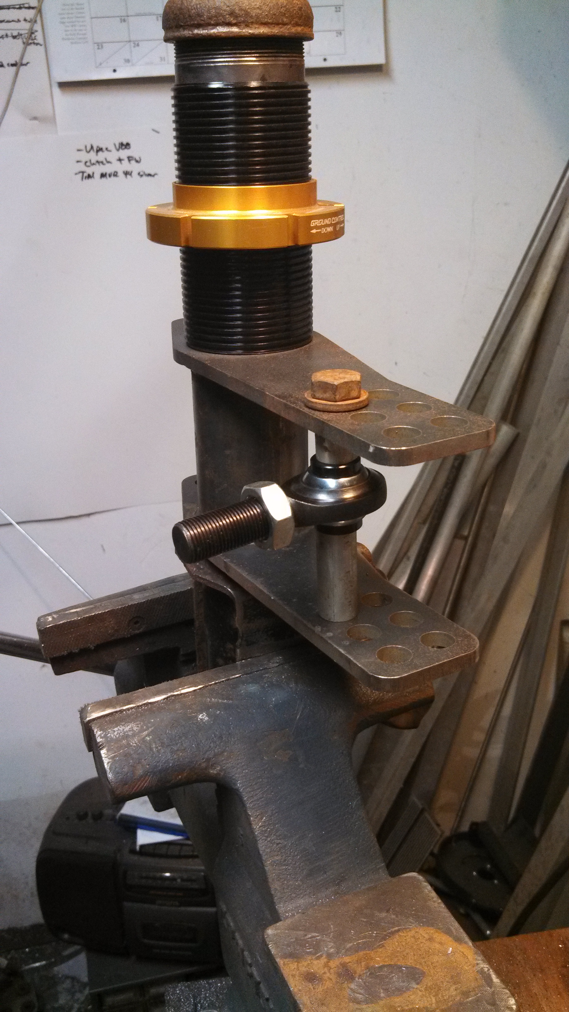

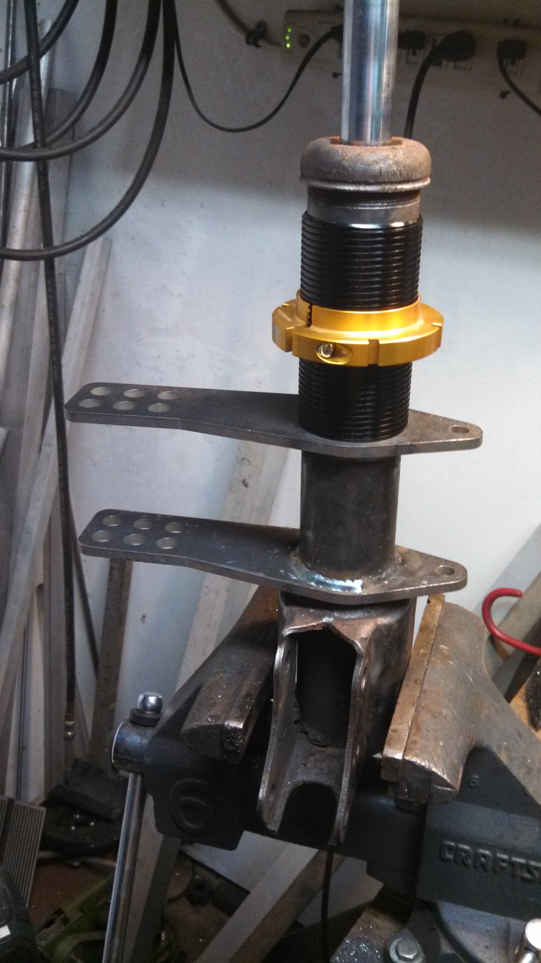

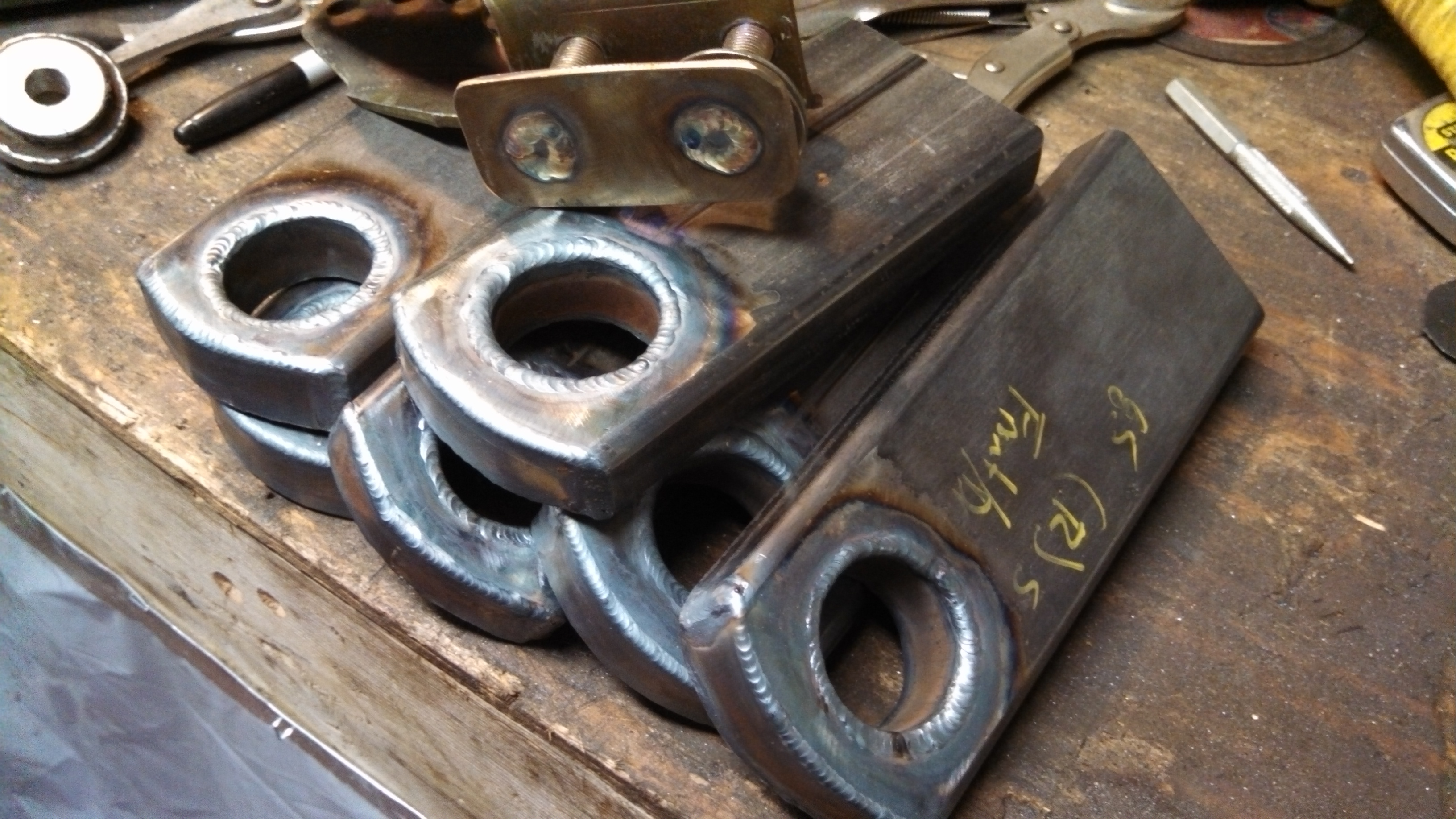

I went down to see Haydn @ HTMS to get a set of the shorter/lower/ turned in steering arms. I got my struts set up on the jig and they got welded up, no process pics as I lost my phone right after.
Here they are welded up with coilover sleeves and spring perches in mockup mode.
HT steering arms welded on and coilover sleeves and perches.jpg (1.88 MiB) Viewed 38334 times
HTMS steering arm w rodends.jpg (1.98 MiB) Viewed 38334 times

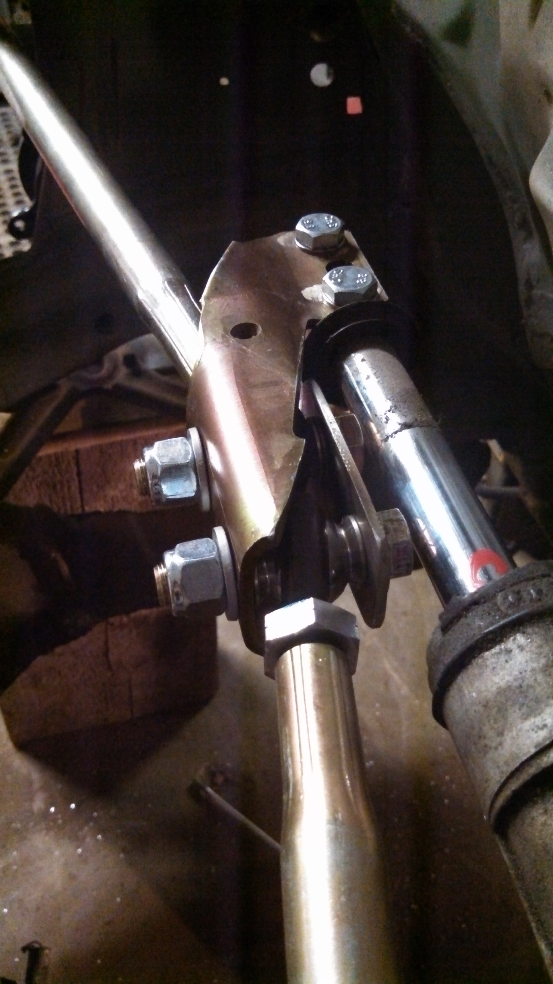

I also made a bracket for the steering inner rod ends.
I have smaller width jam nuts for the inner now as well.
steering rod inner bracket mockup.jpg (1.2 MiB) Viewed 38334 times

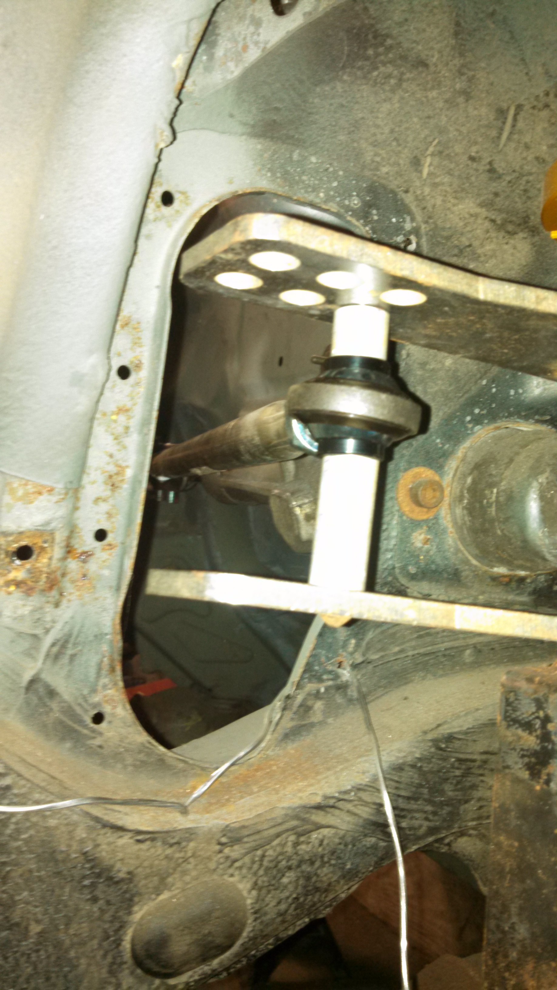

In order to run the tightest steering setting I’ll have to move the steering rod holes rearward a bit. Heres some mockup pics
wheelwell mockup.jpg (1.85 MiB) Viewed 38334 times
HTMS steering arms in wheelwell.jpg (1.36 MiB) Viewed 38334 times

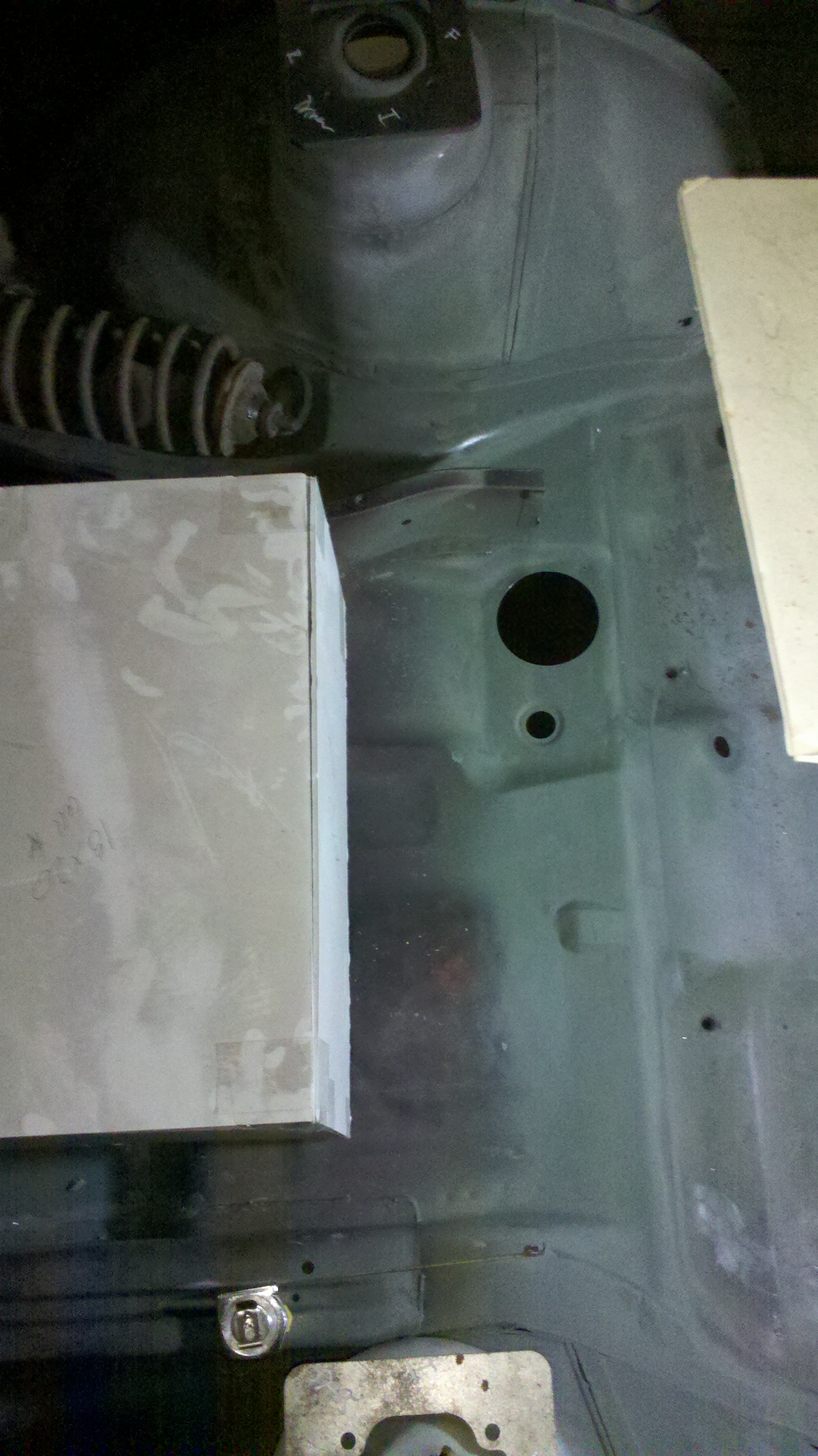

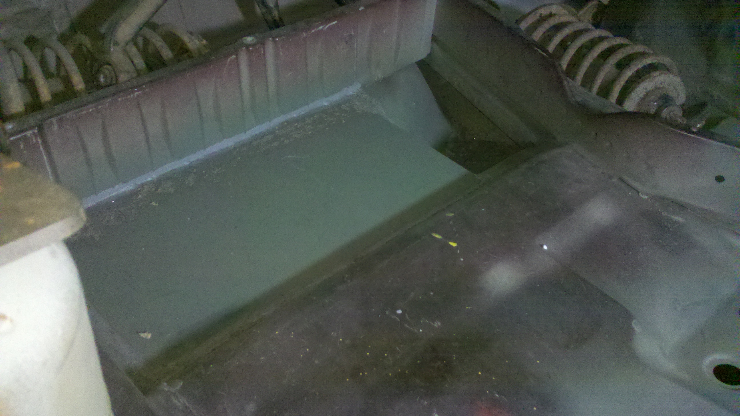

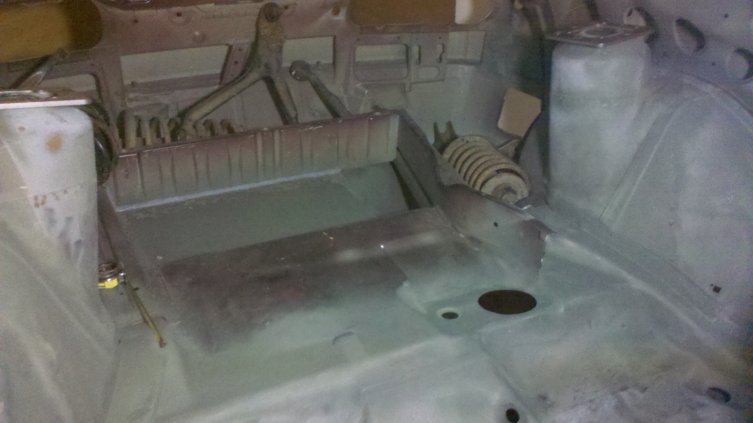

More body mods. I’m certainly not going to run a rear seat, so that sheet metal had to go. I got the spot weld driller bit out and went at it. Not a lot of pics, but here it is sans rear seat metal.
rear seat sheet metal gone.jpg (1.26 MiB) Viewed 38332 times
pass side rear seat sheet metal cleanedup.jpg (1.07 MiB) Viewed 38332 times
driver side rear seat sheet metal cleanedup.jpg (1.12 MiB) Viewed 38332 times

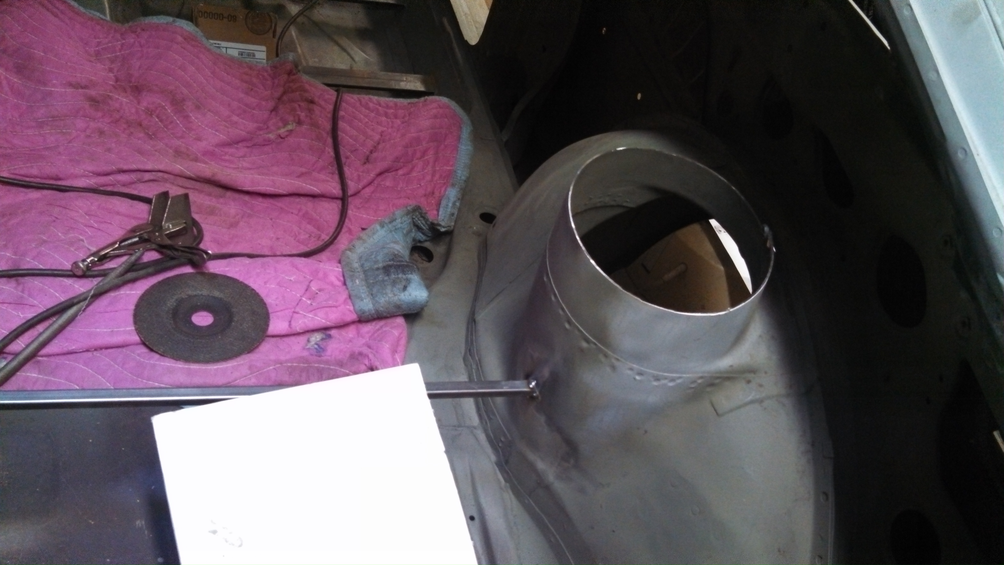

floor patch and cell location.jpg (1.2 MiB) Viewed 38332 times

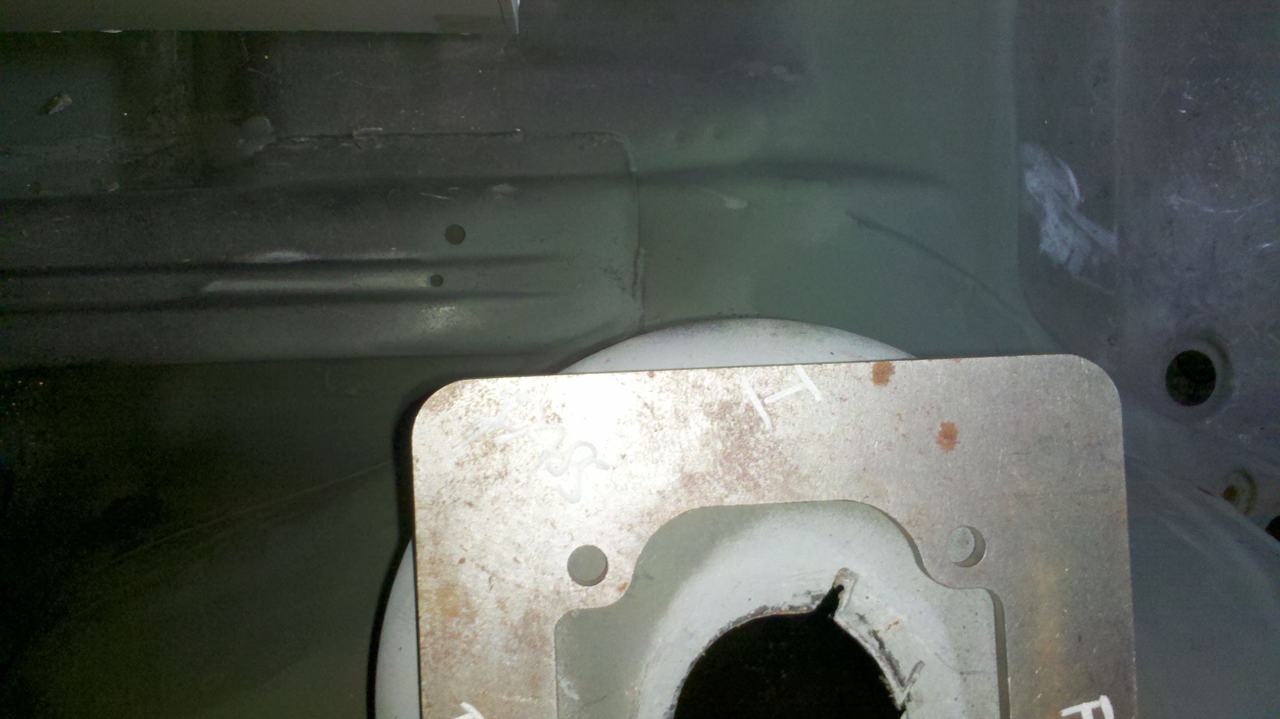

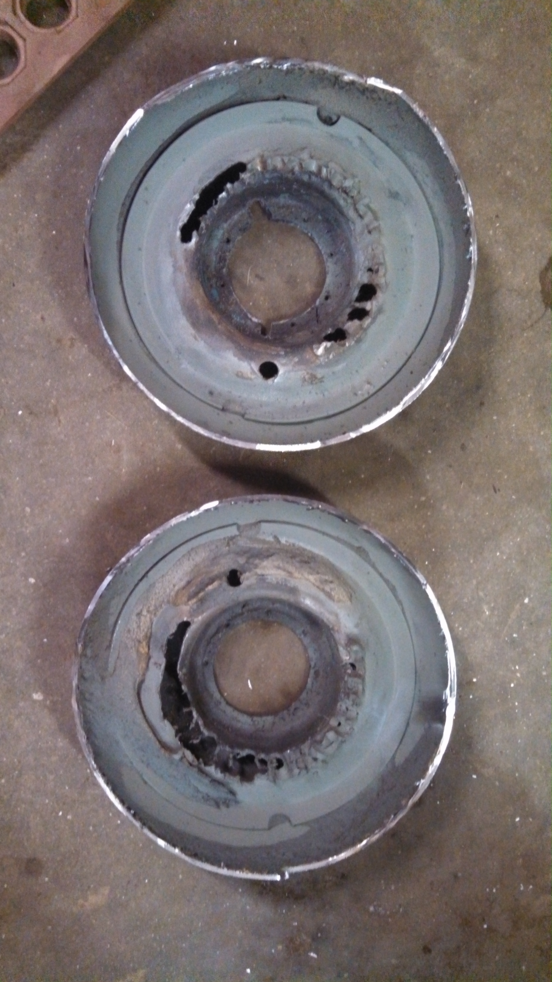

As you may remember from a previous episode, the rear strut top mount receviers in the body were F’d, bigtime. Here they are if you don’t remember what they look like. GROSS. Im still not really sure what happened to the car in a prior life but dang. There are cutting disc marks on the top, suggesting a seized topnut/cup. And some MIG bead and drill marks underneath, for who knows what reason. Beats me. Not worried about it. So I started cutting them out for the adjustable Ground control mounts.
between rear strut towers.jpg (1.05 MiB) Viewed 38549 times
both mangled mounts wtf happened.jpg (1.48 MiB) Viewed 38549 times
mangled rear driver side strut mount.jpg (1.51 MiB) Viewed 38549 times
mangled rear pass side strut mount.jpg (1.45 MiB) Viewed 38549 times

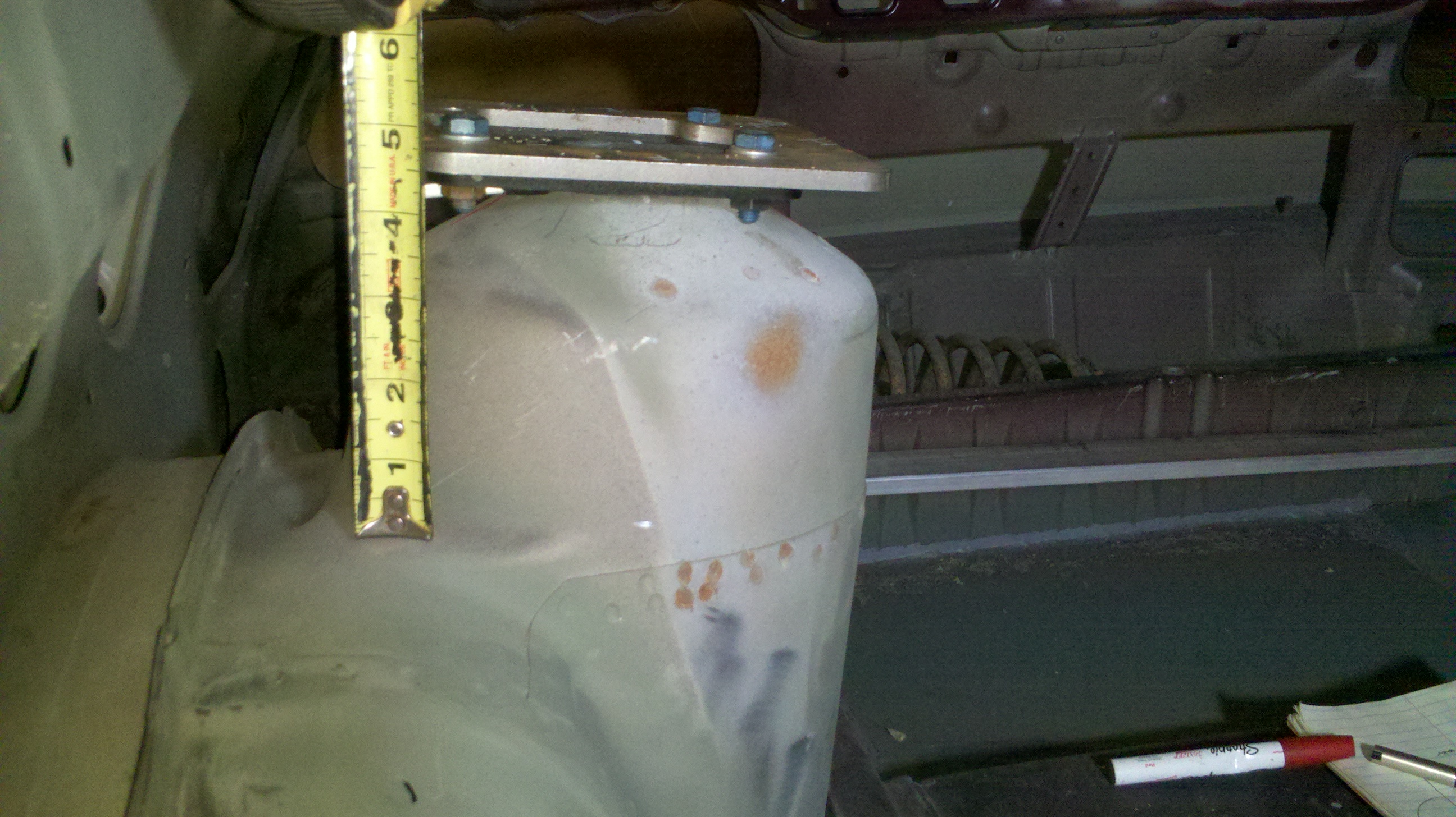

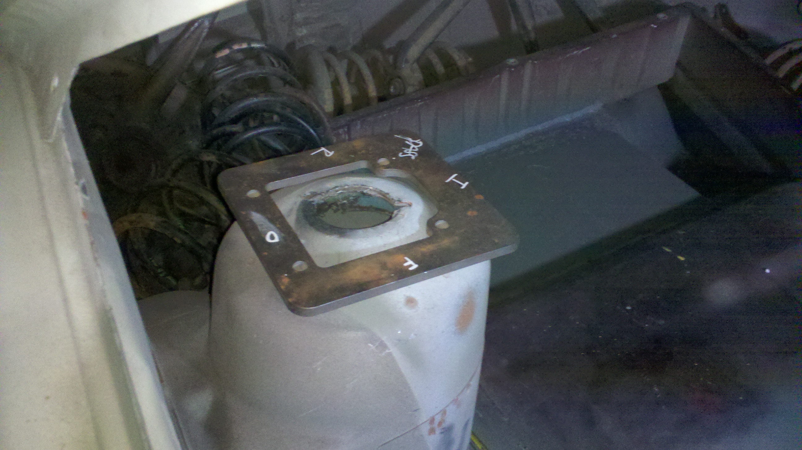

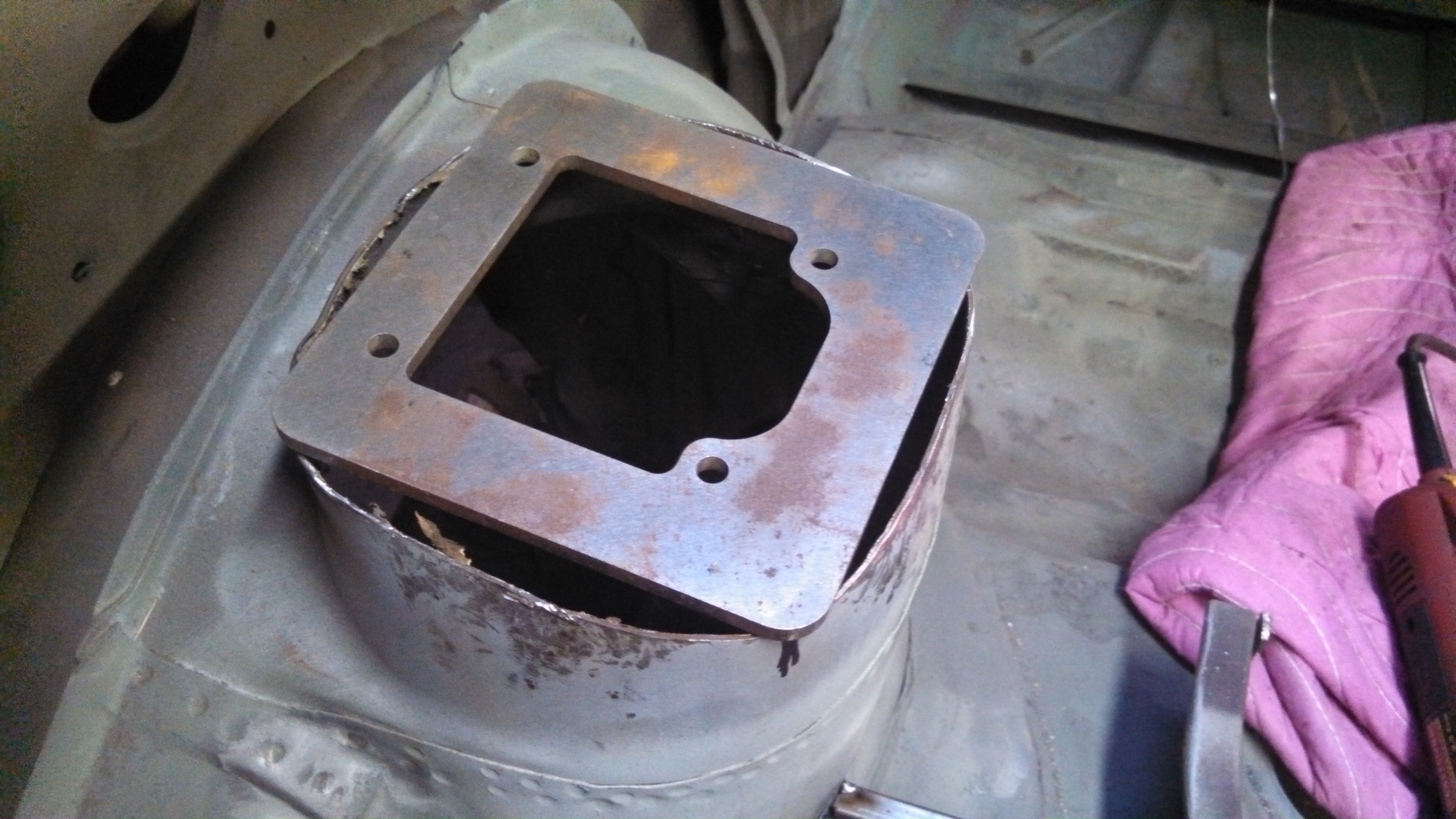

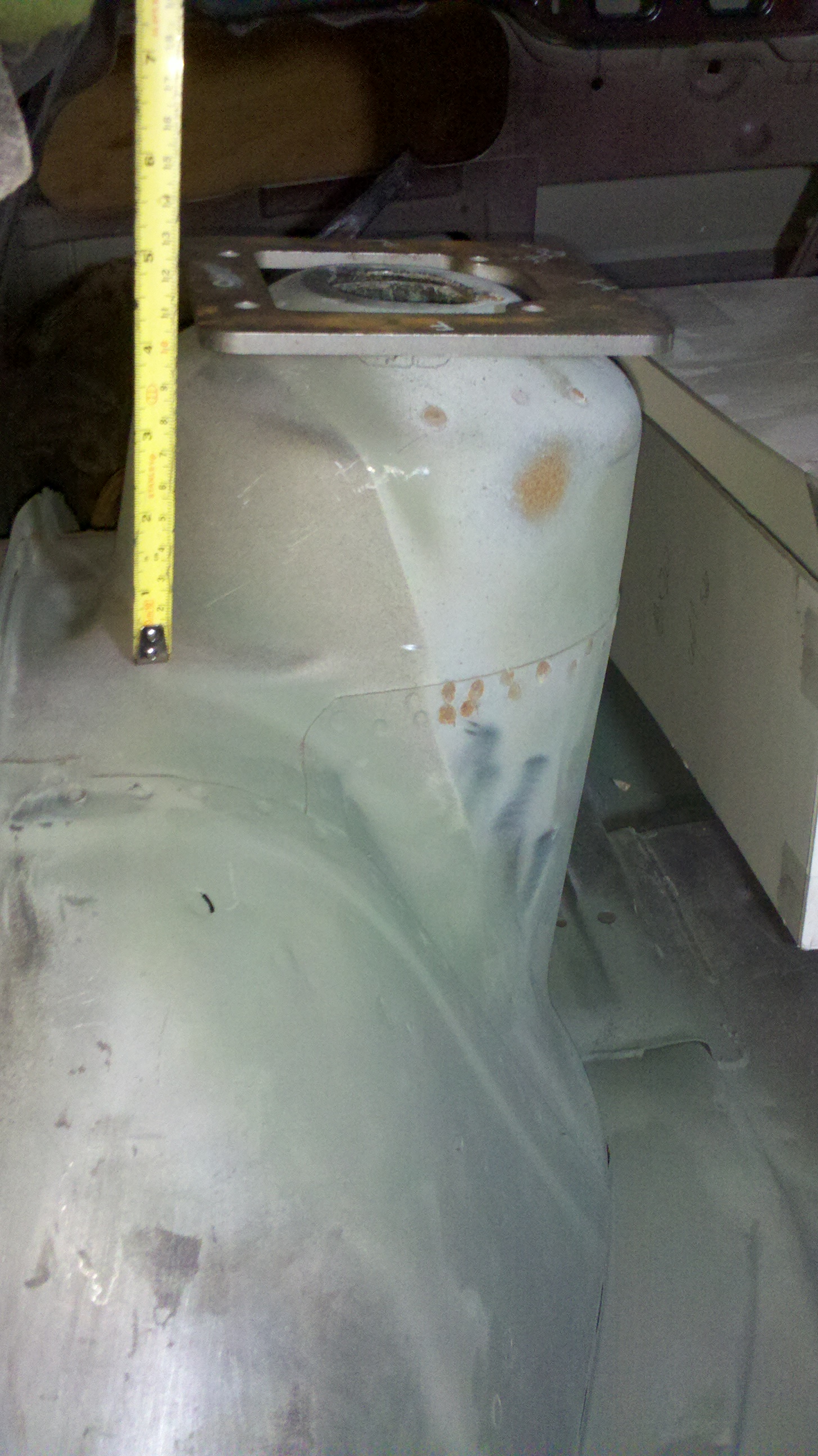

I got the oem rear strut tops cut out after lots of staring and getting myself ready to cut big holes in my nice clean chassis.
Here the new tops are sitting on the oem tops while I get things measured out.
strut top from above.jpg (927.93 KiB) Viewed 38498 times
strut top height.jpg (1.11 MiB) Viewed 38498 times
rear strut tops mockup3.jpg (1.25 MiB) Viewed 38498 times
rear strut tops mockup2.jpg (925.81 KiB) Viewed 38498 times
rear strut tops mockup.jpg (1004.24 KiB) Viewed 38498 times

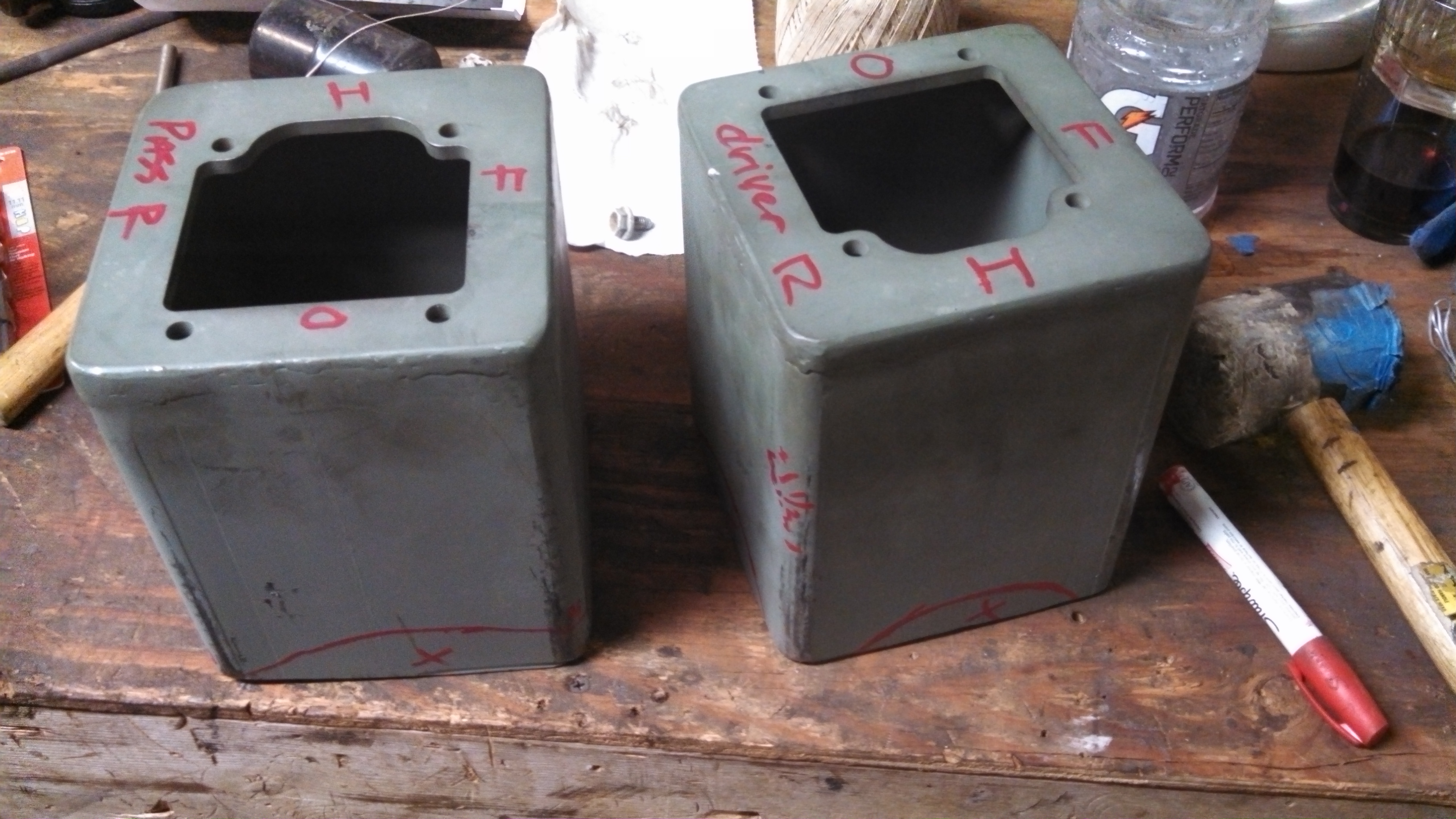

Got the oem tops cut out, now comes hammering into shape time!
oem passenger strut mount cutoff.jpg (1.27 MiB) Viewed 38498 times
oem driver strut mount cutoff.jpg (1.49 MiB) Viewed 38498 times
closeup of strut tower change of shape.jpg (1.44 MiB) Viewed 38498 times

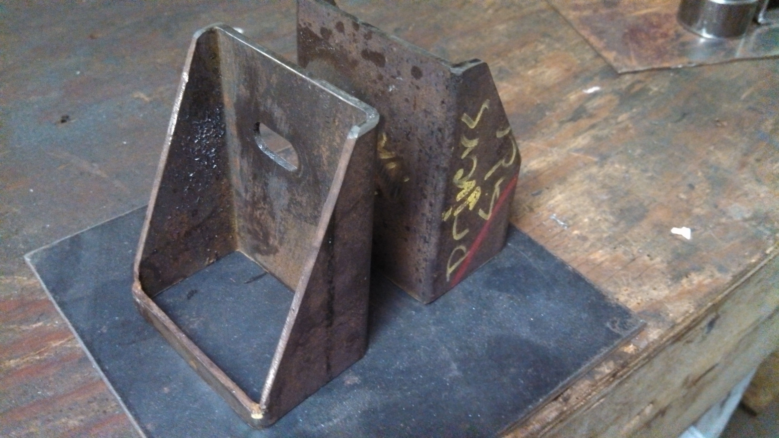

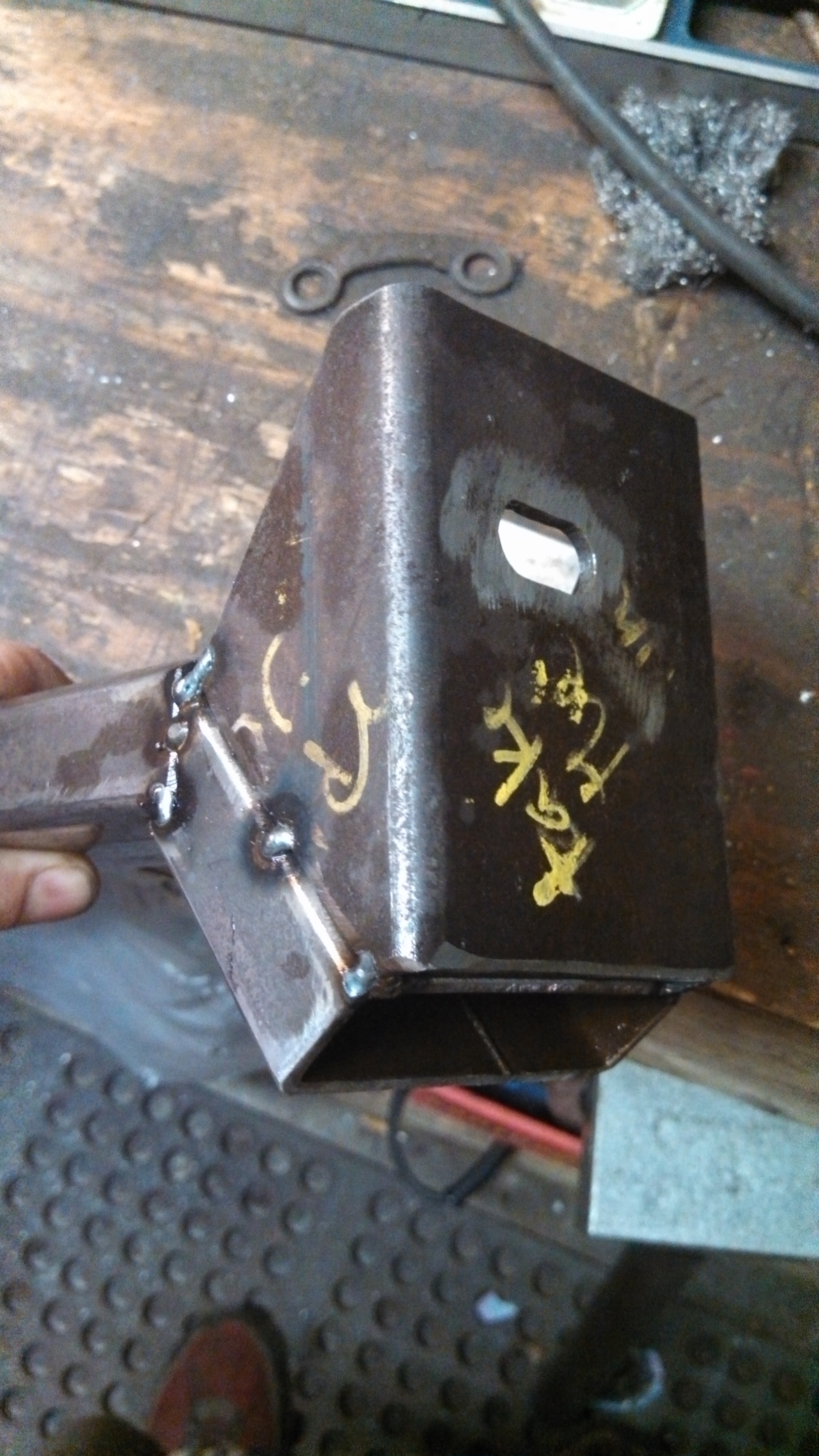

I cut the square tube down with a large cutting disc. They weren’t perfectly flat, so I had Ryan @ Higbee Fab. Flatten them on the Bridgeport. HTMS strut mount plates now sit flush on the square tube.
Lost the pics sorry

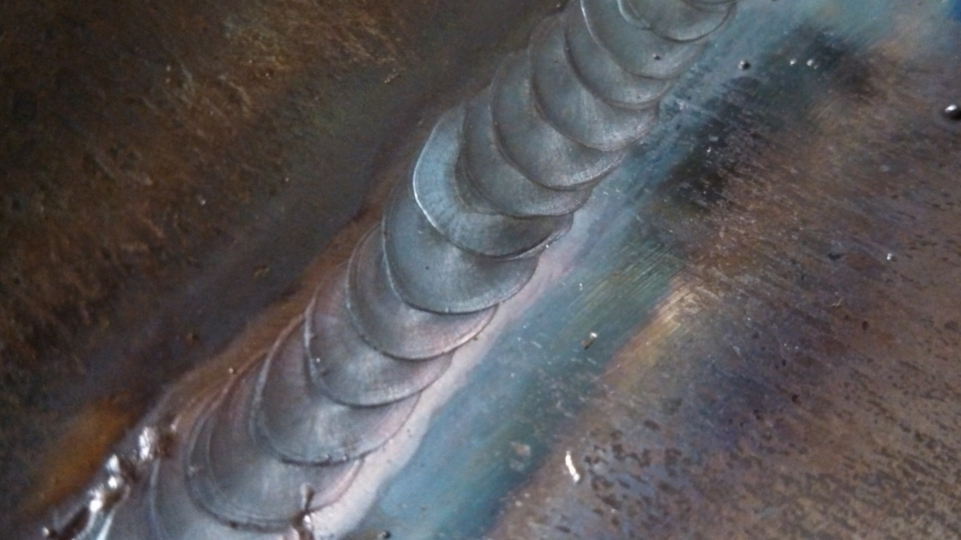

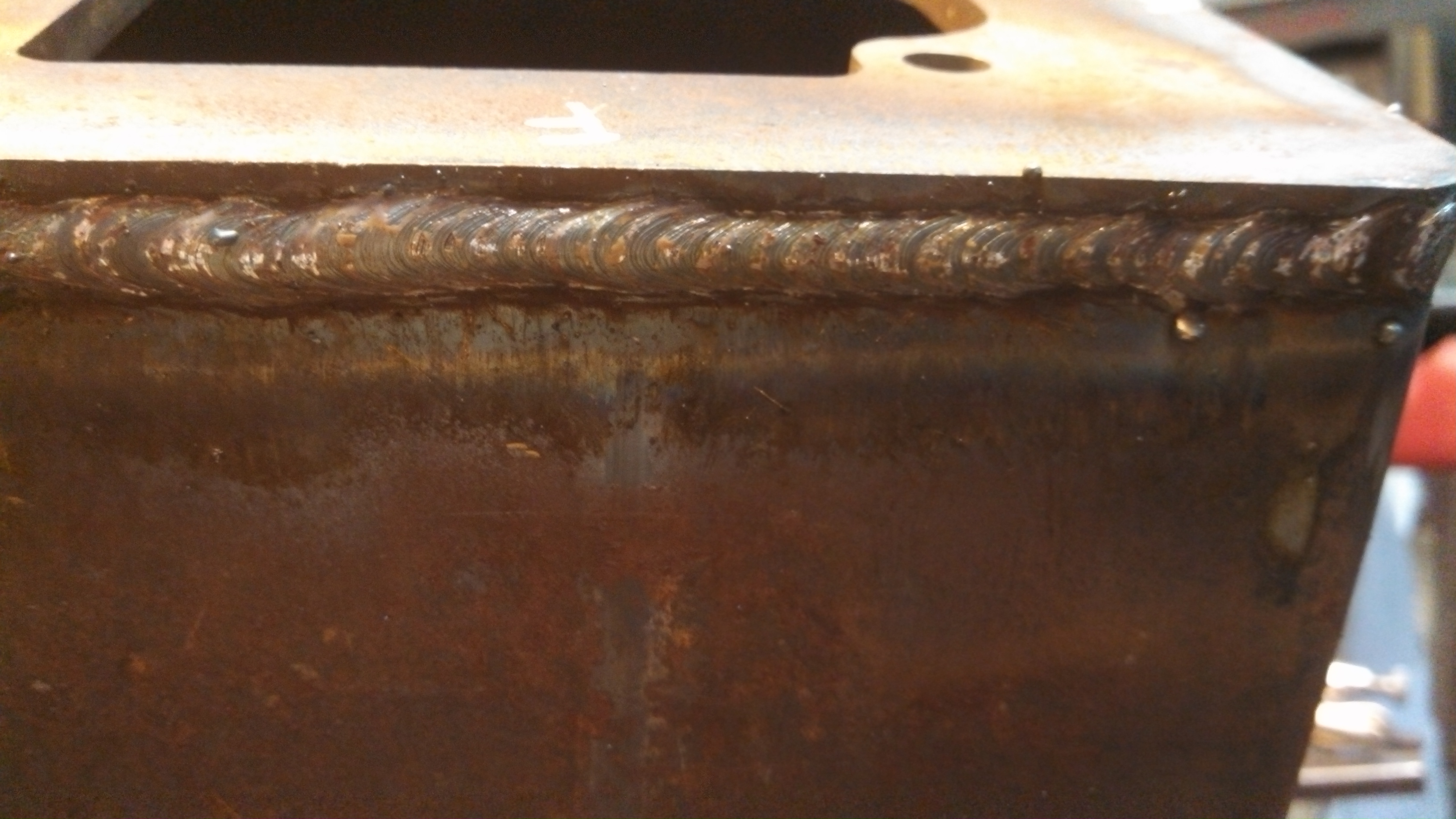

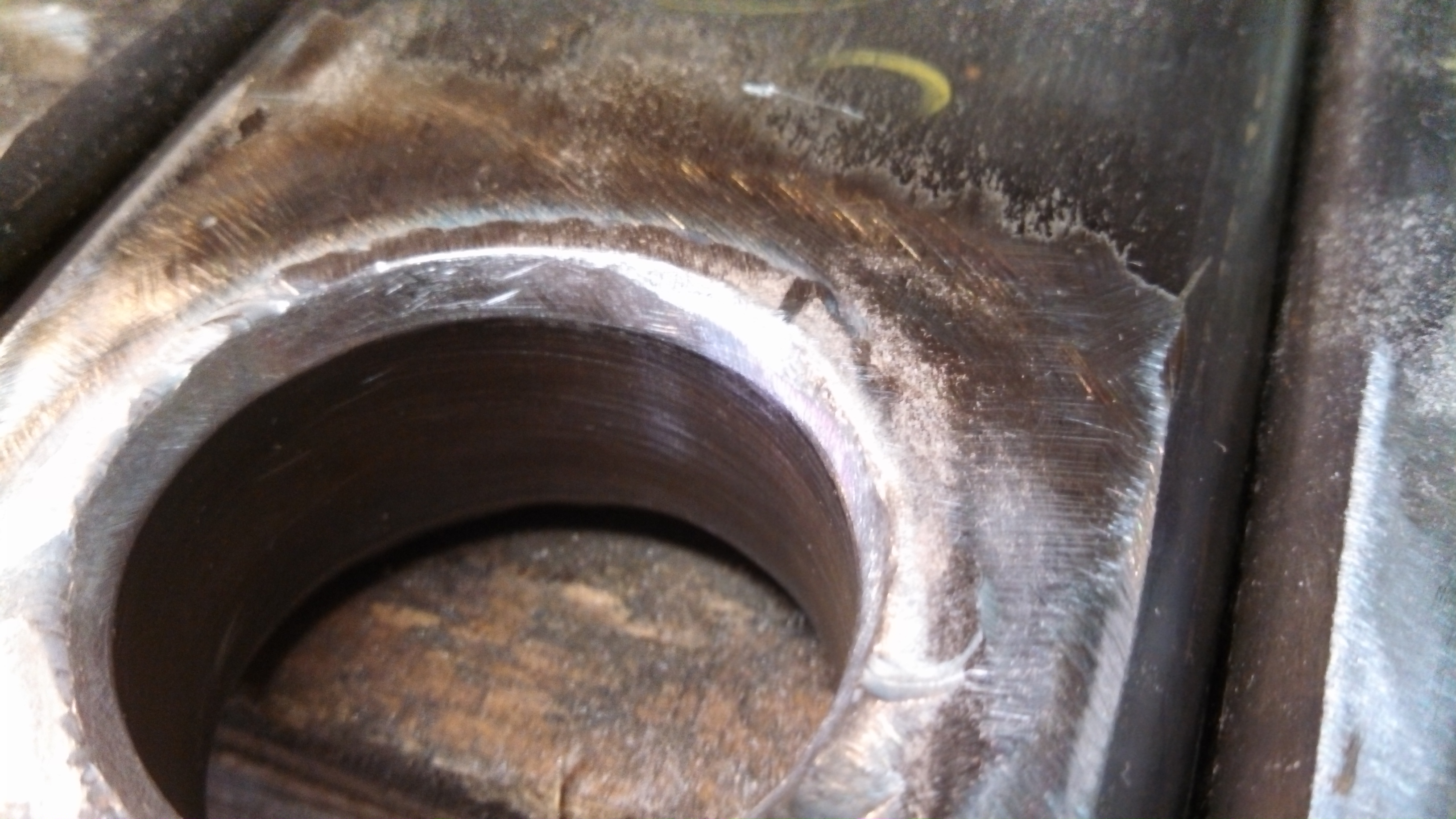

Jim welded the tops onto the tube sections once I got them all prepped and cleaned up with a weld bead recess. That way I can clean them up/flapper wheel them and there is still major penetration in the ¼” thick steel.
Jim welding strut top tubes.jpg (1.5 MiB) Viewed 38498 times
strut tube top weld bead.jpg (1.19 MiB) Viewed 38498 times

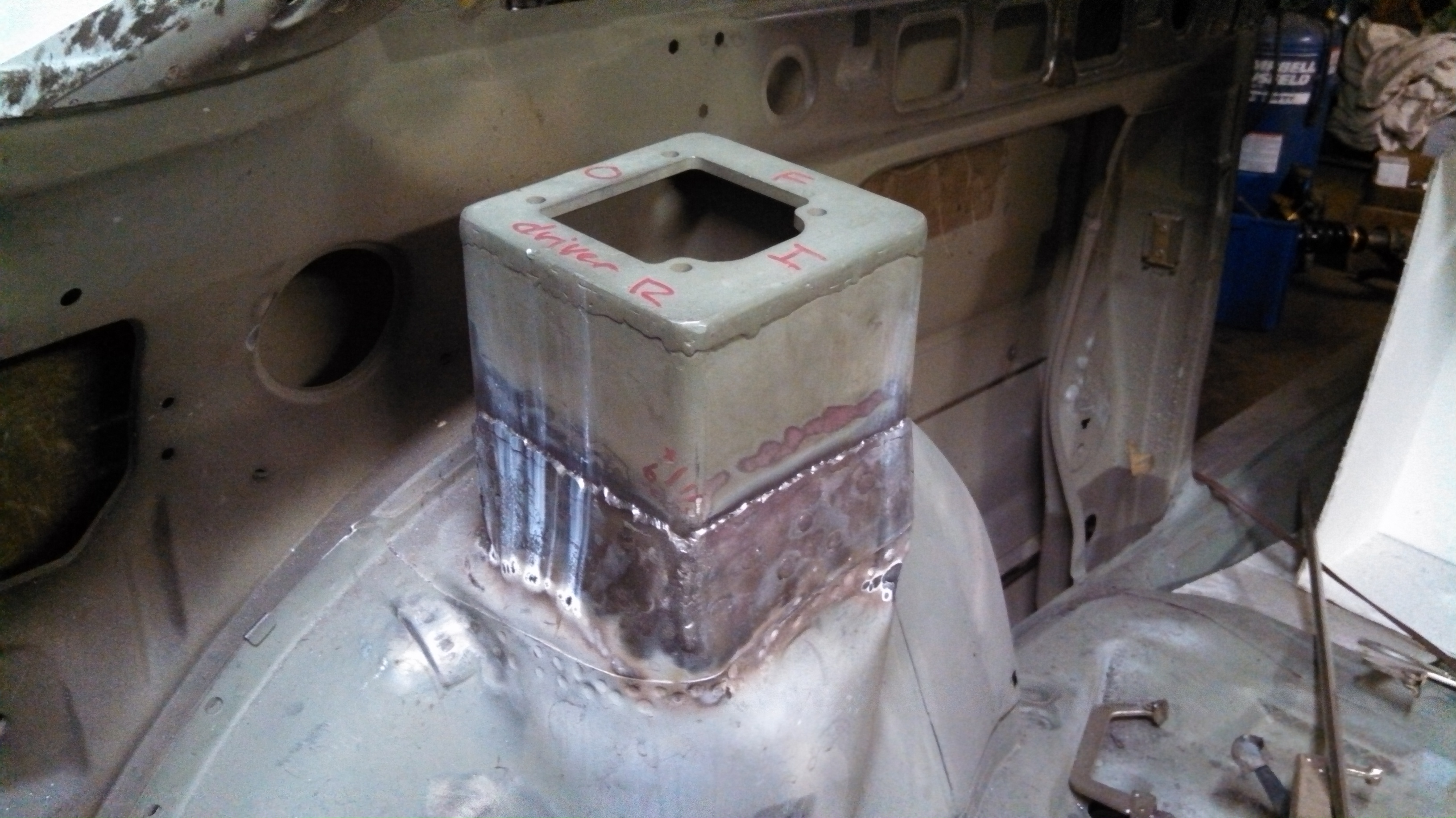

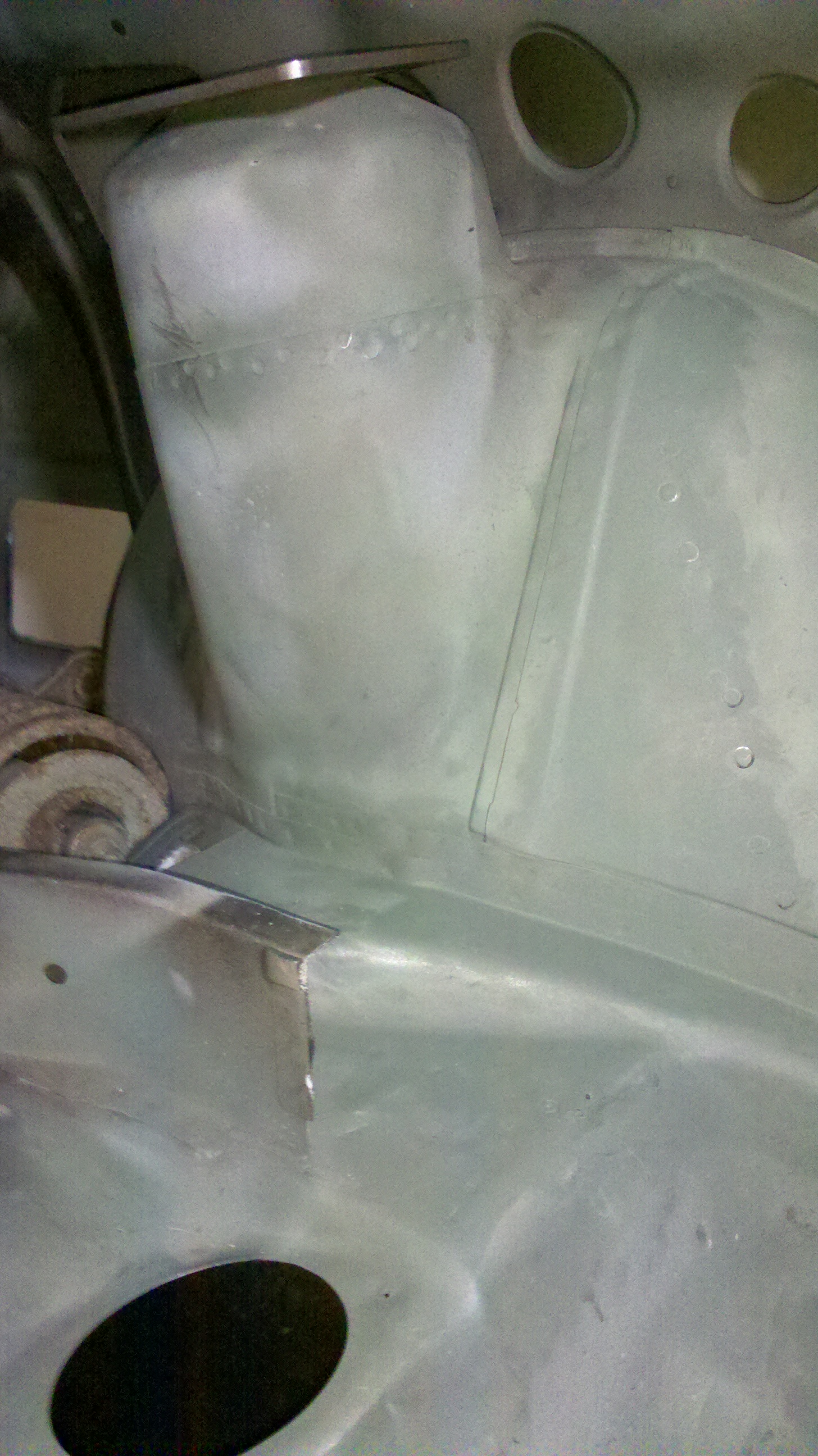

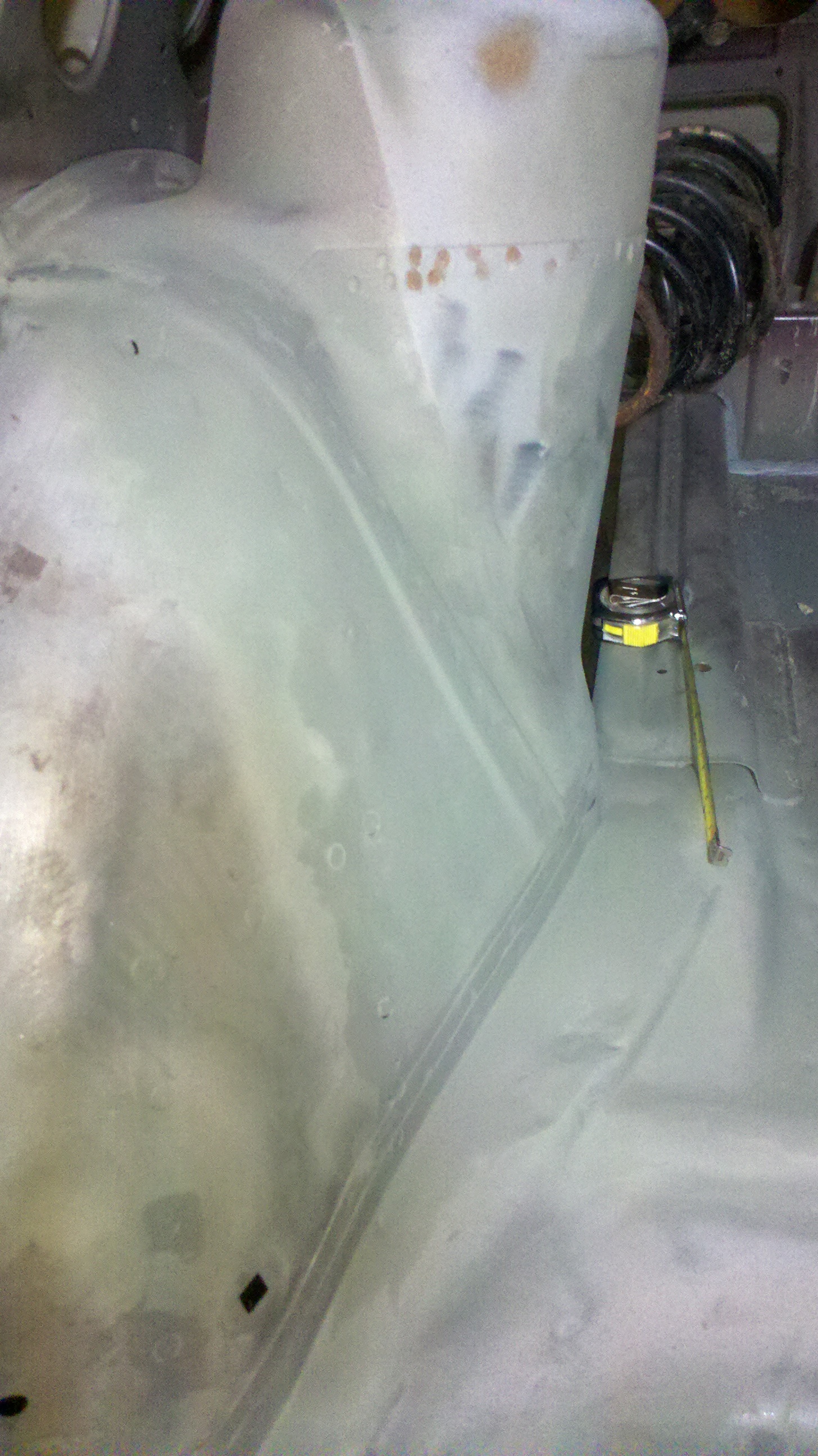

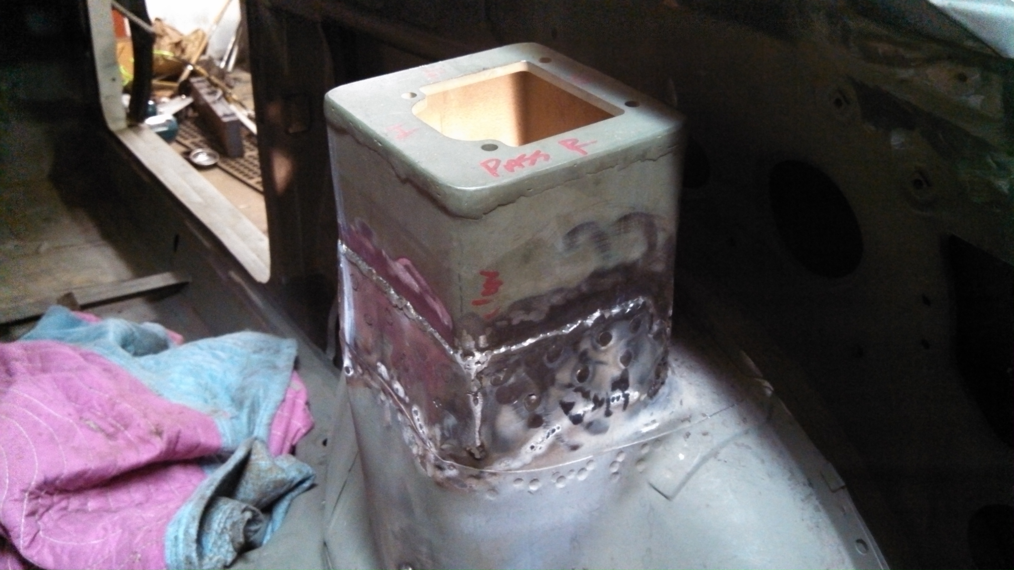

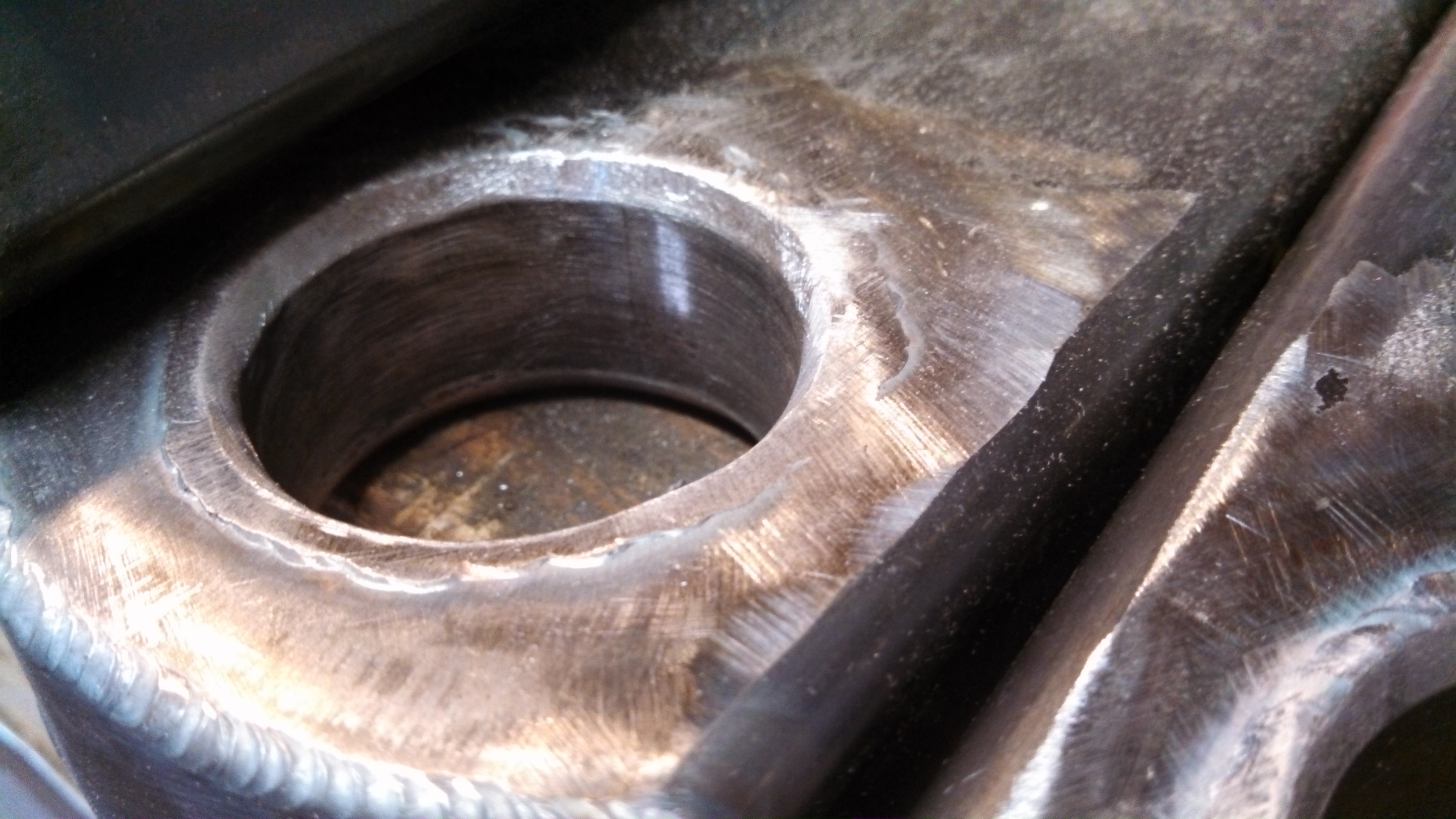

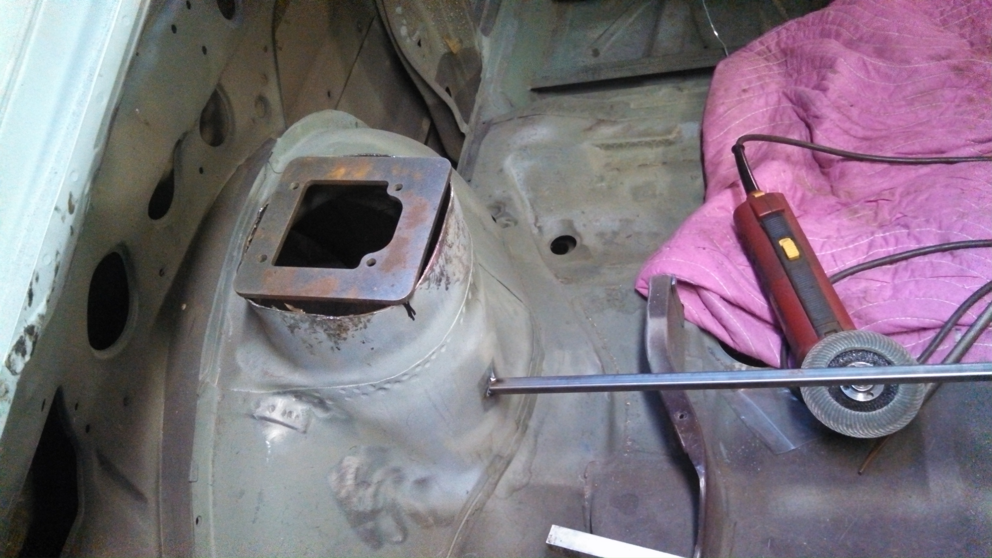

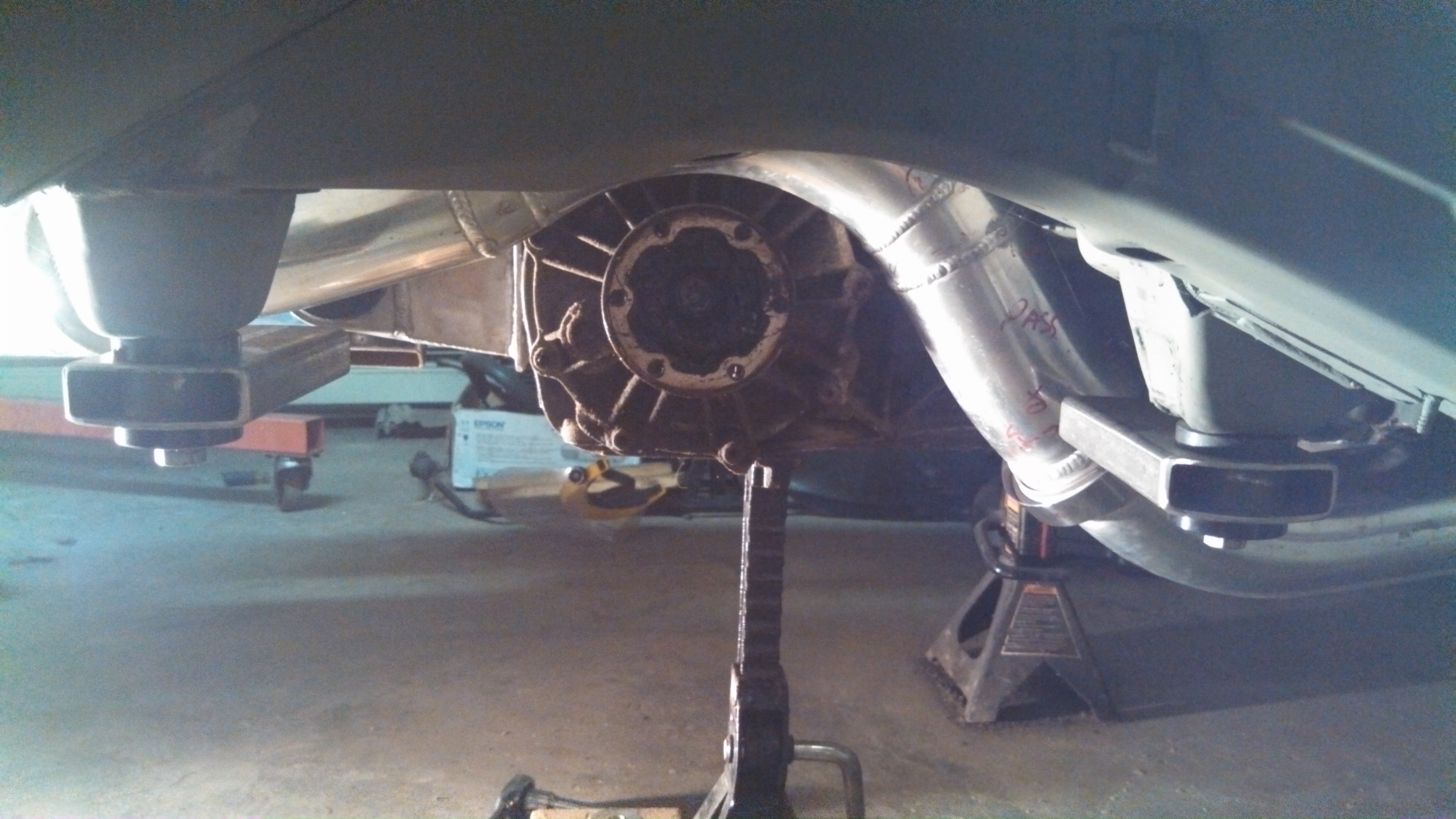

After a ton of hammering, bending and general metalworking, the oem tube shape of the chassis is becoming square. Hours more trimming and hammering, and I got the HTMS tops in place.
strut tube tops welded and ready to fitting.jpg (1.46 MiB) Viewed 38497 times

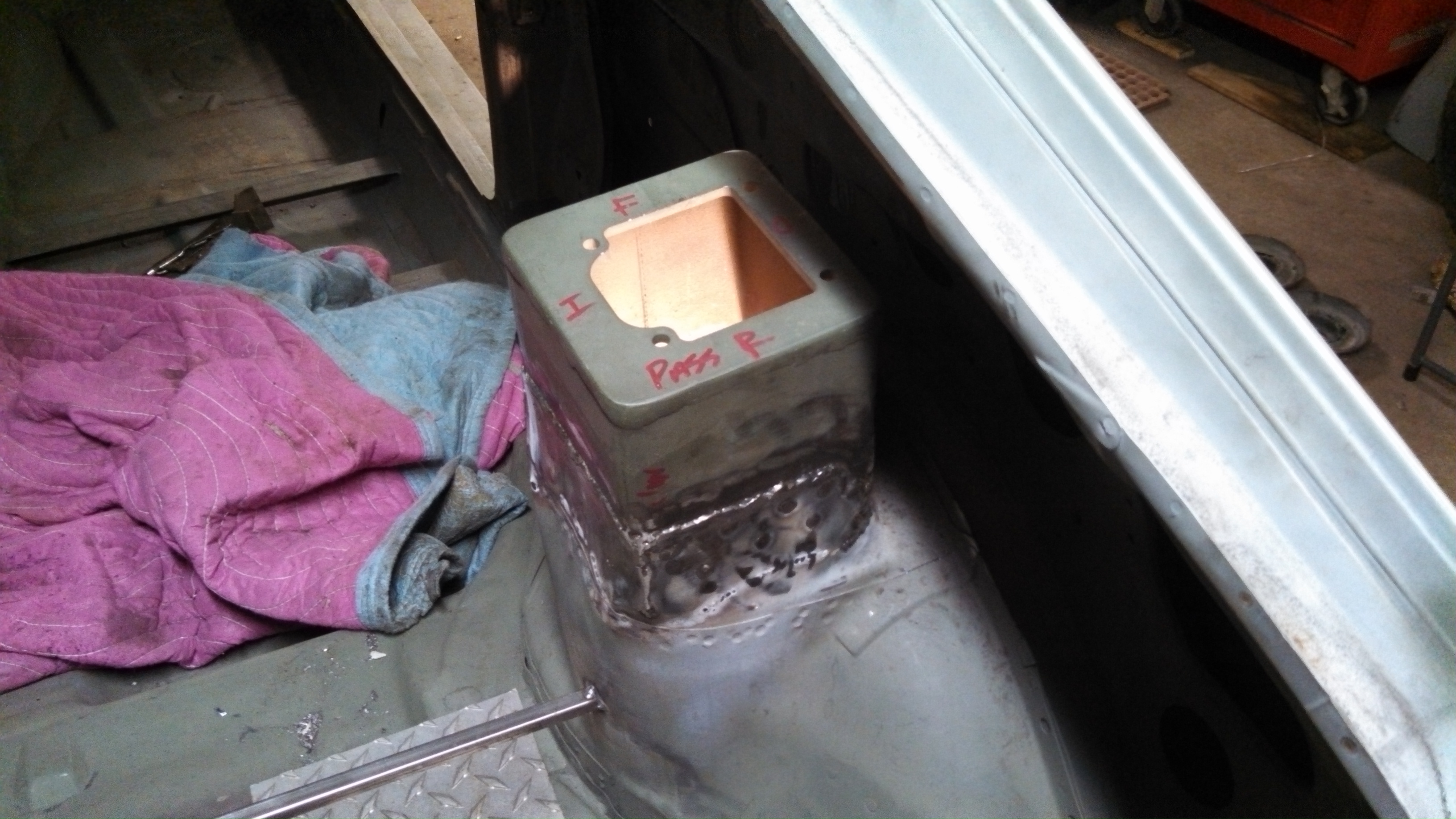

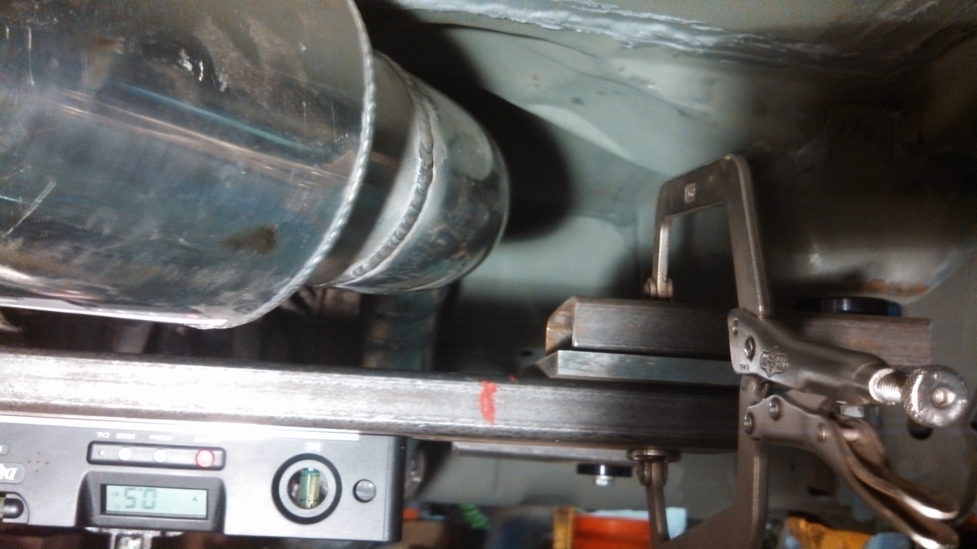

I got them tacked up and they are all within 0.2-0.3 degrees in/outward, and fore/aft. As the welding progressed they did move a little bit, but they are still all within 0.3-0.4 degrees.
Note: the tops have been raised ~2.5 inches so the car can be much lower but retain reasonable suspension travel.
Also note: the tops are oriented for more camber adjustment in the rear and more castor adjustment on the front.

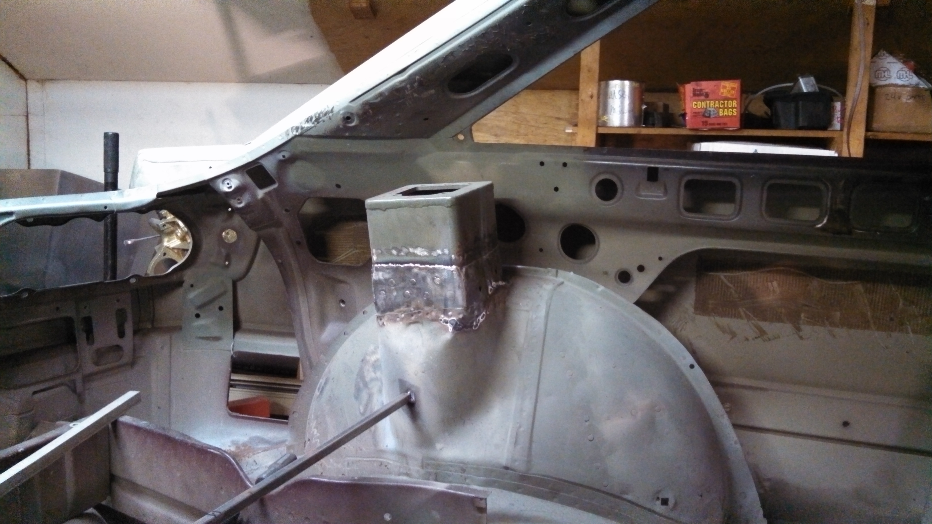

pass rear strut mount extended and welded2.jpg (1.26 MiB) Viewed 38497 times
pass rear strut mount extended and welded.jpg (1.4 MiB) Viewed 38497 times
driver rear strut mount extended and welded2.jpg (1.48 MiB) Viewed 38497 times
driver rear strut mount extended and welded.jpg (1.39 MiB) Viewed 38497 times

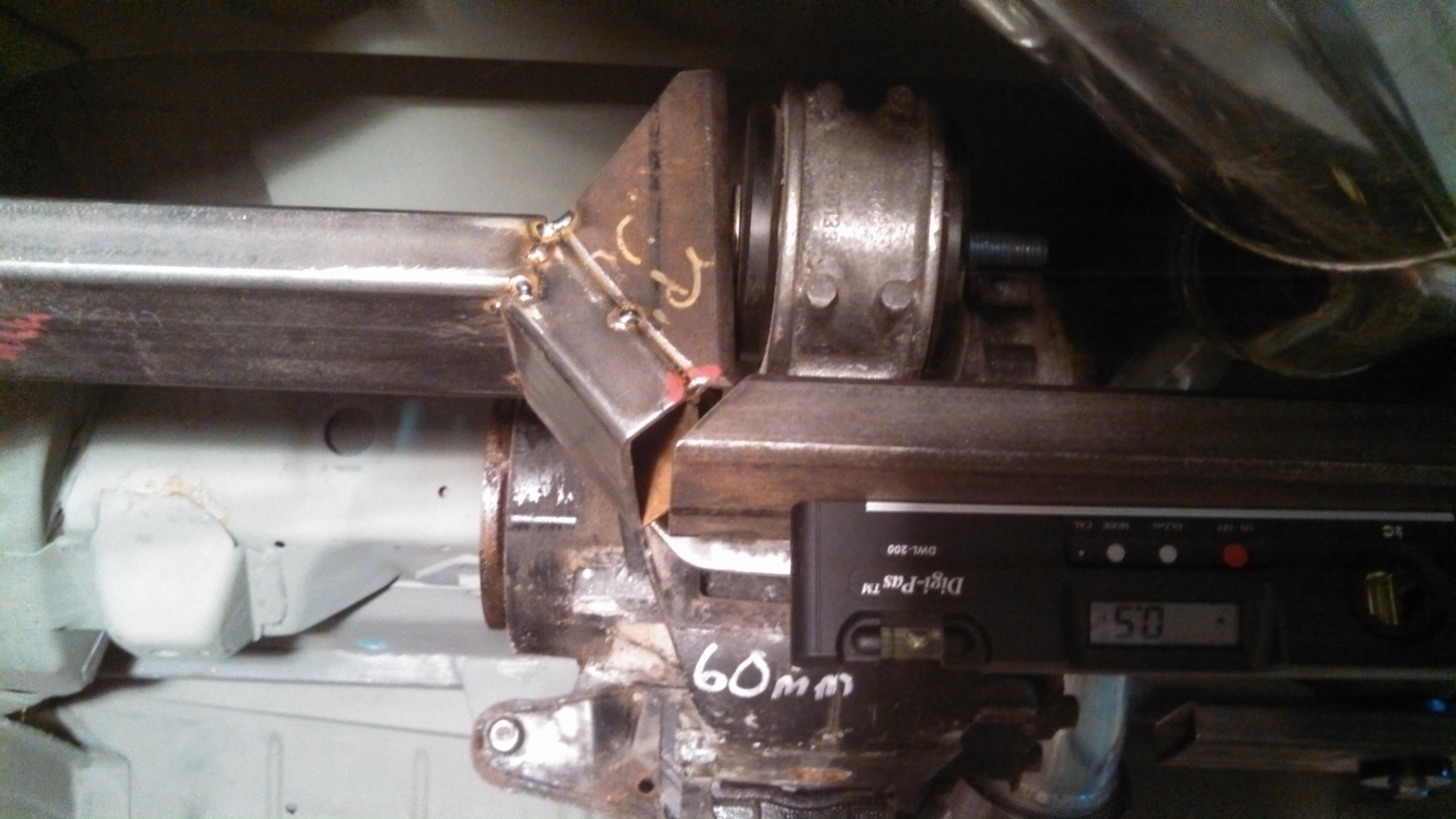

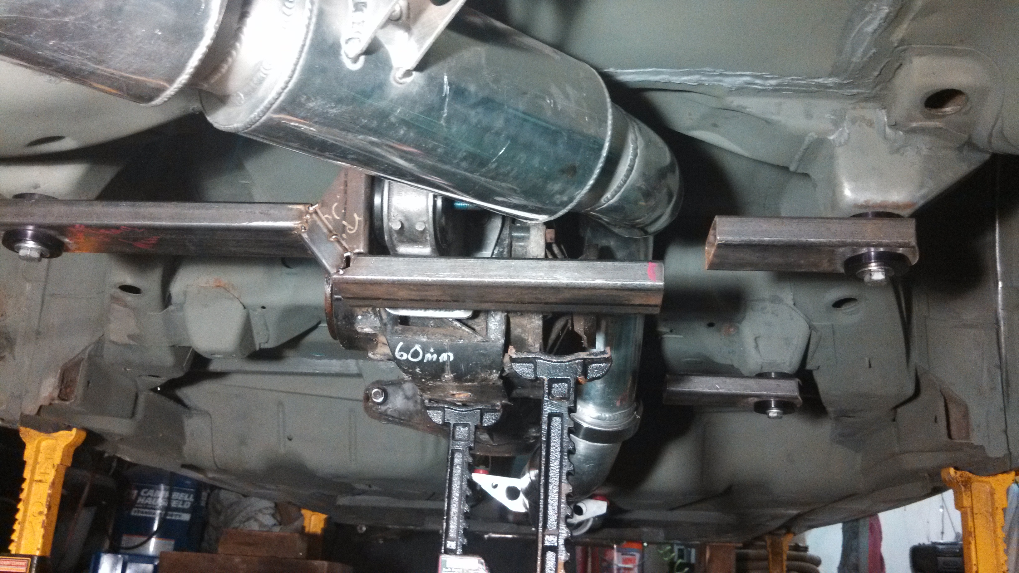

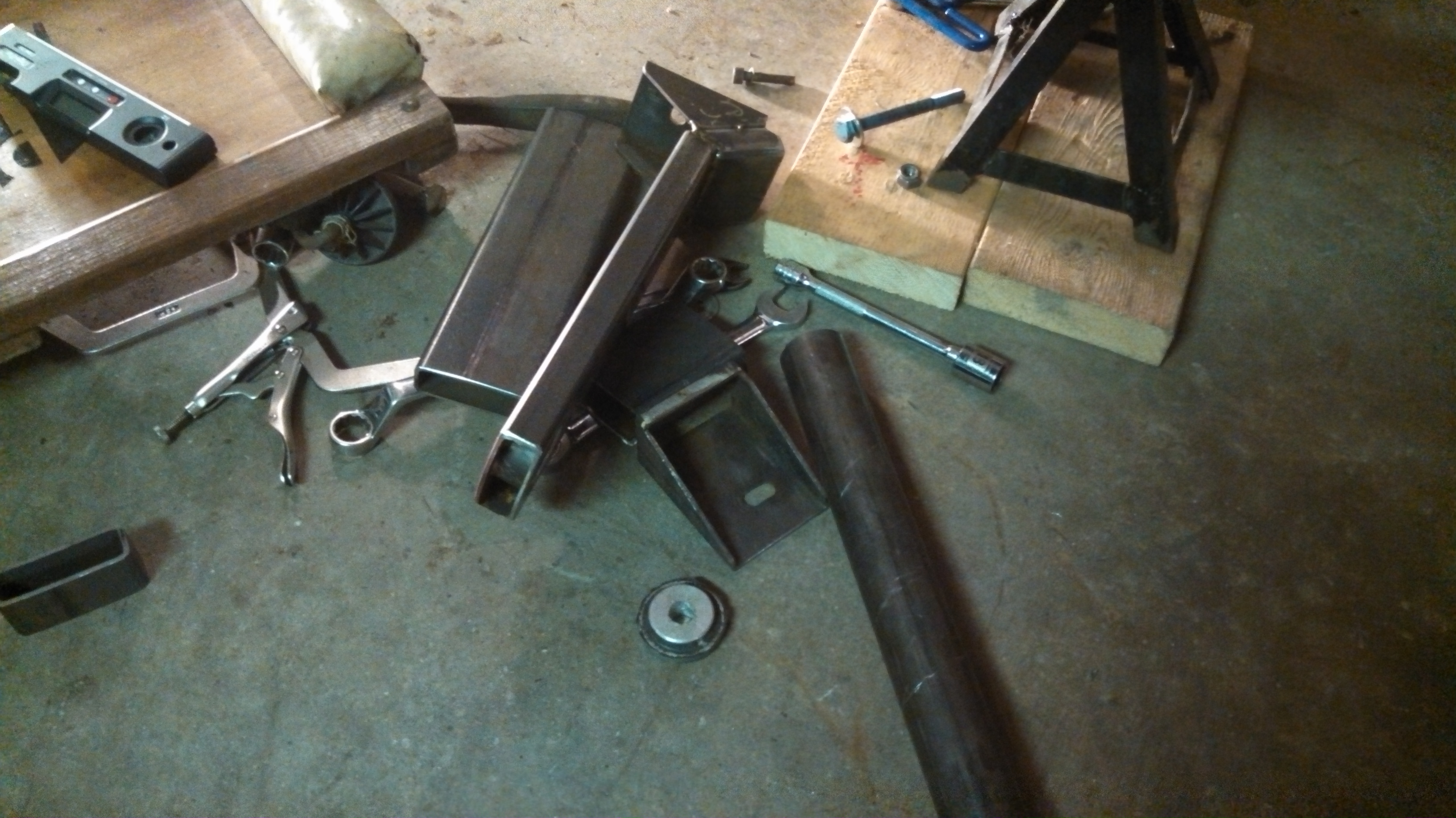

Ok, really starting to dive into it now. I had done about 16-18 hours of subframe modification and still, was not very happy with them… so , one step back and a few leaps forward.
So I deleted the 100 pics of SF mods that I was about to post.

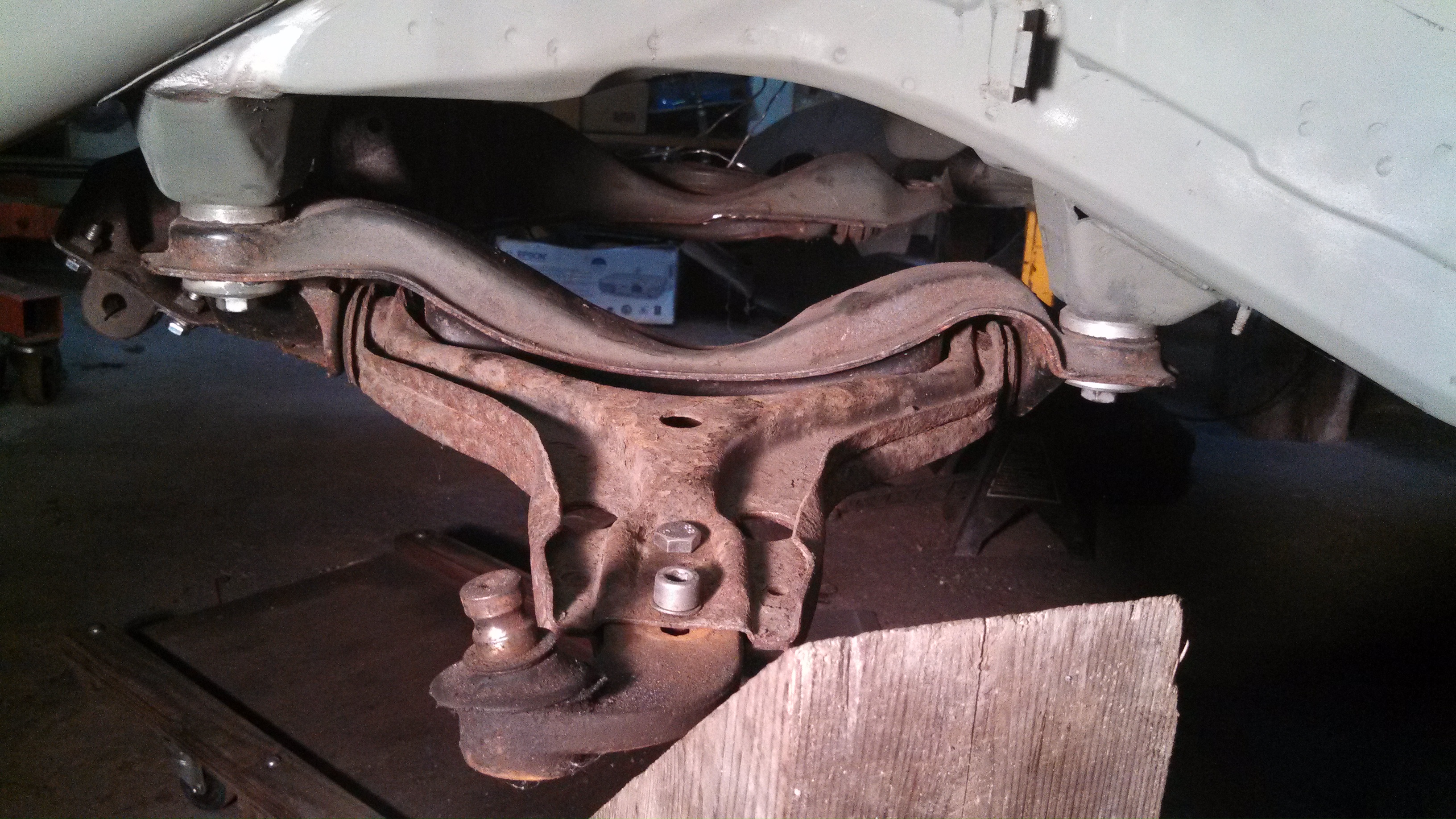

here is the stock setup, and it wont be in place for long
oem sf and c-arm.jpg (2.1 MiB) Viewed 38505 times

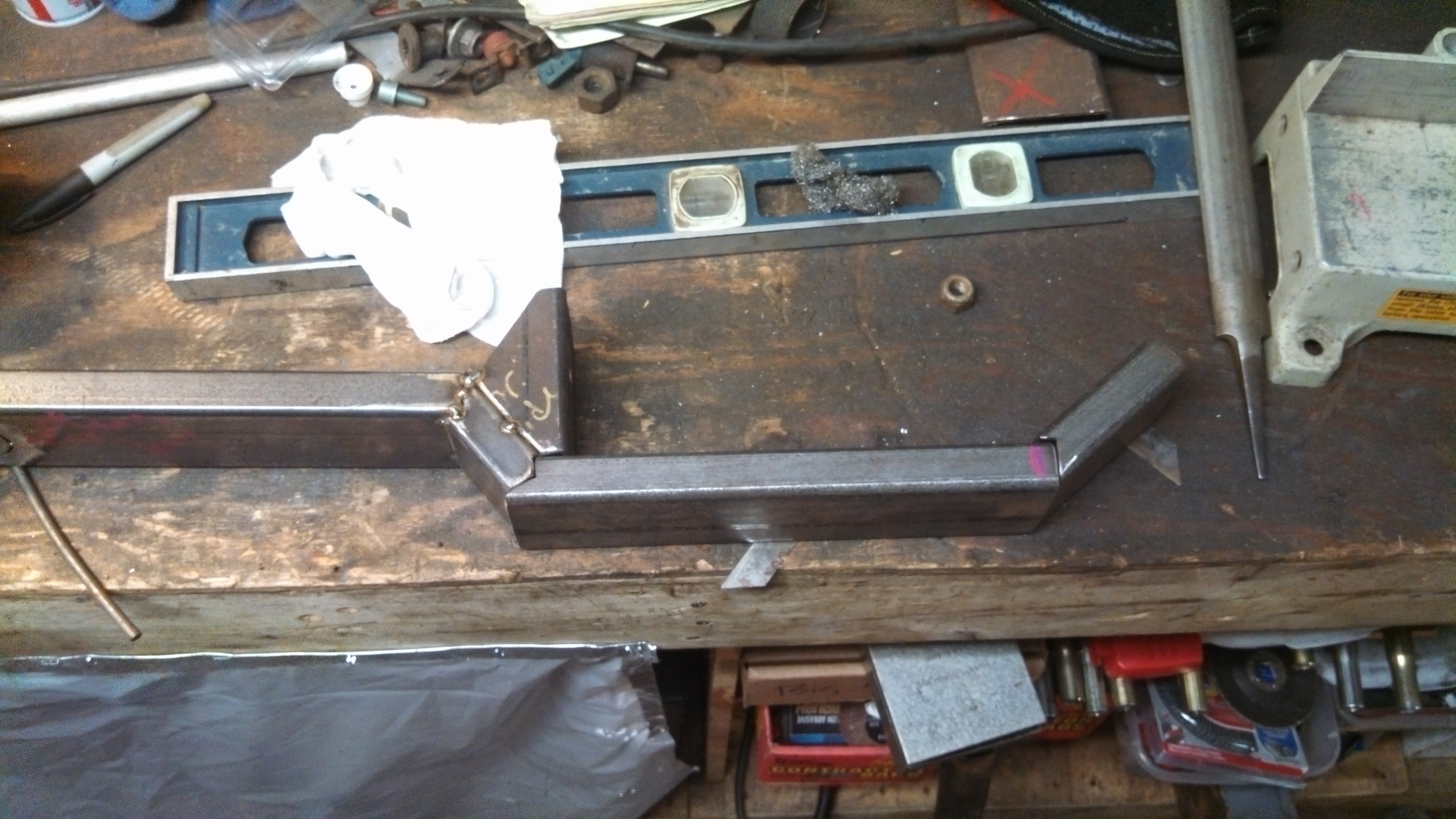

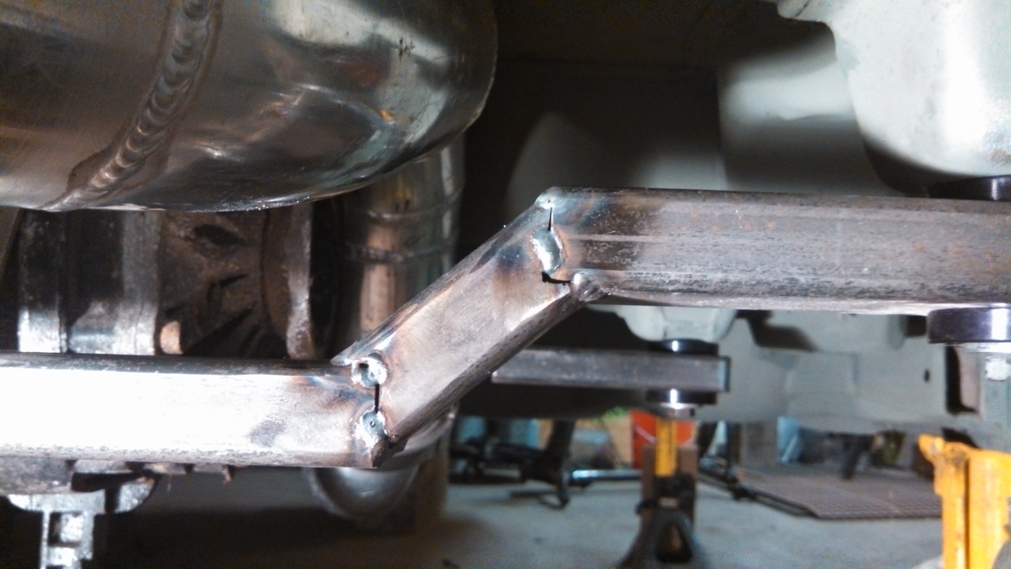

After many discussions with Haydn we settled on a plan. There are pros and cons to deleting the subframe and mounting it all the chassis, as well as a long list of pros and cons for keeping a subframe. Deleting it is nice as it stiffens the car up considerably as well as making/relocating the subframe mounts and c-arm pickup points. But then again the subframe itself is a nice fuse to have in the event of an off track excursion, where it can shear off and not overly twist the chassis up.
We settled on the best of both worlds, lighter and stronger, custom subframes and tubular control arms. Custom subframes will have relocated c-arm pickup points, but I’ll get into that math in a bit. The rear tie rod pickups are also moving inboard and upward to match the new c-arm angle at ride height.
Making my own custom box/tube subframes and tubular control arms!!!

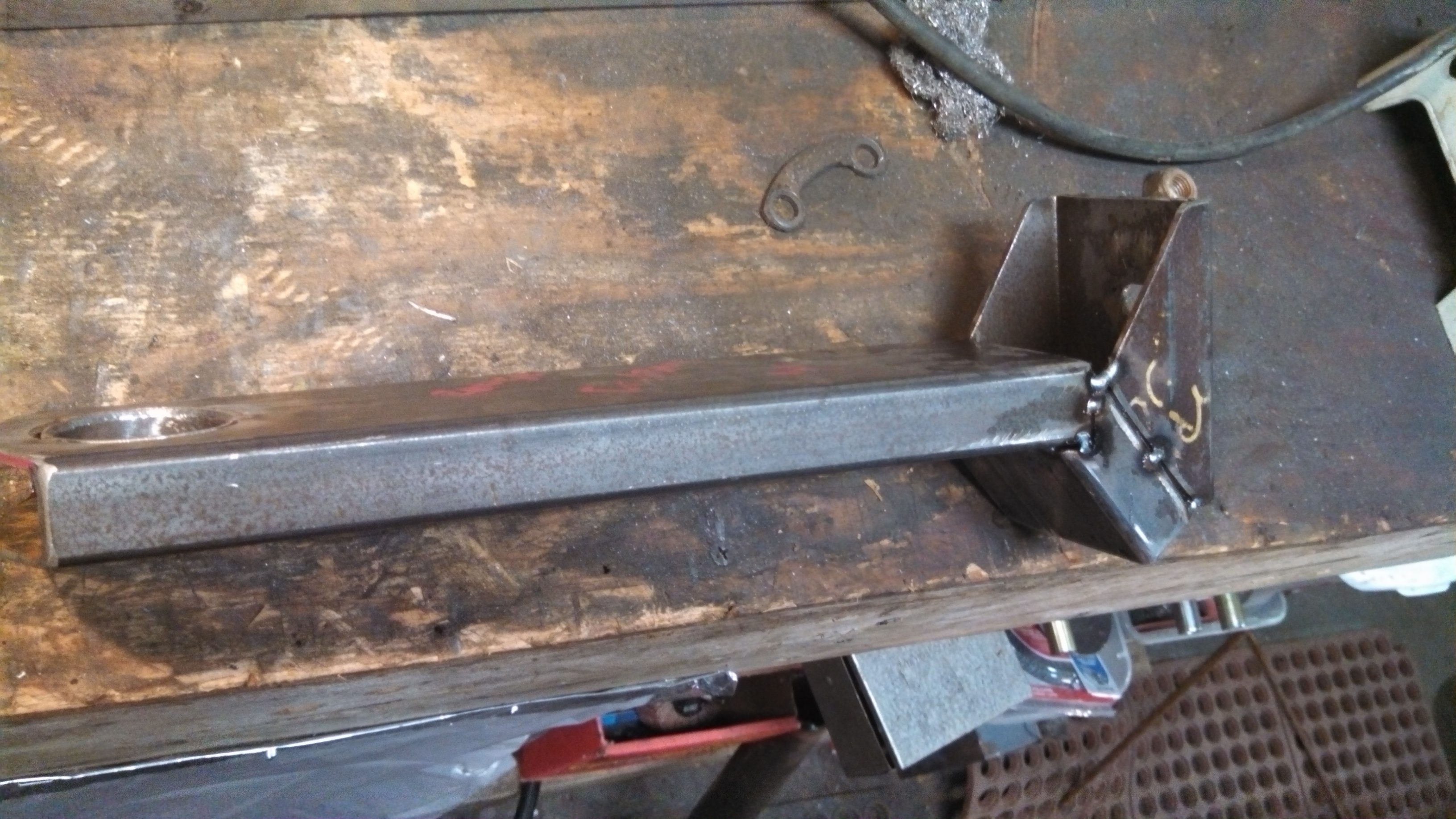

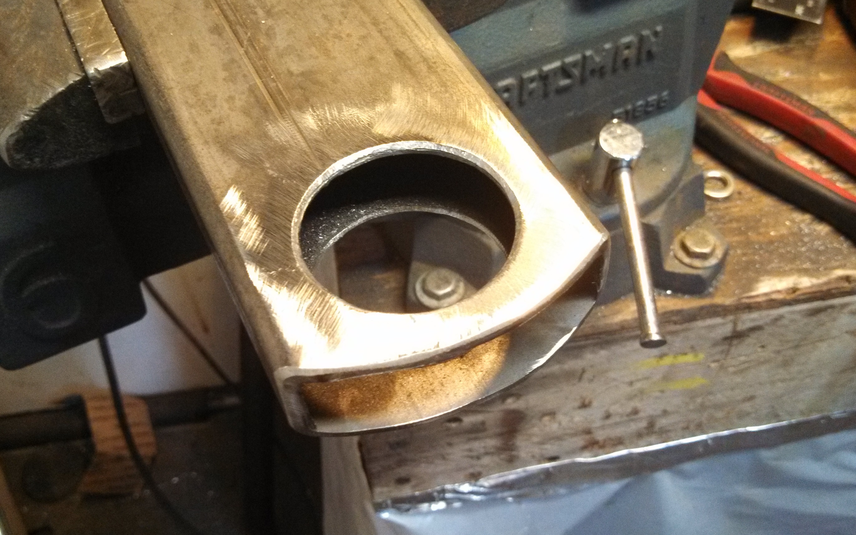

I got some 1x3” 0.120 wall to start making the subframe mounting points. I am using 1.75”, 0.095” wall DOM tubing for anti-crush sleeves in the rectangle stock. A small chassis aluminum subframe bushing fits well inside with just enough room to align/move around.
SF bushing reciever holes awaiting anticrush tube sleeves.jpg (1.46 MiB) Viewed 38505 times
alu SF mounts in 1.75 in. 0.095 wall tubing, like chamfering inside.jpg (1.41 MiB) Viewed 38505 times
and bolted some of it back on to continue making!!
pass rear of custom rear SF.jpg (1.16 MiB) Viewed 38505 times
pass side custom SF mockup.jpg (1.46 MiB) Viewed 38505 times

More subframe work. I got all the SF mount parts done with anti-crush sleeves and rounded ends with 16 ga. Caps on them.
parts back from highbee fab.jpg (1.58 MiB) Viewed 38505 times
Very nice welds Ryan!!
SF weld detail.jpg (1.61 MiB) Viewed 38505 times
SF weld detail2.jpg (1.35 MiB) Viewed 38505 times
Now to put them back on and get back to it!!
I smoothed all of the inner weld out in the bushing sleeve, so the SF bushing fits perfect!
SF bushing chamfer detail.jpg (1.32 MiB) Viewed 38505 times
SF bushing chamfer detail2.jpg (1.41 MiB) Viewed 38505 times
UPDATE!!
Still working on the subframes, I got the rear diff. mount started and its coming right along. The rear transverse member of the rear subframe is all 1”x3”, 0.095” wall, and diff. mount is cut from 2”x 3”, 0.120” wall.
Note: the offset angle on the rear diff mount to provide extra exhaust clearance.
rear diff mount for custom subframe.jpg (1.67 MiB) Viewed 38482 times
rear dif mount in progress.jpg (1.57 MiB) Viewed 38482 times
rear sf progress.jpg (1.67 MiB) Viewed 38482 times
custom rear SF mounting rear diff.jpg (1.38 MiB) Viewed 38482 times
custom rear SF mounting rear diff2.jpg (1.35 MiB) Viewed 38482 times
more
yes, this will be a subframe.jpg (1.43 MiB) Viewed 38480 times
rear sf dif mount coming together.jpg (1.24 MiB) Viewed 38480 times
more rear sf work.jpg (1.34 MiB) Viewed 38480 times
rear of rear sf inplace.jpg (2.05 MiB) Viewed 38480 times
ryan tigging it up.jpg (1.17 MiB) Viewed 38480 times

Update!

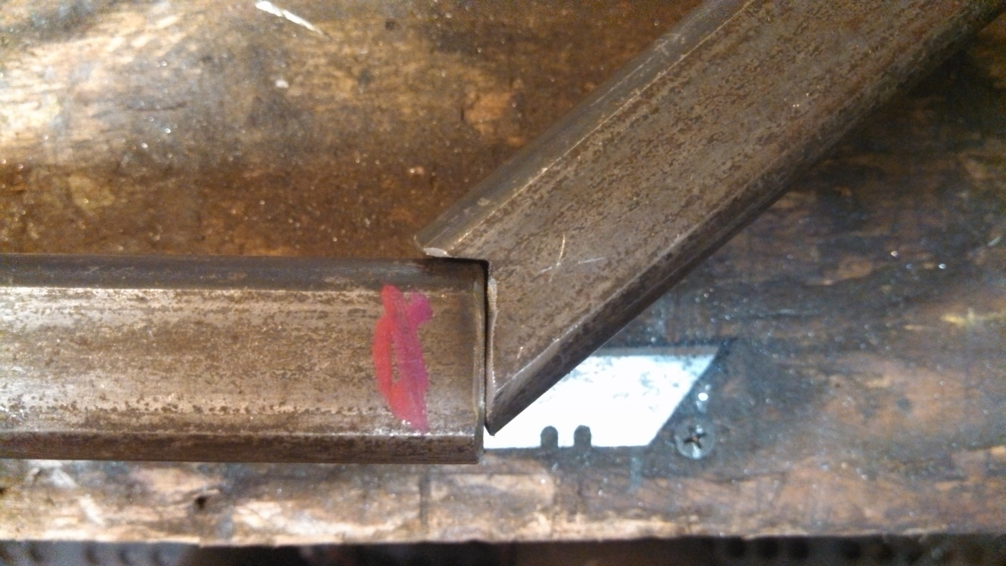

I got the rear beam/transverse portion of the rear subframe done. The rear diff. mount is also finished (tacked awaiting seam tig’ing).
Note: the jigsaw design at the rectangle stock junctions is much stronger than a standard miter joint
rear sf coming together.jpg (1.66 MiB) Viewed 38480 times
jigsaw detail.jpg (1.08 MiB) Viewed 38480 times
SF weld detail3.jpg (1.04 MiB) Viewed 38480 times
rear piece jigsaw, tacked together.jpg (1.28 MiB) Viewed 38480 times
rear diff mounting near finished.jpg (1.48 MiB) Viewed 38480 times
