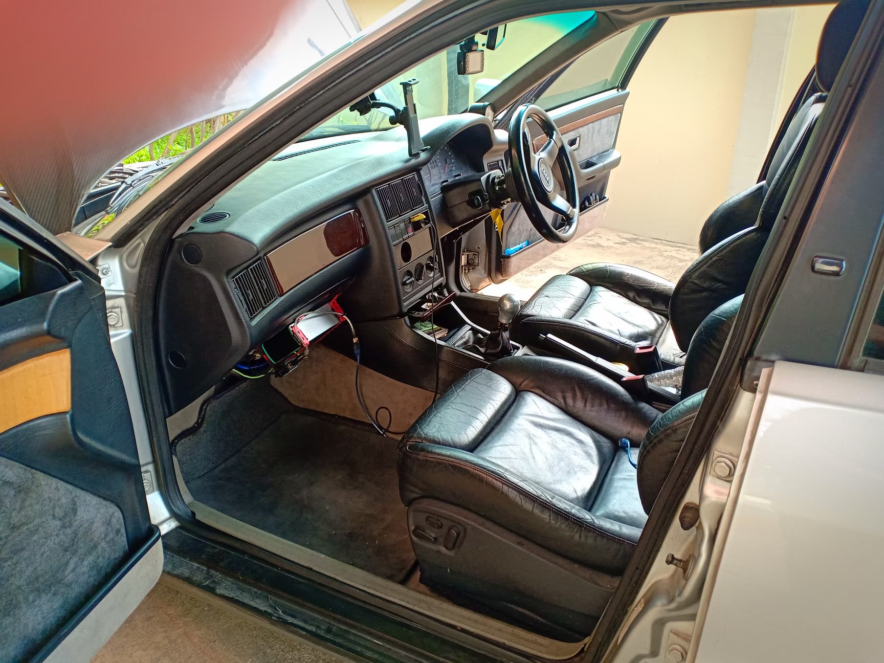

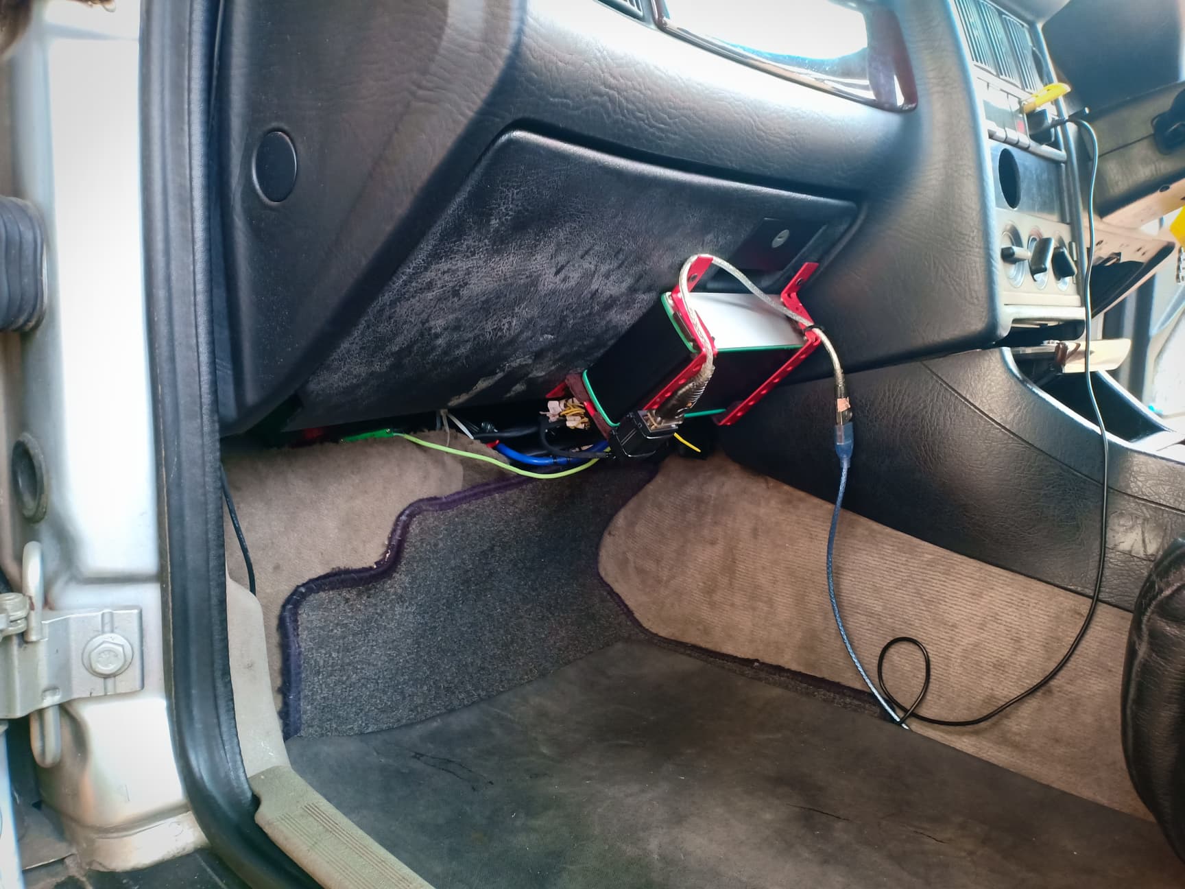

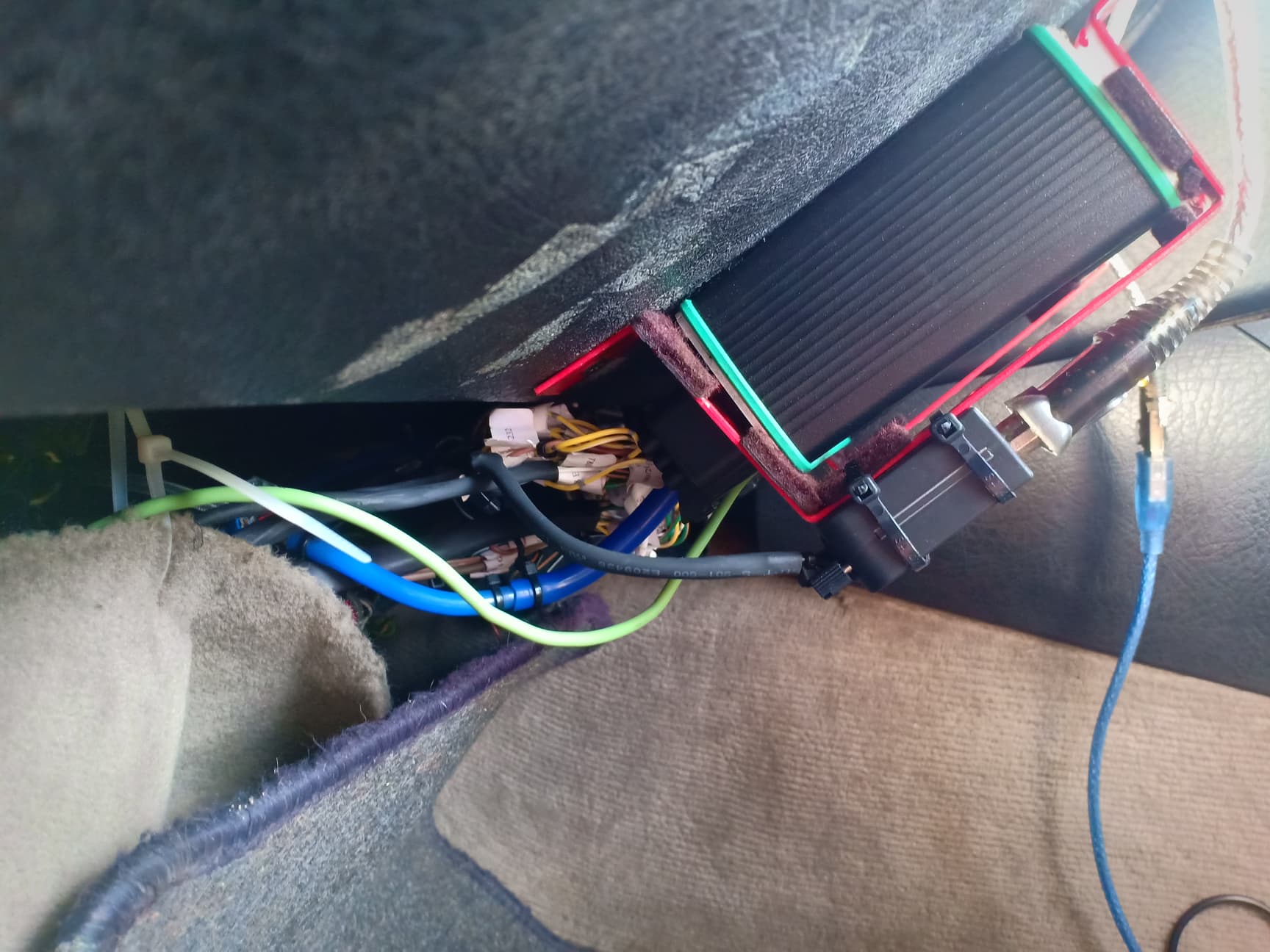

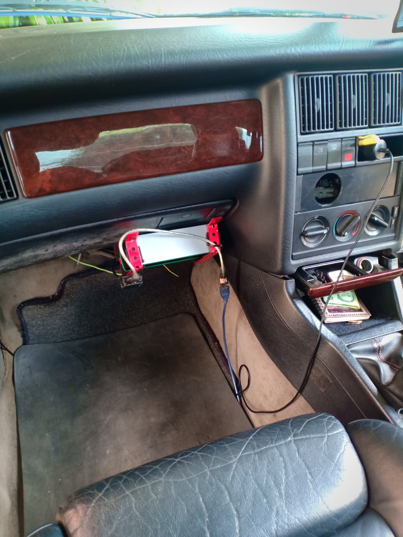

Regarding VEMS ECU placement, I made some crappy Alu brackets and bolted it to my glovebox lid. I'm RHD of course. The lock is strong enough to hold it and passengers are not hit in the knee.
I'll see if I can get a pic of it.

Re: Ben's 95 90 Quattro 20vT - now with corn power!
Of course I can...
Love those seats!
Thanks for the pics
Thanks for the pics
