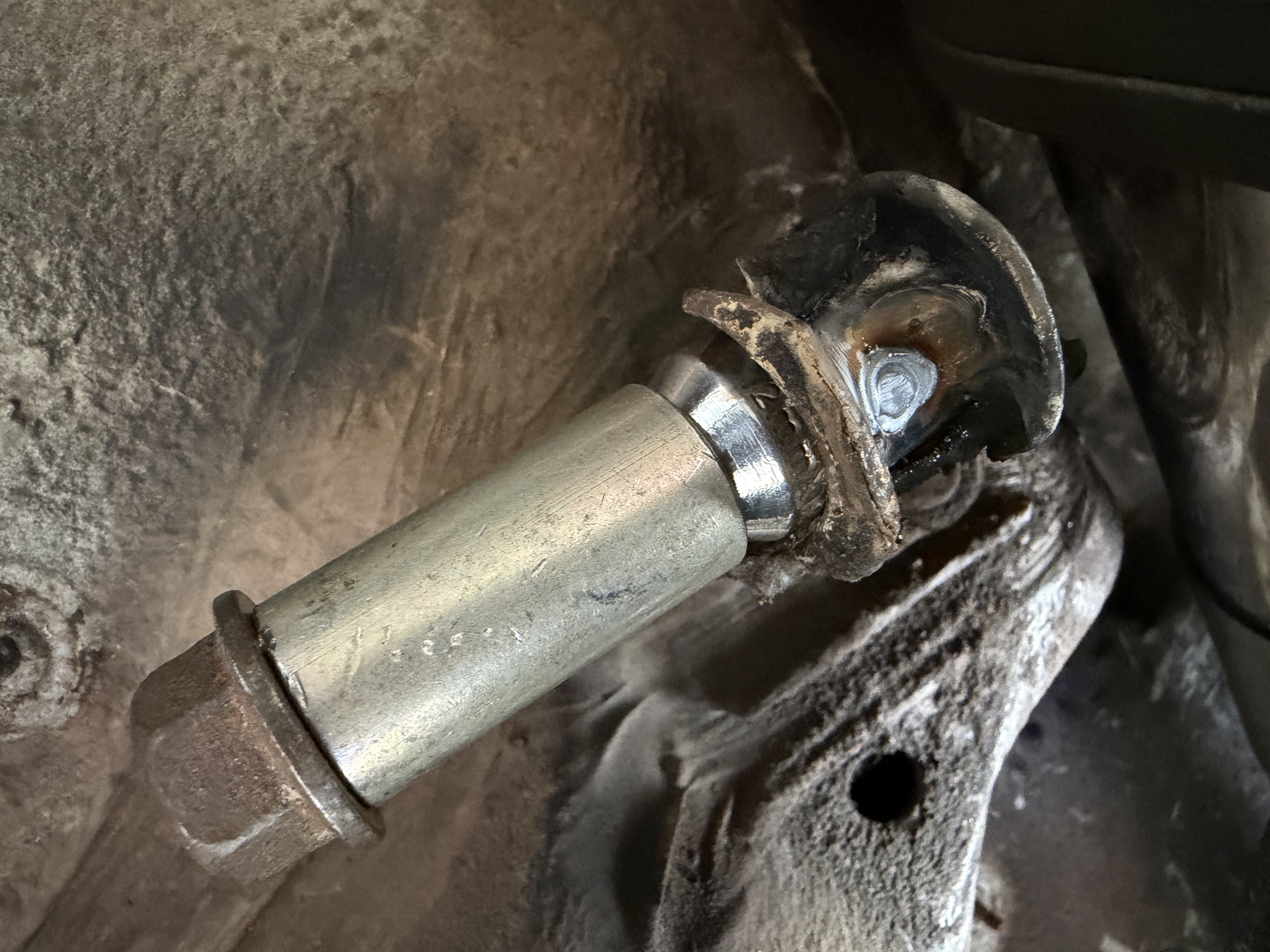

I welded lug nuts in the 3 exhaust hanger brackets
Re: Andy's 91' 80q
Posted: Tue Apr 28, 2026 9:23 am
by rennenmsports
I got some 1/2” stainless steel round stock to weld to the exhaust side. The other end is welded to SS pipe with high temperature silicone hose pressed into the inside of the pipe with a 1/2” inside diameter. Which is bolted to the lug nut. I’ll get pictures when I finish
