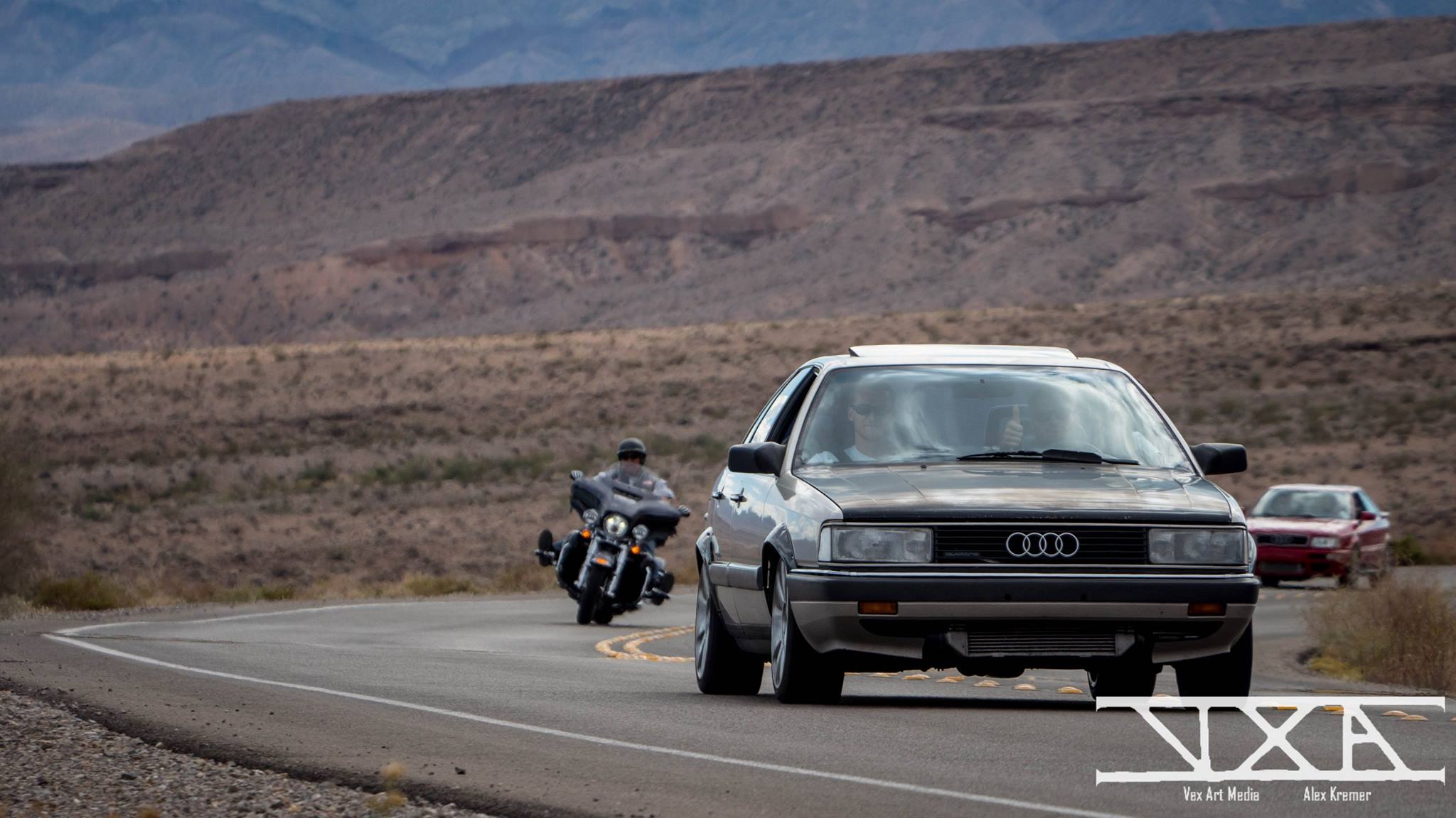

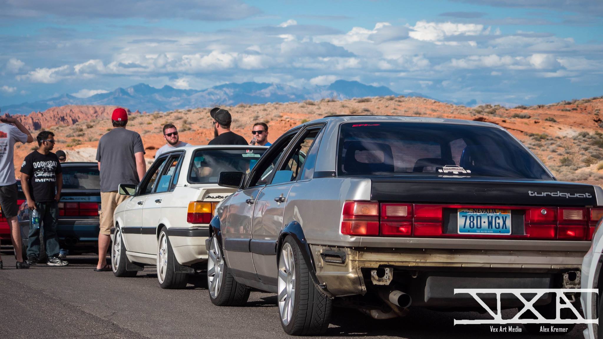

BBQ 2015 was pretty fun.
Alex takes good pictures.
TurdQuat needs bumpers.
First couple minutes into vegas on Friday and the driver side doors got backed into by a 2500 Duramax Chevy. Still waiting on a check from the lady...

Looks way better with those flares compared to how I saw it last.
Re: Phil's 20vt 5ktq, Donuts are delicious.
Thing is fixin to be real sexy with a rear bumper.
