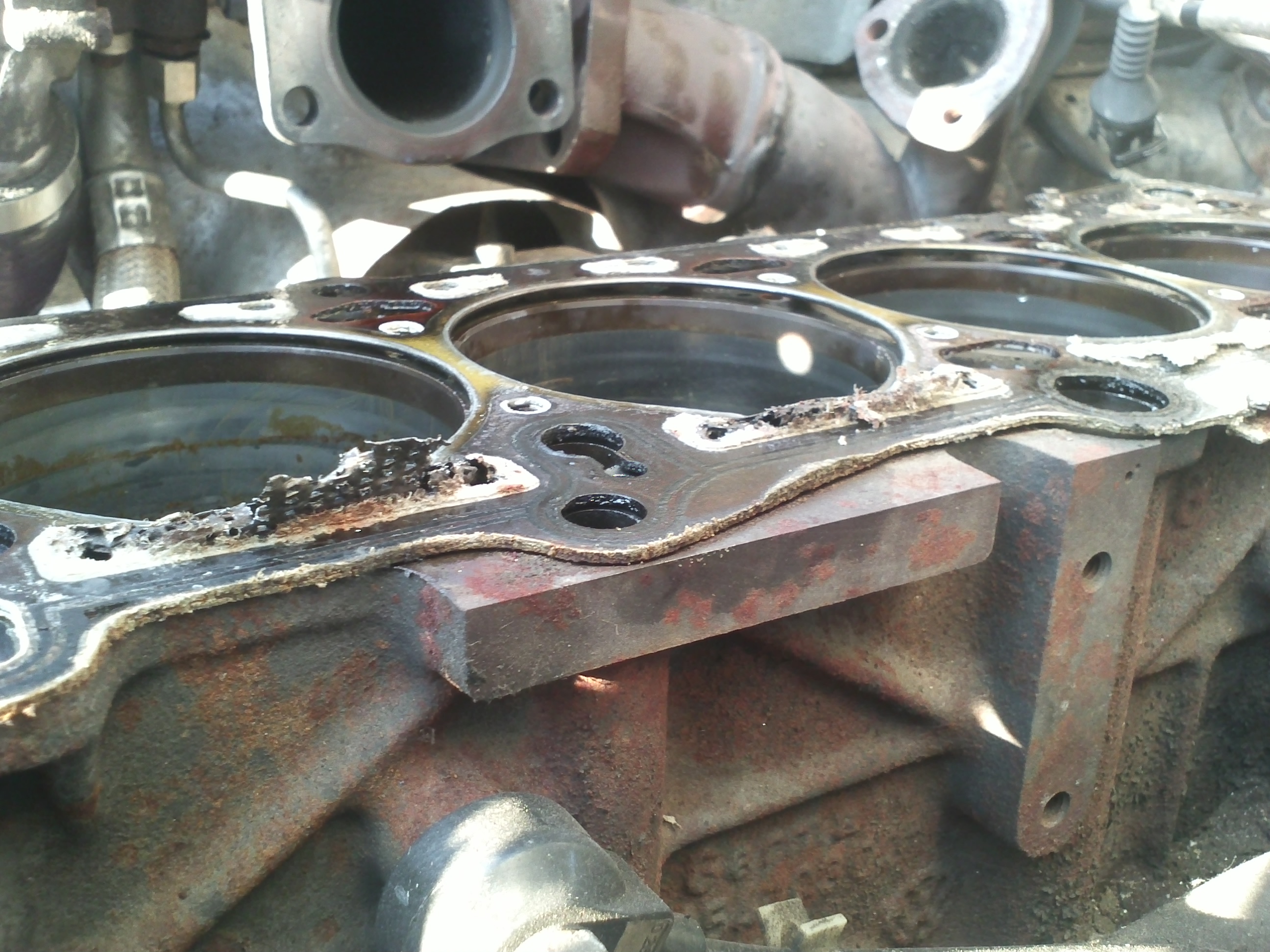

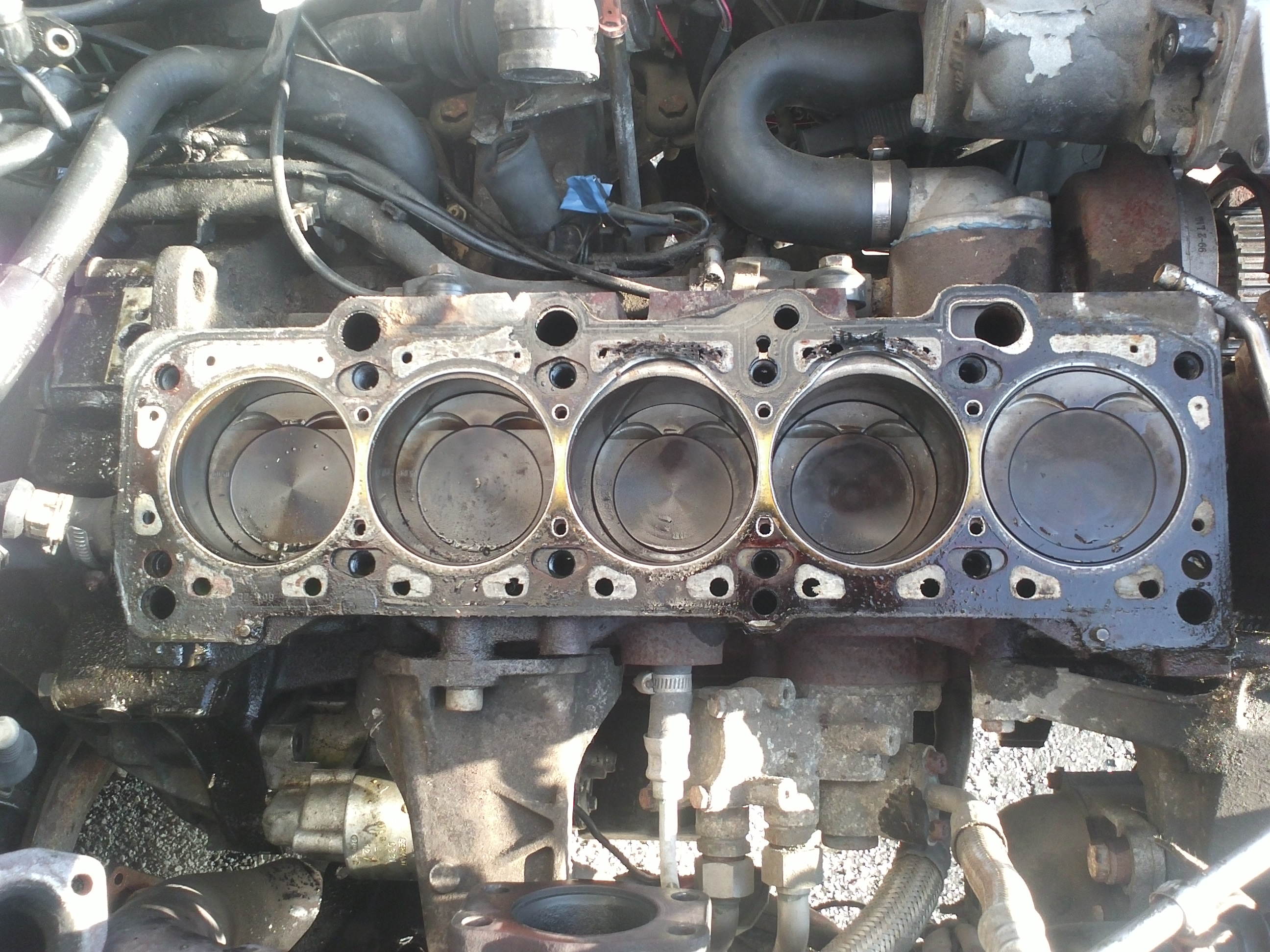

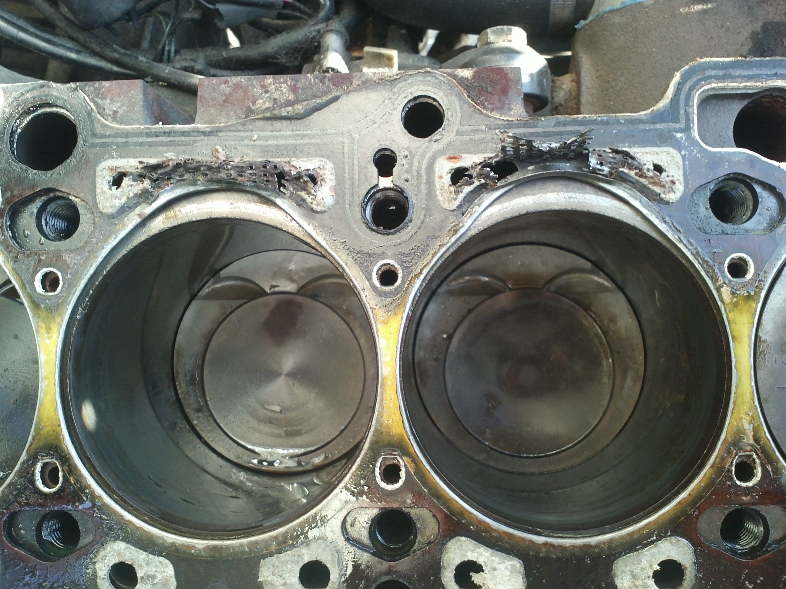

Damn Sven, that's one helluva deal! Check this out...
No detonation indicators anywhere :D :D :D
Im confident my ARP's will prevent this from ever happening again
That looks pretty clean. So you must have had some head lift. Could be a combo of the small turbo torque spike, plus some light det. Got any high res pics of the plugs? Look for very tiny black specs with a magnifying glass. I just don't understand why this would happen with this setup and not on my or Nick's completely stock engines, each with over 180k miles at 25+ psi with bigger turbos. I guess it could just be that k24 insta-torque, but I had no problems running my little k24 balls to the wall either.

I would imagine it's the tune honestly, but I also recall Nick having ARPs on even his stock motors so that could be it as well.
Either way, yeah that gasket is B L O W N

I'll check the plugs more closely tonight. so while looking over replacement gaskets, I don't see anything resembling a passage where this gasket blew out. I hope there was a revision or something. If it blew compression into the coolant system then there must be a passage I missed on the new gaskets. It looks like the gasket blew into the water manifold pipe and the rest is historic. As far as possibly being the tune, too much timing I guess right? When I get the car back u do you guys see any problem using the same tune while I tweak further? Thanks all.

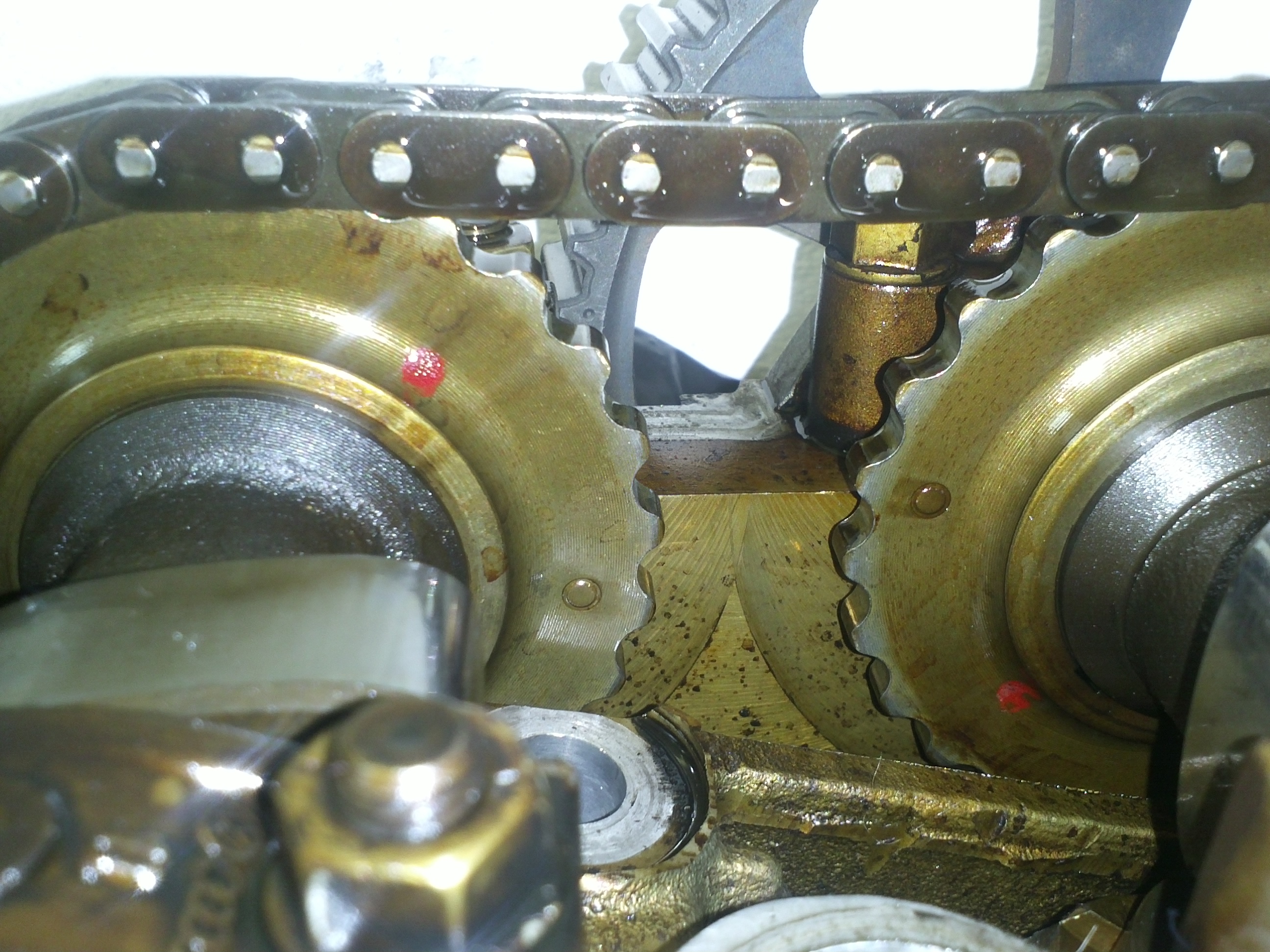

So it feels like its been freaking forever since I dropped the head off to the mechanic friend of mine. He told me last Monday it would be going to the machinist by lunch that day. I go and stop in everyday to offer a hand or look at the fitment of the new exhaust manifold etc. today I was removing the original exh. manifold seeing as he wasn't doing it haha but then this calamity caught my eye:
I almost flipped on the spot.. Do you guys see what I see? The cams haven't been touched by anyone since the headgasket failure so that means that I bought the car with the cams off by 2 teeth. 2 TEETH!! How the hell is this thing running Shit it looks like 2 teeth to me but I don't know. It doesn't even appear to be lined up properly even if the teeth were the only thing off. It looks disproportionately placed according to the teeth on the cams. Am I hallucinating? Anyway what sort of worries should I have now. Compression was stellar when I checked it when I first bought the car and that was on a cold engine with no oil added to the cylinders. Thanks for any advice in advance.

Maybe my knowledge is corrupted to doing 1.8ts, but arent the dots supposed to line up with dots on the chain? Not eachother?

I think this is the goal
Haha I was going to post that pic of mine, you beat me to it ;)
That's what you're looking for, dots level with the top of the head and seven chain links across the top of the cogs.

I just couldn't resist... very good illustration. Maybe that explains why the boost drops off so dramatically at redline? Apparently its not enough of a difference to facilitate valve interference...
Probably a good chance, though I can't say for sure myself. I'm sure someone who knows will chime in, and hopefully explain if that's advanced or retarded timing.

Doesn't look like the cam pulley is at TDC in your pic. So I would say the timing is probably fine. The dot on the back of the cam pulley level with the top edge of the head is TDC. That or plop the valve cover back on and line up the line in the front of the pulley to in the V on the VC. This might also be helpful http://forums.quattroworld.com/s4s6/threads/13406.phtml

wow nice thanks yoda. Those are cool. Ya I looked at it again tonight from a lower vantage point and they are off a tooth or two. The mechanic gave me a key to the garage so I cleaned the place earlier and went back 2 hours ago to start pulling the exhaust mani studs (got 10 out and 6 are stuck without heat) and to put the wastegate on the new manifold. It weighs a ton lol so I should probably figure out a method of bracing it. Austin you are right its not at TDC but its only a few degrees off since I set it TDC and rotated the cam sprocket just a little in one direction in order to stick a screwdriver through it and brace it while I removed the cam bolt. I will be sure to get the alignment spot on when it goes back together for sure!
Put both dots as close as possible to level with the head. From each dot count 7 links up. This means 7 peaks including the dot. Then from one side, count 10 across including the links you are at. That is proper cam timing. The picture above is perfect.
