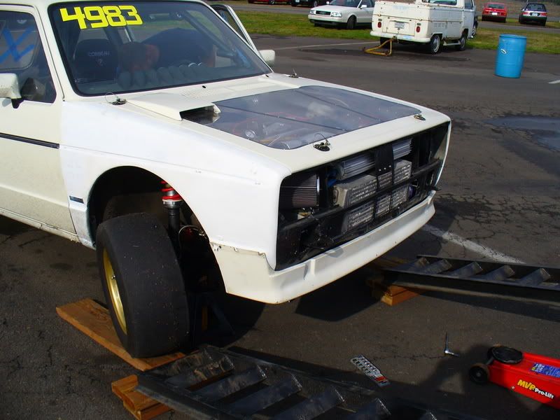

question, why are you placing the fuel cell under the hood?
speeding-g60
Posts: 2152
Post by speeding-g60 »
drag race only. small cell, less weight. fuel is ~6.5 lbs per gallon, and i can go with something 1gal if need be. the rabbit custom cell is 2.25 gallons, i get ~5 runs out of it? this one will be roughly the same size.
the reason is to have shorter runs of fuel lines.... its all compact right there. twin 044 pumps, cell, filter, all right in that front corner.
this cars' use is only ever drag race use. never on the street ever.
and the way i analyzed the front end was for support of the bumper for anything forward of the motor mounts. the lightness of the sheetmetal leads to not much cross support, and the frame horns are accordian style for impact. the peice that connected the frame horns to each other is way light, too light for structural support in my mind.
so, i can remake the front end in a different material, giving me the room i need at the same time. and mine will have a bit more structural support than factory. hell, the Euro Cab front bumper is not US spec for crash ratings, so then my thinking is that the mounts for it do not need to be either. if i have impact, i got alot more to worry about than if the front sheetmetal bends a little. remember, i am shooting for 140+ traps.... a high 9 sec would be awesome, too.....

So, since your not going to be rear ending anyone the only functions of everything in front of where you cut is now supporting the hood, bumper, lights, radiator and providing mounting for any misc stuff.
so long as you brace the struts back to the body and maybe incorporate a snubber (or just REALLY stiff motor and tranny mounts) you do not need much structural support up front.
IE just add more lightness!

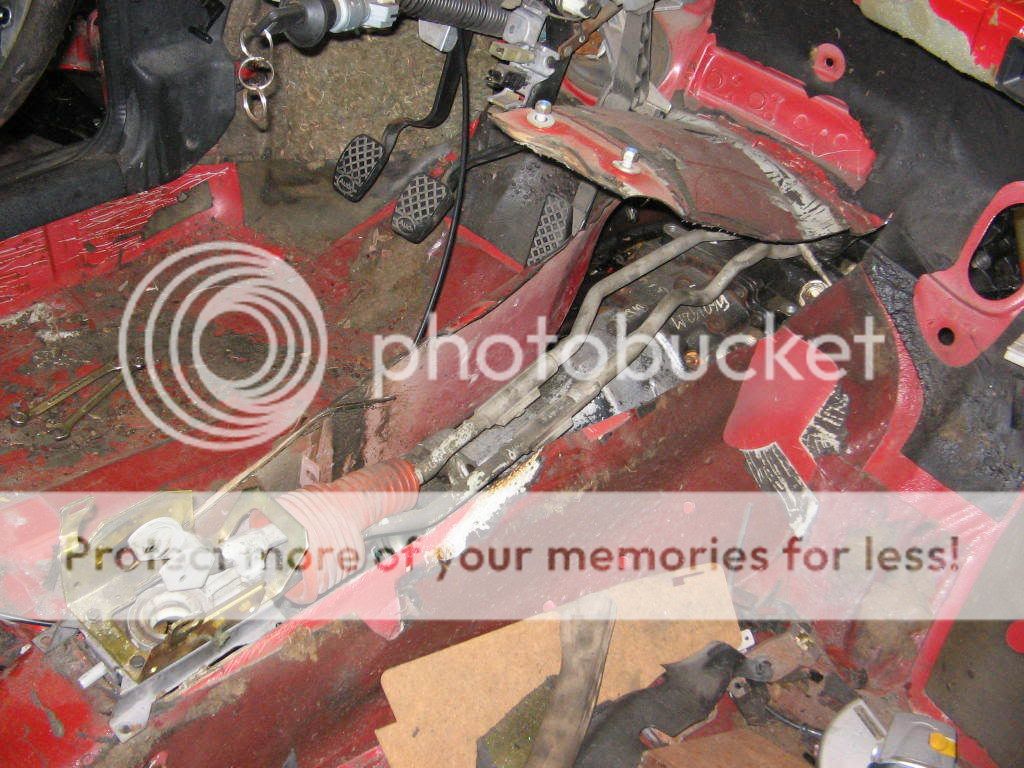

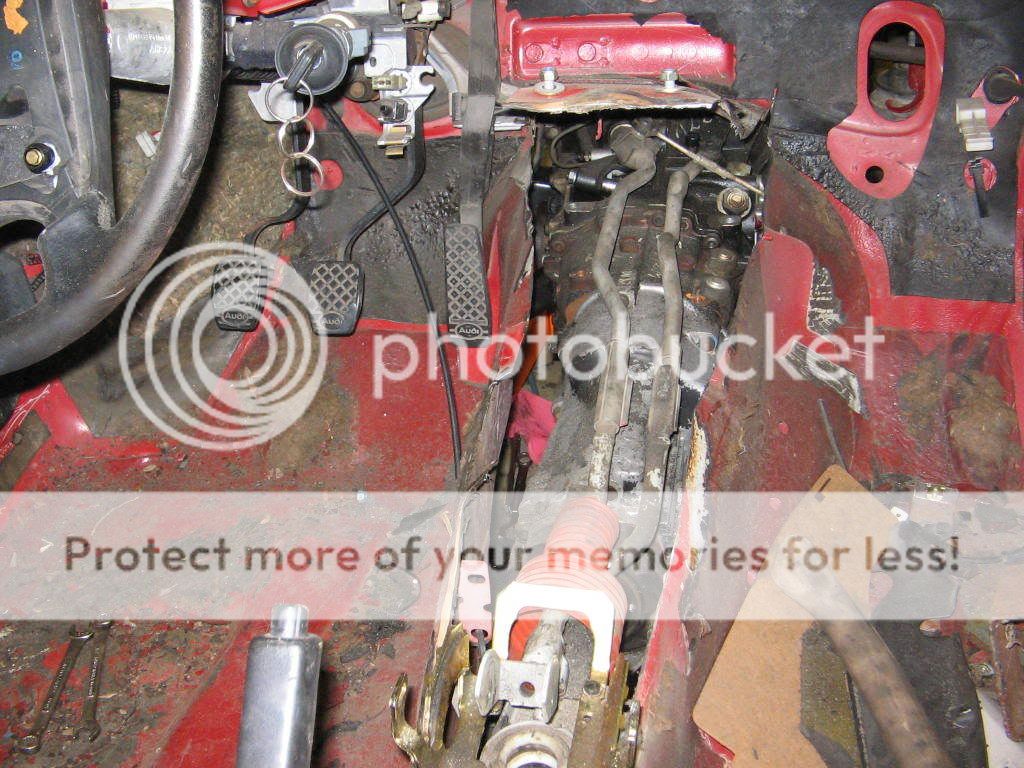

so, i did a little locking. its permanent now. shame too, because this Torsen unit is a pretty nice piece of work. i am looking into a machined part to directly replace the torsen for full time locking like this. the Subaru has something like that available from what i understand.
and i did a little shifter clearancing. this is better for me than modding the rods....

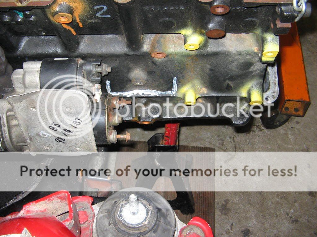

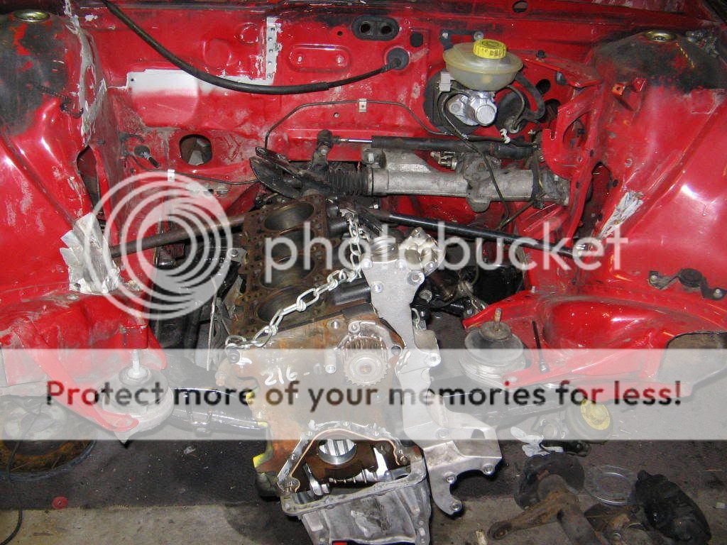

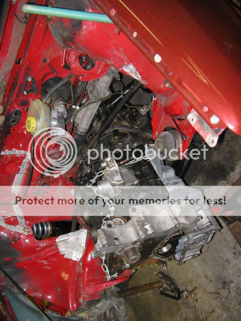

ok. so i tossed in the mock up block to see how i want to make the motor mounts.
anyone have thoughts on solid my style versus the solid/delrin 034 ones? whats the difference? that delrin crap is pretty stiff. and since the trans is mounted SOLID, it cant get any flex anyhow.
http://www.034motorsport.com/product_in ... cts_id=434 ... cts_id=434
anyways.... couple pix. dont worry, i have a remote oil filter setup so there is no interference there. and the motor is just in there for mockup purposes.
zerb
Post by zerb »
i know youve already got the solid trans mounts, and i havent driven my car yet obviously...but the motorspec mounts i got from 034, are farking solid. like, you could take them out and use them as a weapon solid. with just the two tranny mounts bolted in and the passenger side mount bracket 'resting' in the passenger side mount....the motor didnt move even the slightest bit.
shoot me a link to the remote oil filter setup too please, cause i may need to go that route, cause im not sure if the aeb oil filter hosings bolt to the 06a blocks....cause those put the filter at an angle.

careful with the totally solid mounts... you will make your engine and transmission "structural" in the build of the car, and chassis flexing will put stress on your block and transmission. and i'm sure that it'll have it's own load of stress to deal with just from normal engine operation.
i was going to make my mounts solid and a friend of mine was telling me of some old mopars that guy were making solid mounts, and breaking the trans tail snouts off, so i decided to design a little isolation into my mounting systems to take extra stress off the engine/trans.

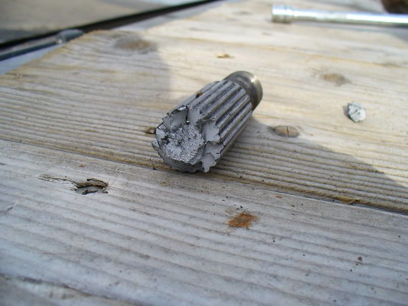

yeah, about those videos :D
i have not forgotten them. i have that same video from the inside of the car, too. goes just like that.... i have a theory of why it happened.... i was lower powered then. only 325whp/269wtq.
theory goes that when i did that burnout, i passed the lights. so i put it in reverse until i was staged. i think the tiny bit of play in slamming it forward snapped it. if i had backed thru the lights and then forward to stage it wouldnt have happened my thoughts are.
