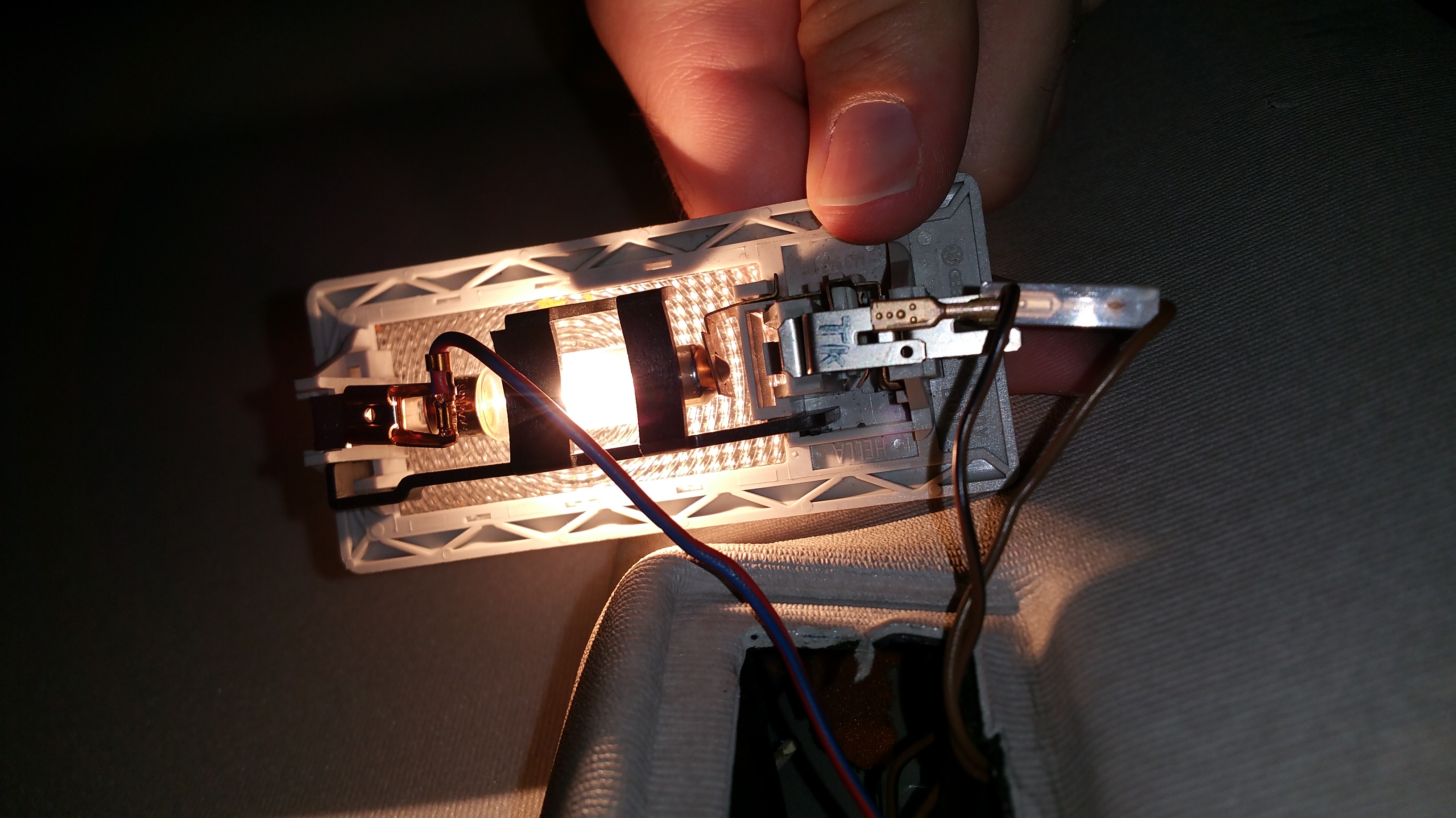

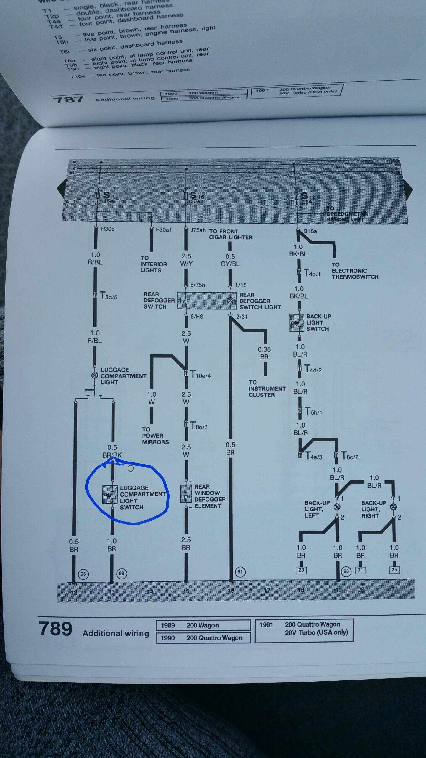

Can anyone tell me where this switch is located?
My luggage compartment light only works with the wire that goes straight to ground. The black/brown wire doesn't do anything. The wiring diagram makes it seem like there is a separate switch in addition to the one that the light is on. How is the luggage compartment light supposed to operate? Does it come on when the latch is released or something?
Here's the back of the switch the light is attached to.

Apparently other people have wondered the same thing... does anyone have a luggage compartment light which comes on when you open the hatch? I'm thinking it is integrated into the latch somehow. Can't find any documentation on this though. Not in the Bentley or parts diagrams anywhere.
http://forums.quattroworld.com/v8/msgs/13464.phtml

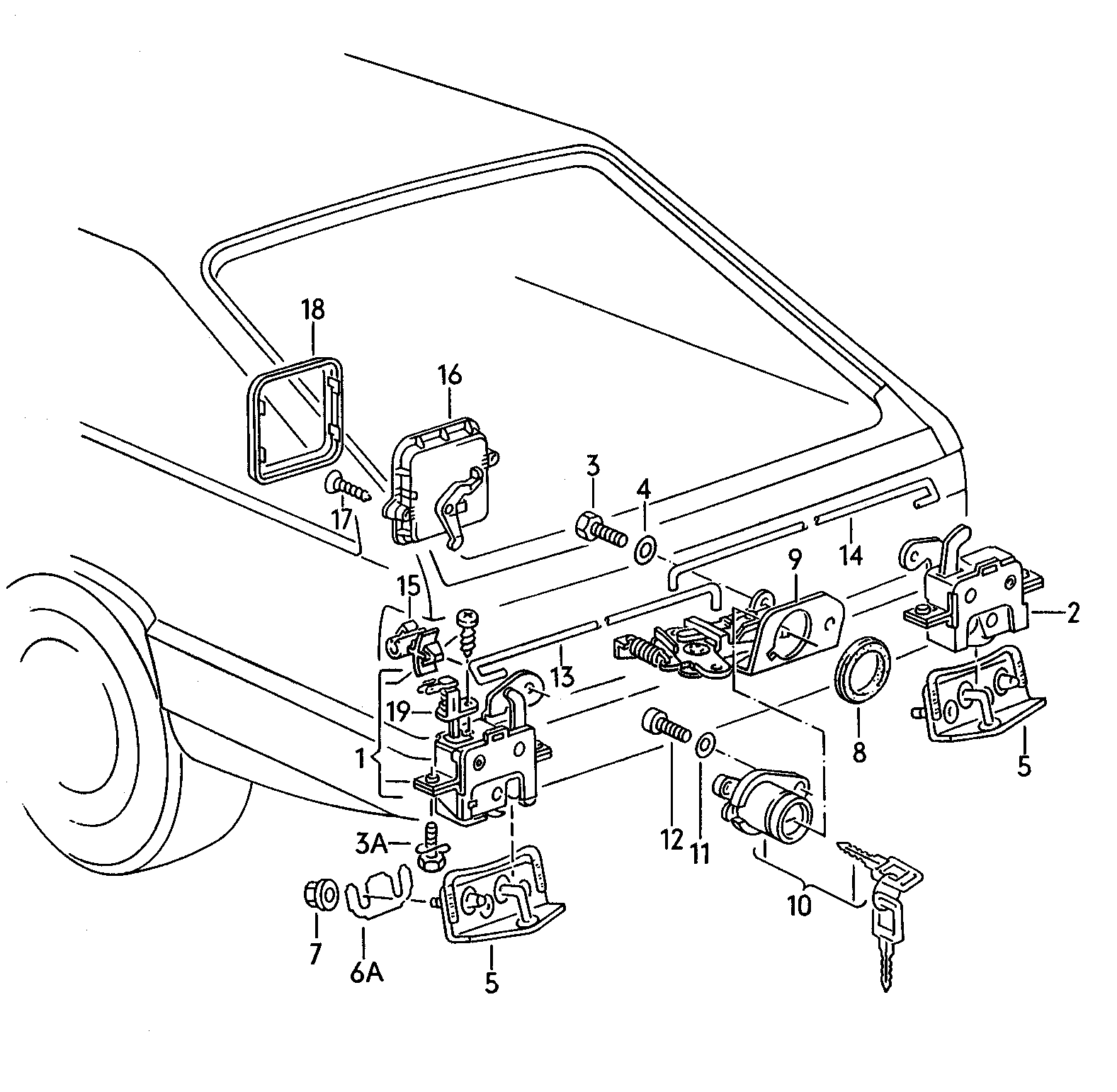

*Edit* FOUNT IT!
Number 19 in the diagram below. Part number 443947561C. I will order a new switch and hope that fixes it. If not, then wiring is next.
*Edit* FOUNT IT!
- Number19LuggageCmptSwitch073120100.png (40.93 KiB) Viewed 31598 times

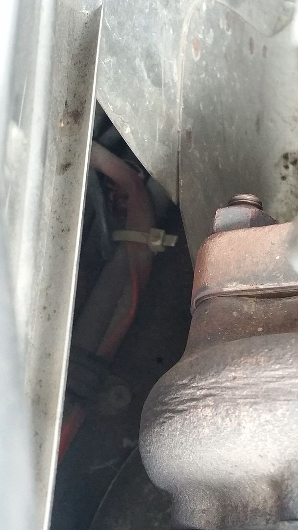

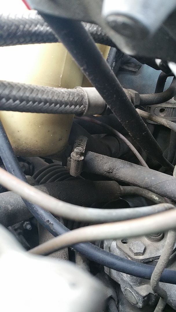

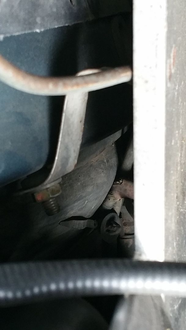

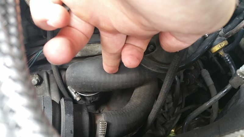

I was bored the other night and did a bit of an inspection in the engine bay. Here is what I found.

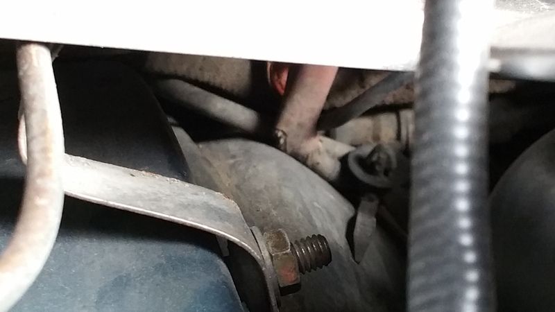

Broken radiator mount. I am ordering six of these (4 for the aux radiator for when the timing belt gets done). P/N 443121273E
The plastic nut for my fan shroud is gone. This is me being picky, but why not replace it when it's available? P/N 171201969

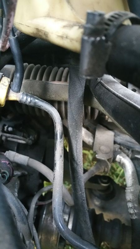

The steering damper is all oily... I can't see anything around it that could be causing that, so I believe it is probably bad. My records show that it was replaced at some point, but I'm not sure exactly when. I think it is at least 10 years old and 70k+ miles old, so why not replace it! P/N 4A0425021 (this is the only one I can find when searching in the parts stores online anyway... the Audi replacement is very expensive at over $200... Febi makes one for around $50).
There is a steering hose which has some Pentosin leaked onto it, but I think it is from the smaller diameter hose right above it. P/N 443422891B
This appears to be the culprit. 443422891B

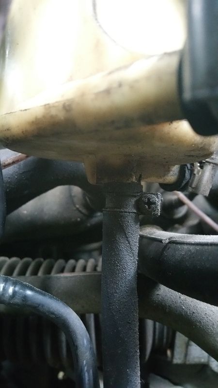

The bottom hose on the hydraulic fluid reservoir is also leaking. I will replace that hose as well. P/N 443612733C. It isn't a special hose (just regular hydraulic hose with hose clamps on it). Size 8X14

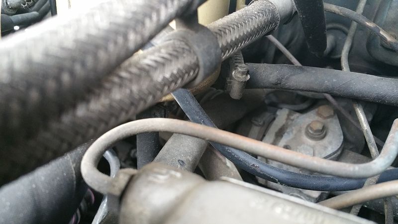

My crank breather is VERY soft. I almost feel like I could push my finger through it lol. It doesn't leak for now though. I will order the kit from 034 to replace it all with silicone.

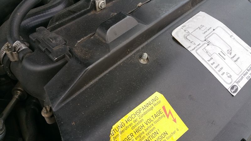

This one is particularly interesting to me because it seems like it could be a big deal actually. There is a medium-sized red wire which splits off near the turbo and goes down near the passenger fender. It seems frayed and possibly damaged here as you can (barely) see in the pictures. Maybe that's just the jacket and the wire is just fine. I'm going to work on figuring out what that goes to before it becomes a problem though!

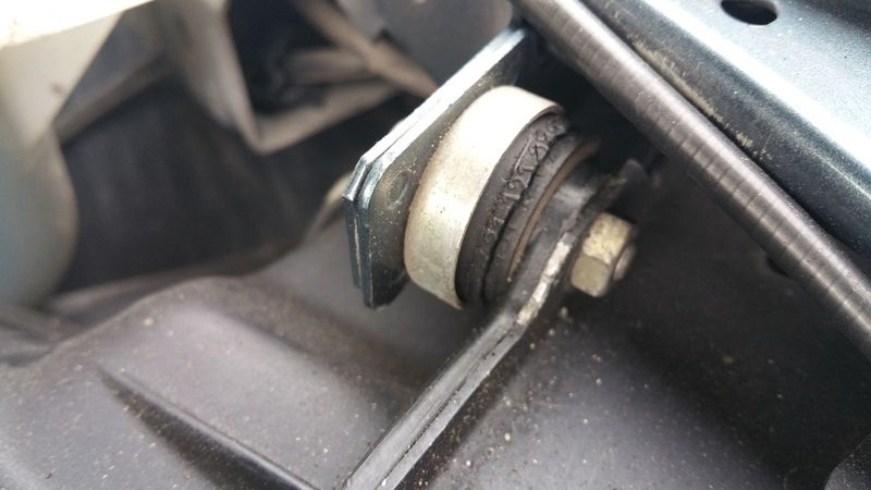

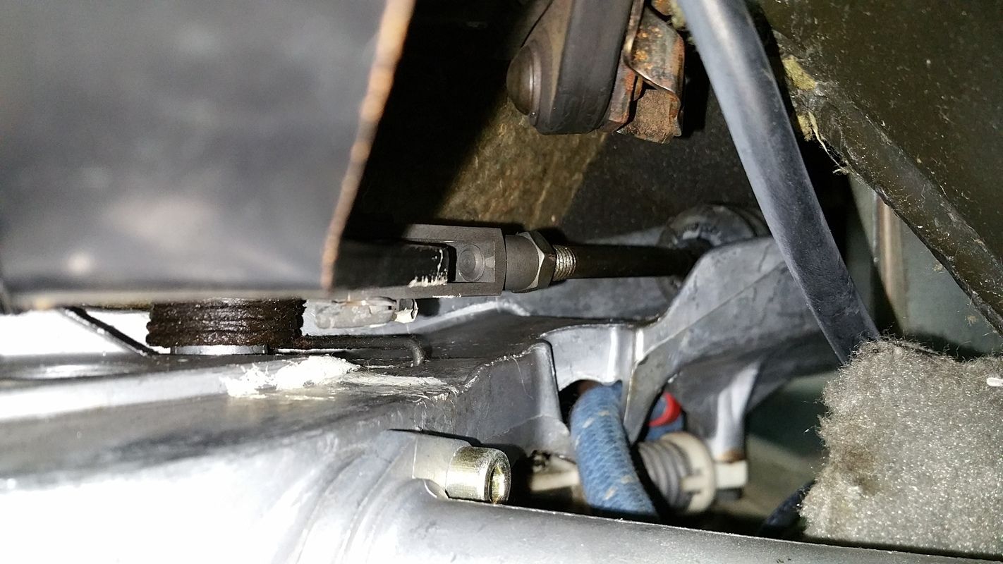

Finally, there is a funky noise that comes from the brake pedal. It is pretty strange because you can depress the brake pedal very lightly and a loud tap comes from the brake master or maybe the hydro assist area. It seems to mostly go away after the brakes are pumped up a bit. I'm thinking maybe I need to adjust this rod? If that doesn't help, I will start looking at the hydro assist unit and master.
Before you go too nuts on the brake pedal, pull the clevis pin and see if it's worn/slotted. I know it's happened on the older B2s, and it causes a click/pop. Hopefully the clevis itself isnt' worn!

I will definitely check the clevis. I kinda did already, but need to take a closer look. That was my first thought actually, but it didn't "feel" like it was coming from there when I was messing with it from under the dash.

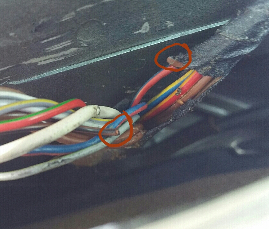

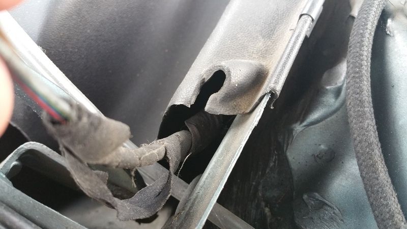

And we have progress!
I suspected this all along. I was able to get to the hatch latches easily yesterday. They come right out readily and the switch is so simple it really isn't worth even testing. So I took the wire in question off of it and grounded it straight to the chassis. No light. At that point, I had to face the fact that this was a wiring issue.
So I thought to myself, "If I were a wire, where would I break." Of course, the obvious answer is at the hatch hinges. Sure enough...
Almost all of the wires in that area and by the other hatch hinge have their insulation cracked and probably wires nearing failure from fatigue. Time to spend some time with the soldering iron and rebuild this part of the harness! Or get a new harness?
I rebuilt the hatch wiring completely on my UrS6 avant, took a couple hours tops...
I used some techflex, counted, gauged and labeled all the wires and then cut that section of the harness completely out. Soldered inside the main cabin and well into the hatch itself. Not sure if the harness itself is available.
Yeah, I agree cutting out a large section is important to make a repair like this last. At least one version of the harness is still available, altgough I could buy a mighty nice Metcal soldering thing for the price. I'm still trying to figure out if it's for a specific model or what...
