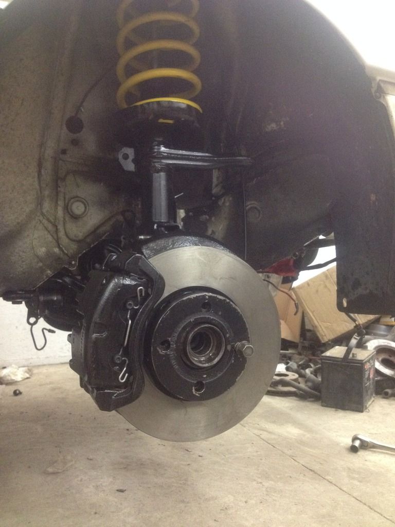

DE80q wrote:Those are the same rotors I have. If you have the small bearing knuckles, you will still have to space the caliper back to center it on the rotor.
do you have the rotors for the euro spec 90 sedan or the coupe quattro rotors? 90 sedan 276mm rotors have a different offset, maybe that is the issue requiring the backspacing? The part number I used is 893 615 301 for the lower offset rotors.
http://www.worldimpex.com/parts/brembo- ... 28102.html
I used this info, we will see if it was 100% correct when I bolt everything together. Test fit looks right. http://www.20v.org/brakeupg.htm#G60
Re: 1.9 TDI into 90q
I don't remember the part# I used, but they were listed by brembo for the 1991 90q 20v sedan. They have a much lower ofset than the CQ and B4 rotors I had lieing around.
dana
Posts: 951
Post by dana »
hmm, sounds like the same rotors that I used. Very noticeable difference in offset from the coupe rotors I have. I guess the larger knuckle has a different offset at the caliper mounting tabs.
I think the difference I have it useig the 80q front hubs with the 75mm bearing. I believe they have a lower offset than the 90q 20v with the 82mm bearings.
dana
Posts: 951
Post by dana »
bolted rotors and carriers on and it all fits without spacers. Success.
That must be the difference between the 75mm knuckle, and the 82mm knuckle. I'm glad it was just a bolt on affair for you.

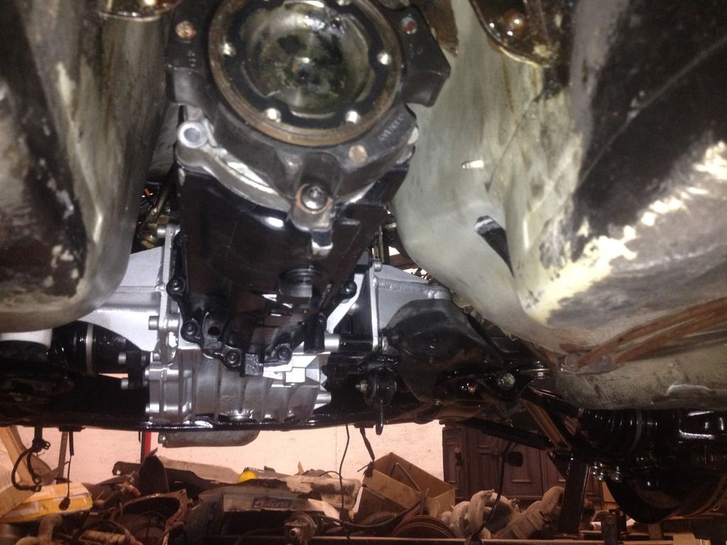

6 speed 01e is in, fully mounted, shifting and has axles!
I used:
-b4 90 fwd axles that fit the TDI trans tripod joints

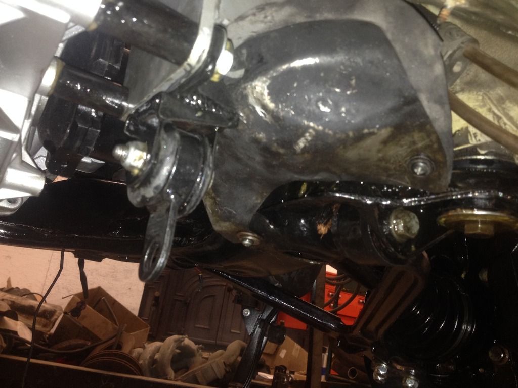

-second hand set of hanks first generation rs2 replica mounts
-made some spacers for the mount on the passenger side from some old inner control arm bushing sleaves
-made up a lower downpipe hanger bracket to hang from the passenger side mount
-cut down the 01a trans bolts to work with hanks mounts
-stock 90 20v outer knuckles
-276mm g60 rotors
-g60s from a coupe quattro

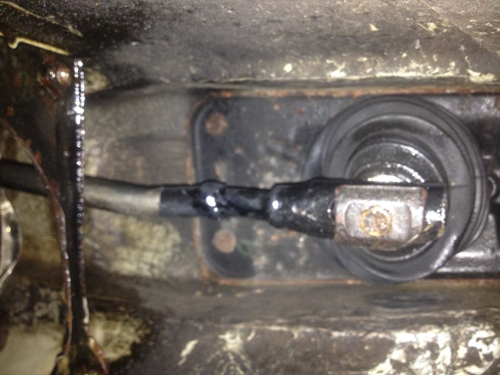

-early b5 s4 linkage. I had to actually lengthen mine about 1.25 inches. I redid this several times because I really didnt like how it shifted. At first I made a short shifter using the mk1 vw shifter, but I just didnt like the reverse lockout action. I ended up using the slightly worn factory shifter flipped (so reverse lockout is correct with 01e pattern) I cut the end off the original linkage with 1.25" extra and mated that to the b5 s4 linkage. Shifts as well an an 01e can now. Damn things are notchy.
-b5 s4 shift knob
-audi 4000 driveshaft. (not yet installed, assuming this will fit)
No pics of it installed, but I am glad to have that hurdle cleared.
Downpipe hanger bracket
more salvaging from this old winch mount plate. This thing is all over my car. Many brackets including motor mounts were made from this thing.
had this random hanger that came on the TDI trans, didnt work for my application, so I scavenged it too.
you can see the spacers made from the control arm sleeves, perfect for this
mounts all painted up
hanger

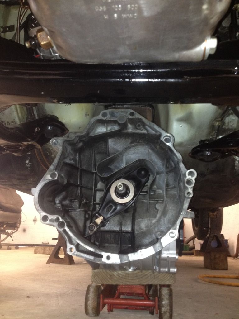

6-speed going in
k03 turbo removed, and ready for holset

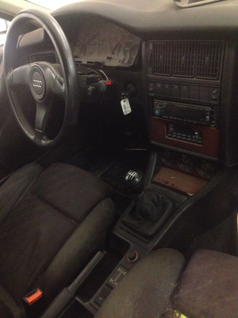

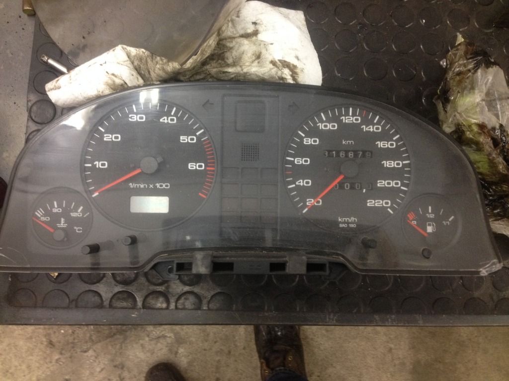

TDI cluster! Will have to put my mph speedo into this cluster
its officially a 6 speed now!

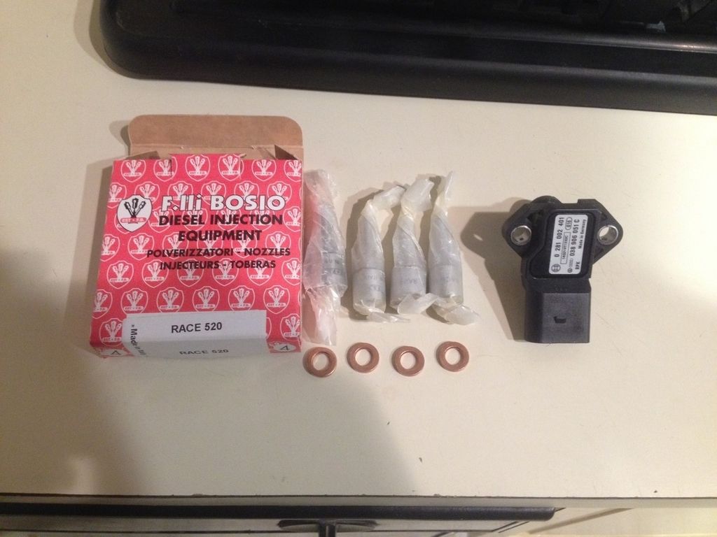

big ol injectors!
This thread needs videos!
PRA4WX
Posts: 589
Post by PRA4WX »
RACE 520's?! I approve! They've worked out fantastically for me! Nice work!
dana
Posts: 951
Post by dana »
PRA4WX wrote:RACE 520's?! I approve! They've worked out fantastically for me! Nice work!
they seem like a good choice, plenty of fuel for any amount of reasonable mods without getting crazy (read waaay to expensive). Trying to get someone to write a tune for this car is like pulling teeth. Its pissing me off so bad, Ive tried all the major tuners. Kerma was a straight dickhead, malone stopped responding, jeff at rocketchip was encouraging and liked the project but said the AHU cant take over 150hp (which i do NOT believe, and he never got back to me after talking on the phone), mike at TDtuning said he could and would do it, but takes 2 months to get back to me. I think MR Tuning in Quebec is going to do it, but still waiting to hear if hes burned the chips yet.
Makes me really annoyed that there isnt a decent and affordable self tuning option for these.
