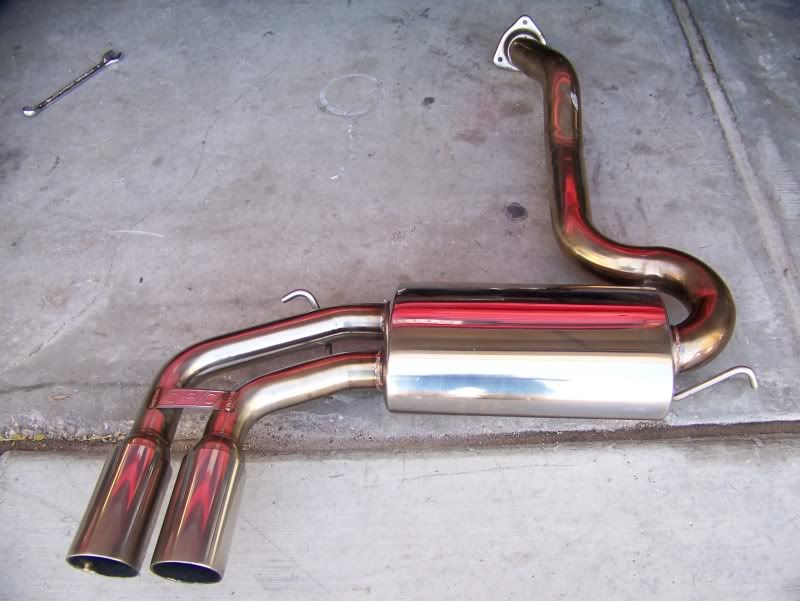

The good was that a few weeks ago you may remember that I was wondering what I was going to do about an exhaust. I ended up with a straight pipe center section and just putting the better of the two muffler sections that I had. It was far from ideal, but because of the time constraints it had to do. While at the dinner Saturday night Dick, the owner of the black TTV6 Urq, asked me if I would be interested in a stainless muffler for my Urq. Not even caring what it was I immediately said yes. At the dyno session the next day he comes with this piece which in my way of thinking is GOOD.
A CAC rear section. I think they are a made in Belgium piece. Quality work.

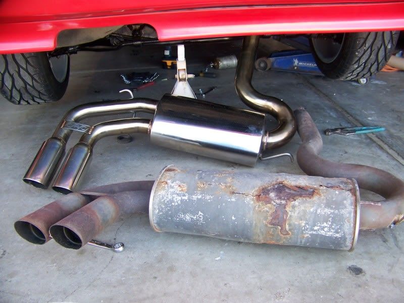

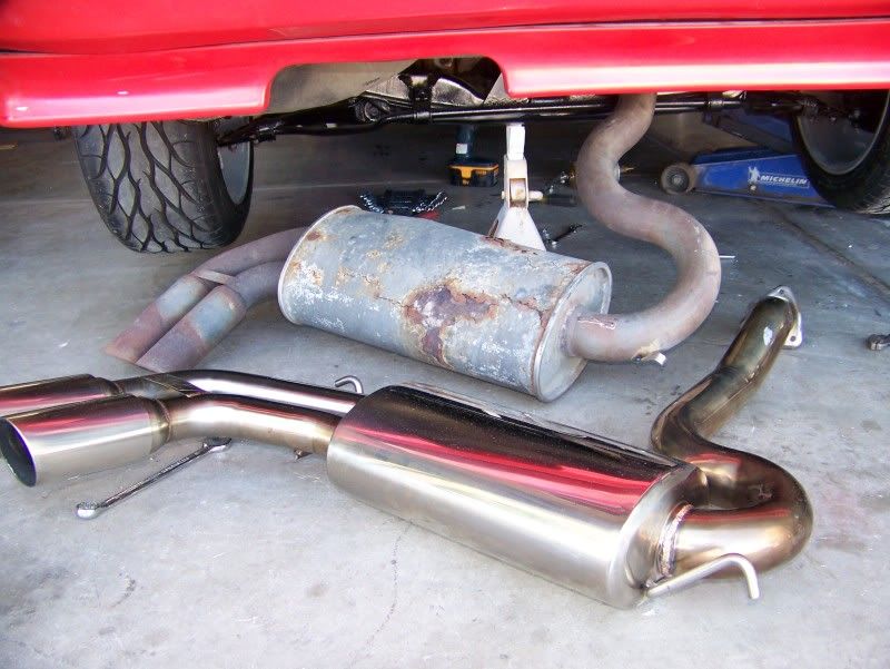

Old out to make room for the new.
and new in it's place

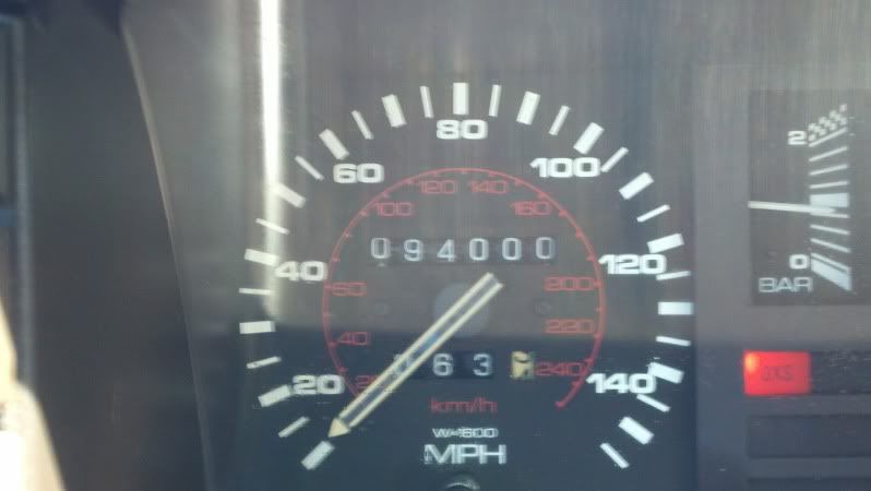

About 50 miles into the test, she turned over 94k so I guess that will be my purchase/back on the road benchmark starting mileage.

I used Coupe quattro CAC centre piece with extension to make it fit the typ 85 body. Rear muffler was Ur-q spec with tailpipes extended to fit the 4kq bumper. He now offers a version with extended tailpipes as well. I was couple of years to early for him

John, you might still need to check some hoses. At least to the dash for the 'boost' gauge. Im not seeing much boost when you throttle it up and not much vacuum when you let off. In stock form you should still see that needle go up to about 2/3 scale, just below the checkered flag.
Yea Sean, I don't think that I have full boost either, but I'm not sure that I trust that stock boost gauge either. It's hard for me to decide since it doesn't pull as hard as the 225hp TT, but then at 165hp it shouldn't. It also doesn't seem to hit as hard as the old MCs in the 5ktq did at 3-5k, but that could just be cam and I don't know what is in that head. I know that you said it was a pretty torquey cam so I wasn't expecting a high revving type motor. I don't have major leaks, but I could still have some small stuff going on even though it starts right up. The only time it struggled at all was trying to restart at 8k feet elevation and then only a little more cranking. It could use some more boost though.
