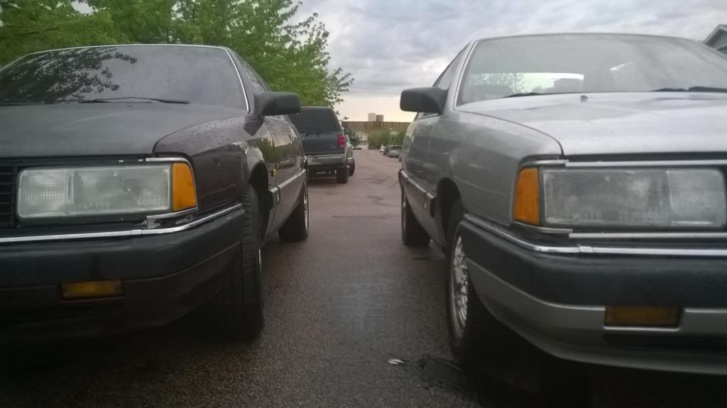

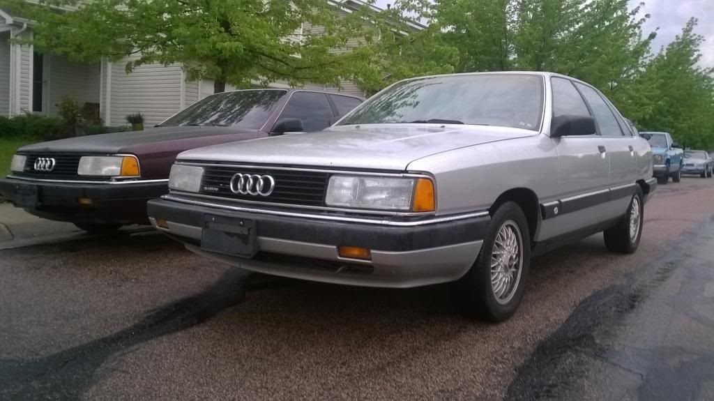

Some after work pics:
:flag:

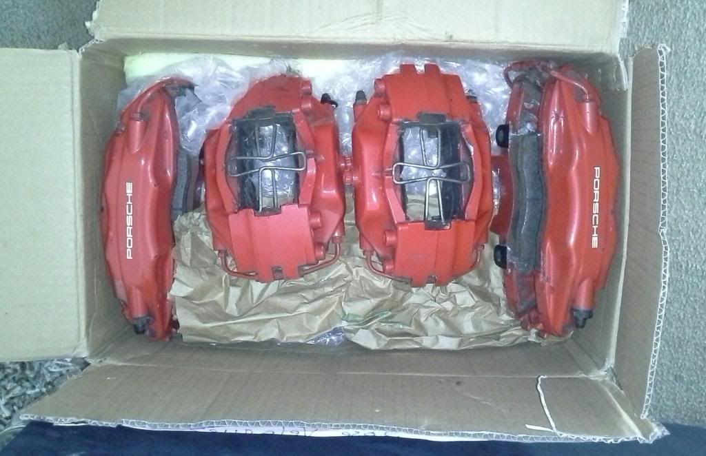

Whats up guys,
Since the 20v's brakes were bad, i decided it was a good time to just replace/upgrade parts. I decided to get new brake lines on all four corners and new calipers. For the front i went with braided steel lines from autohauz, for the back i ended up getting professinal grade rubber lines from rockauto.com since i couldnt find steel lines for the back. While i was at it i ordered a new fuel filter and spark plugs, just like magellen suggested.
I ended up getting a set of Rs2 calipers from audifans:
Im still waiting for the calipers in the mail. I know i still need carriers to be able to install the calipers in the back. I was told the front calipers fit with out carriers ( can someone confirm this?)

Guys,
The RS2 calipers finally arrived in the mail yesterday.
Holy crap are they bigger then what they seemed like on the pics. I hope they fit with the stock bbs, also does any one know where I can find new brake pads for them? I really hope I don't end up working Sunday so I can at least change the brake lines, spark Plugs and fuel filter.
Sent from my SCH-I405 using Tapatalk 2
Re: 1991 audi 200tq 20v-RS2 Calipers
Sorry to be the bearer of bad news, but I am pretty damn sure it was 16" that is the minimum. Maybe someone can chime in to see if you could use some extreme spacers or grind them a bit.
Either way, so fucking worth it. Damn balling.
