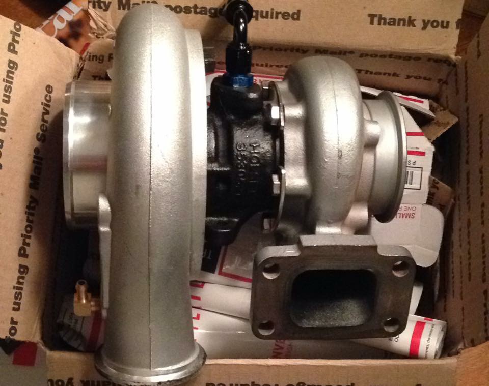

The housing is in! it's quite adorable. I am really intrigued to see what this setup does. If it chokes out, I can always go bigger.
- IMG_5422.JPG (142.94 KiB) Viewed 38045 times
