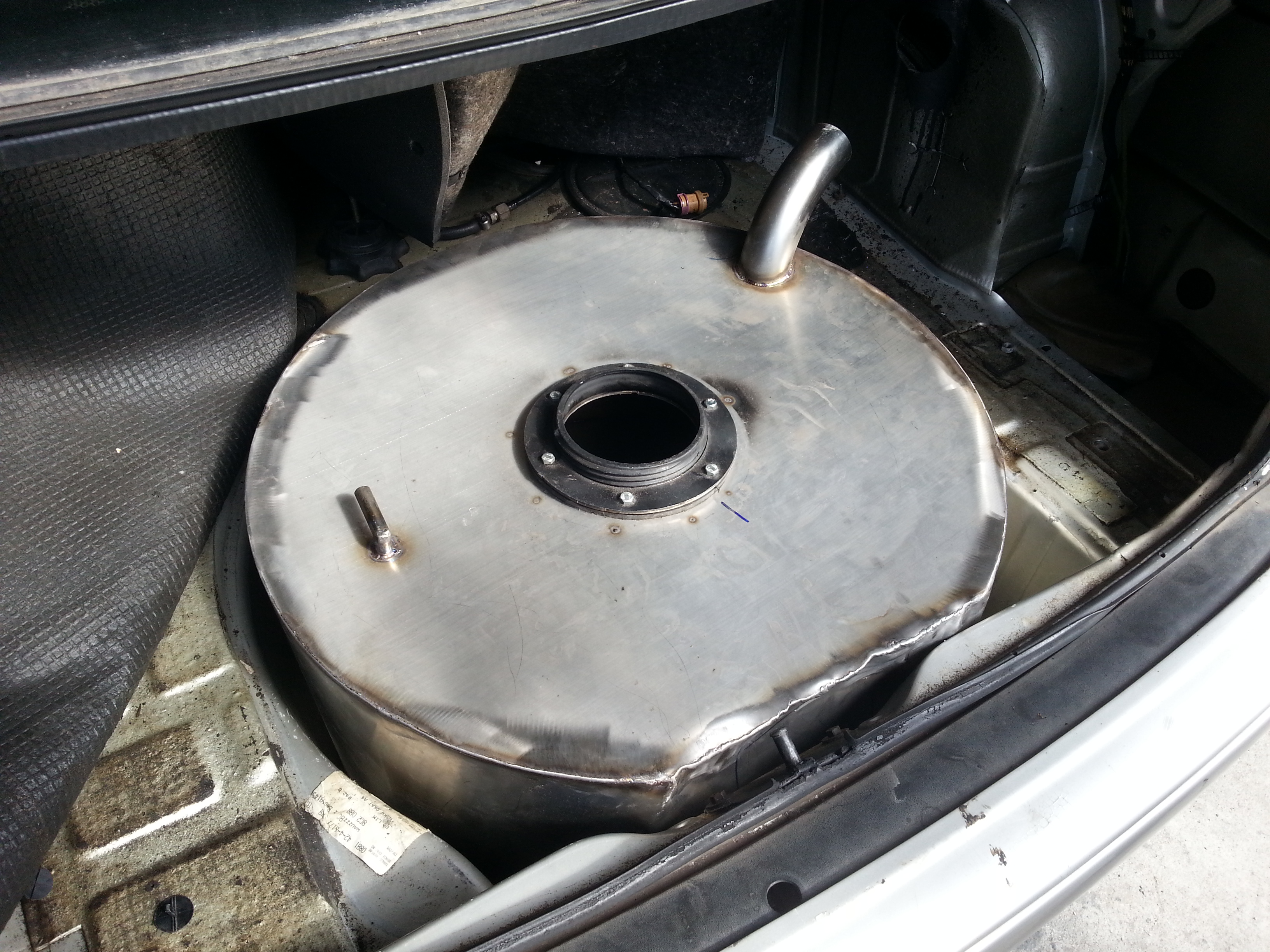

Went to start the fuel tank work today. My buddy and I butchered my old FWD tank for the fill nozzle, the access hatch with the thread and the basket inside was cut out/off.
The exhaust shop will make a round SS tank which will sit in the spare wheel well. Should be about 59 liters...
EDIT: Oopsie, got my Volume formula mixed up. Tank will be round with a diameter of 63cms and 30cm tall. So, not 59, but 93 liters!
That's about 25gals American... Is that too much?

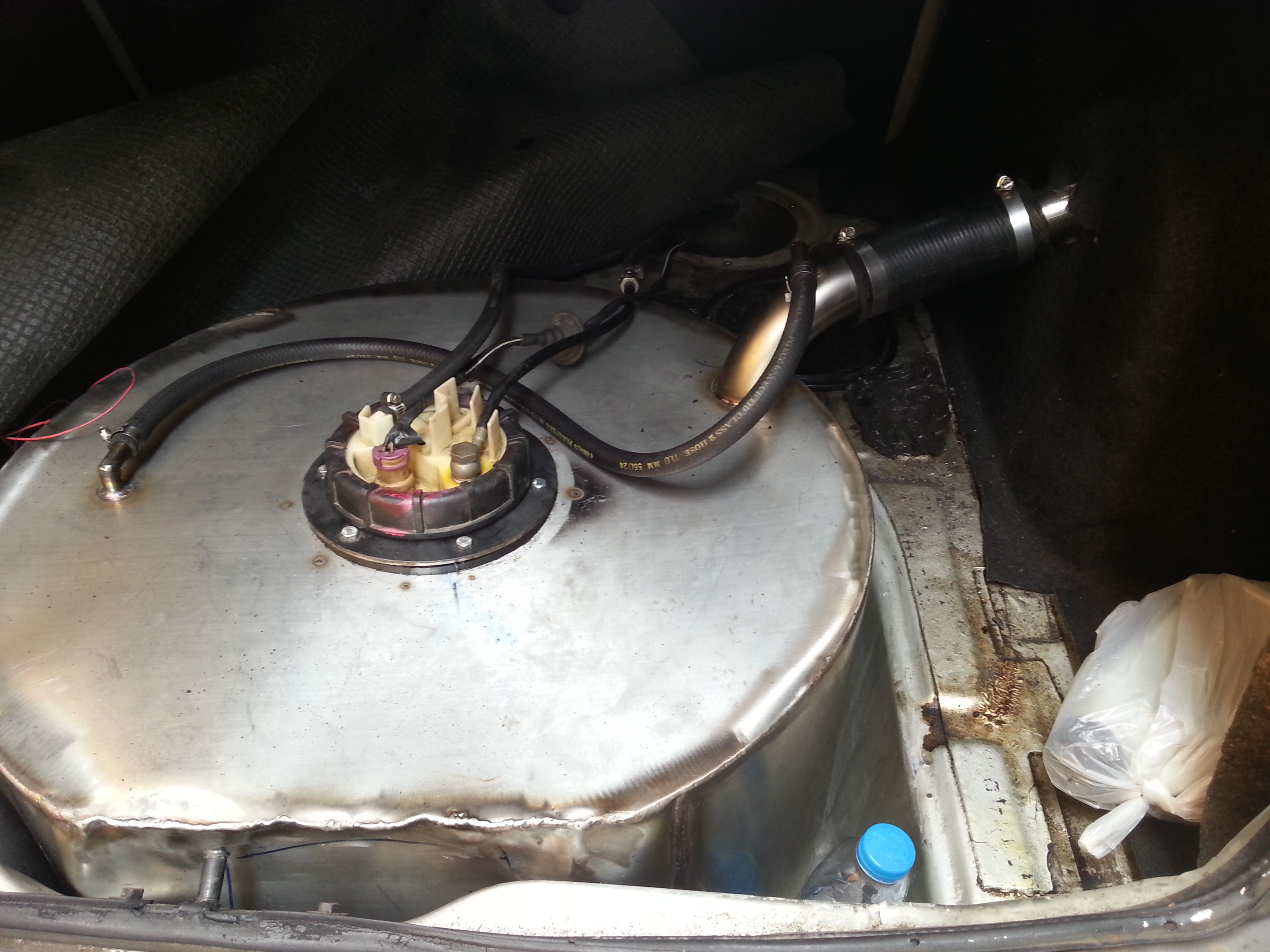

Re: B4Q 80-AEB> Fuel tank in, Stage 1: done
SS fuel tank is in! What a job...
Will post up some pics later.
Oh, its LARGE alright.pilihp2 wrote:That is a LARGE fuel tank. I thought my 18.5 gallons for my 5000 was big.
- 20140924_112515.jpg (1.64 MiB) Viewed 67985 times
- 20140923_152034.jpg (2.49 MiB) Viewed 67985 times
