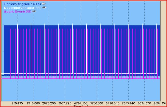

Because of the messed up triggers you won't be getting voltage at cranking. VEMS Isn't allowing voltage because it's not picking up proper engine signals.
Let me find a picture of a proper looking trigger log so you'll know what to look for.
Here we go.
- trigger.JPG (58.77 KiB) Viewed 41902 times

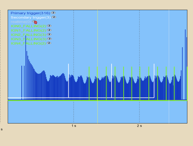

Oh God what the hell is wrong with mine lol?! My primary looks like a roller coaster but I guess my secondary looks fine...
I noticed my log looks quite similar to the log posted for this m3: http://www.vems.hu/wiki/index.php?page= ... BmwInstall
Primary is wacky, and you're not getting enough secondaries.

I have no idea how to even reverse the COP settings to dizzy. Was preconfigured and have no hookup instructions really for COP conversion harness per se. Heres my log without any zoom:

Sorry. I'm over here giving bad advice. Didn't look at the numbers of yours. secondary to primary ratio does look correct. My bad!
yeah, so 135 flywheel teeth, x 2 (per cam sync, two revolutions of crank) = 270 / 3 (standard auditrigger divider - in software) = 90. meaning, we need to see 90 primary triggers between every secondary. and we do, so he should be sparking fine. if he's flooding out with fuel that probably means we have wrong settings for the injectors, or something else happening. lets also see a regular vemslog while cranking too. (click the red "log" button. it will turn green. crank for 5 seconds or so, then click the button again, it will turn red again. send along the .vemslog that got created in your vems directory).
