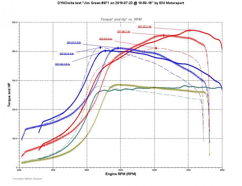

470whp was a safe pump gas level for the PTE5857 on my 8.5:1 motor. Even if the Meth injection failed, I would still run well at this level. That was my street tune.chaloux wrote:Go big or go home.
500whp on pump with a safe tune is big turbo mode. Jim did it with his pte but I'm not sure if he ran that tune daily (Jim?). That's a lot of power and you're going to have to sacrifice some spool methinks.
I'm going to do gtx3576 with either .82 or 1.0 a/r and qsv to hopefully spool before (even if just) 4krpm. But that ain't happening for a while. I don't have any power goals because the 4k is crazy with any more than 300

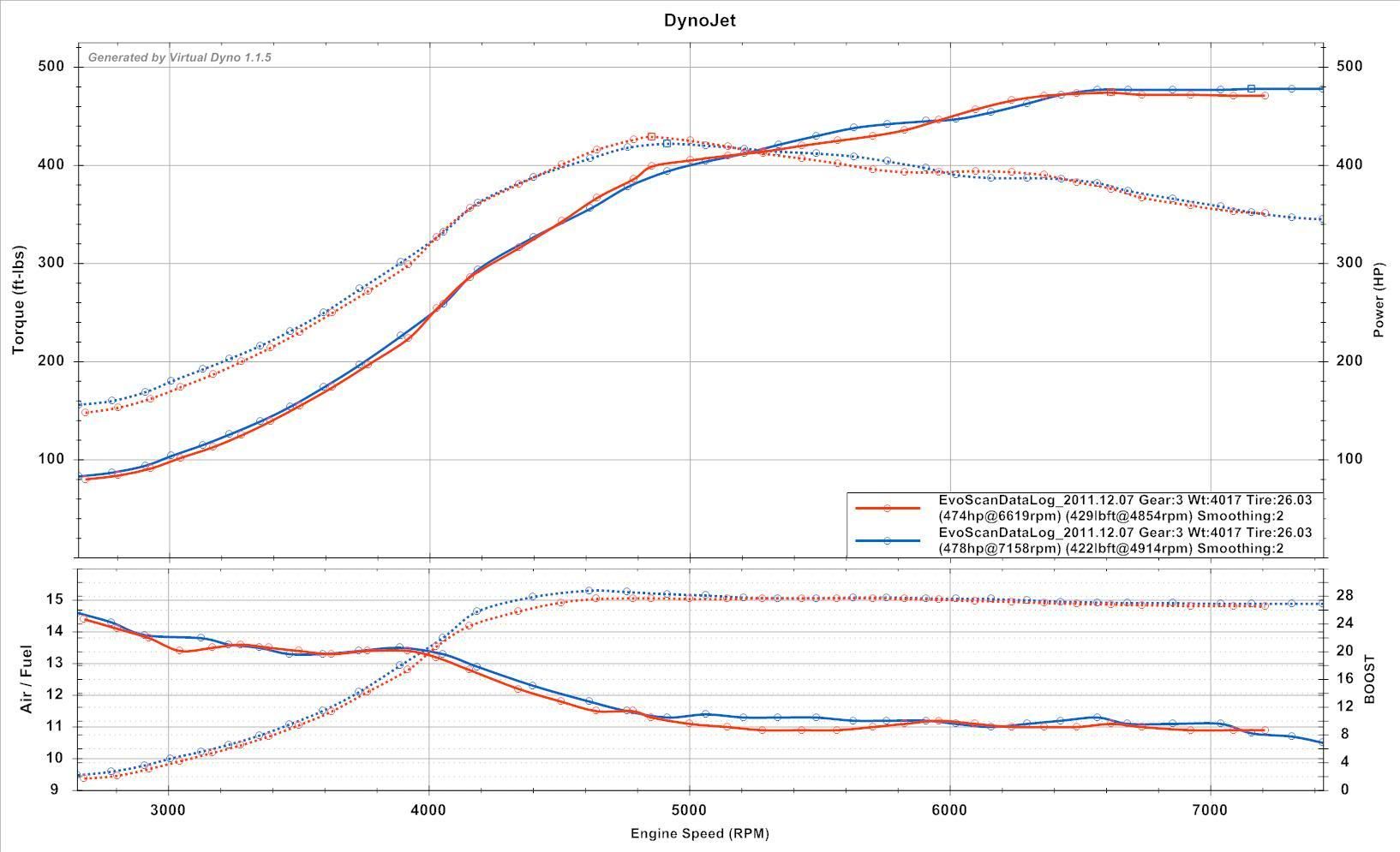

Re: ... A tale of Rubí ... Turbo Choices Abound!!!
At what PSI was this "safe" daily tune set around... and was this a revised tune from what the comparison chart showed?audifreakjim wrote:470whp was a safe pump gas level for the PTE5857 on my 8.5:1 motor. Even if the Meth injection failed, I would still run well at this level. That was my street tune.chaloux wrote:Go big or go home.
- Posts: 2144
The comparison chart is the tune I am talking about. About 28 psi from what I recall.
Is this the chart your talking about Jim?audifreakjim wrote:The comparison chart is the tune I am talking about. About 28 psi from what I recall.
- Posts: 2144
That's the one. You know, now that I think about it, 500 wheel should be easy. On the dyno, the car was eating up more timing and gaining power which leads me to believe we were not getting detonation, most of the time. I backed off the timing because I was getting random knock. I thought at the time I was riding that fine pump gas line, but last month I discovered I needed a restrictor before the ECU to smooth out the map signal. I was seeing swings of -+ 3 degrees of timing. 6 degrees of timing variation can cause a lot of issues..
Nice! SO you're saying that my car should see 500whp without an issue too?
