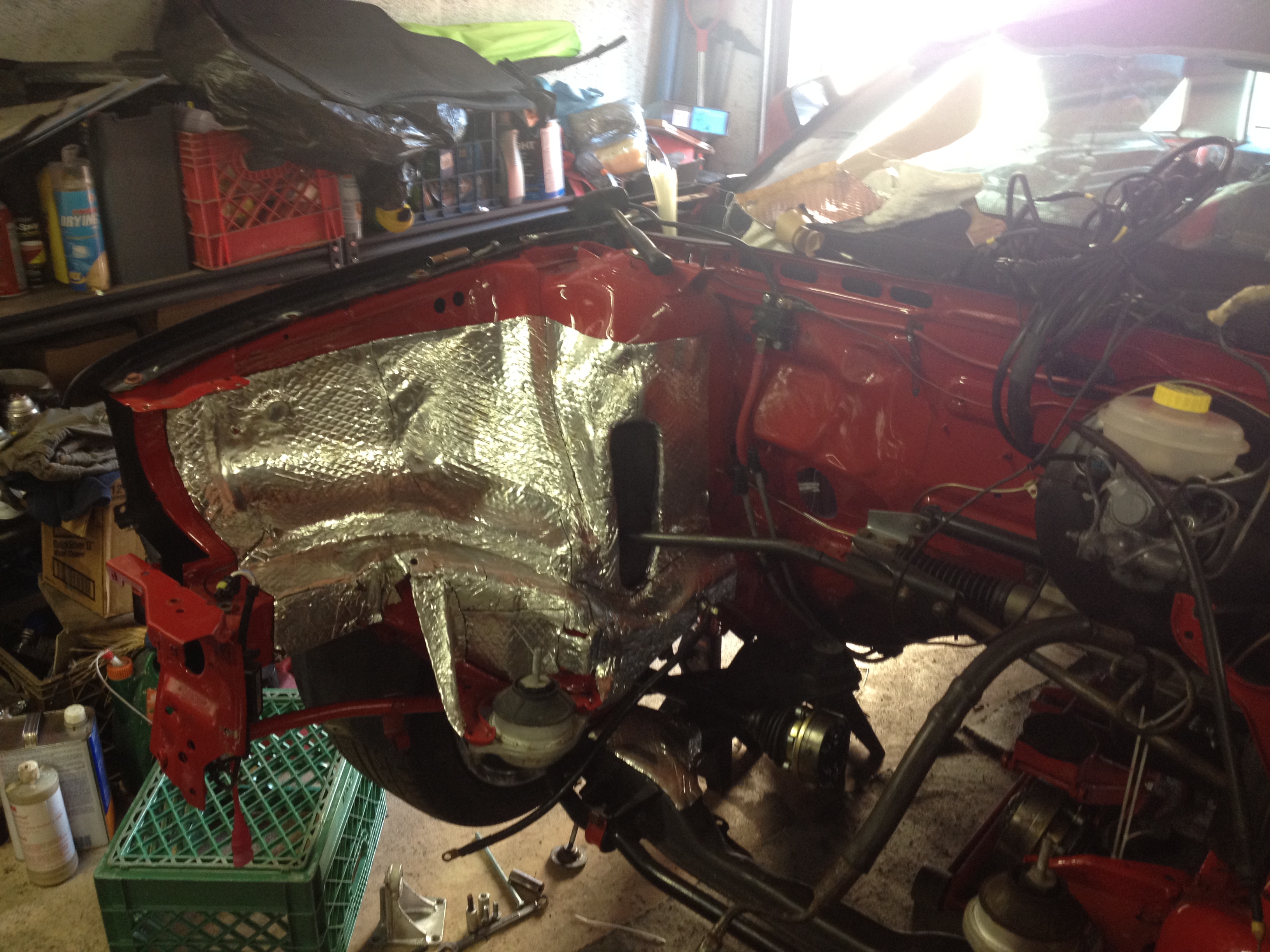

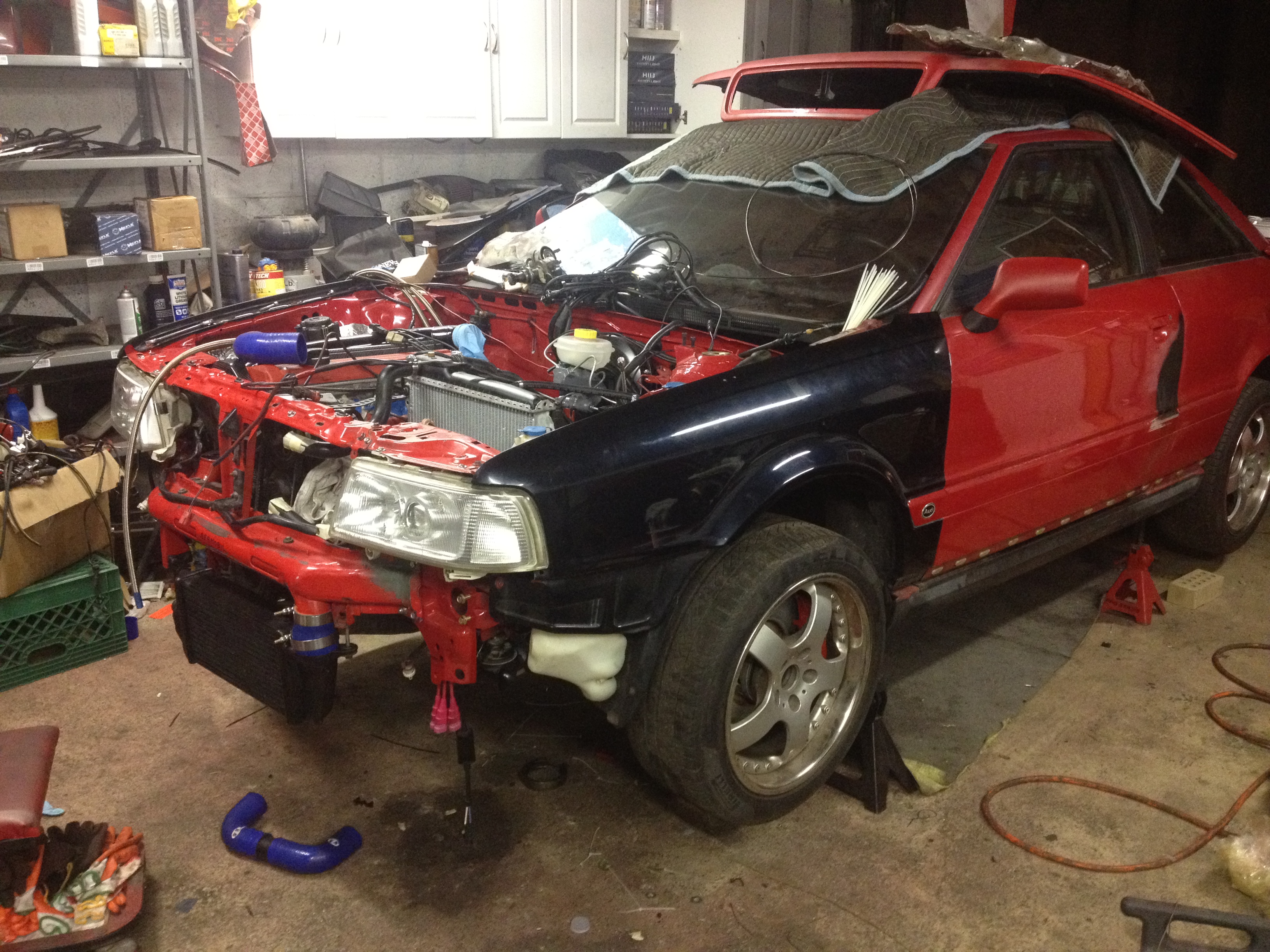

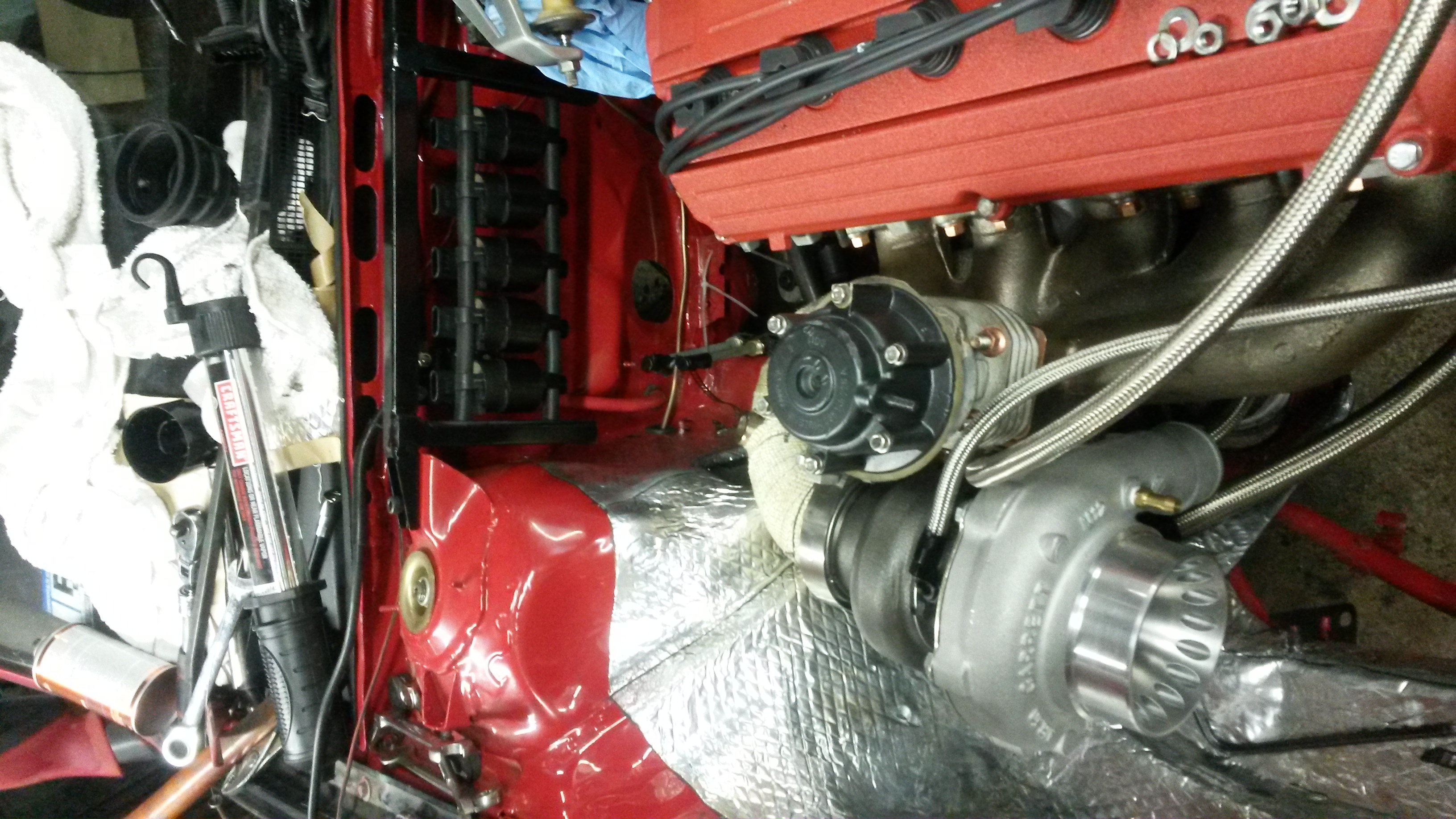

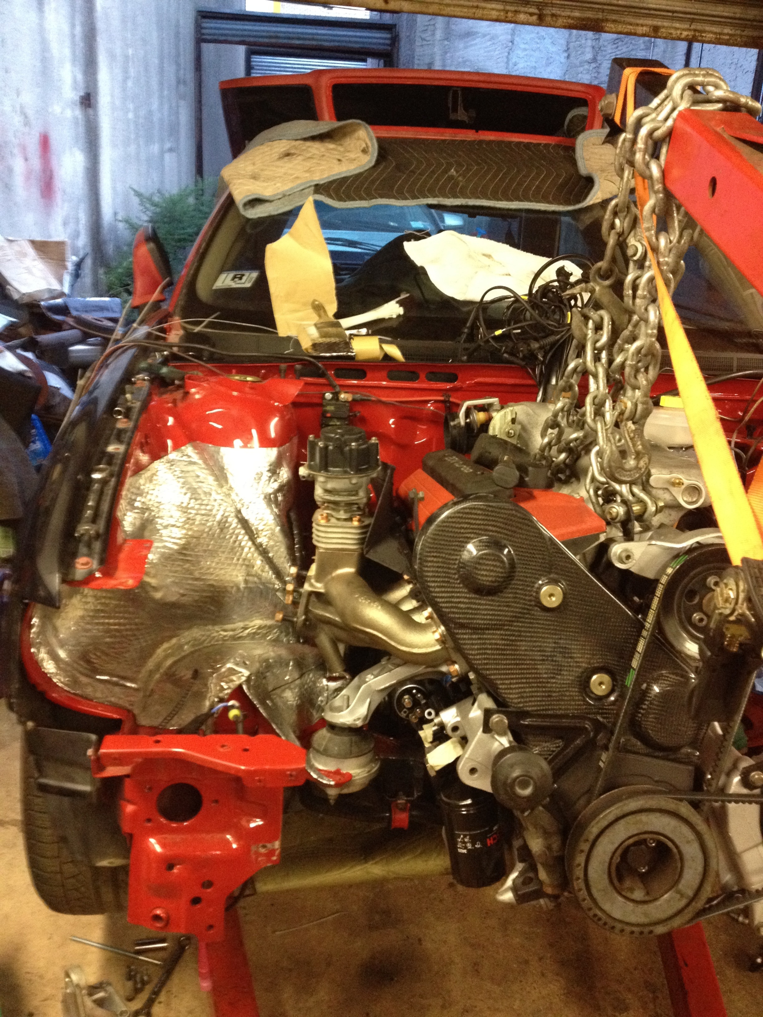

engine bay prep for engine install adding some heat shield
Sebastian's CQ91' engine bay heat shield.JPG (2.13 MiB) Viewed 42309 times

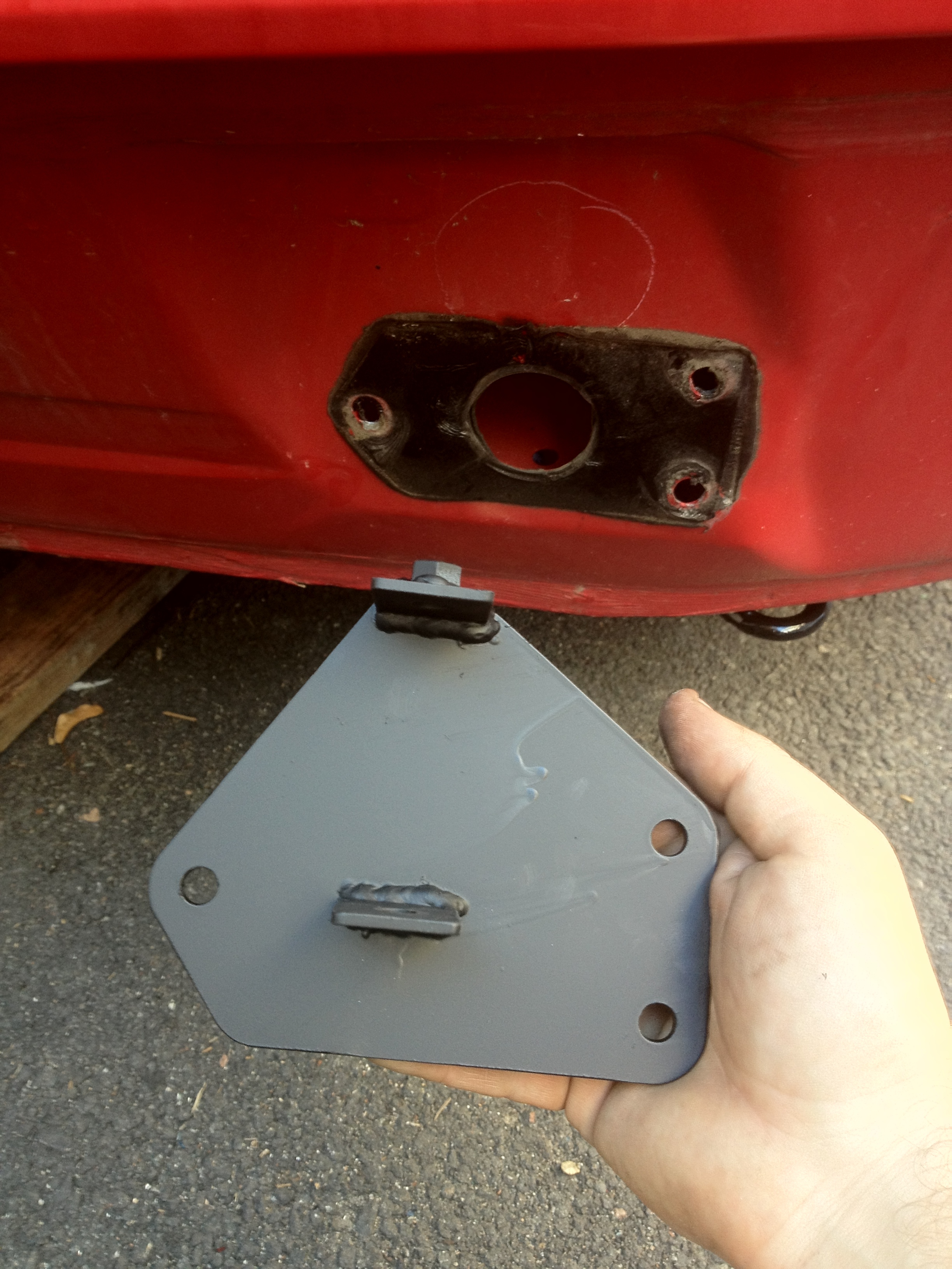

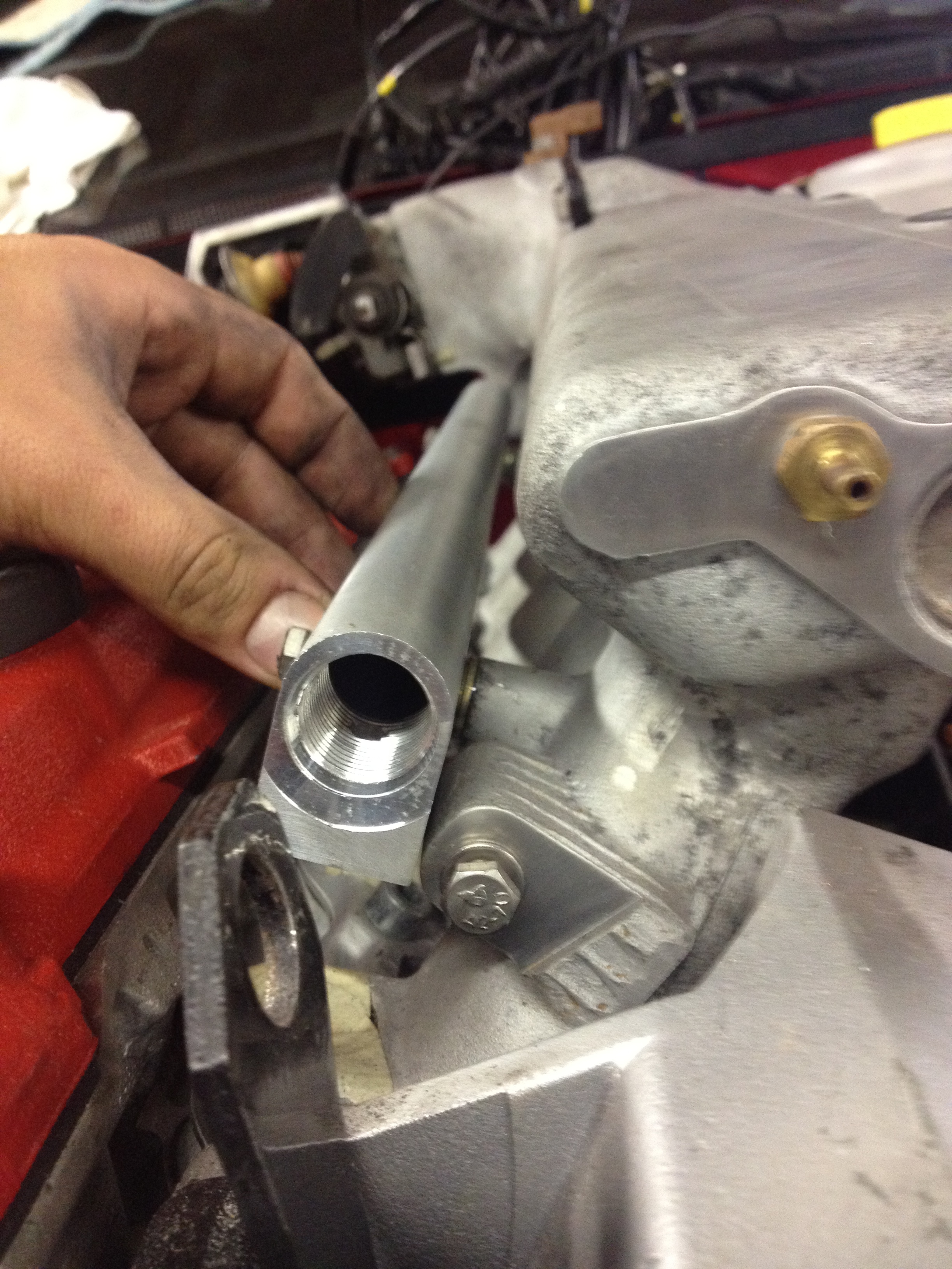

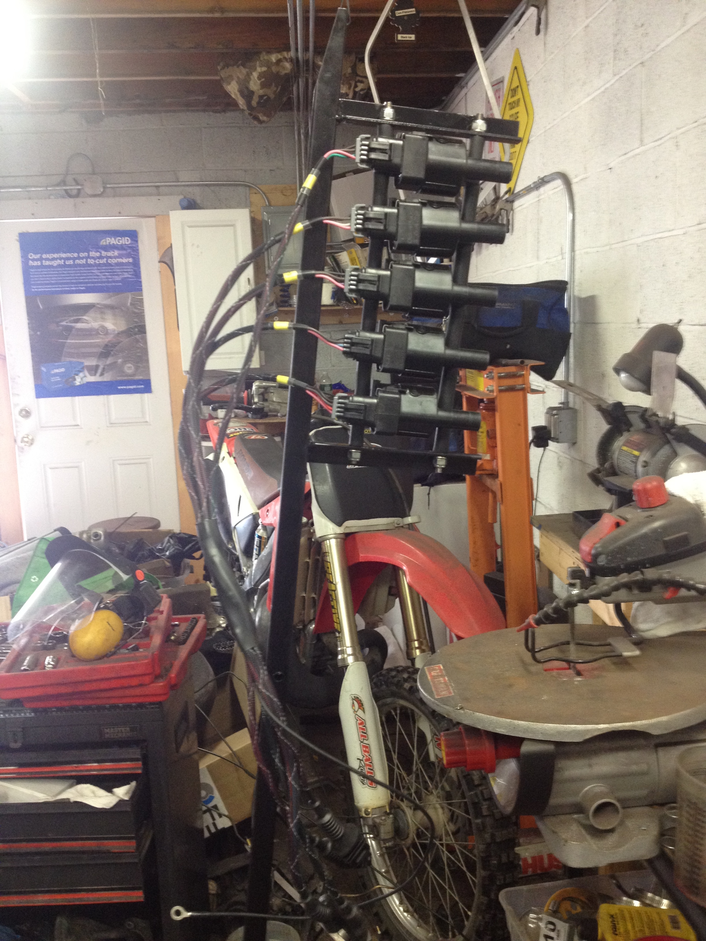

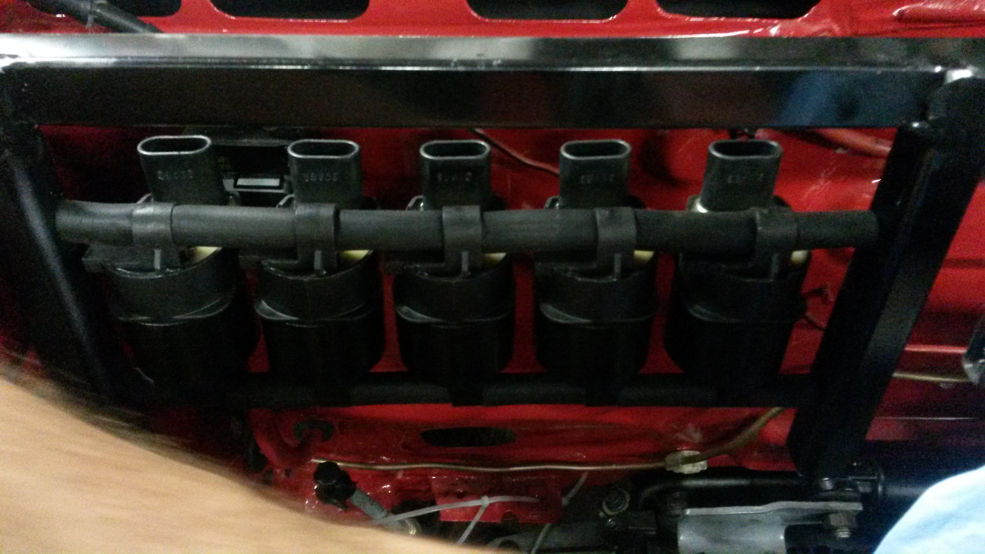

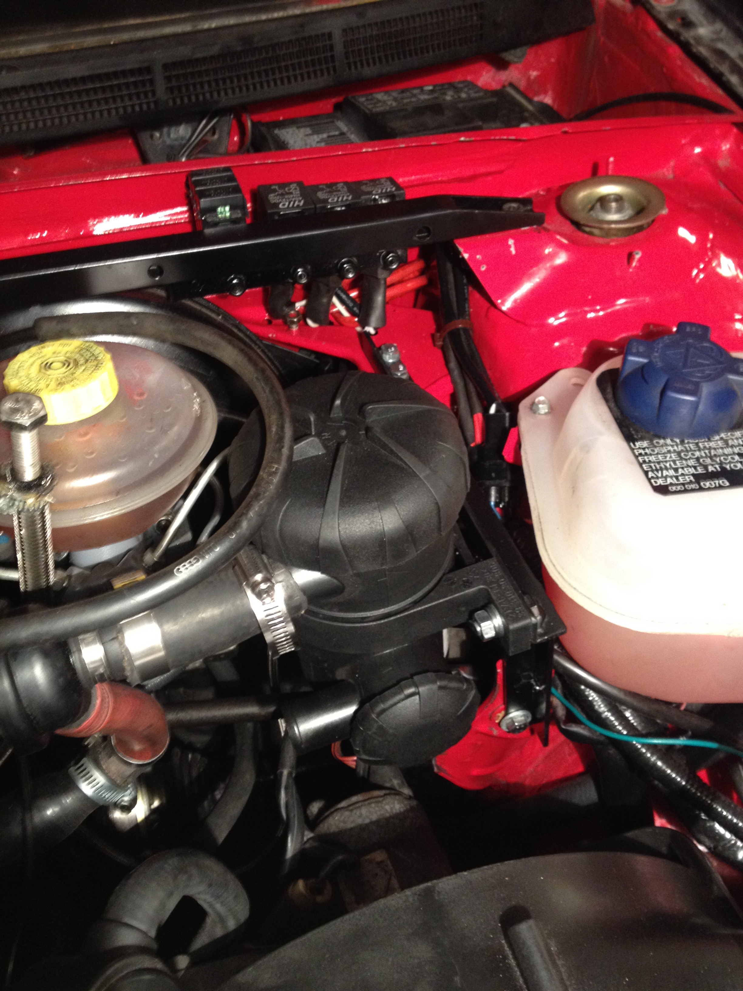

some more parts and work, custom bracket for the coil setup based on strut bar with welded mount for the coil rails
custom bracket for the rear bumper from Jack " Mayham project" ,
the fuel rail didnt fit on stock s2 intake manifold wih spacers so some grinding was needed to fit it perfectly
Sebastian's CQ91' coil conversion .jpg (2.75 MiB) Viewed 42292 times
Sebastian's CQ91' fuel rail fitment .jpg (2.74 MiB) Viewed 42292 times

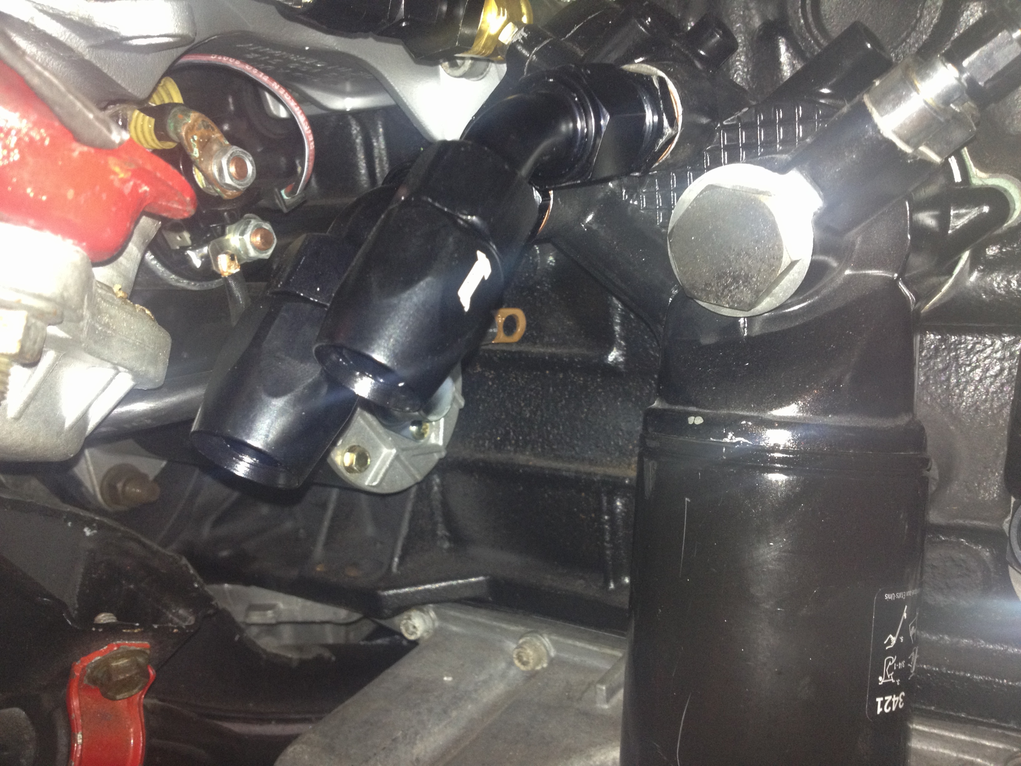

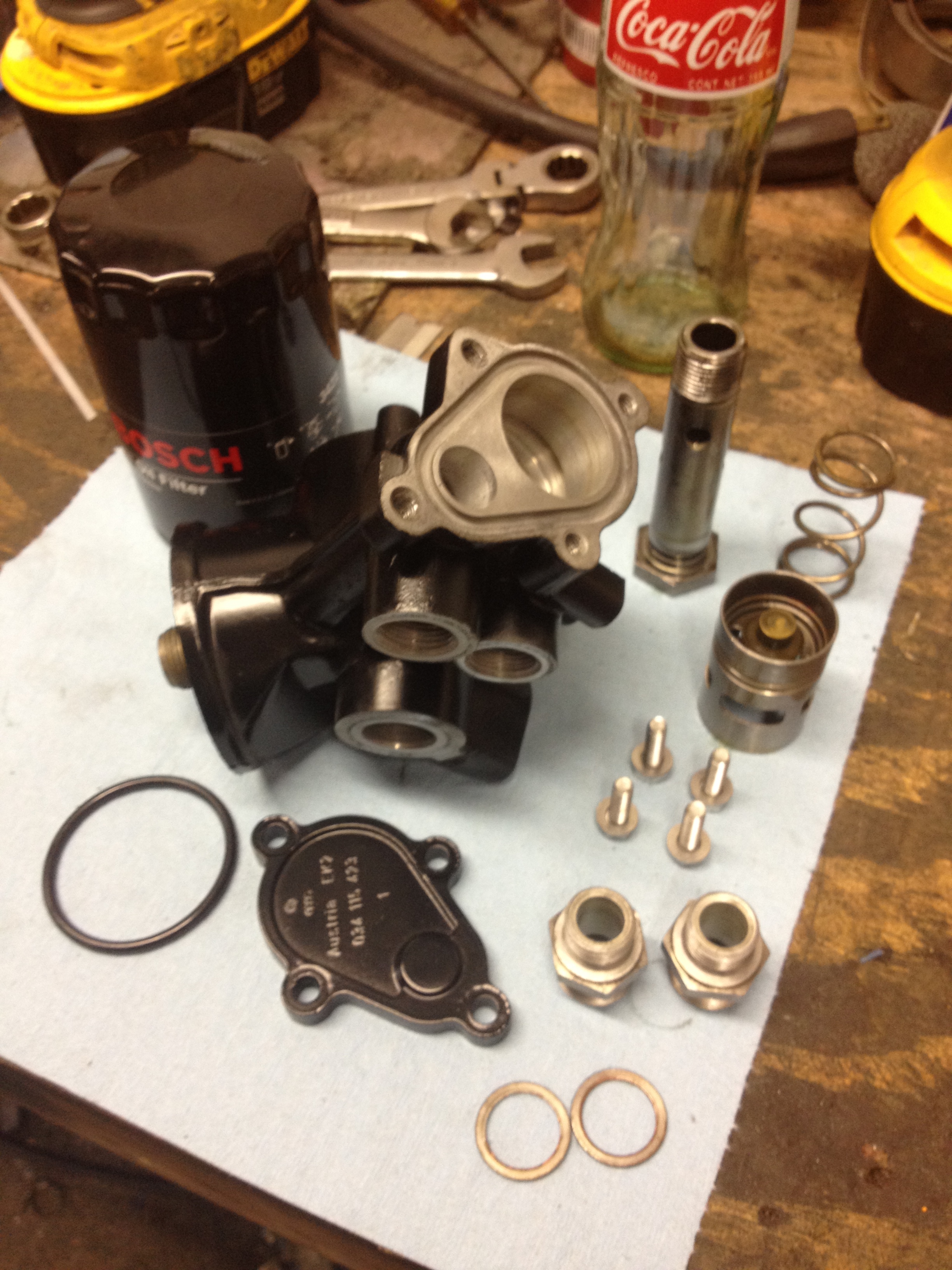

Oil housing has been rebuild and some an fittings added
Sebastian's CQ91' oil housing .jpg (2.36 MiB) Viewed 42287 times
Sebastian's CQ91' oil filter housing restored.jpg (2.4 MiB) Viewed 42287 times

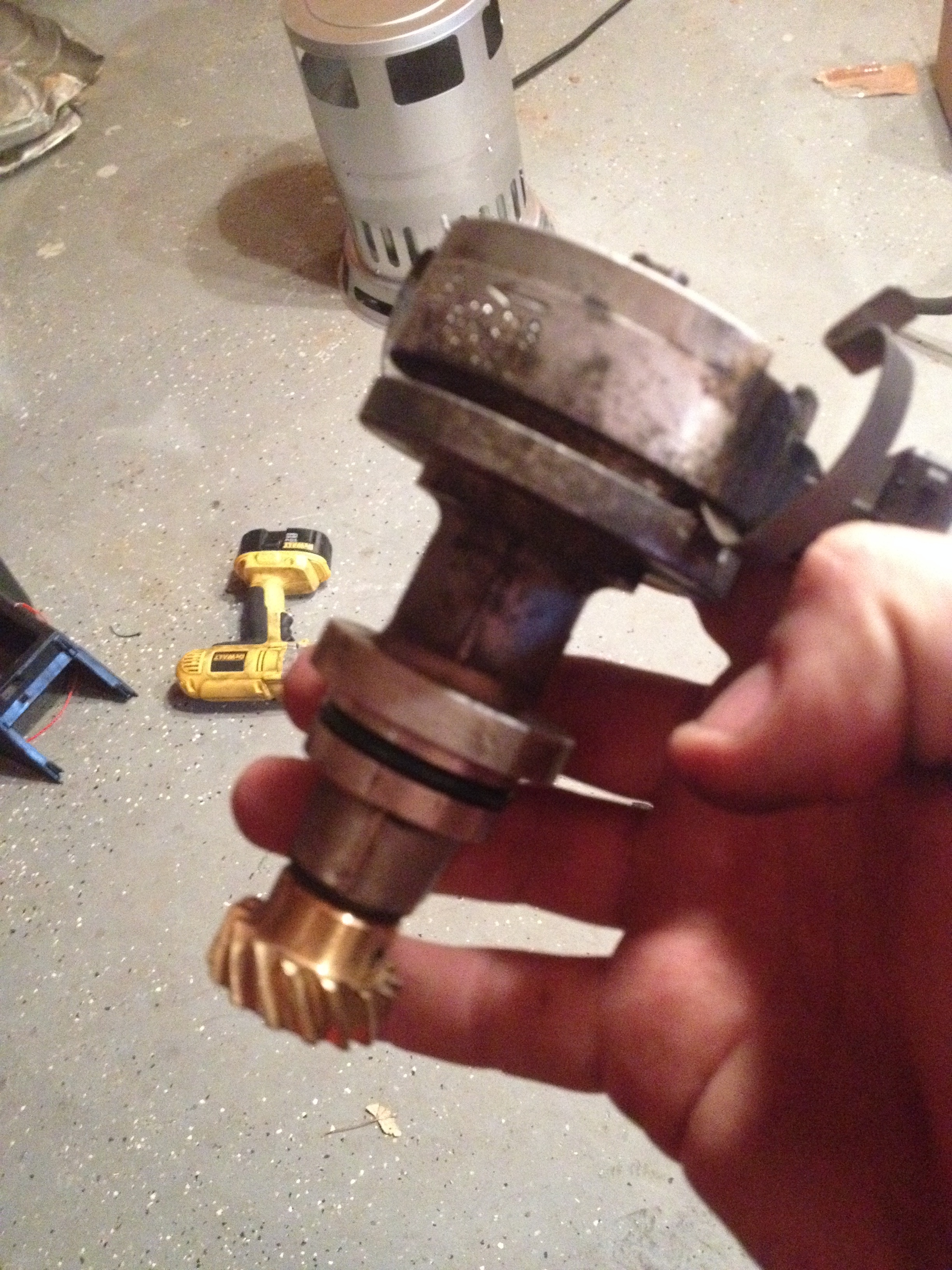

distributor brass gear
Sebastian's CQ91' upgraded gear .jpg (3.19 MiB) Viewed 42287 times

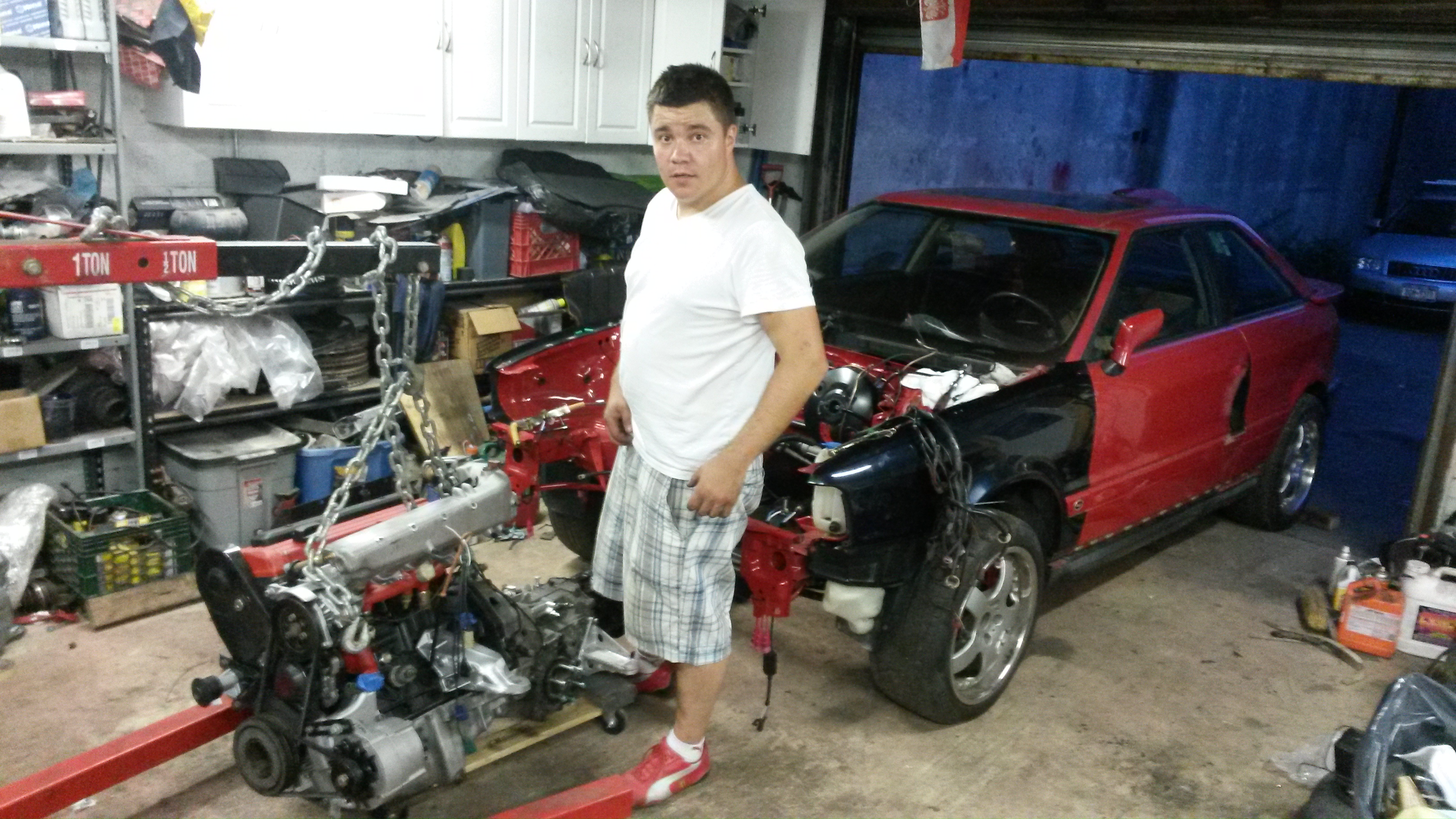

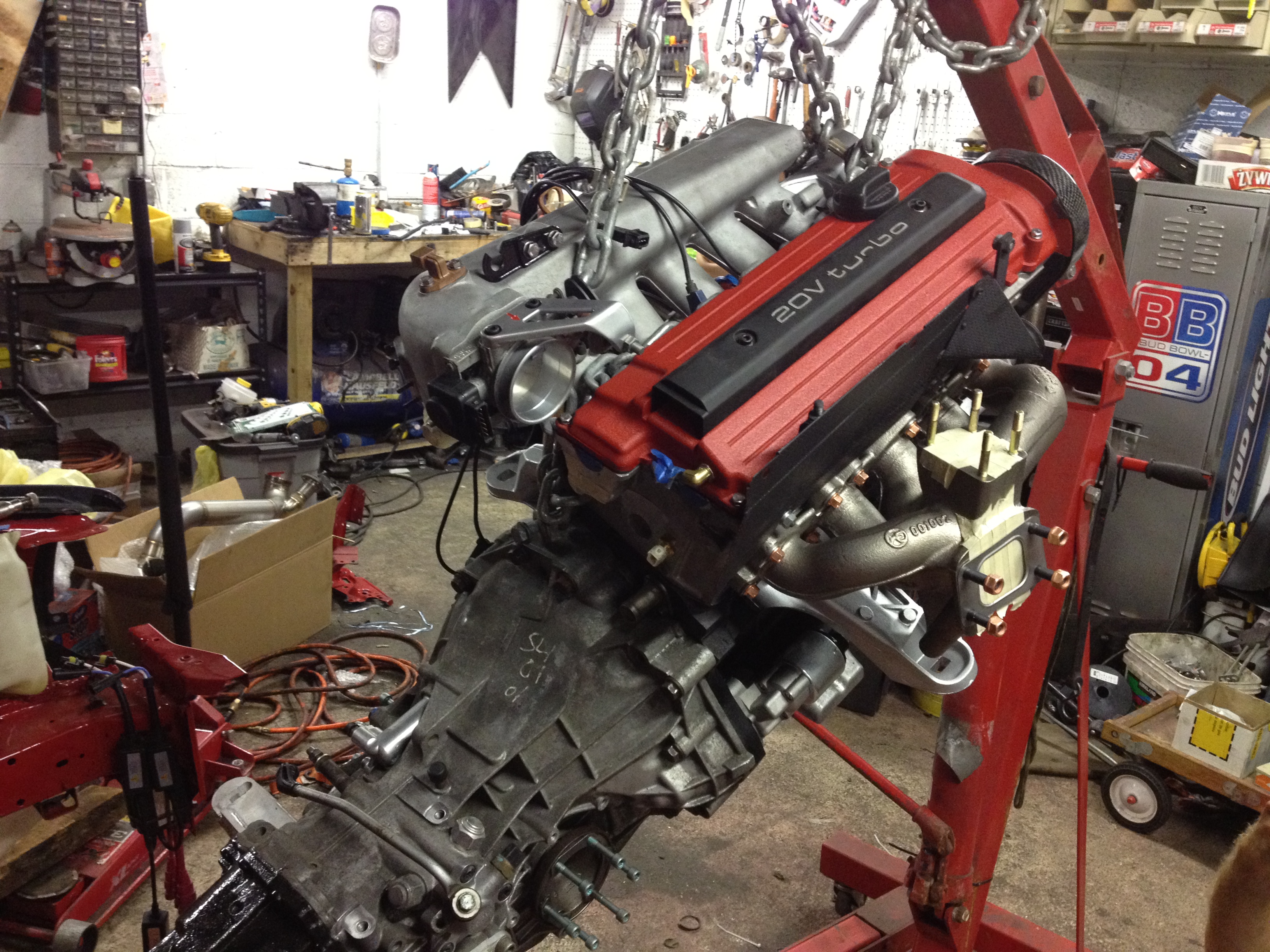

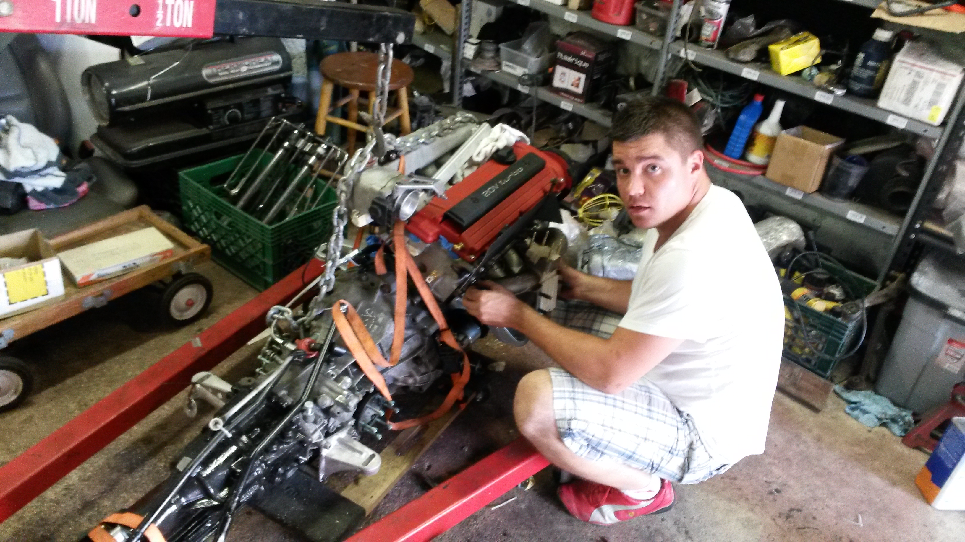

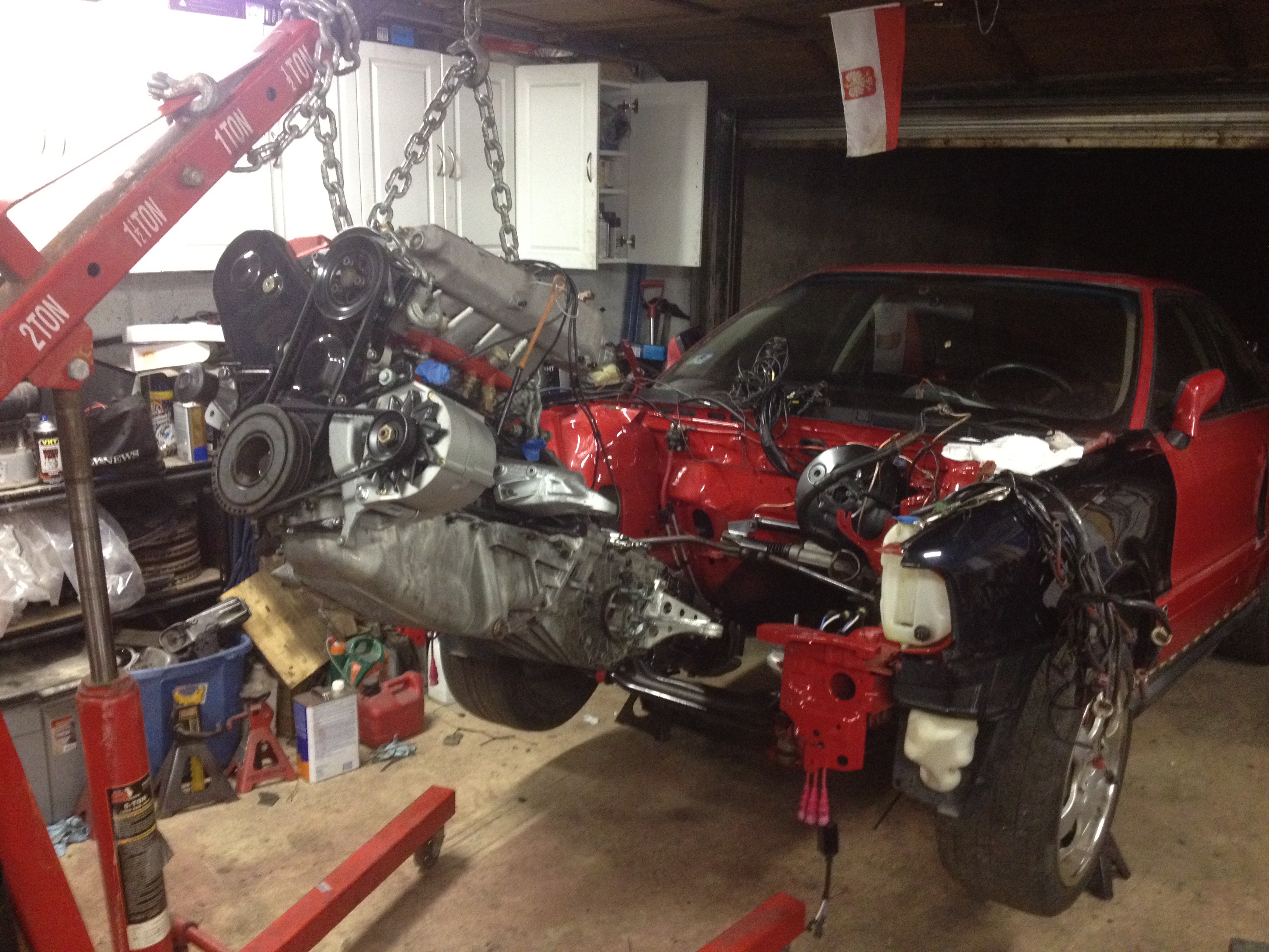

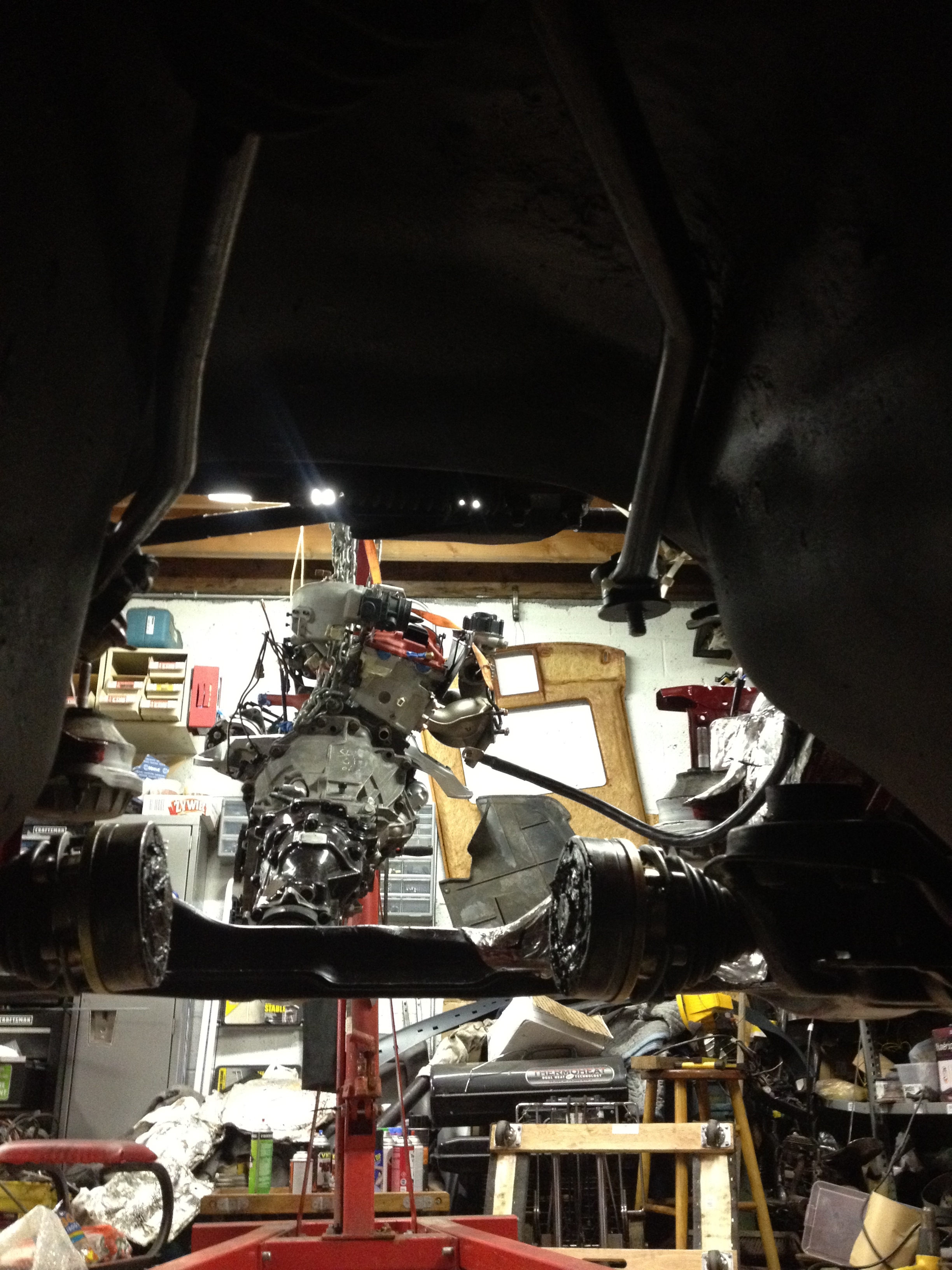

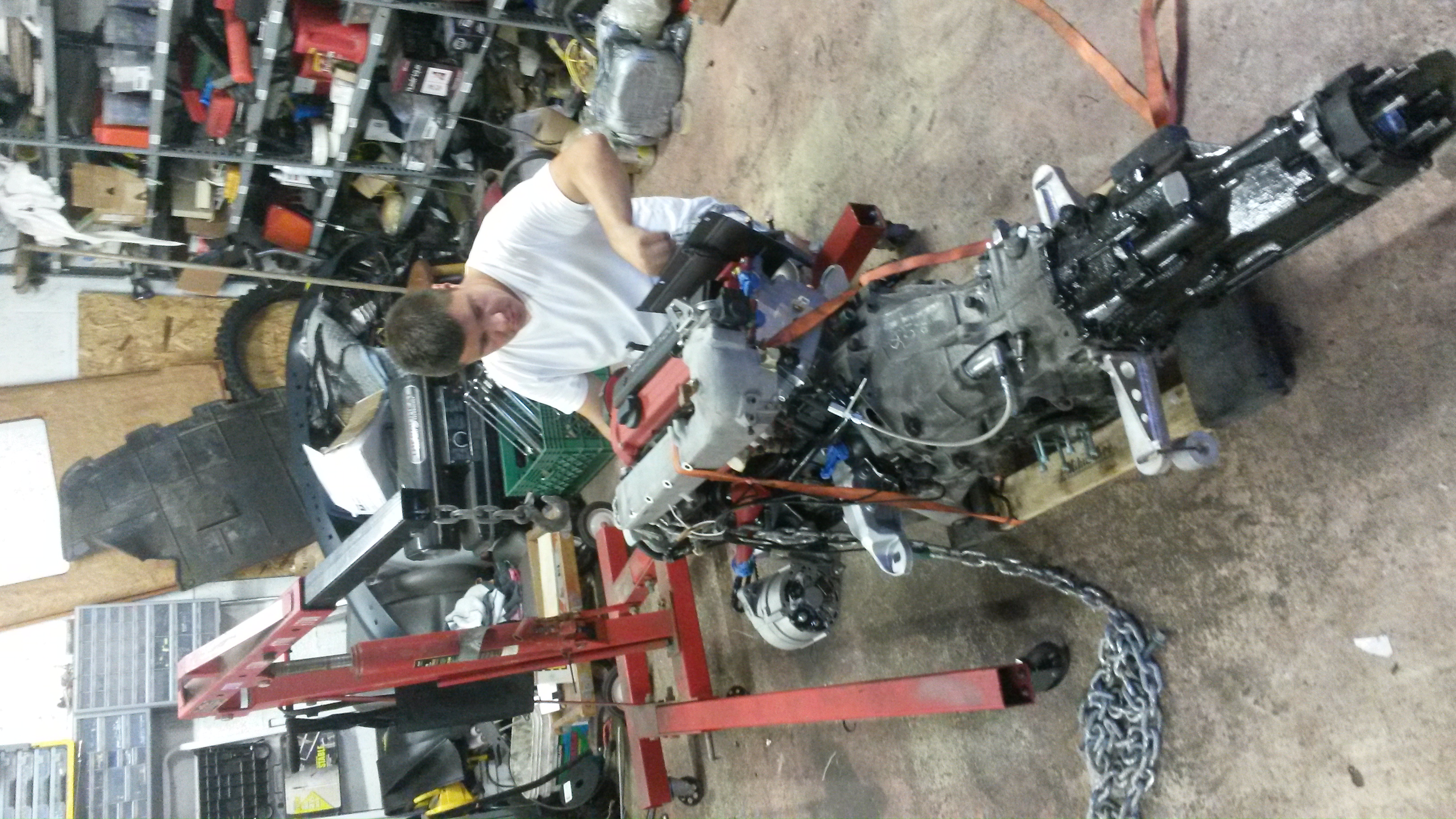

engine drop with hand of a friend Pit
Sebastian's CQ91' Engine 10.jpg (2.29 MiB) Viewed 42282 times
Sebastian's CQ91' Engine 9.jpg (2.01 MiB) Viewed 42282 times
Sebastian's CQ91' Engine 9-1jpg.jpg (2.21 MiB) Viewed 42282 times
Sebastian's CQ91' Engine 8.jpg (1.93 MiB) Viewed 42282 times
Sebastian's CQ91' Engine 7.jpg (2.01 MiB) Viewed 42282 times
- Sebastian -
Zaworek
Posts: 103
Location: New York
Re: Sebastian's 91 Coupe Quattro - 3b swap - Vems - e85

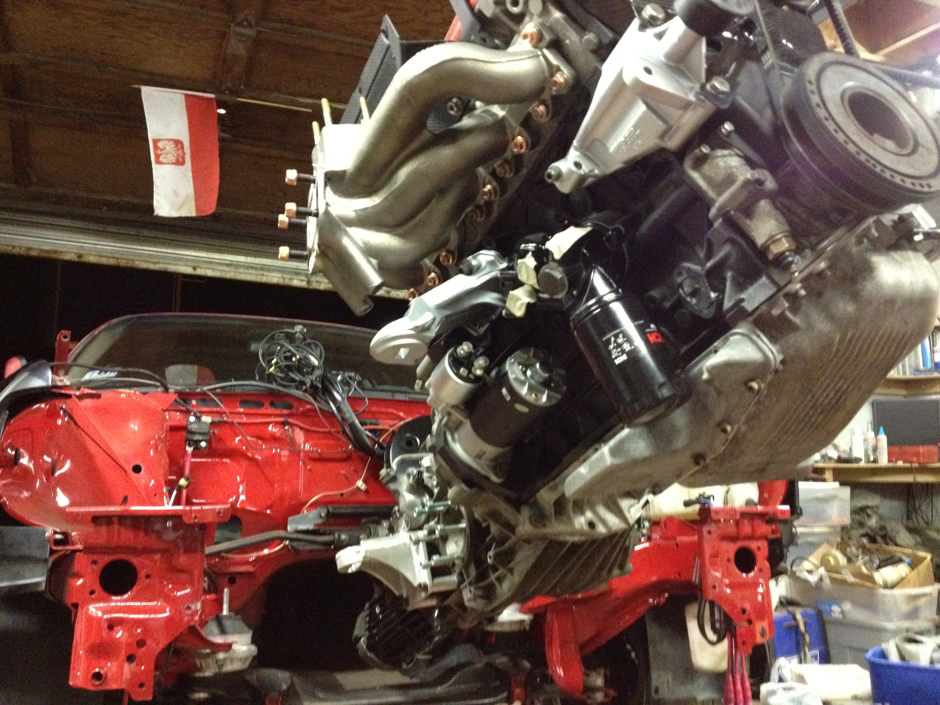

Post by Zaworek »

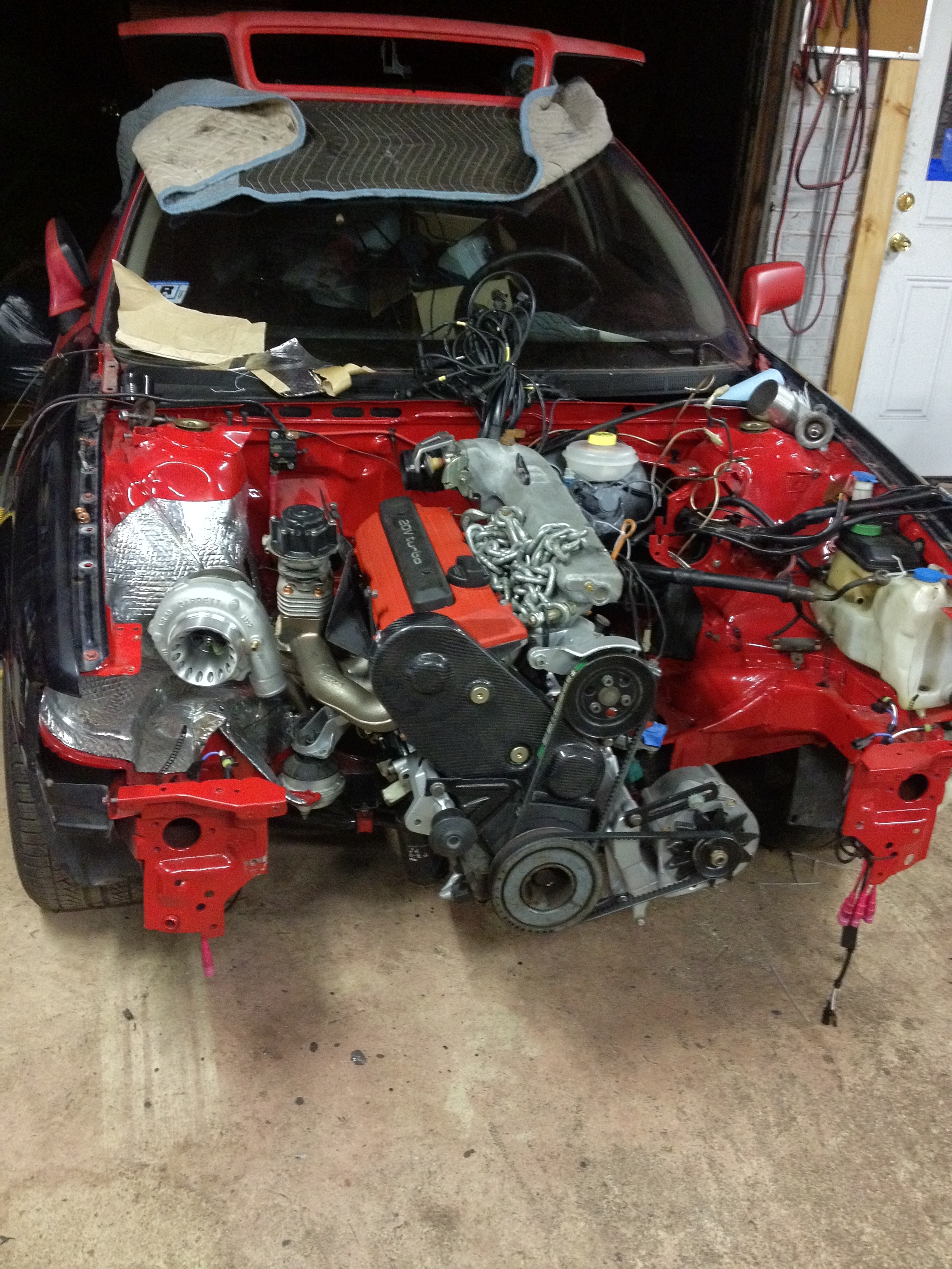

dropped
Sebastian's CQ91' Engine 4.JPG (2.69 MiB) Viewed 42279 times
Sebastian's CQ91' Engine 3.JPG (2.48 MiB) Viewed 42279 times
Sebastian's CQ91' Engine 5.JPG (2.67 MiB) Viewed 42279 times
Sebastian's CQ91' Engine 2-2.jpg (3.27 MiB) Viewed 42279 times
Sebastian's CQ91' Engine 1.jpg (3.11 MiB) Viewed 42279 times

some addition of spark and random photos
Sebastian's CQ91' coils 2.jpg (1.67 MiB) Viewed 42279 times
Sebastian's CQ91' coils 1.jpg (2.14 MiB) Viewed 42279 times

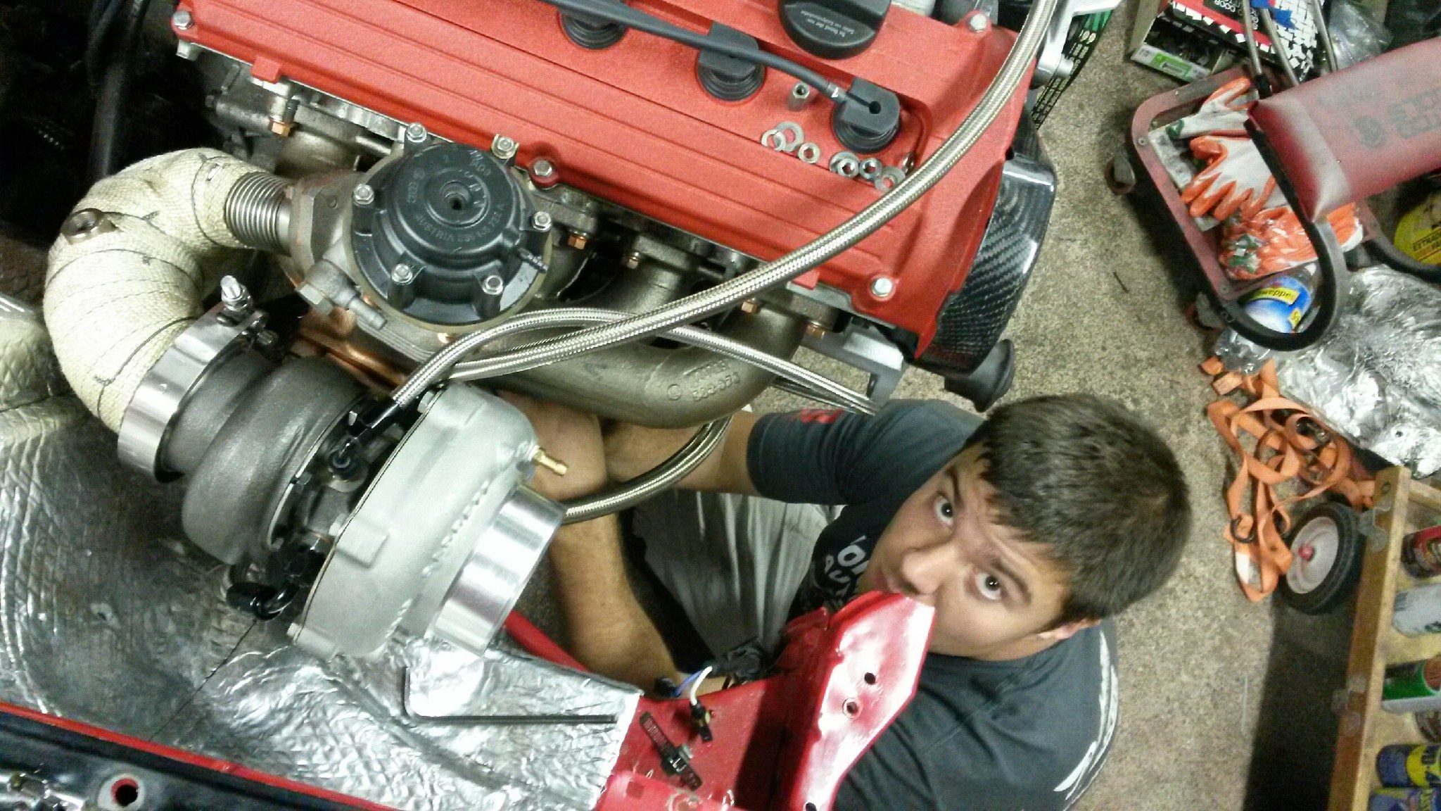

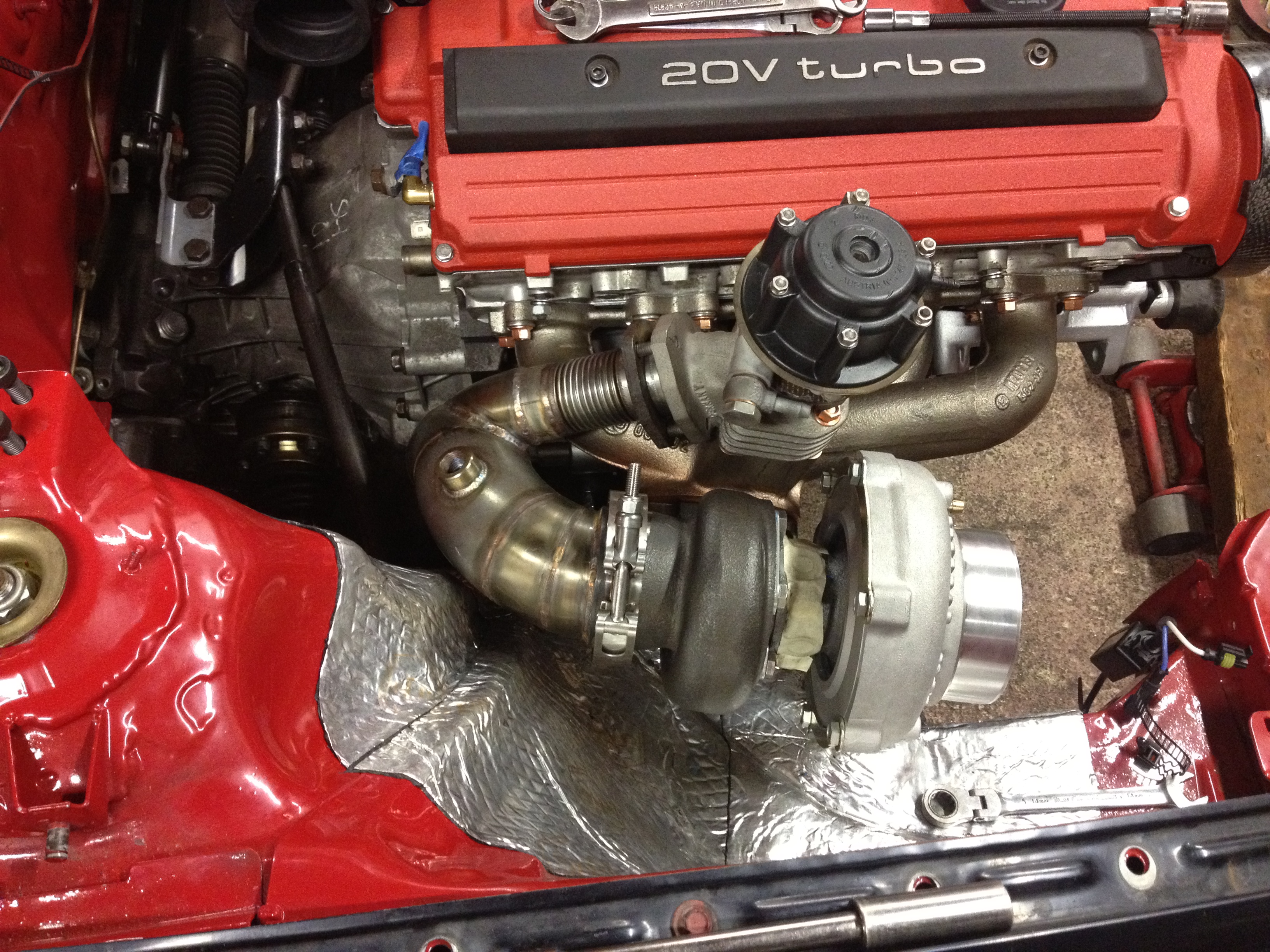

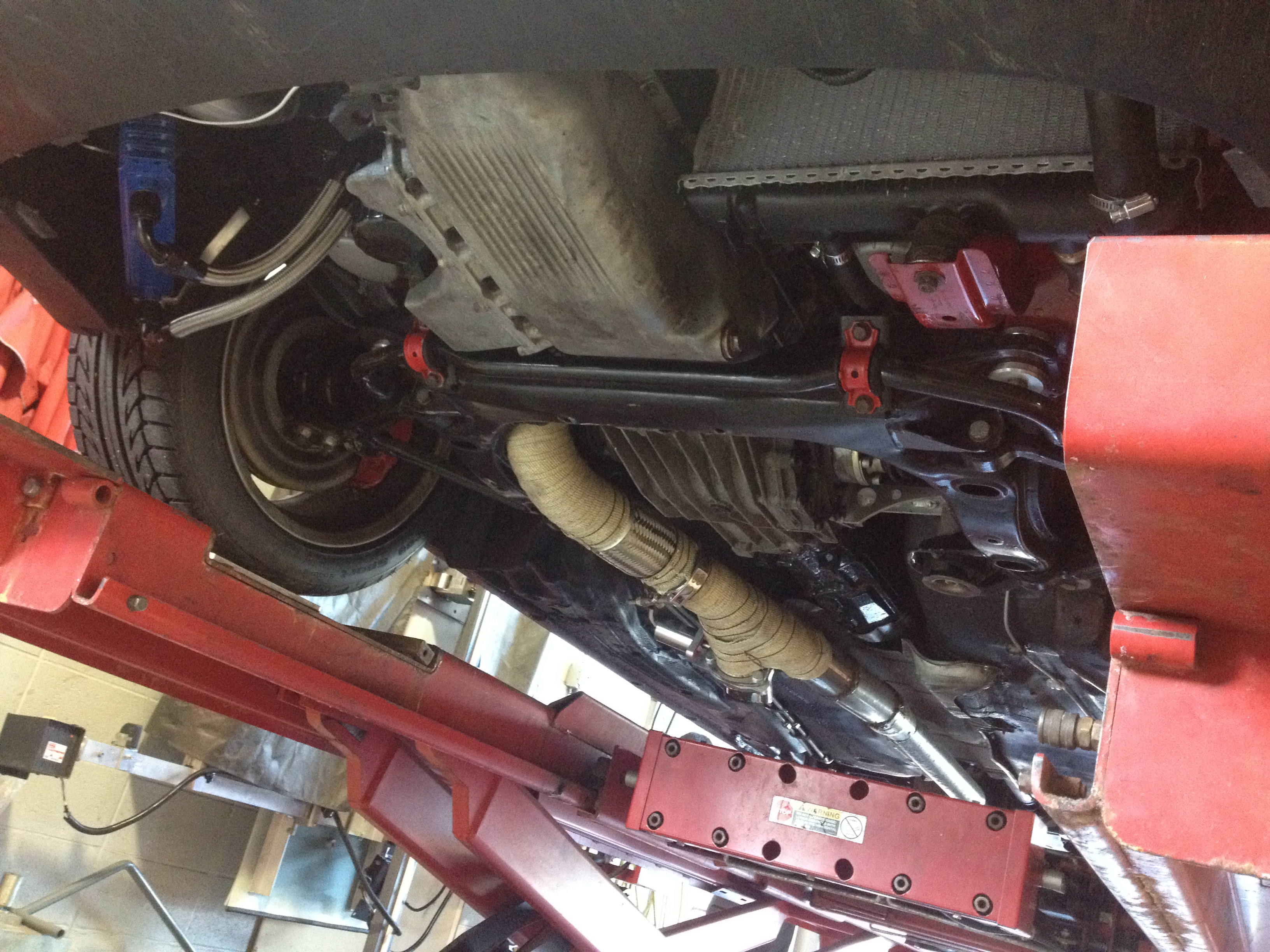

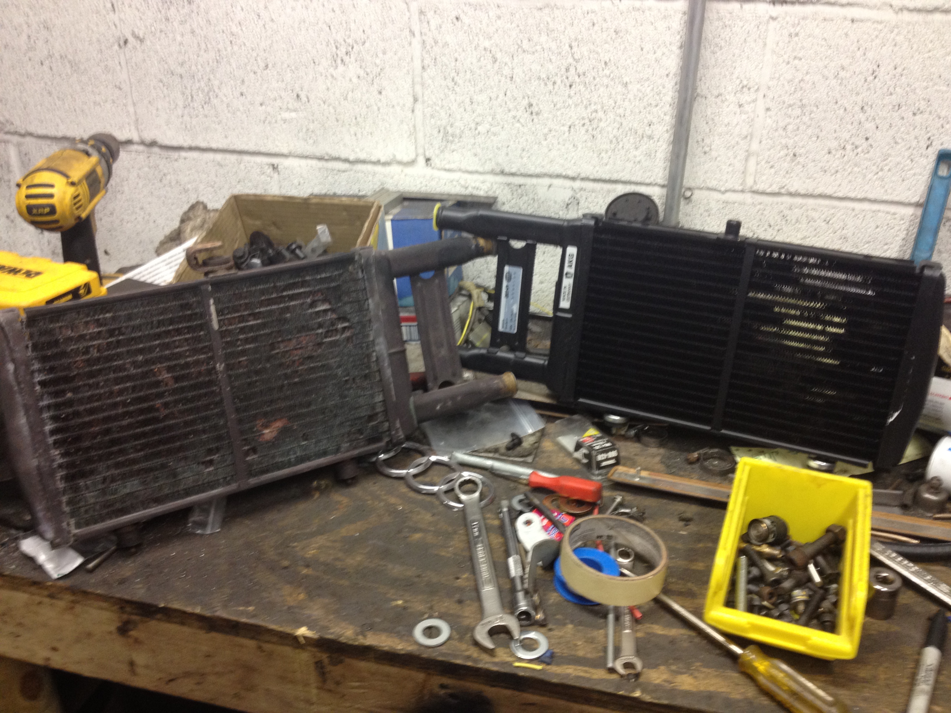

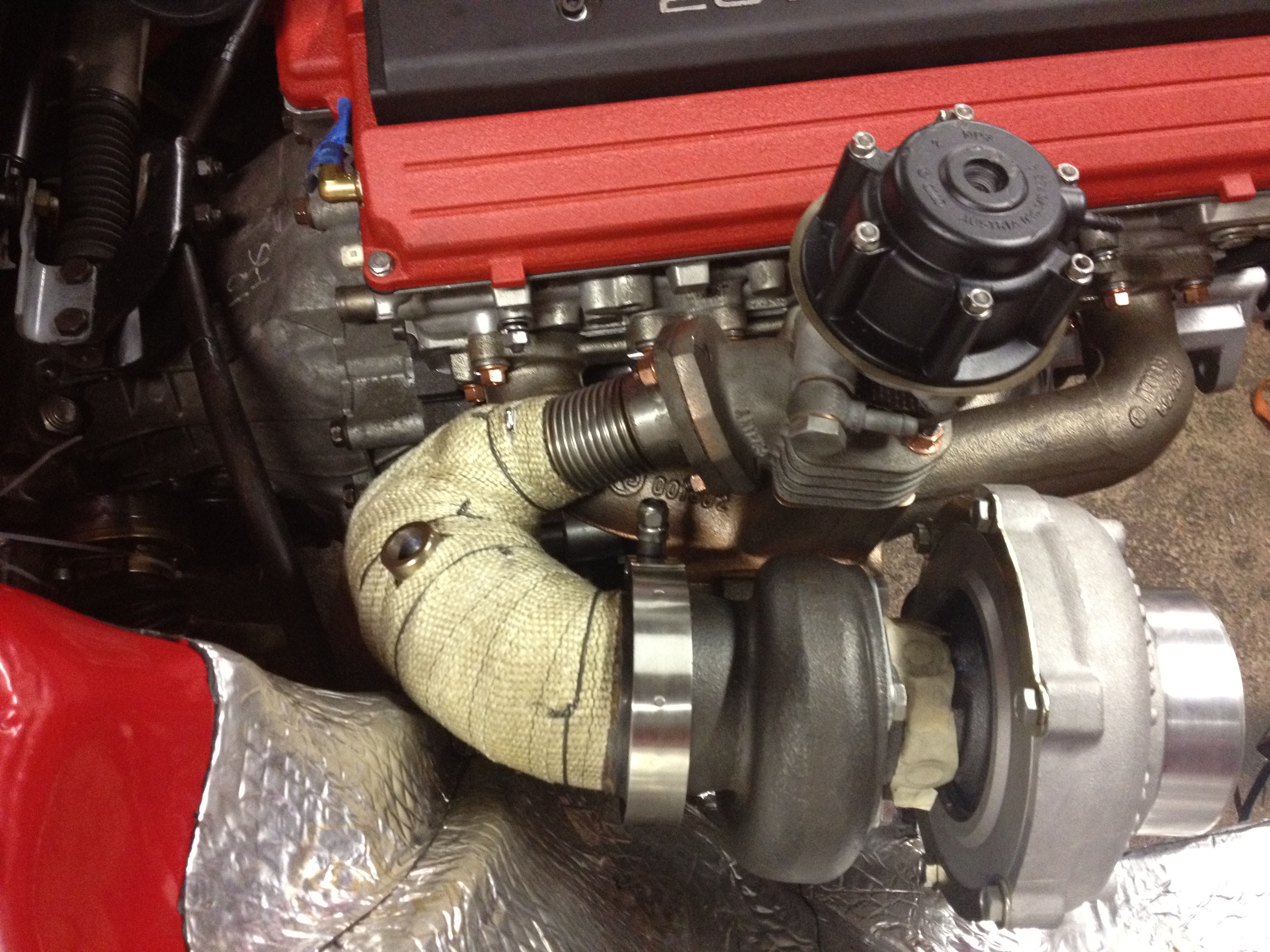

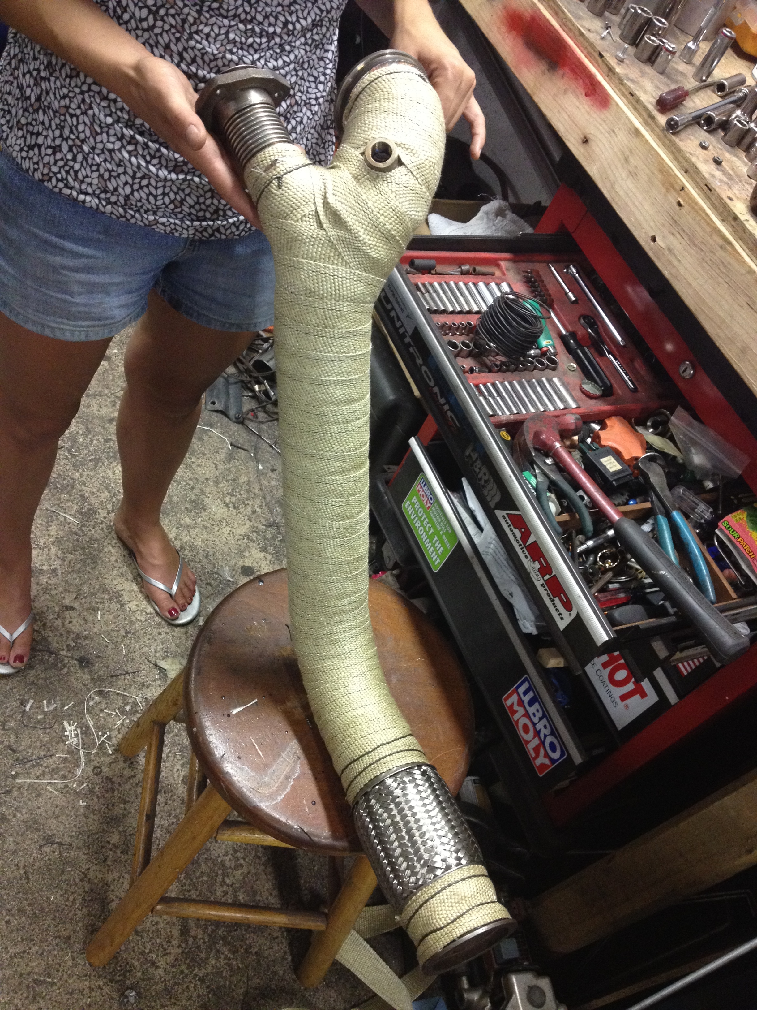

down pipe and radiator
Sebastian's CQ91' down pipe no wrap.JPG (2.89 MiB) Viewed 42274 times
Sebastian's CQ91' downpipe wrapped.jpg (3.32 MiB) Viewed 42274 times
Sebastian's CQ91' downpipe 1.JPG (2.57 MiB) Viewed 42274 times
Sebastian's CQ91' work in progress.JPG (596.73 KiB) Viewed 42274 times
Sebastian's CQ91' aux radiator change.JPG (2.36 MiB) Viewed 42274 times

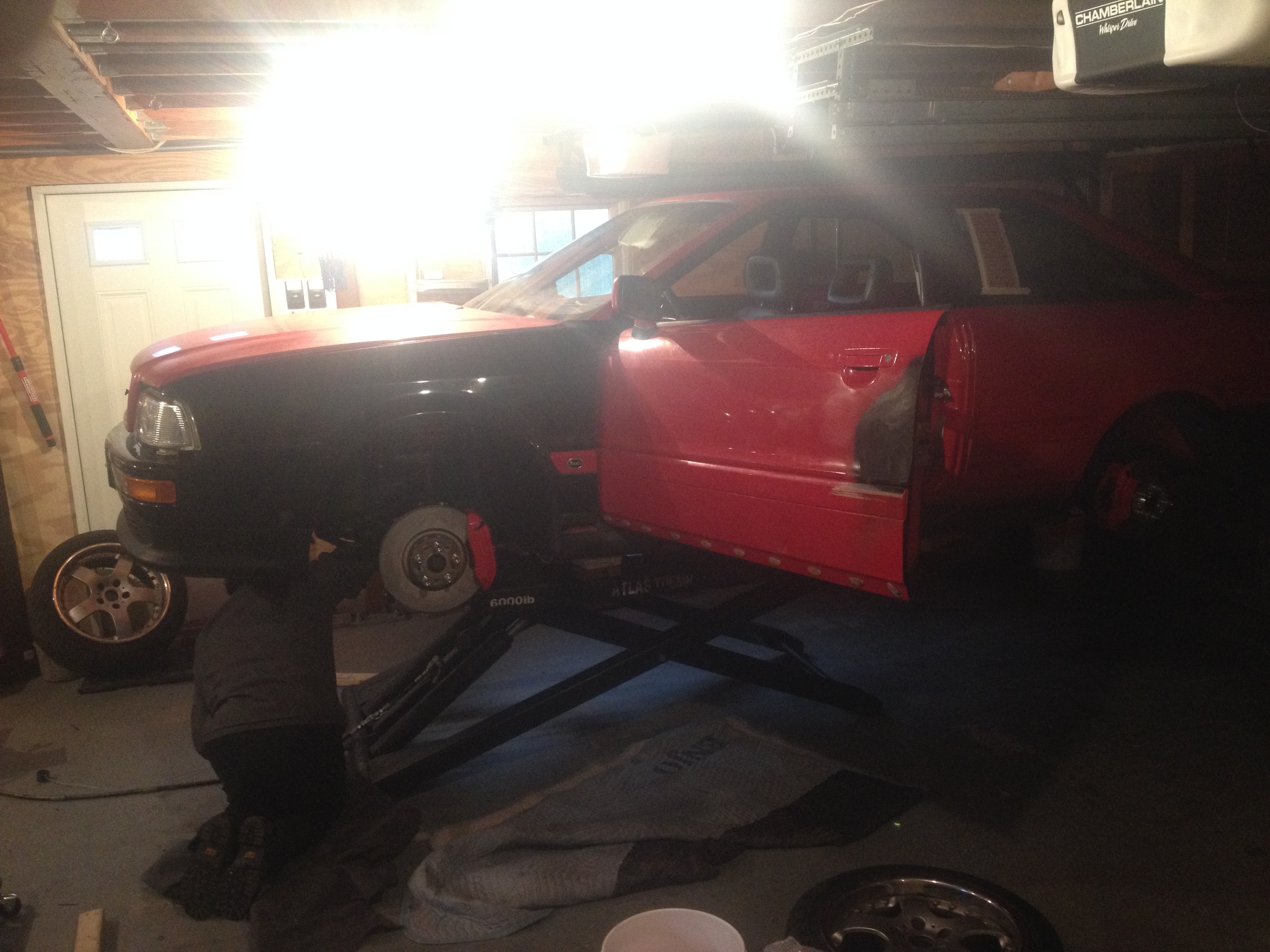

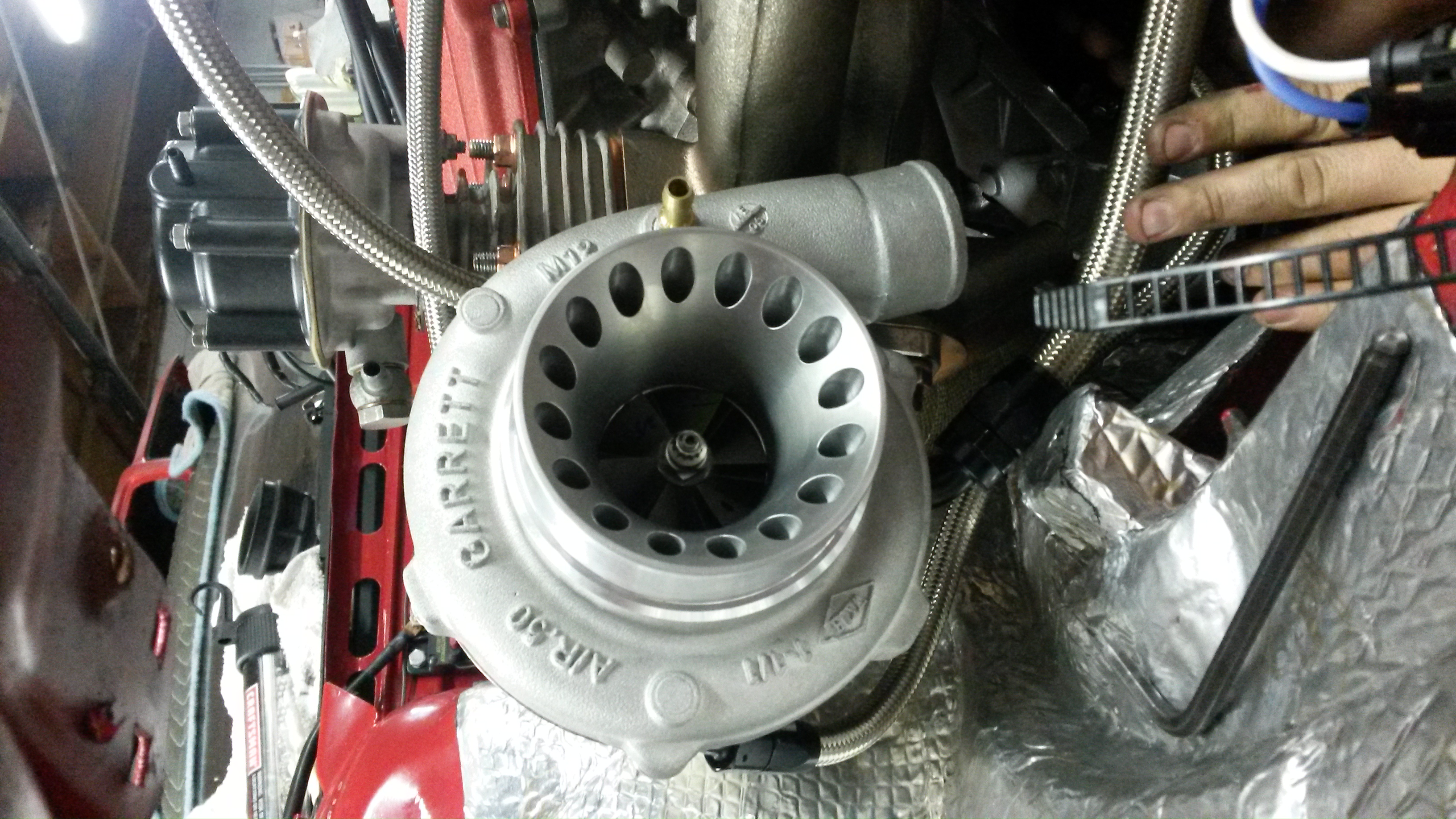

here some random shoots i found in my folders
coupe being pressure tested for any leaks from brake fuild, coolant, clutch etc,
catch can loction
Dear Peter cleaning the whole windshield from over spray with small razor

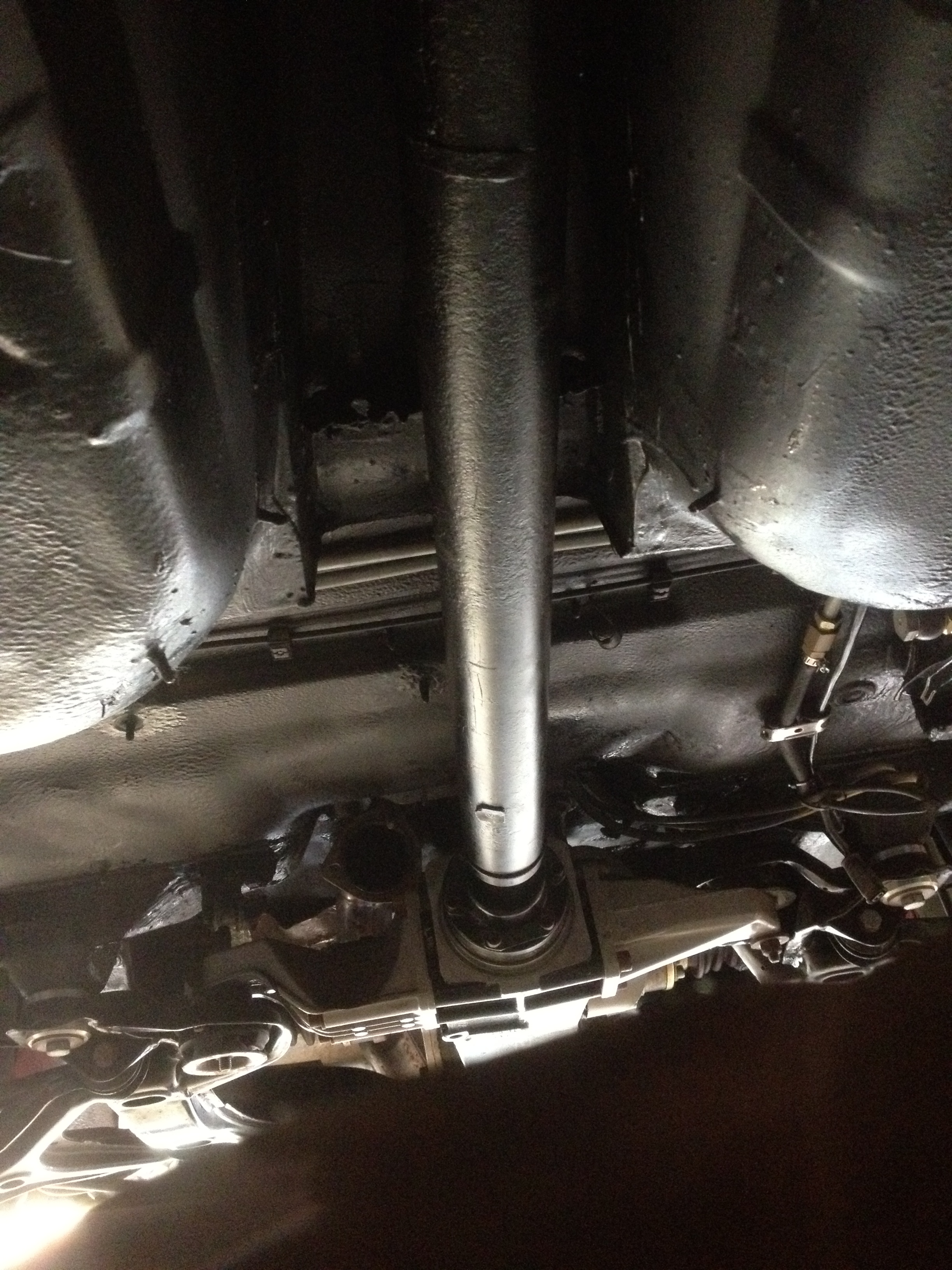

random under shoots

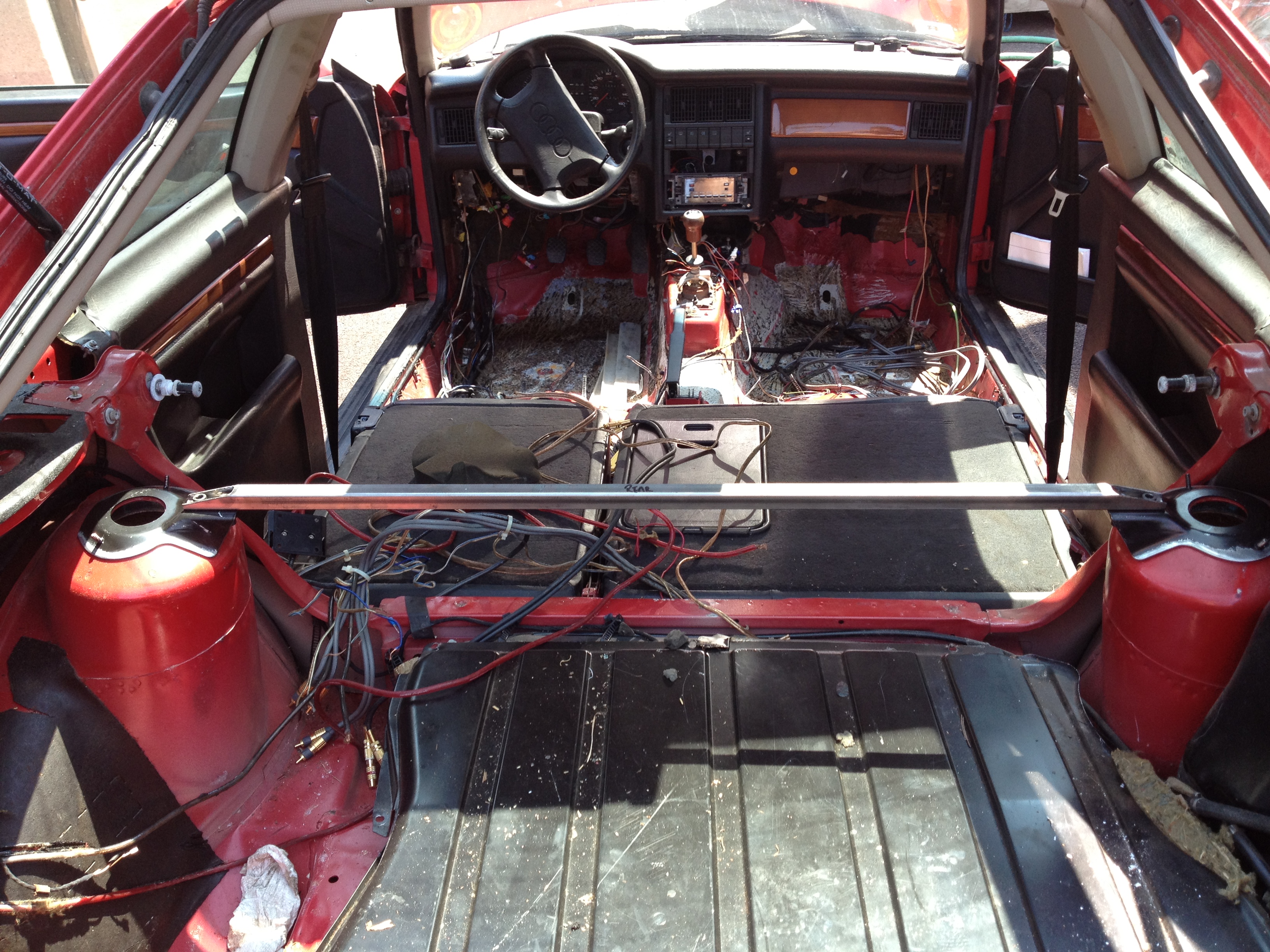

rear strut brace in place

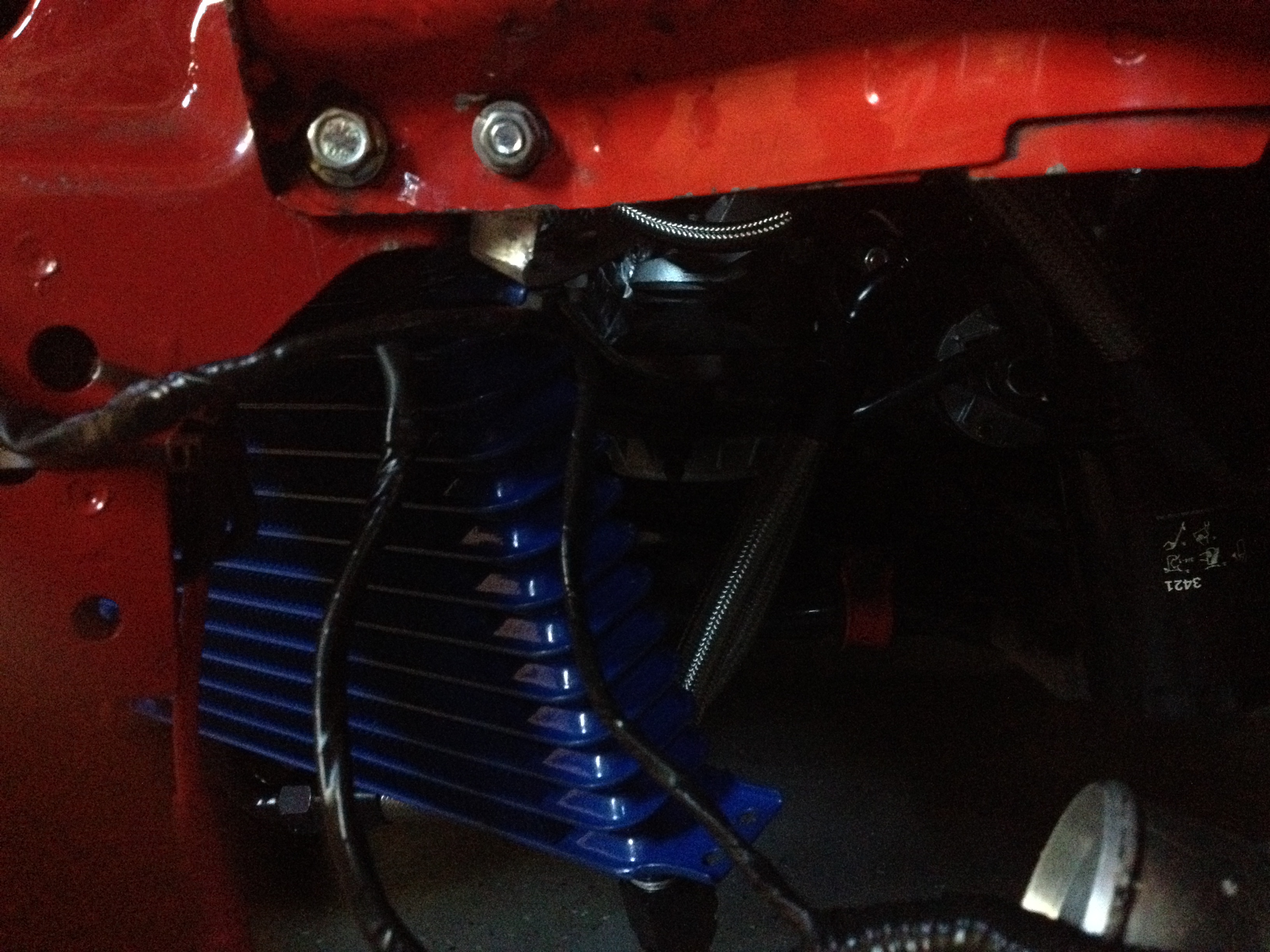

oil cooler installed

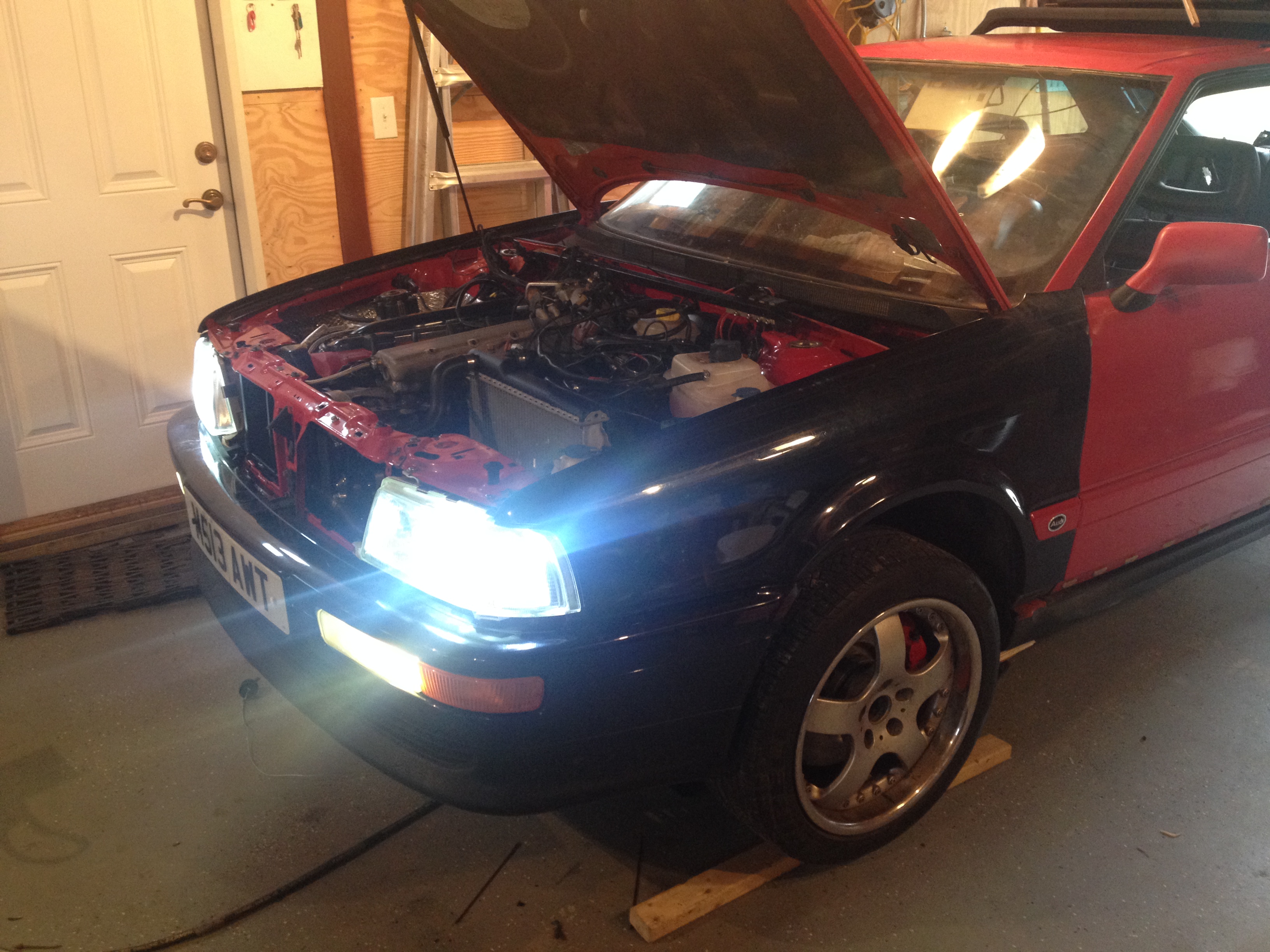

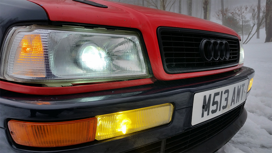

front support installed along with upgraded hid head lights and s2 bumper covering an s2 IC

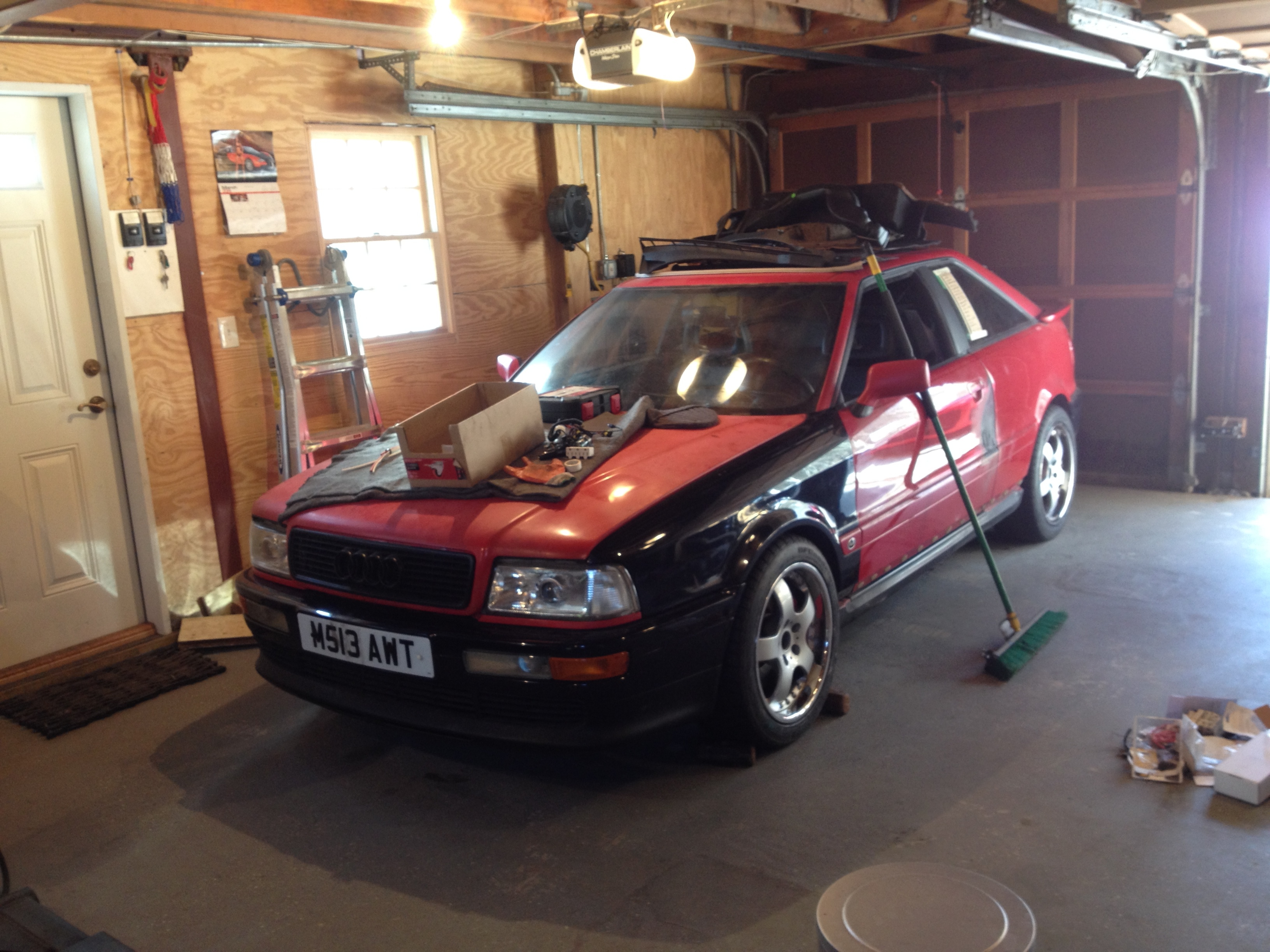

coupe is ready for Marc
Sebastian's CQ91' garage storage.jpg (2.07 MiB) Viewed 42189 times

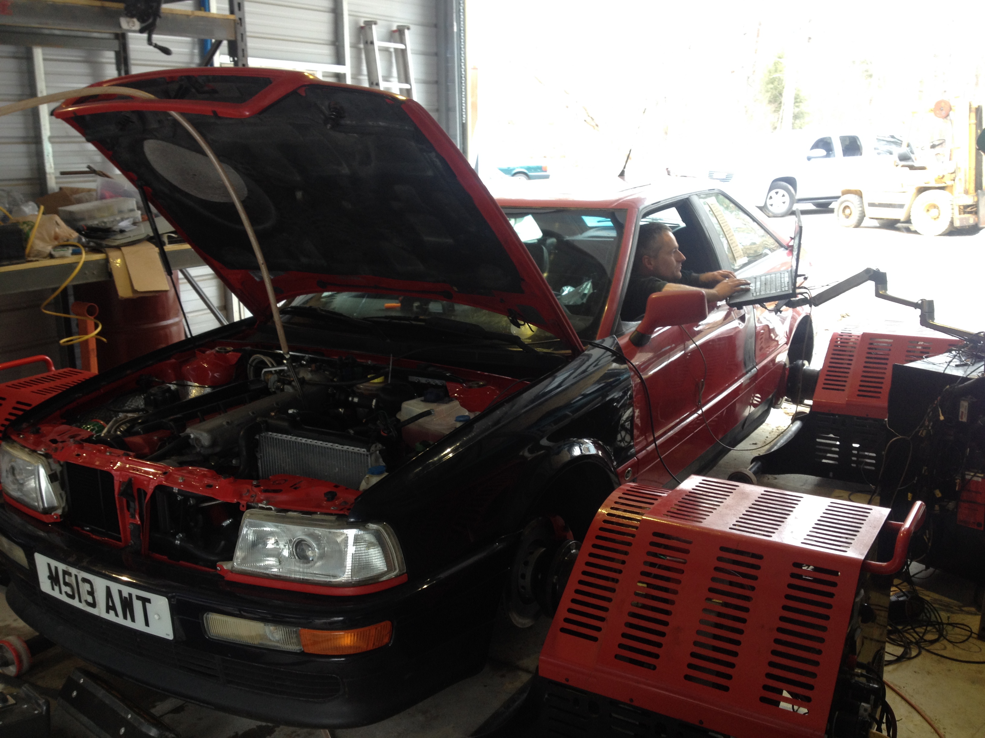

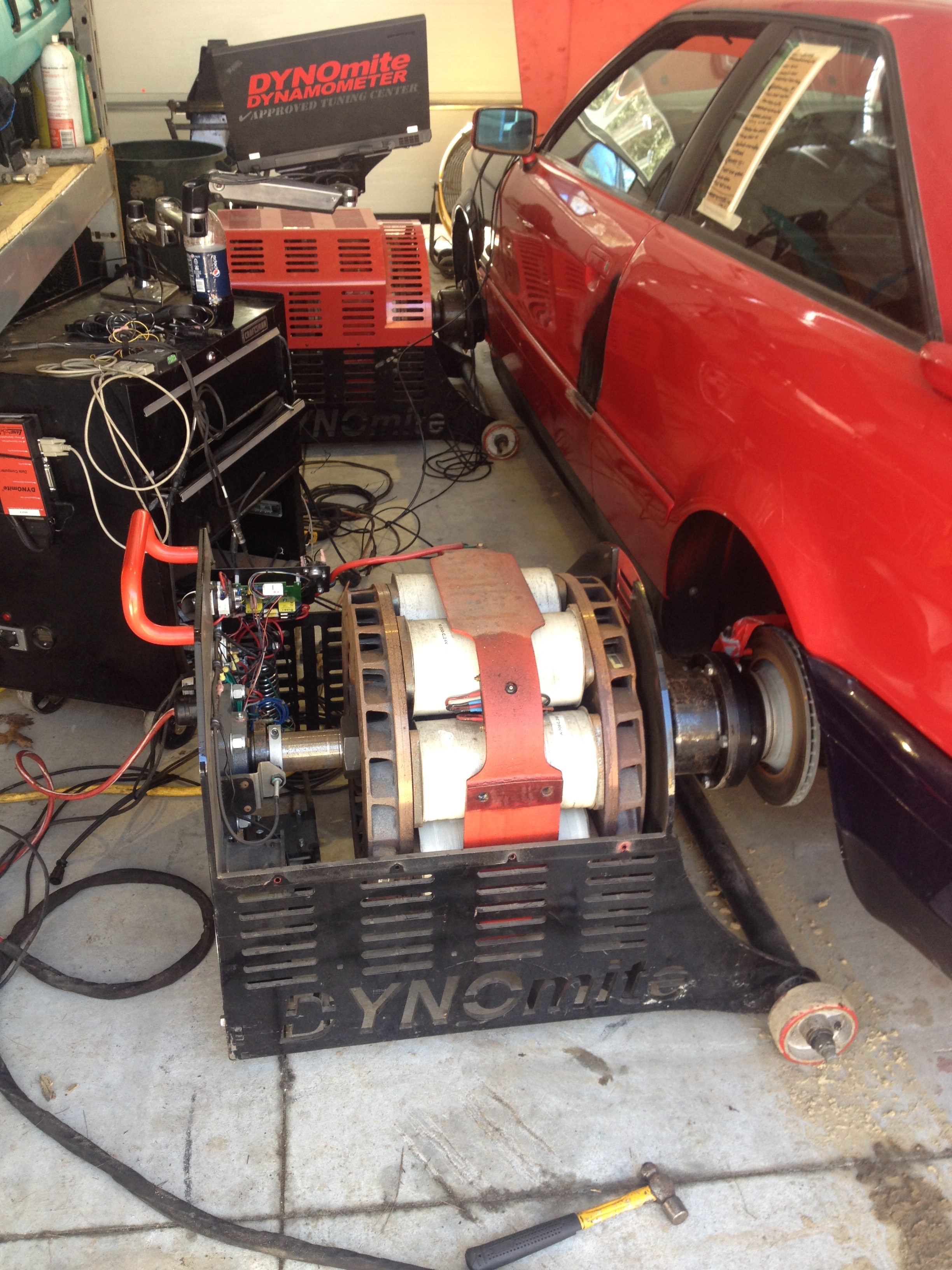

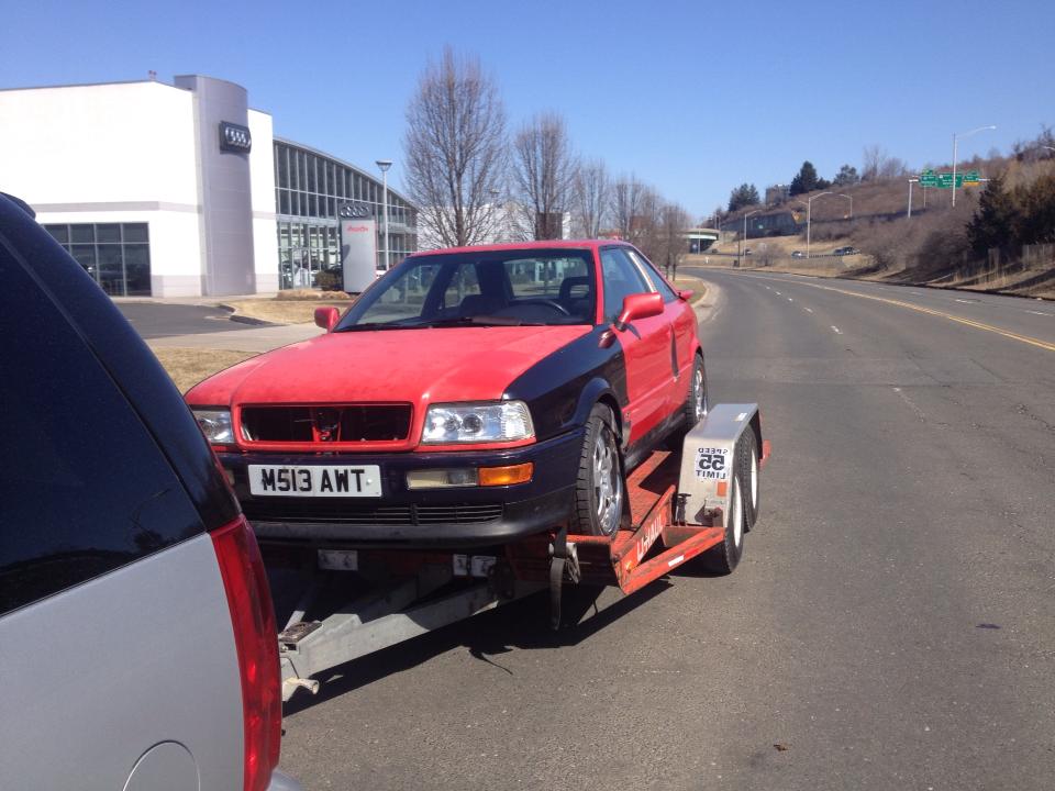

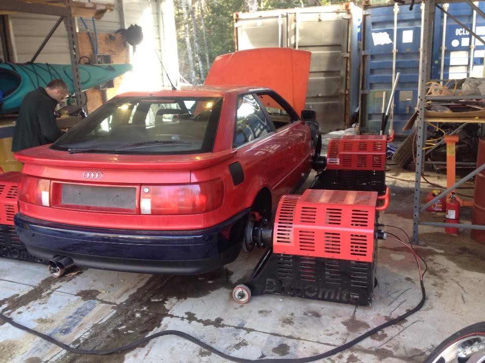

on the way to Marc at EFI Express after getting alignment done
here are some dyno pull and launch control videos
dyno pull 8200 rpm's
http://youtu.be/Gve438Dnjt4
launch control
Sebastian's CQ91' alignment.jpg (81.65 KiB) Viewed 42163 times
Sebastian's CQ91' dyno tuning at Marc's EFI Express.jpg (112.75 KiB) Viewed 42163 times

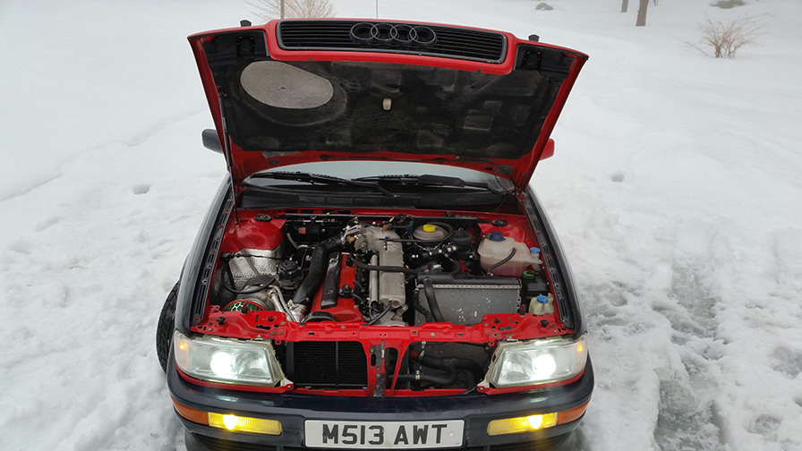

Finally i was able to find some time to take her out to see some snow
