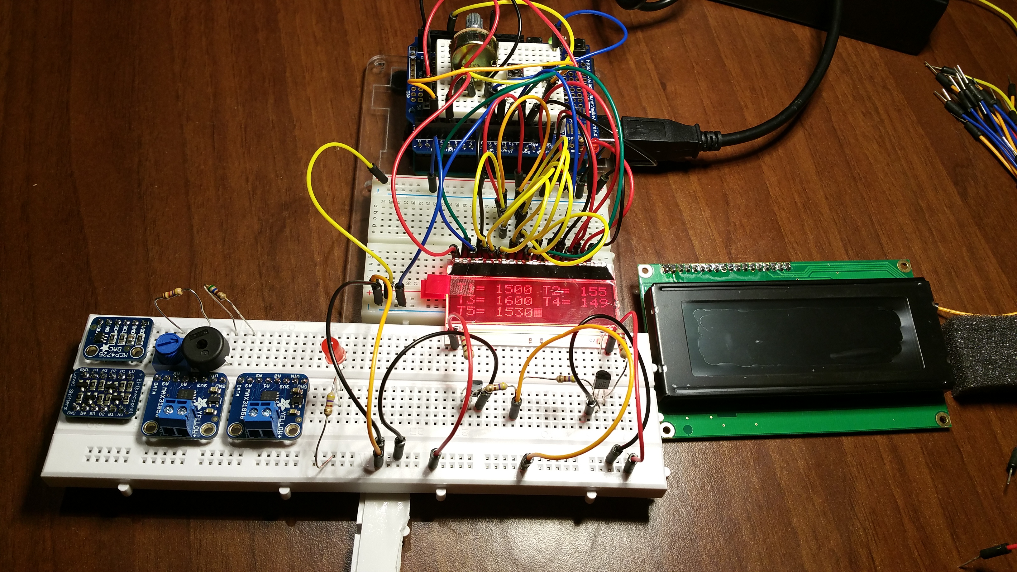

It has taken me a little while to get this thing figured out becuase the documentation is awful, but now I believe I've come up with the smallest possible solution for the display while still retaining all the features I want.
More than 6 channels will require the 4 line screen or will require switching the display between two sets of sensors periodically.
This screen will require some kind of small board behind it just for an interface to a connector, and for mounting, but the package will still be waaaaay smaller than a normal 4 line LCD.
Now I need to denounce the buttons used for menus and settings and add the ability to save settings into memory.
Re: 5 Channel Thermocouple Gauge/Amp w Analog Out & More
Oops, I just realized the temperatures are getting cut off in the picture haha. Too much spacing.
