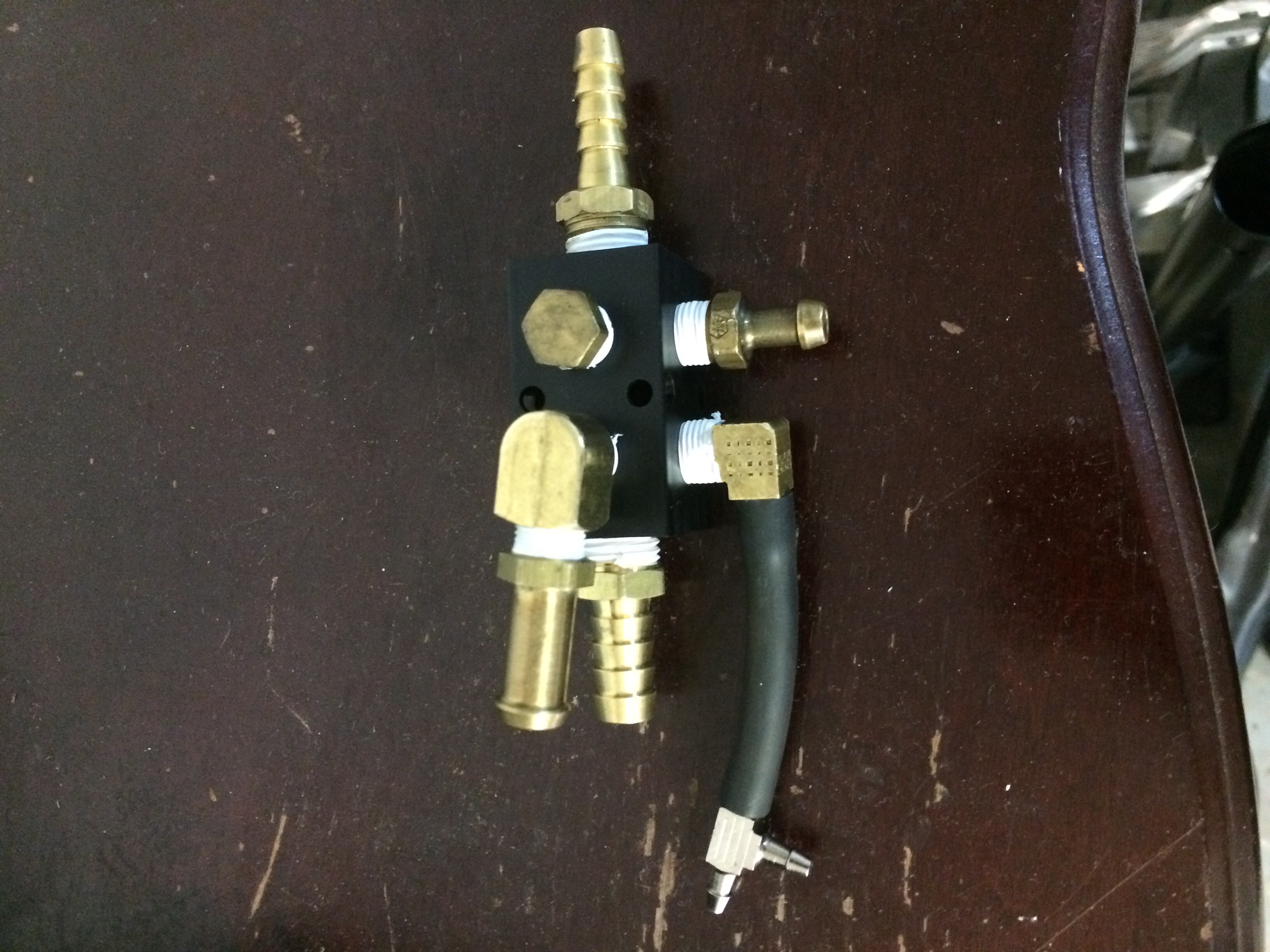

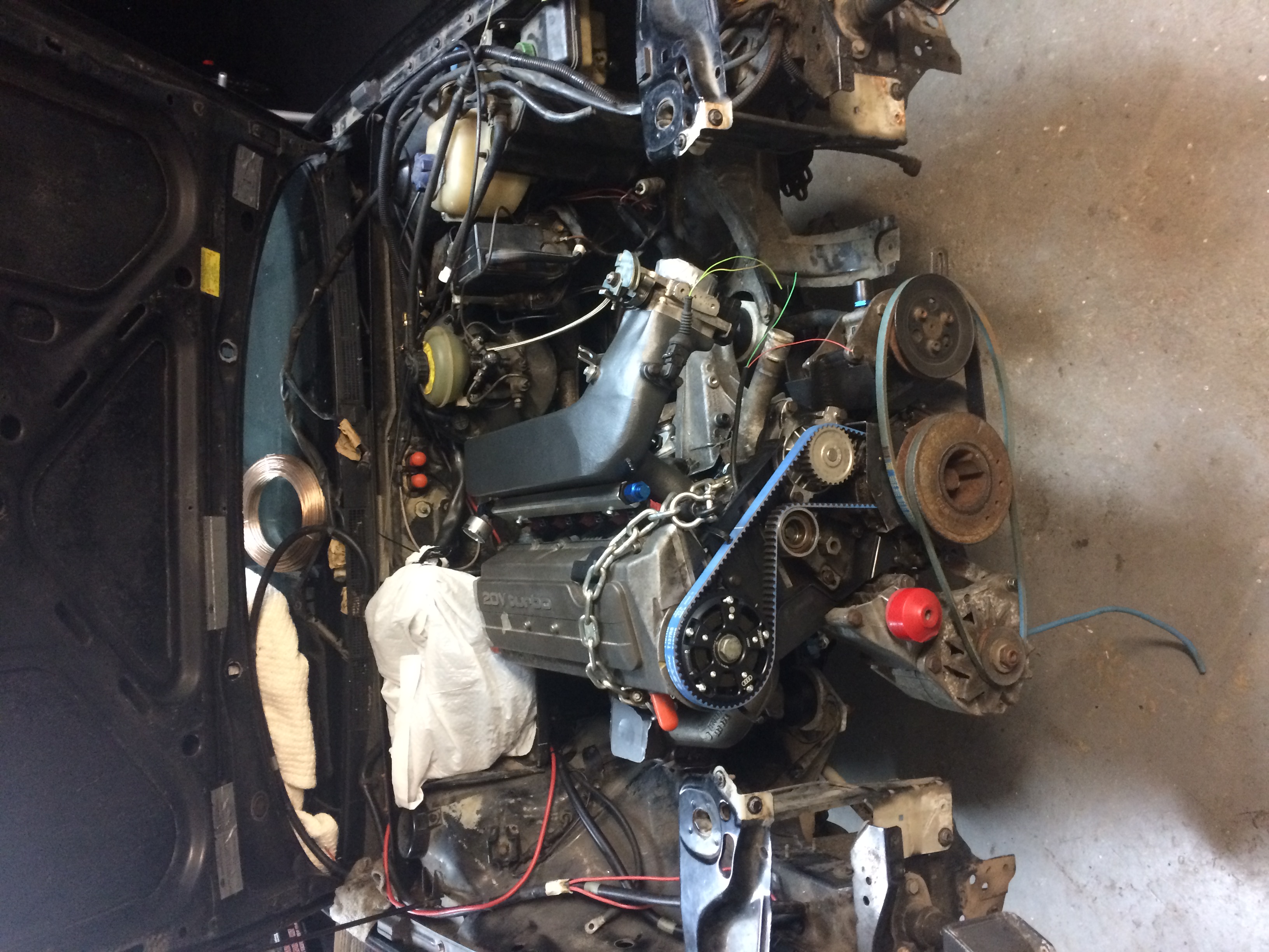

Well. It’s on
And the vacuum manifold

Well shes going back together

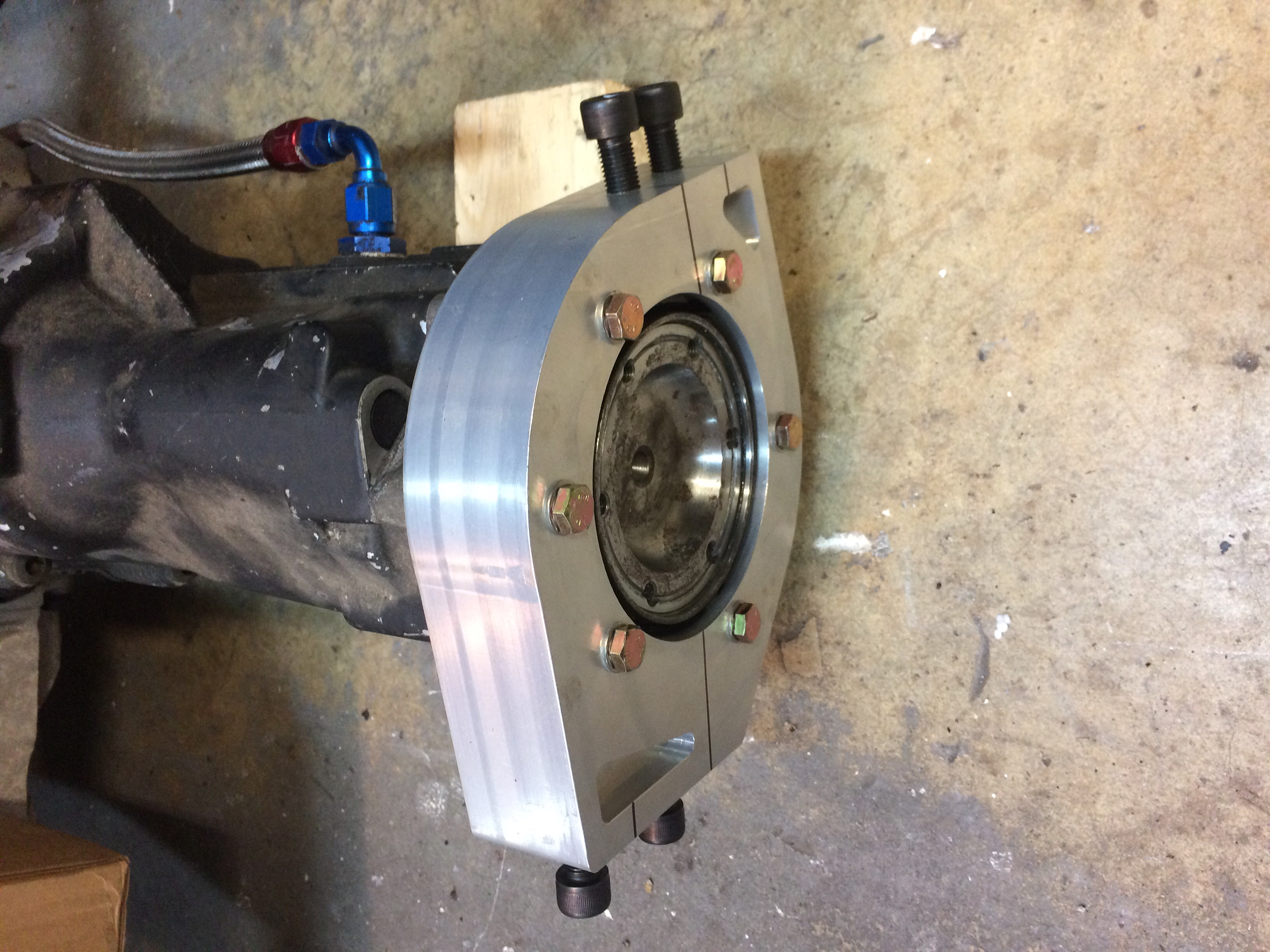

rennenmsports
Posts: 165
Re: Andy's 91' 80q
Post by rennenmsports »
Well. I regret to say that this 01E mount from AK Motorsports does not fit this car at all. It's geometry is off to the point that it will not go up into the trans tunnel with out banging in the tunnel from underneath the car. They told me that I have to fabricate and reinforce the tunnel. After that no more response. I don’t see me beating the tunnel in and then cutting and welding it back together. If it fit into place so I can mark it then fabricate that’s one thing. :huh:
the german
Posts: 720
Location: Bellevue, WA
Re: Andy's 91' 80q
Post by the german »
On the website they do say that it is not a bolt-on and requires fabrication on the chassis side to make it work, but that message is somewhat understated in the description. You may need to cut a slice out of the tunnel, bolt the trans in place using the forward mounts, then fabricate the replacement tunnel section w/ mounting points for the AK rear mounting plate. HTH
Kirk
1990 ABZ CQ
1990 lifted CQ
2005 S4 6MT
rennenmsports
Posts: 165
Re: Andy's 91' 80q
Yes. I agree. I’m going to save it for a later date. It bolts to my 01E just fine so I can make it work. I thought it fit better then I anticipated. I’m trying to get it to run without making it a full race car. But I have a good feeling it’s going to be sooner then later. I never seen anything like that mount before so I thought I’d give it a whirl.

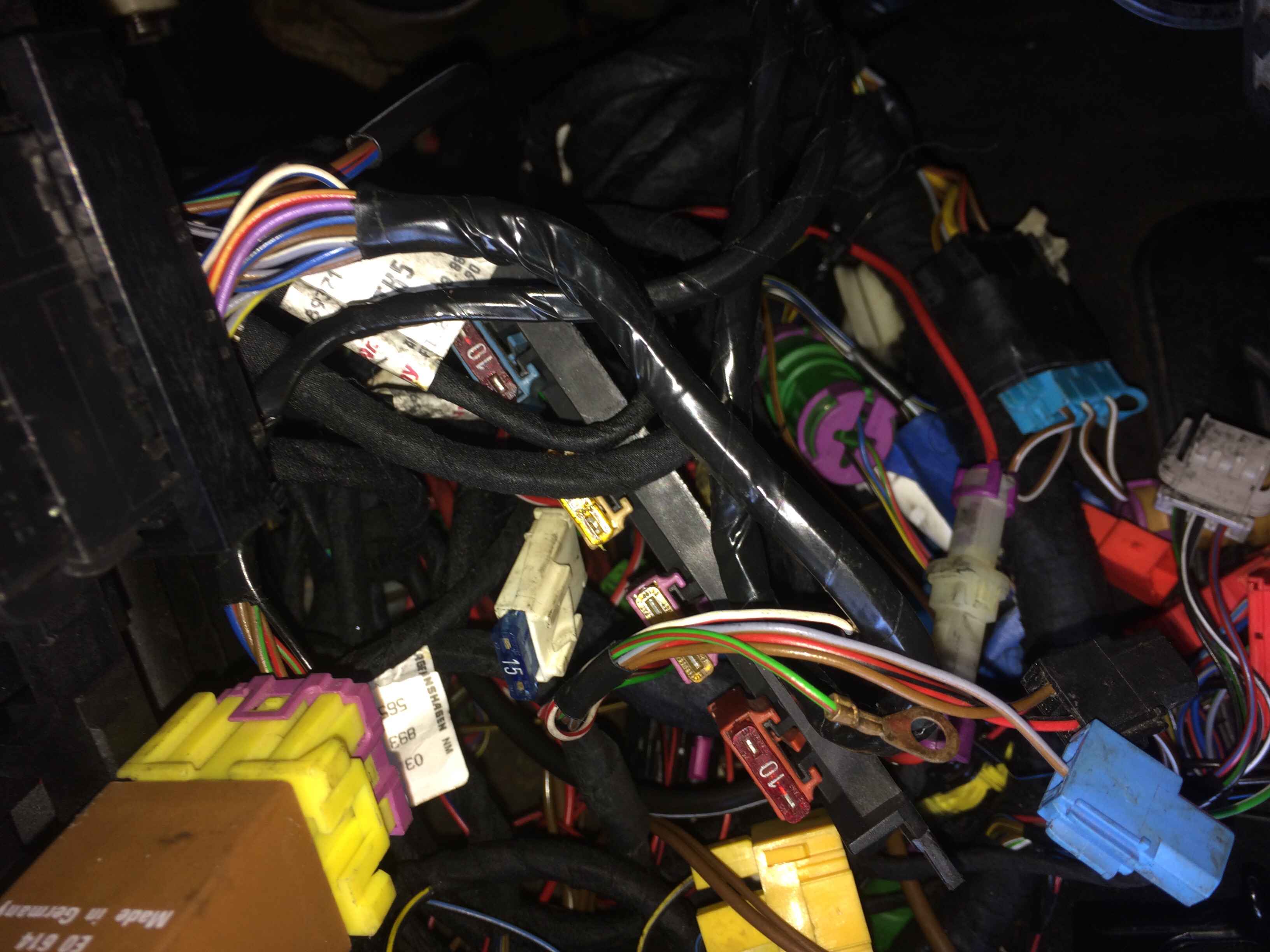

V8q battery cables and junction box r going in
Last edited by rennenmsports on Wed Feb 07, 2018 4:52 pm, edited 2 times in total.
rennenmsports
Posts: 165
Re: Andy's 91' 80q
Took a little convincing but.....

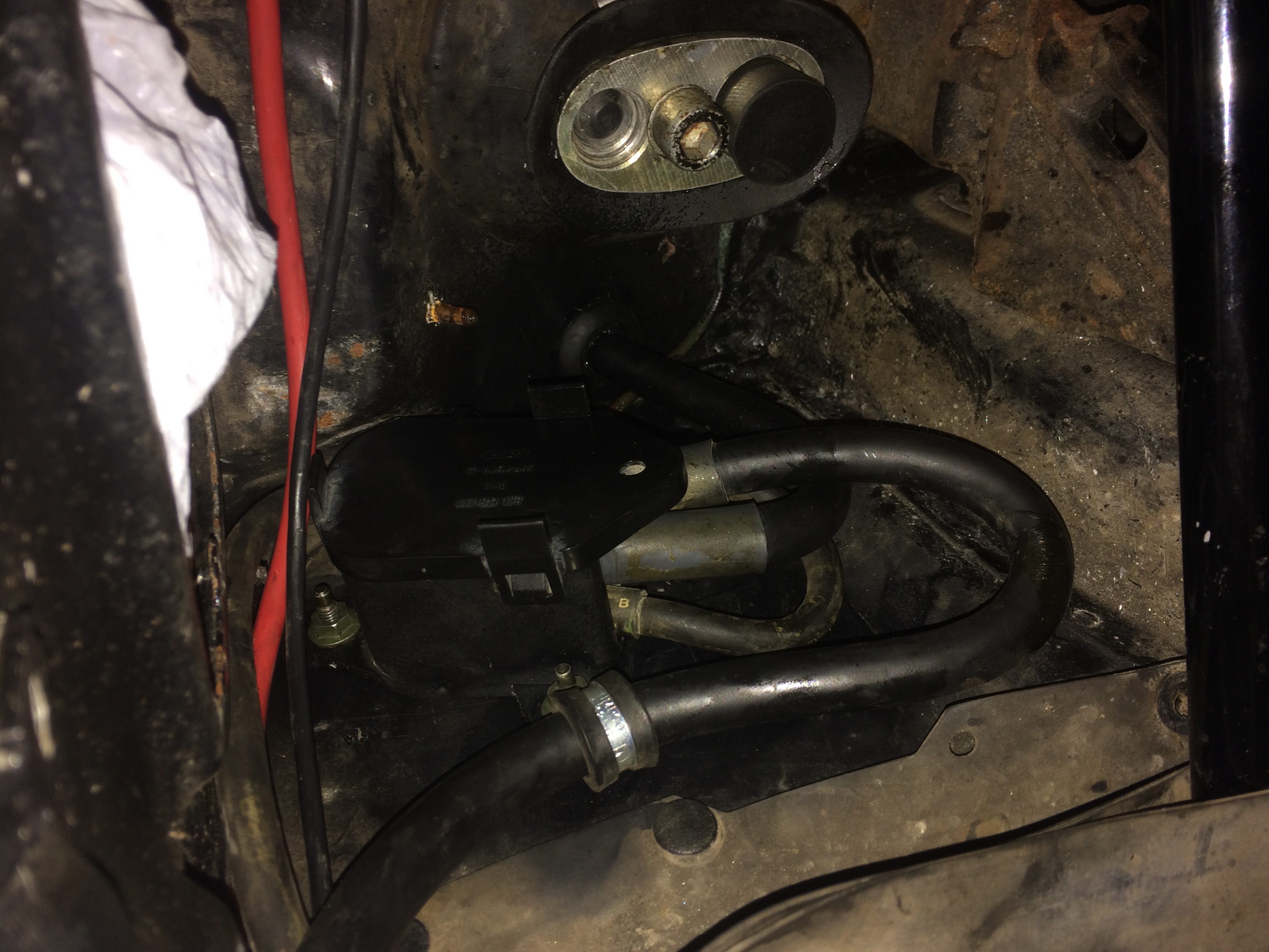

Re: Andy's 91' 80q
Is that the firewall AC hardline fitting you've routed the wiring through?
rennenmsports
Posts: 165
Re: Andy's 91' 80q
Yes. I had it routed that way in the beginning but changed it to the grommet for the seat belt cable

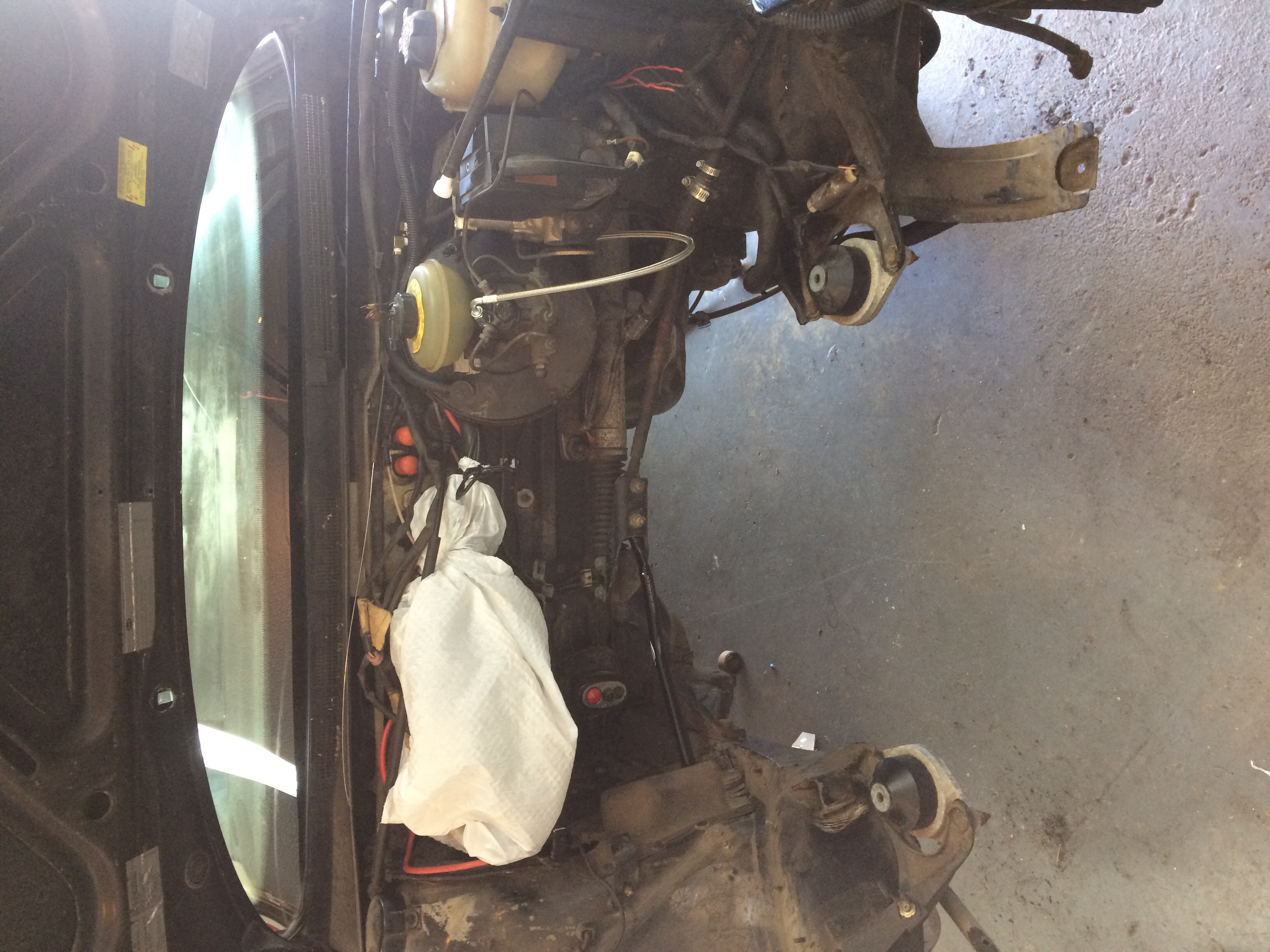

No one got hurt and nothing got broken! Good times

Anyone know what size vacuum line goes to the VEMS urs4/6 ecu? My Wagner I.M. hose barbs are 3.67mm at its lowest point. I suppose it’s 3.5mm then.

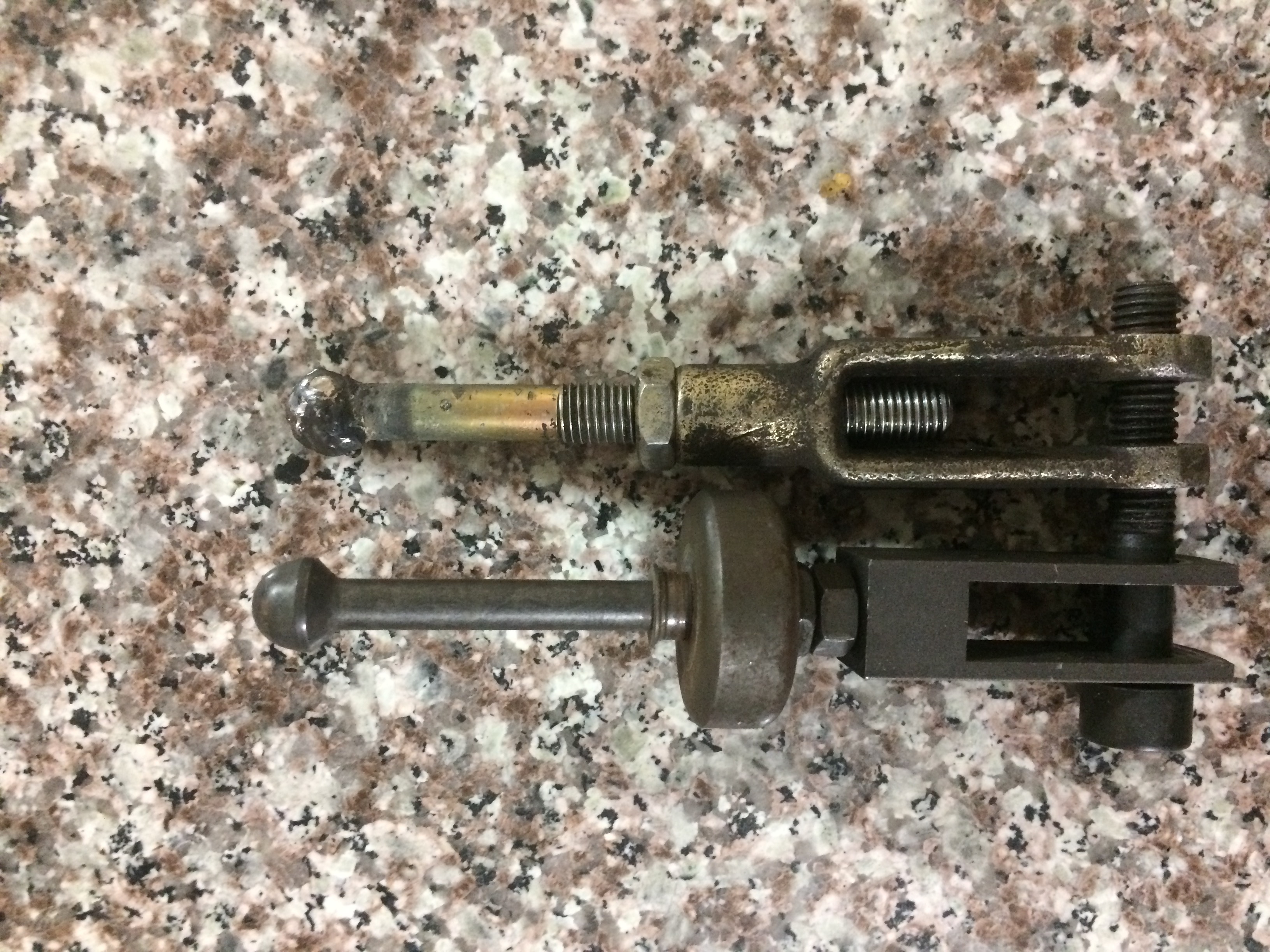

Found a John Deere tractor clevis for my clutch master
mrdeye
Posts: 193
Location: Colorado
Re: Andy's 91' 80q
Post by mrdeye »
Merica!!

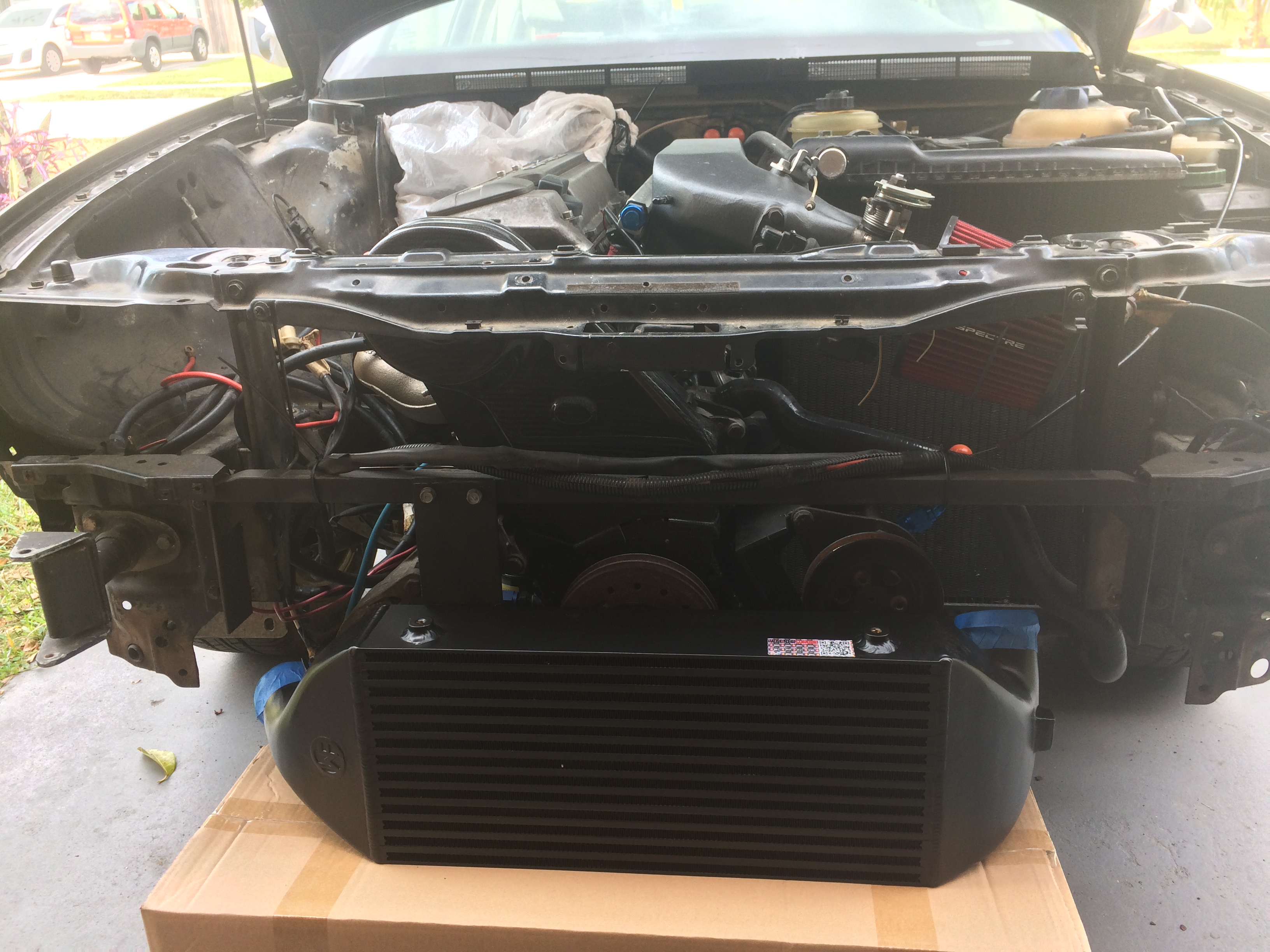

intercooler came :rofl:
rennenmsports
Posts: 165
Re: Andy's 91' 80q
A little smaller than I anticipated but really is a nice piece
maxnadri
Posts: 50
Joined: Fri Dec 06, 2013 9:29 am
Re: Andy's 91' 80q
Post by maxnadri »
This project is really coming along, I like what you are doing, the transmission tunnel you left it? No slicing and stretching it out a tiny bit? Is that a stock 3b 20v intercooler? What are your HP/TRQ goals? This looks like a really fun project, I have enjoyed watching.
rennenmsports
Posts: 165
Re: Andy's 91' 80q
maxnadri wrote:This project is really coming along, I like what you are doing, the transmission tunnel you left it? No slicing and stretching it out a tiny bit? Is that a stock 3b 20v intercooler? What are your HP/TRQ goals? This looks like a really fun project, I have enjoyed watching.
Awesome! Thank you! I left the tunnel alone for now. Maybe after its up and running I'll consider installing the rear mount. The intercooler is from Wagner Tuning. Its the short path. They sell just the cooler now. Before I think you had to get the entire $990 kit. Due to the length of the cooler inlet and outlets its not going to sit dead center. Maybe a 1/2'' off. If I was to remake the power steering pump pulley bracket to hug the block tighter it would be able to have the room. My goal is about 450-500hp with the egine the way it is inside. I want the chassis built for much more then that though.
