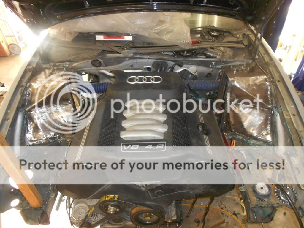

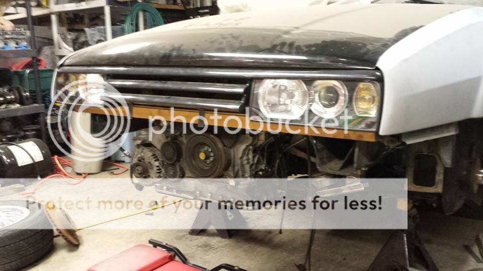

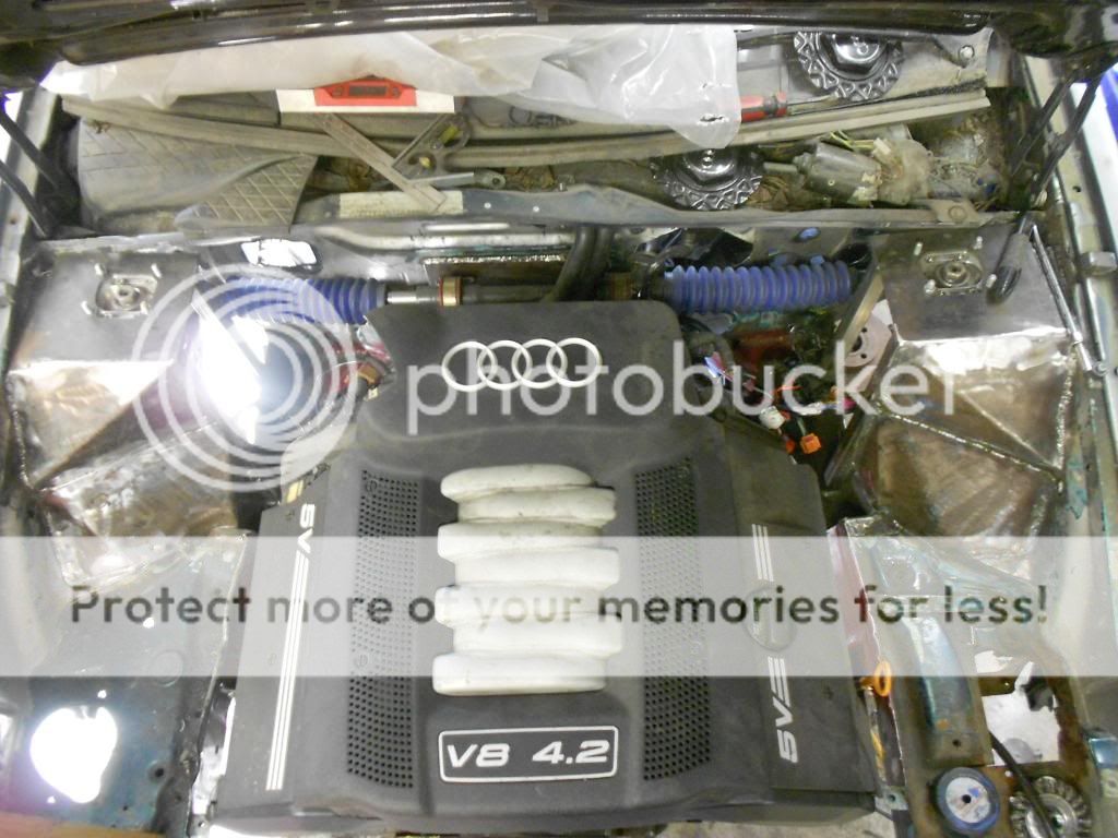

crap i have fallen way behind on this updating thing havent i.....

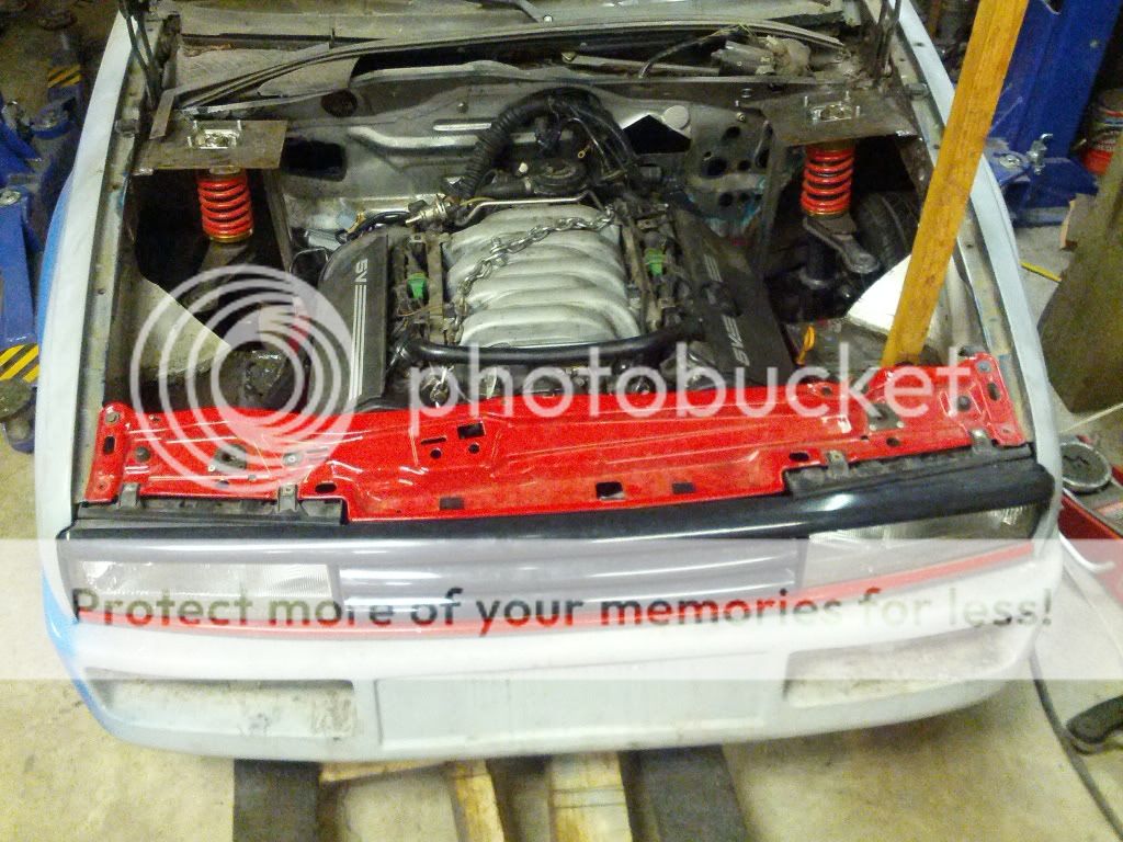

lets see.... judging by the picture trail and what is not up here, i think we have a few updates.

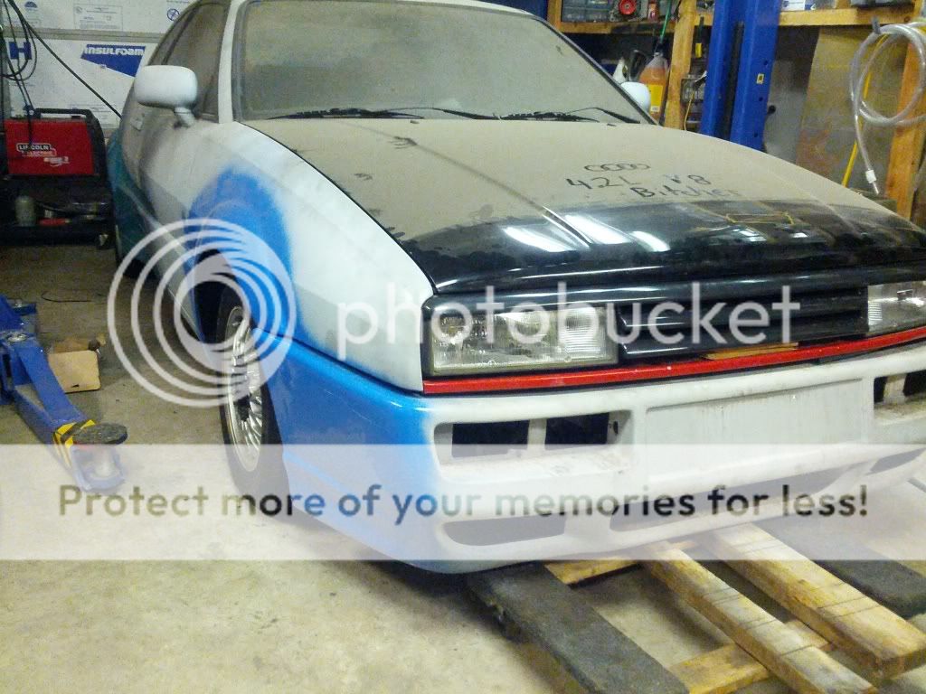

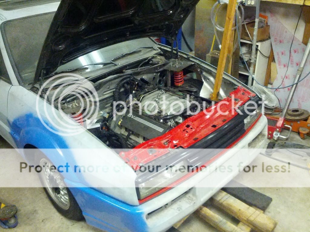

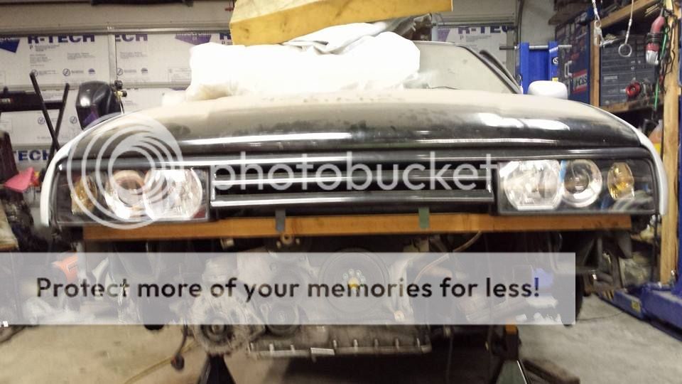

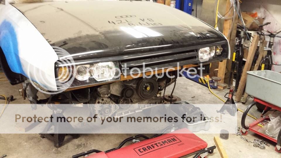

played with the front end some, got some headlights and new core support. just lookin at how stuff fits in there.

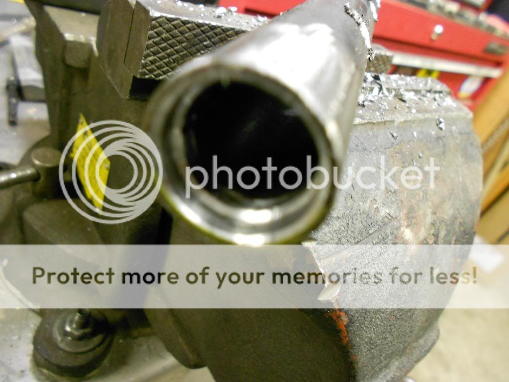

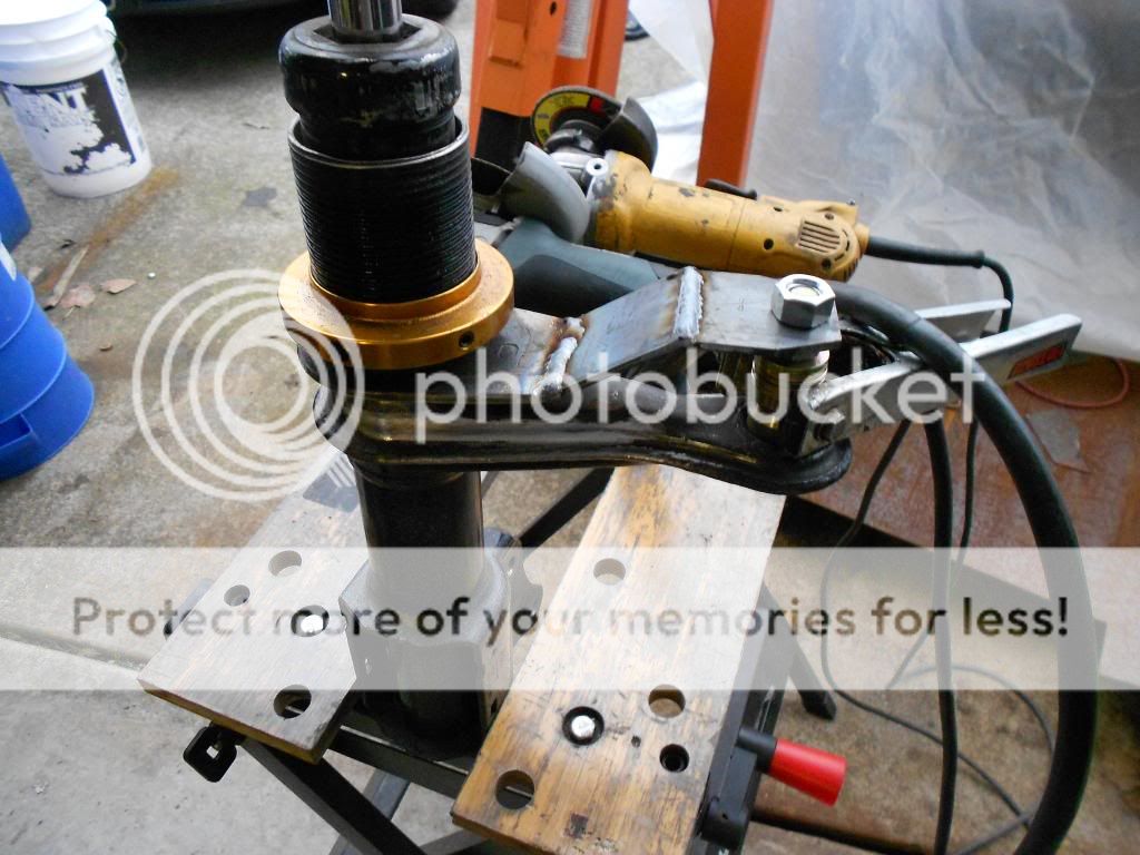

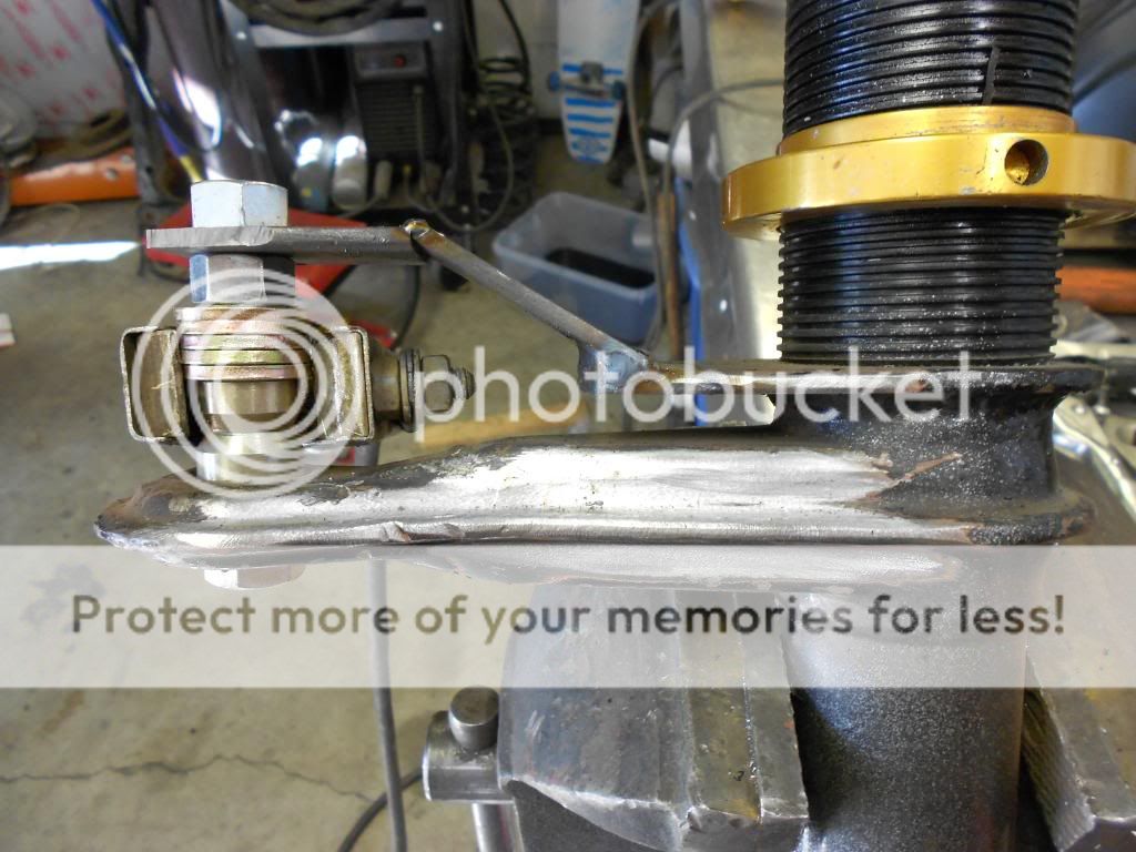

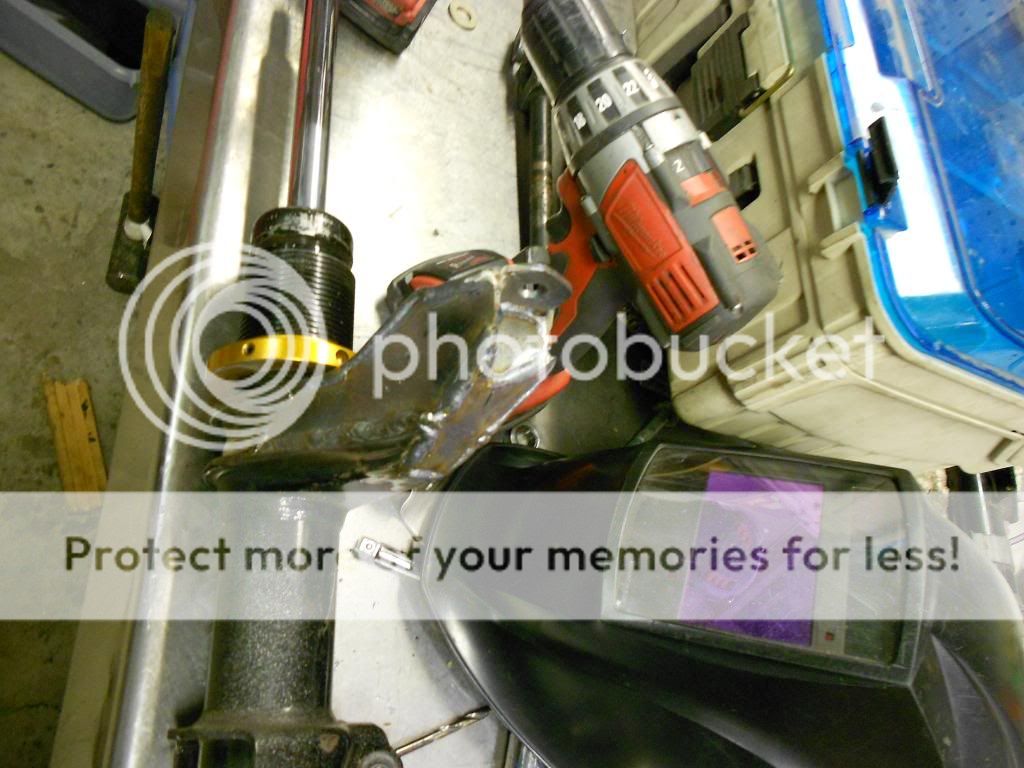

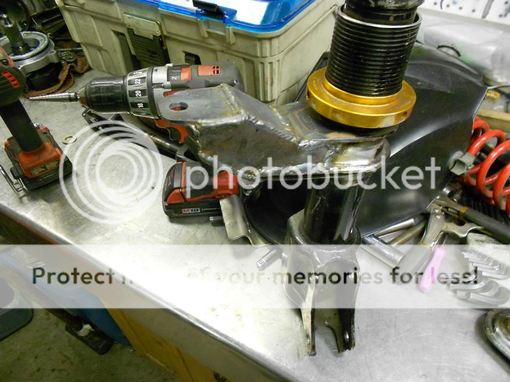

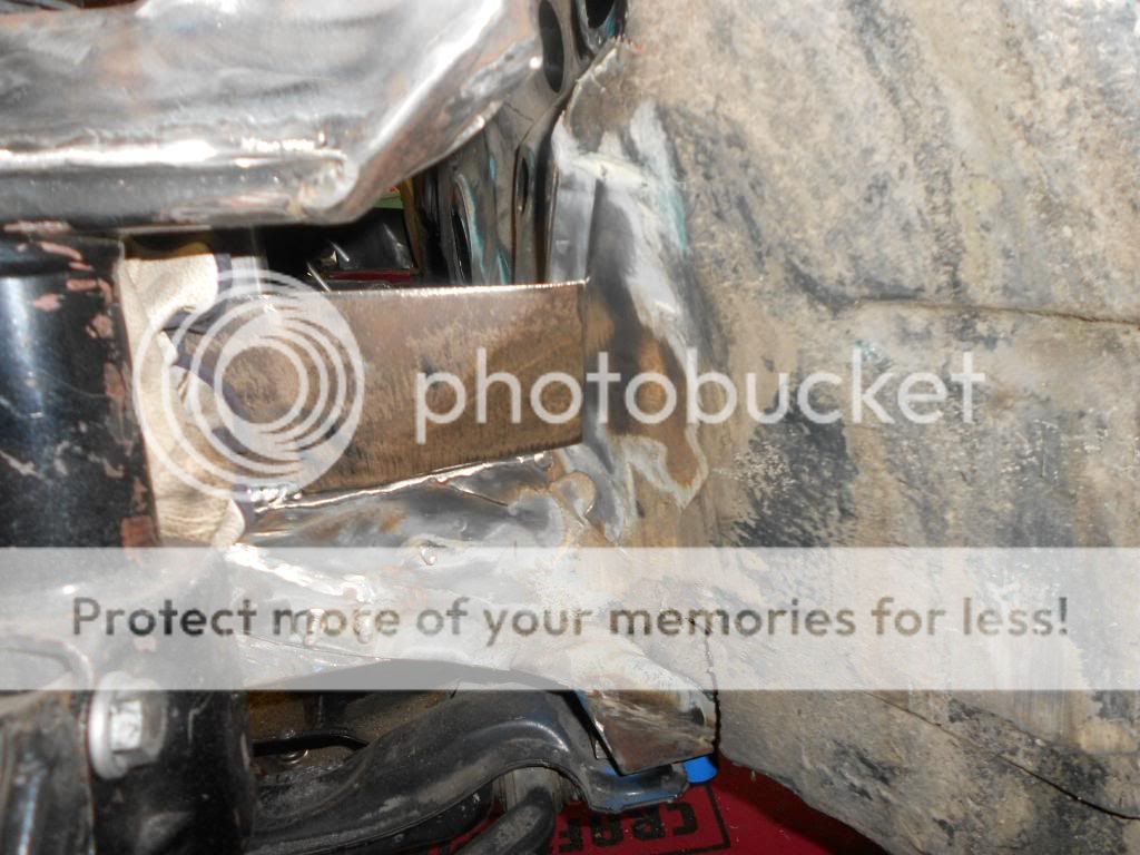

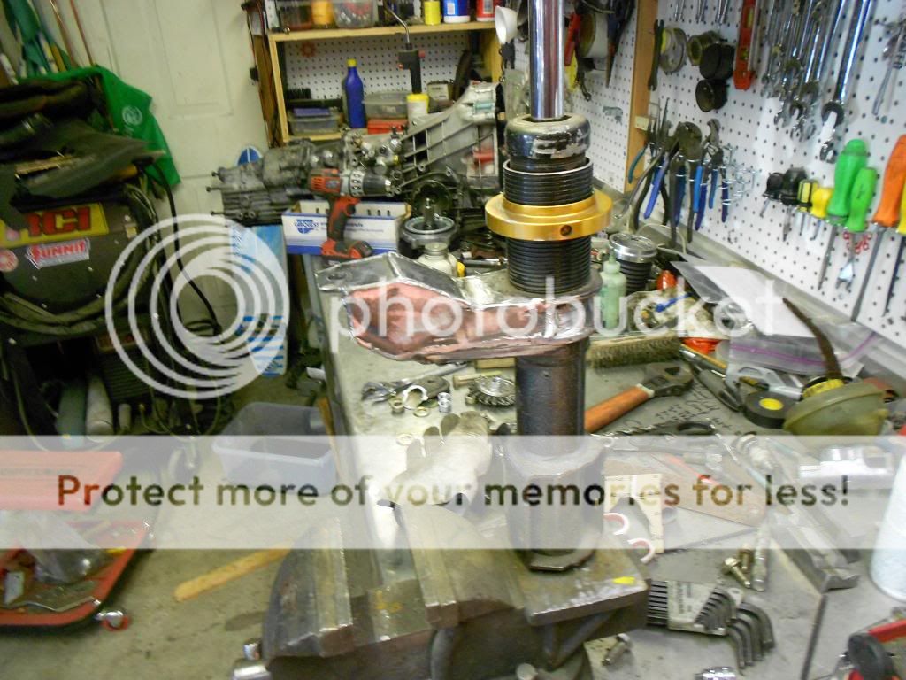

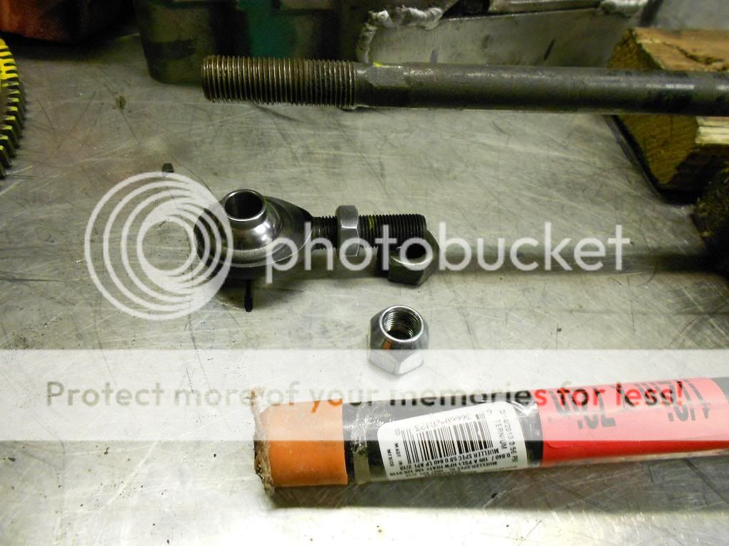

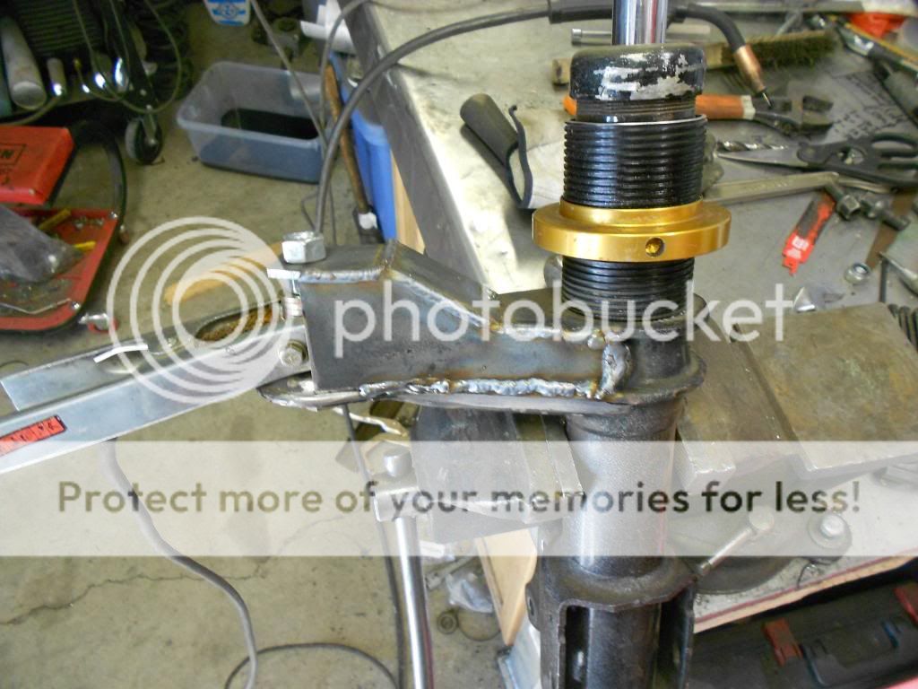

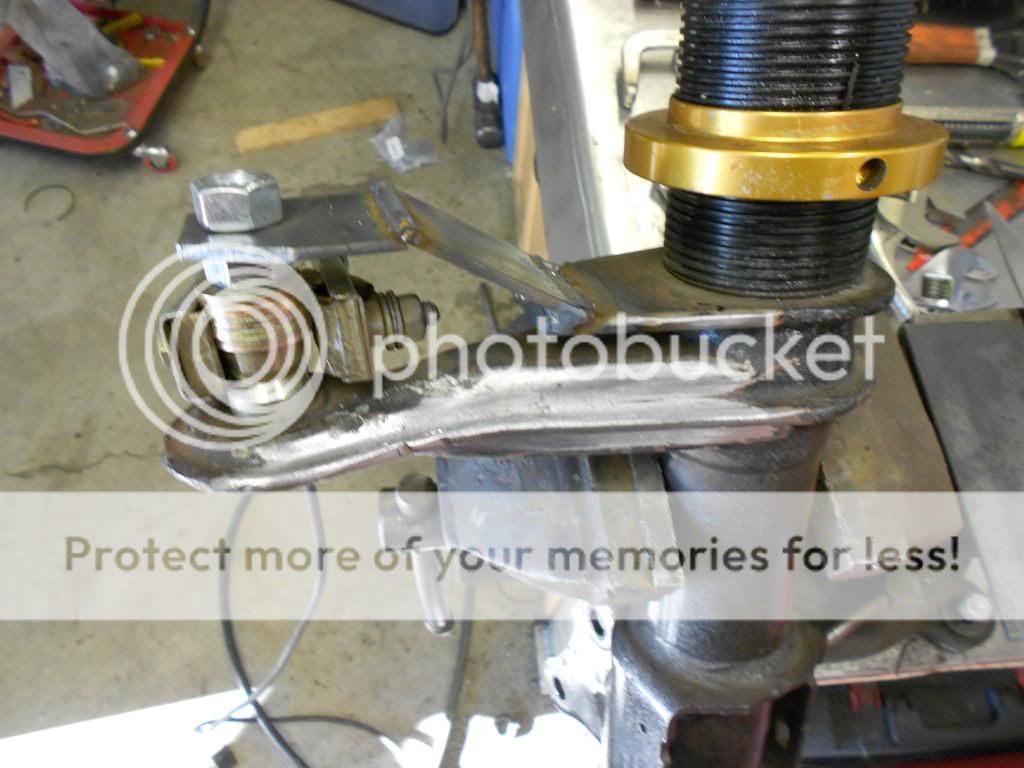

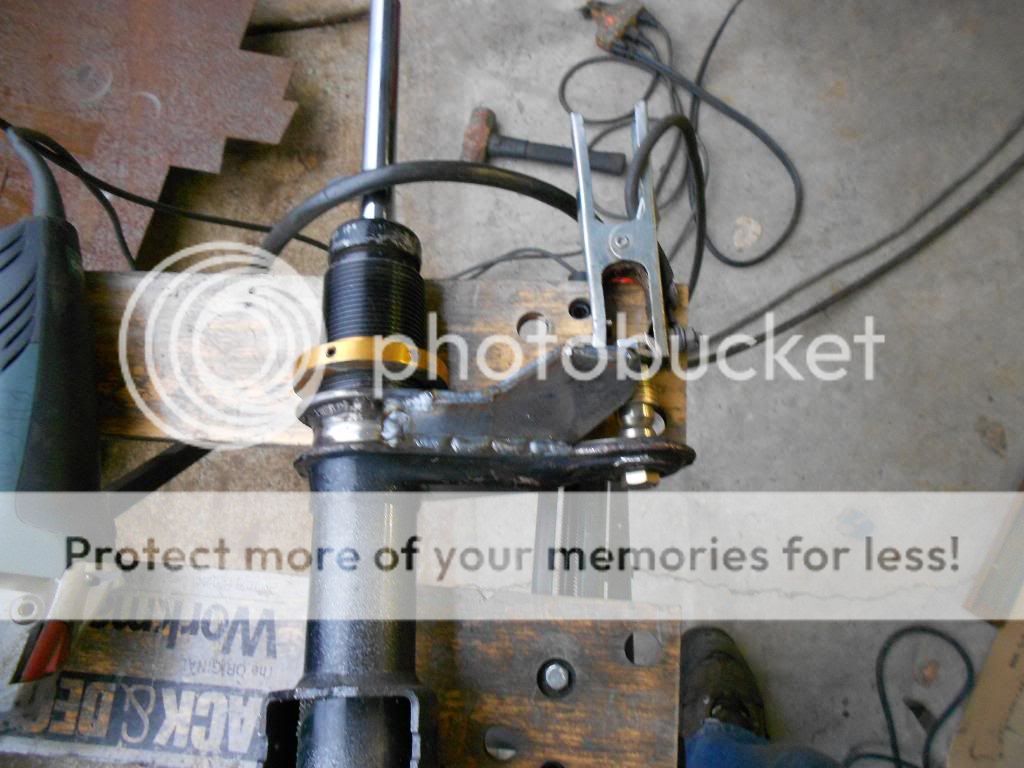

then i raised the tie rod points on the steering arms off of the strut housings.
- speeding-g60
- Posts: 2152
Re: 4.2L Quattro Corrado, Aarons way. tons of pics.

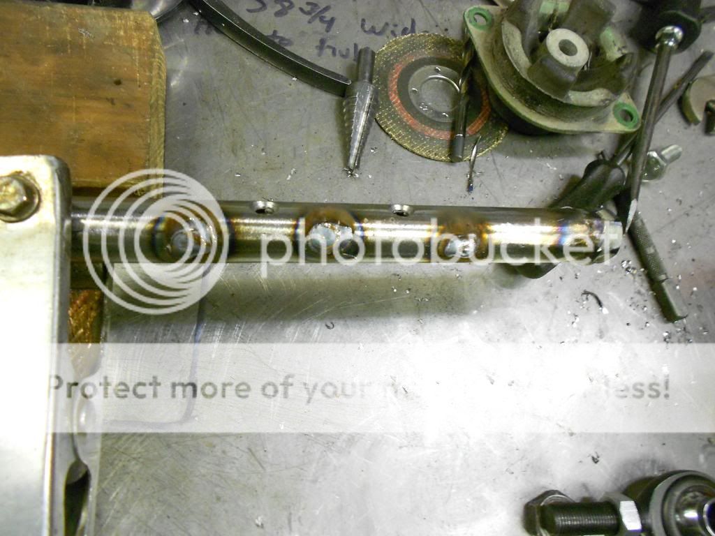

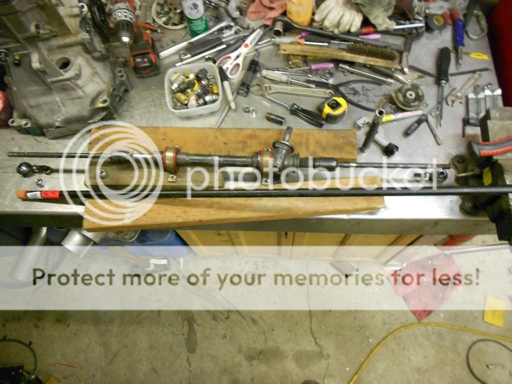

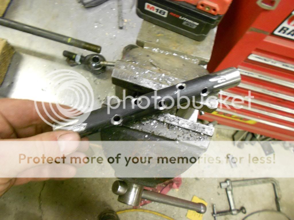

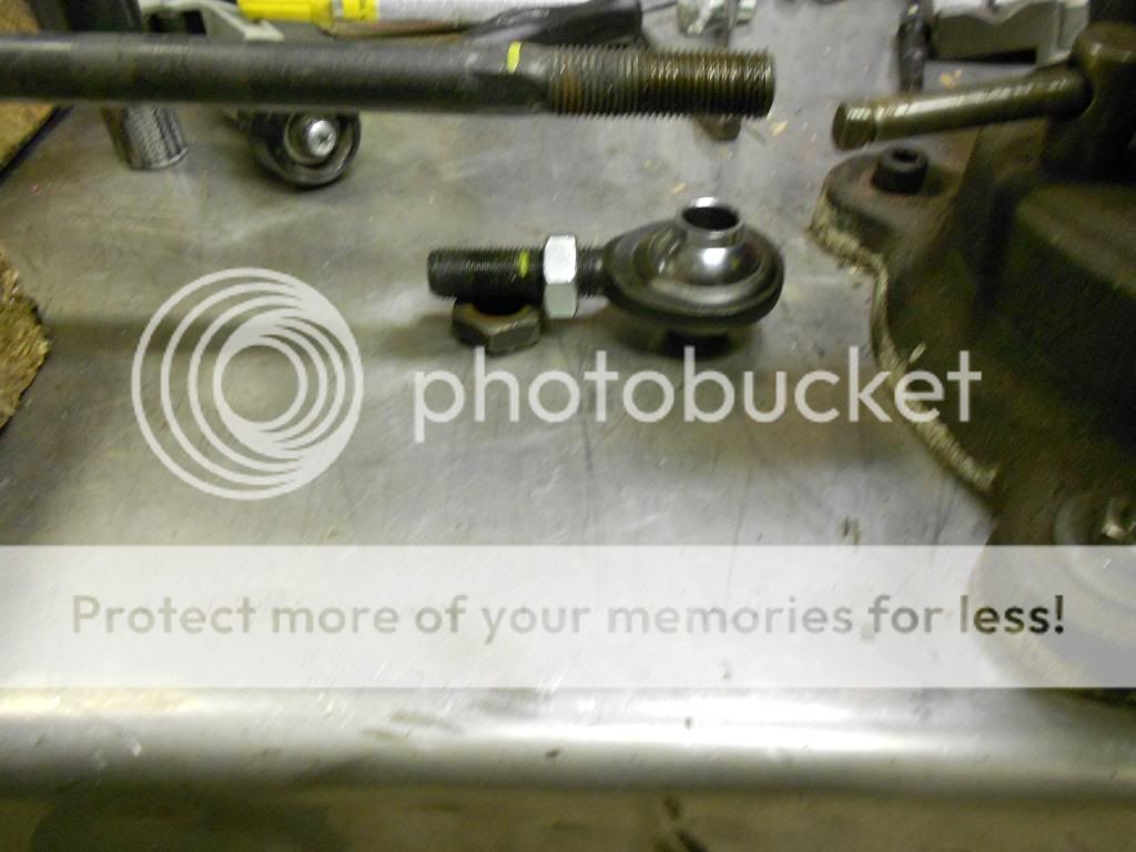

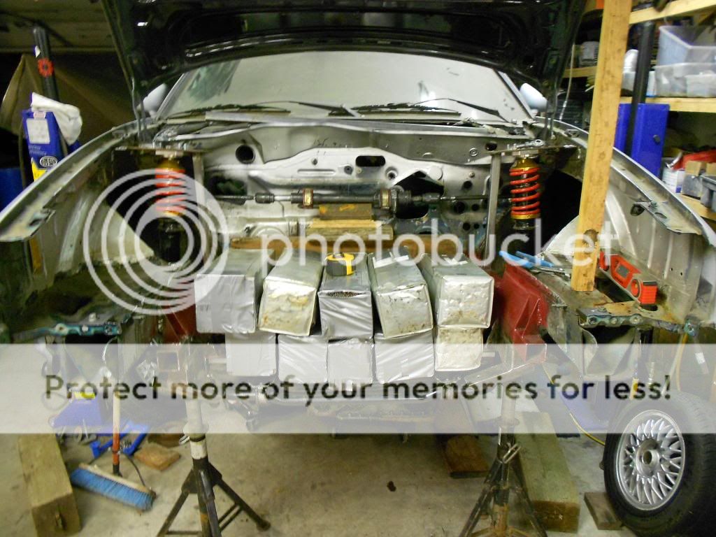

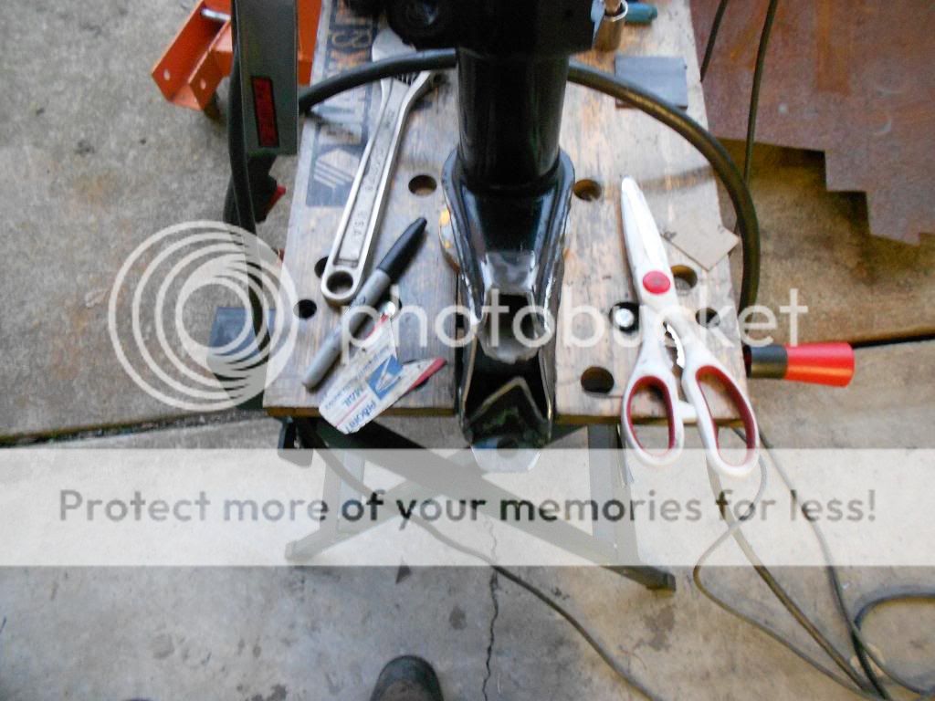

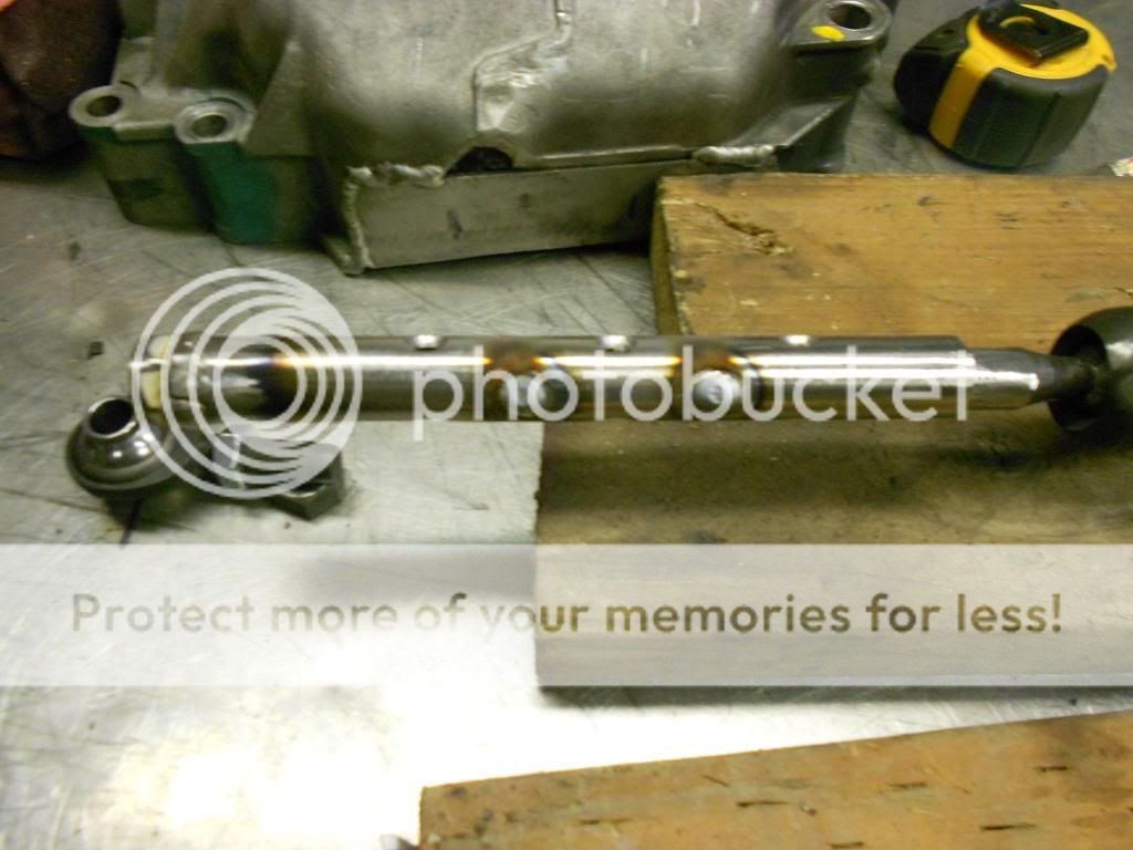

then i needed to mount a steering rack, i took the rack out of my MK1 Rabbit GTI, and figured lets give that one a whirl and see how it works out.
but with the motor in the car, it was in the way to easily work on it. so i removed it, and then put some weight back in it with the car on the suspension to simulate ride height and strut compression. just grabbed 500 pounds of welding rod from work for the deadweight haha
seems i didnt take many pix here, or i didnt upload. maybe i sent them straight to FB from the phone. its easiest that way anymore. but first welded a doubler plate to strengthen the firewall, then made bracket mounts to attach the rack.

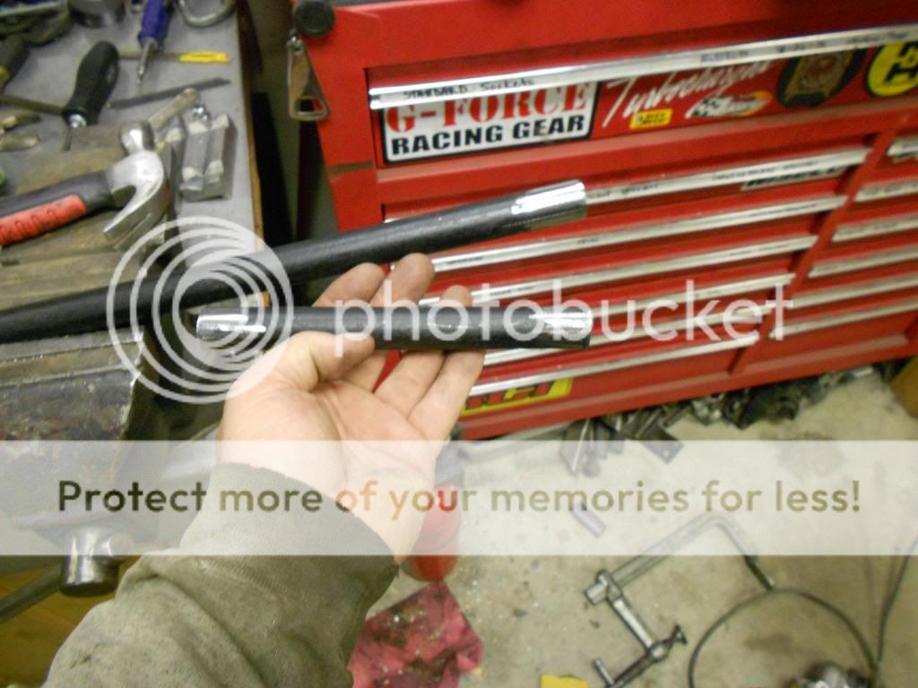

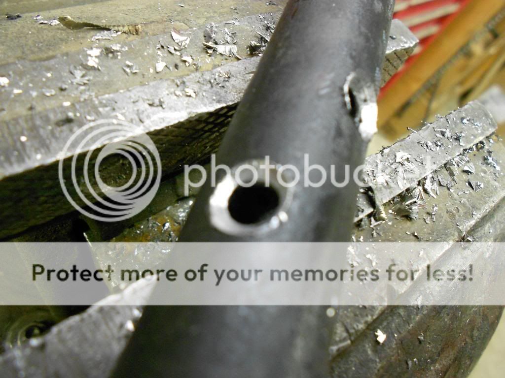

then made the steering rods for it.

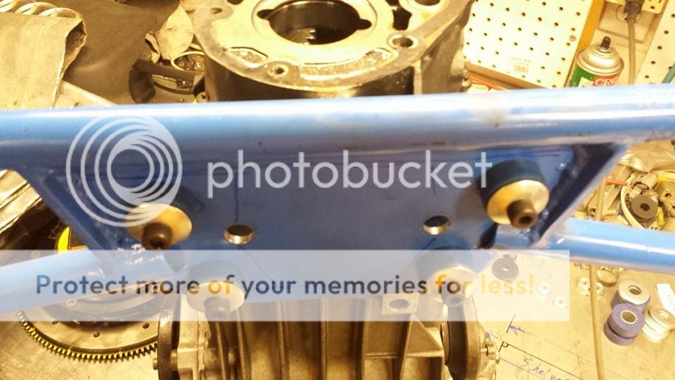

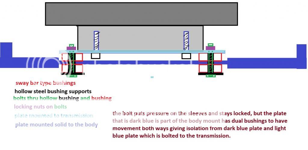

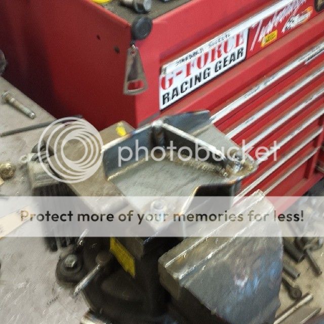

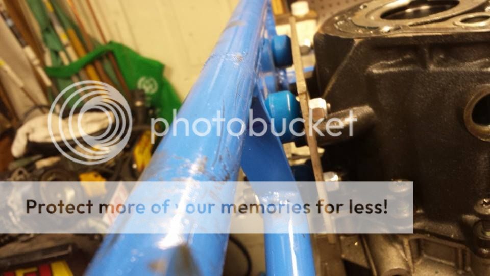

then i decided i wanted some more flex ability with the trans mounts, and Derek suggested an idea and i went with it. instead of just hockey pucks between the mount and the trans, i went with isolators both ways.

and i skipped the sleeves thru the bushings.

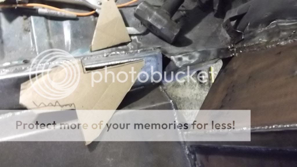

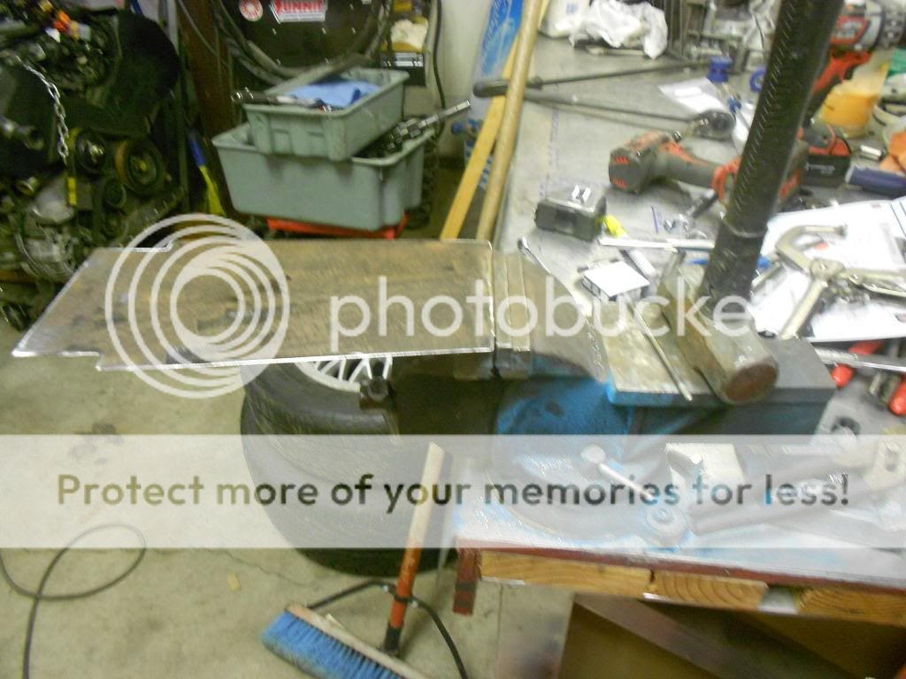

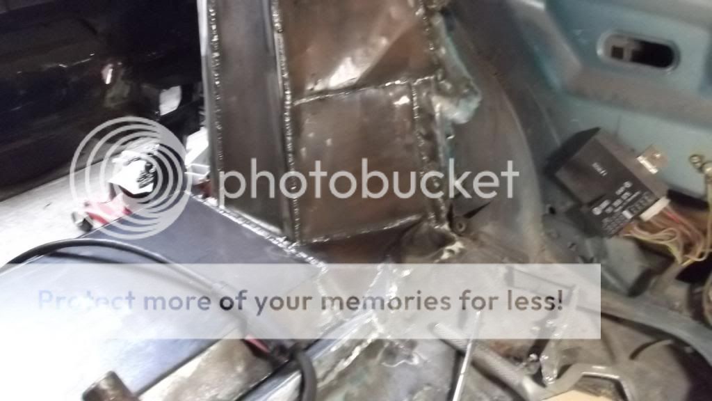

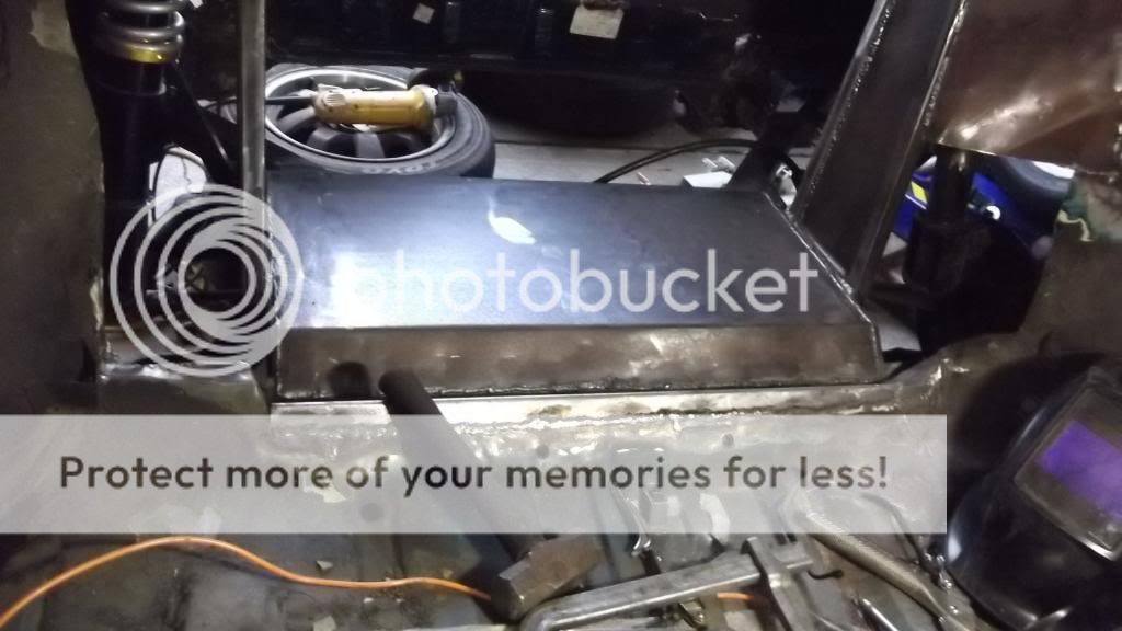

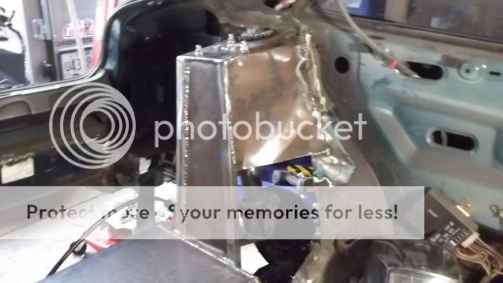

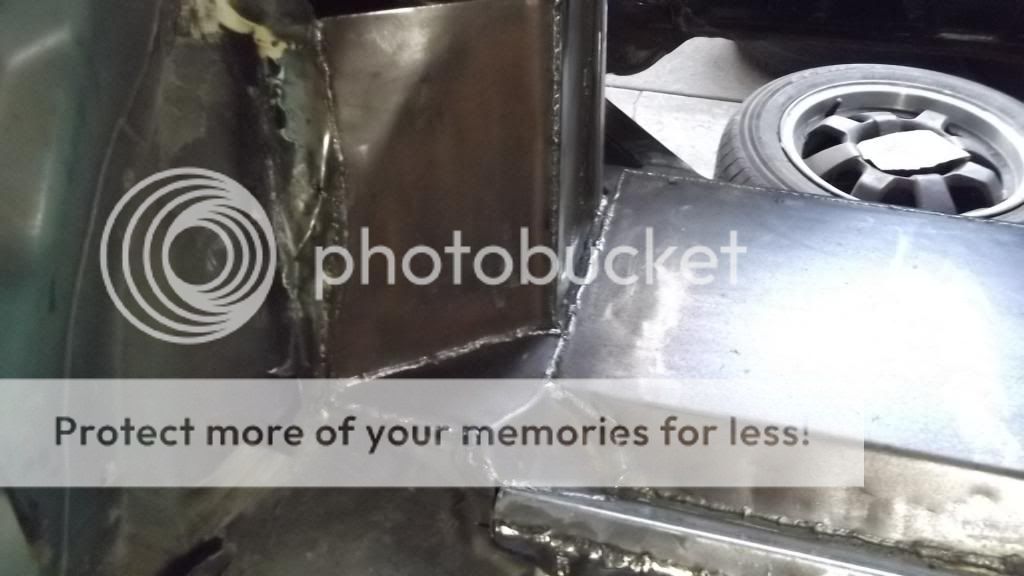

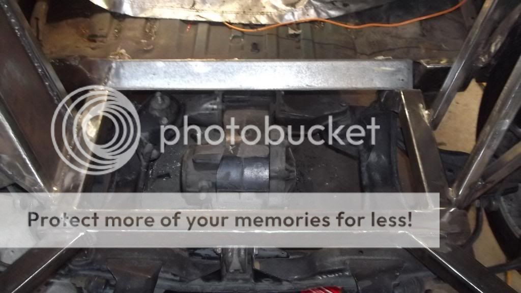

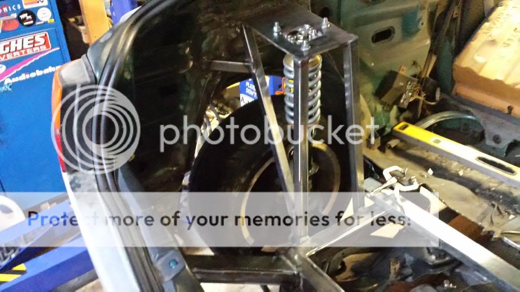

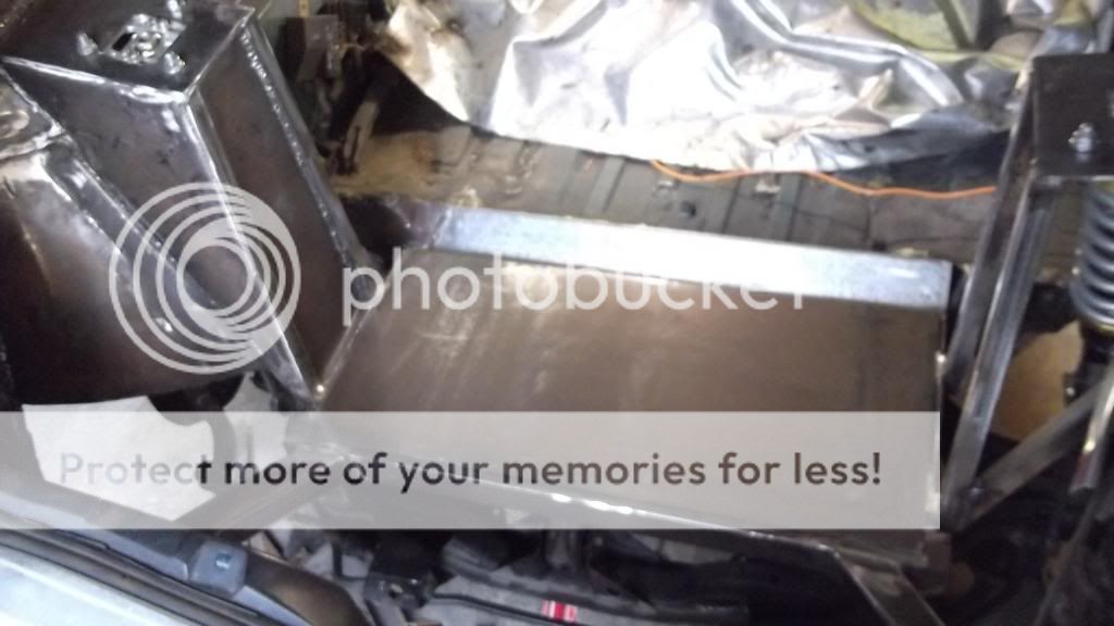

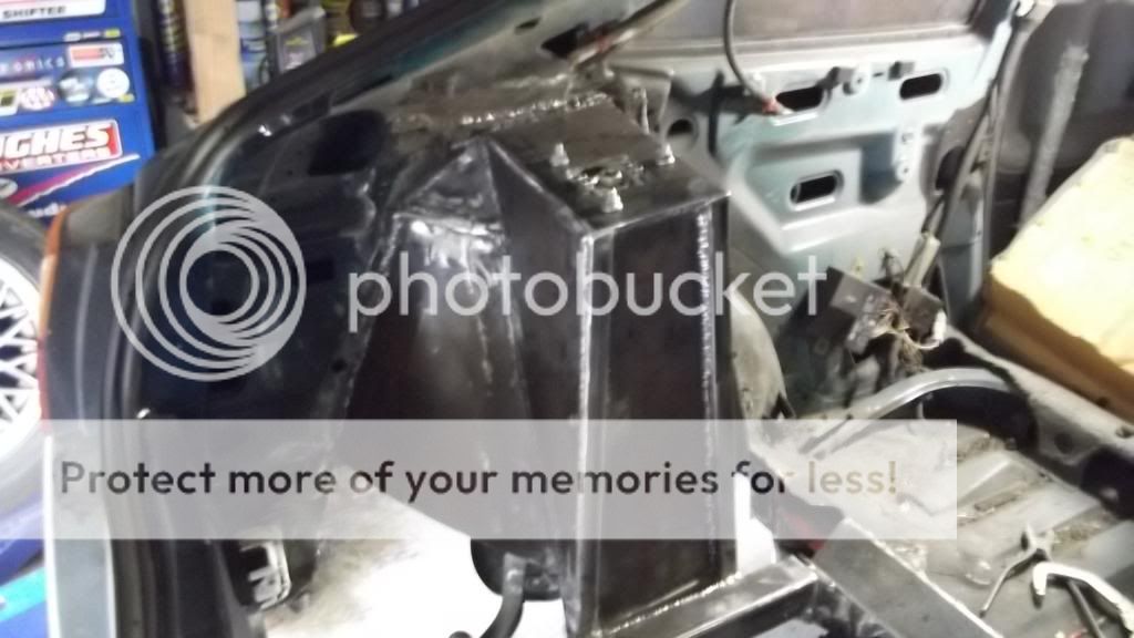

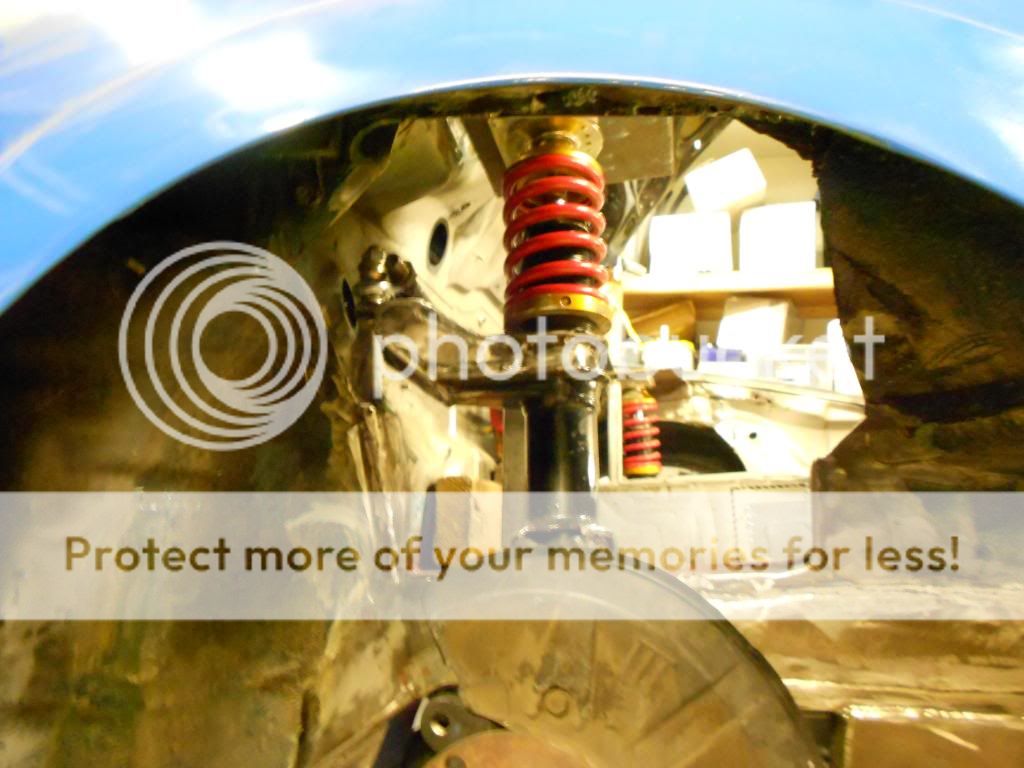

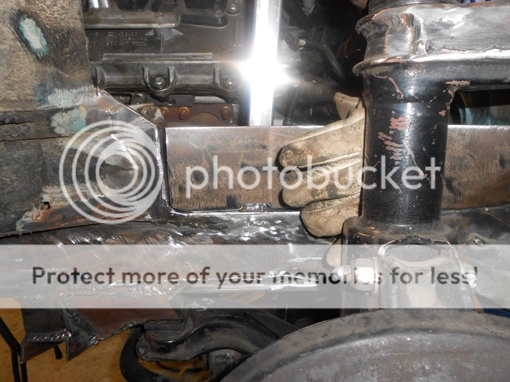

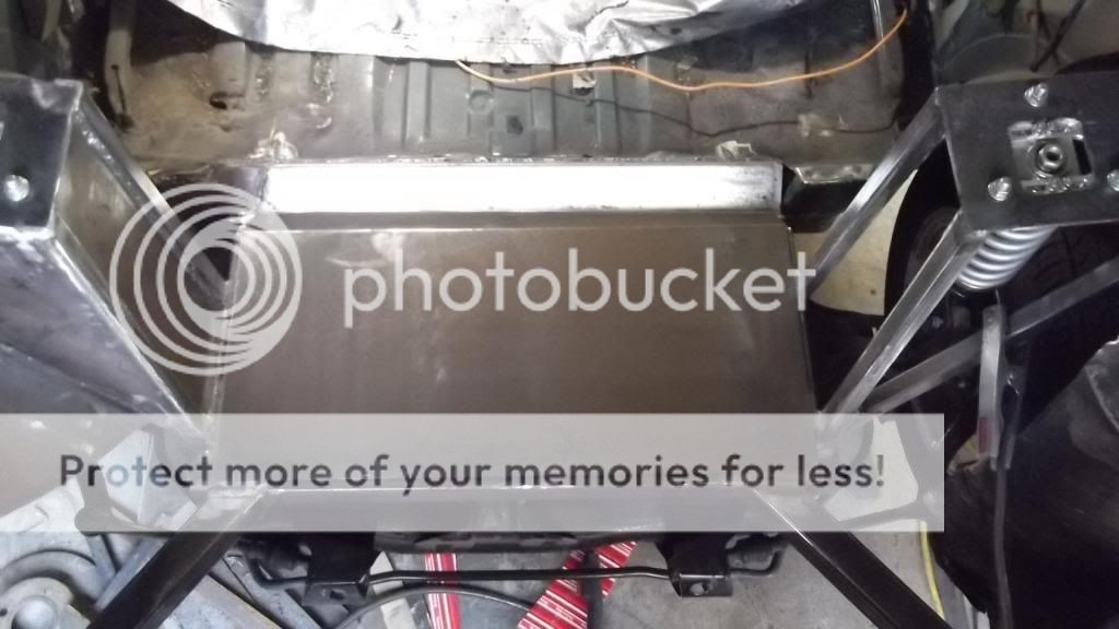

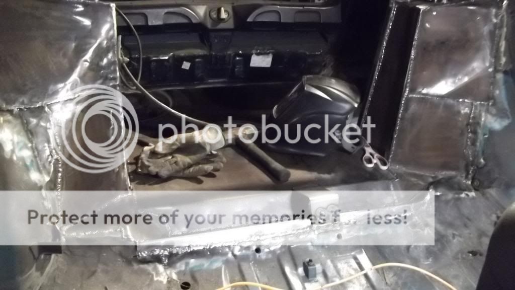

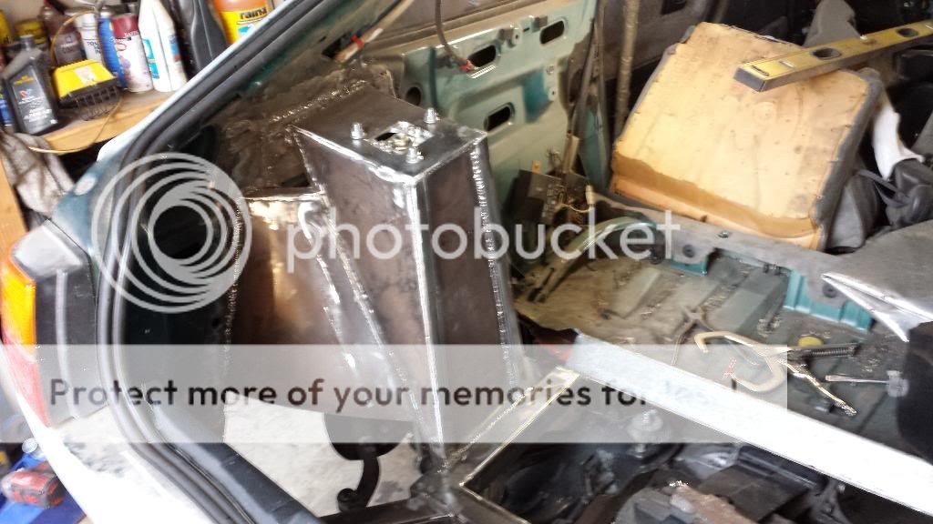

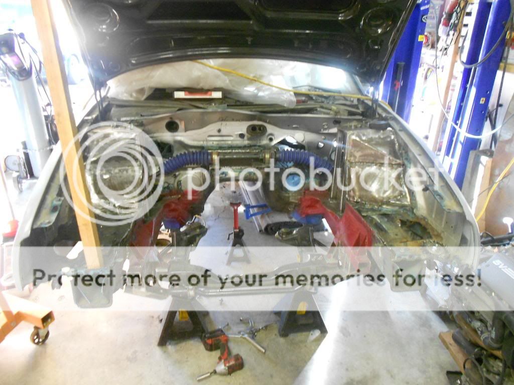

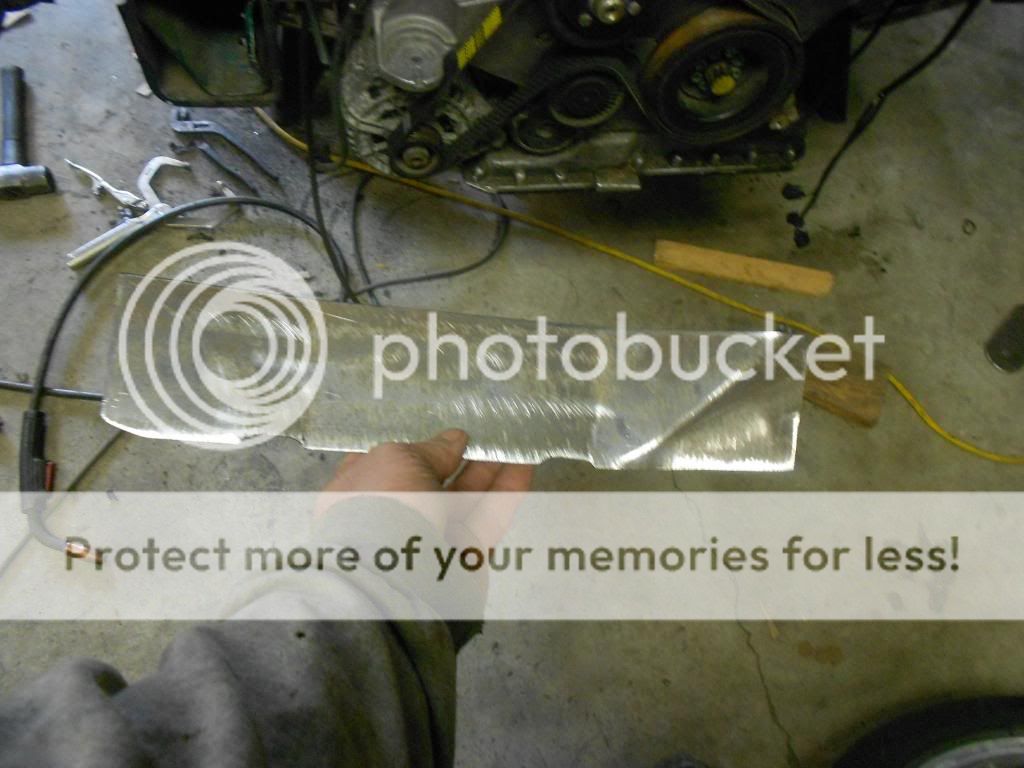

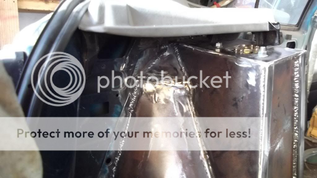

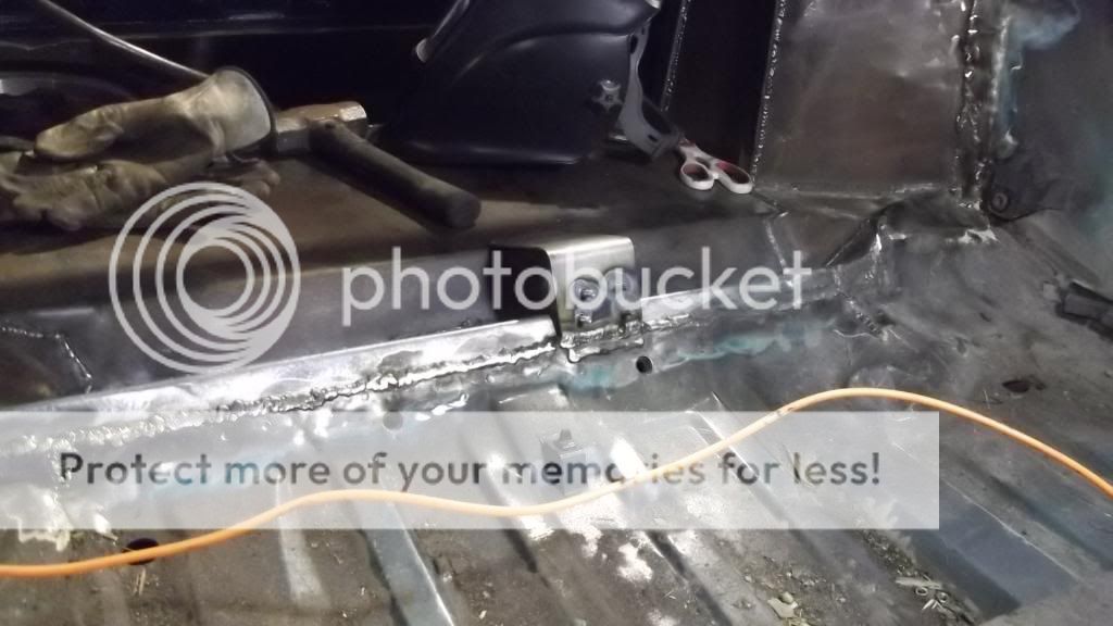

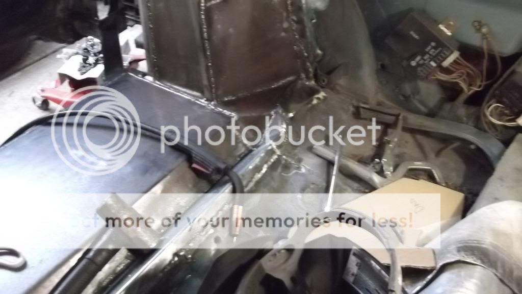

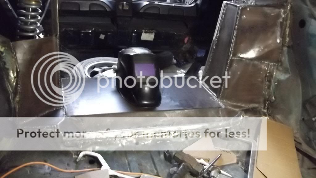

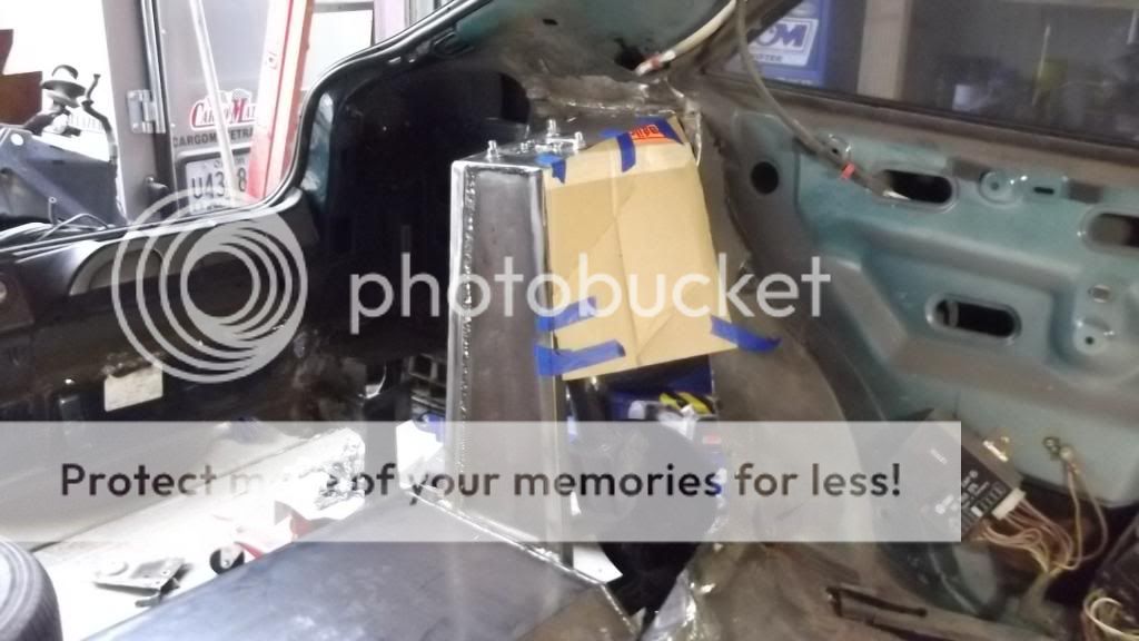

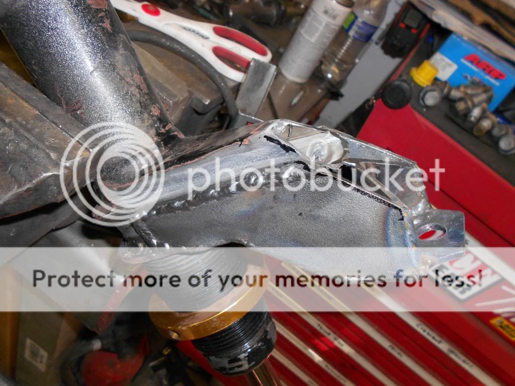

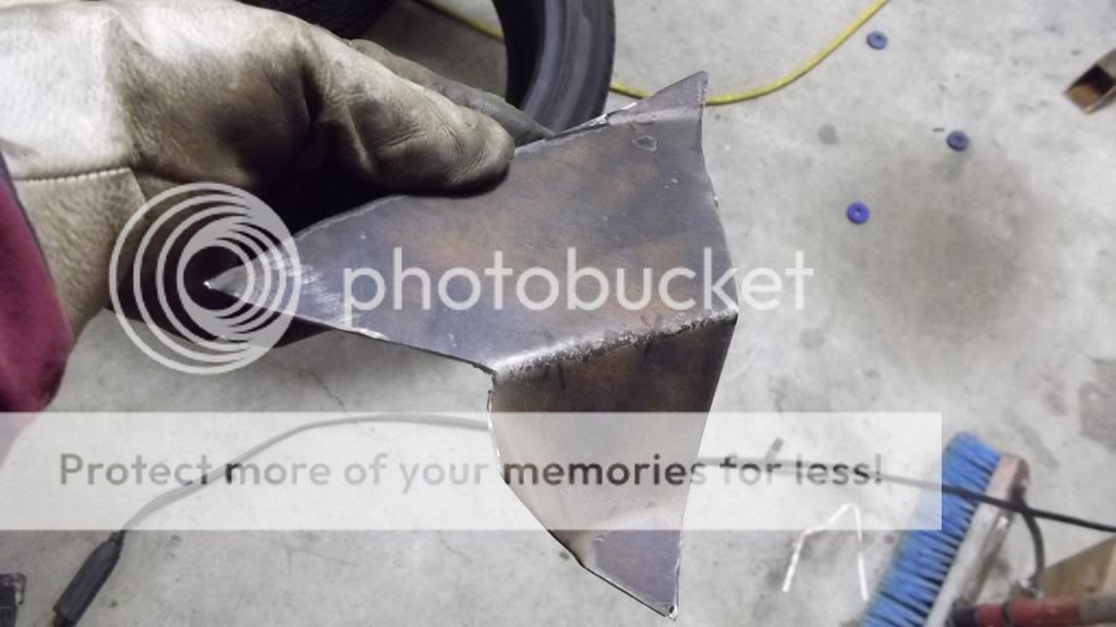

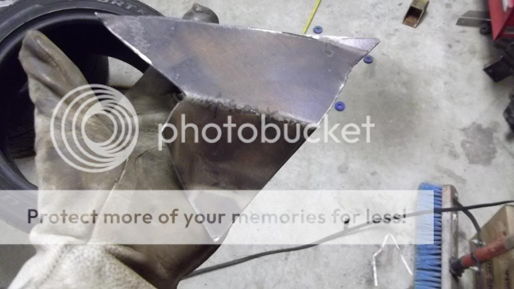

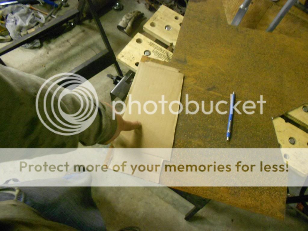

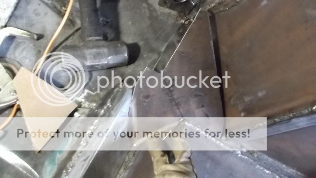

worked on the rear strut towers and the floor area. and got about 80-85% complete there minus the rearward portion of the floor, i need to design the fuel cell for that area. the goal is to still hopefully use the OEM plastics and all the interior trim pieces. i think i can do it.
anyhow, on to this weeks work, thru my birthday (monday) and the Christmas holiday.

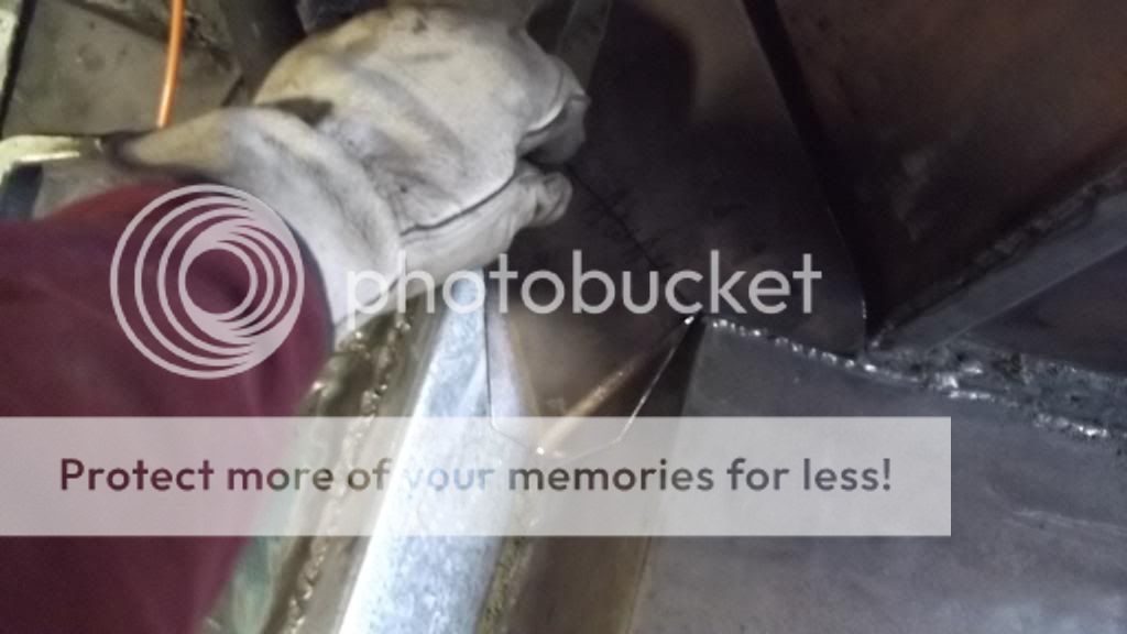

that was thru Christmas day, and of course i ran out of shield gas. FACK ME!!!!! so today i got more gas, and made it to here.

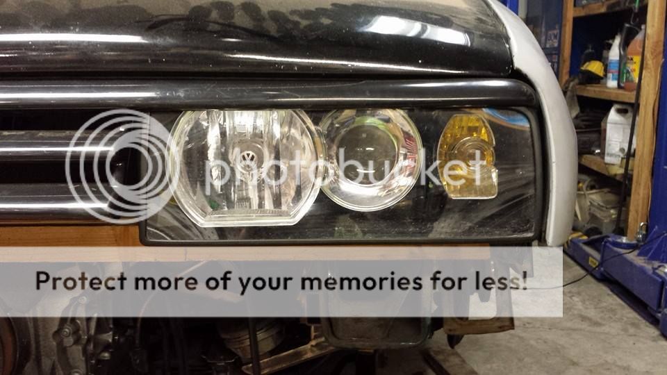

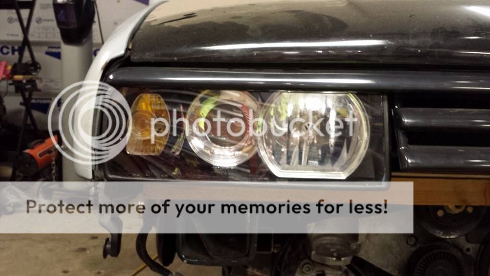

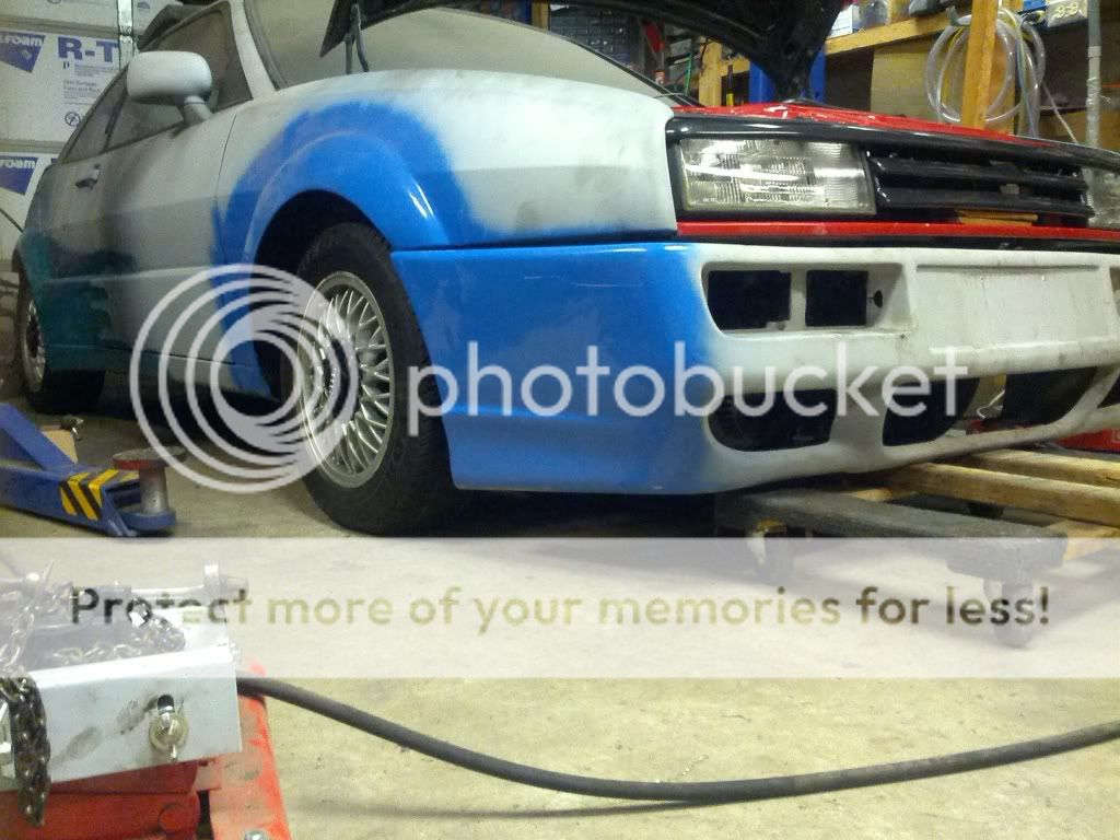

oh yeah, i almost forgot. the guy who started this project, well he was making some custom headlights for it. and he decided to finsih them and give them to me as a Christmas present. my challenge will be to mount them, but they look pretty cool. a couple sets of headlights gave their lives for these. still using the OEM HIDs even.

Sweet headlight setup! This is coming along very nicely. I look forward to seeing how well all the factory plastics fit in the rear.
Re: Aarons 4.2L Quattro Corrado, 12-26 mega pic upload
Looks great! I like the B6 headlight retrofit too!

Headlights are sweet too. Icing on the cake for sure - very cool of the PO to finish them for you.

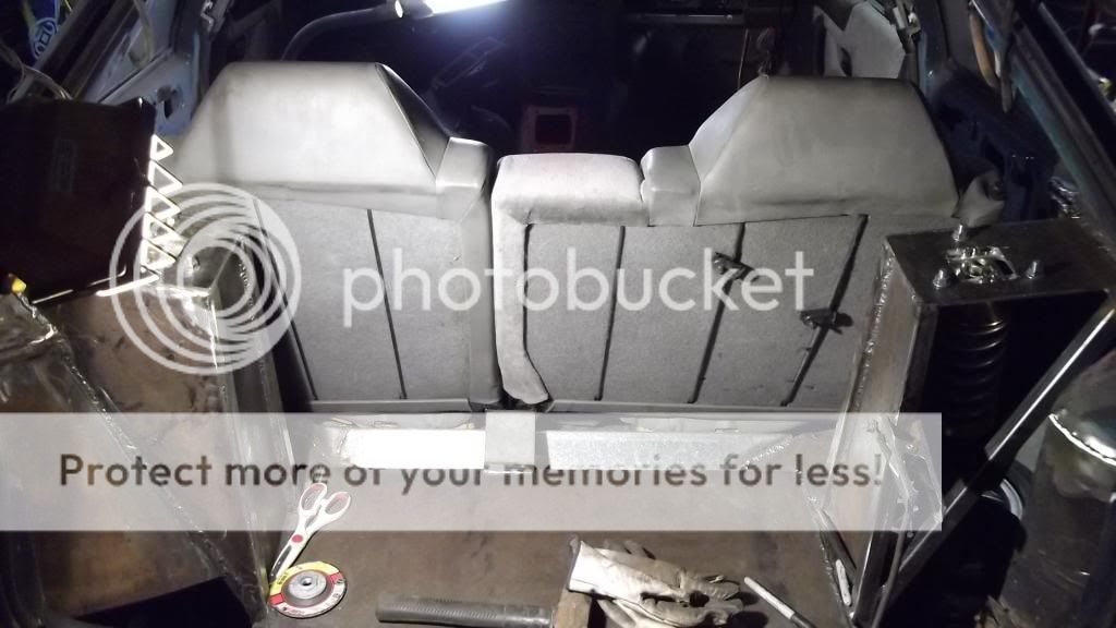

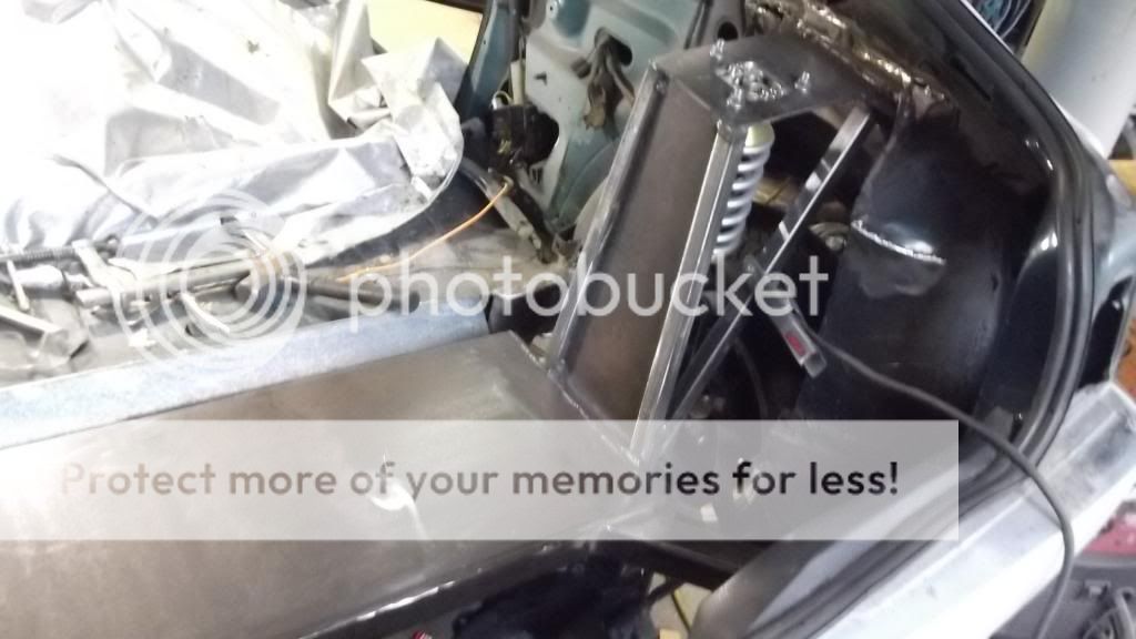

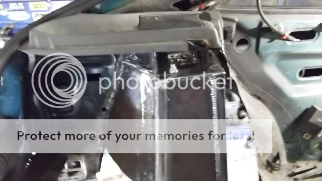

did some more work today, just a lil bit really. went to the race shop to discuss the tube frame car some more.

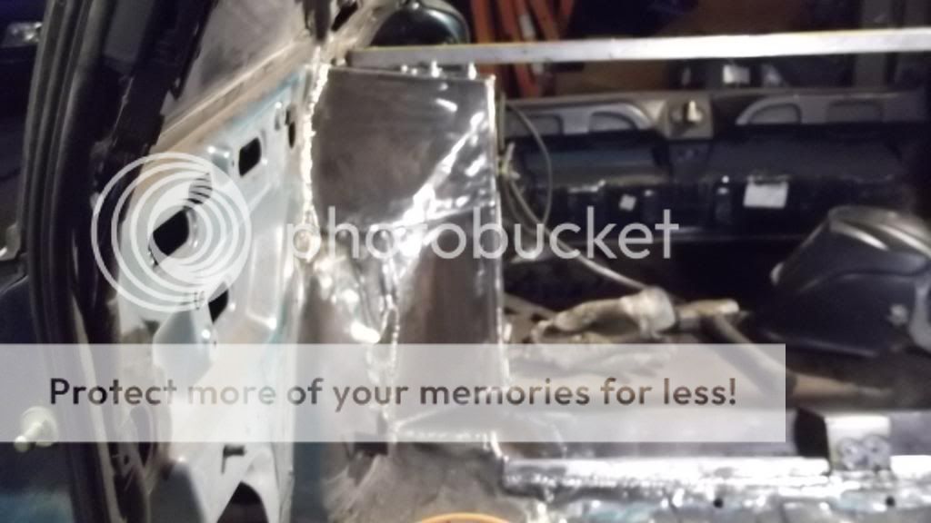

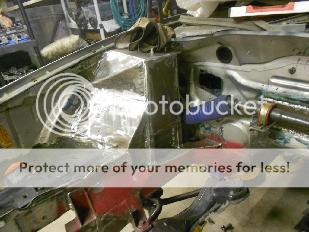

finished the rear strut towers (on the front for pass side) and mounted the rear seats.
also, put new Flowmaster mufflers on my 4x4 Chvy truck. has a Corvette Tuned Port Injected motor in it, one of my earlier swaps.... sounds good and runs good, too.

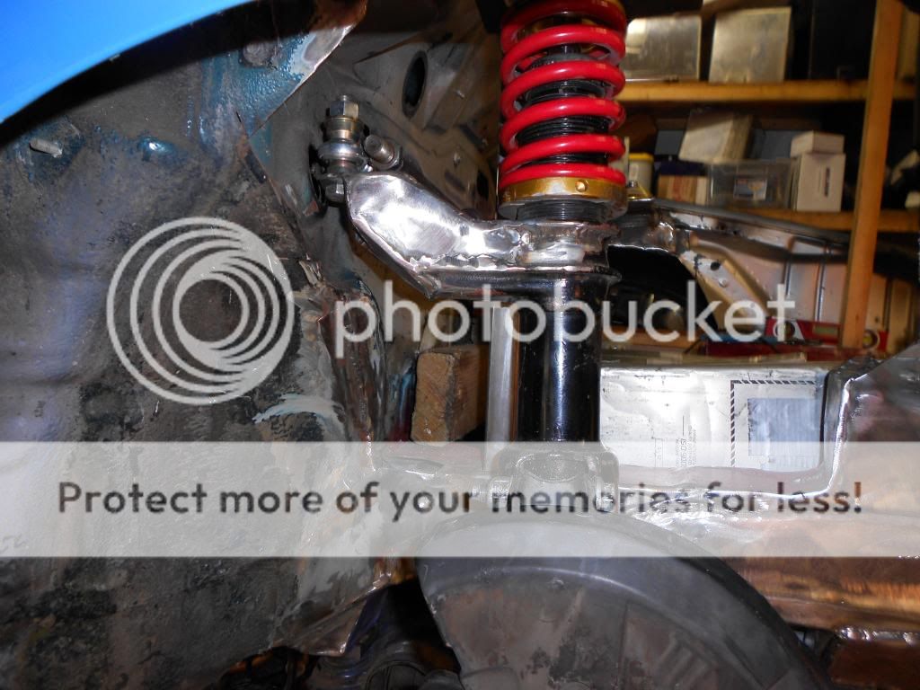

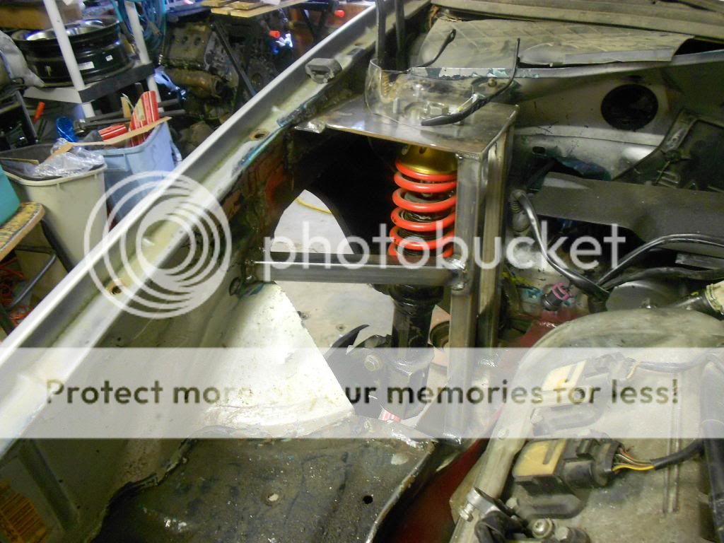

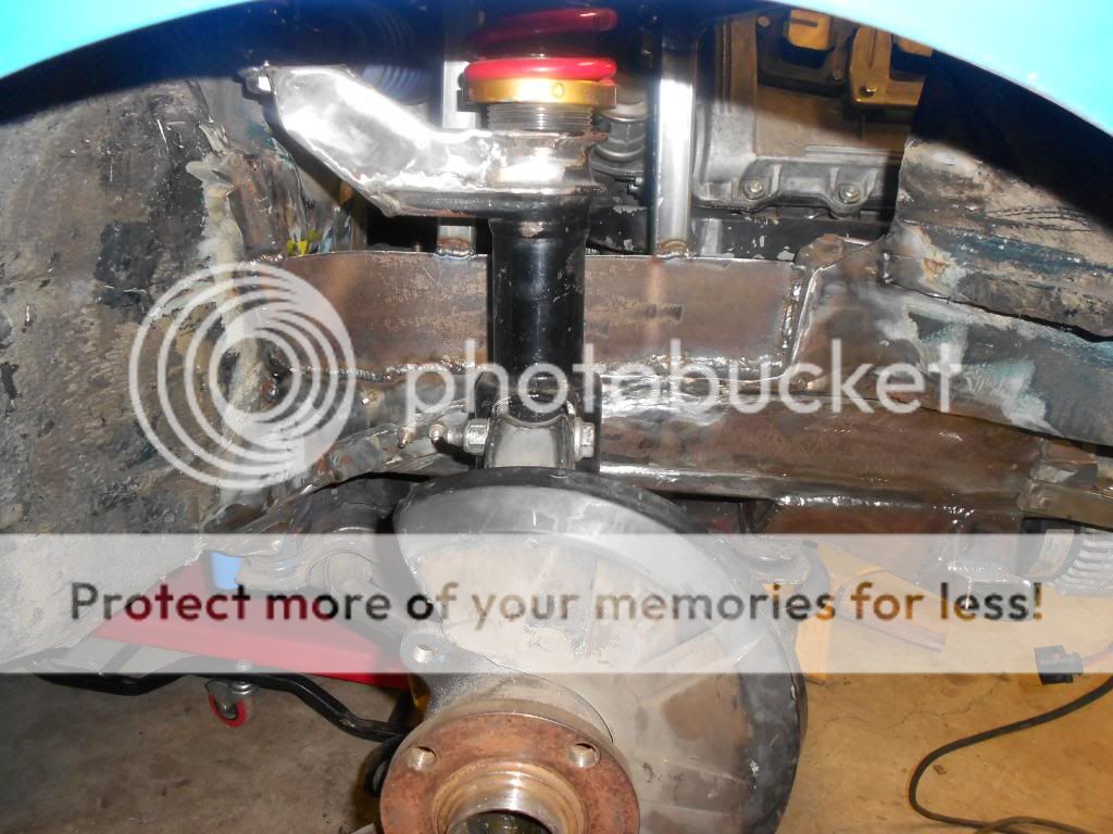

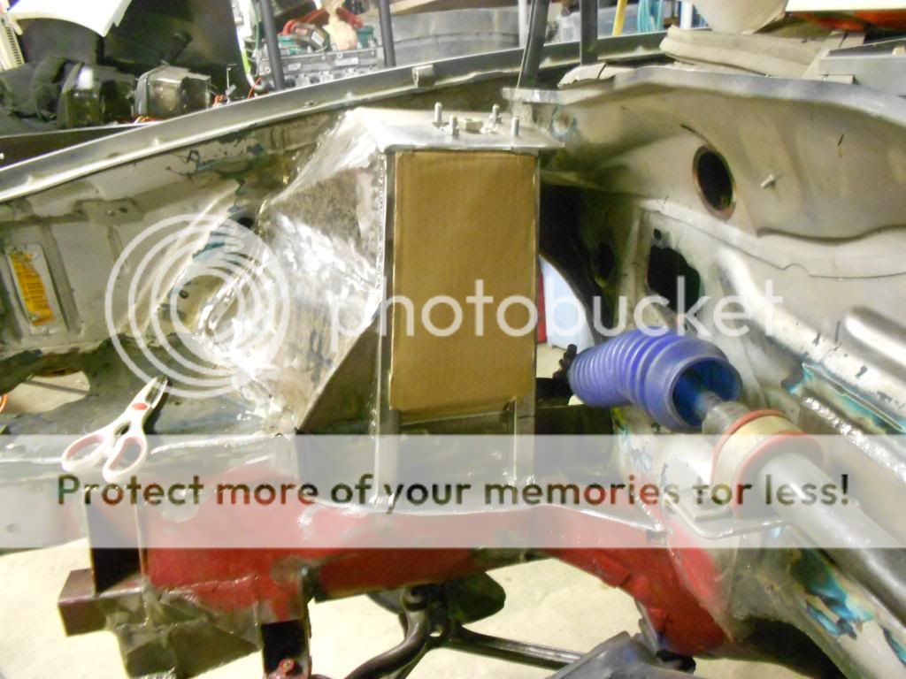

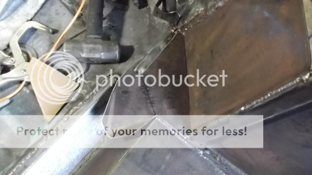

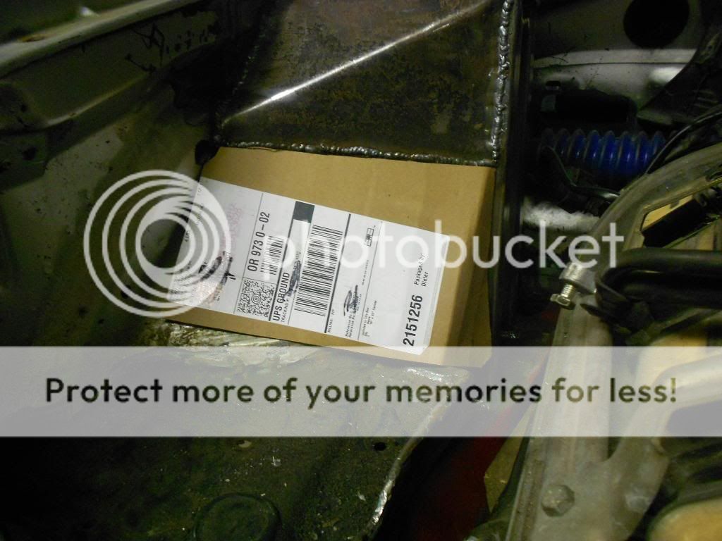

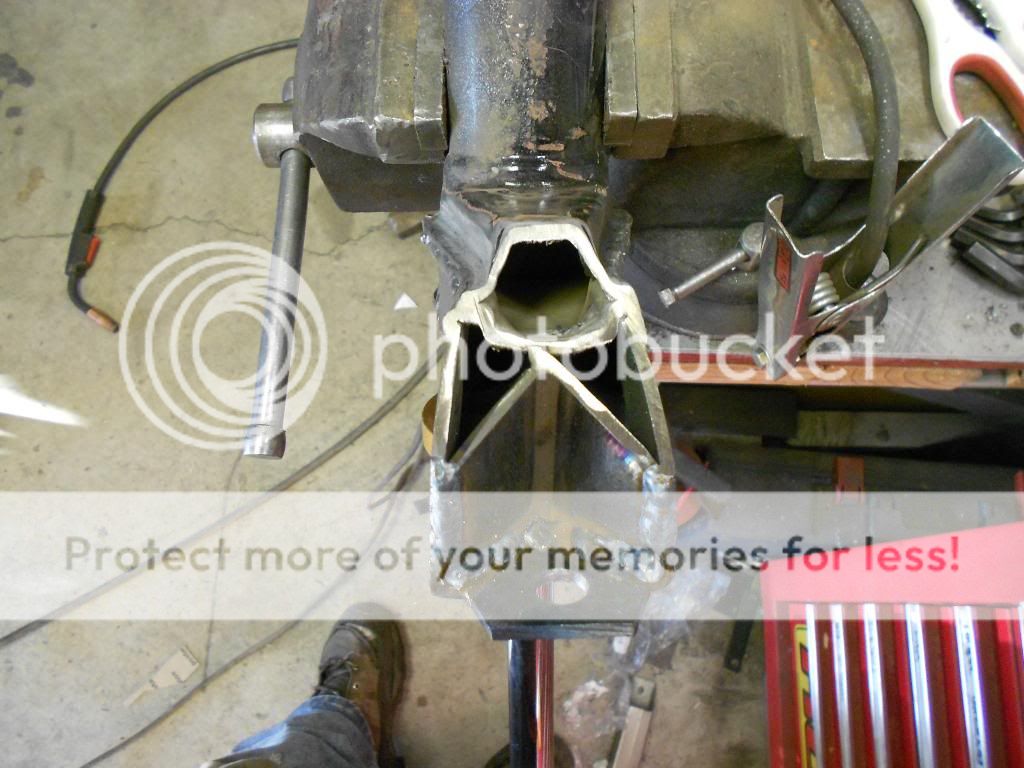

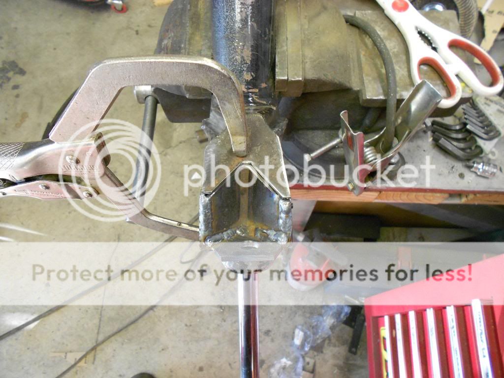

did a lil work on the front strut towers today. one side about 70% done i would guess.

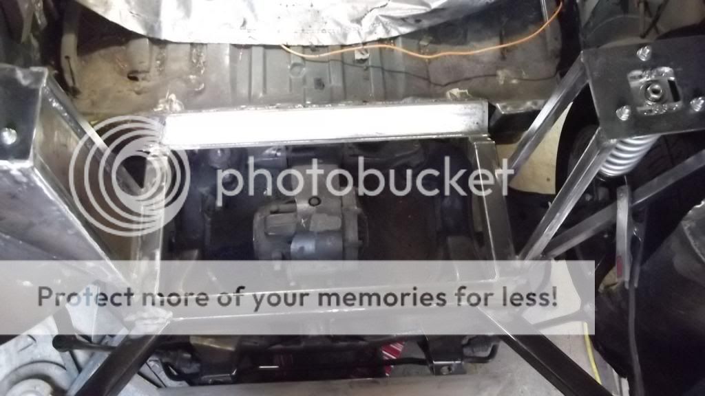

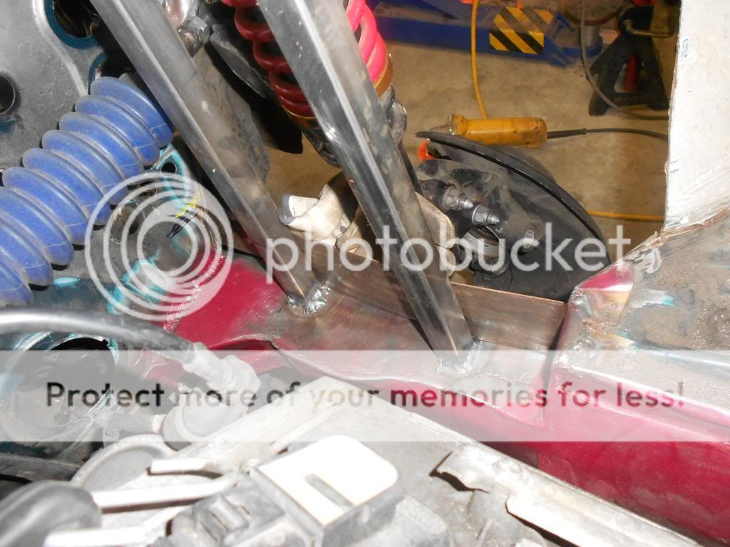

been workin on front strut towers.
its starting to look a lil bit better i think.

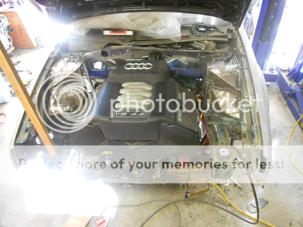

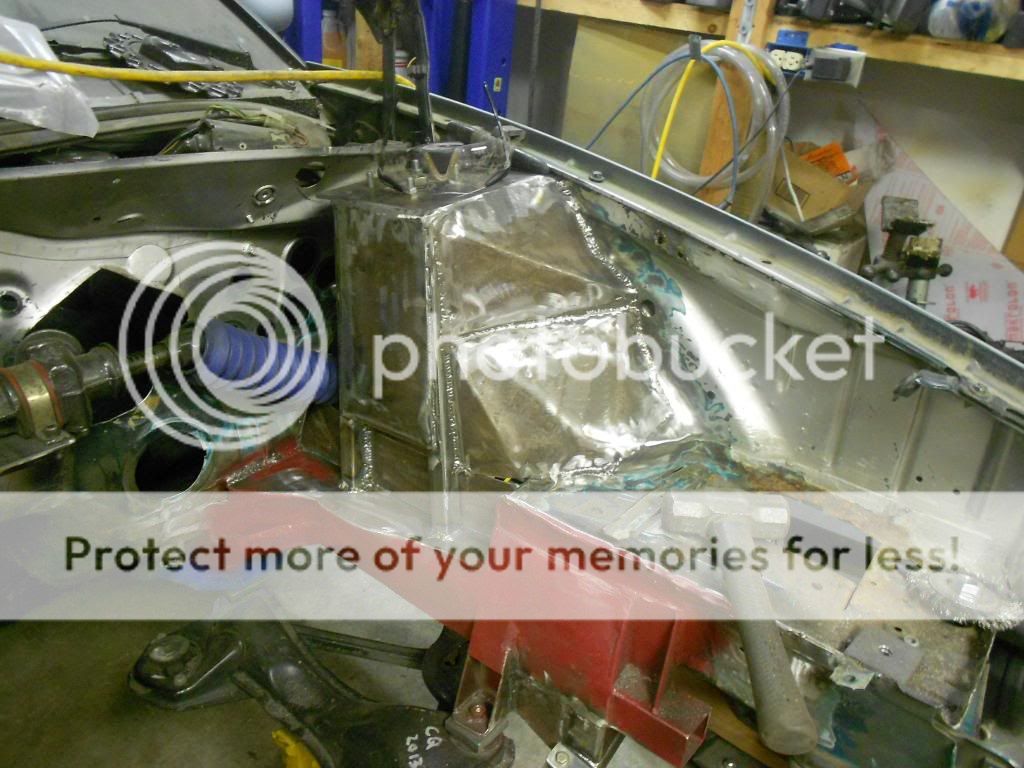

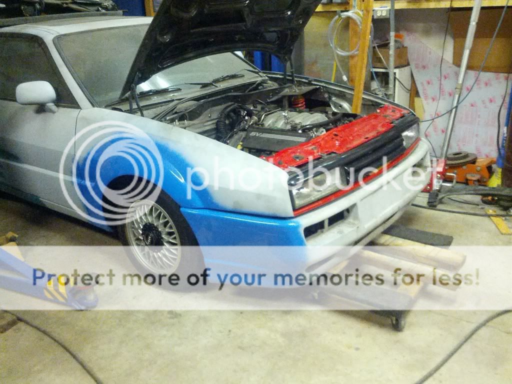

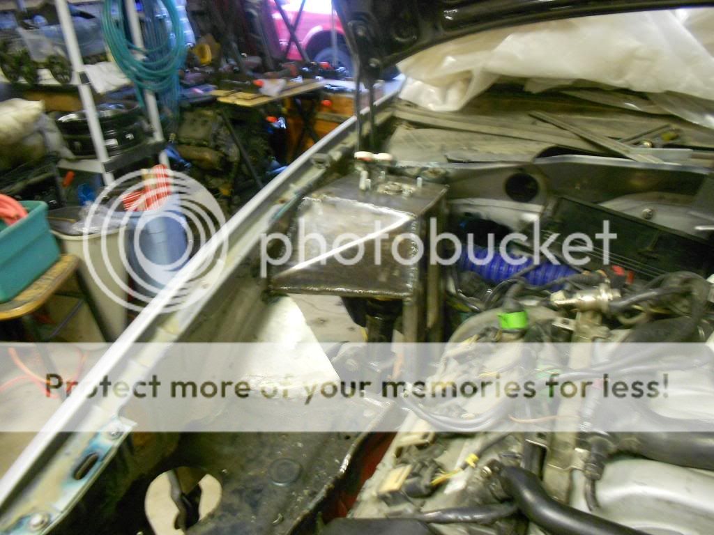

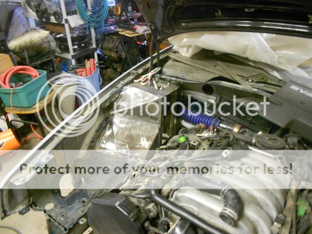

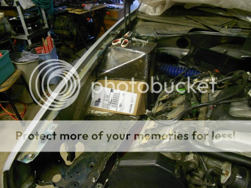

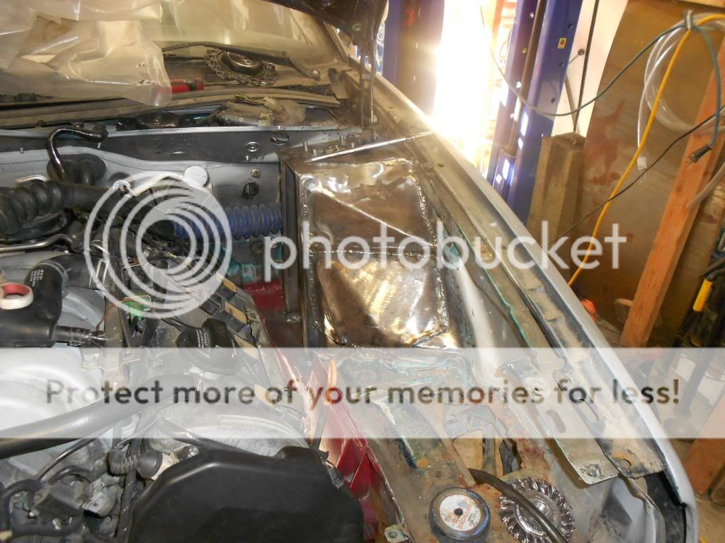

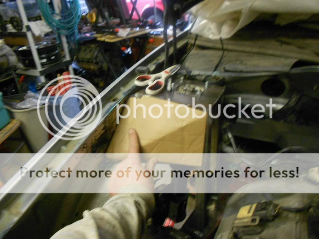

gutted the front end today, pulled motor and struts/hubs. did some touch up welding. just basically out in the garage messin around.

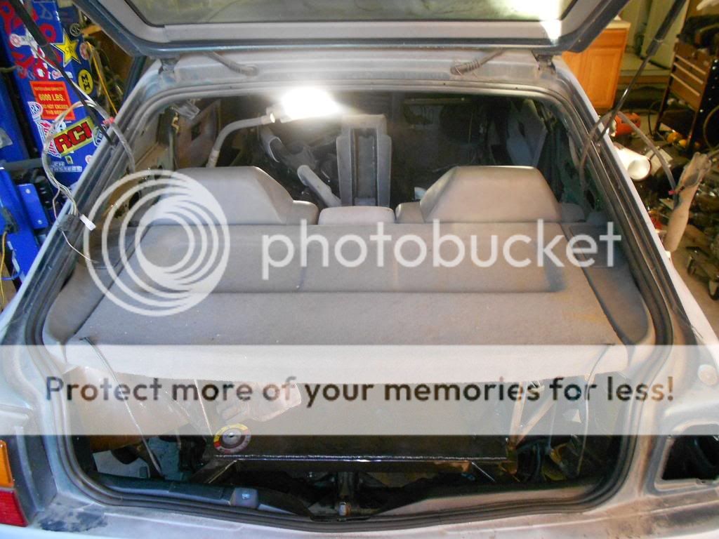

chopped up the front core support some to play with the new headlights. also did some looking into radiator and front bumper, etc. thats gonna be about as fun as integrating the 40v motor harness with the G60 cluster, i think.
and trial fitted the rear parcel tray and side pieces. i think imma be able to pull off this car being stealth inside.
