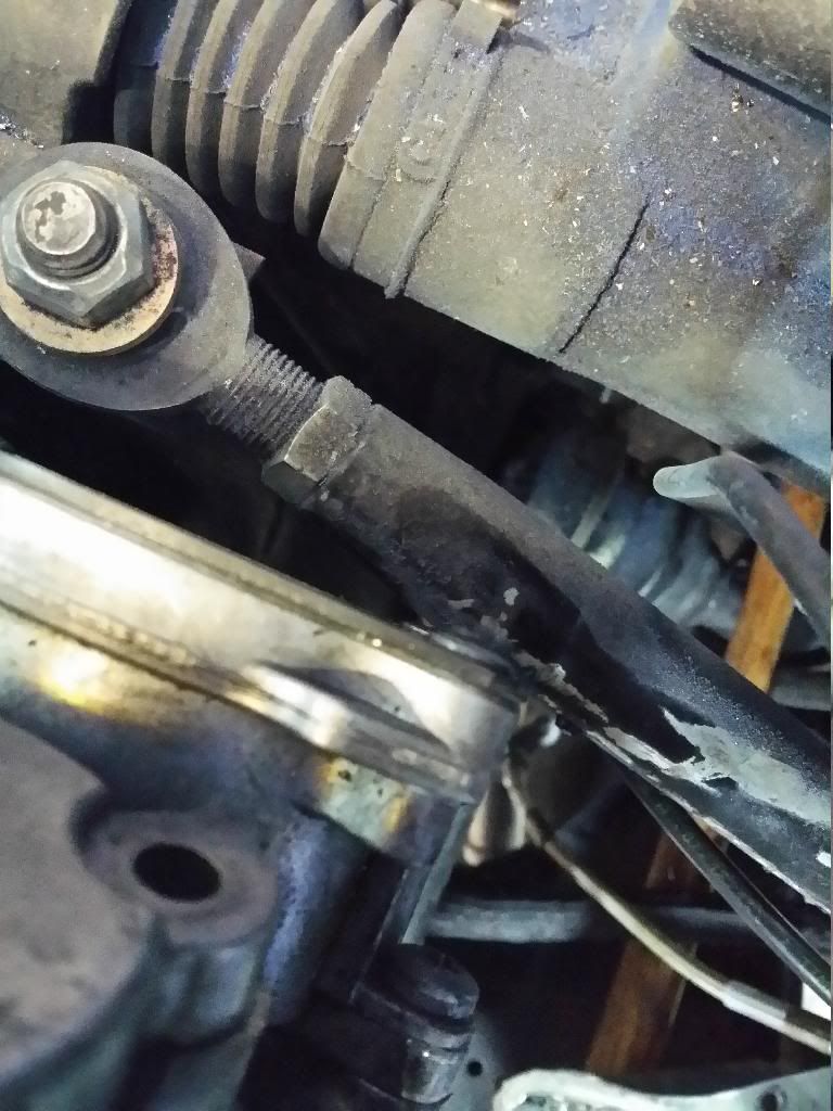

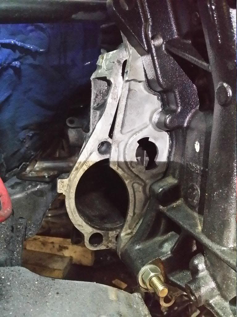

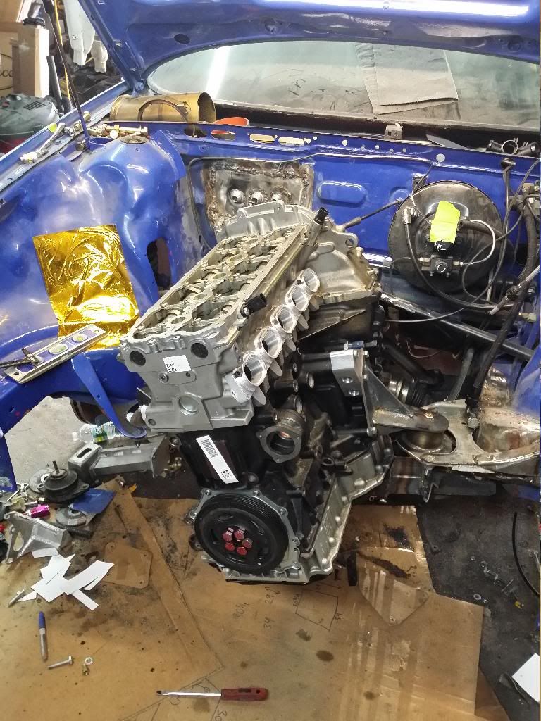

Ok. So we got a motor bolted to a trans. Trans mounted in the car. And the motor dangling from the hoist. I'm doing my best to photo document what I haven't already read on here as I go.

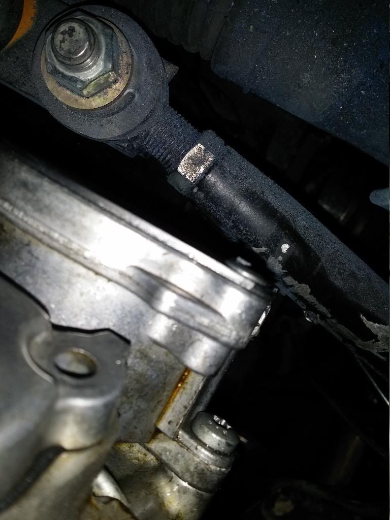

First off. If you keep the stock tie rods in this chassis....b3...I don't see how the vacuum pump will be able to stay on the motor. I have the tie rods modified to be on top of the rack. And I'm still pretty tight here.
Not sure if I'll keep it or ditch it at this point. But it's looking like it'll have to go you can slide perhaps 3 or 4 pieces of paper in there but no more. I was going to modify the tie rods regardless this build so I may see if I can make it all fit.

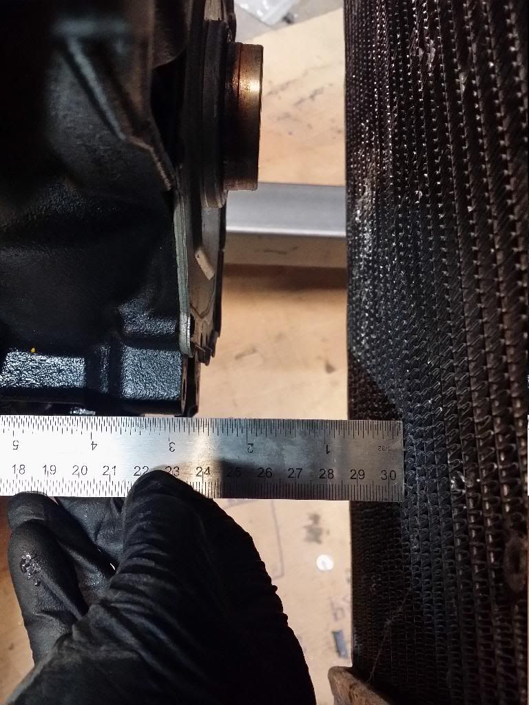

Second. Space I'm front. I bolted back up what I had made for the VRT setup. And it does seem as if there is a bit more room between the engine and the radiator. And with the accessory belt being set back off the crank pulley versus it sticking out like on the vr. I may be able to get a fan in there to pull the air through the rad versus 2 smaller fans pushing the air from the other side as was intended with the VRT.
The subframe has already been cut and welded some to give more clearance when the vr was in there. But it still certainly won't be enough for this motor as you can see. Do I think I can make it work? Probably with some more subframe modifications. But I forgot to measure the ground clearance I would have IF I hacked and dropped the subframe to accommodate the stock pan setup.

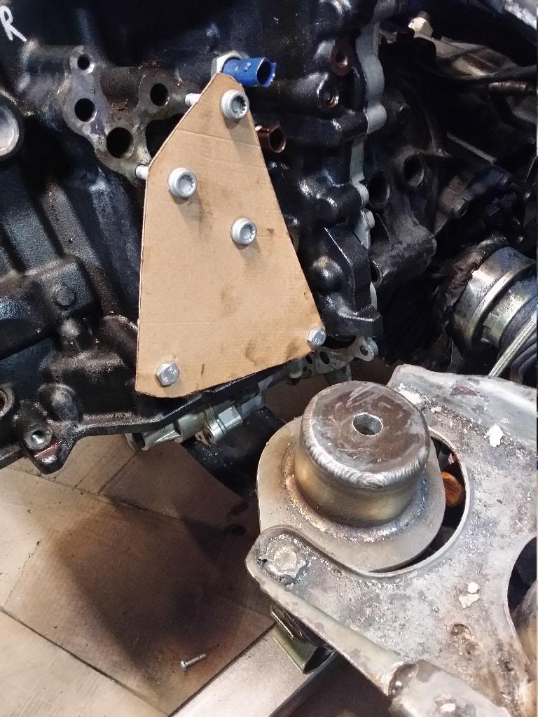

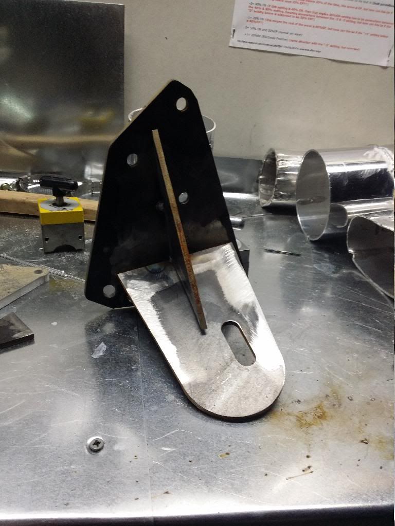

Other then they. We got some mount plates all ready to be water jetted and then hopefully I'll have some much needed parts here this week from the small chassis 07k pioneer himself Hank.

4kq tie rods are close but do clear the vac pump. Thats 01e hank trans mounts shoved back all the way and no spacer on a 4kq prop shaft
Re: Zerb's 90Q...07K it is
Yes that's a late block. And I thought that the 4k tie rods were a different setup...lucky. Can't push this thing back further due to the pump. Can't go forward cause it'll make the front end too tight.

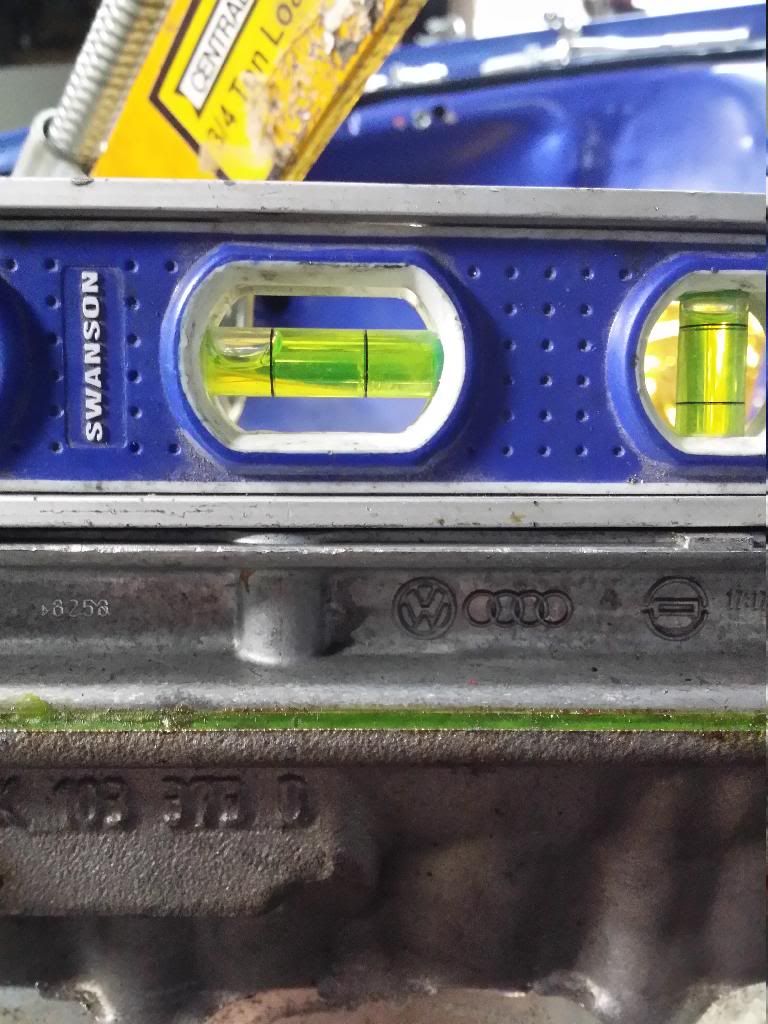

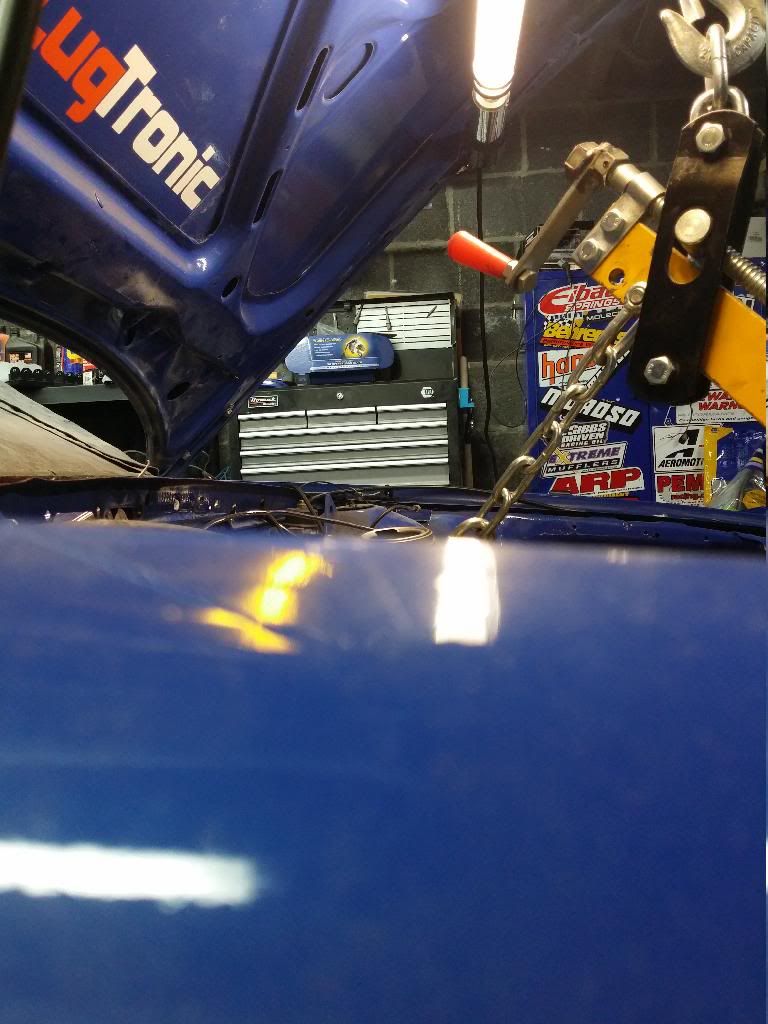

Few questions for you since you've done the swap. How level is your motor? Left side is front of car right side is rear.
Clearance for the hood on the belt side of the motor? What about on the chain side?

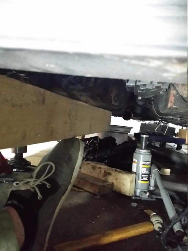

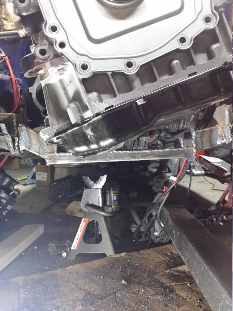

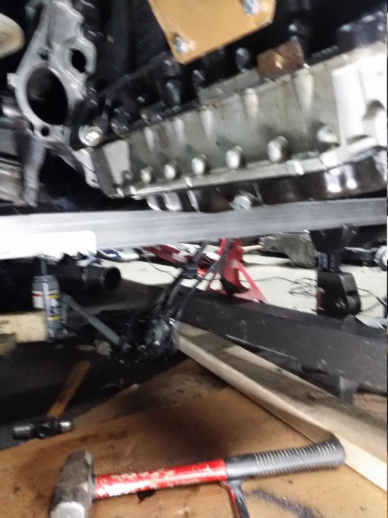

So. Here's some terrible pics of the sub frame process here.
The piece of wood is straight relative to the bottom of the 2by3 tubing. The idea is to chop that tubing and make it 1by3 so it tucks up a bit more. After that it should all clear just fine.

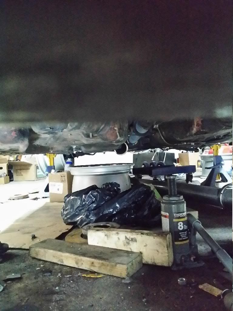

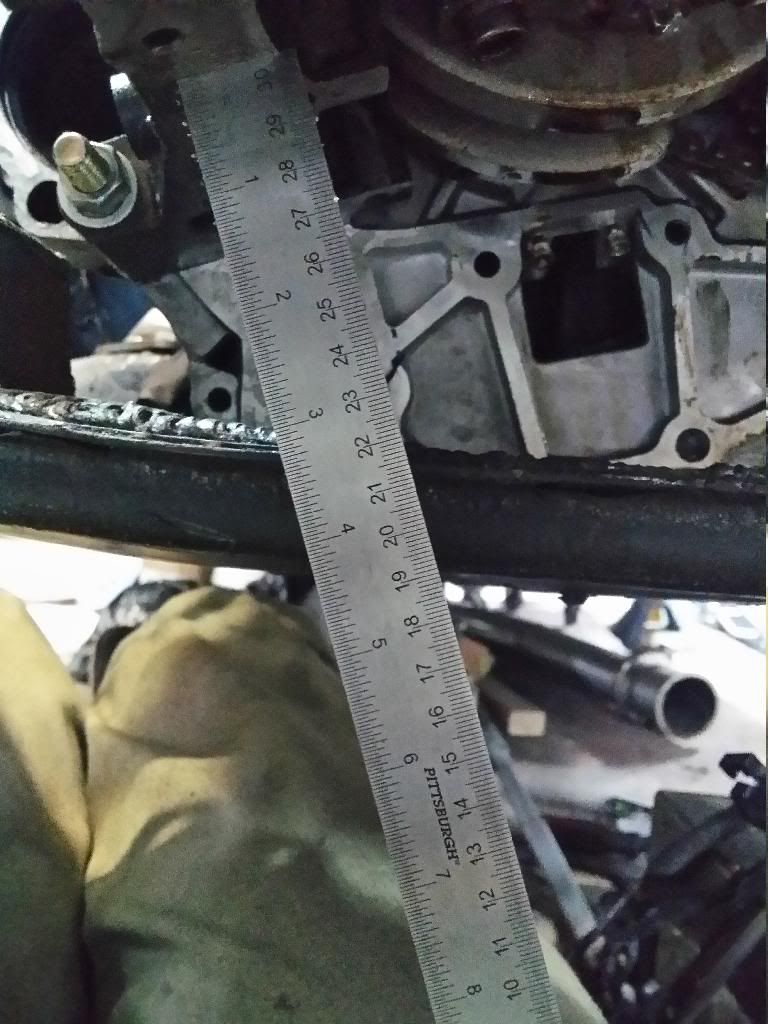

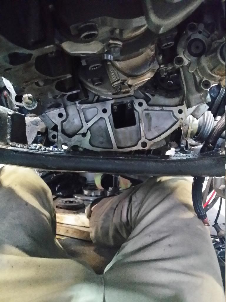

Got the subframe done tonight. Just need to finish welding parts of it. Welds aren't beautiful. Design isn't beautiful. But it fits. And so does the motor with the stock pan setup.
Enough room to slide my hand in there on the passenger side. Which is the tightest spot on these motors. The drivers side has even more room.
Really exciting to see an 07k swap without waiting 6mo for a $1k oil pan, makes it much more appealing as a prospective swap.
Nice job!!
This is kind of what I was thinking, especially with how people flip VR's without issue all the time, but Hank was talking about oiling issues but I guess that's probably a problem with the design of the Iroz pan
the more i look at this picture the more i wish i triangle slotted the tubing and then bent it to the angle it needed, seam welded it, chopped it for the angle to meet the subframe, and welded that, it would have looked much cleaner and probably been a bit stronger too. oh well.

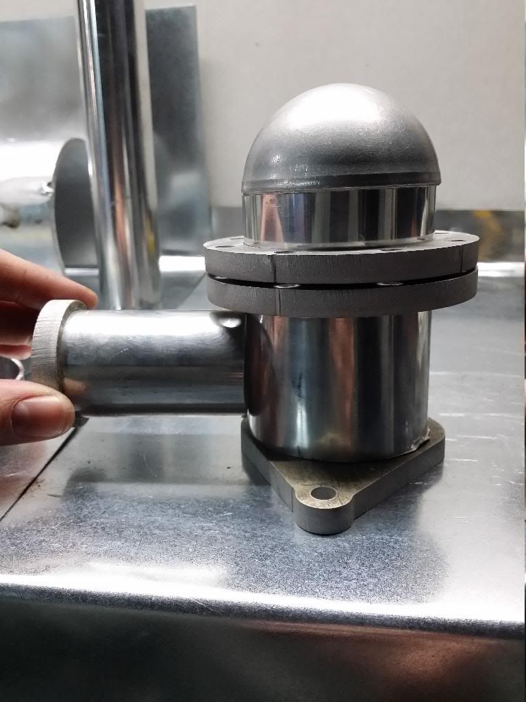

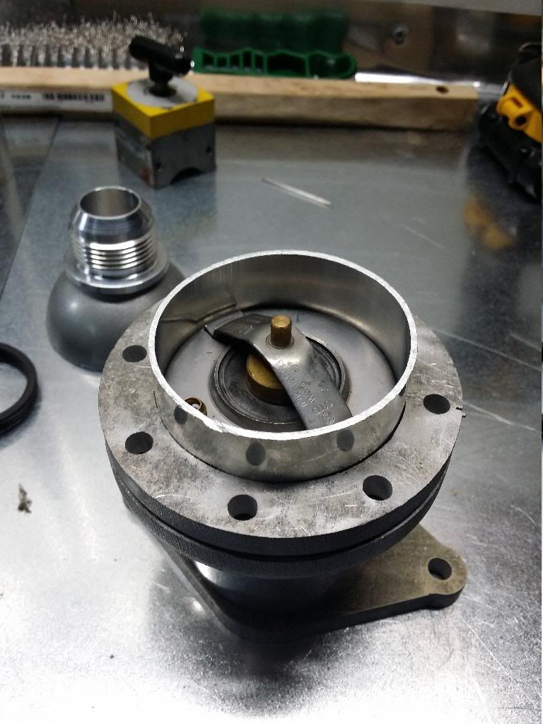

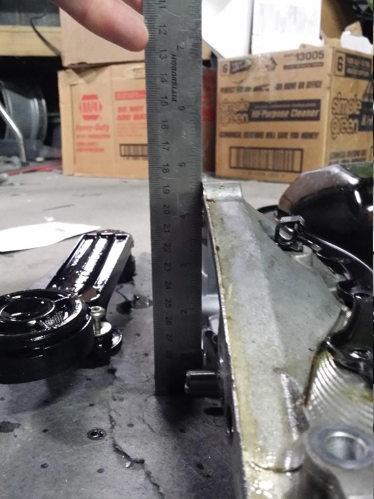

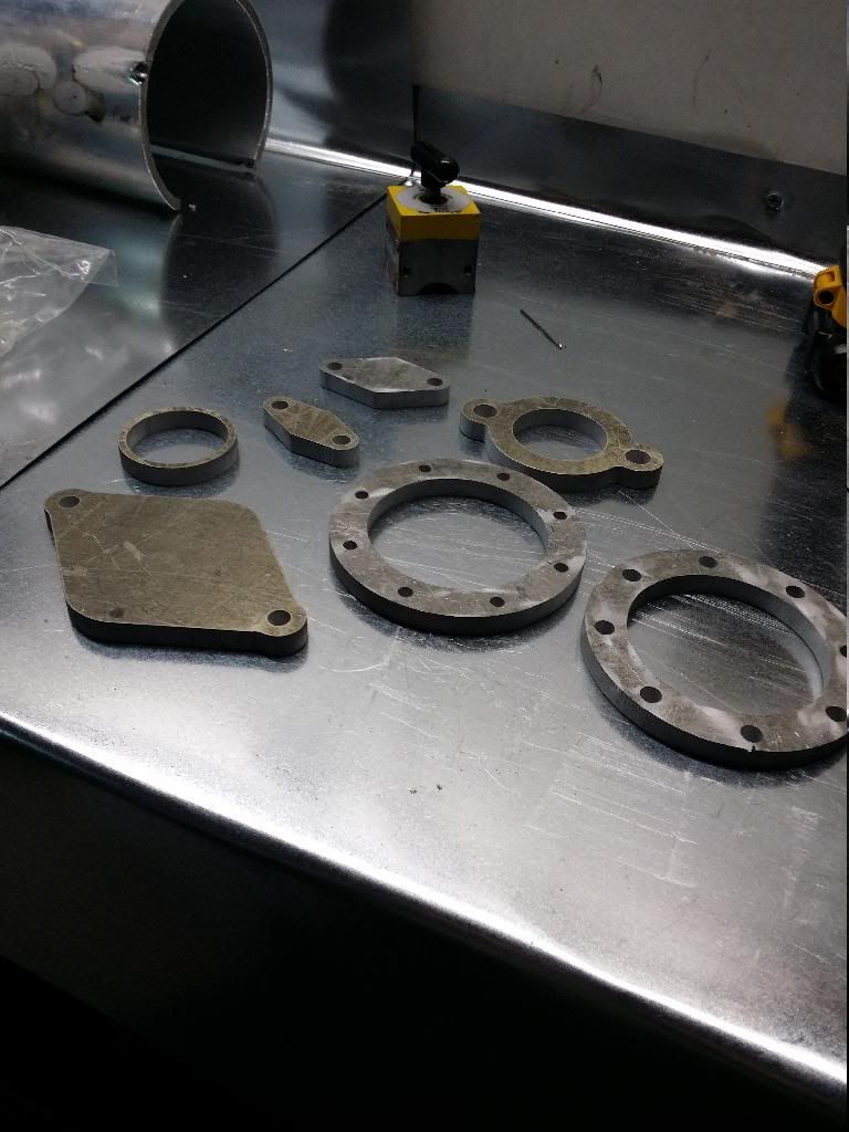

So. Got some pieces from the waterjet for my aluminum thermostat housing setup and the flange off the head as well.
Everything fits up well. Including on the car. Will need to trim a bit of the back of the accessory bracket for the water pump feed tube. Other then that we should be good to go.
Sent from my SAMSUNG-SM-N900A using Tapatalk

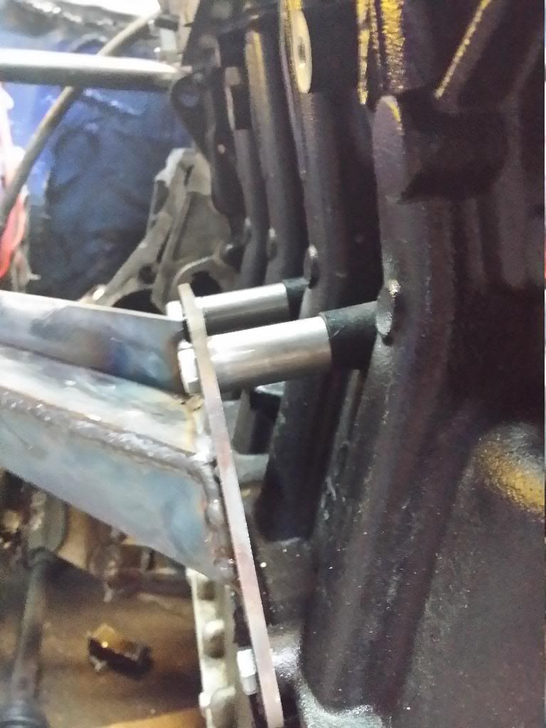

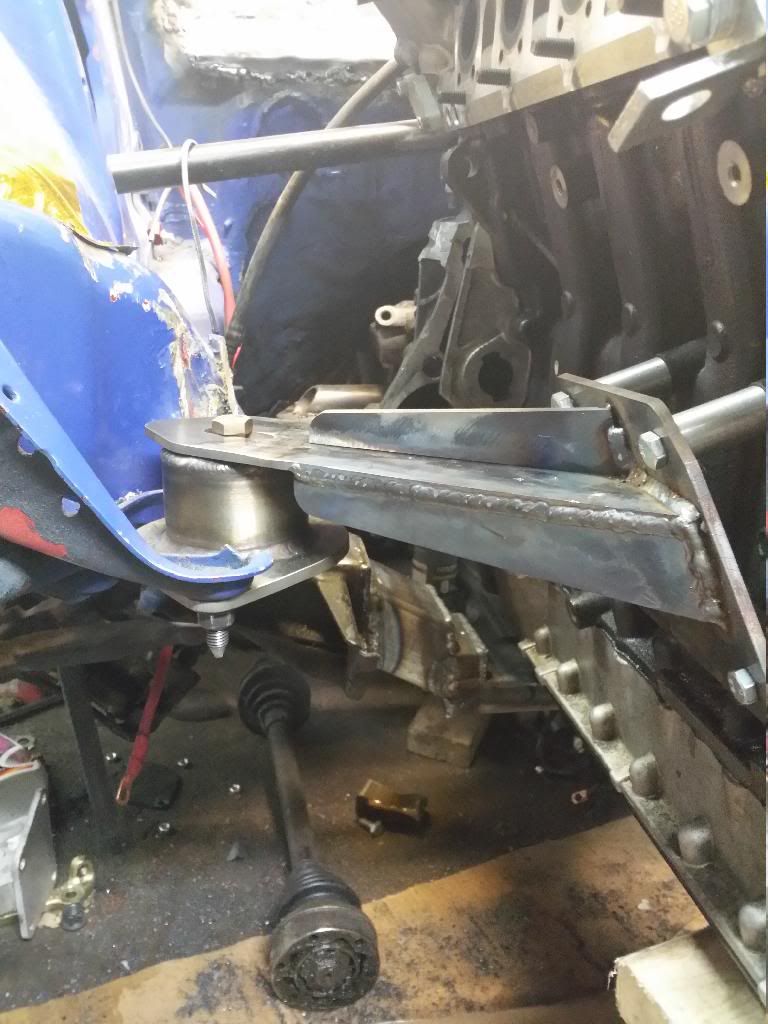

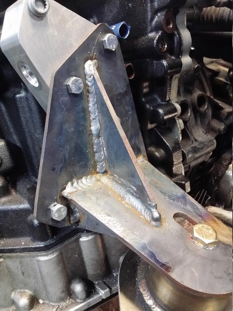

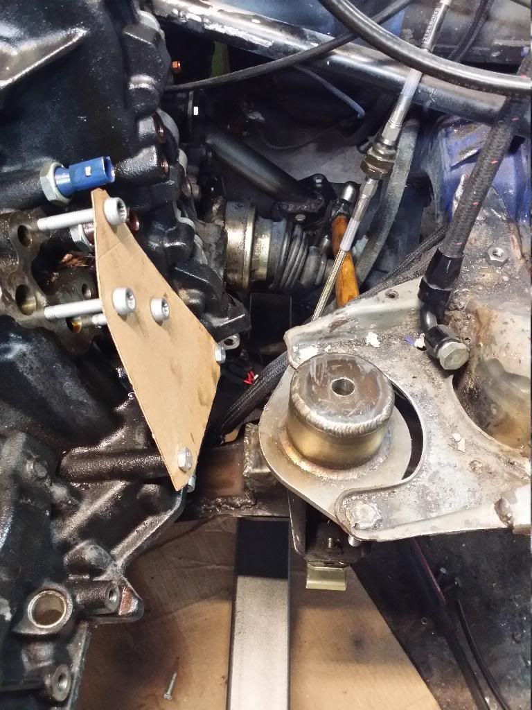

Got some motor mount stuff done this evening. Ran out of gas. Went to store and got a bottle. Came back. Welded some more. Ran out of wire. Tomorrow I shall finish.

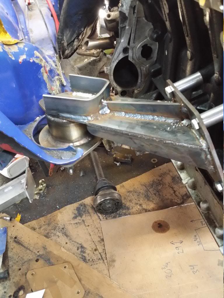

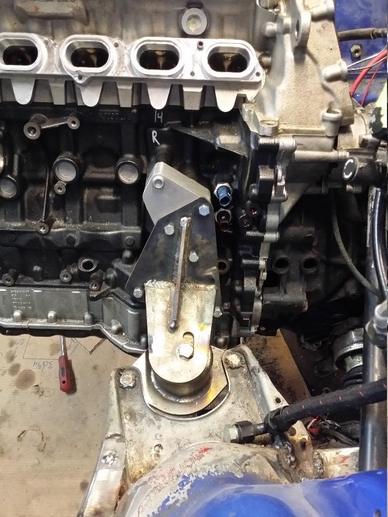

Re: Zerb's 90Q...07K motor mounts

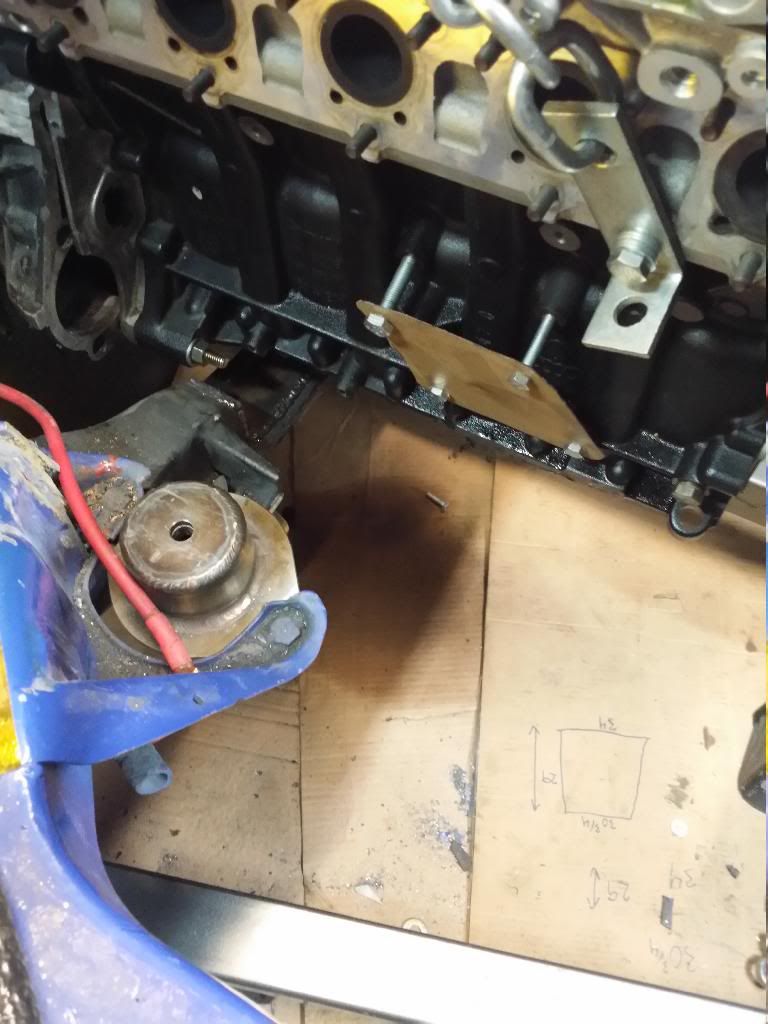

And. We have a motor bolted in and mucho fabricationo shall commence shortly.
This is obviously not the final rendition. I will grind down and round out the edges on the ends there.
