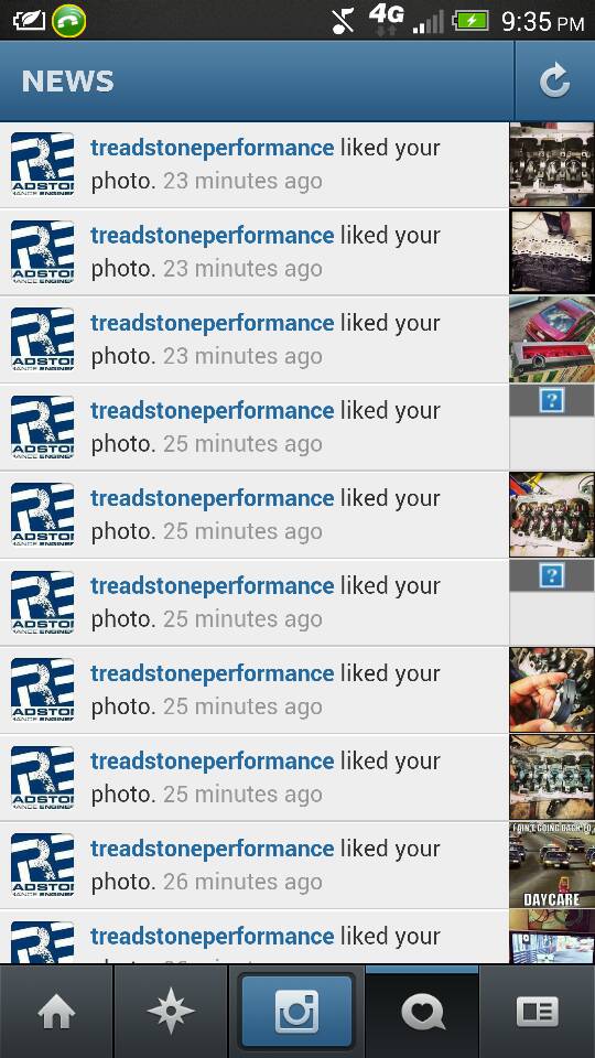

Someone at Treadstone has definitely taken notice of Rubi's build on my instagram... Pretty cool I guess...

it must be done if you have time for instagram
Re: A tale of Rubí... Top Assembly Commences w/PICS
I blast instagram and TPP pics at the same time... Todays post will be more meaningful... Buildwise... I promise...

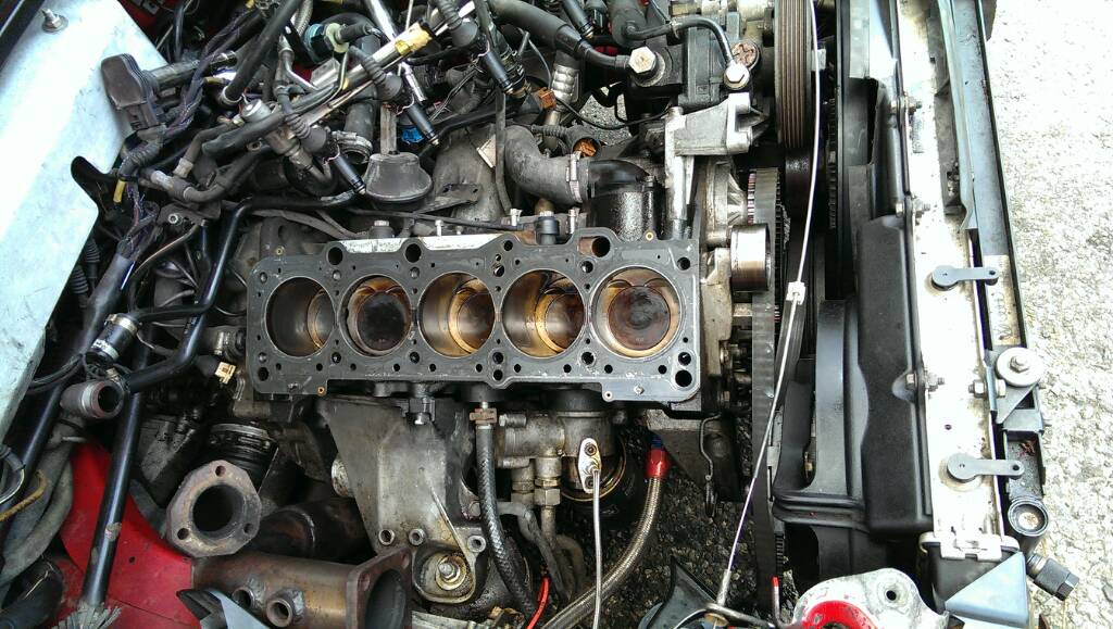

Head, intake, downpipe all unbolted ... Just need to pull it off then came the rain delay...

Looks like you wont be running a cam sensor..what trigger setup will you use?

da_trem wrote:Looks like you wont be running a cam sensor..what trigger setup will you use?
Actually I will... I just threw the 7a cam gear to time it up against the valve cover...

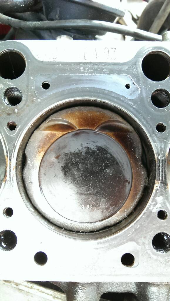

Cylinder 4

HEY THAT LOOKS LIKE DET, JUMP ON THE DET TRAIN WOO WOOOOOOOOOOOO
Or did the hg fail through cylinders? Can't see shit on my phone.

That is some bad detonation. Whatever you do, don't run that same tune on the new motor.
What do the rest of the cylinders look like?
ouch! I bet that t04e was scooting around.
