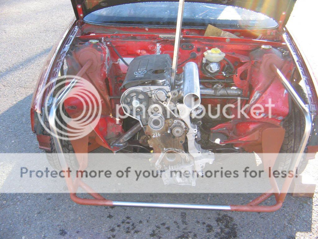

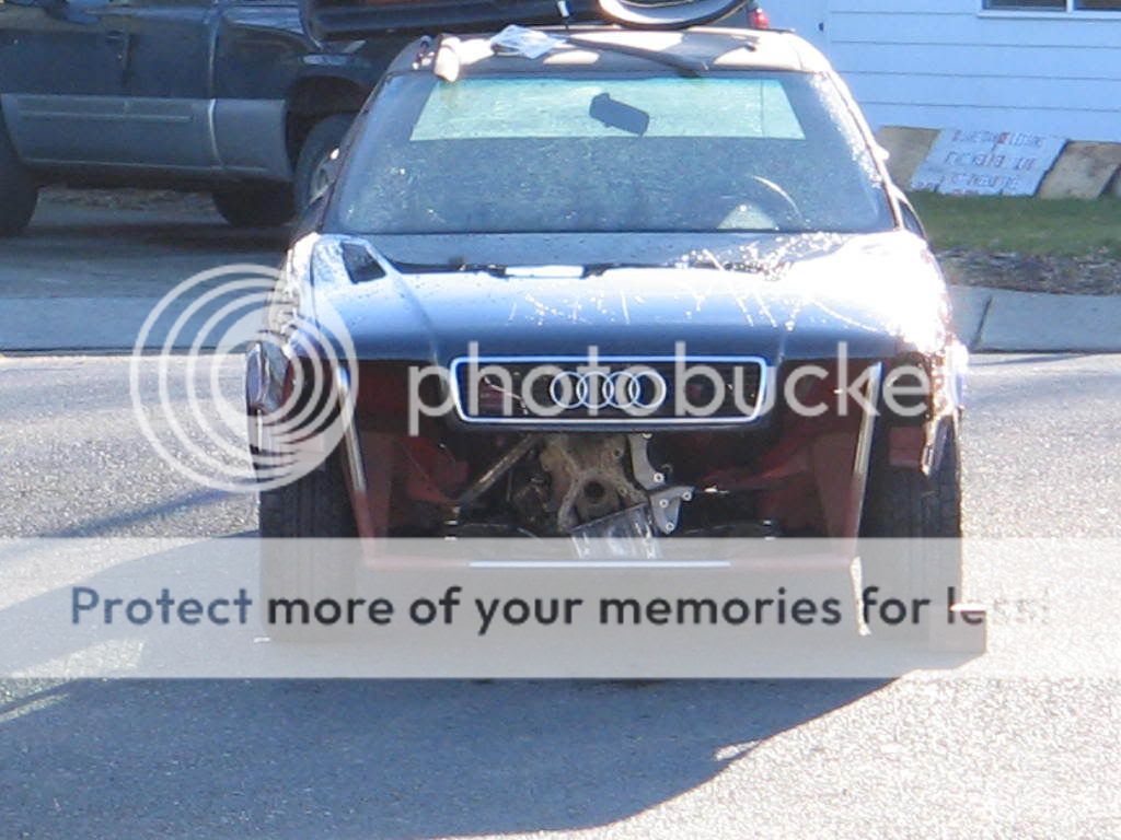

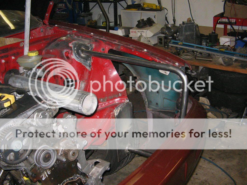

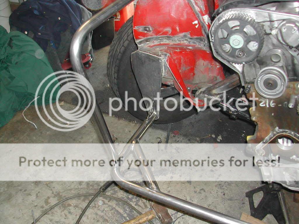

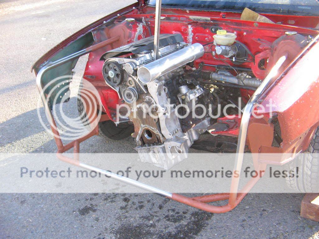

so. i have been digging away at the front end framing. i put some doubler plates on the strut towers. the pass side is a big divot there, so i used 1/4" plate there. driver side sits flat, so i used 1/8" on it. had to contour it just a little. heat it and beat it haha.
i dropped the frame rails down low with 1/4" plate as well, as i wanted the crossbar pretty low and out of the way. it sits even with the bumper skin on the inside now. tomorrow i am going to gusset each intersection, and trim those drop plates to a Vee. also, going to gusset them back to the framerails on the backside as well. corner bracing on the lower hoop and may incorporate a small snub mount.
the passenger motor mount is also engineered and 2/3rd's done. just need to do the driver side and i am all set.
tab off the side bars for some fender mounting points. make the upper core cross beam. make the strut tower cross beam. cut holes
:( in that super nice hood for the aerocatch flush hood pins. and make tabs to mount the bumper.
a craptastic event happened. just got the bumper back from my buddy with fressssshhh paint. just need(ed) a color sand, buff out. and it slipped on the jackstands and scratched it up pretty good on the lower front. i can live with it, but he is gonna be bummed. he will want to repaint it just cuz thats him.
well, enough blabbering. on to some pixorz.

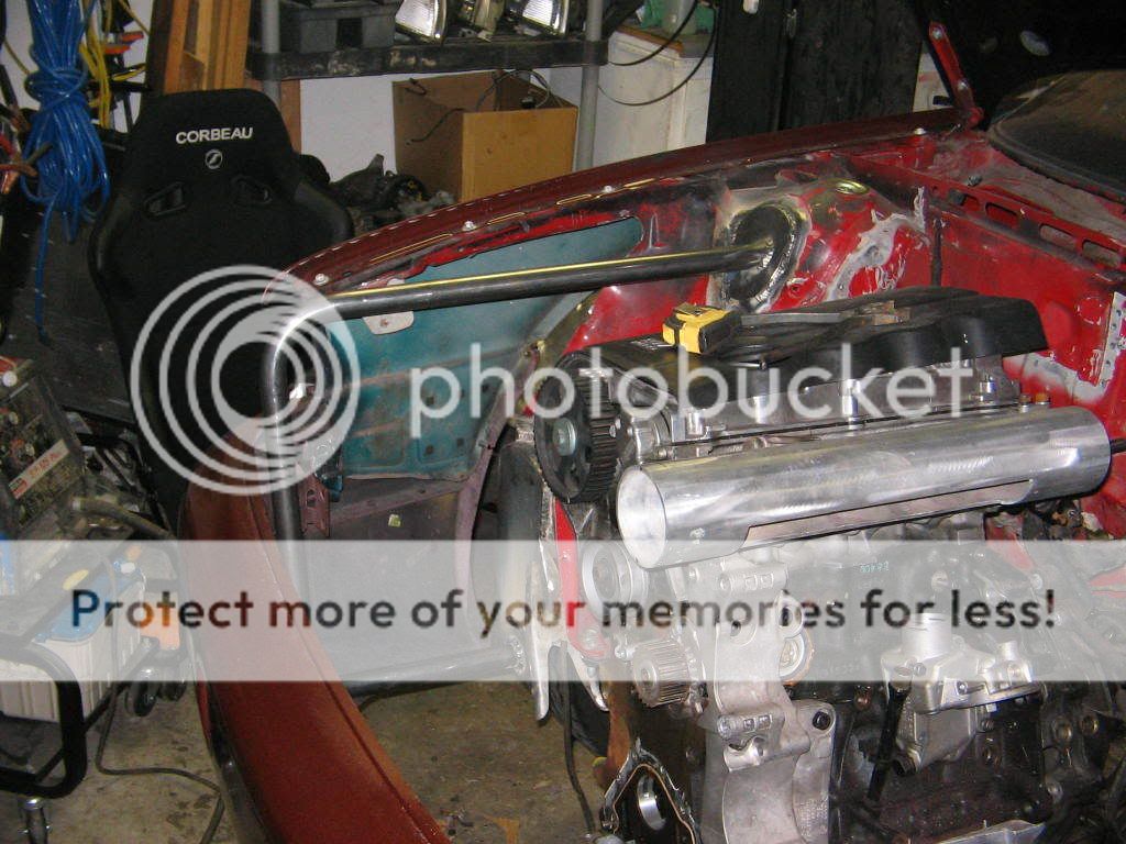

oh ya gotta trust me

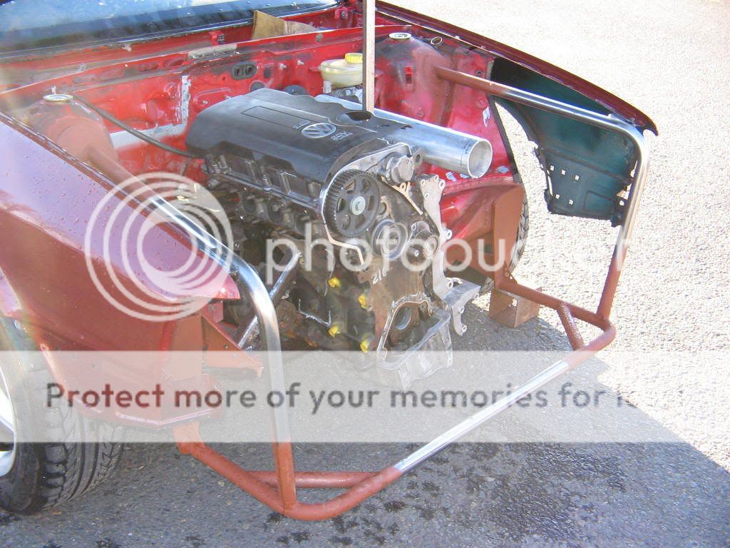

i played plenty with all this as i did it. checked the hood clearance every single step. i built it with the fenders and bumper in place.... see 3rd and 4th pix... the tube is just under the fender rail where it mounts to the OEM fenderwall.
i actually was getting kinda tired of shutting and opening the hood so much. but i gotta make sure of it before i do it. ya know?
so yeah, no worries. and its strong as hell, too. i over build things on occasion. well, all the time i think. but rather be over than under built.
and dont mind that intake sitting on there.... its just messin around action.... seein whats to see, ya know? that was left over from a different 20v 4cyl project we did awhile ago.

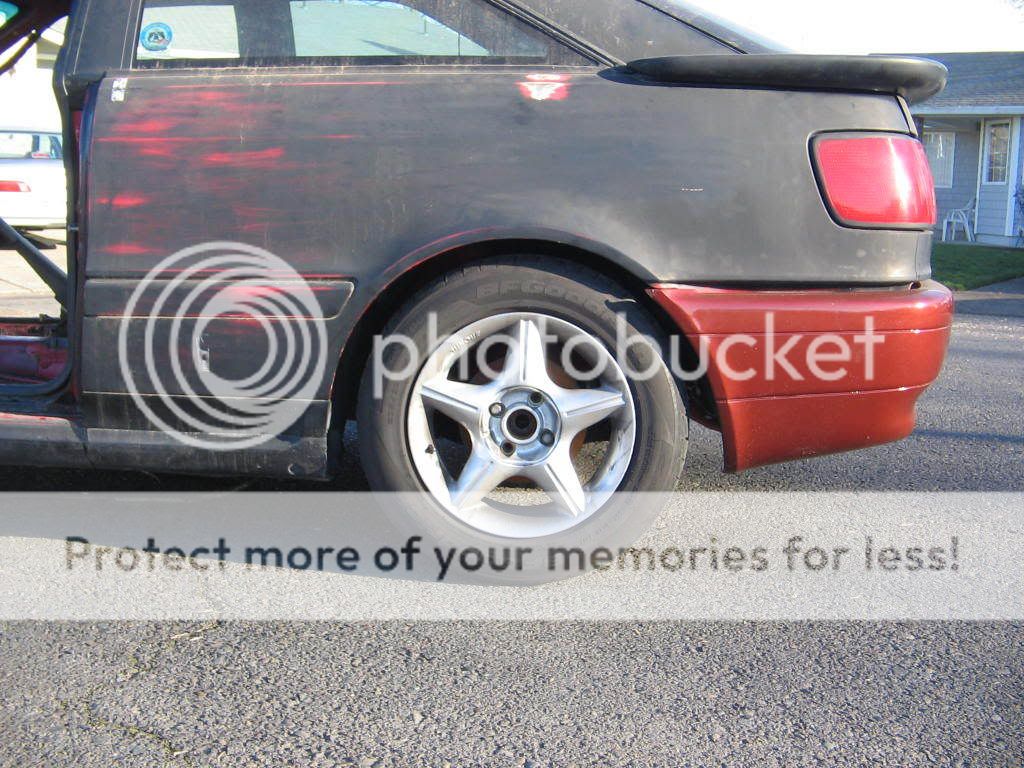

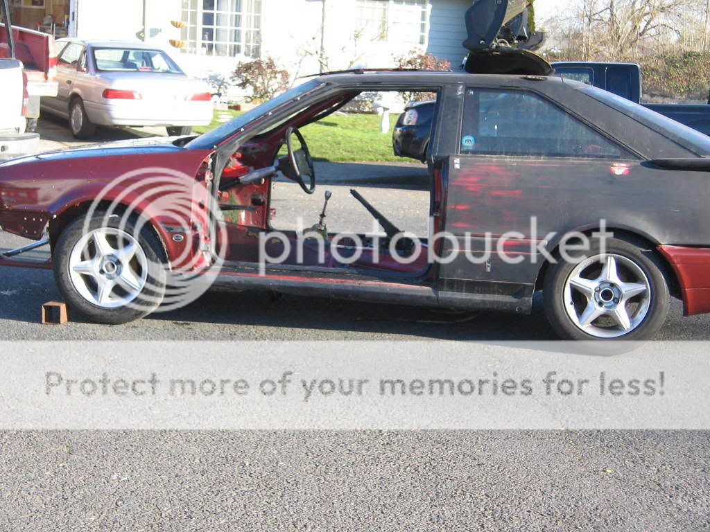

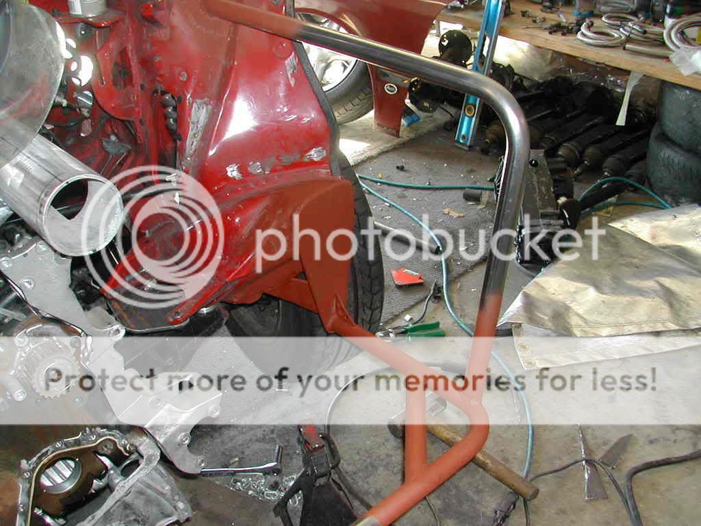

updates. still gotta make tabs for bumper and another one for the lower fenders. but the plating and gussets are in place. with me jumping on the front end, it goes nowhere. sturdy as hell.
and it could just be me, but this does not feel like 2500 pounds rolling around. i am no Mike Toxcheap, but i am not a little guy... pushing it around is easy. piece of cake.
i also tossed in the manual steering rack, so i could push it around. little more work to do there and it is finalized as well. gotta make a driver side motor mount, but with just the pass side it is sturdy as can be.
i am done for the day, i think. i am gonna clean the hell out of the garage while it is outside. but i gotta play plumber on my big reef setup. my chiller stopped working and i have to take it out of the loop so i can have it looked at. and re-route one of the drains as well.

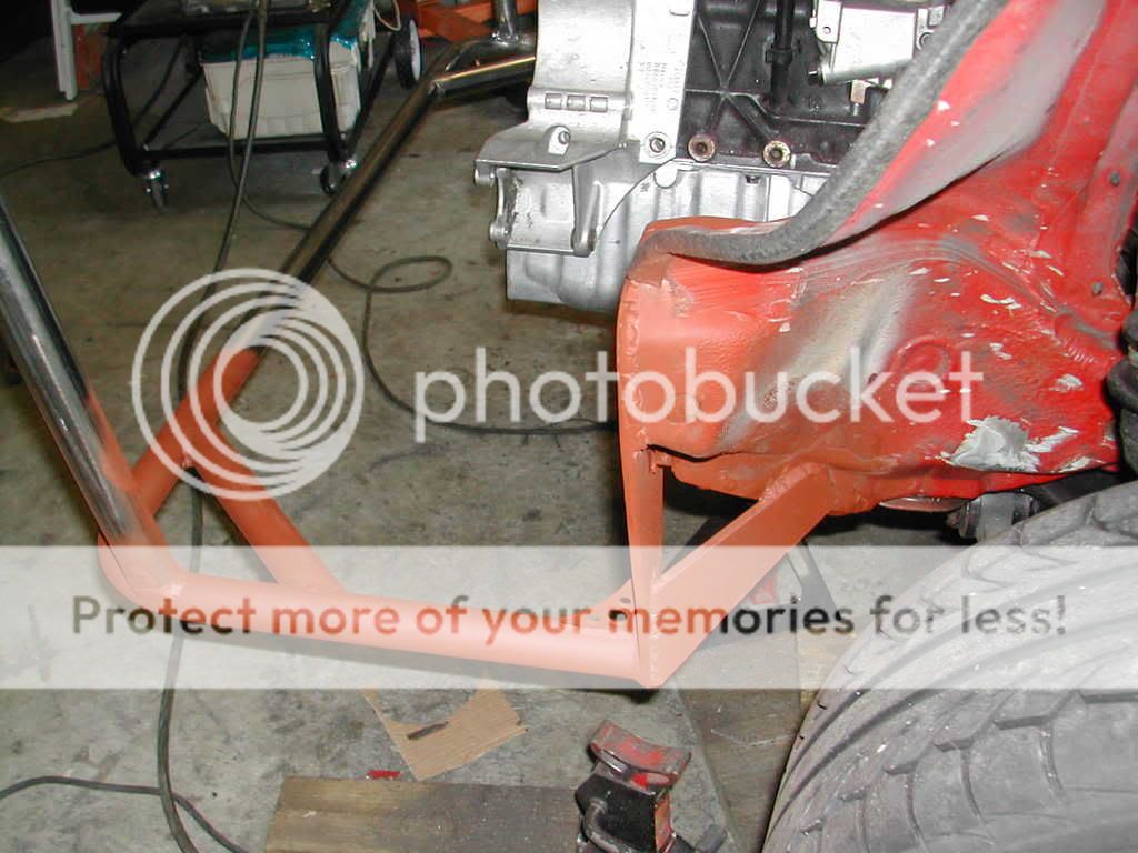

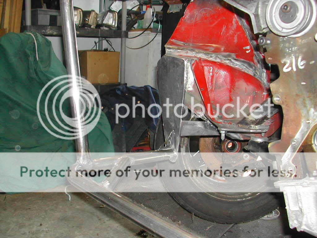

and some detail of the gusseting. went back to the framerails on the back side with 1/4" plate. actually used the drop pieces from Vee'ing the drop plates
nothing like material management haha.
and i bought a tube notcher setup in prep for making the cage, it works decently. and the cute little gussets with the holes i got with the roll cage, i used a couple here.... and i am leaving the wide open spots on either side for the turbo and the fuel cell, etc.

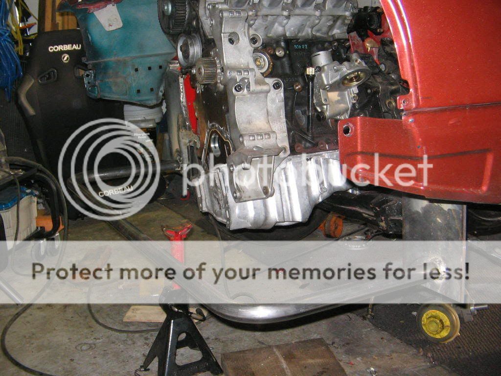

oh yes, Johnny my friend. it is going to be twin scroll goodness. with two Tial MS-V v-band 38mm WG's. and it will have just a short length of 4" pipe run out the fender probably. i think the turbo will go low, and the 5" inlet will be facing the openings of course.... i im tossing about the idea of running it inside the fender, and out high by the door gap. coated pipe and wrapped for heat protection. we will see when the manifold is made.
but that is definitely the plan. that whole area on the pass side in there is for manifold and turbo, WG's. why i did what i had to with the tubing
i held that big thing in there and was like "WTF???" scratching my head thinking its not gonna work.... bahhh, cut out whats in the way, it'll work
