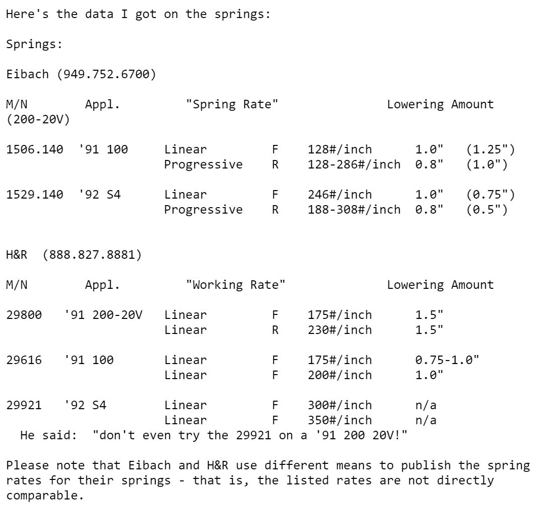

For those who have gone the DIY coilover route, what spring rates did you run, and what are your impressions of them? I know Chris recommends 450/550 lb/in, which is what I'm favoring, but at the same time, I accept that this is no racecar. I think the perfect setup for me would be just soft enough that you could take a non-car friend on a slightly bumpy road with a few potholes and such without them noticing a harsh ride. I'm just wondering if that's possible with the recommended setup.
I'm considering ordering springs somewhere in the upper 300/lower 400 range, with an appropriately-valved damper. Any thoughts?
Re: Kevin's 200 20v
Yeah... That's not going to happen with the rates I recommended. What did you think of Corey's setup?

Corey's are 200 20v H&R springs with either Koni sport or Bilstein sport with regular valving. I found some strange information related to those spring rates... this is an old excerpt from some forum. It's odd that they quote the rates in #/in, but they are not directly comparable... I'm thinking the H&R rates are true lb/in, and the "OEM" Eibach's are not.
My 635csi has 375 lb/in springs in the front (which is a comparable suspension design to this car as opposed to the rear which is not). That car is more of a grand tourer, so I didn't want it super stiff, but I did want it to be sporty. I think it is a good mix of comfort and sporty, leaning a little more to the sporty side. This is something I have to consider for my avant too. I need it to be somewhat comfortable going "offroad" and on bad highways, but I also want to keep it pretty sporty. To that end, I might either just go with whatever the H&R rates are (like I said I would do earlier in this thread), or up them a bit to 300/375 F/R or something like that (so I can utilize some springs I already have).

Damn good info Chris, thank you! I'm sure a lot of this comes down to the dampers as well, but it's good to get a rough sense of what I'm trying to achieve. I'll probably order something in the 300 range, given what you posted.
Before I finalize anything, though, I'd like to get better acquainted with suspension setup and tuning, which will require reading up on some literature. That way, (hopefully) I won't be making such blind guesses with regard to part combinations! I will, as always, post my findings, if any.
