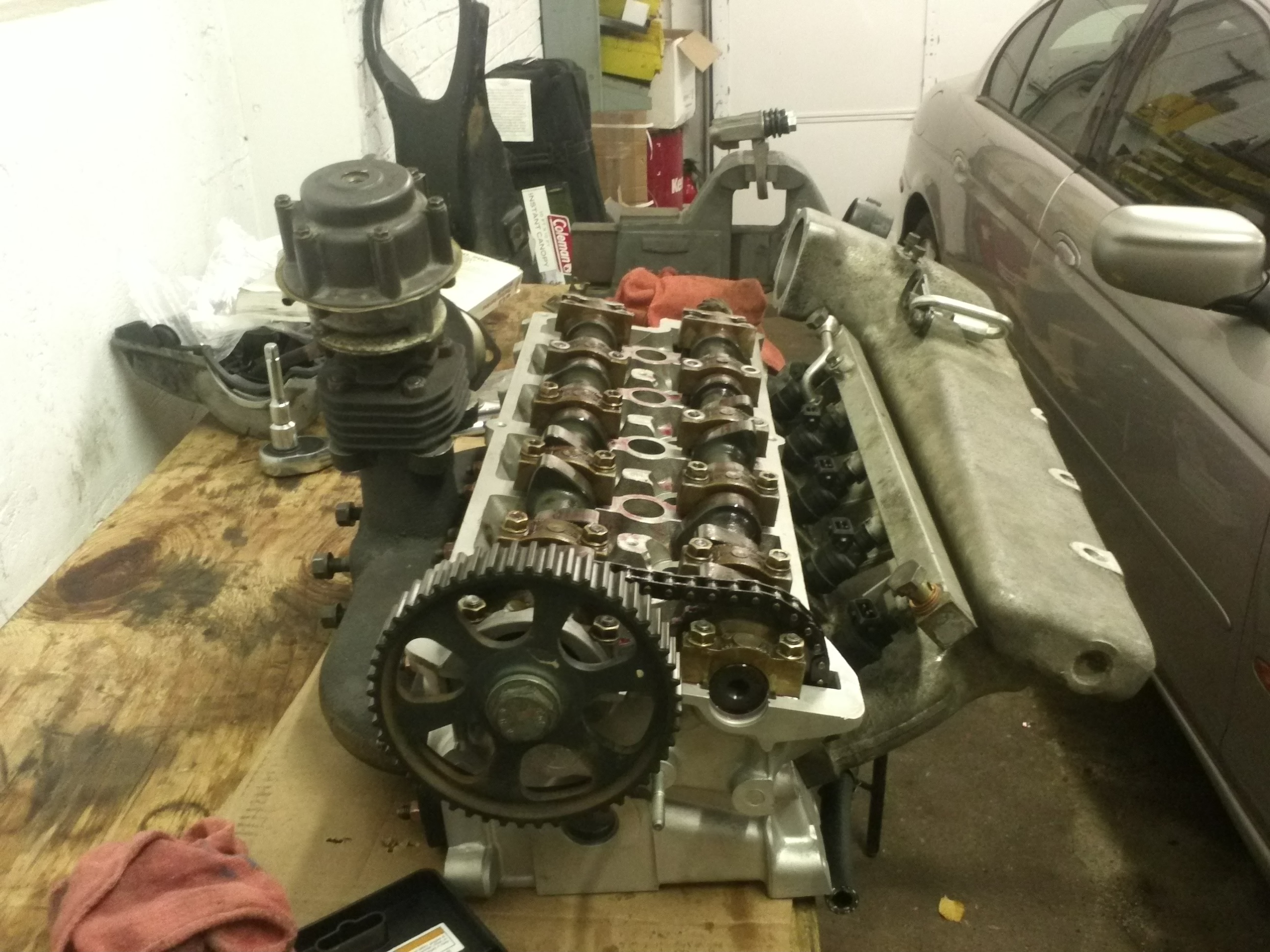

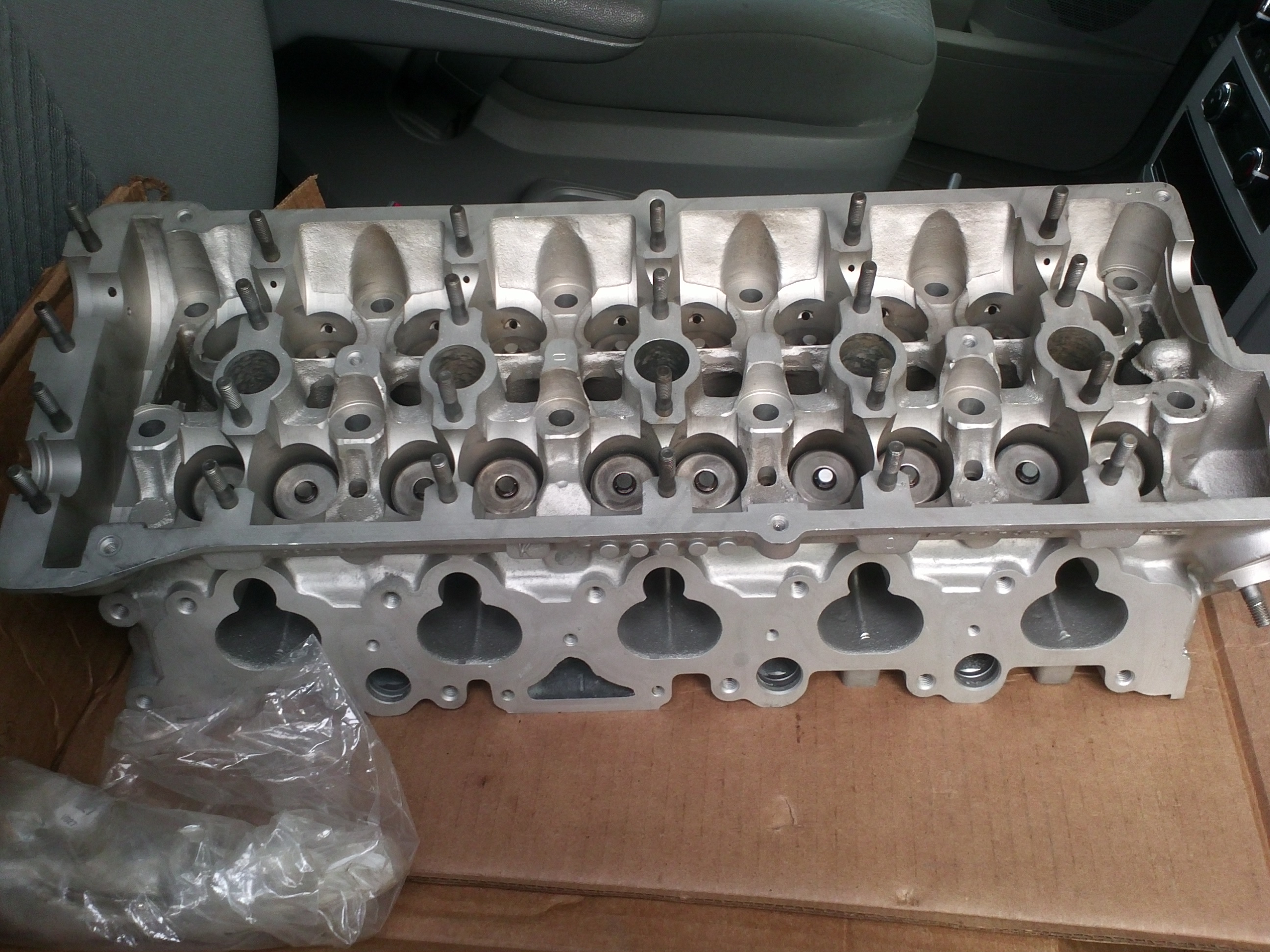

This thing is so.... Beautiful haha. The shop owner said they checked all the valves according to the Bentley page I showed them and they all checked out
it did look as if they ground the stems on some of the valves. 11 guides were replaced and the total Bill was freaking $515. The milling was the cheapest on the invoice of everything!
My retarded mechanic acquaintance says I can't use anymore tools or the garage bay until I pick up and organize the tools the mechanic that he fired didn't put away. I said ok I'll do it all night Monday, since I plan to have the car done tomorrow lol. He can get fucked with his attitude
it did look as if they ground the stems on some of the valves. 11 guides were replaced and the total Bill was freaking $515. The milling was the cheapest on the invoice of everything!My retarded mechanic acquaintance says I can't use anymore tools or the garage bay until I pick up and organize the tools the mechanic that he fired didn't put away. I said ok I'll do it all night Monday, since I plan to have the car done tomorrow lol. He can get fucked with his attitude

He was referring to valve guide play when he said "valve play"
Seriously get this done and back together. Spend all the time getting it done if you have too lol.
Let's go!! That thing looks cleeeeean. Here's to this being the last of your unexpected problems.
Aktapod wrote:Let's go!! That thing looks cleeeeean. Here's to this being the last of your unexpected problems.

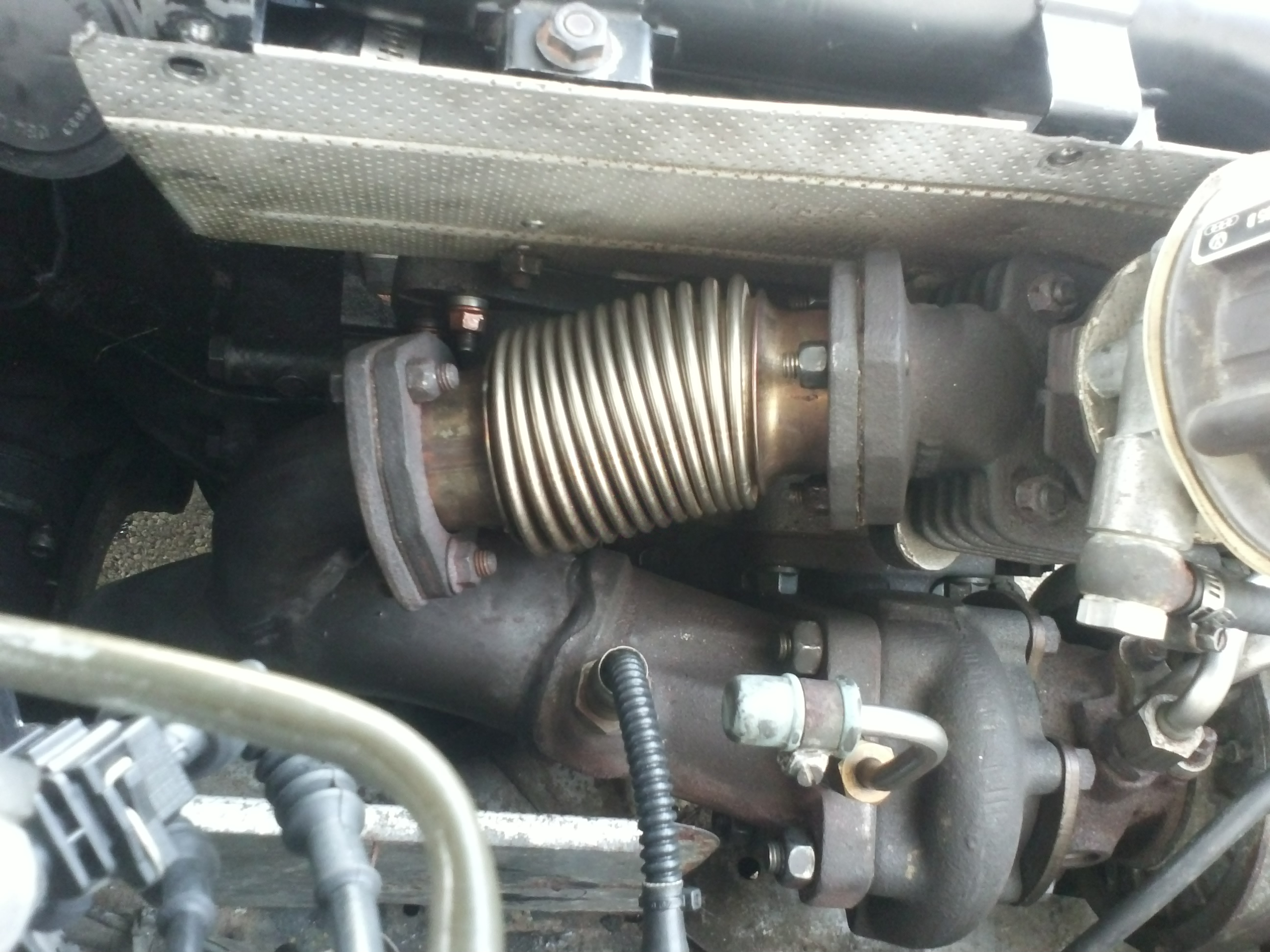

Now that's a tweaked WG flex pipe!
