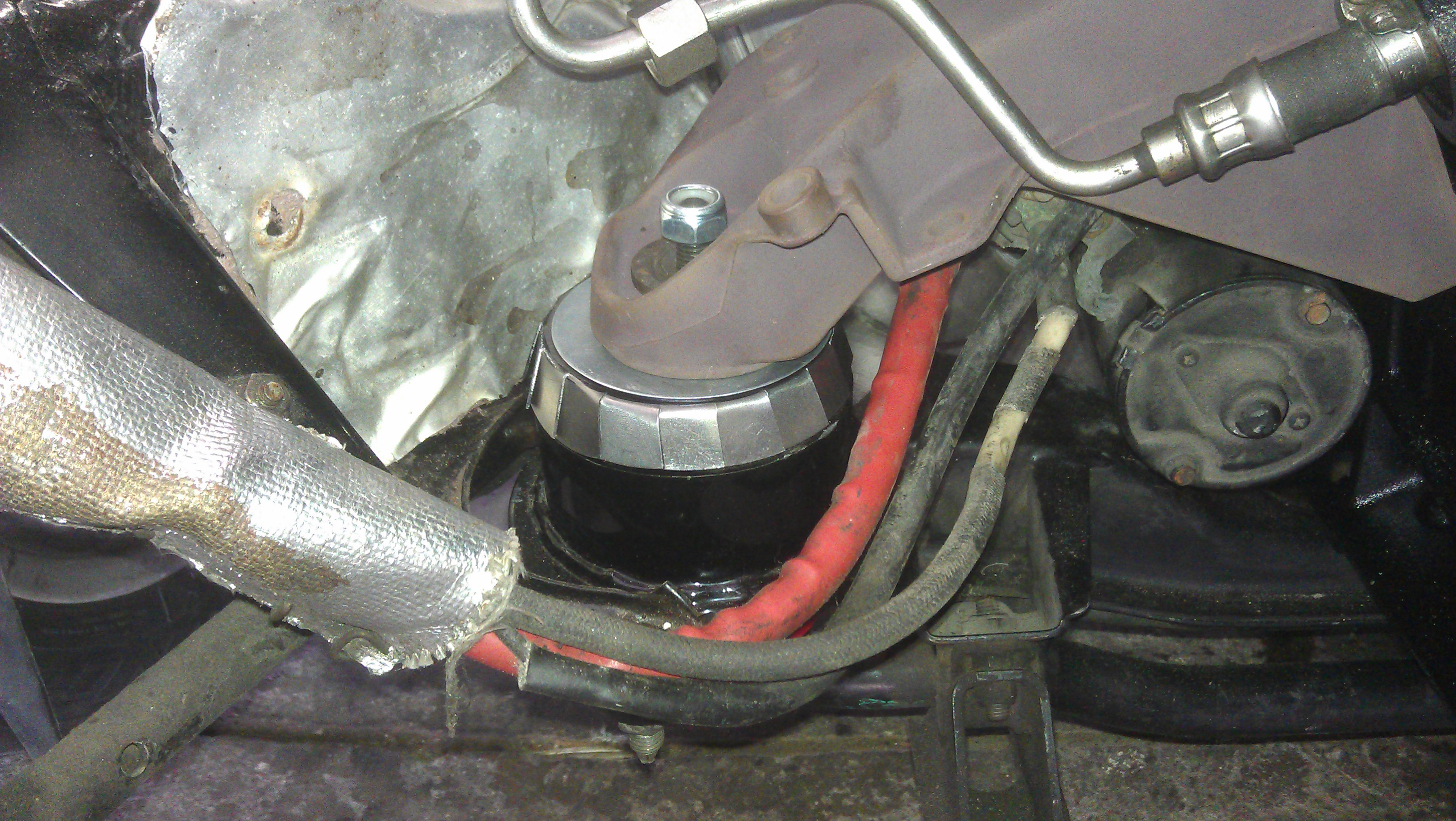

I made a heat shield out of a diff part I had in my tool box. I never throw away good usable parts that could be repurposed. Yes, I have a whole drawer full of stuff like that...and a few other boxes...and another drawer. I cant seem to throw it out.
Anyway, this is what I came up with. I hope it deflects the heat like I want.

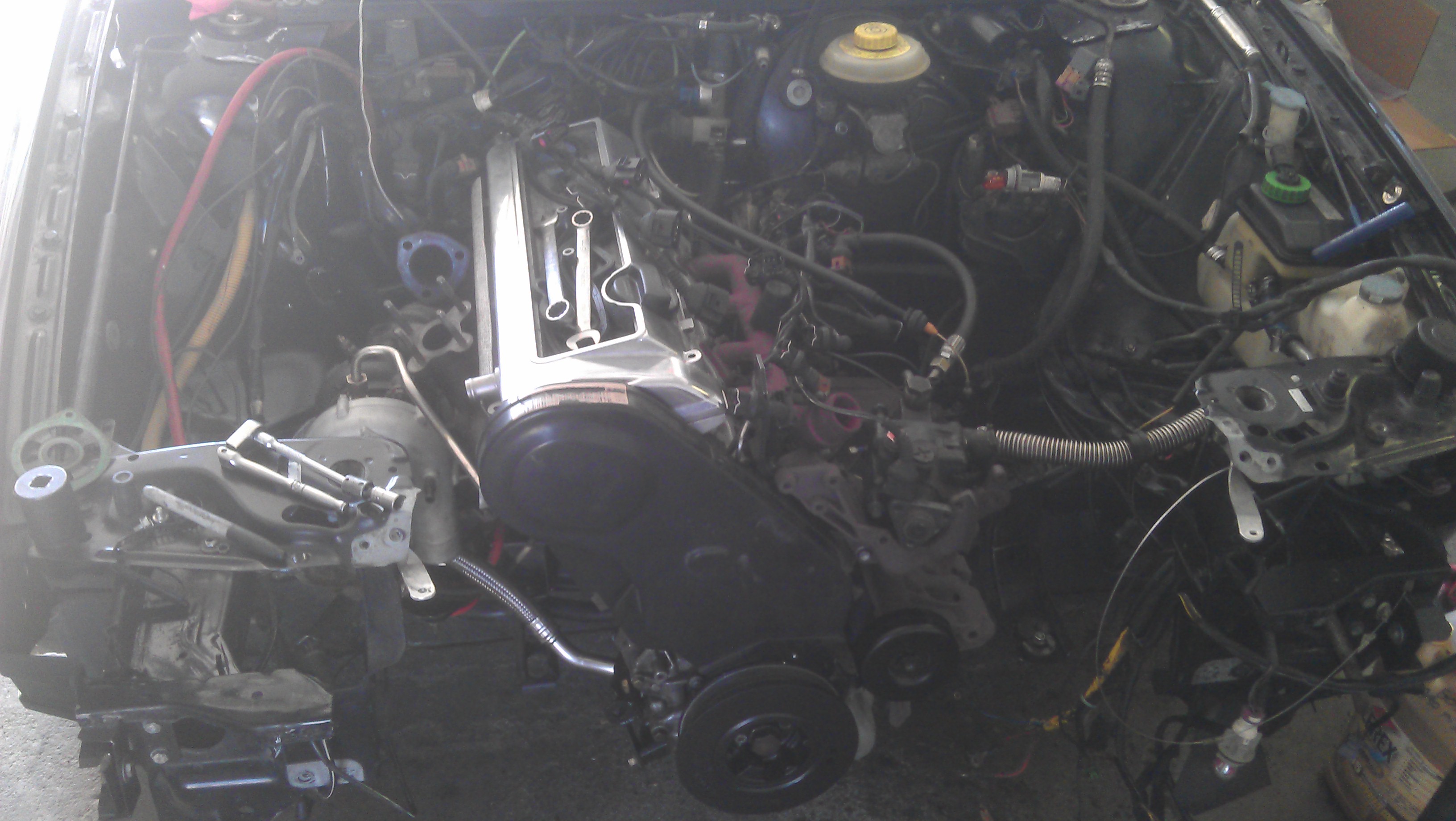

So, this is how far back in the motor is. Stabbed it saturday. Spending about 4 hrs a day at times working on it. I cant wait to fire it up again. Why do I love my car so much?

Am interested how you did the heat shield
Re: CQ project, then it, sniproad less traveled ( progress )
Cut circle ~2" larger than mount OD, snip ~1" radial tabs x~24, bend tabs 90°.

Ohh Ed, you gave away my super secret process for my heatshield!
