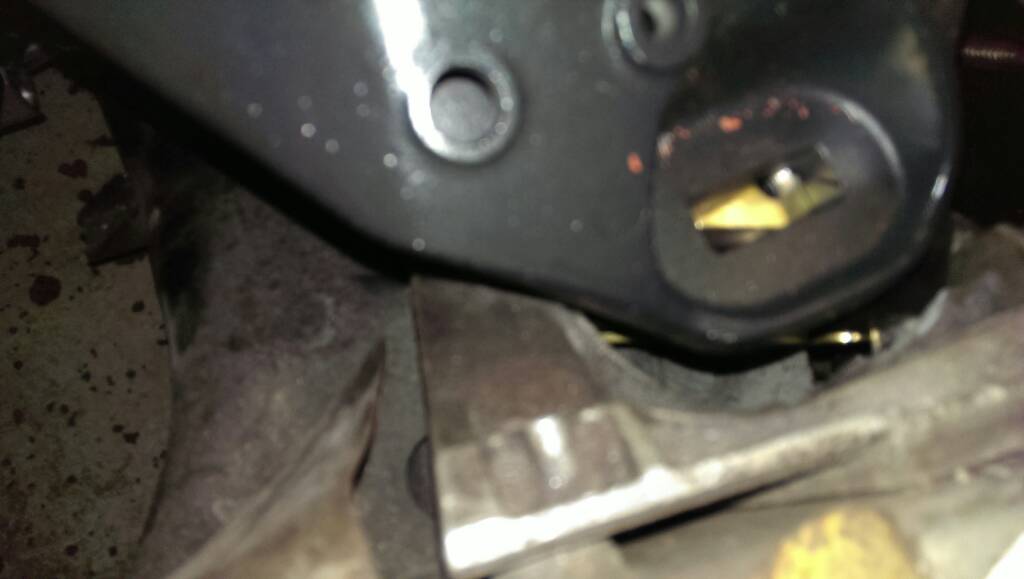

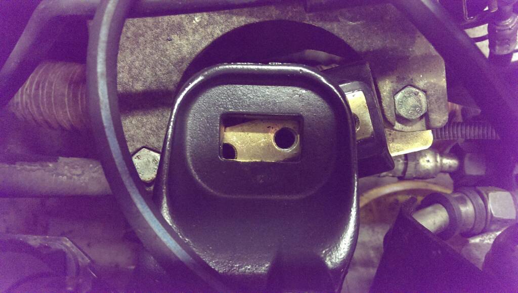

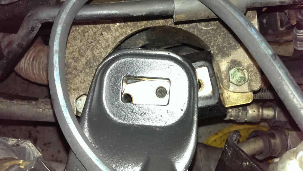

A look of a Mustang Tranny mount used as a C4 motor mount pic... Not my car...

Got mine to both line up pretty easily. Note that the bolts they give you with the mounts are not long enough.
Let's see some pics of the underside of the passenger mount...it looks like the mount is not seated all the way on that side?

Not his car I think he said...
Those look so odd in that area. OB let me bring you a cordless drill and some Canadian made hockey pucks with 1/16th thick rubber washers :hide:

Yeah, I read that, doesn't mean he can't get pics of whoevers car it is
Re: A tale of Rubí... Top Assembly Commences w/PICS
EDIGREG wrote:Yeah, I read that, doesn't mean he can't get pics of whoevers car it is

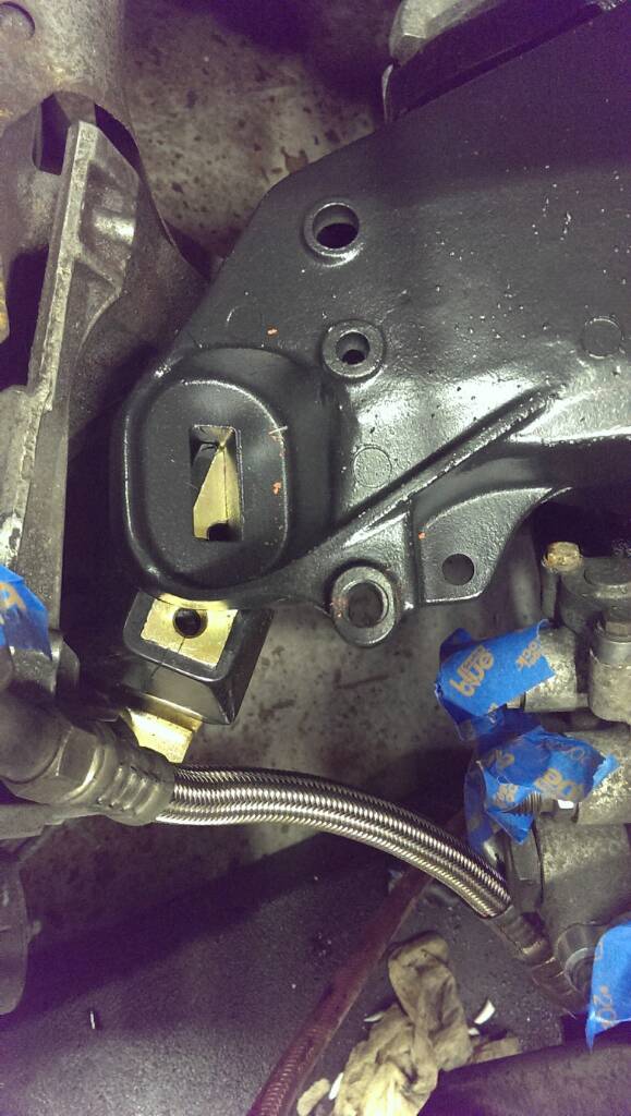

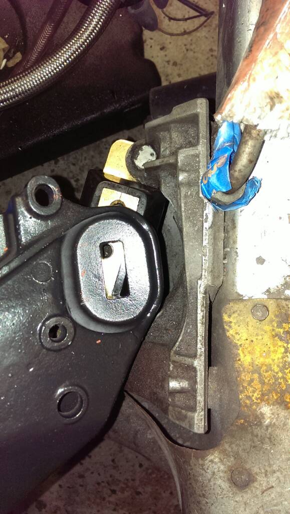

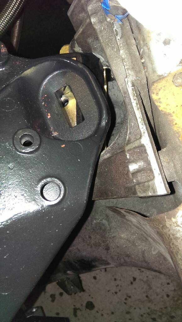

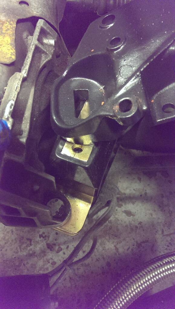

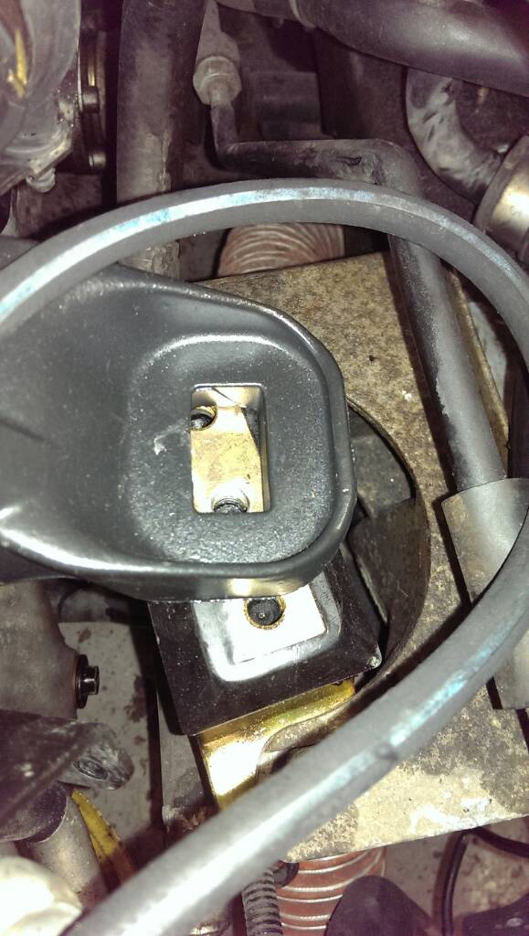

I would've loved to but the car was in between lift posts, on the floor, on a lowered car at EFI... So I took a few pics grabbed my parts and left quick... Here are some others unfortunately they might not give you the angle you need...

What is wrong with those pictures? They look like they will bolt up fine?
The Mustang mounts are virtually identical to the audi mounts in terms of height and location of holes. If the mustang mount looks like that, so will the audi mounts.
It's the corner square edges of mount... If I understand it correctly, in order have it fit trimming is needed to fit in the rounder housing to get the holes aligned.
Did you get that test mule c4 in yet? I'd be curious what you find...
Driver's side bolts in, you only have to trim the corners of the bracket since the mounting surface is not flat.
On the passenger side, the mount does not fit into the fork on the frame rail - it is the only thing we can't see in the photos because it's blocked by the arm coming off the block. You can bolt one side in, but then the other side won't pivot in far enough. Either grind the mount or grind the fork. You also have to trim the corner of the rearward bracket on that side as well.

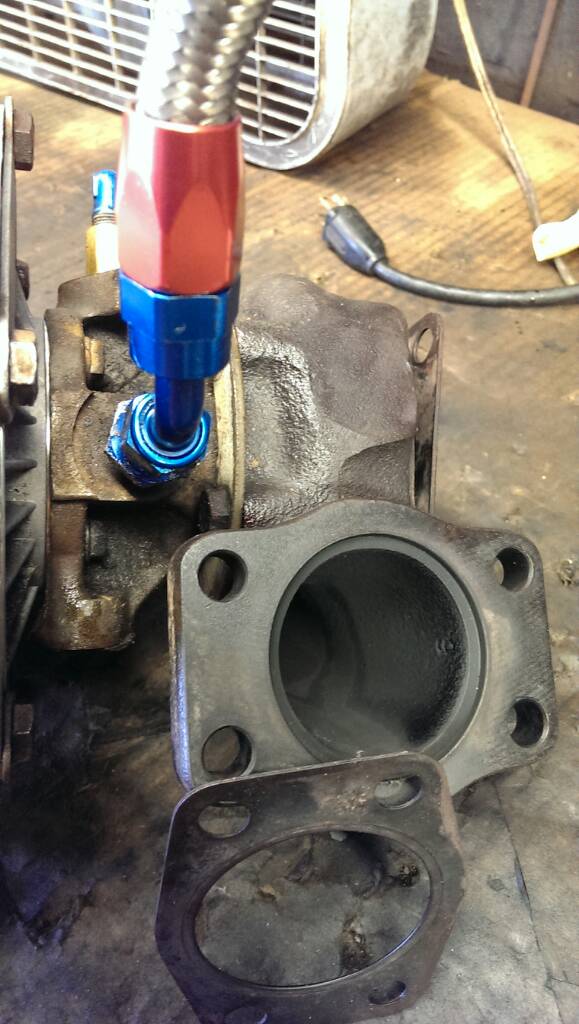

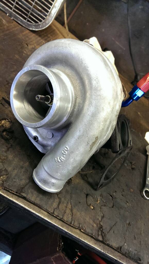

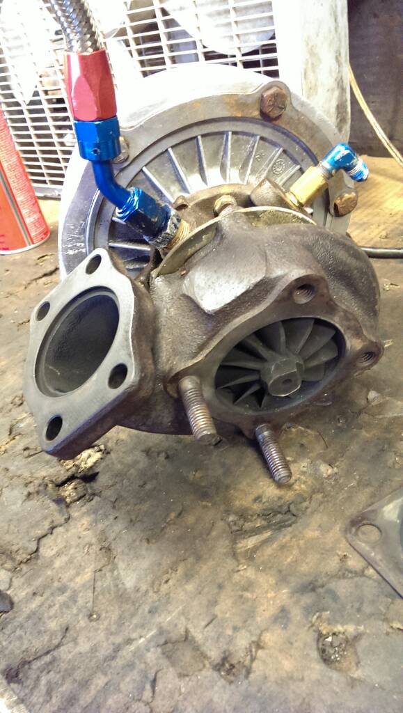

Out with the old...
