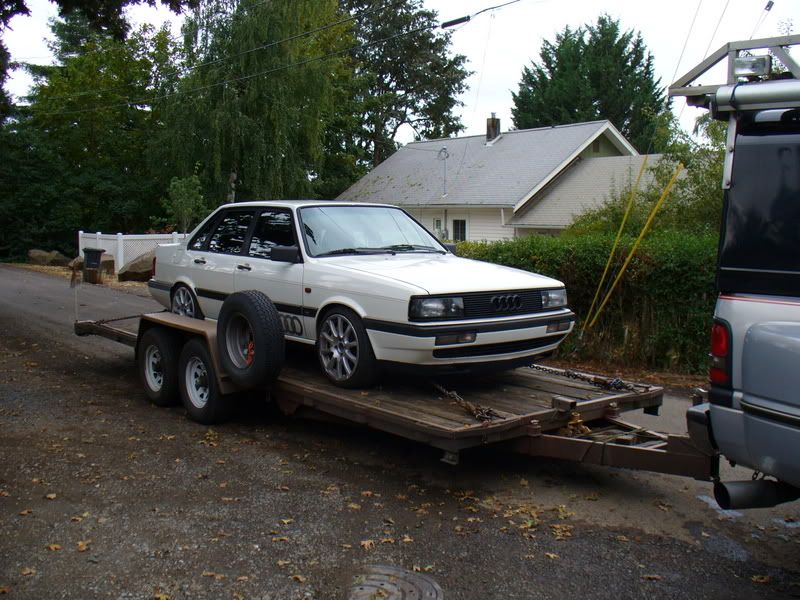

yesterday te car made it's journey to the modding grounds at my dads shop in sacramento,CA.
leaving home....

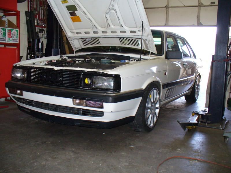

sitting in the shop again....
i took the wheels off and rotated them, the rears are almost bald from the slip sliding around with no front sway bar :). and i also cleaned them up real good since i'll be selling them soon.
i also did a bit of measuring looking at lowering and moving the engine/trans package rearward, and i think i'm going to be able to get away with about an inch or so drop, and about 1.5" move rearward. i'll go two if it doesn't look like it'll pull the CV's out of the joints.
currently the steering arms are pointing upward from the rack at about a 3degree angle. i'll situate that better once i get the new struts in place with the new steering arms on the struts, which, now that i think about it, i might be able to swap the struts one side to the other to put the calipers in front of the rotors and not swap the lines etc on the 6piston calipers.
anyone know what the difference is between where the caliper sits as far as fore or aft the rotor?
oh, and i also had one other thought, since i'm doing so much new construction in the suspension department anyhow, what's the harm in moving my struts inward a half inch ;) the upper will be compensated in the camber plate installation, and the lowers in the construction of the lower control arm. some johnny joints look like they'll fit the bill nicely for my inner pivot points 8)

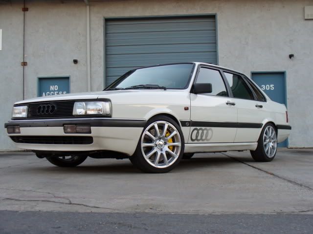

yesterday evening, just for kicks, i cleaned my car up and took a pic in the same position as last summer when i installed all the suspension and brakes. i one other pic from when i first got the car and it had the konigs on it. i need to find a digital version and hope i haven't lost it :( (changed computers and it may have gotten lost)
noriceforyou
Post by noriceforyou »
god your car looks great. Can I take it out on a date? I don't kiss on first dates, just an fyi
