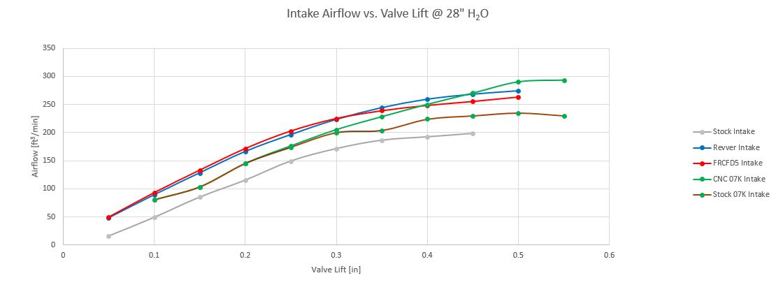

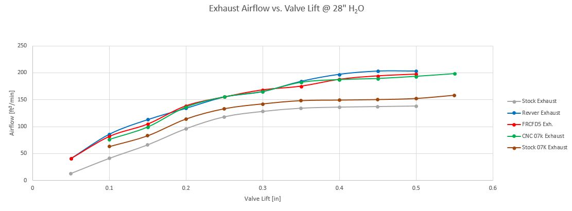

Indeed! Those numbers would be more meaningful, but only marginally so without making many, many assumptions. Either way, the only real conclusion you can come to is that there is more flow capacity.Wheeljack wrote:Very nice...some good info there...
As far as the area under the curve, if you have the cam profiles between stock and whatever you're running, plotting the flow versus an engine cycle would tell a much more meaningful story. Increased lift and duration will only add to the improvement shown from the valve lift data and be a little more indicative of actual engine flow.

I would have thought there'd be more over another member's "standard" port job, but perhaps that speaks to Jeff's standard of work in general.
But the improvement over stock is frikkin awesome.
Re: Chris' 200 20v Sedan - The Revver
I agree Matt.
I'd love to see more flow data from other heads from around the world as well as from an 07k so I can plot it all.

Well, well, well... what do we have here?
Some rudimentary 07k comparison plots. I had to guess at the data points a little bit since those plots from IE are awful. Maybe Issam will be willing to release the real numbers and I can make them a bit smoother. For now, this is what we have. Next up, calculating airflow with the cam profiles available to both types of valve actuation.
I have to say, I'm very happy with the low lift flow results here! That will help make up for the fact that we can't run near the duration that an 07k can.

Now that's really cool data! Thanks for sharing!

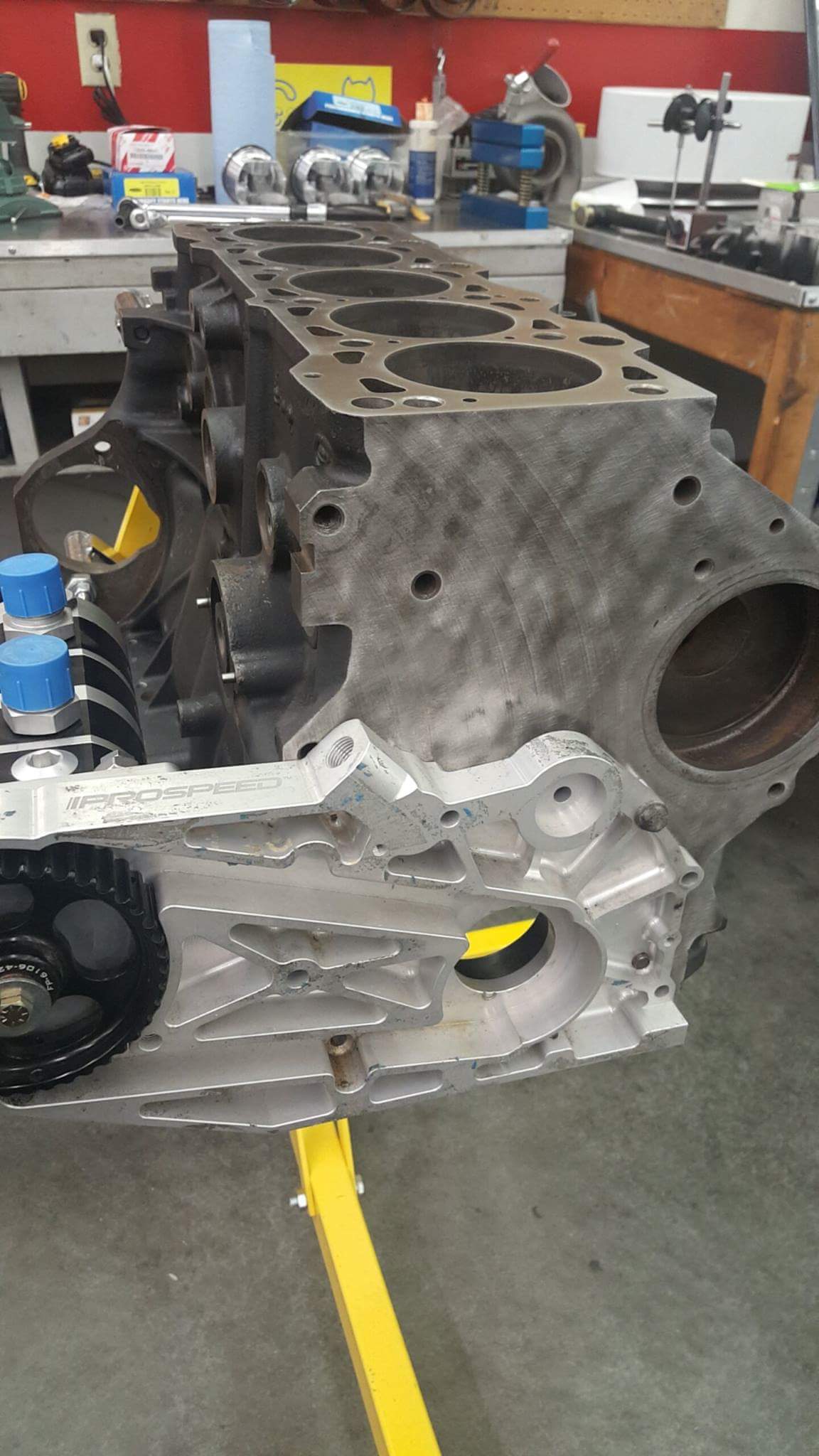

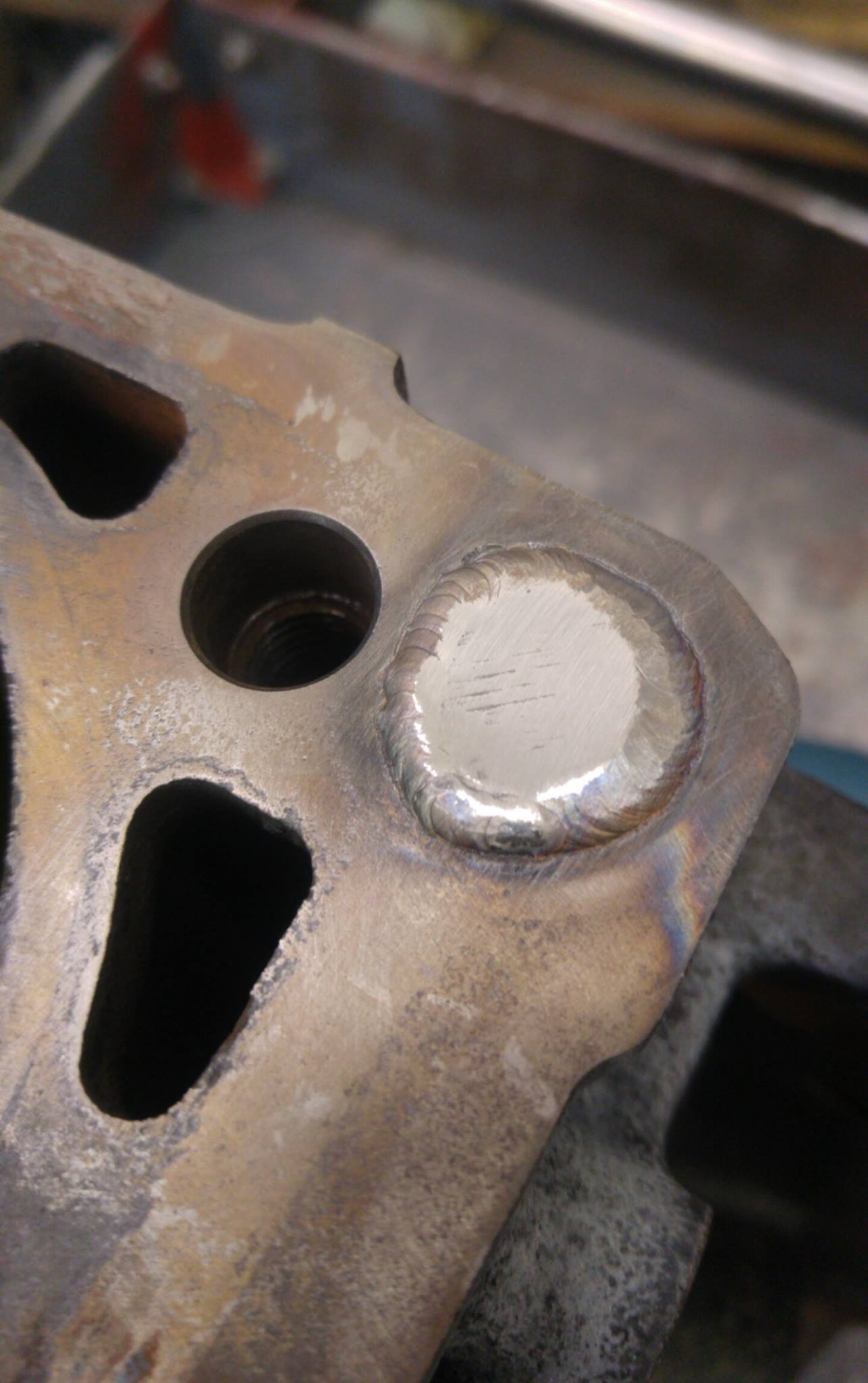

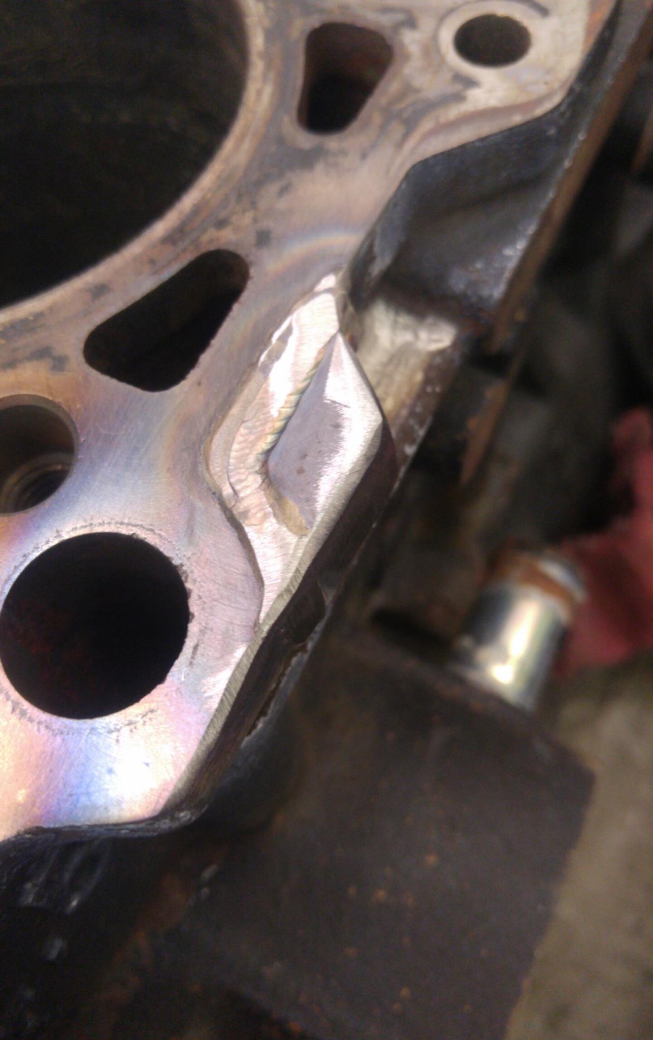

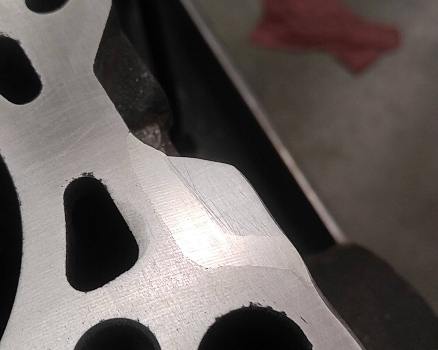

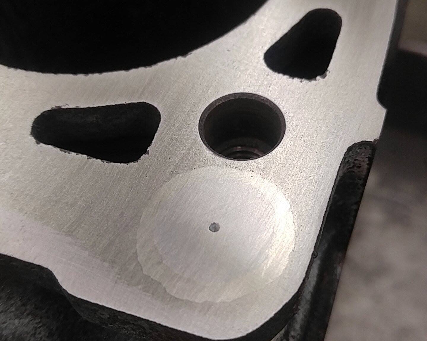

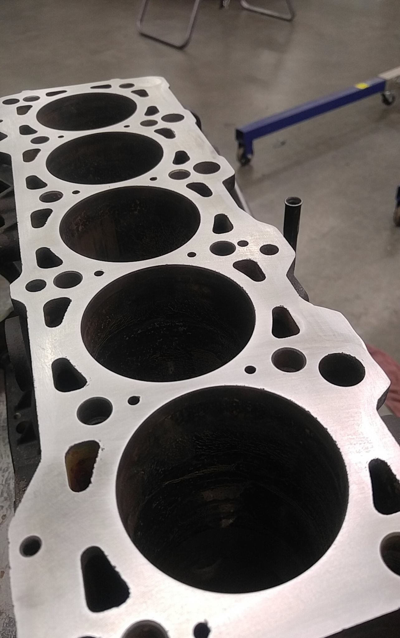

The latest developments with the revver are mostly to do with welding the block up for use with a 20v gasoline head.
Before decking: After:
Semi-interesting discussion:
I think we've also finalized the plan for main caps. They will be made as a one-off set in Finland. The originals will be measured for roundness and diameter while torqued in the block. They will then be sent to the manufacturer for precise measurement via CMM machine. The new caps will then be made from a high end alloy and machined individually to match the original caps' "holes" exactly. This will eliminate an approximately $500 line bore job when installed in the new block. They will only require a line hone. The extra cost added to machining/setup/measurement times is negligible.
One interesting discussion the machinist and I had was related to the honing process. He asked if the engine builder wanted the bores in the caps to be slightly offset toward the bottom of the engine. Apparently some builders have requested this due to the fact that when line boring, the softer material (cast iron) will be removed more quickly than the harder material (the alloy used for the caps) thus making the hole oblong when the caps are torqued and honed. However, a counter point to that thinking is that the surface of the cast iron bearing shell seats is finished to a much higher quality (less surface roughness) than the machined caps will be. So the material on the machined caps, although harder than the cast iron, will be removed more quickly than if it had the same finish as the cast iron due to the microscopic hills and valleys associated with the rougher machining process. AKA a surface that has already been honed will be harder to remove material from than a surface which hasn't been finished to a hone level yet.
So... we agreed to just make them "duplicates" of the stock caps in terms of hole location. Extra material will be left on top of the caps for use with a custom girdle.

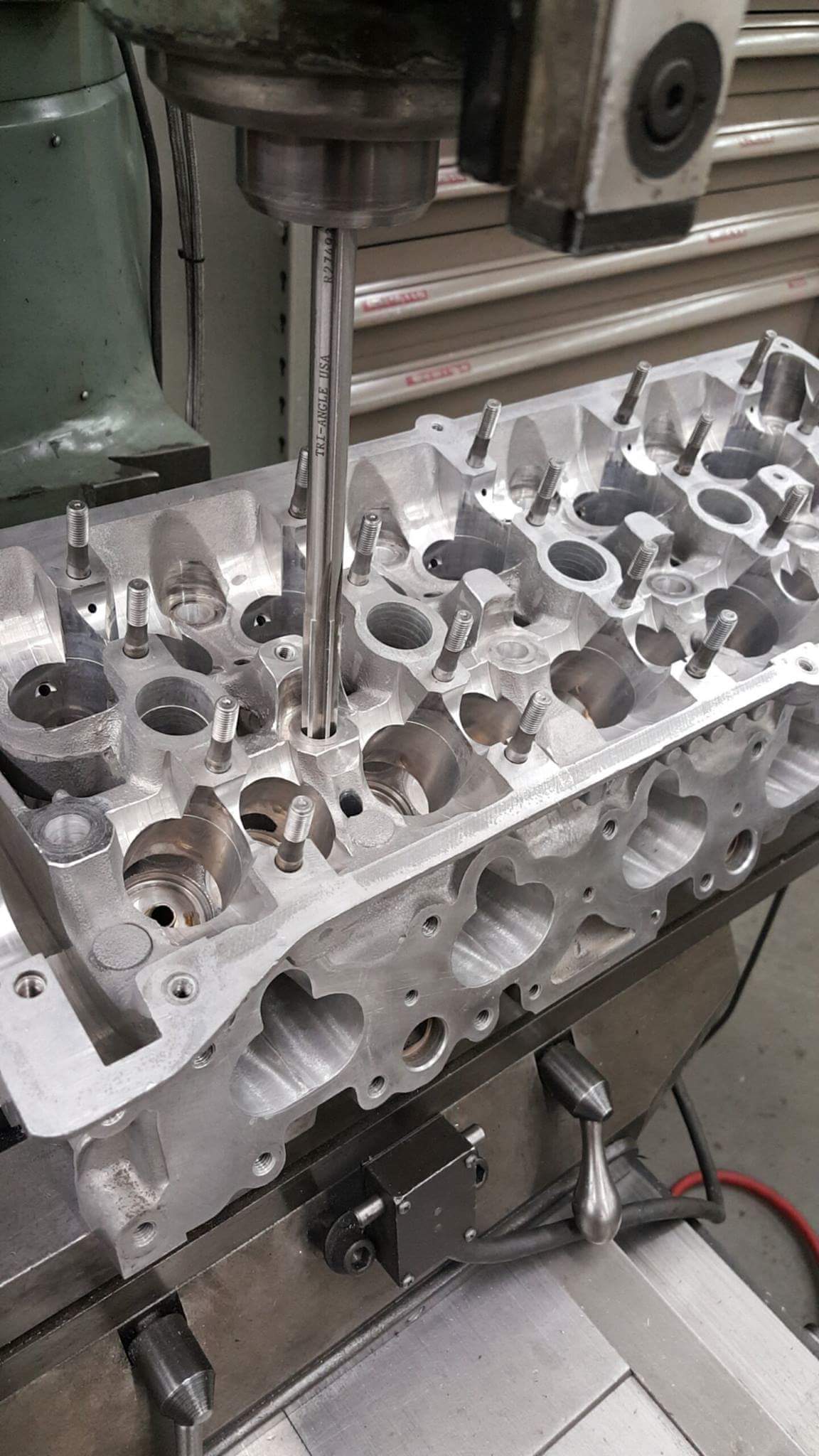

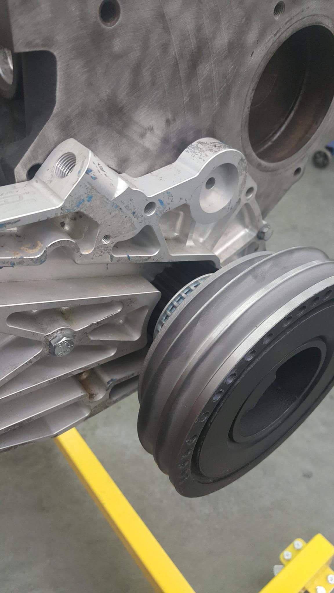

The main things which have been done lately are:
Boring the head from 11 mm to 12 mm for bigger head studs

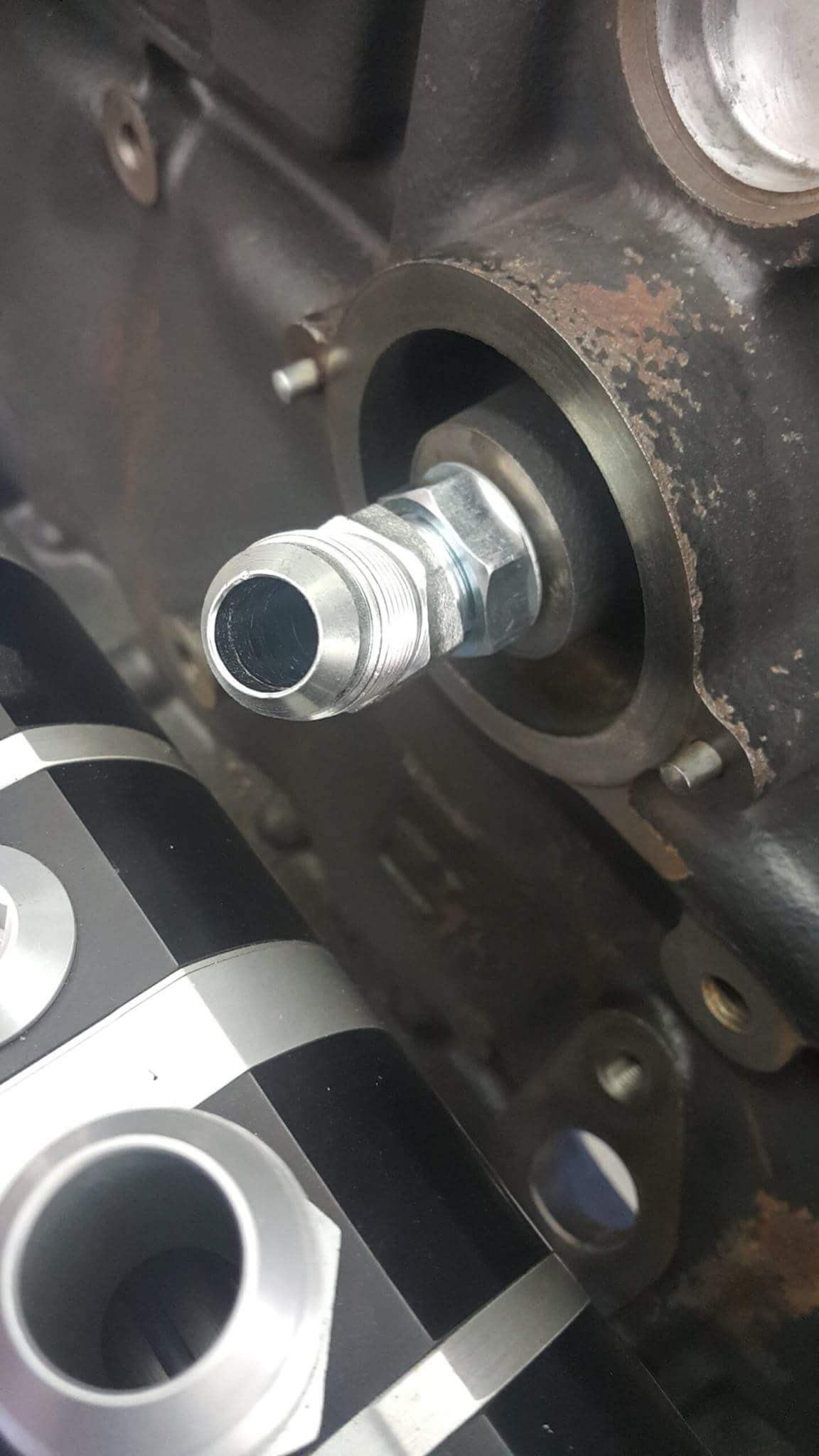

Figuring out how to deal with the oil filter location and oil feed for the block
And determining that we will use a stock 3b vibration damper for this build (as per Jeff). He likes it better than any of the other options, and apparently it's 100x the damper an AAN one is. The forged crank and zero balance of everything should help with that too of course.

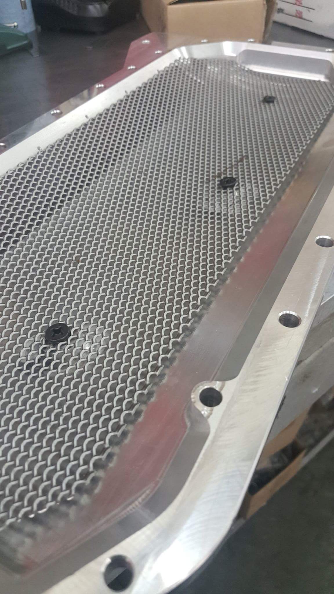

Also, as I suspected, the 034 dry sump pan has been determined to be utter, and totally un-engineered shit. But luckily it will serve as a basis for modification which will make it ok for the job.
