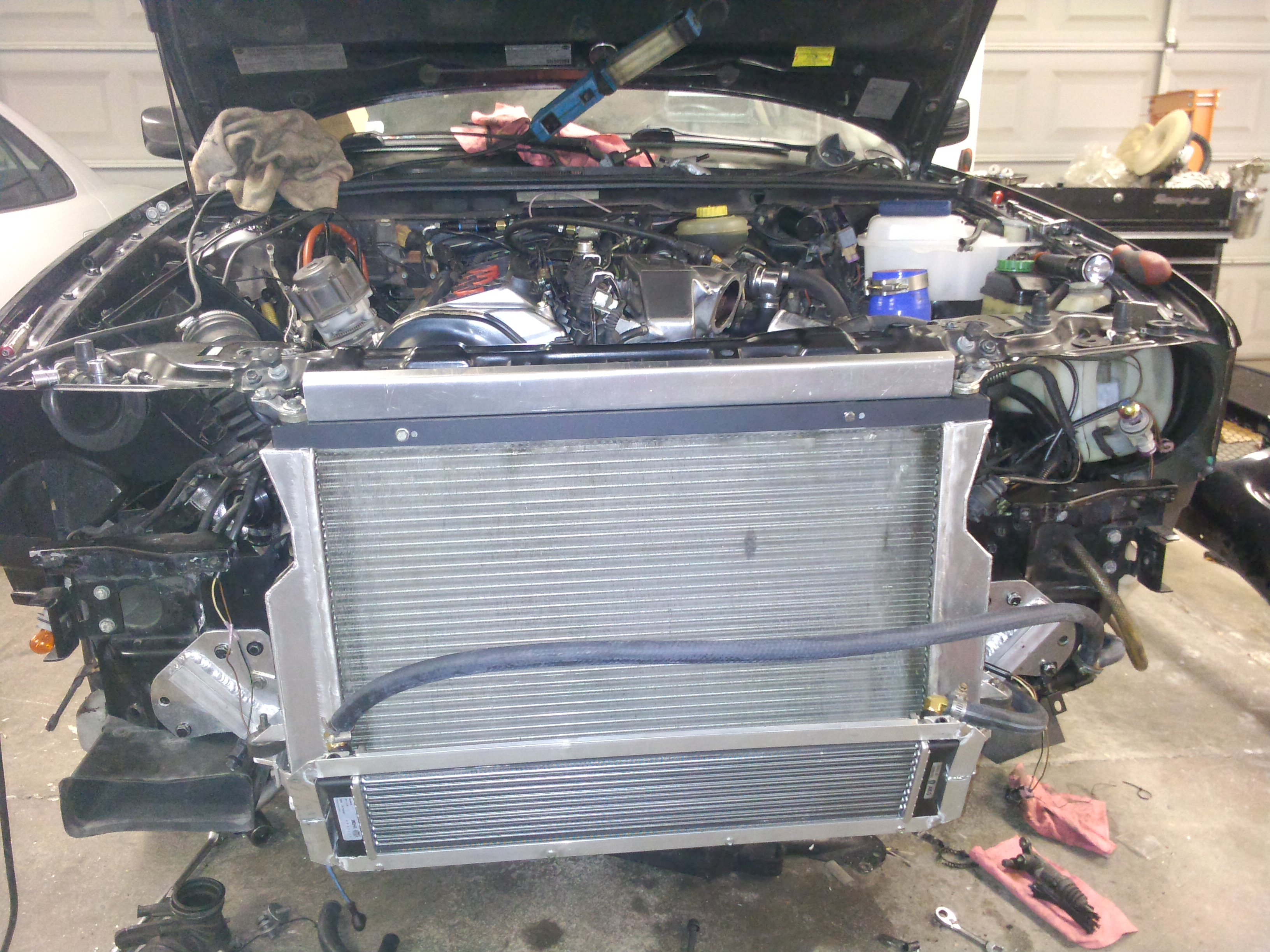

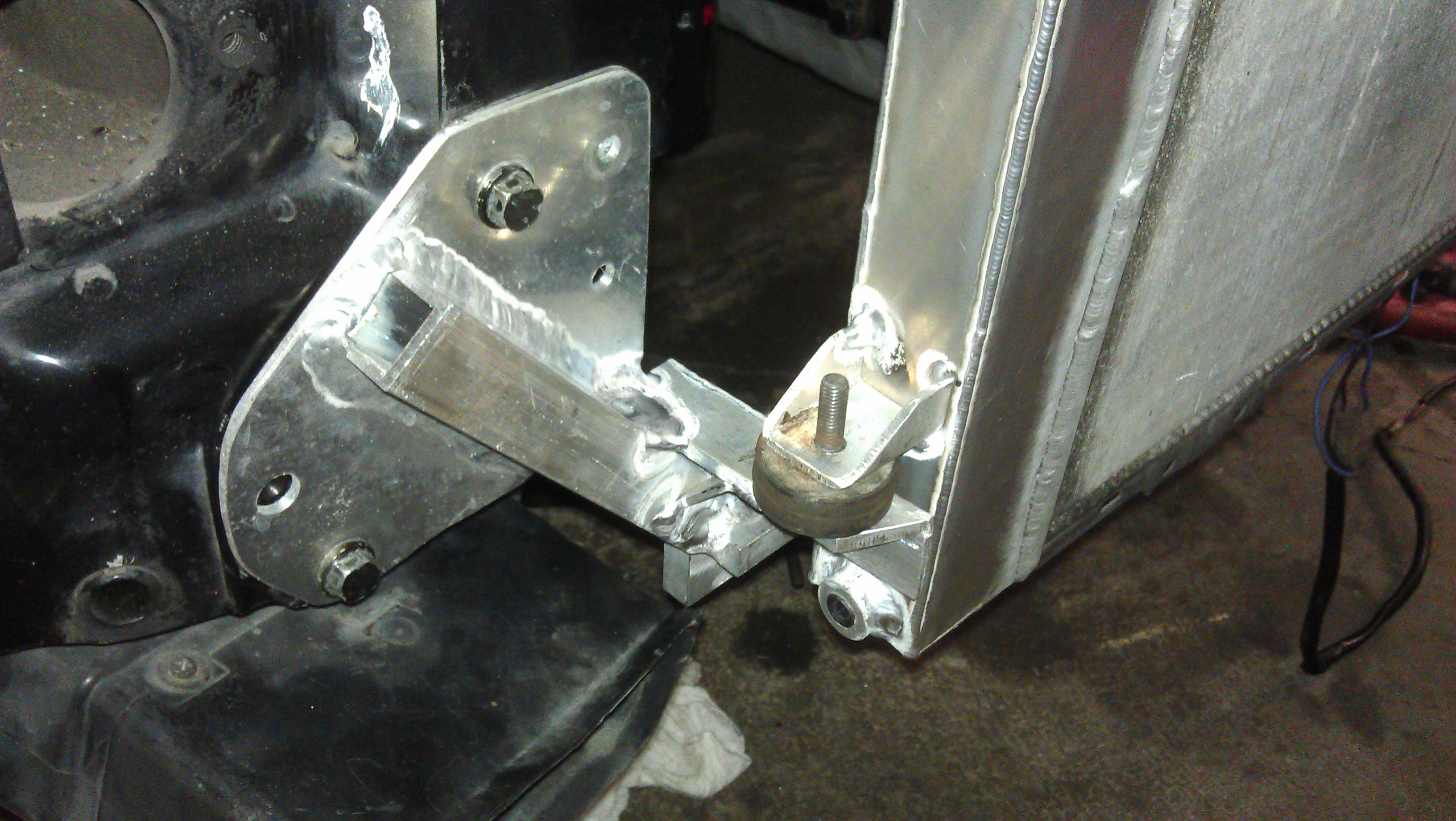

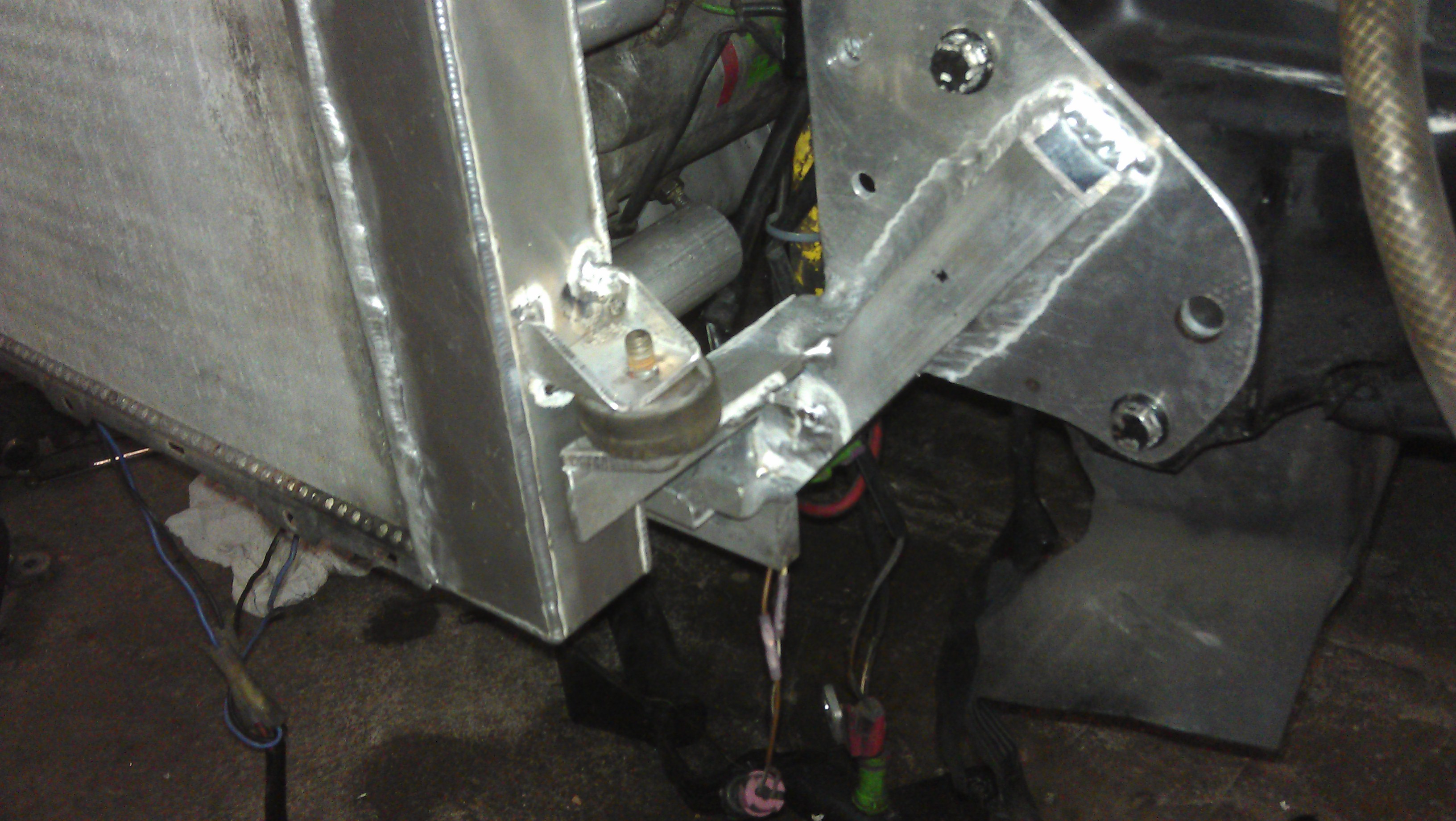

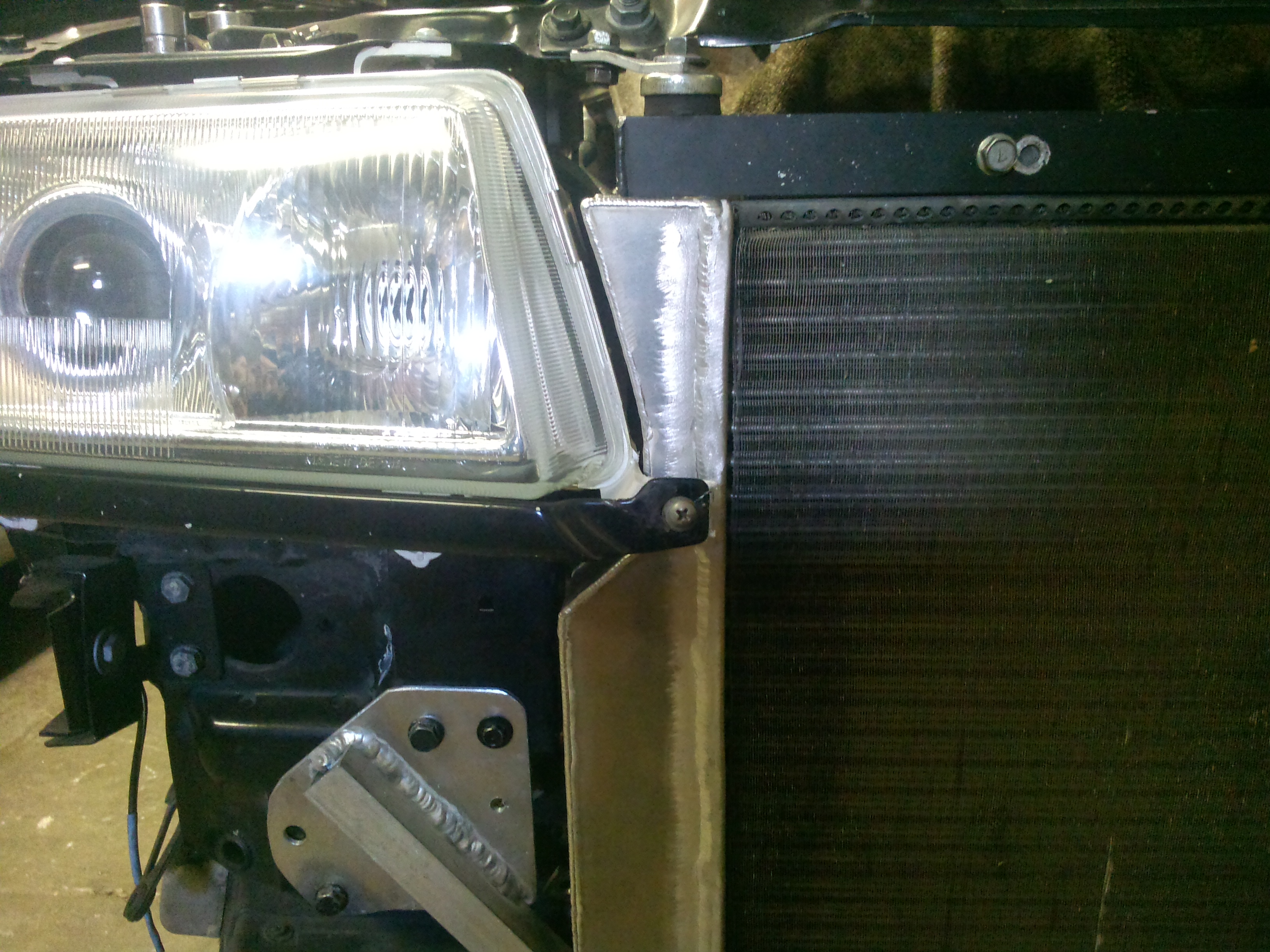

Here it is hangin like it should. There will be some other variation of hanger/ tab for mounting, but this is right where it should be on the xyz.

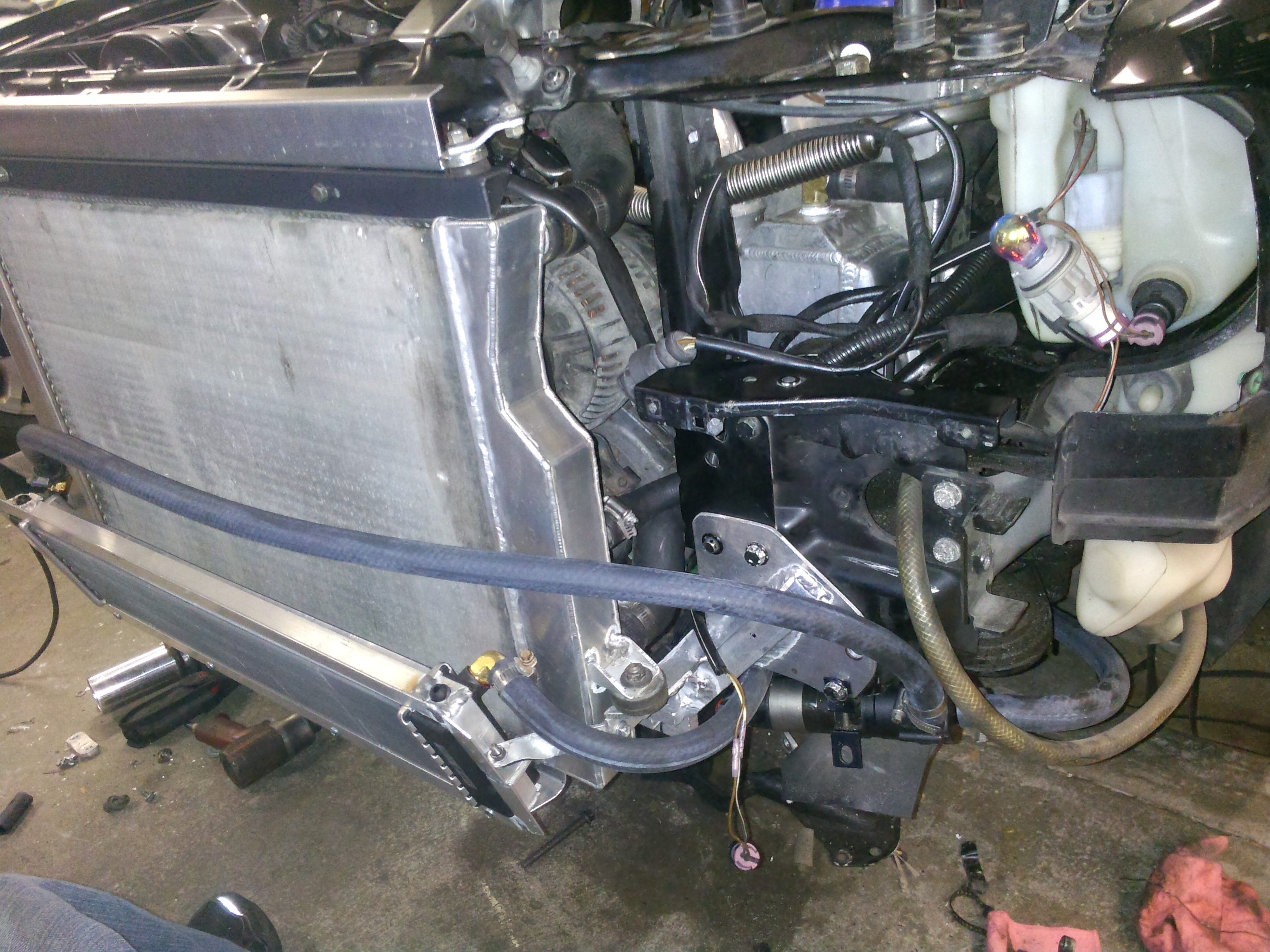

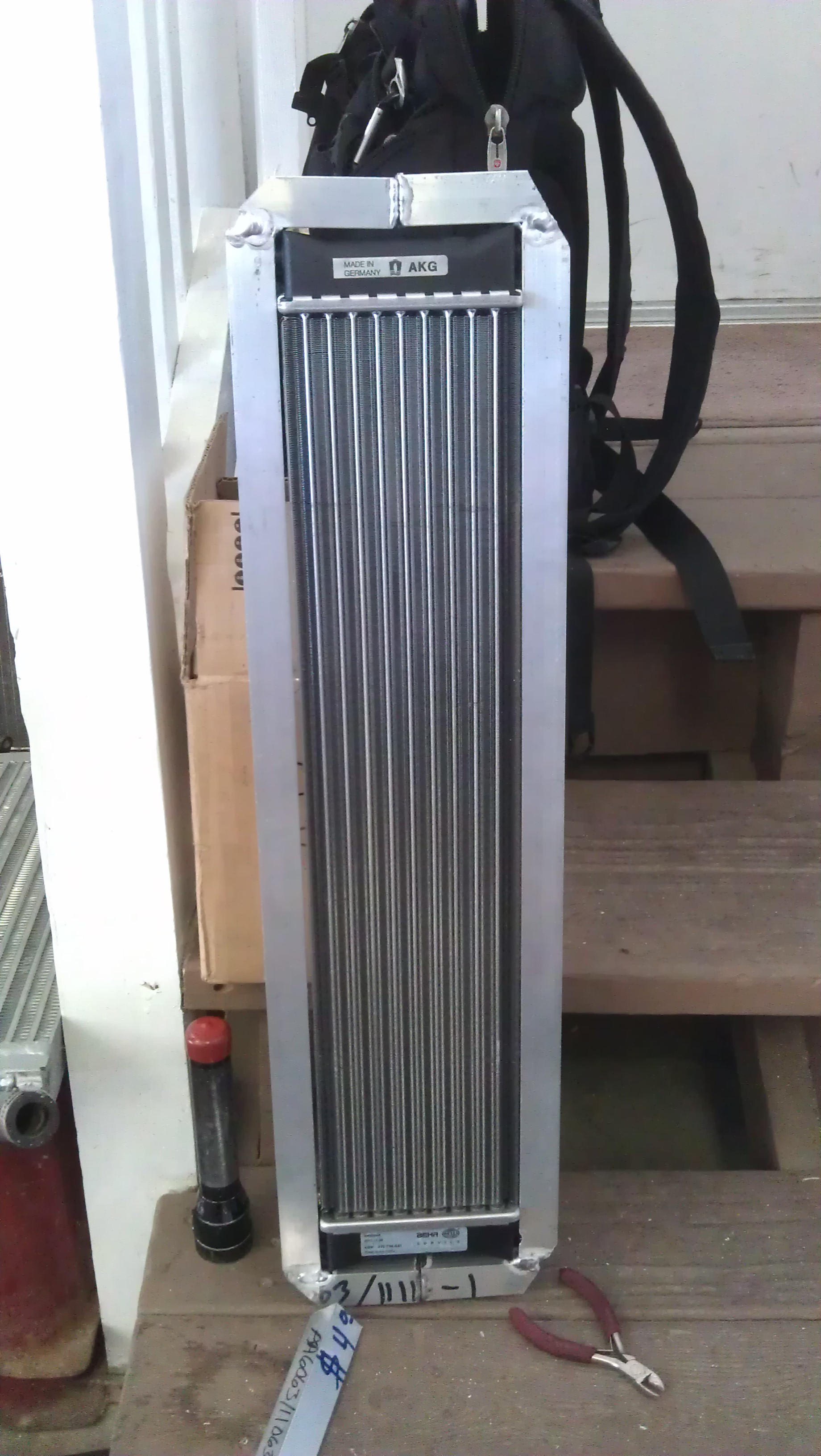

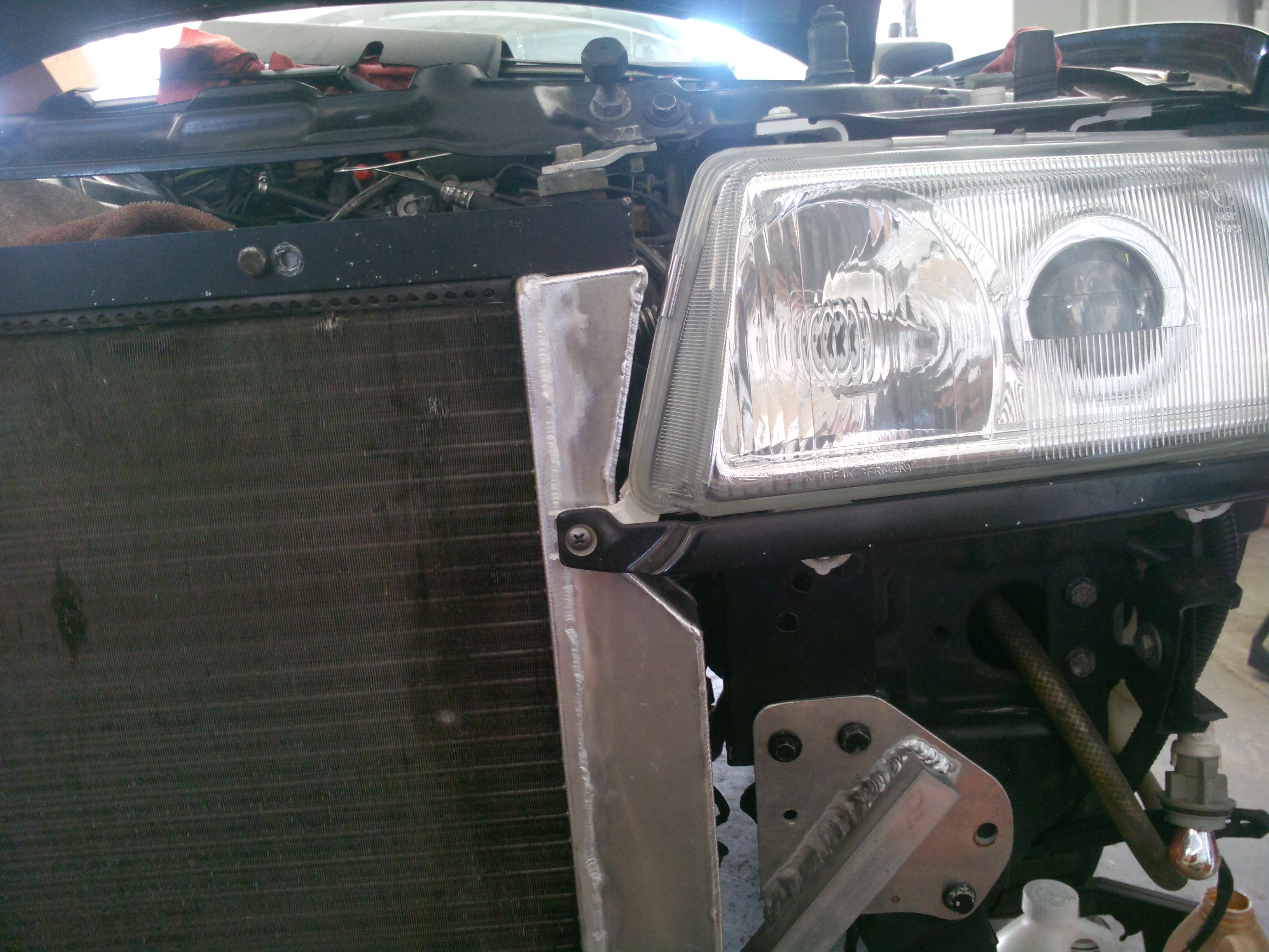

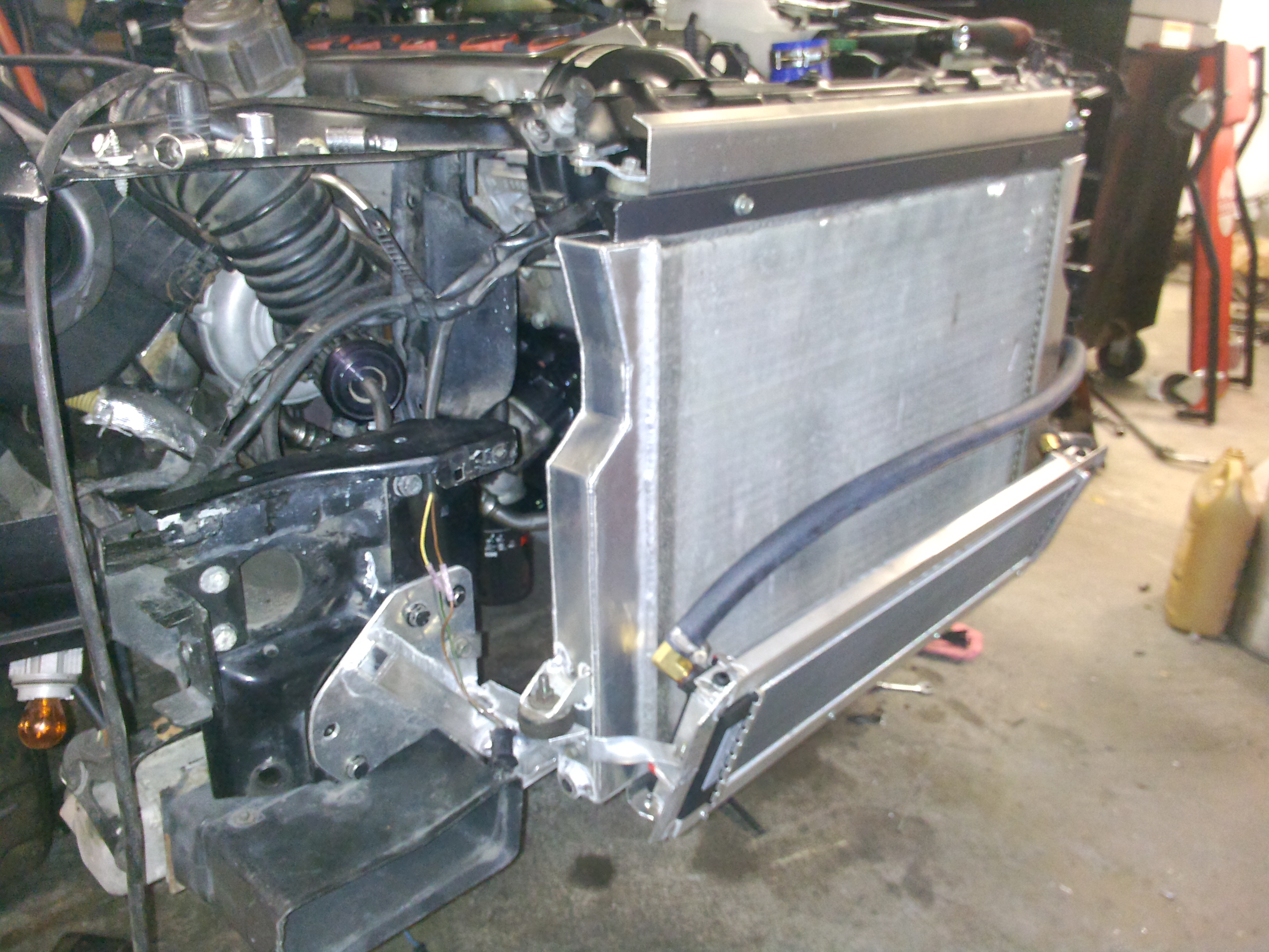

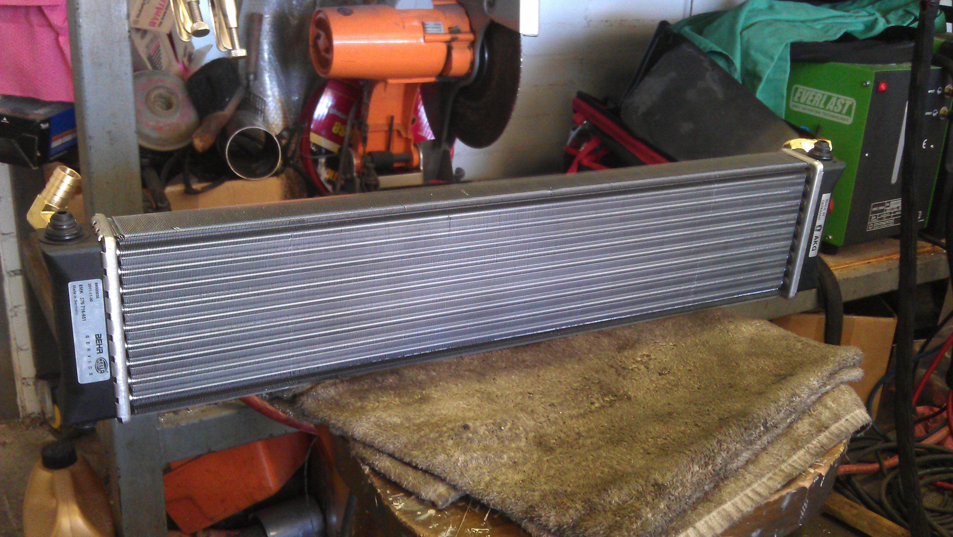

I have been busy trying to get the rad brackets and mounts done. I have also picked up another Heat exchanger for the air to water since the frozen boost option I had is not really very efficient and is about five times heavier. while searching for a better option looking through google images which seemed to be the fastest way to find the option I was looking for, I found a post on audizine of what seemed to be just the right size. It was actually a Porsche 911 center radiator and they were using it for the heat exchanger for an air to water as well. I finished with the lower rad mounts today, and had previously installed the drain plug into the bottom of the tank.
I figured I would save the pictures of the heat exchanger for later as I am in the middle of building the brackets to attach it to the rad and framework. I have plans to keep it part of the rad, A/C condenser packaging and leave it unattached from the bumper. It should prove to be a better, more efficient option for what I want. I will keep updating as much as possible and will be working on the car every day from now till its running. I hope I can get all the little things done in time.

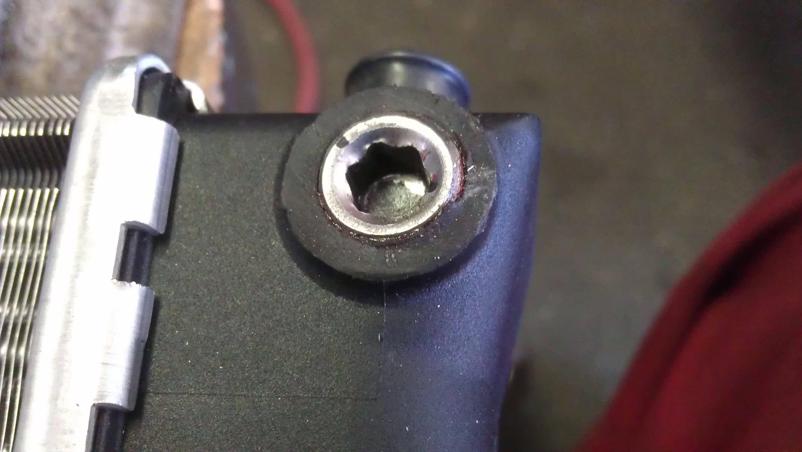

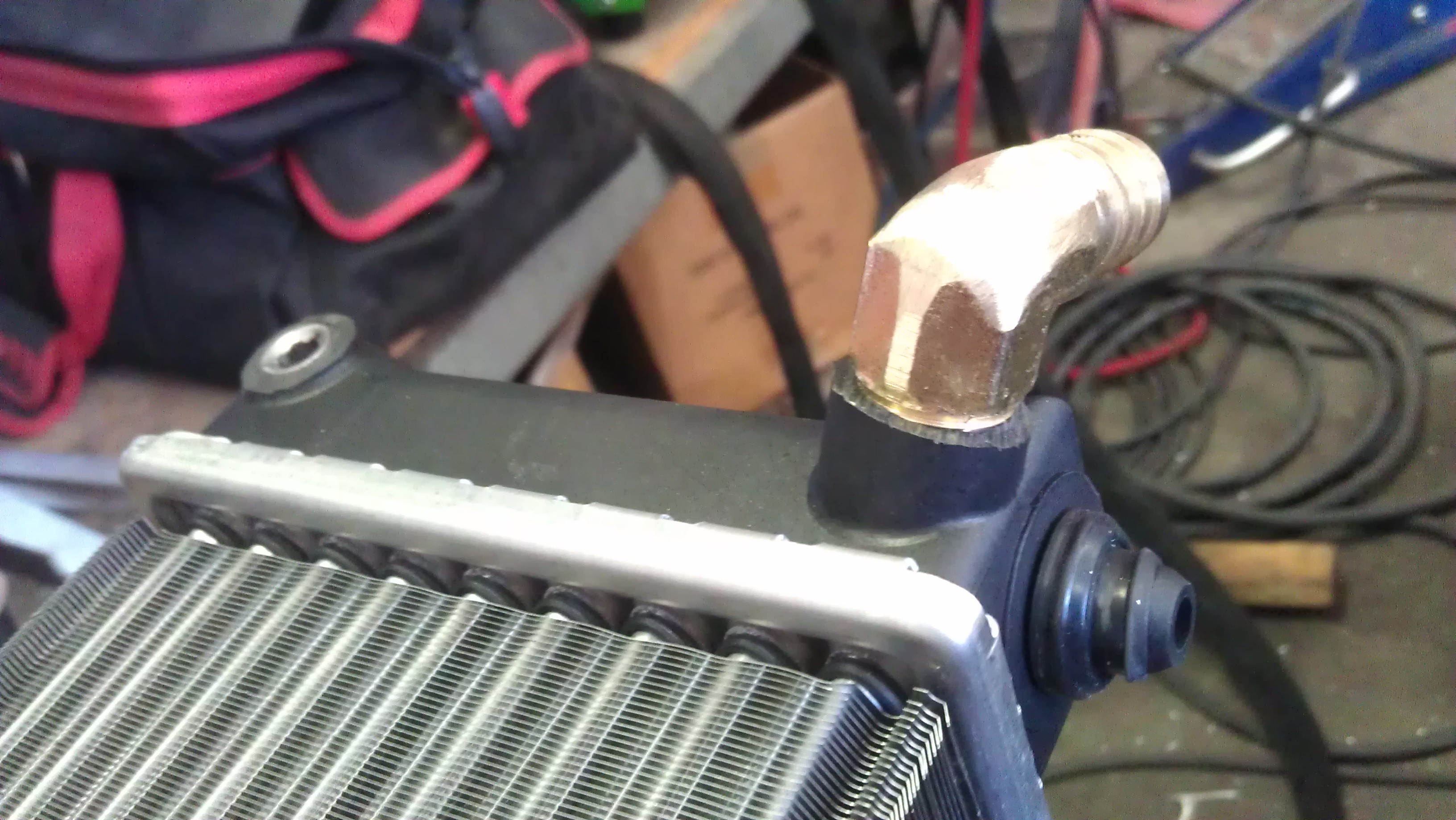

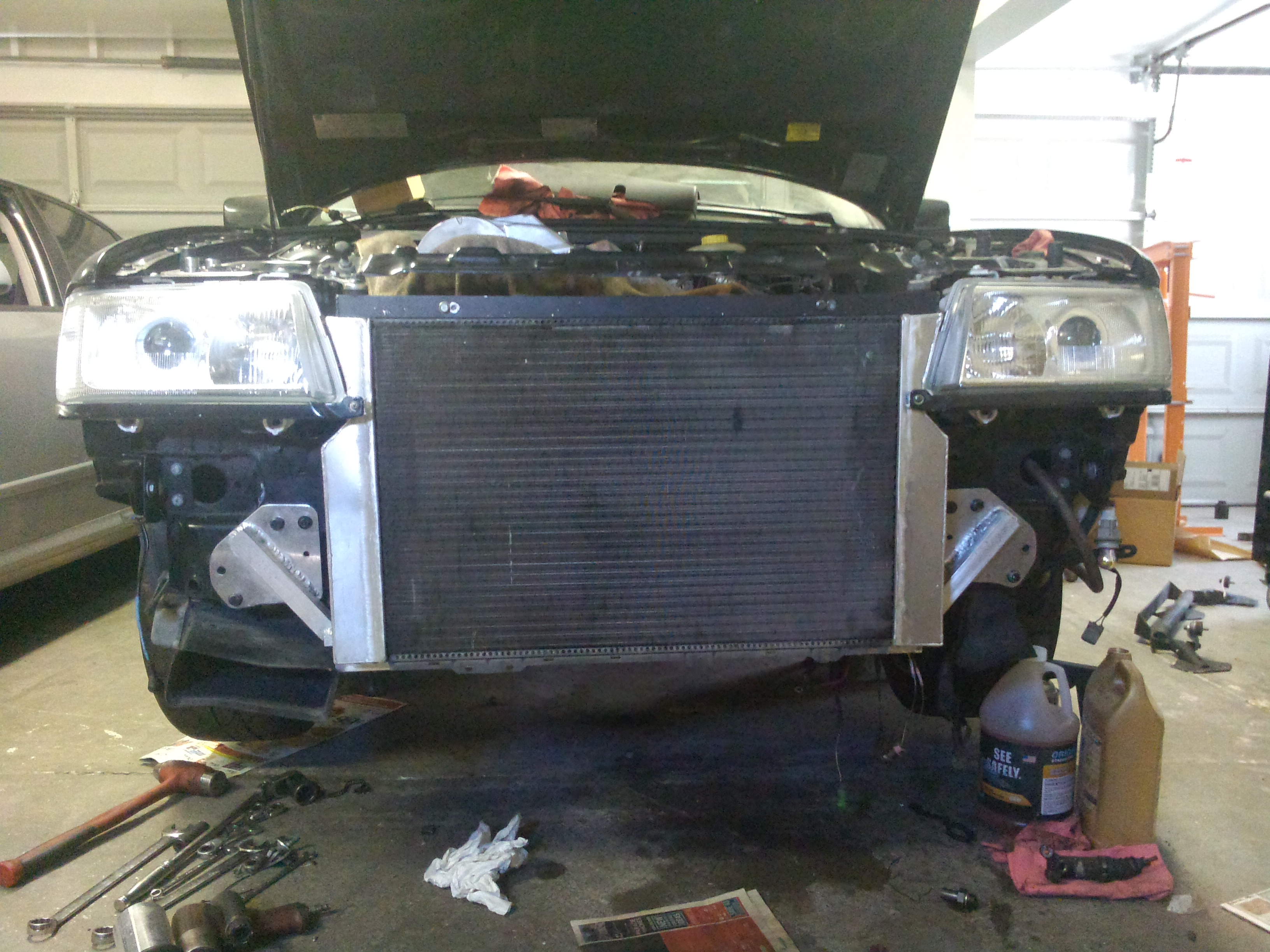

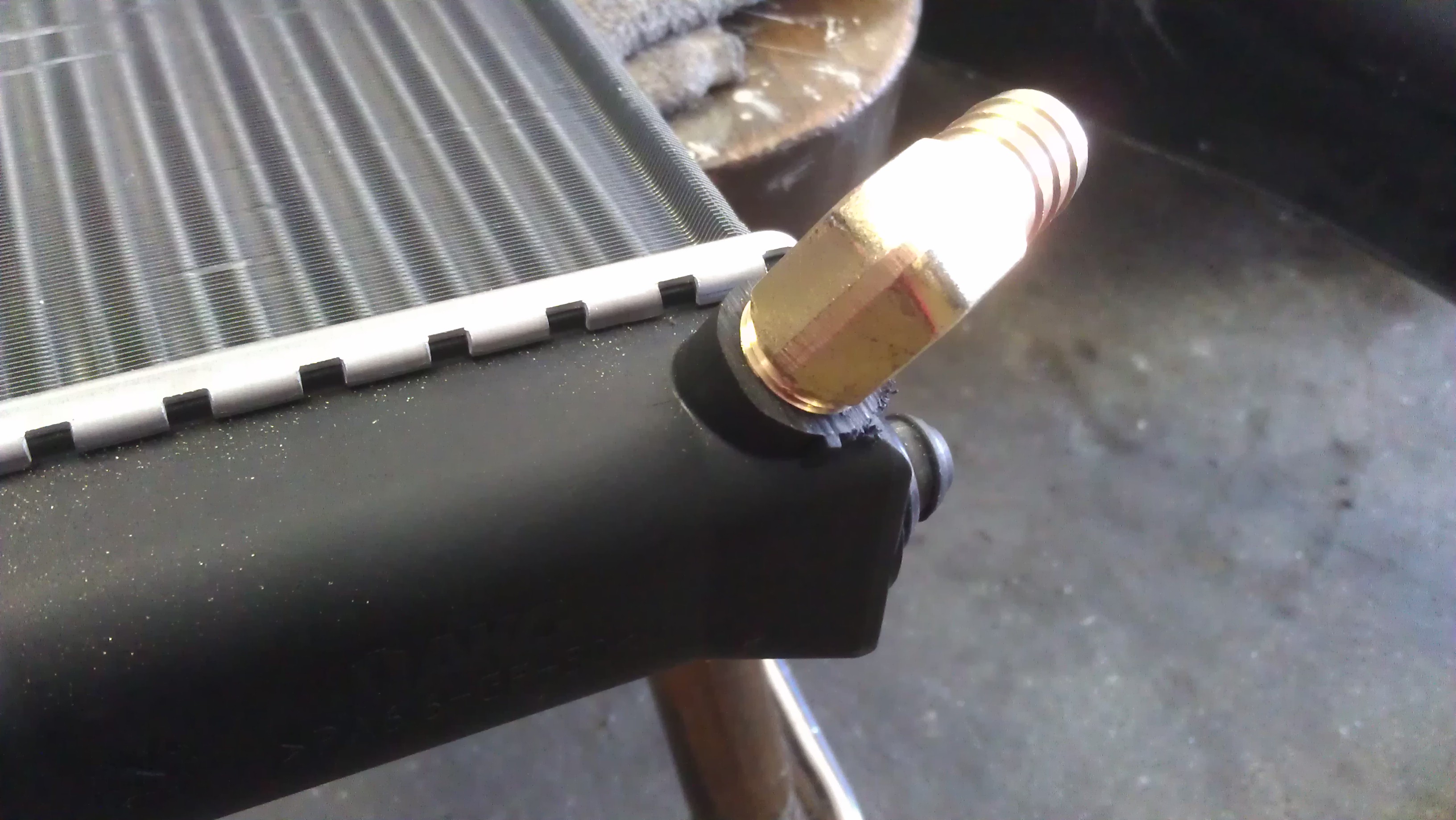

Well, as of today I have the heat exchanger 95% done and fitted where it should be in relation to the radiator. I still have to fabricate the brackets to hold it in place, but Im happy with the current results. For those who cant imagine what its like to buy a brand new in box radiator, direct fit for a porsche, and hack the nipples off the plastic end tanks, I'll tell you what thats like. In order to make it fit, I needed the inlet and exit to veer a different direction. Pretty much 90* out the tanks. How did I make it usable after the circumcision? I used brass 3/8 pipe thread to barbed nipple 90's, and cut pipe thread into the holes of the missing plastic nipples. I also cut off the drain and did the same mod to gain needed room by using a plug countersank into the tank. I have yet to take pics of my carnage, but i can show you what an unmolested radiator looks like. I built a different surrounding bracket, so ignore the one in the pic. Image
Ill get piics of it within the next few days. I wasnt worried about the system being under any real pressure, so the mods I have done dont worry me about leaks. It seemed to go very well anyway, so I doubt it would leak even if it was. I should be finished with the engine radiator by this weekend, and be able to fill the system and start it hopefully by monday if not sooner. I will keep that updated.

Lots of progress the last couple days. I have the bulk of things needing to be done pretty much ready as it will ever be. Mind you, I have plans that have to be postponed till after the gtg in a week an a half. Its mostly just final touches on a few things, and I will get to them as long as my car makes it there and back without a major incident. They may be finished in the time up to, or put off as I would like to fully break in the engine before I take the trip down.
I may be firing the engine in the next day or two, then time to take a few drives to put on the miles for break in. All this while I still have to work every night till 3am at my real job. Thank dog its only 4 nights a week. I will need to watch the radiator very closely for leakage. It passed a pressure test with about 15ish lbs of compressed air and soapy water sprayed on the original tank seals.
