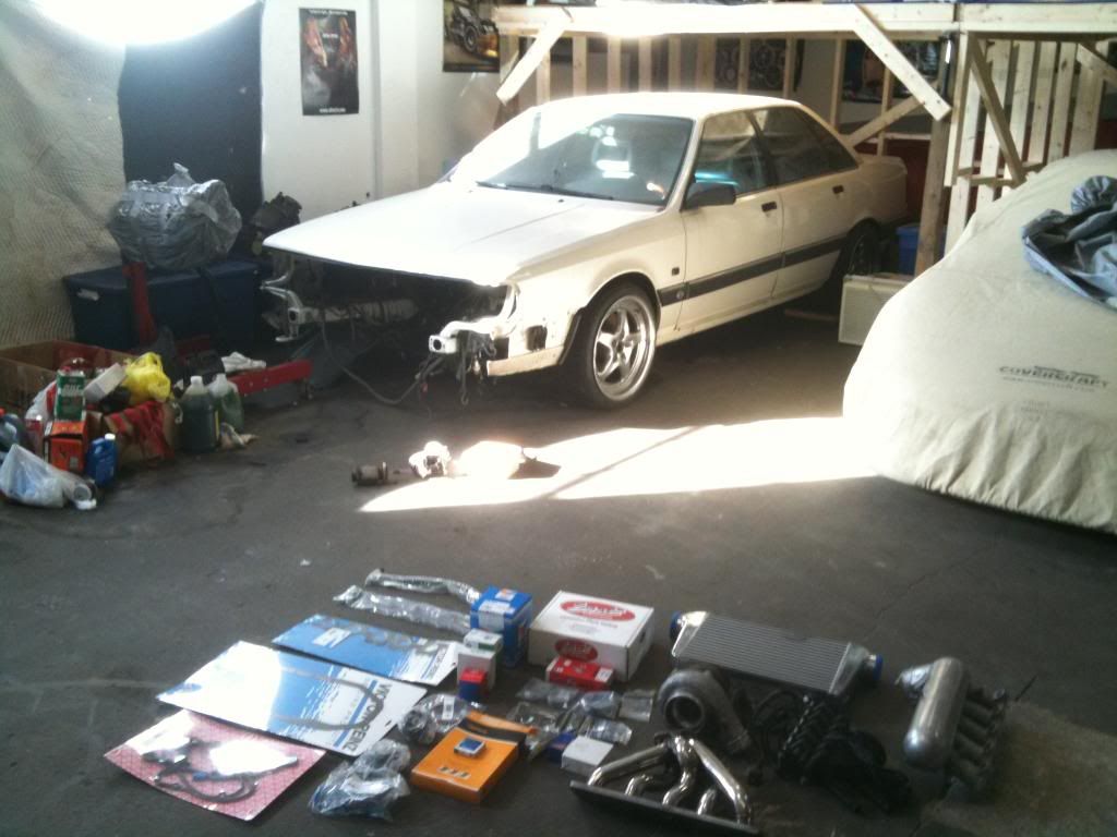

I cleaned up the shop a bit and decided to layout some of the goods for a picture... excuse the cell phone pics

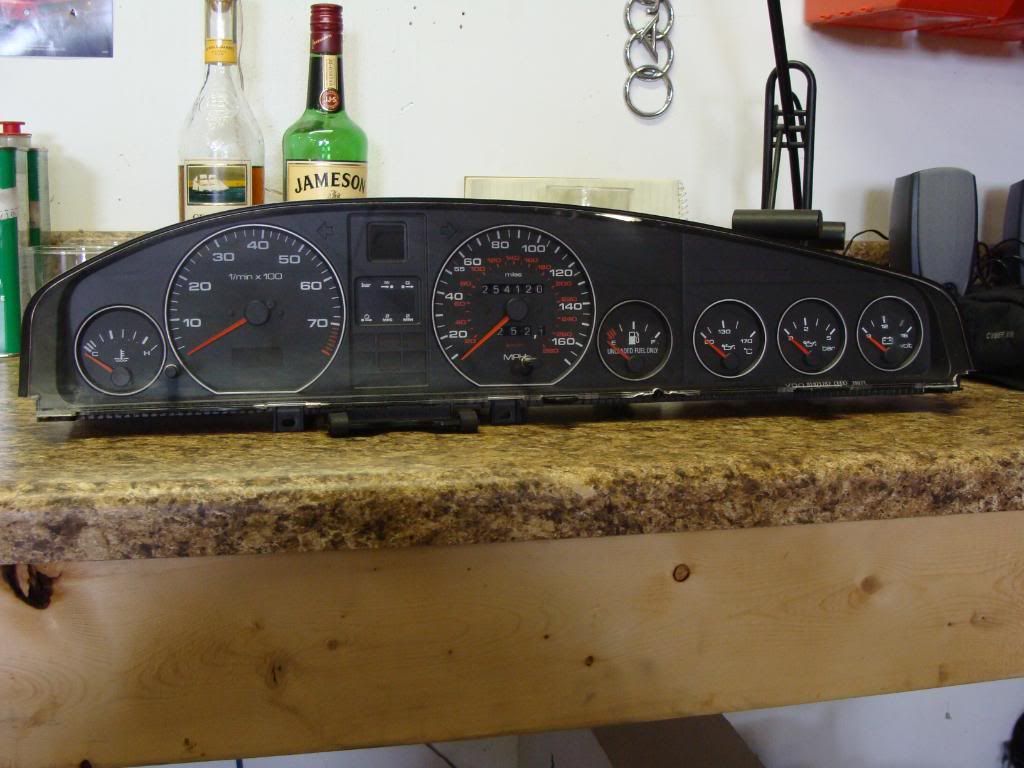

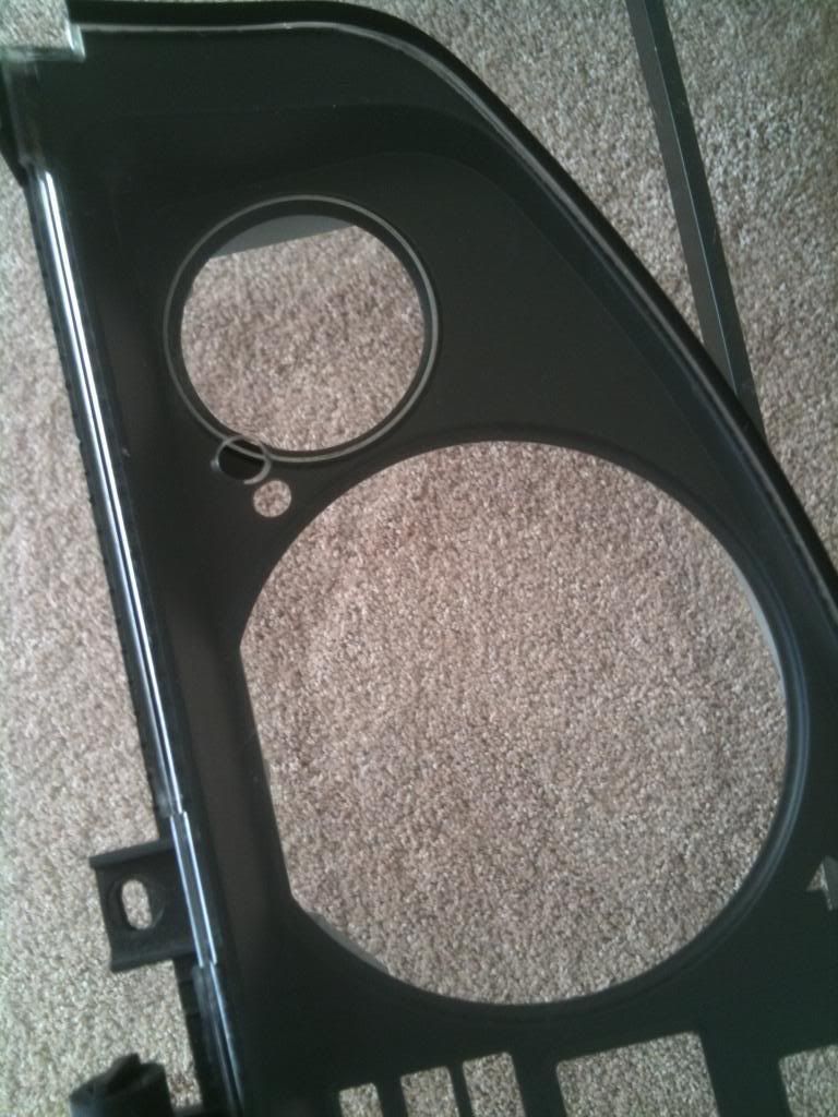

And am in the middle of a small detail sort of project wherein I am attaching some A6 gauge cluster bezels that add a touch I feel to the 200's boring cluster. Here are a couple in progress shots:
Removing the mounting tabs (made to lock into the A6 cluster, 200 cluster does not have provisions for these)
Glued in place
Glued in place

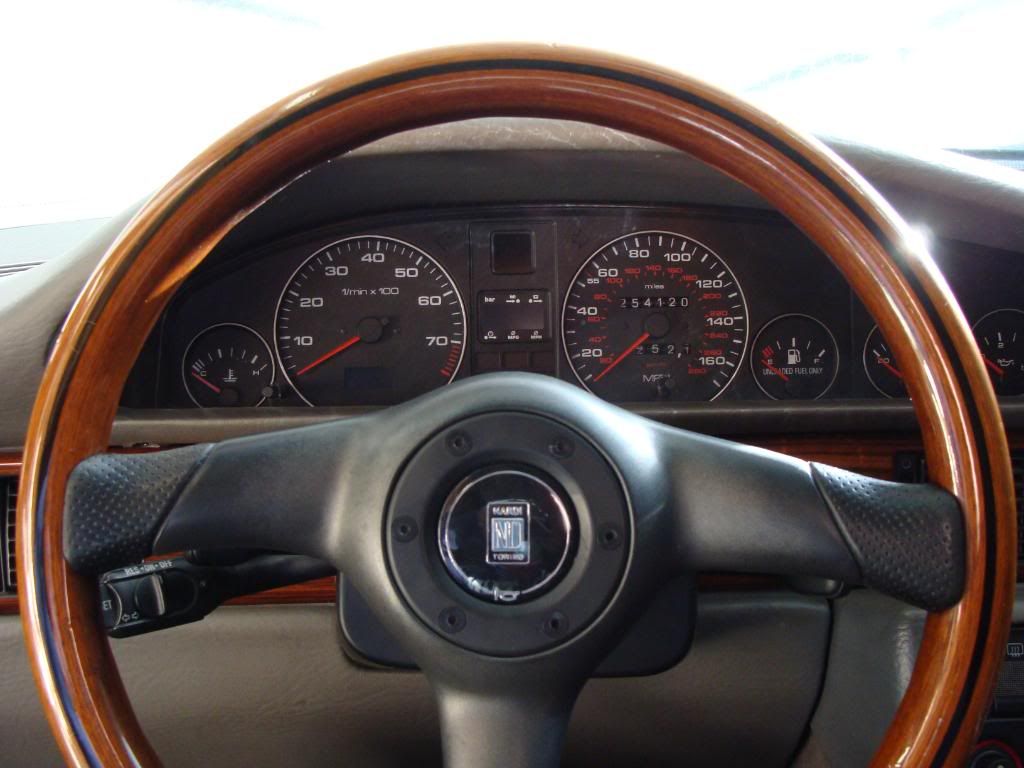

Re: Casey's 200 20v: Inst. cluster finished

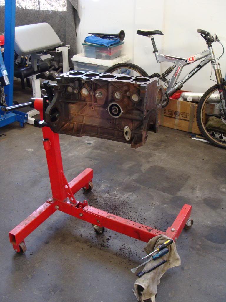

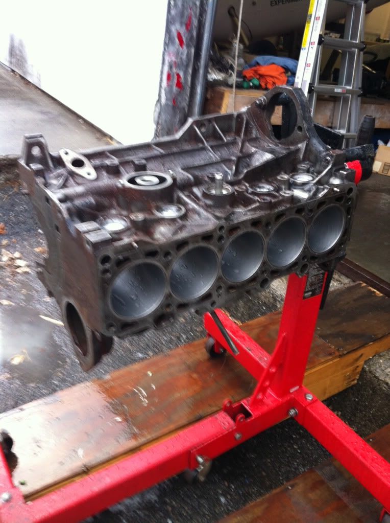

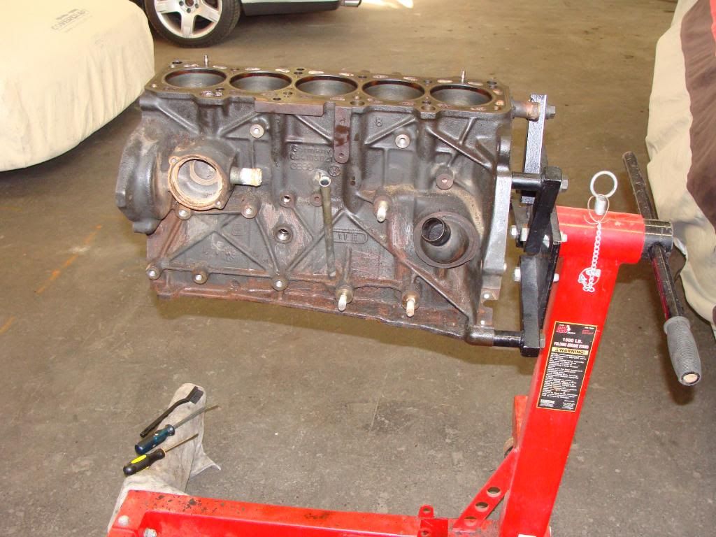

Today I finished installing the gauge bezels and reinstalled the cluster into the 200. Also took a little time give the front half of the car a wash since it still has the salt/grime on it from being towed up to VT last January. I then cleaned up the engine block a bit, scraping off gasket remnants and flaking areas on the outside to prep it for media blast before heading off to get an acid dip and hone.

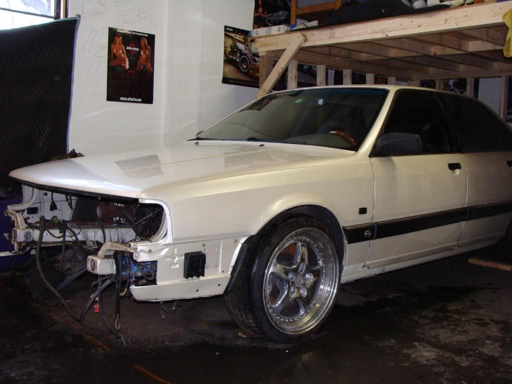

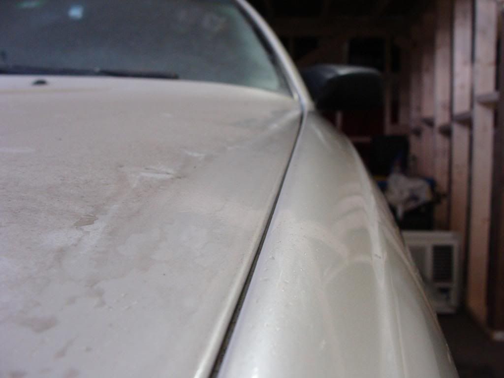

Quick wash...
And the block
nice, I love it and am especially jealous of your nardy
nuugen
I did the same with those rings, with the S4 white gauge faces, looks really sweet..I cut the notches into the back of the 200 cluster so that they lock in..Gluing them in definitely would have been way easier!
What are you doing to the block?

"what are you doing to the block?"
from the looks of it, I'd say SCAT rods going in
Oh yes, full build
I have the goods, just need to prep the block and assemble... And save for an ems

Either way its a pain.. It took far too much time to cut all of the tabs off the rings, but the result is definitely worth itnuugen wrote:I did the same with those rings, with the S4 white gauge faces, looks really sweet..I cut the notches into the back of the 200 cluster so that they lock in..Gluing them in definitely would have been way easier!

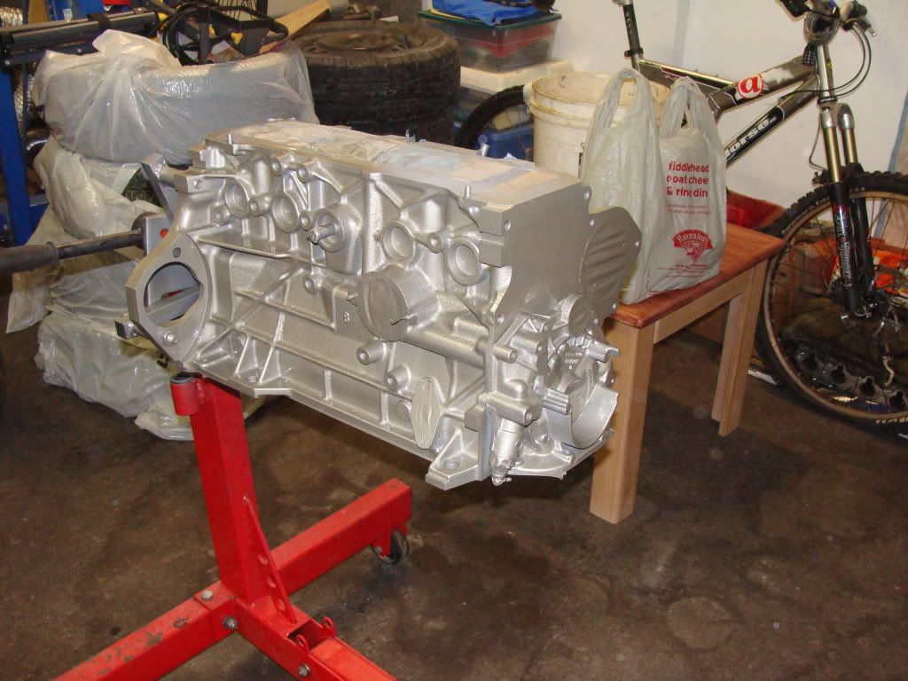

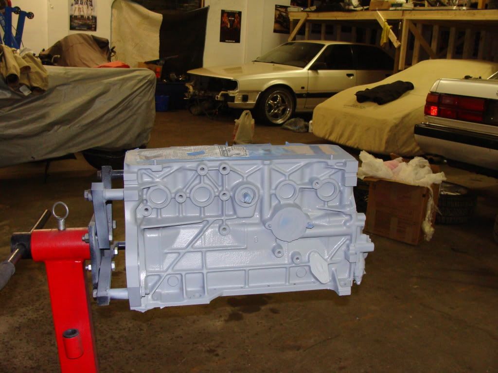

Re: Casey's 200 20v: Block prepped.
Just a quick update before getting back to wedding stuff - getting married this Saturday 8)

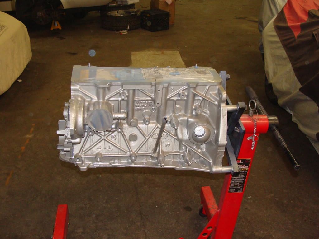

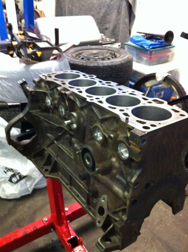

scraped, wire brushed, honed, degreased, power washed, soap n' water, power washed, dried, oiled cylinders/mains lightly, masked off the block, primed and top coated. The color was a ppg in a can I had left over... not a preferred color, but is darker than the pictures make it out to be and is a metal flake gray.

Looking good man! What intercooler is that?
Thanks everyone!
That IC, like my exhaust mani, is an ebay POS... I'll use it for the time being, but there's enough test data out there to convince me I need a real core. That'll happen sometime much later though since I don't anticipate any track use; especially with my wheel/tire setup.
