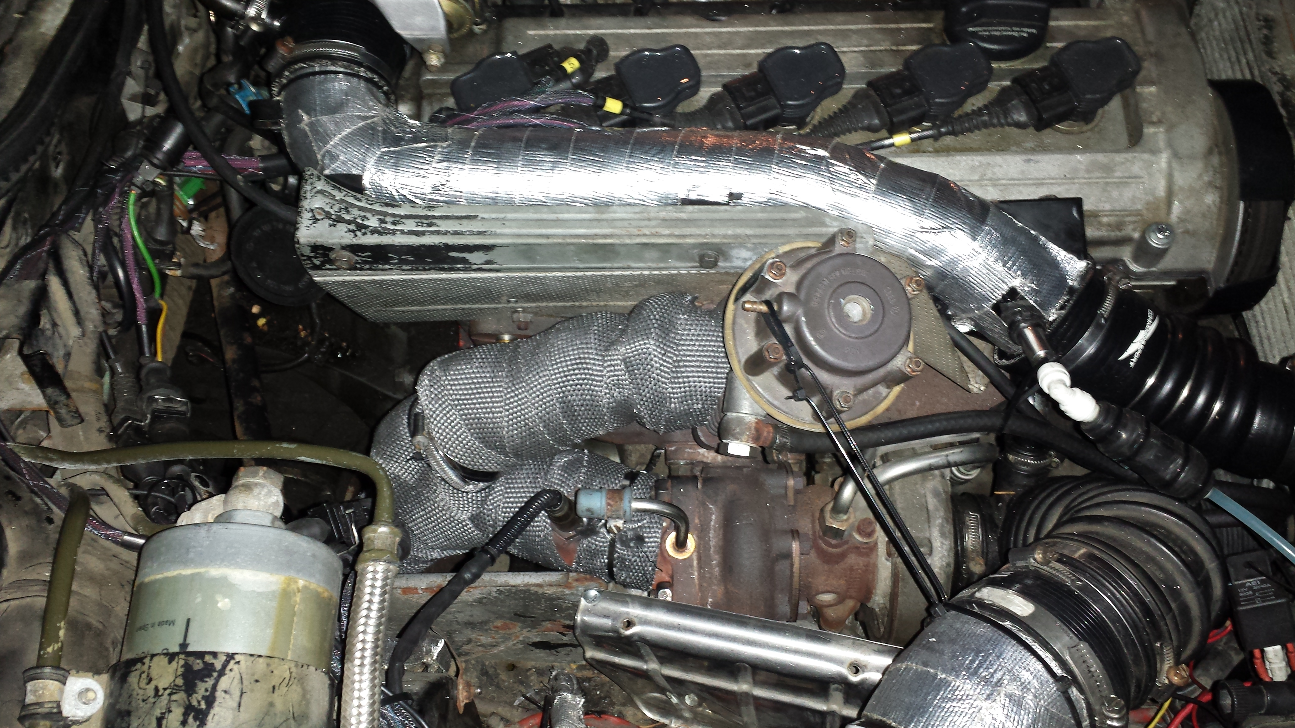

Rightio! I did this today in an attempt to bring down underhood temperatures dramatically. Time will tell me.

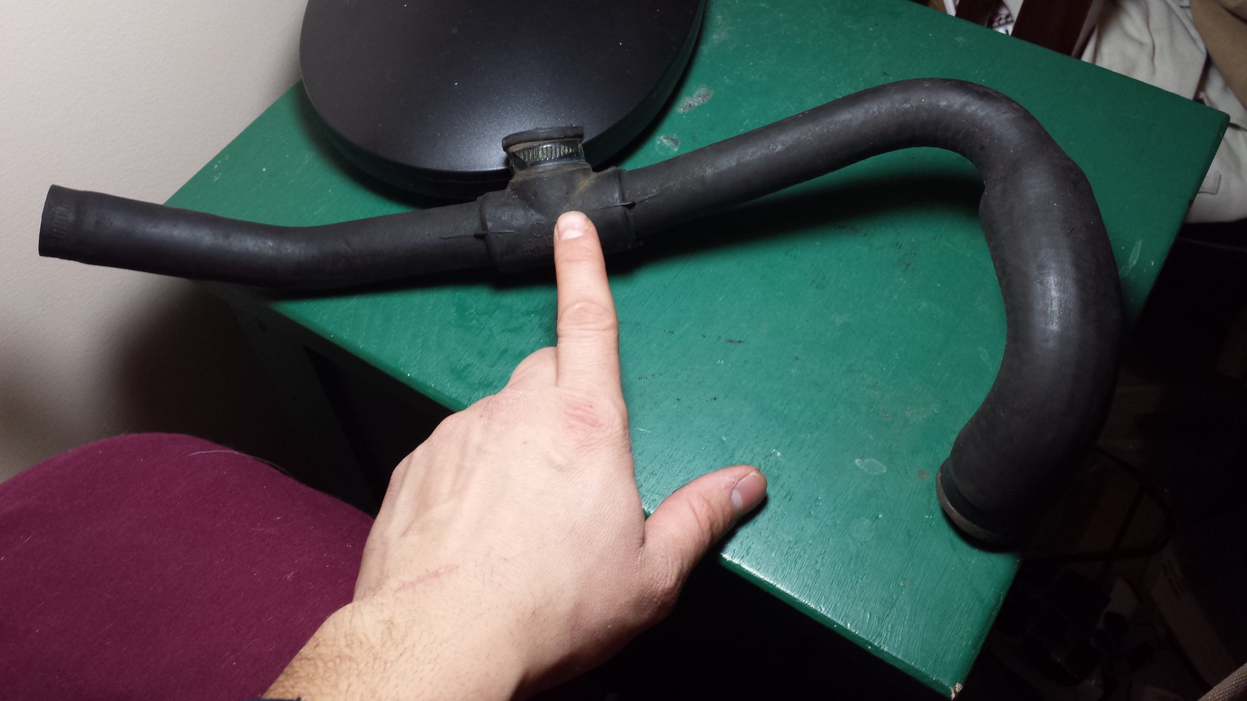

Can anyone provide some insight on why a 5 month old rear main seal would be leaking down through the bellhousing as well as oil showing on valve cover around the oil fill cap? I have ruled out the power steering reservoir as the leak. Also not coolant washing old oil off trans. I'm stumped except for a hunch that the CCV system is blocked or something failed in it. Thanks
Also, no, the mechanic who pulled the Trans for the clutch was not the same ham fisted mechanic that bent my 2 valves. It was done by a much more professional.... professional.
This leak began around the time I redid the valve cover gasket as well if that helps. It's definitely oil. Too much to be the transmission input shift seal. It went from zero to full blown leak in about 2 weeks (since VC gasket).
check your PCV system for collapsed hoses. Pressure will force oil out seals
Thanks. Sounds crazy but I'm glad you confirmed that. I suspect a check valve is pressurizing the crank case on booooost.

I didn't find any collapsed hoses yesterday but I put my 2 spare CCV valves in after cleaning and oiling them for extra insurance. I fear something worse though.

I think I fixed my CCV issue by putting my spare valves in. There's waaaaaay less oil under the car today even with the tremendous beating I put to it today. I think what's coming down is just leftovers that saturated the felt seal cover. IYa dramatically improved and I think my flush adjustment of the snub mount bracket may have contributed as well. It had probably 1.25" upward play before contact with the bracket. I'm blown away by how much more punah the power is at high rpm's now from the adjustment. It's a kick in the balls with the cams! I'm thoroughly impressed lol

I don't know if people think my efforts on my intake look ricer but I'm seeing a drop from 26 C to 12 C at full boost. Now tell me that ain't functional as hell!
that's only 10 degrees above ambient with the stock intercooler. ..
Pipe insulation like that really does make a big difference. Heat transfer is fast even with the air moving that quickly. I did some probing on my M5 with temp readings at the beginning of the intake path and then again at the throttle body. It was like 3 feet of pipe at most and temperatures went up about 50 degrees F over that length just due to engine bay heat transfer.
Wow I could absolutely see problems just as dramatic as that on the 3B with its intake/exhaust configuration. What's amazing is the 400 hp that m5 makes

I'm still investigating the CCV system. All of you who are familiar with the hose below, will me blocking off the port leading to the intake manifold (preventing high boost from playing a role) cause the valves to not allow crank vacuum to take place? Is my free flowing k&n filter not allowing as high a vacuum to occur? "Path of least resistance" and all that. The stock airbox surely made higher vacuum possible with its slightly higher air resistance, right? Thanks to anyone who chimes in

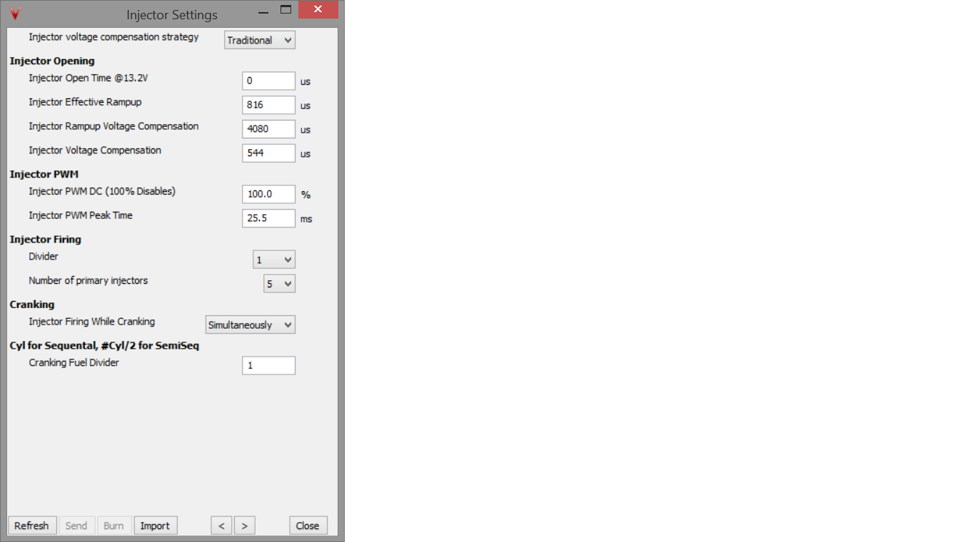

This week I am retuning my fuel VE table and the acceleration enrichment graph since my stock injectors were being stupid in low RPM's. The car stalled too often or encountered hard cold starting far too often for my taste and it was damaging my perceived opinion of how shitty my neighbor thinks my cars are
. I HAD to put the used injectors in in an attempt to solve this embarrassing side effect of old injectors. One of the old injectors had a cracked tip cap also so that may have been jacking up atomization.
I also realized I didn't have the smallest meth nozzle JB welded to my charge pipe as I had thought. I was running piiiiiiiiG rich on the lowest pressure so that needed remedied also.
The new injectors are used with 10k miles with p/n D3165BA . I don't have ANY information on these injectors except for what is turned up on the racetronix website for that part number. Its a long shot that they are the correct injectors IMO. First of all, the measured resistance I got was 15.1 and 15.2 ohms compared to the website's reported 15.9 ohms. What the hell does that mean?! I was a little concerned about that honestly. Im thinking it could be my ohm meter from Harbor Freight just has a % error. The seller is unreachable at this time...
I am getting very strange behavior with these injectors at idle. I have my first 6 VE cells set to 87 in the idle region (3 tall and 2 wide) as that netted the most stable idle with the stockers. Sometimes the injectors provide 0.99 lambda at idle and will go clear to 0.88 without my injector ms changing. That is just odd to me. No changes to my enrichment or afterstart stuff or even changing the fuel VE numbers to lean(er) affect the lambda at the time unless I blip the throttle. When I originally put the injectors in, I was under the impression I could just change the req'd fuel based on the ratio of change in flow cc's. It worked out to a 25% increase in flow if I was following exactly as listed here: http://www.racetronix.biz/itemdesc.asp? ... BA&eq=&Tp= . That link doesn't even give me the injector dead time or ANYTHING pertinent to VEMS settings except for the estimated lb/hr flow rate. Anyway, I calculated the correct req'd fuel value and it was too low by about 8 tenths or more IIRC. way off. Also, my VE table became useless and Im in the middle of a complete remap. I admit that my old tune, though it ran incredibly, was never tuned for fuel VE with meth injection turned off. I am running with it off until I can truly tune fuel. One last note in VEMS. With my fuel VE set to 87 for idle, sometimes it is as lean as 1.09 lambda or rich as 0.88 with that left constant and warm turned off. Its completely different from the behavior of the old injectors in an uneasy manner.
Can anyone help or make a suggestion as to figuring out the injector settings? I feel those are more pressing than the VE table at this time. I just am unsure how to determine the finer details of these injectors and VEMS settings. For instance, my injector angle graph is 720 across the board and my injector settings are still what my base tune provided shown below. THANK YOU to anyone who can be of assistance. I mean that intensely.

I found this concerning the numbers for the inputs in the picture above:
"Rep injector I used Traditional Idel 860 rpm 0,192,4080,544"
Not the best English but I may try that 192 to see if it blows up my engine. From s2 forum
Where did your base tune come from? If it's from Marc, just leave those injector settings alone. They work for anything from stock up to 2000 cc injectors with no problem. If you're having issues, it's either the injectors or the VE table (or some other mechanical issue we don't know about). Sorry I can't get more detailed at the moment, but I'm quite busy. Otherwise, I'd compare your settings to what I know works.
Thanks Chris. I changed that rampup to 192 and things seem to have improved sort of. Glancing down at my lambda I saw the numbers were much closer to target than before. I did have to bump my entire VE table up +5 after the change. The cfg is from Marc. I had a cold start issue that cleared up after going to 192. the rest will probably be handled with the VE table.

Cold start is not addressed by adjusting injector settings...
I'd look into the Priming, Cranking and Afterstart page, the cranking enrichment page, afterstart enrichment and possibly the IAC ref DC while cranking page.
Agree ^^
Cool I'll give those all a look. If I recall now I did mess with the after start enrichment and cranking enrichment curves prior to my injector setting experiment. I guess I left them slightly higher than originally. The issue was enrichment only netted me 1.15 lambda upon cold start. It ran like a potato

That's the warmup enrichment table. Granted those fields are perfect when up to temp.
