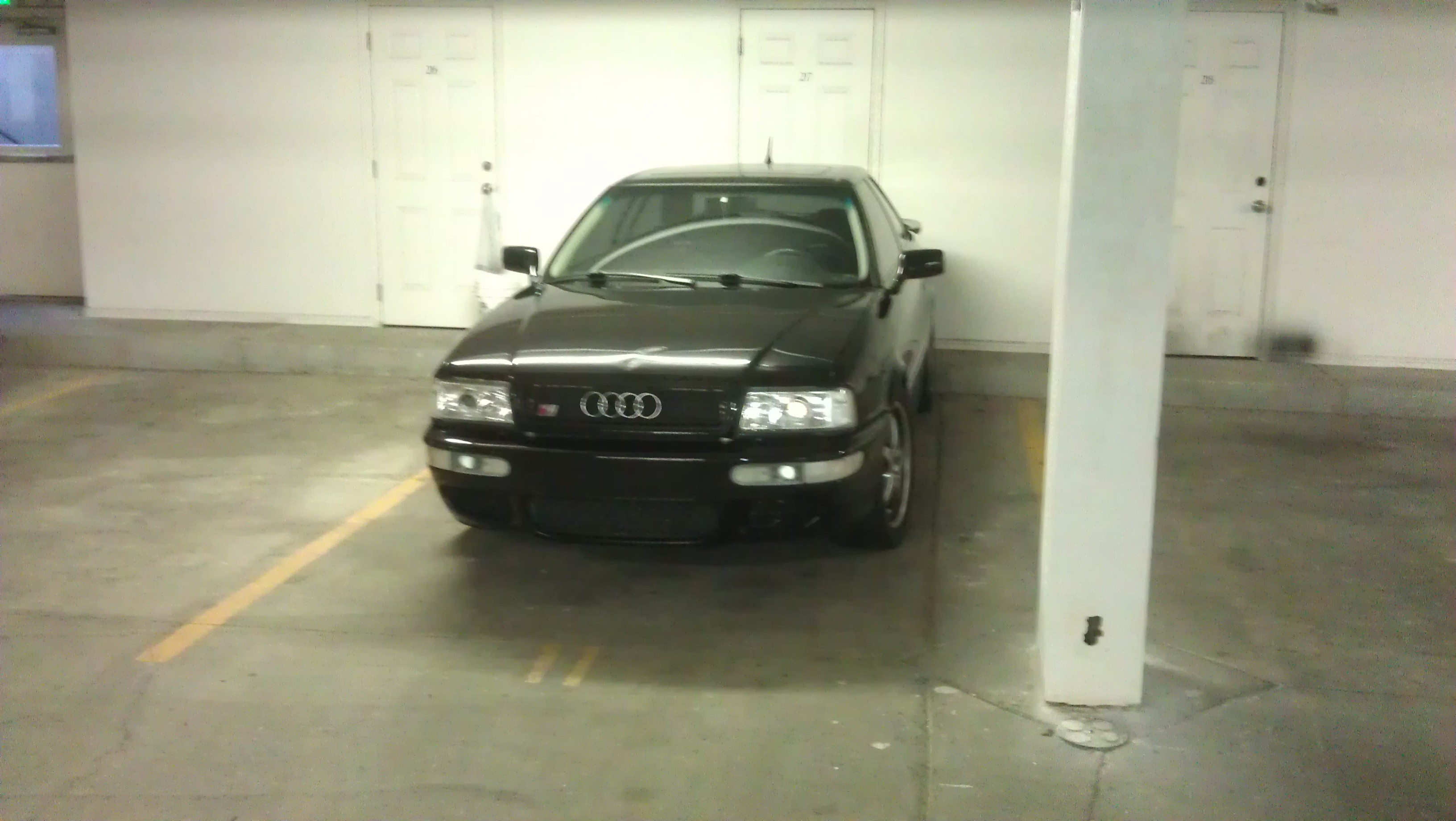

Well, I have done what I could to have this car ready to go on a trip 430ish miles away. I did not get a chance to fully break in the engine before the trip, It will have to be done on the drive. I have managed to put about 80 miles on it so far. Nate and I will be leaving here early afternoonish and will prob make it down there in about 5-6 hours. The days of salt lake to vegas in 4 hrs and 30 minutes are long gone thanks to the UHP. They have bulked up in force since then, and its more dangerous to give er the gas now a days. but, thats ok since the speed limit is now 80 mph throughout most of the Utah I15 corridor. At least its not super slow.
I have found that the radiator is working, and not leaking. It does need a fan shroud to help keep the temps controlled at a quicker rate. I will need to design and cut the shroud when I get back, and wont be going on any long scenic desert drives while Im down there.
Here is a crappy cell of it in its ready state.

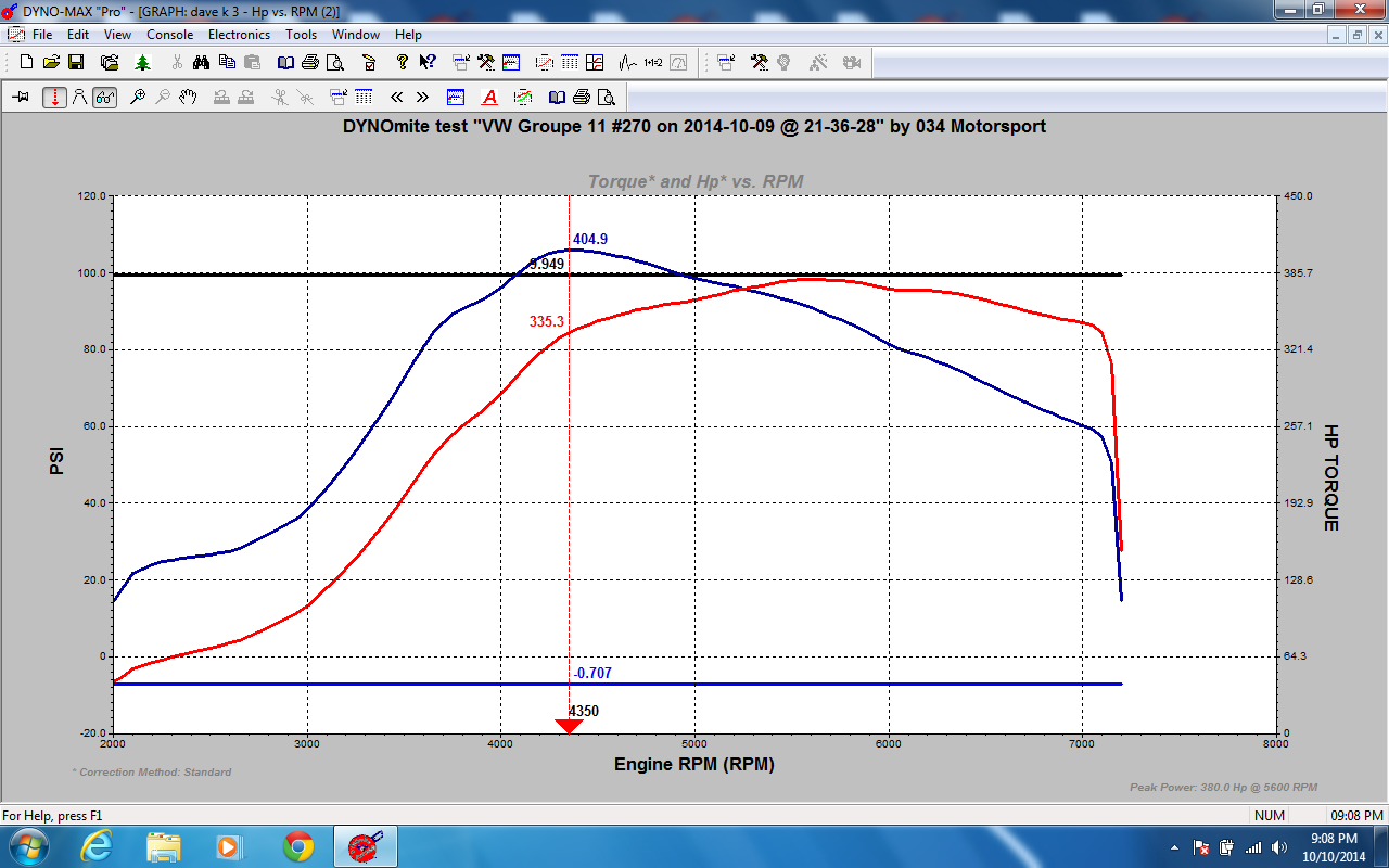

have fun. Go find another shelby gt. Also, how do you like the mounts?
scubadave
Posts: 496
Re: CQ project, the road less traveled (Done all I can)
Post by scubadave »
dave k e85 billet k26.png (131.37 KiB) Viewed 48305 times

I have the record for this turbo!
