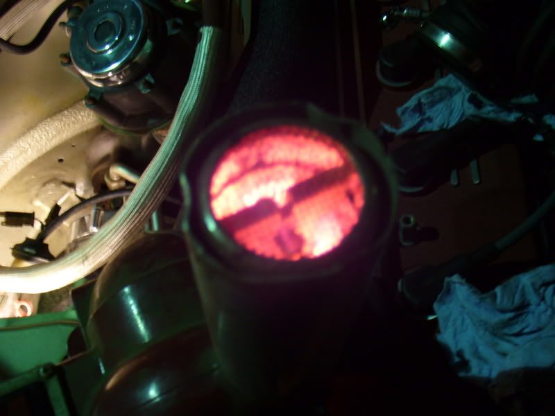

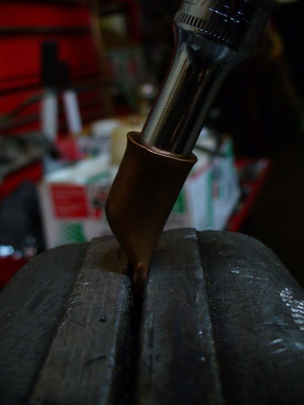

got the turbo and all its lines on and tight. i got rid of those STUPID allen bolts that hold them on too. gah, i hate those things. i always save the flange head bolts from oil pans when i take them off as they always clean up and have those anti releasing teeth on them.

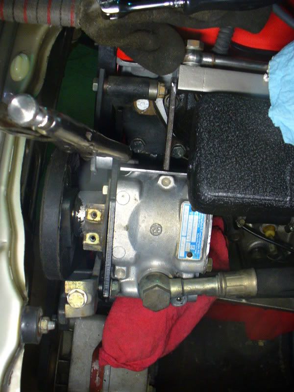

i'm also still working on a P/S pump mount. i tinkered a bit yesterday off an on trying to get something sturdy worked out.

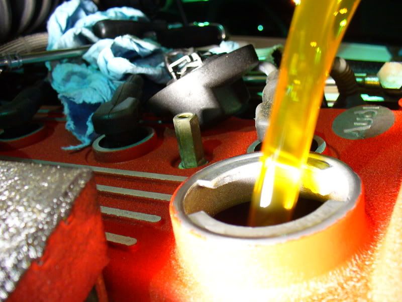

i also added the life blood of an engine! oil....
...which i had to drain back out because it started to drip out of the bolts on the oil pan extension. sooo, i gotta clean those out and put some sealer on the threads so i can put oil in and make it stay :P

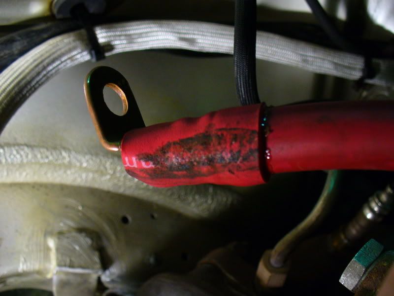

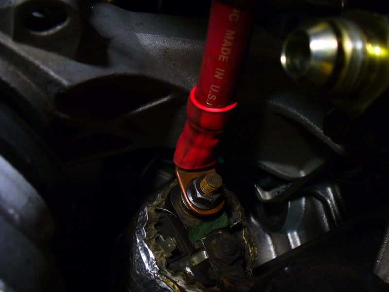

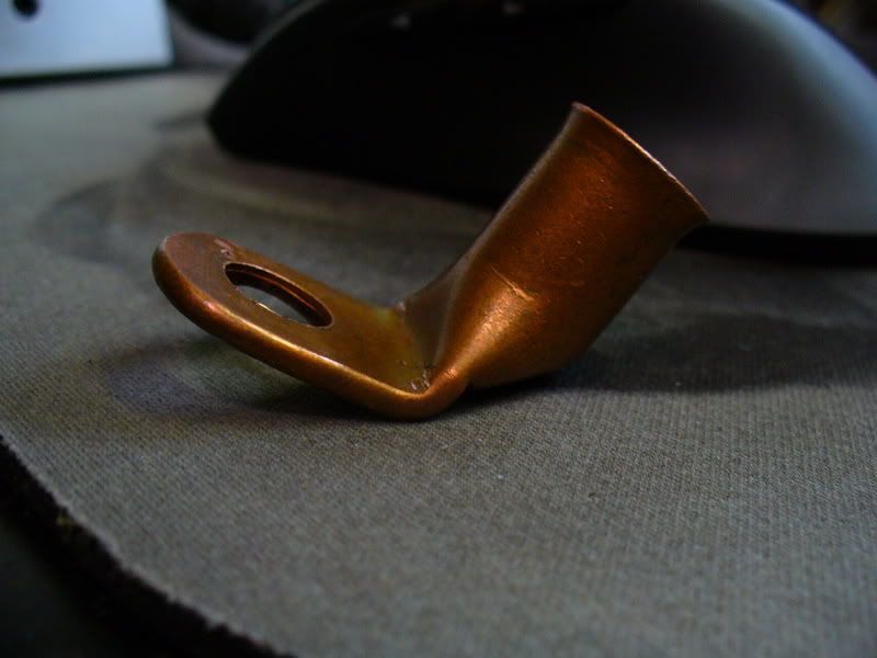

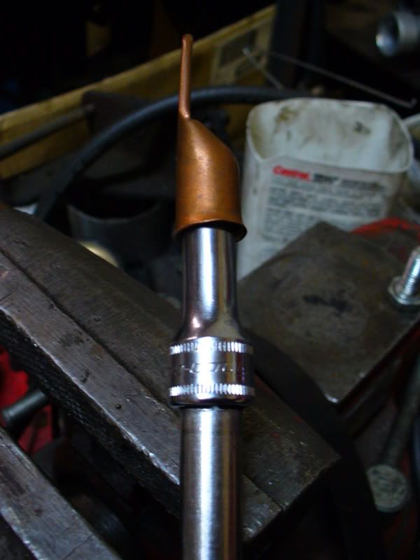

last thing i did was finish up the battery wire to the starter. it's a tight fit in there and with the straight lug there's no way it'll work. so i had to bend it a bit to make it fit.
then i shrink tubed some shrink tube over the hair drier of death :D
bolted in place :)
i need to replace some of the wire on the solenoids as they've done the crumbly jumbly that seemingly every one of these things does. hmm, other things, the alt. is now in place, and once the P/S pump brackets are finalized, i can stick the radiator and shrouds in. then i'll be getting reeeeeeeeeeallly close :D
