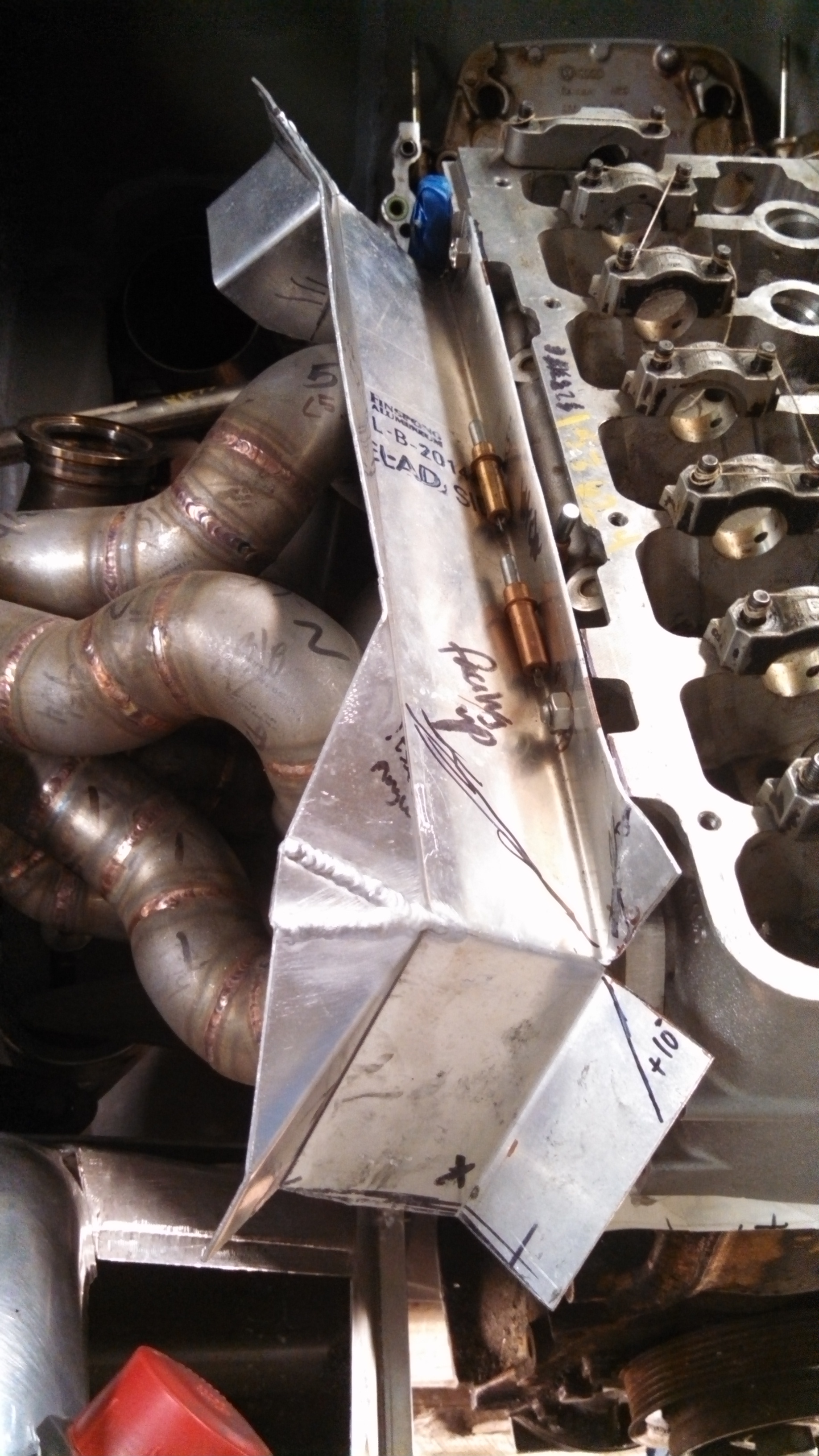

24vVR6T CQ Project: EATSGTR rear firewall fab.
MORE!!!
I also got started on the hanger braces for the turbo/ex mani and the downpipe as well.
Just a few sneak peeks of the mounts for the braces, those will likely get finished this week as well.

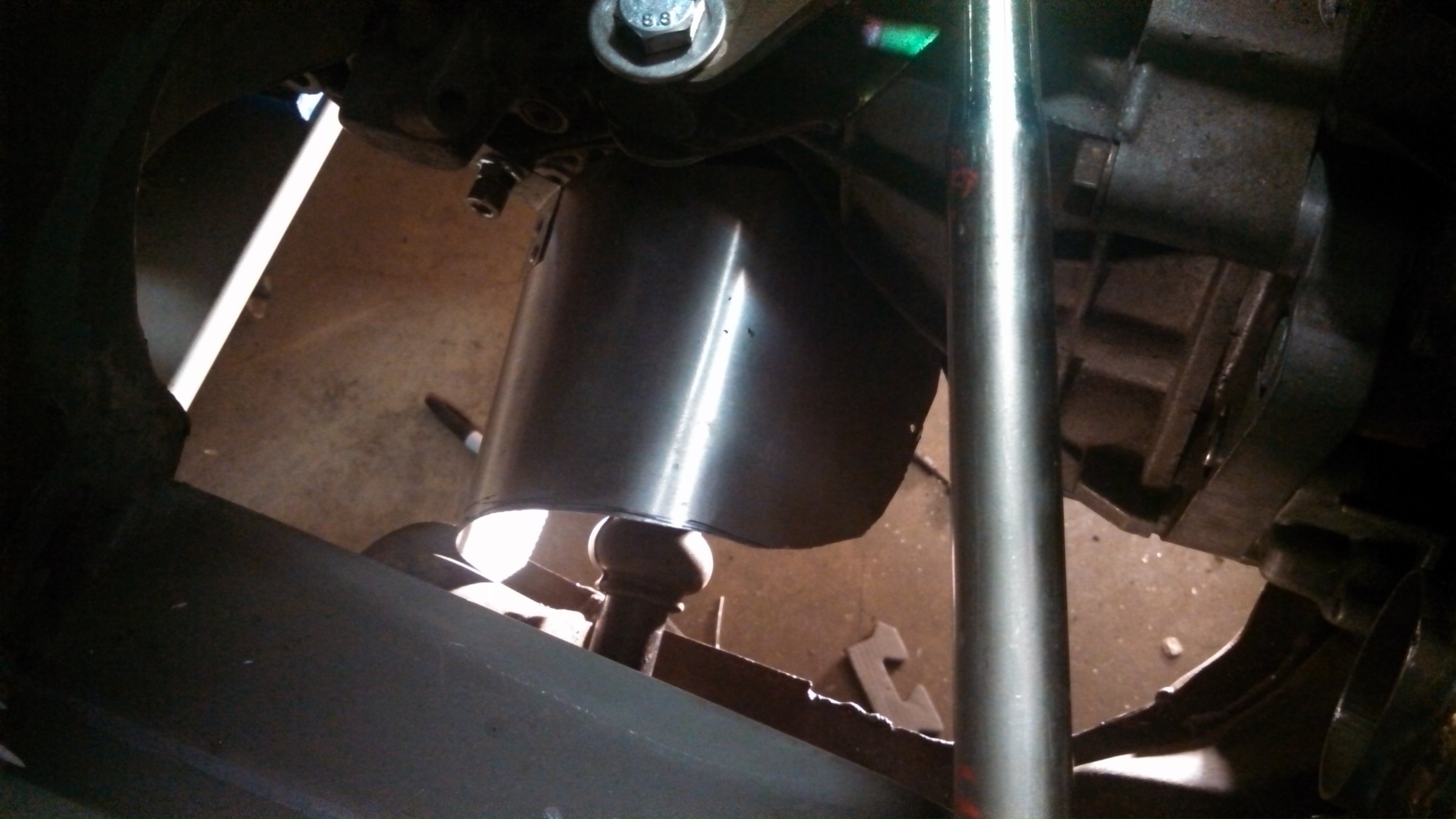

I also made up a heatshield for the front passenger CV boot/joint, its ultra thin alu for now and ease of mockup, I’ll be making it out of 0.125” aluminum sheet for the final version.
front pass cv boot heatshield.jpg (1.05 MiB) Viewed 61869 times

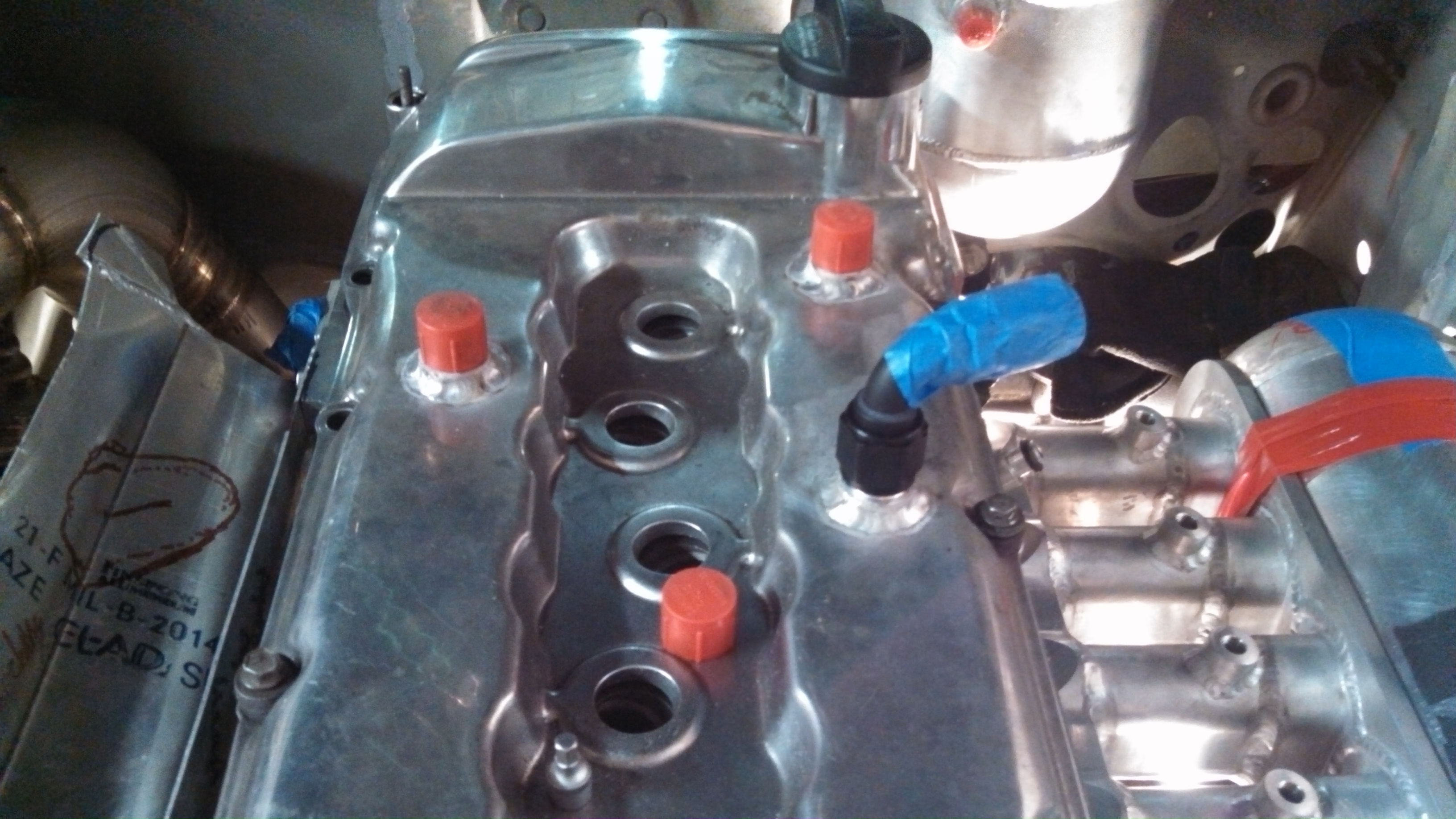

Ok let’s get caught up. I got 3X 10AN male bungs welded on my valve cover for the catch can lines.
valve cover breather bungs.jpg (1.35 MiB) Viewed 61405 times

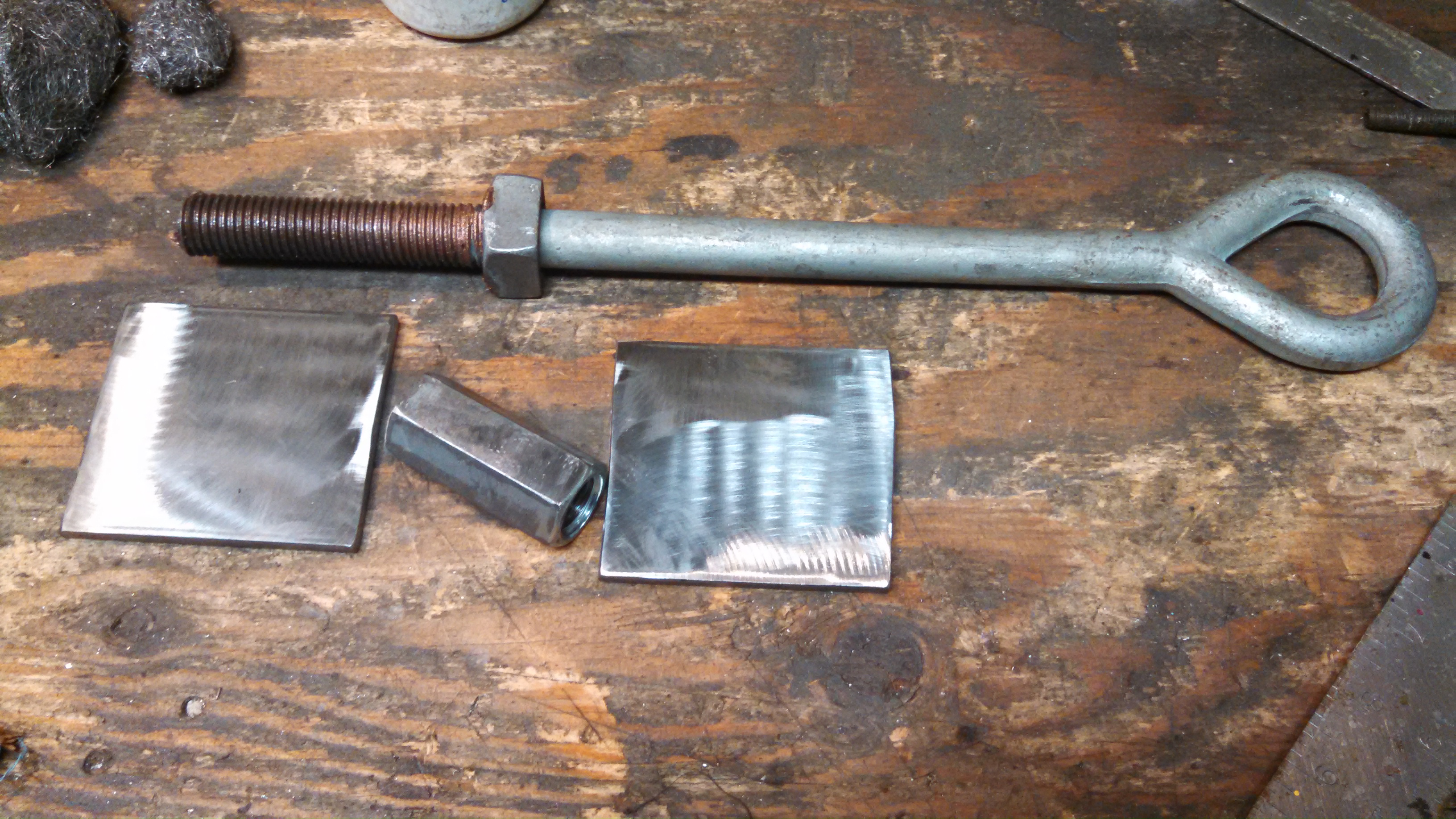

Last fall Jim and myself stopped by a scrap yard a few towns over and I found a few of these!!! They are from electric pole turnbuckles. They shoduld make for some good, strong, removable tow hooks. The longer one goes in the front, so it can stick out through the bumper and the rear is a bit shorter and even thicker ahahah.
extra rugged tow hook.jpg (1.9 MiB) Viewed 61405 times

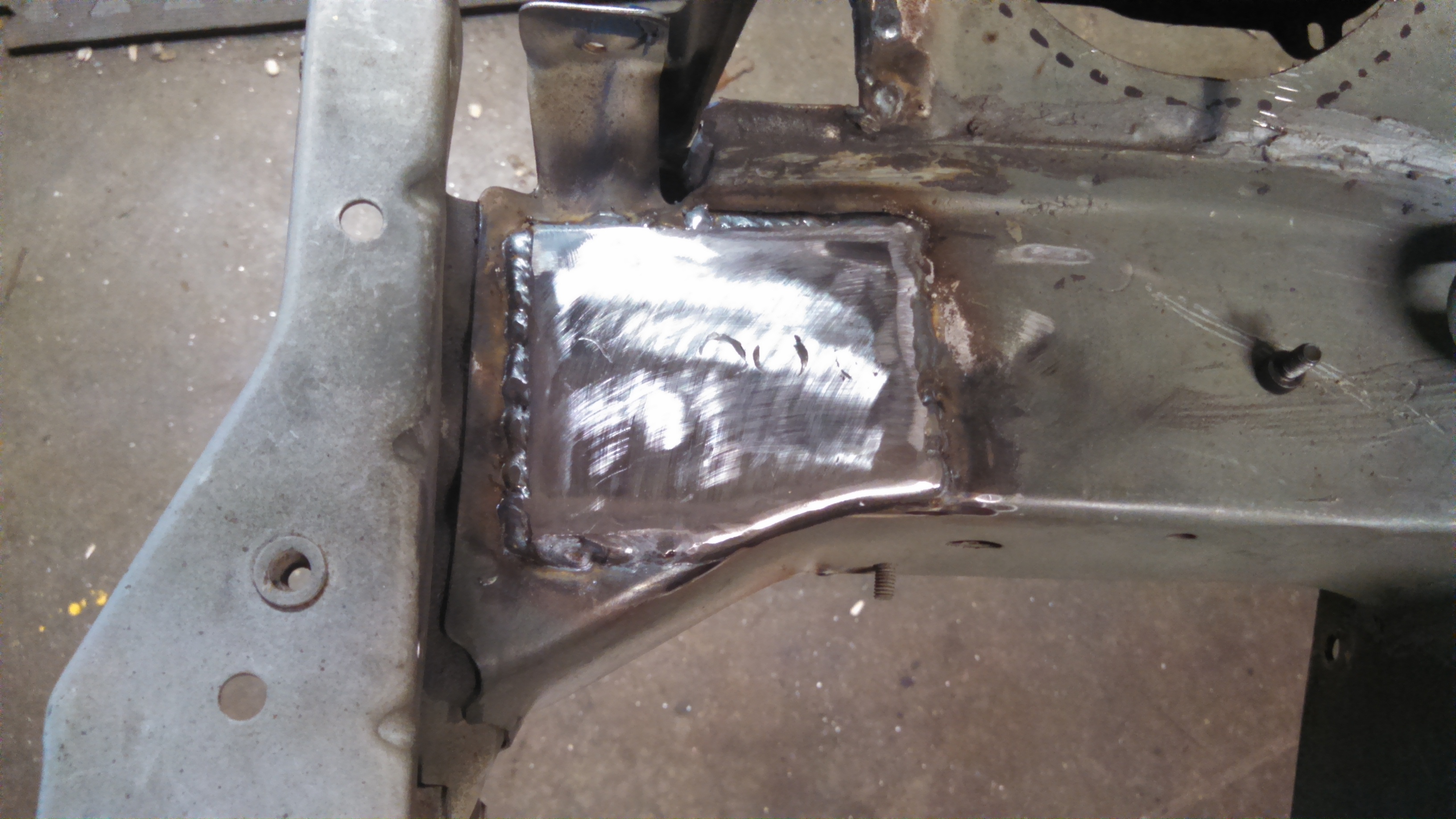

I welded a plate on either side of the reciever threaded part. The plates are slide up through a hole in the bottom of the frame rail, up into slots cut for the upper edges of the plates and seam welded on either side.
front tow hook reciever plated into framerail.jpg (1.13 MiB) Viewed 61405 times
They are a tad recessed and only need a little bit of flapper disc to make them smooth. I then welded a 2x3” plate around the entire area. It had qty. 8, 3/8” holes in it along the weld seams of the reciever’s plates. And again plated and seamed below the framerail. I just need to drill a hold in the front aluminum cross member for the tow hook. I knew I was going to do this when I built the front cross member and there is a ¼” wall thickness 1.75” tube going through the mounting plates for just this purpose.

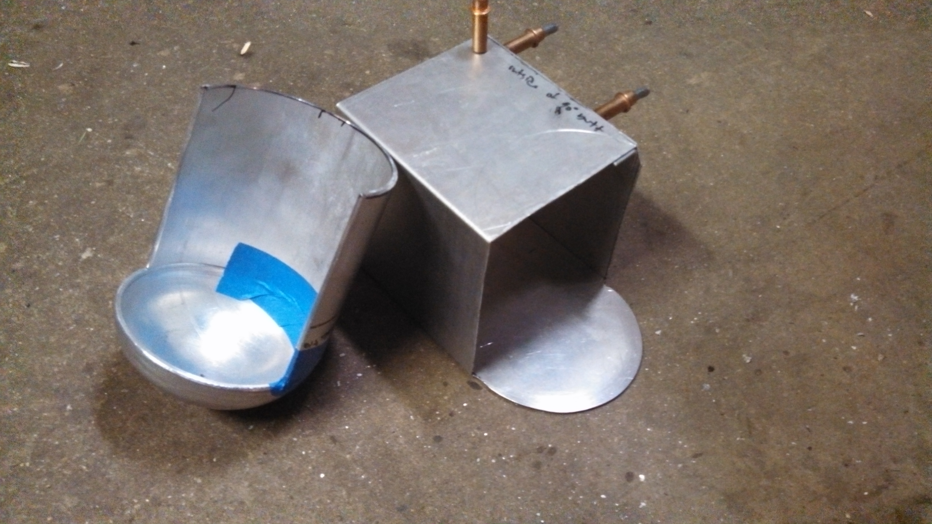

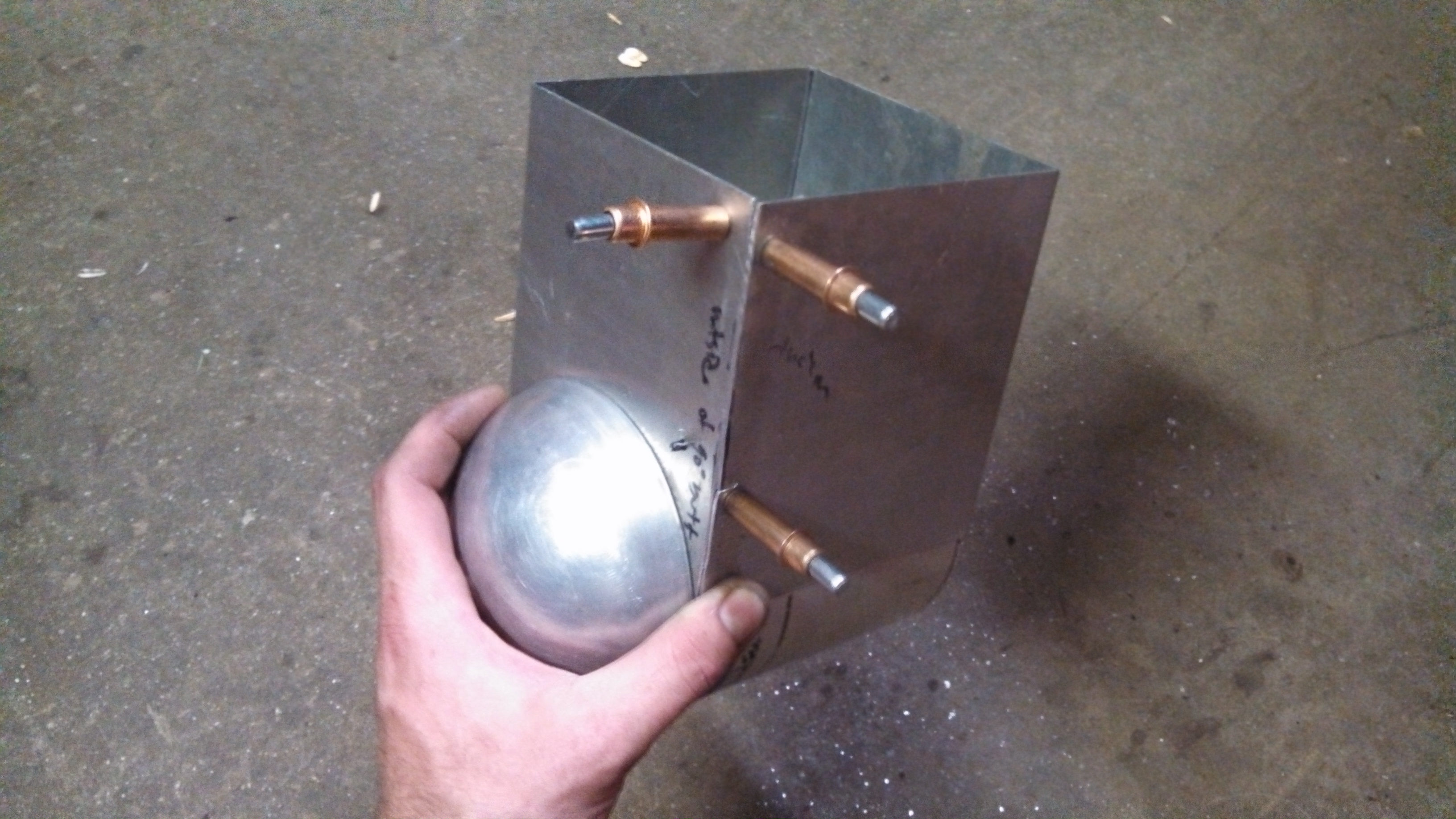

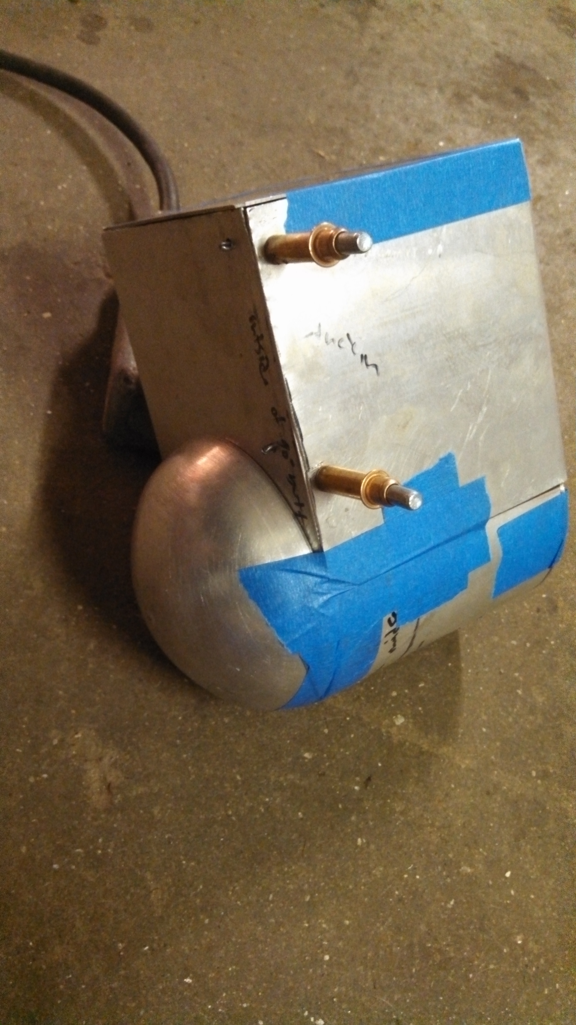

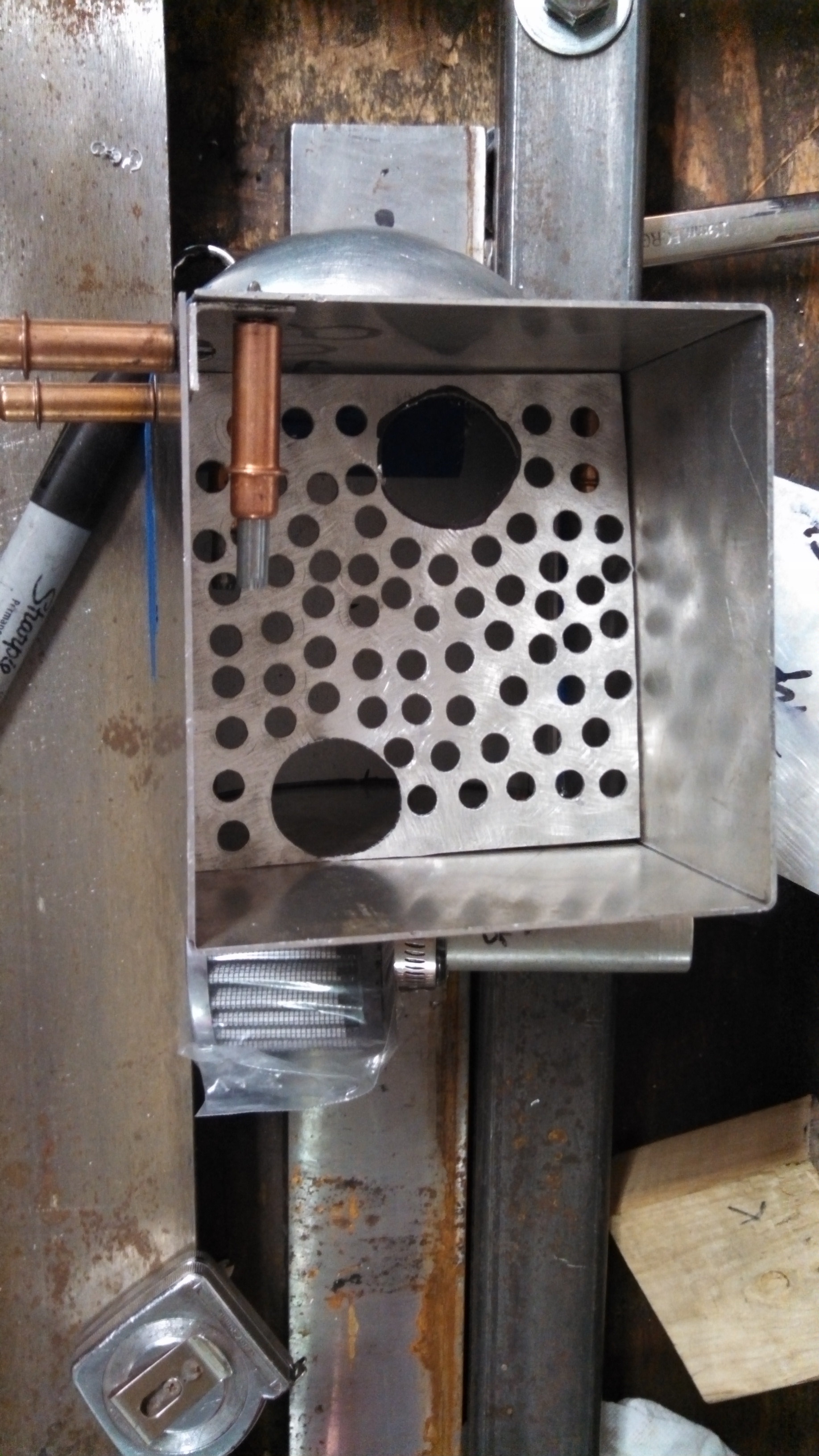

The catch can will be mounted under the strut tower bar just like the coolant tank. I will make it out of some round stock and a cap, as well as a box for the upper.
Here it is as a template
catch can lower template.jpg (1.71 MiB) Viewed 61403 times

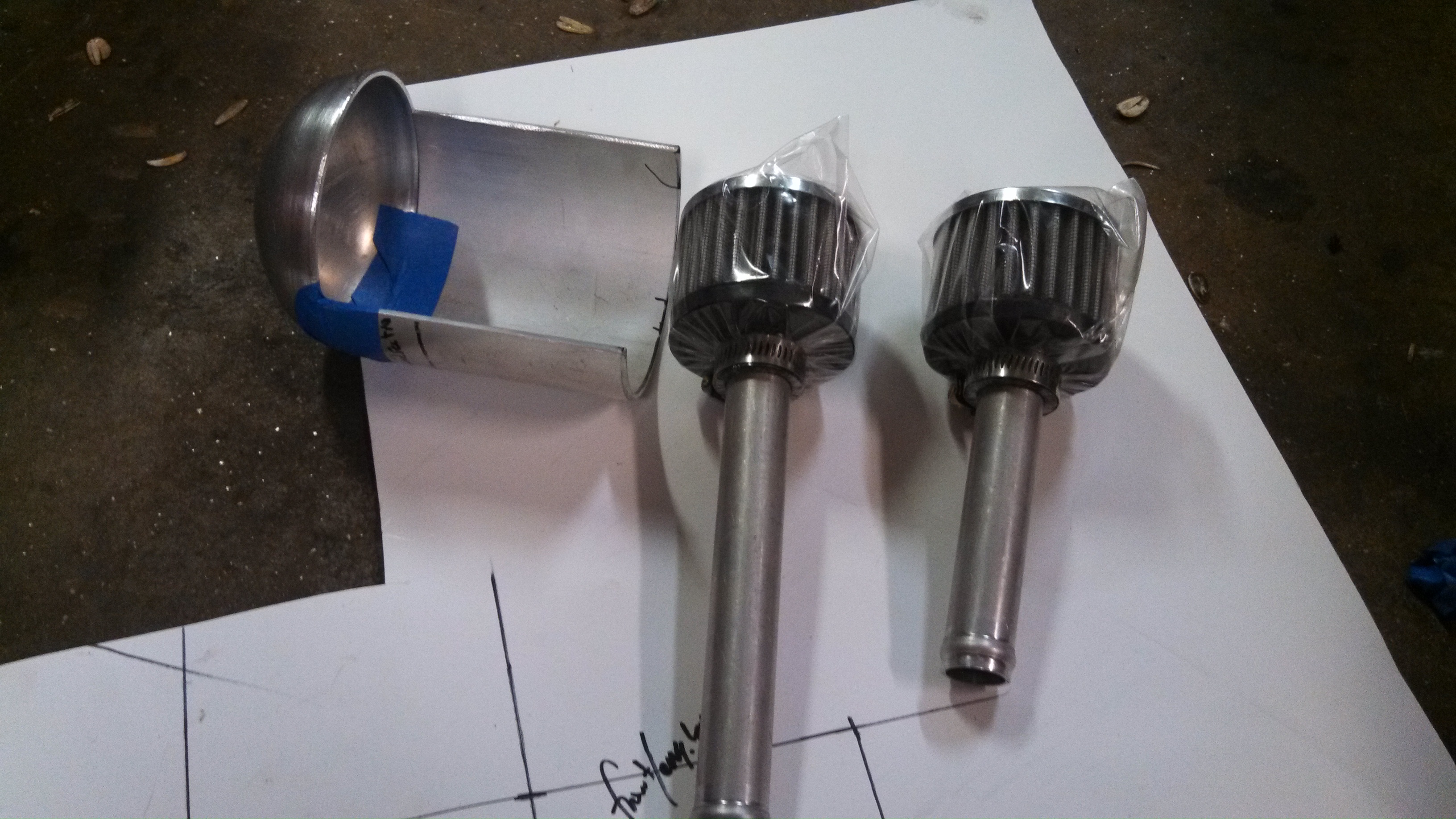

I am using dual K&N 1” breather filters on the catch can outlet. I went a tad over the top and beadrolled the ends of tubing where the filters attach. If there is any real pressure buildup to the point of needing the beadroll, I’d be screwed. So its more of a fit and finish thing.
catch can breather tubes.jpg (1.71 MiB) Viewed 61403 times

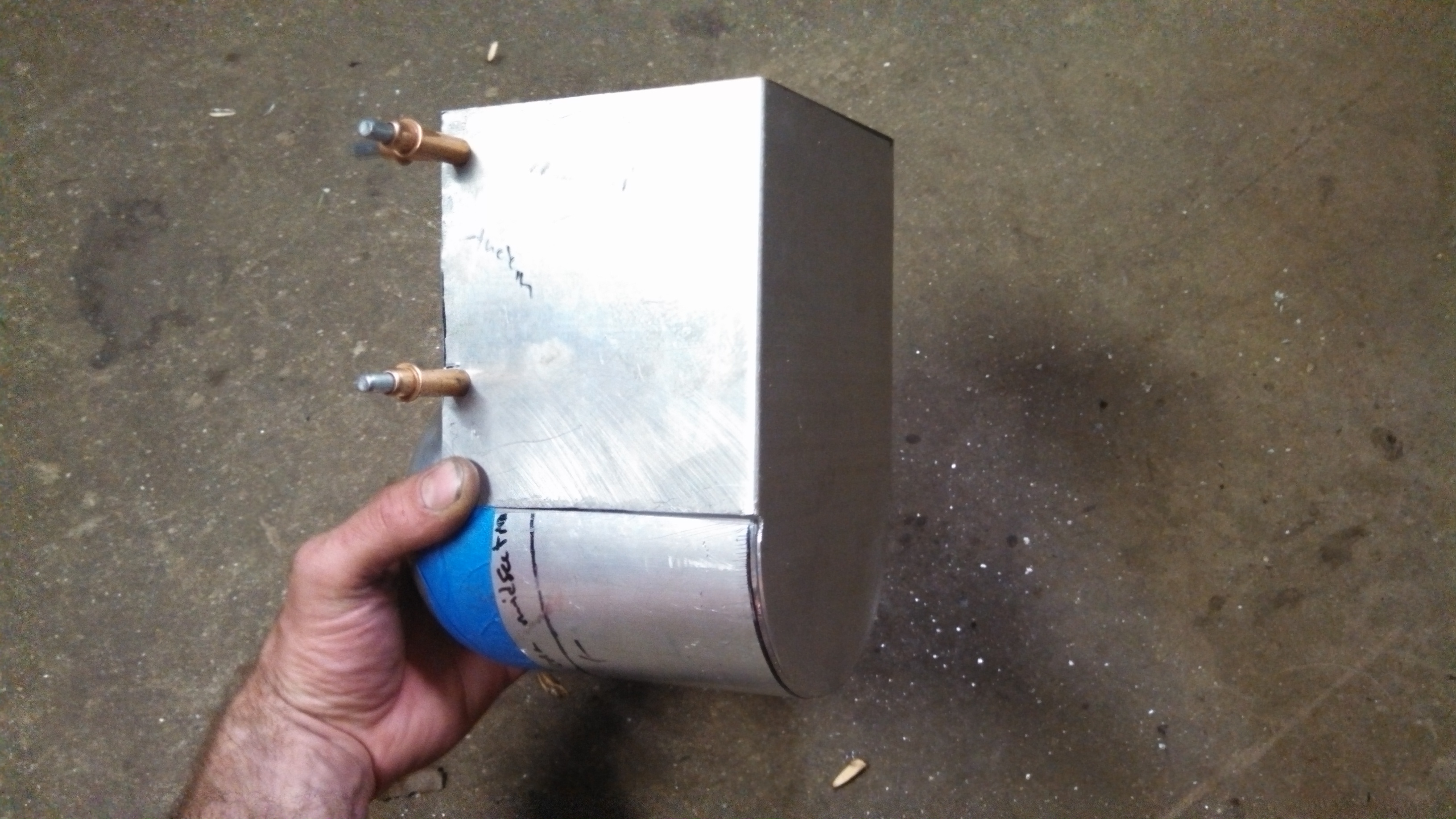

And taped together.
catch can body mocked up.jpg (1.62 MiB) Viewed 61403 times
catch can body mocked up2.jpg (1.44 MiB) Viewed 61403 times
catch can body mocked up3.jpg (1.39 MiB) Viewed 61403 times
MORE!!!
Catch can ready to weld.
catch can body ready for welding.jpg (1.47 MiB) Viewed 61420 times
I drilled a ton of holes in a thin plate and will be using that as a separator layer for the media.
catch can media sep layer in can.jpg (1.45 MiB) Viewed 61420 times

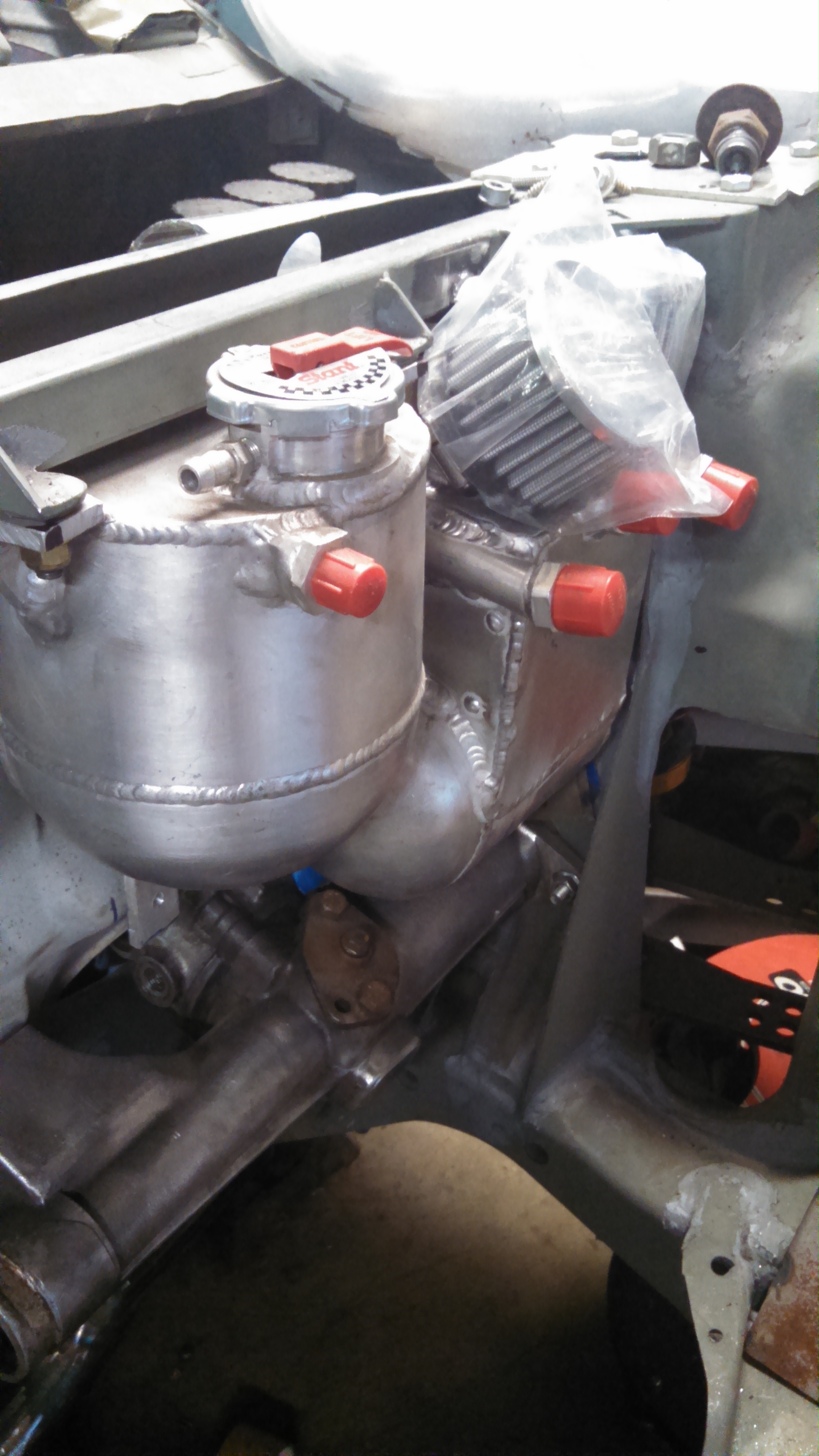

And here is the catch can all finish welded and mounted up. I still need to clean it up a bit near some welds,( thin thin material) caused a few blisters. Give it a good sandblast and some clear powdercoat.
catch can finished and mounted.jpg (1.1 MiB) Viewed 61420 times

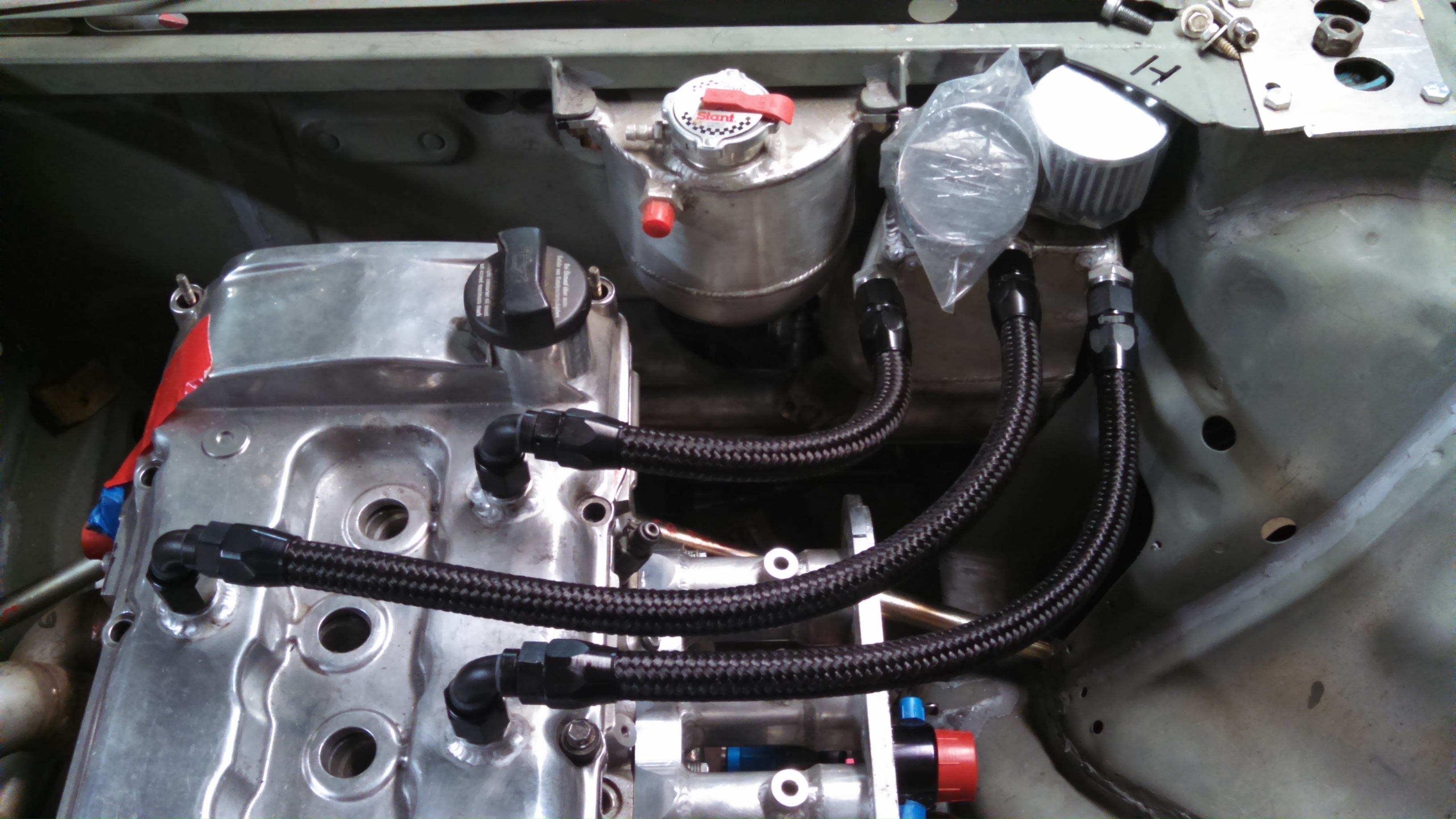

I then made up the valve cover to catch can lines in Earl’s black Pro-Lite 350 Hose, 3X 10AN 90’s to straight’s, into the can.
they are just threaded on and not correctly aligned.
catch can lines.jpg (1.24 MiB) Viewed 61420 times

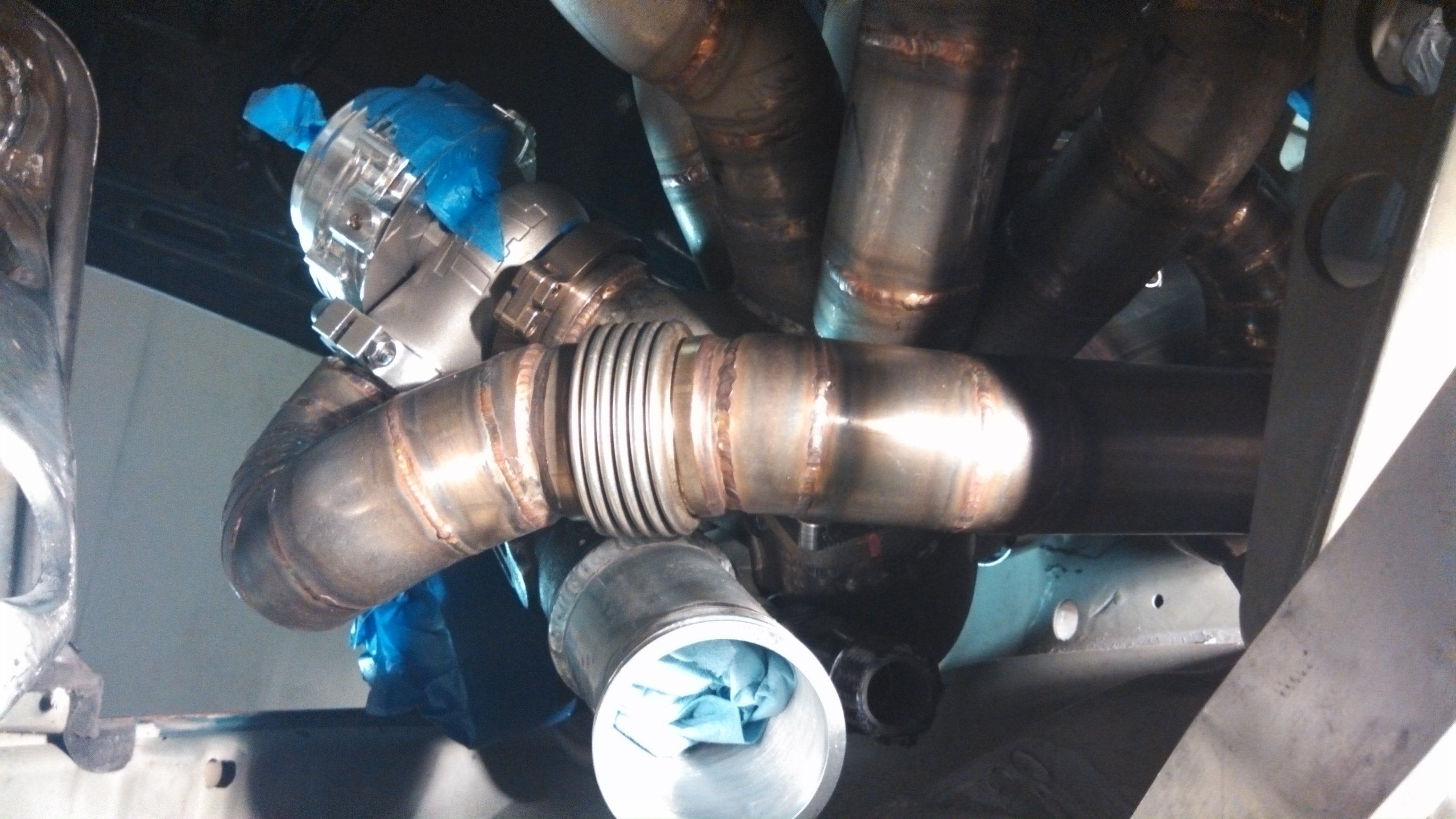

UPDATE!!!

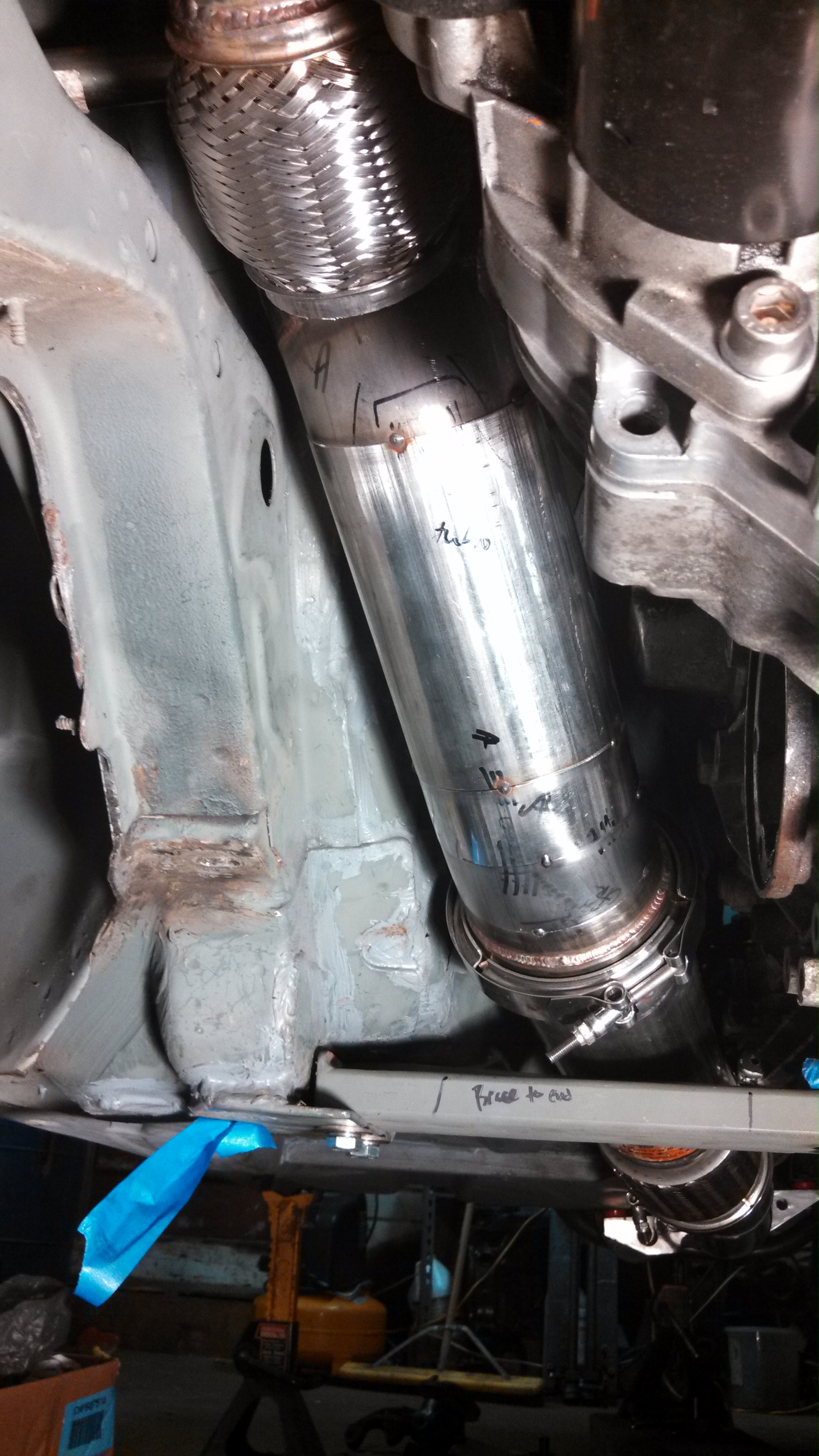

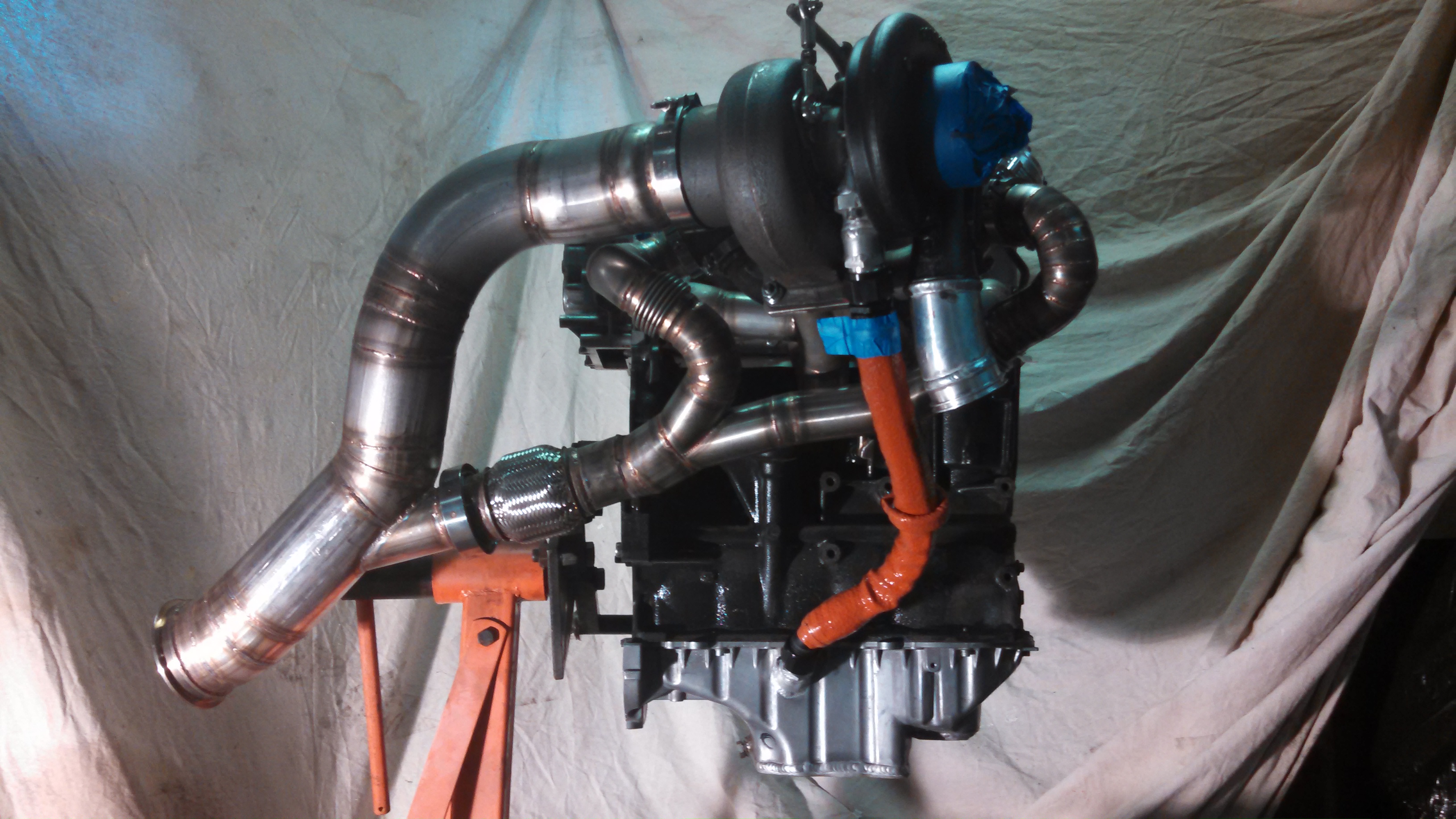

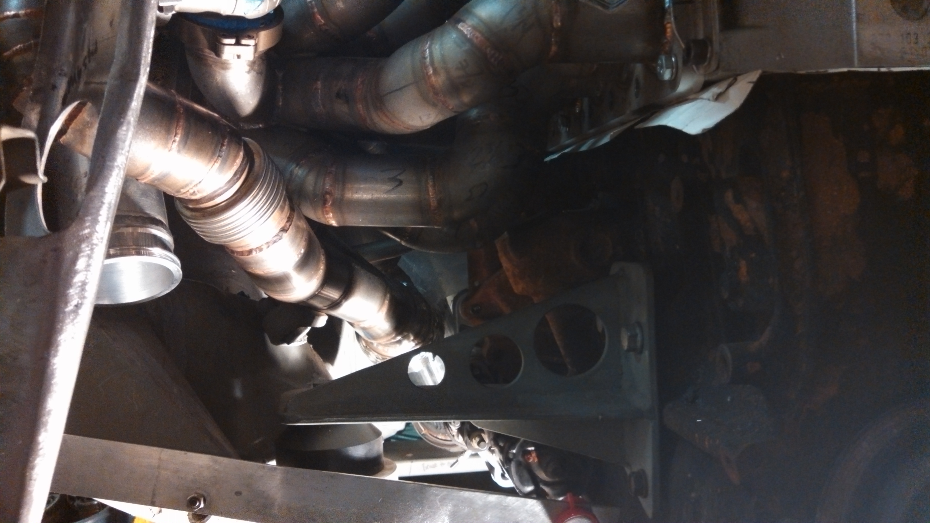

I finally got back into exhaust work after taking a short break from stainless. Here is the downpipe, nearly ready except for adding a small wedge.
DP jsut needs a wedge.jpg (1.13 MiB) Viewed 61417 times
Lower portion of the downpipe tacked together.
downpipe from under, tacked.jpg (1.61 MiB) Viewed 61417 times

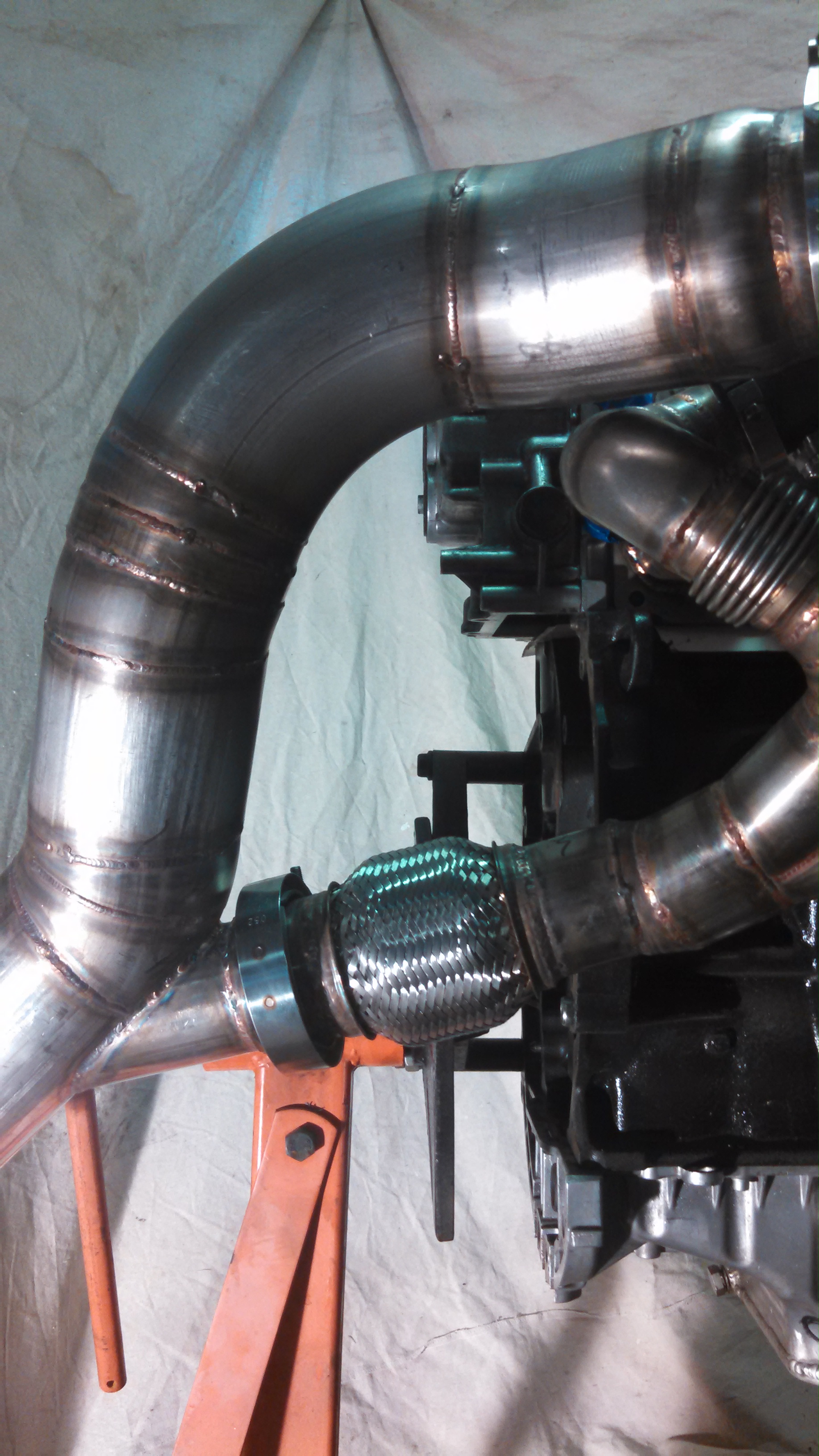

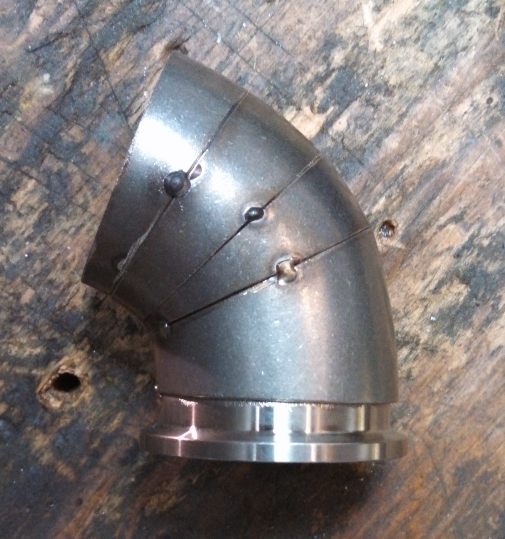

Here is the front Wastegate outlet that needs to be finished. It’s a bit tight up front with the Wastegate outlet, airbox intlet, headlight, radiator and shroud, but it fits!
need to finish Front WG.jpg (930.89 KiB) Viewed 61417 times
front WG dump connection.jpg (1.43 MiB) Viewed 61417 times
Start of the tight radius outlet for the front Wastegate.
tight radius WG outlet.jpg (678.33 KiB) Viewed 61417 times
MORE!!!
Completed front Wastegate outlet
front WG tube.jpg (1.23 MiB) Viewed 61415 times
front WG tube2.jpg (1.35 MiB) Viewed 61415 times
front WG tube3.jpg (1.21 MiB) Viewed 61415 times
front WG tube4.jpg (1.28 MiB) Viewed 61415 times
front WG tube5.jpg (1.83 MiB) Viewed 61415 times
MORE!!!

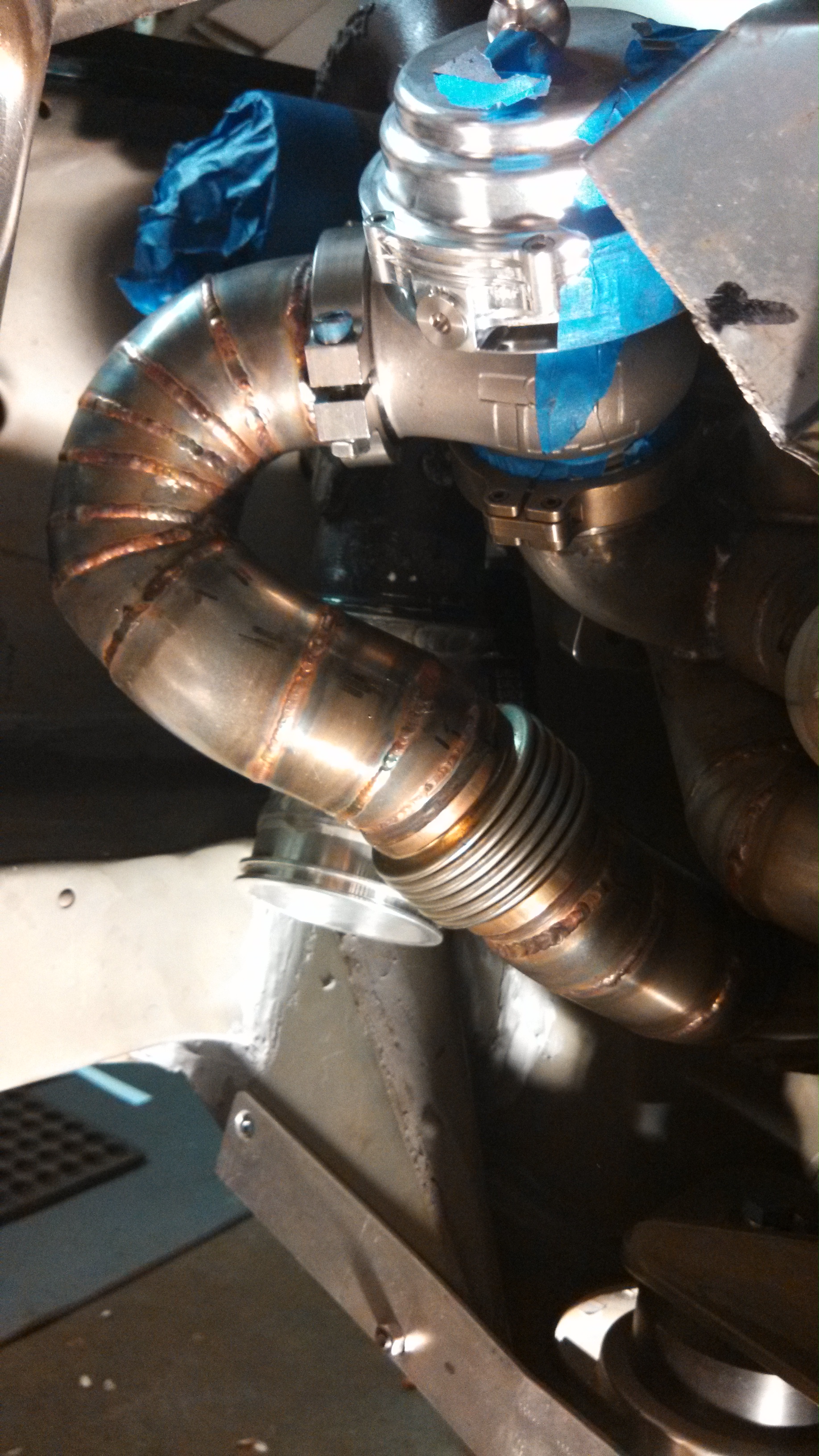

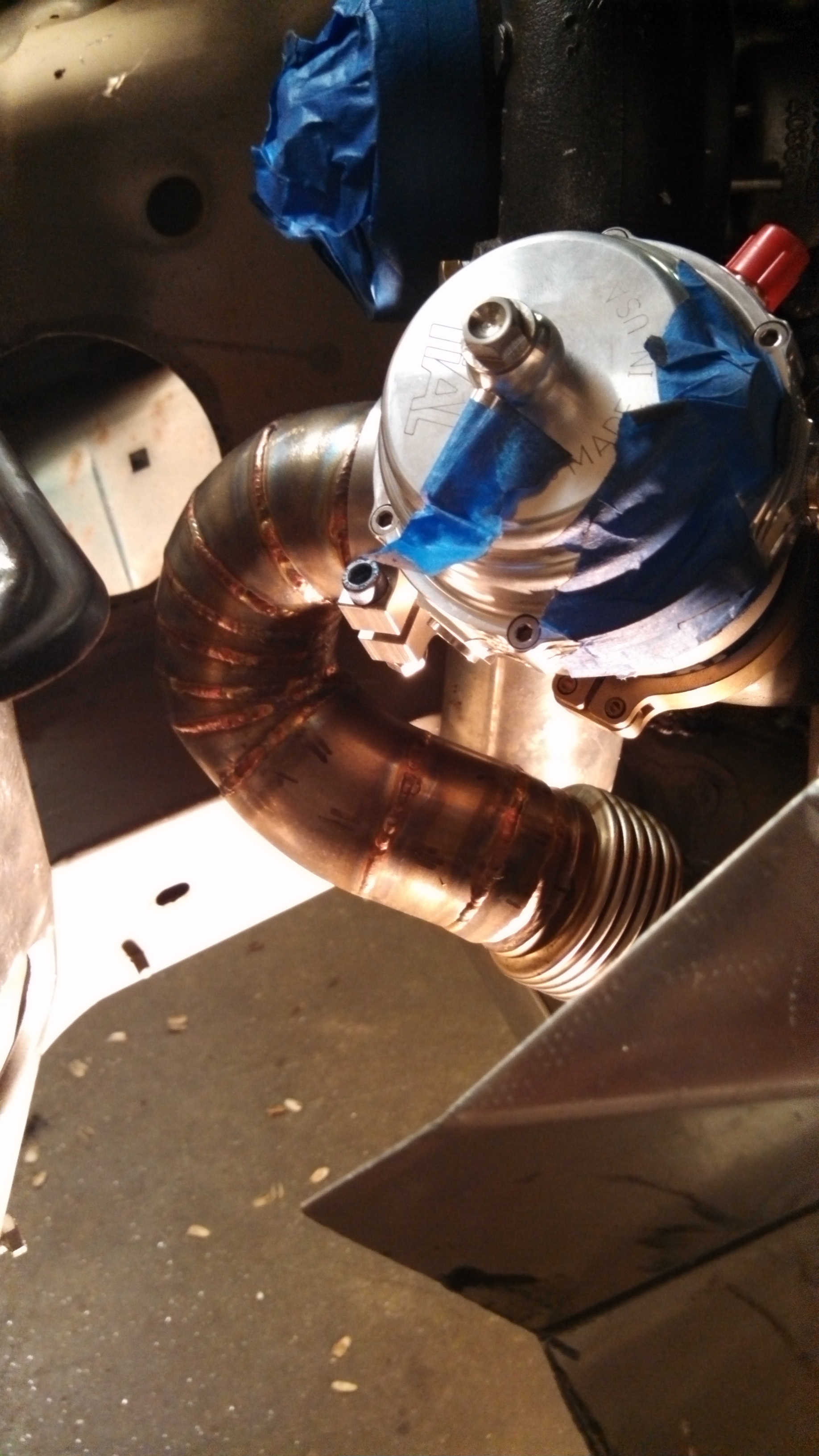

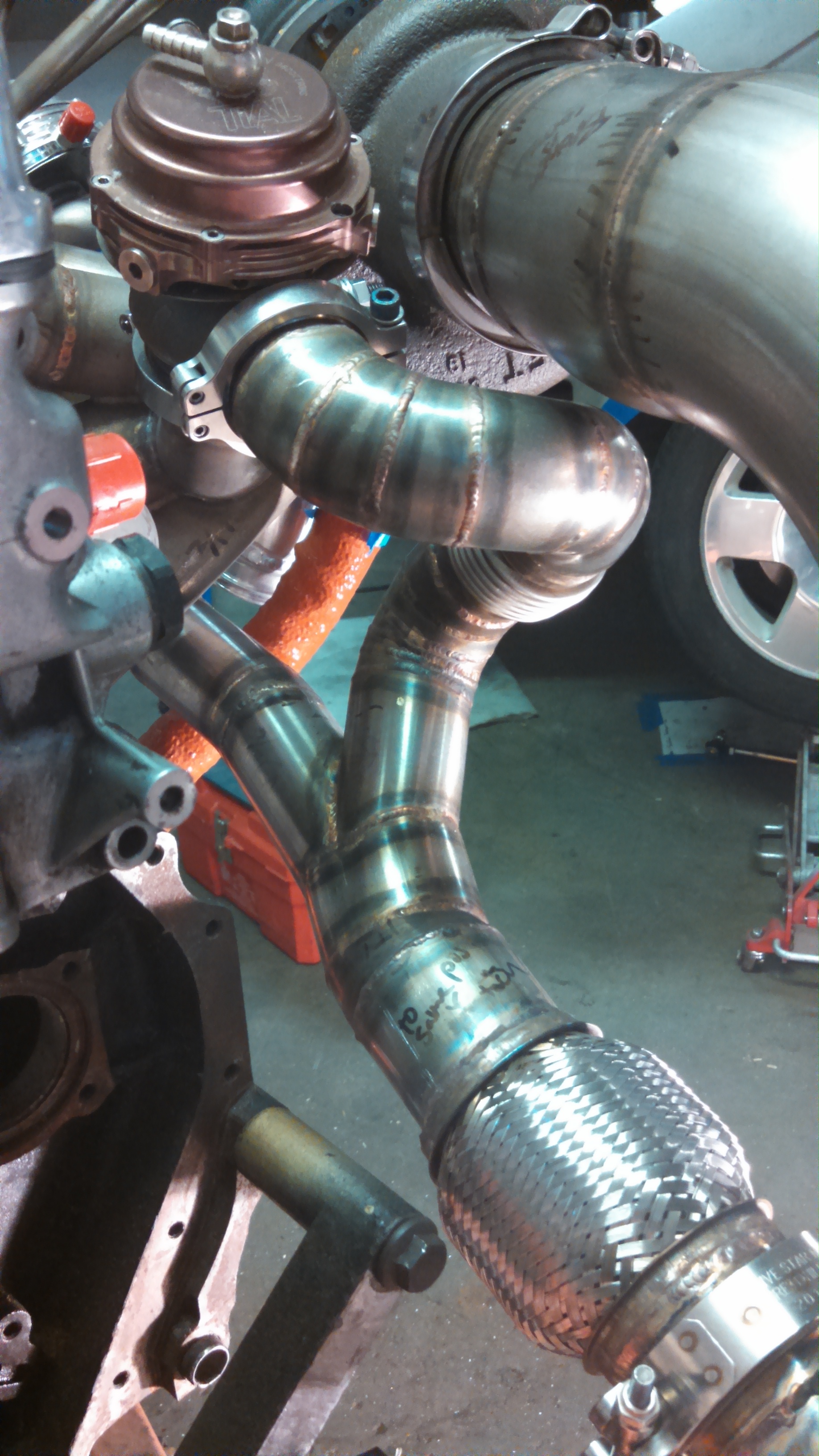

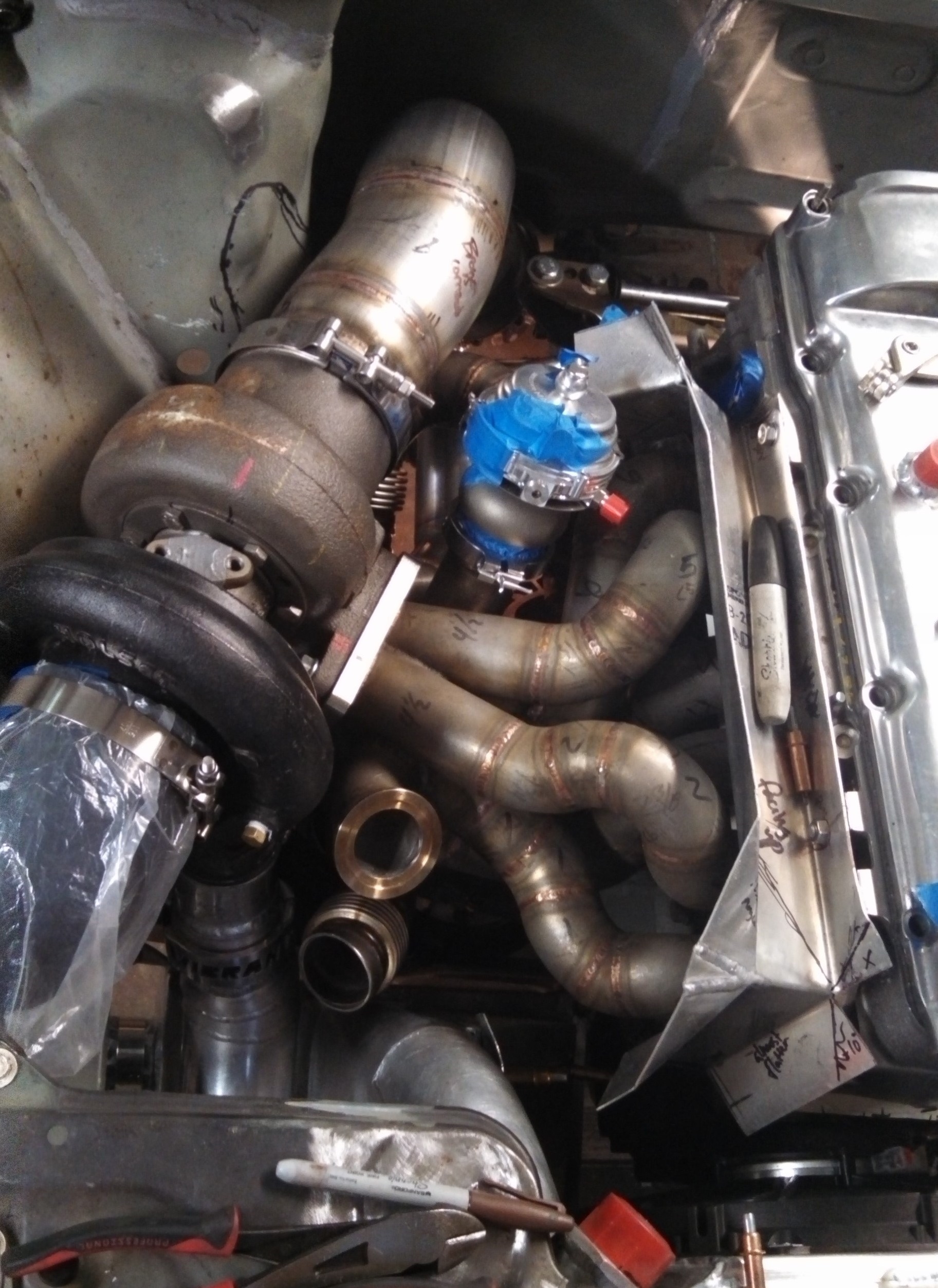

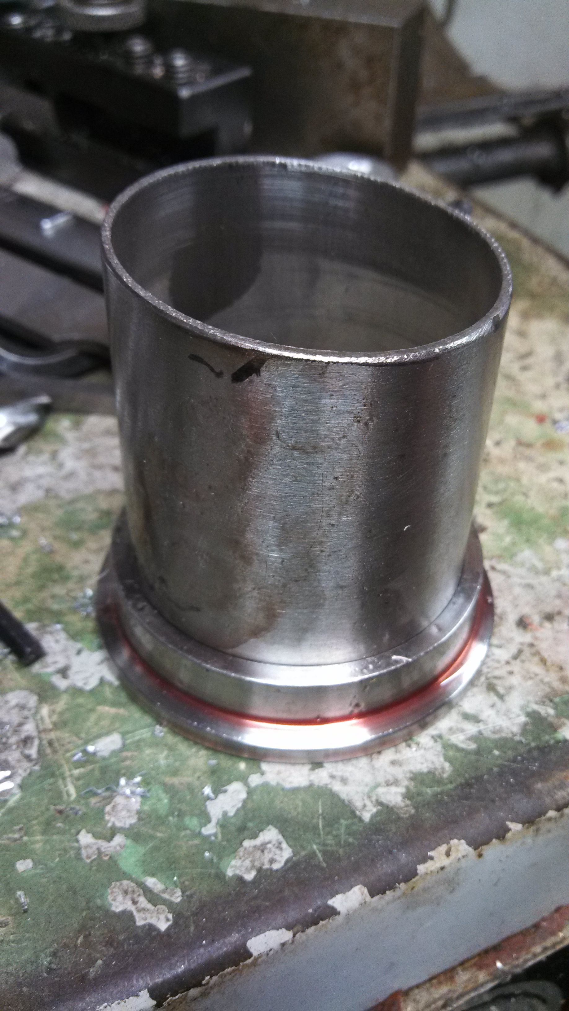

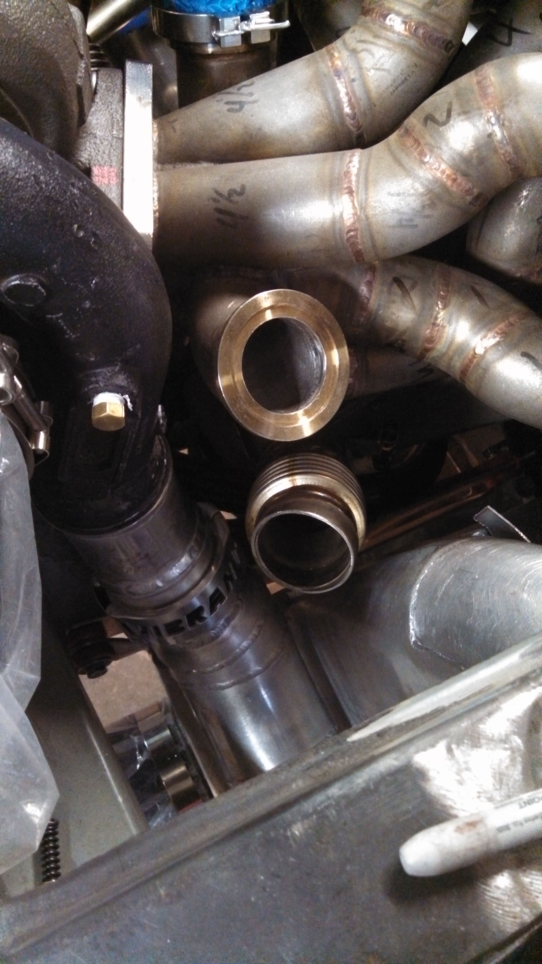

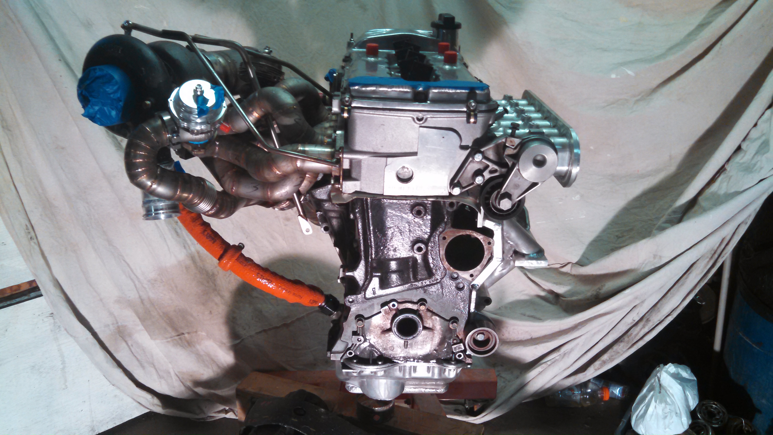

In order to make the Wastegate outlet “Y” removable without taking everything apart, I will be adding an additional Tial v-band connection for the front gate, just before the “Y” junction.
I purchased two additional MVR 44mm Wastegate inlet flanges that would normally belong on an exhaust manifold. I put these on the lathe at Ryan’s and cut them down to fit and recess perfectly with my 2.0”, 304SS 16ga. Tubing that is used on the Wastegate outlets.
tial flange lathed for tubing.jpg (1.84 MiB) Viewed 61414 times
And another shot of the rear WG outlet.
rear wg dump.jpg (1.37 MiB) Viewed 61414 times

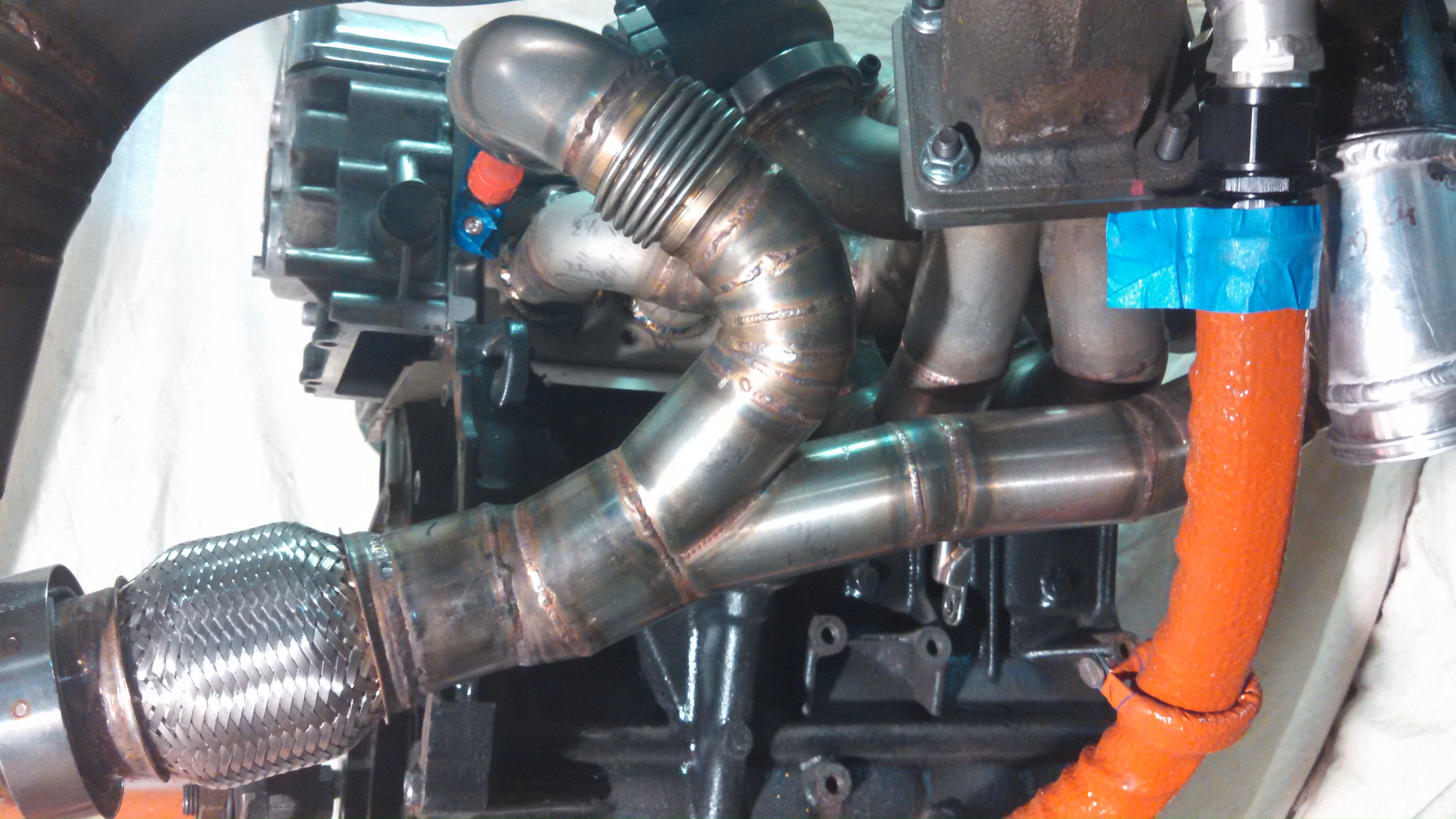

And a few pics of the Wastegate outlets merging
finished WG merger.jpg (1.48 MiB) Viewed 61414 times
both WG tubes finished.jpg (1.6 MiB) Viewed 61414 times

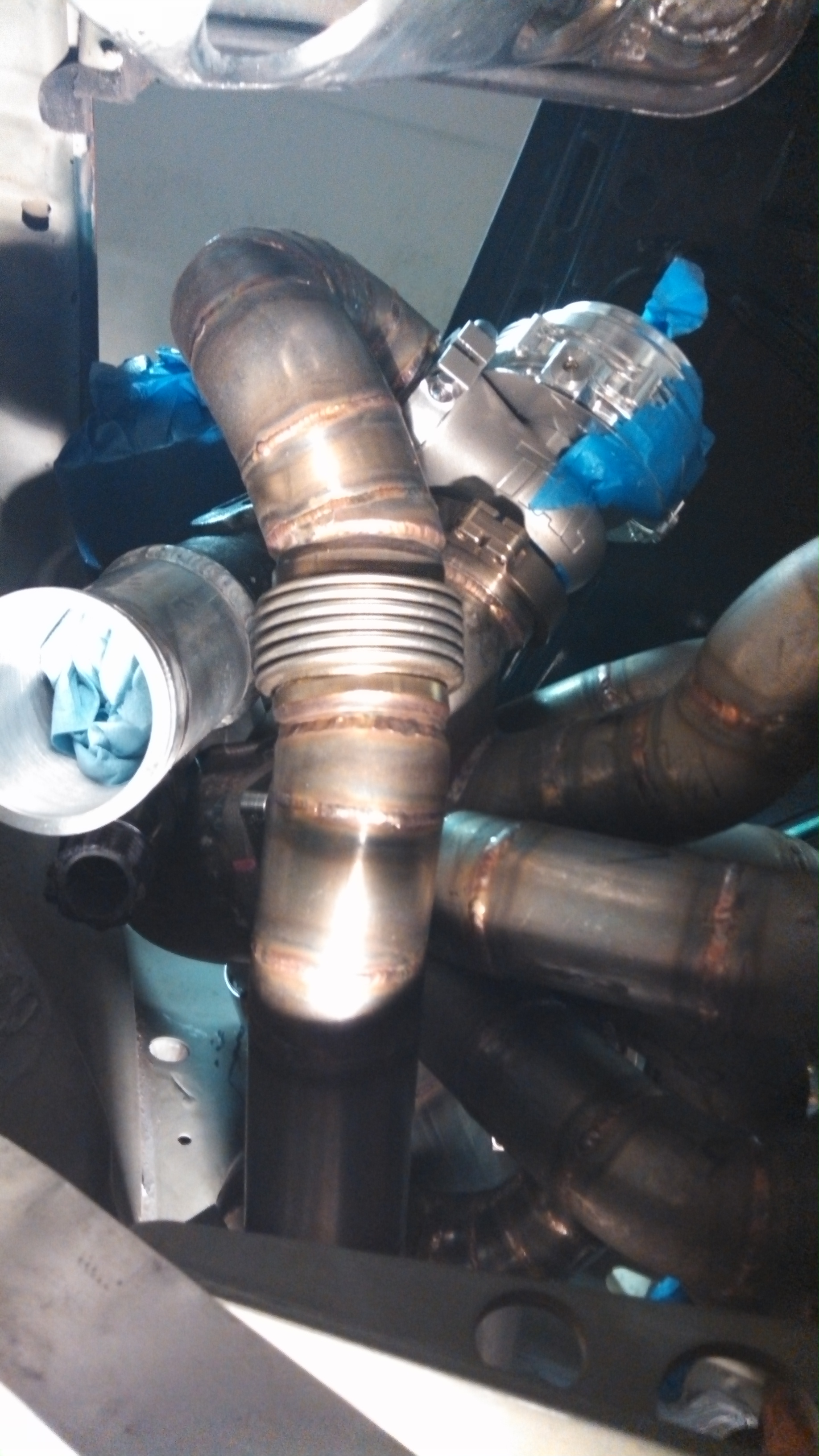

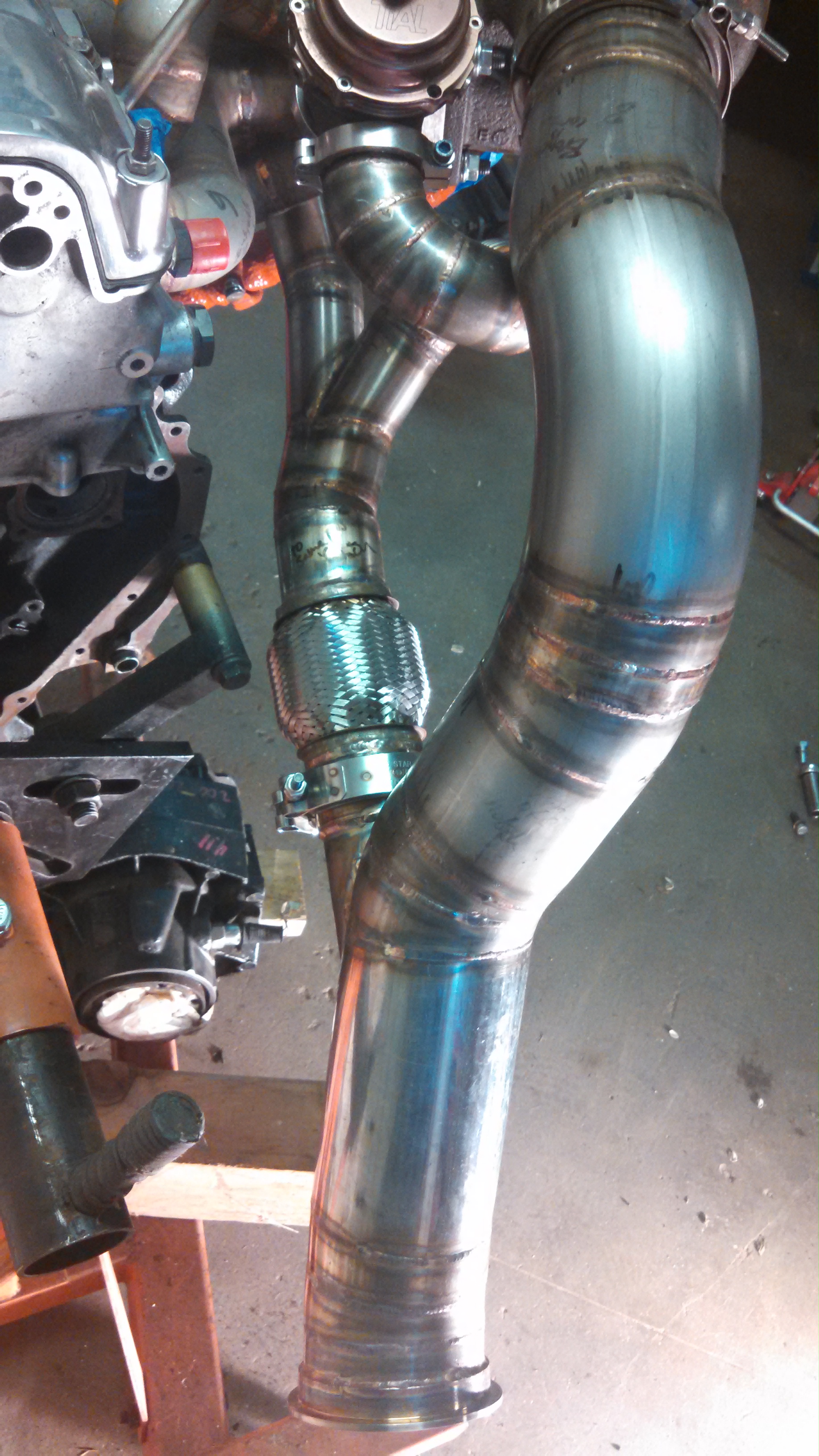

And the Wastegate merge back into the downpipe, its dual 2.0” to 2.5” v-band and flex-joint and then back into the downpipe.
wg dump into downpipe.jpg (1.48 MiB) Viewed 61414 times
NOTE: the sizeable hole between the downpipe and the Wastegate outlet Y , flex, v-band etc. the steering rod has to fit through there!!! With the HTMS steering arms on my strut tubes and upper ground control plates, the steering rod has been run through full droop and compression at full steering range of motion, and it clears!!!

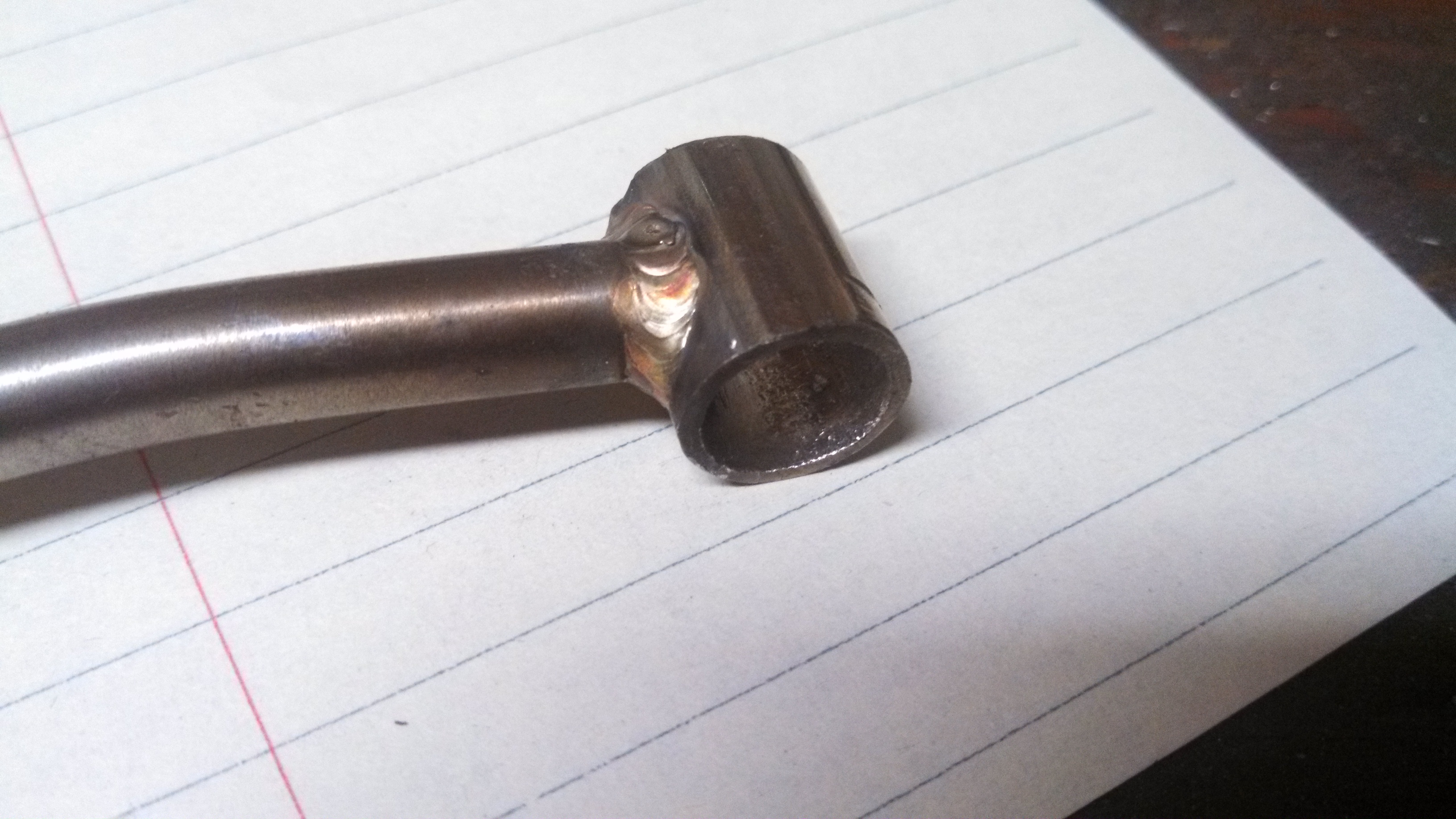

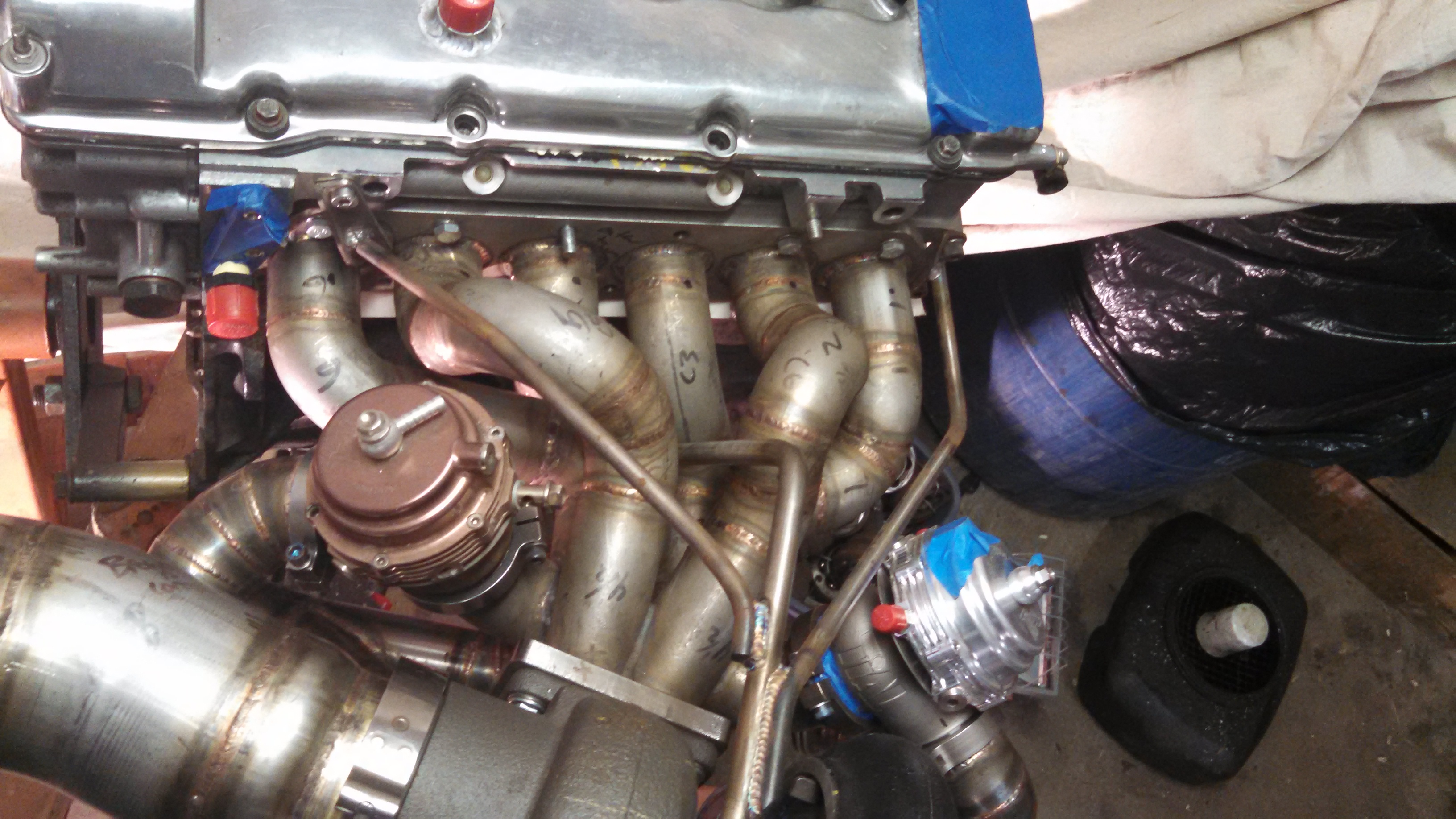

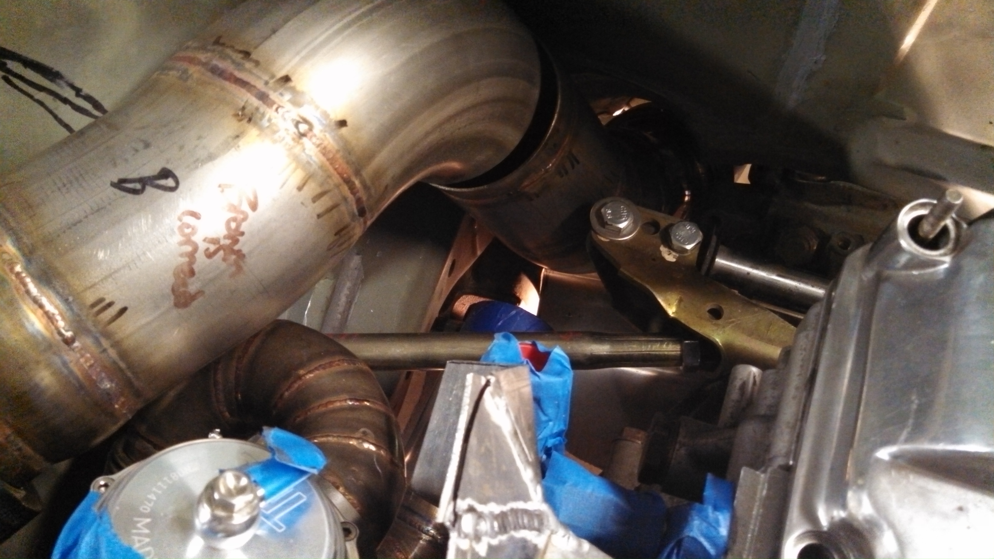

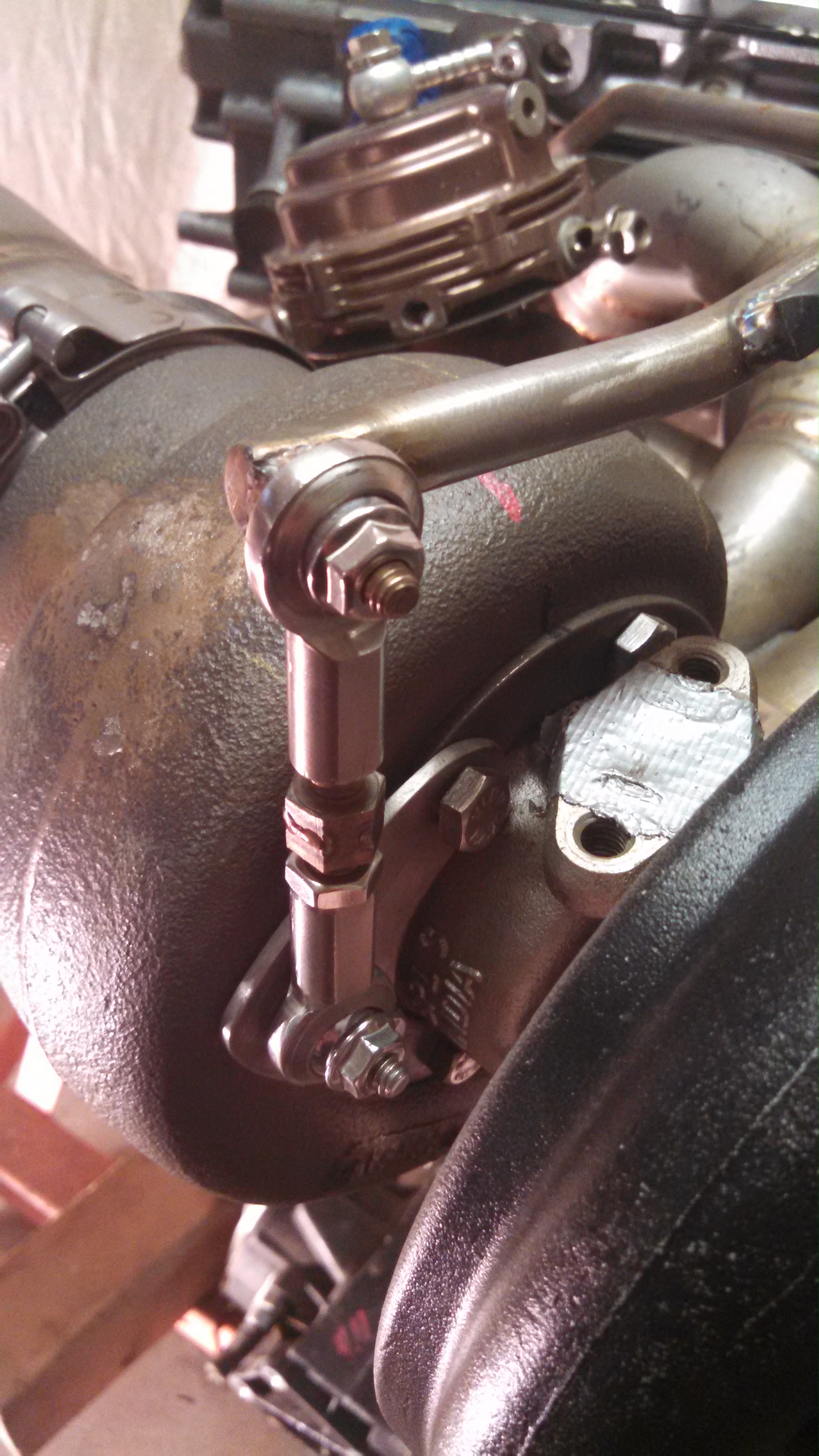

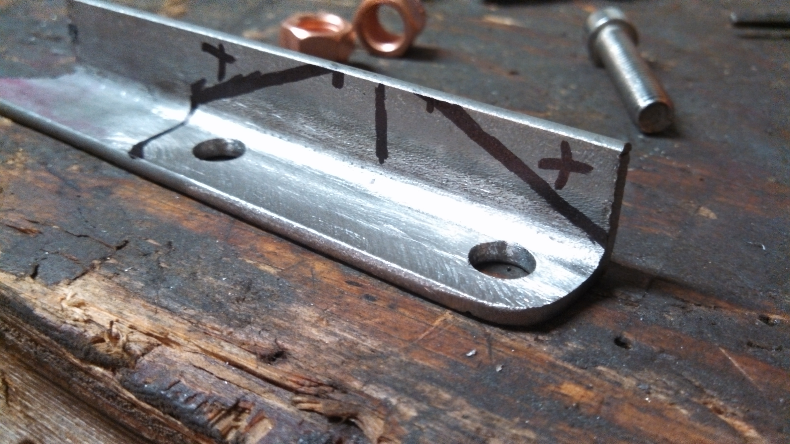

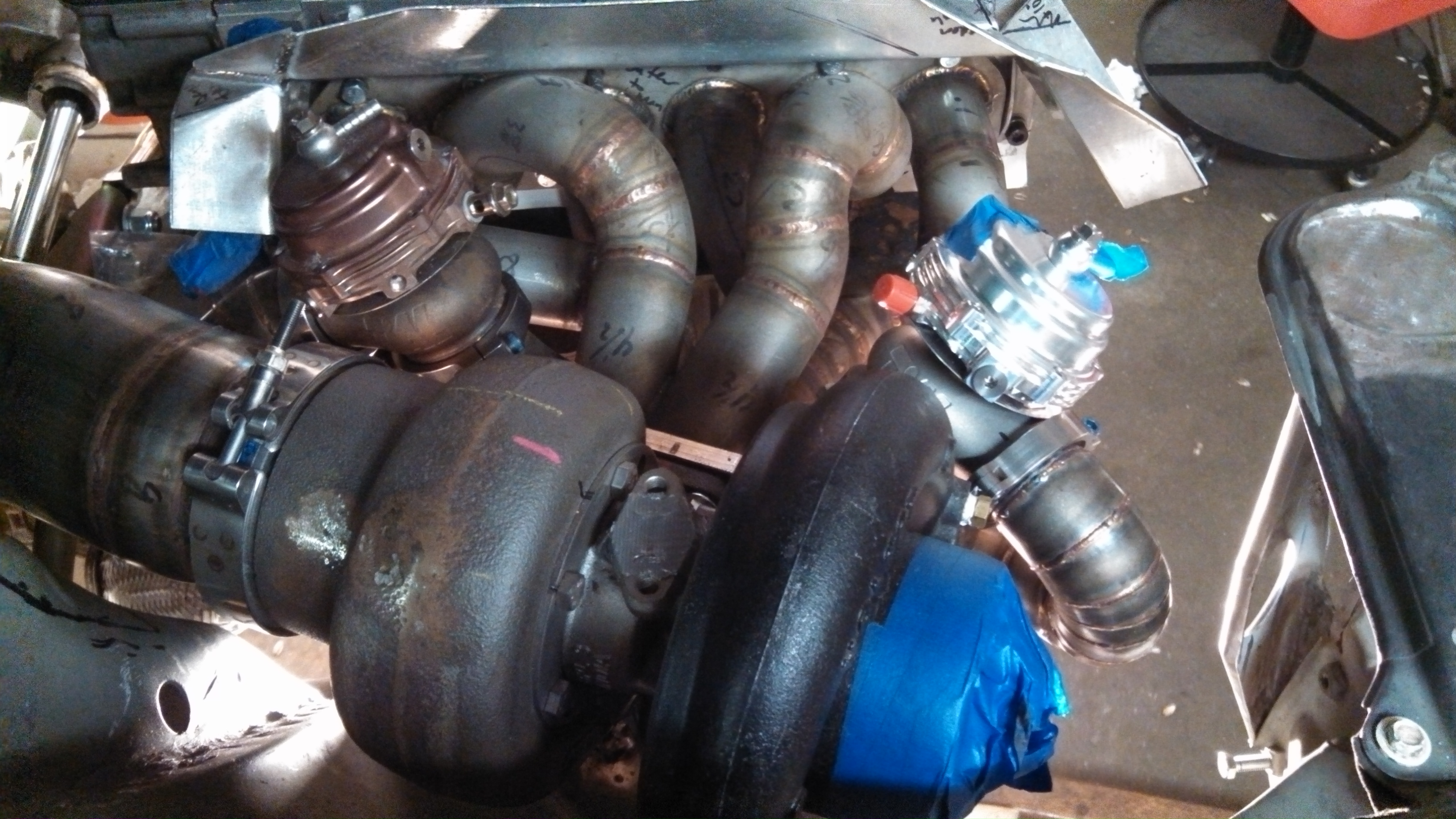

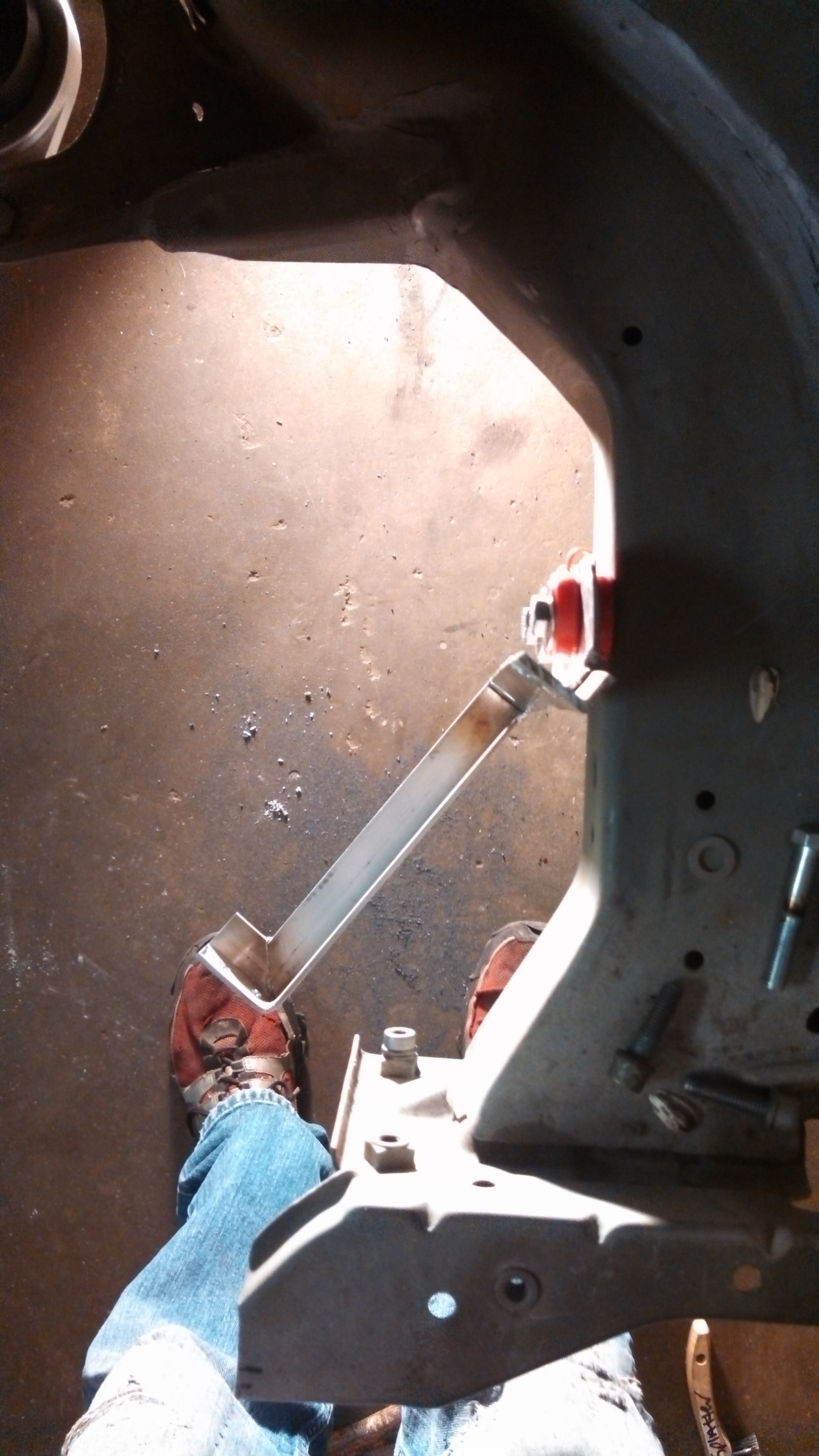

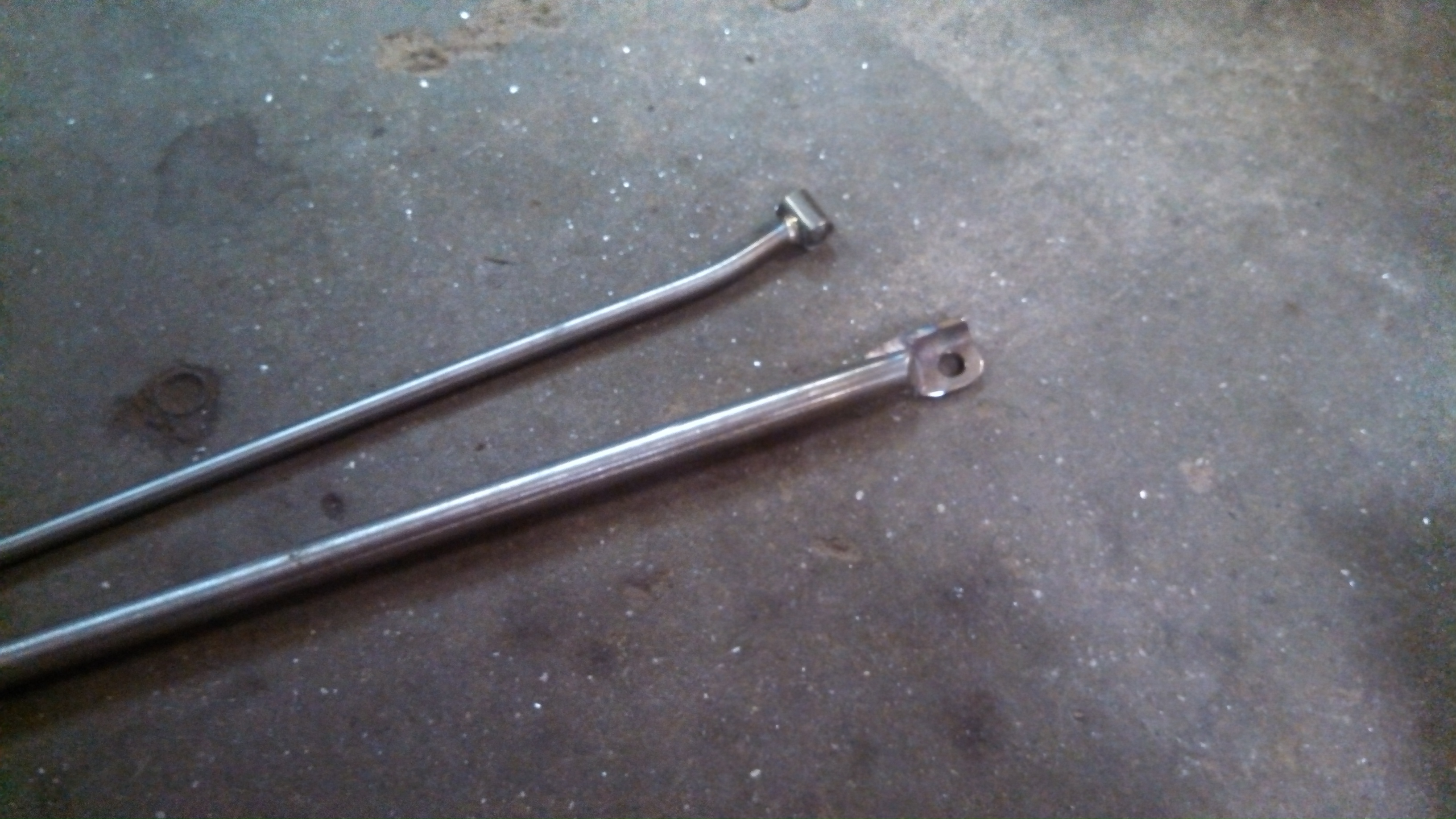

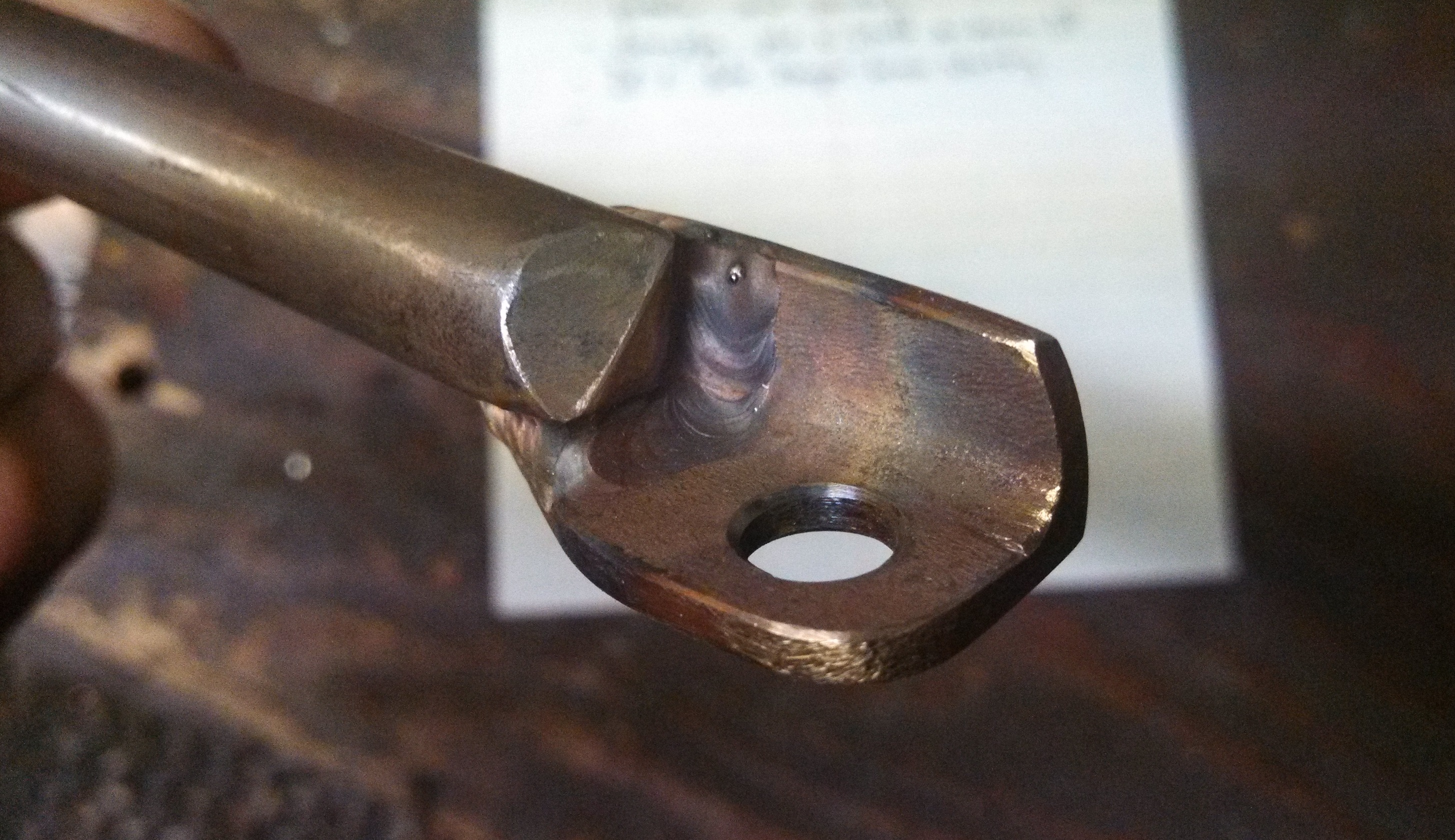

I got started building a turbo hanger brace. The main vertical is ½” stainless rod and the side supports are 3/8”. It attaches up front to two spare m8 bosses in the head, just forward of the exhaust manifold flange.
The rear mount is on an upper boss on the cylinder head and a studded boss located very high up on the exhaust manifold.
The lower center mount is a stainless, extra large diameter shoulder bolt, so the machined should part of the bolt goes though the mount arm and in shear. It is very strong
turbo brace bracket.jpg (1.56 MiB) Viewed 61495 times
Im just waiting on a 1” punch and flare, sheetmetal tool and I’ll be adding one small, punched sheet brace to the turbo hanger brace to finish it off.
I’m awaiting some machined SS adjusters with LH and RH threads, those are just welded bolts for mockup
turbo hanger brace heim.jpg (1.51 MiB) Viewed 61495 times
turbo hanger brace.jpg (1.49 MiB) Viewed 61495 times

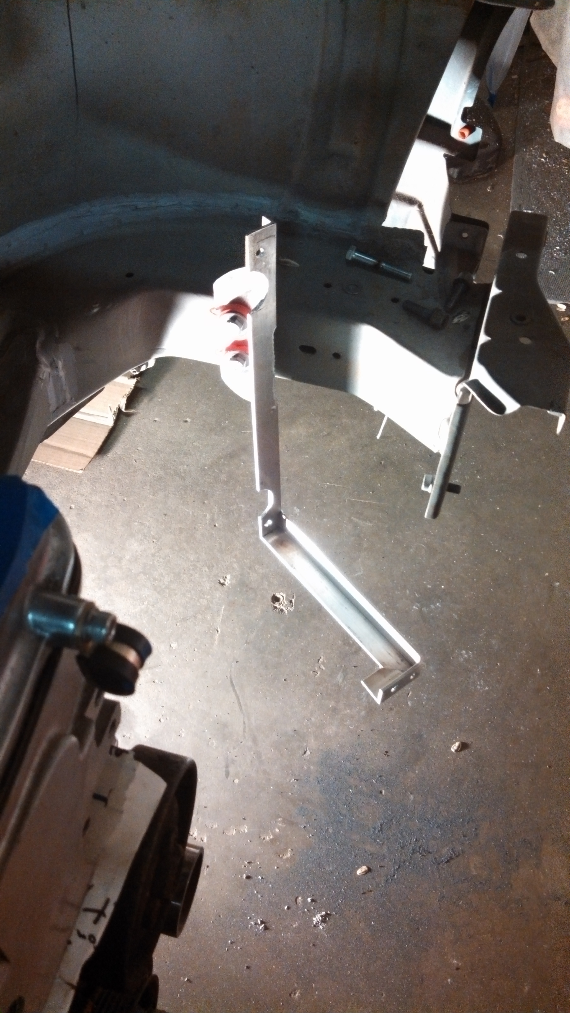

And a few pics of the oil cooler mount that Shawn, (vt10vt) helped me make up when he was down here a few weeks ago.
I just need to add another leg to a silicone isolater mount tab under the frame rail, to triangulate it, and it’s done, and time for plumbing.

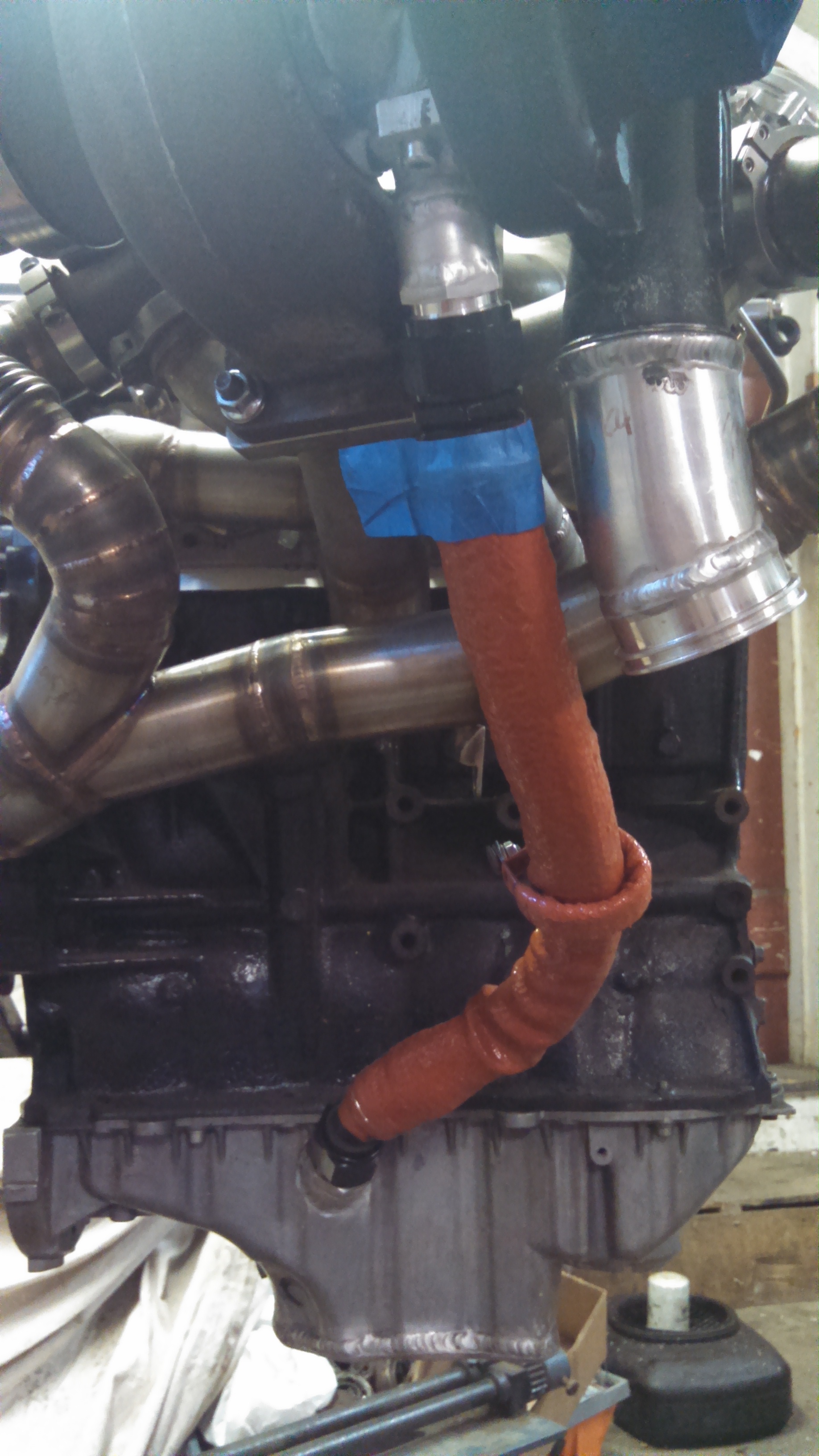

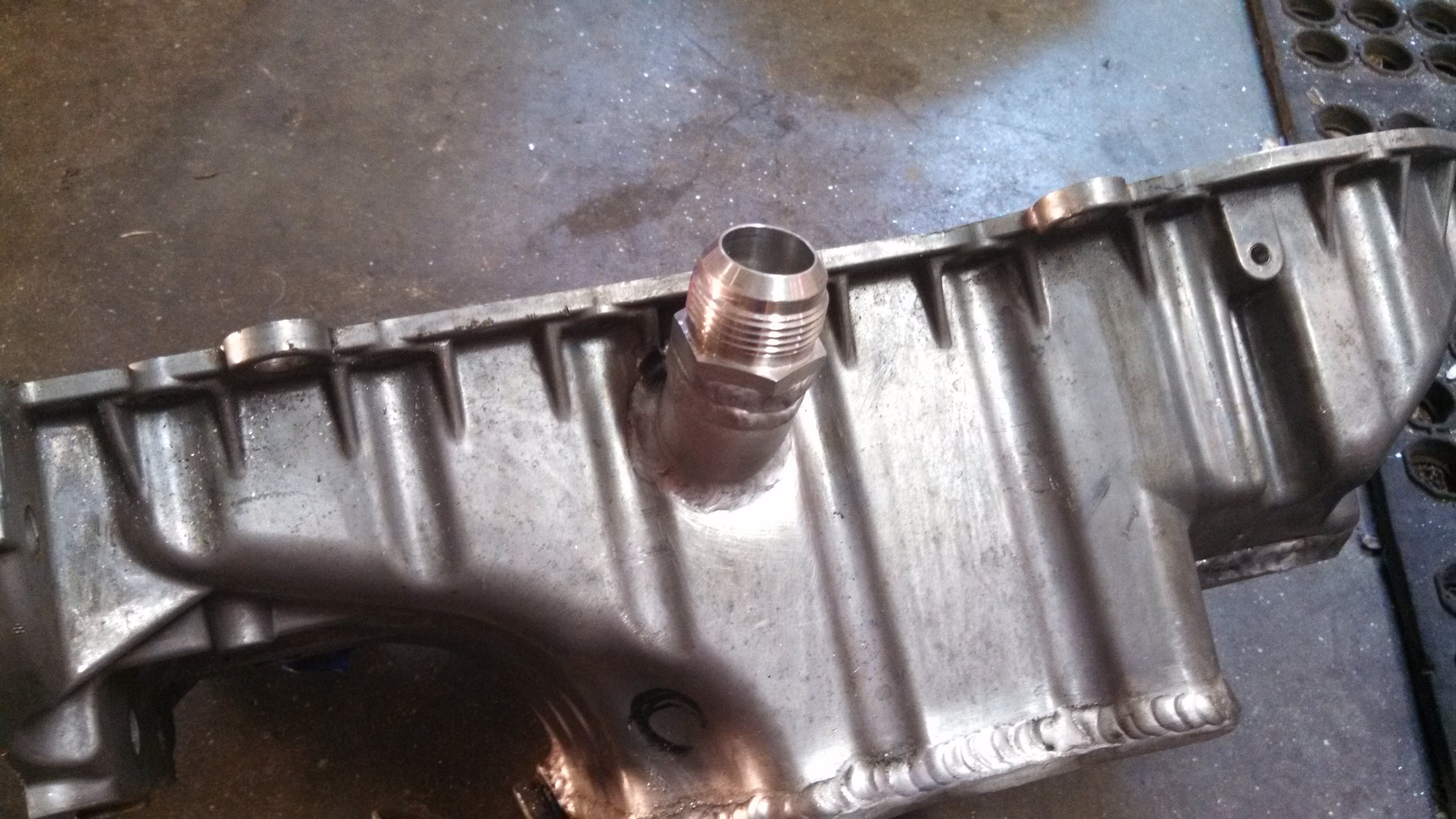

I got a 16AN bung and elbow, welded up to the oil pan for the turbo oil drain return. The hose is made up with Earl’s pro-lite and wrapped in FlameGuard insulation, as it runs close to the Wastegate outlet tube.
turbo drain on pan.jpg (1.92 MiB) Viewed 61487 times
turbo oil drain line.jpg (1.16 MiB) Viewed 61487 times

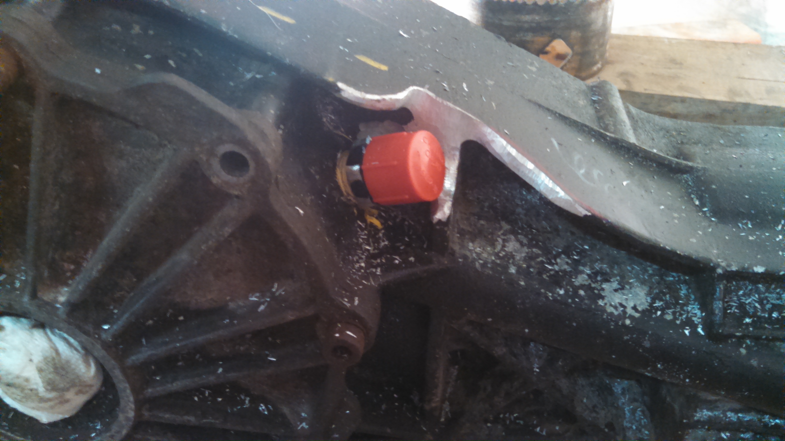

I also got a spare rear diff modded up for the pump/cooler return line. It sprays right on the rear differential ring gear.
rear diff pump return.jpg (1.17 MiB) Viewed 61487 times
I just need to make the pump and cooler brackets, more on that later.

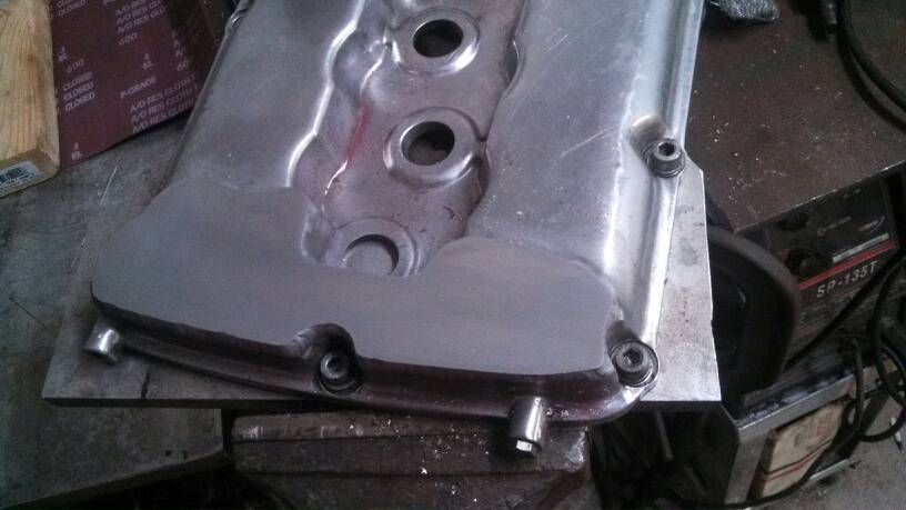

I also had Ryan replace the plate on my valve cover with something a bit thicker so some engravings, more on that later
new VC plate for engraving.jpg (44.78 KiB) Viewed 61487 times

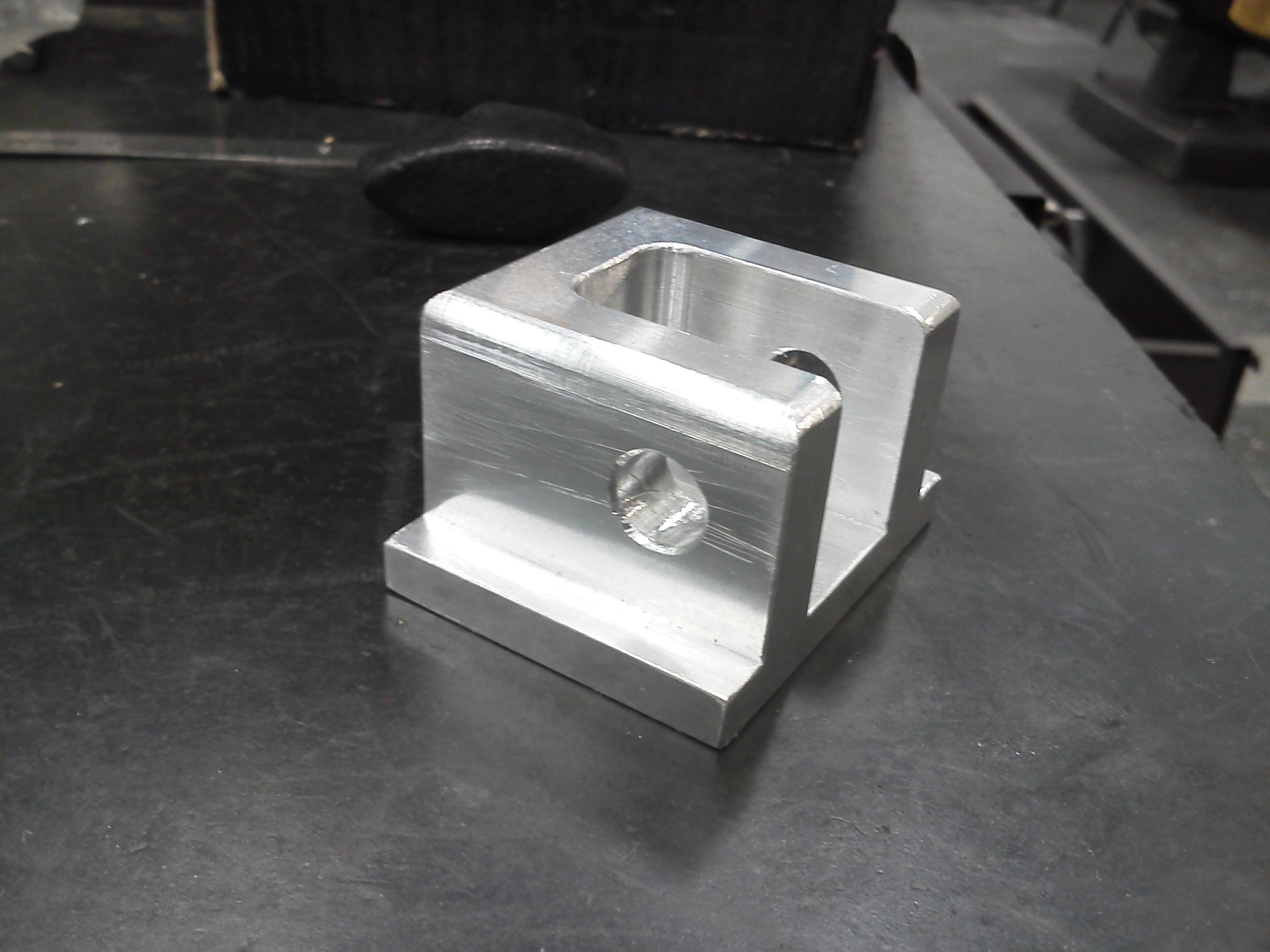

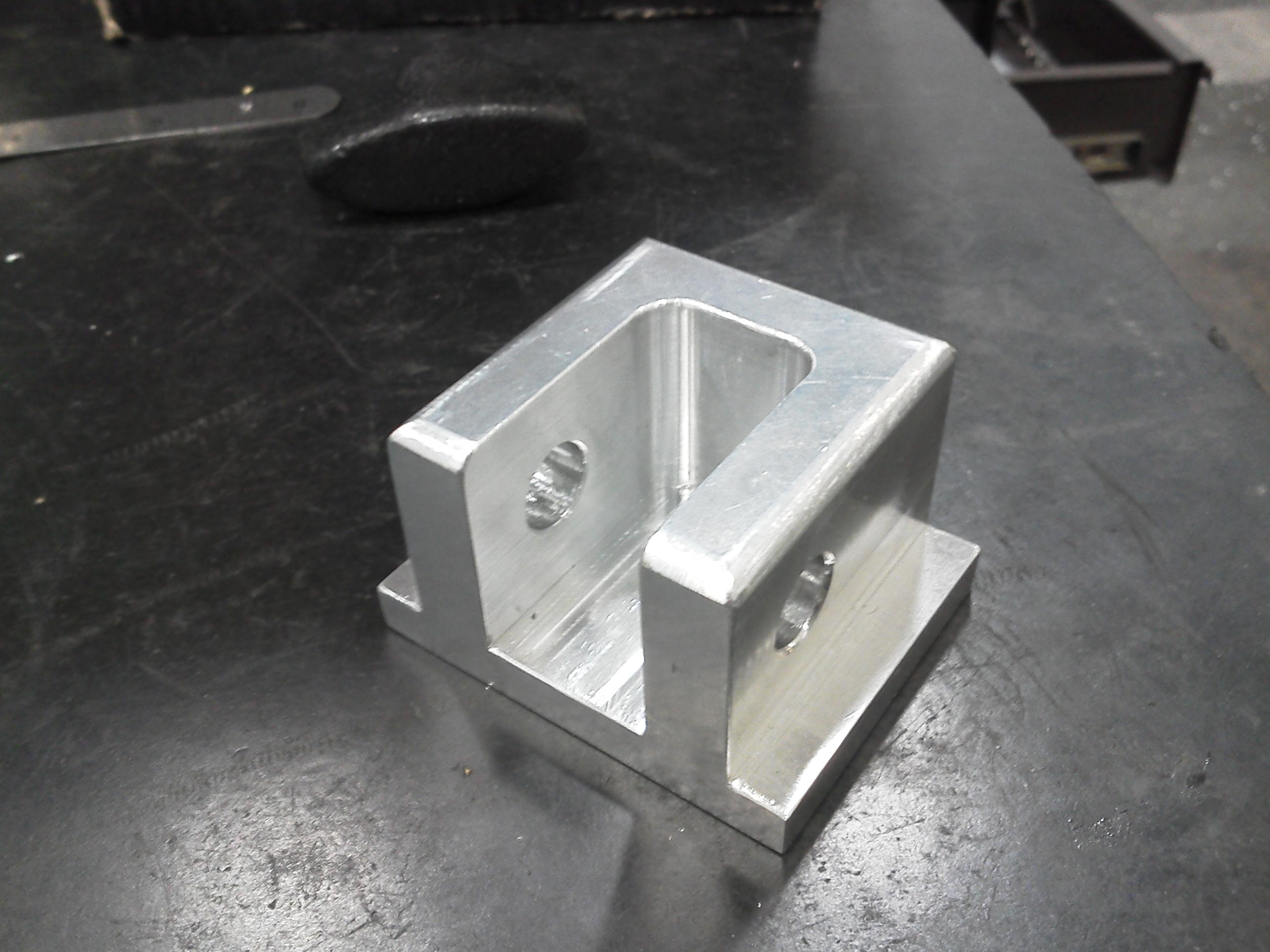

I sent some drawings to a machinist buddy of mine and got the these beautiful pieces back!!!
The first is a receiver for a 3/8” rod end. I am also having a threaded RH/LH adjuster made to tension/adjust the serpentine belt. The rod end fits in snugly with washers and Seals-It rod end seals.
upper alt tensioner mount.jpg (353.17 KiB) Viewed 61487 times
upper alt tensioner mount2.jpg (284.29 KiB) Viewed 61487 times

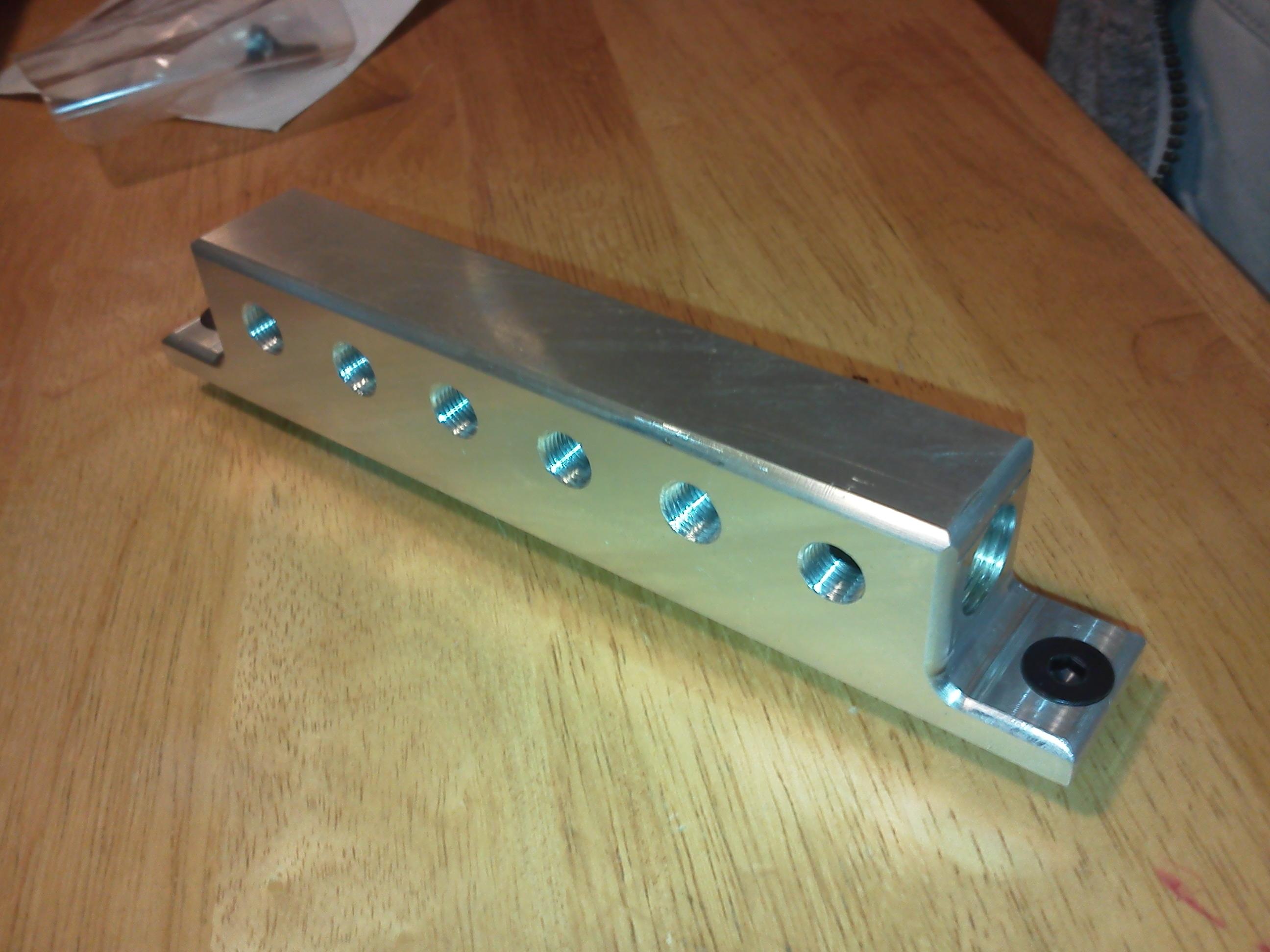

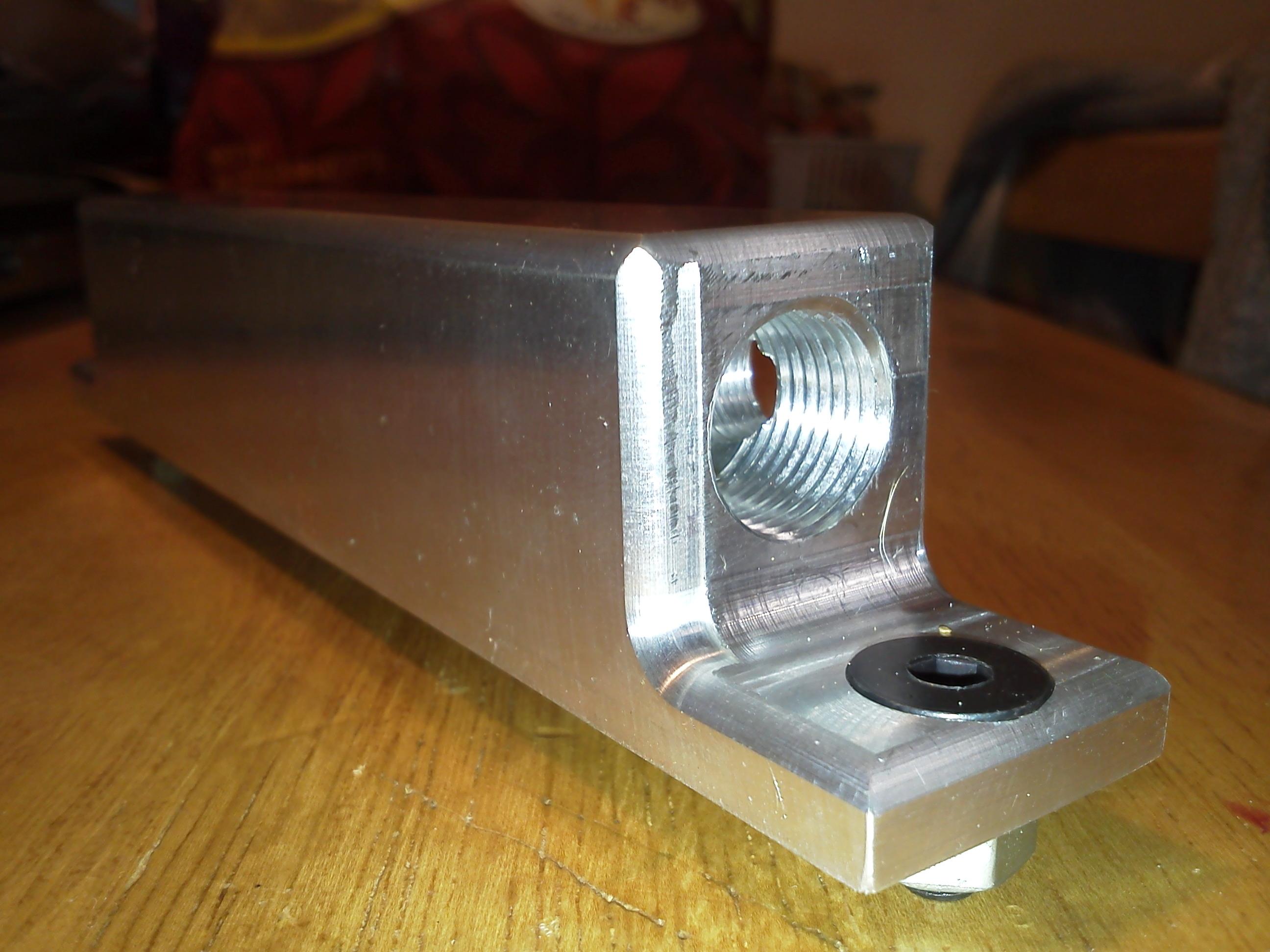

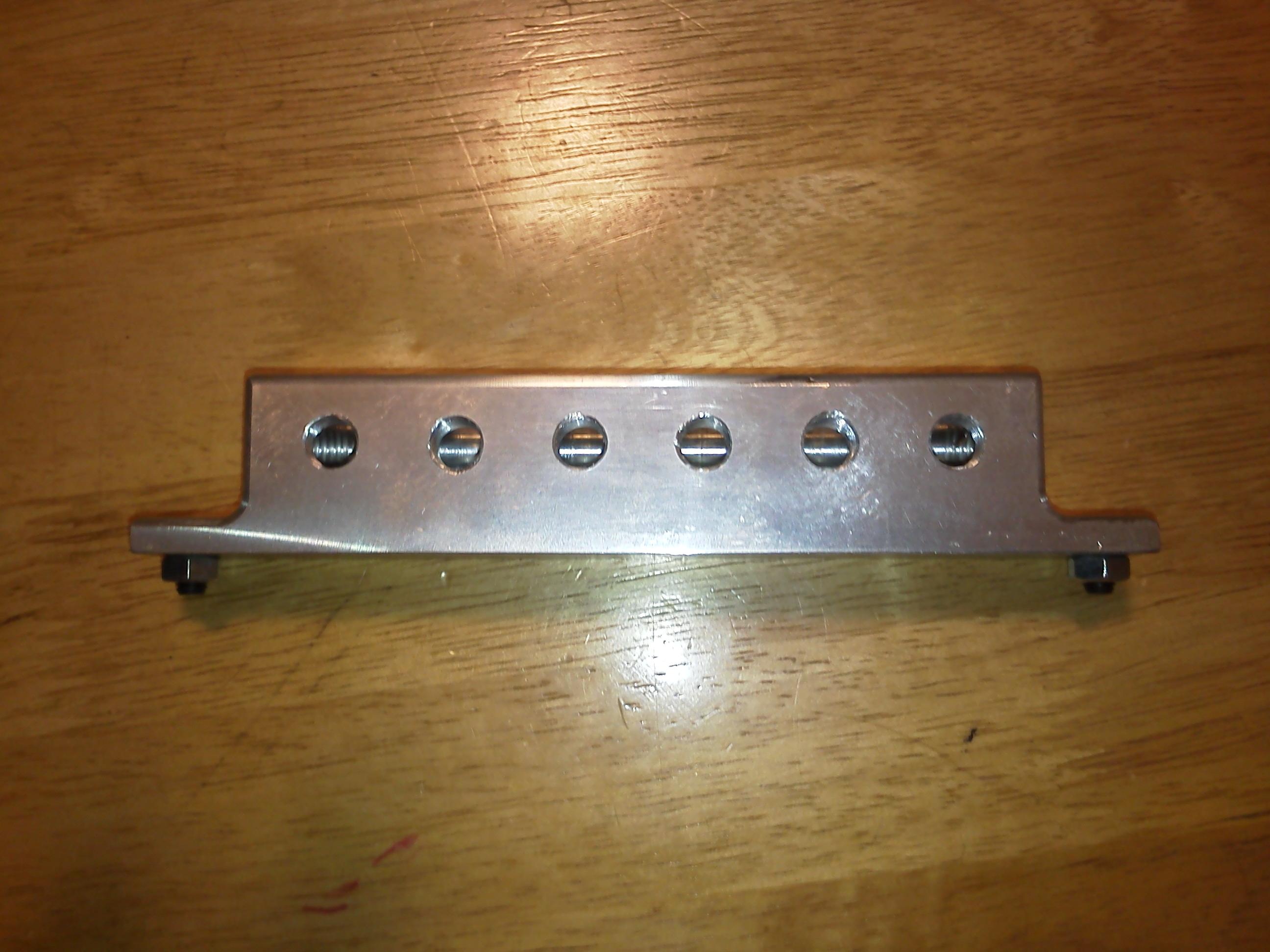

The second piece is the water/methanol manifold. It has an 1/8” NPT outlet for a 4AN adapter for each cylinder and an add’l outlet for a nozzle at intercooler outlet. It will be mounted on threaded bosses on the intake manifold for nice short lines to each cylinder’s nozzle.
It will also get anodized black when all the parts go out.
water meth manifold.jpg (327.26 KiB) Viewed 61487 times
water meth manifold2.jpg (314.58 KiB) Viewed 61487 times
water meth manifold3.jpg (327.41 KiB) Viewed 61487 times

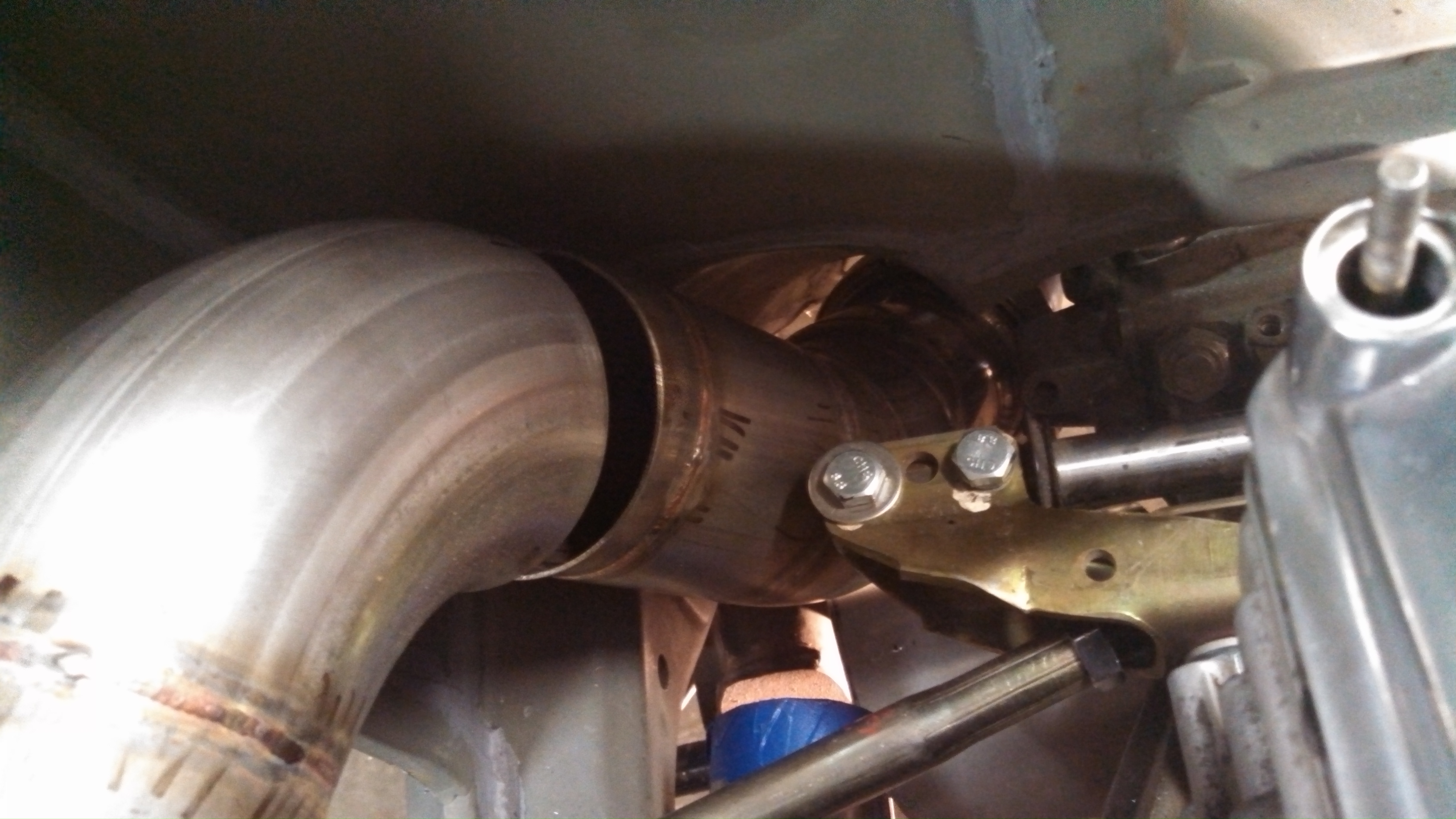

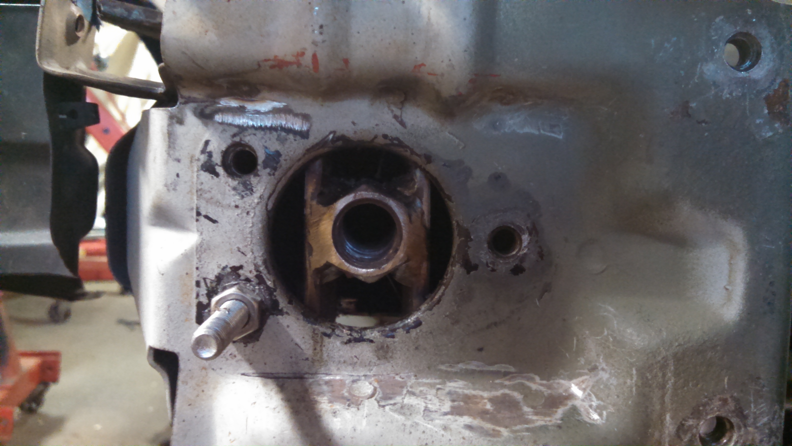

So the engine and trans has been pulled so I can get some work done in the engine bay. Here it is on the engine stand.
steering arm hole.jpg (1.32 MiB) Viewed 61487 times
current engine stuff shot SIDE.jpg (1.35 MiB) Viewed 61487 times
current engine stuff shot.jpg (1.53 MiB) Viewed 61487 times

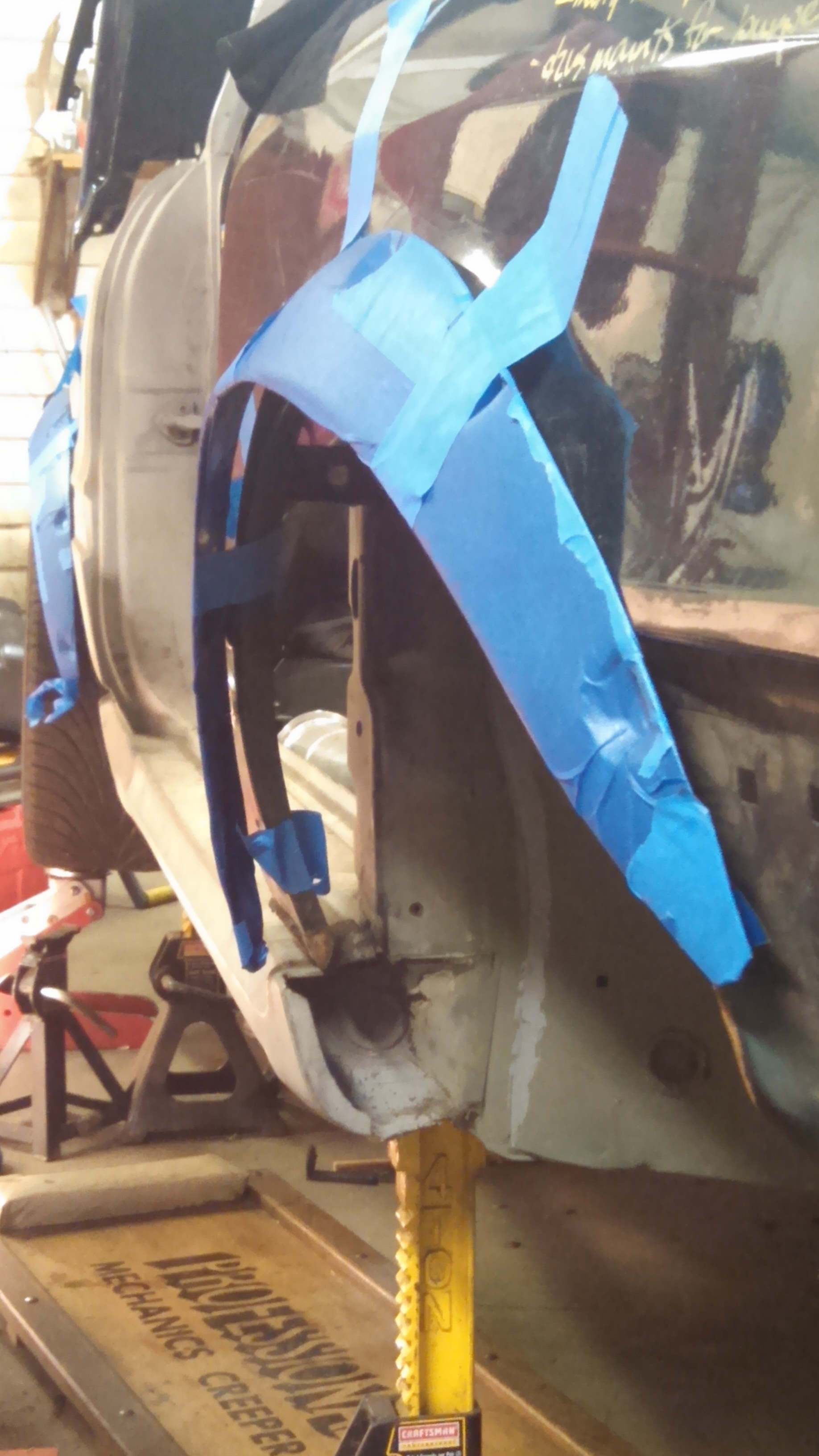

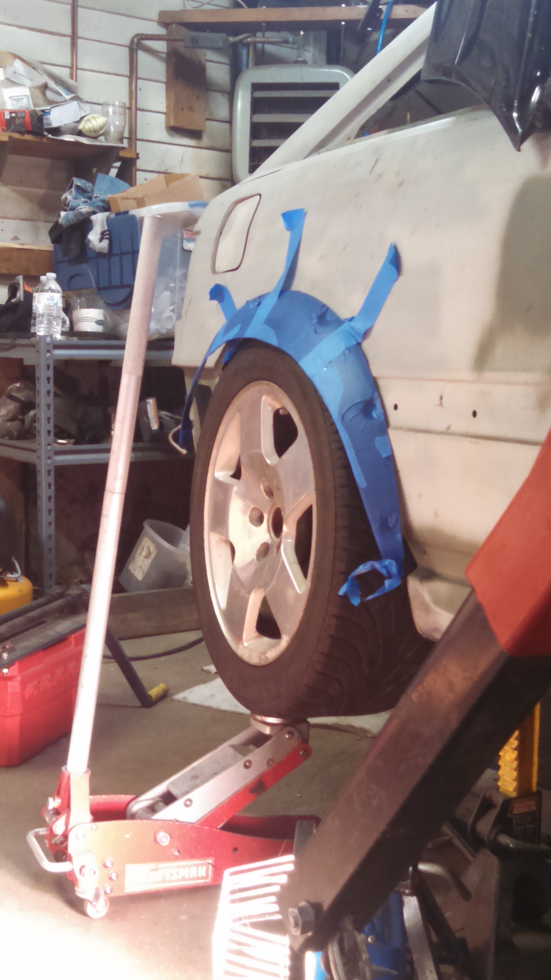

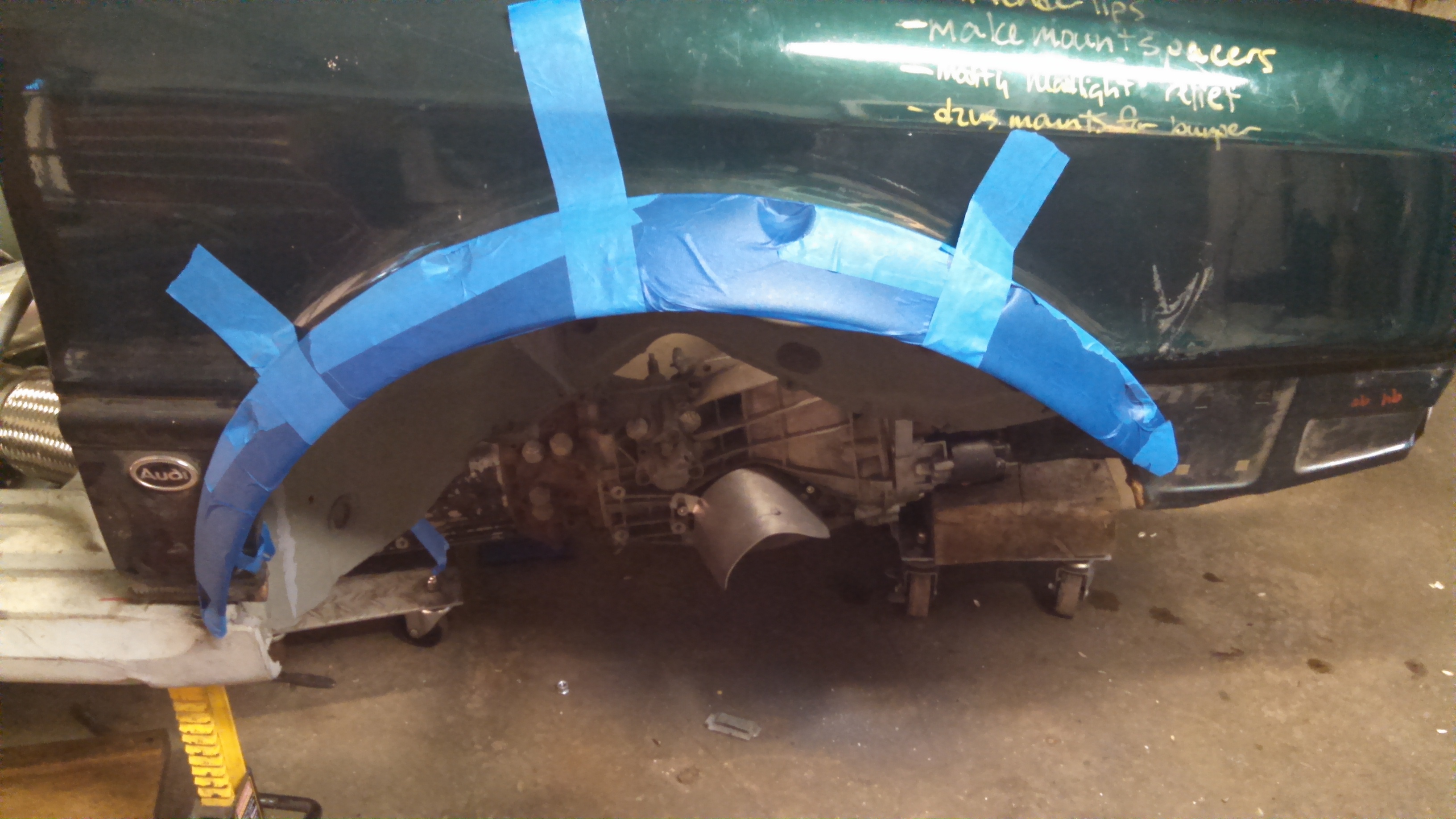

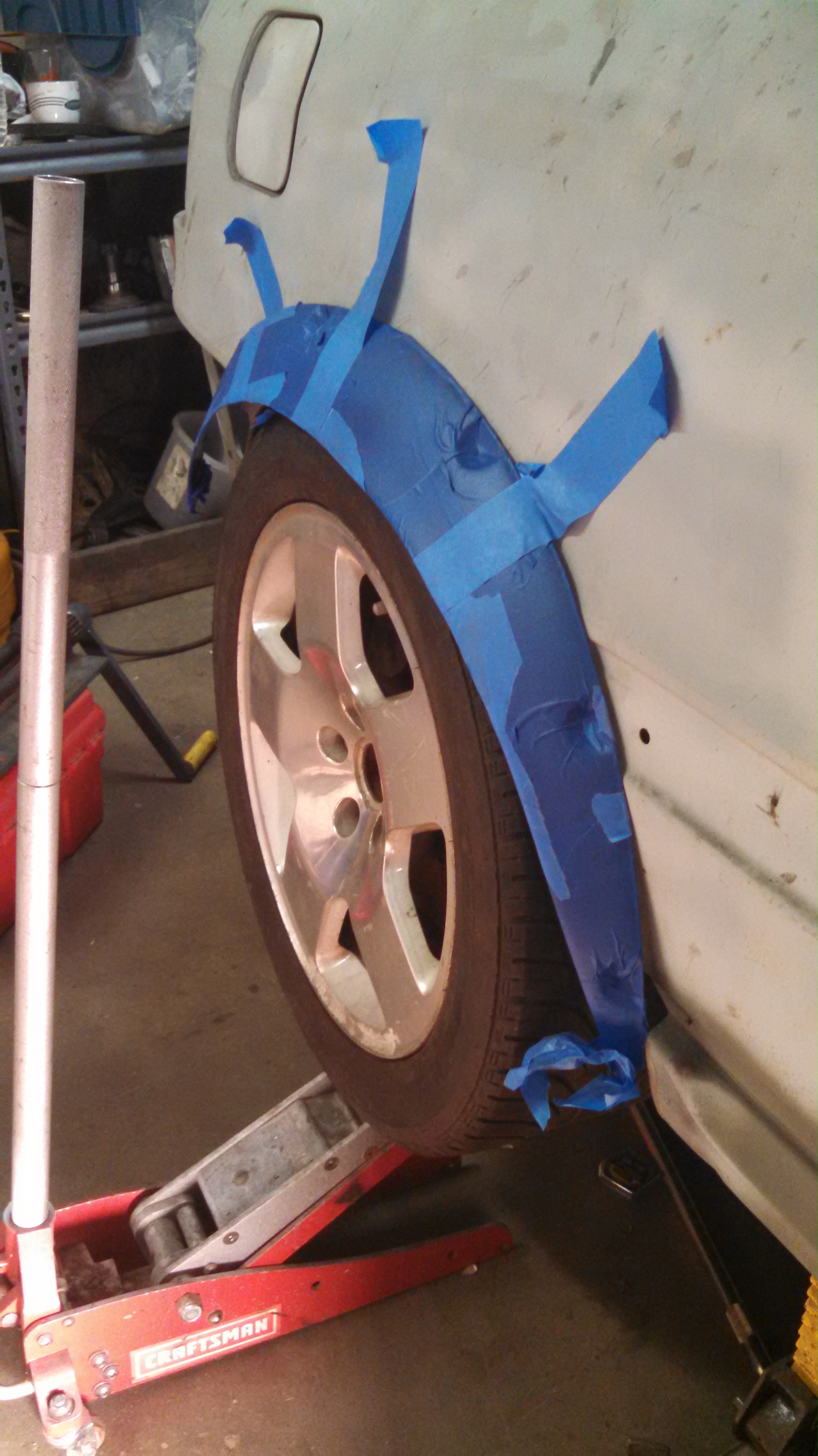

I picked up these ‘70-78 Z car flares online somewhere and will be doing a bit of work to get them to flow well with the CQ, like it or not, I’m doing it, I need/want all the tire I can get under there. 265/40/17 yup no prob, will go 275/35 at some point once its dialed in.
front flare.jpg (1.12 MiB) Viewed 61487 times
front flare2.jpg (973.39 KiB) Viewed 61487 times
And just screwing around with a 245 on a 17x8” fat five
rear flare w fat five.jpg (1.33 MiB) Viewed 61487 times
rear flare with fat five2.jpg (1006.22 KiB) Viewed 61487 times

how much do those flares stick out? the ones im using are universal ebay fiberglass ones, $180 shipped. 3" height on em.
