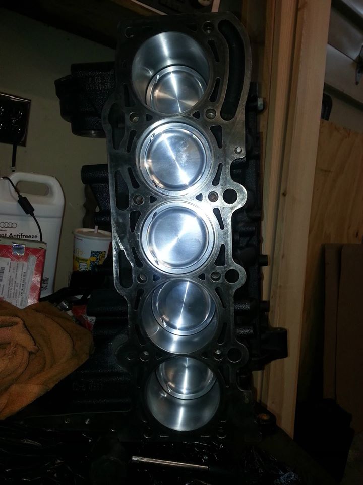

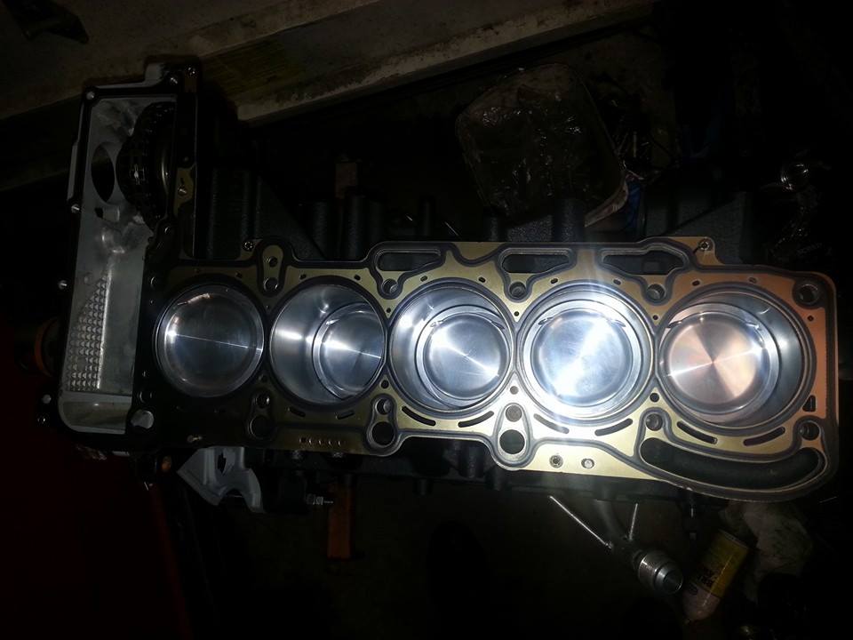

Those are from Nick's 200, and he is running basically the most aggressive hydro cam Cat sells. No dish on exhaust, and equal looking dish on the intakes. Do you have the spec sheet? we can compare with the JE's Nick has
Posts: 659
Re: Jims 07K 84 Super HX40 4kq break in.
Post by glibobbo21 »
Im not sure where the spec sheet is off the top of my head but i did send you a pic on fb messenger a couple months ago of it. Also, i have pics on fb of the physical pistons?
07k pistons 2.jpg (78.88 KiB) Viewed 28388 times

What CR Jim?

8.5:1

Wrist pin diameter?

22mm tool steel. Yes 8.5:1
