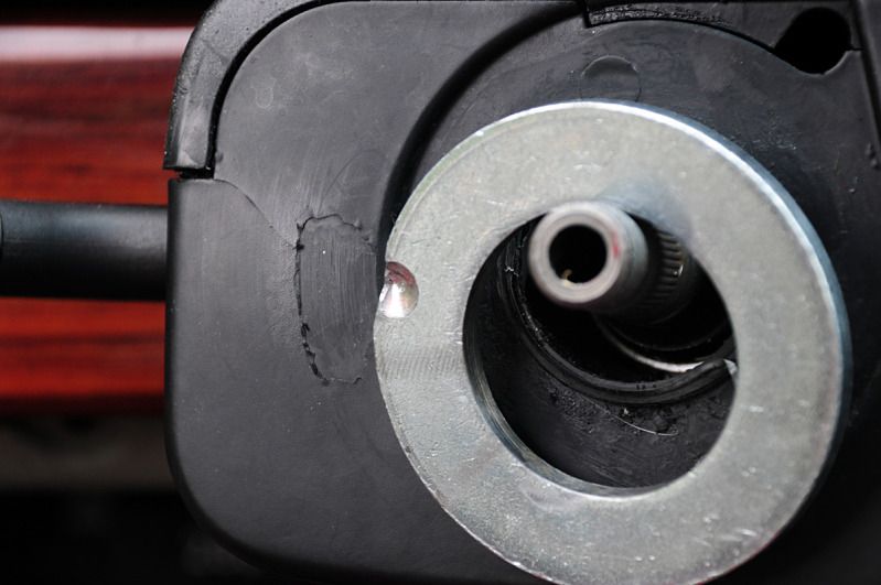

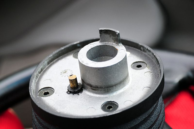

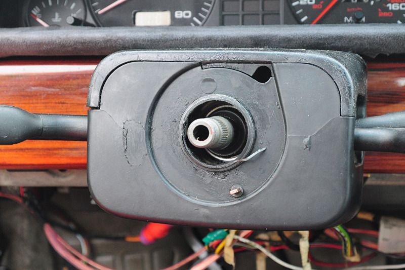

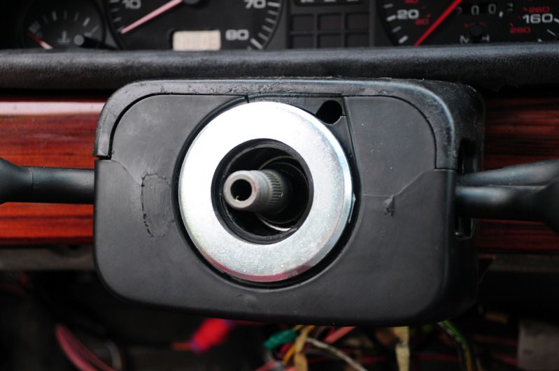

With my new (Euro urS4) steering wheel, I had no horn. It eventually started going off randomly about every quarter turn on the wheel to the point where it really wasn't driveable anymore (embarrassing), so I decided to do something about it. I ordered this big washer from McMaster-Carr a few days ago and used it to make a sort of slip ring.
The brass thing in this picture
and this one on the wheel
have to make contact through a slip ring in order for the horn to work. This is the ring I ordered. It came with a 43 mm ID which I had to bore out to 45 mm.
After it was bored out correctly, I also had to make a relief in it so it would sit flush with the column cover.
The horn works like a charm now! All I have to do is glue the metal ring to the column cover and I'll have a nice, permanent solution to the horn issue with the new wheel.
I also got around to installing my V8Q door sills. Don't mind the messy interior. The car is still in major project mode!
I get my intercooler piping in the mail tomorrow, so I am getting my insurance reinstated and getting the title ready to register the car on Monday
Then all I need is exhaust!

That was EXACTLY my idea to fix my horn. You beat me too it, lol. Horn is very low on my list. Make two by chance????
Strange that yours would randomly pop off the horn though. I've never had that happen.
Re: Loxxrider's 200 20v: plumbing
Yeah, I dunno why it was doing that. I can give you the part number to the washer. Then you just need a drill and a way to hog the I.D. out. I really don't want to sit there with a dremel for another hour making the extra two millimeters in diameter myself lol.

Nick, the washer is here: (43 mm I.D.)
http://www.mcmaster.com/#standard-flat-washers/=hsp4dy" onclick="window.open(this.href);return false;
Honestly, it is probably better to just have it machined if you can do it easily. You need 45 mm ID and close to 80 OD. The thickness really isn't important as long as you can cut that relief out and still have a surface for that pin to contact. I thought mine was going to be too thick, but it worked out fine.

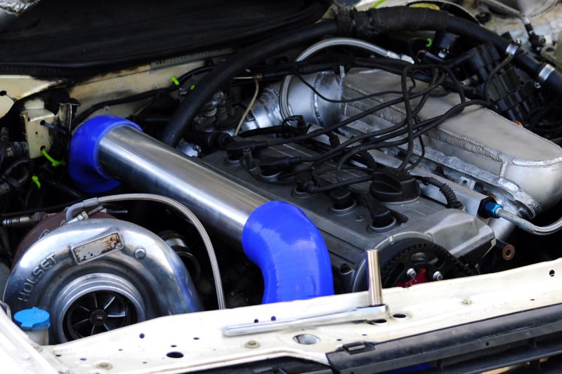

Rough IC piping mock-up. Yes, the hood closes and yes, the new wastegate is going to fit below the pipe.
There are some tight turns in this setup and some very goofy turns near the throttle body... I think in the future I'm going to get a different tb (sorry Hank) and rotate the 4" section coming out of the plenum up such that the upper charge pipe doesn't have to make that stupid drop down to the throttle body. It is all because of my retarded tb choice too lol.
Of course, most of the tight turns seen here will also be able to be eliminated once we break out the welder and start cutting stuff up and all silicone couplers will be replaced by welds or Vibrant Vanjen connectors.
Nice that is a hot air intake no? My only problem with the 3b style mani, you're superheating that pipe above a header
The OEM heat shield does a great job at keeping that pipe very cool. Mine is always cool to the touch unless the car is sitting still.JonathanL wrote:Nice that is a hot air intake no? My only problem with the 3b style mani, you're superheating that pipe above a header
amd is the best wrote:[/quote]
the heat shield is always a good idea but lets not lose sight of what is really happening. it is cool to the touch because you are drawing hundreds of cfm of ambient(ish) air through the tube which cools the tube to the touch and raises the temp of the incoming air. heat loss=heat gain. brainiacs : )
The OEM heat shield does a great job at keeping that pipe very cool. Mine is always cool to the touch unless the car is sitting still.[/quote]JonathanL wrote:Nice that is a hot air intake no? My only problem with the 3b style mani, you're superheating that pipe above a header
It does look wicked
My IAT logs also look good...
I could remove the heat shield and see what the difference is.
Lets also consider that the main mode of heat transfer for that pipe is through radiation with a little bit of free convective heat transfer in there as well. Those foils and such do an incredible job of keeping energy flux to a minimum. The math is pretty complex, but just know that radiation shields are very effective for this kind of thing.
