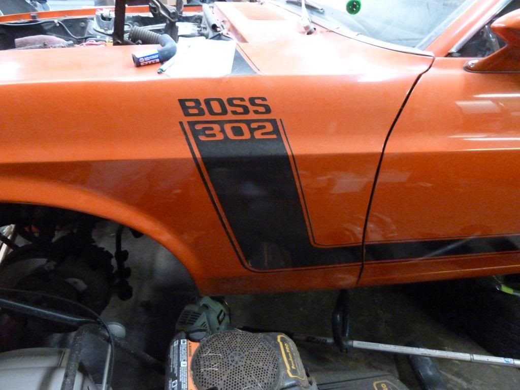

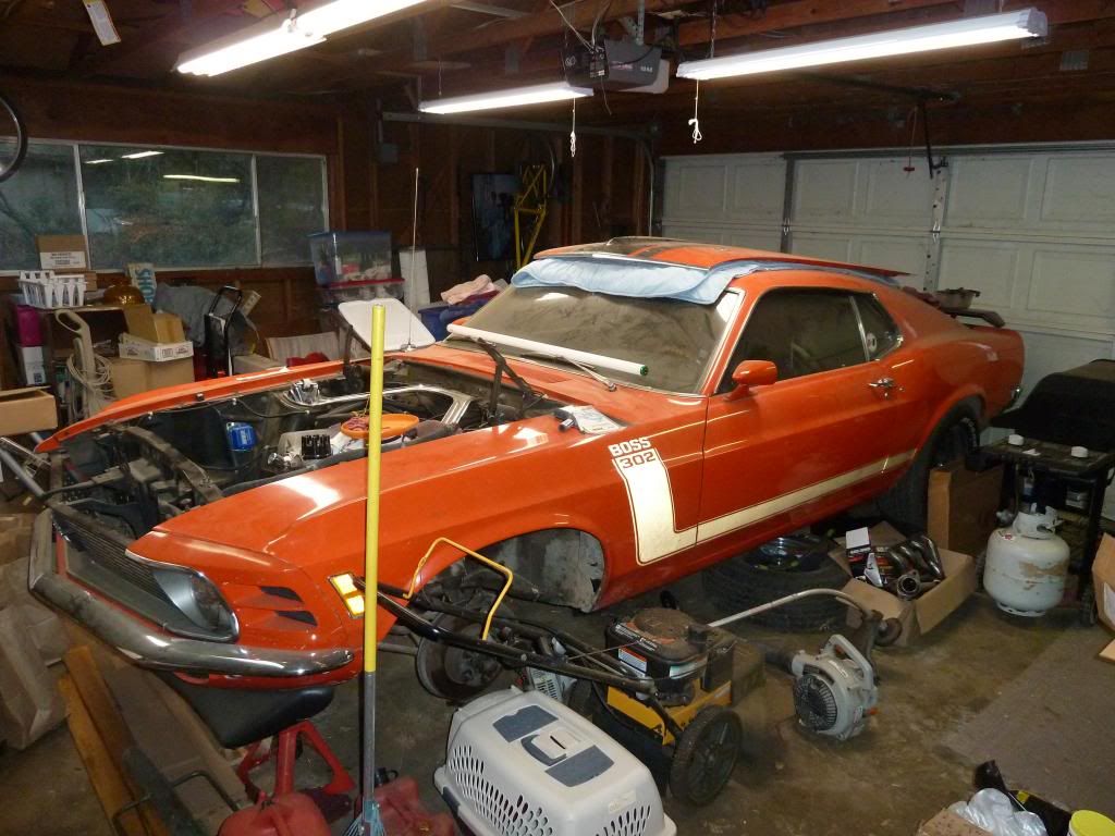

I know I promised you some pics of my mustang a while back so here they are while i remember. As it sits now...
Numbers matching boss 302 engine was rebuilt about 10 years ago to 10.0:1 custom comp forged piston, heads ported, everything balanced and blueprinted, and stuffed with a custom single pattern cam that was .590 lift and 280 duration at .050. It was fun but in fear of damaging the original block that was allready at .040 oversize it got removed and is biegn replaced with a 351 windsor with aluminum AFR heads, edelbrock victor jr intake, a decent comp cam, and nice stainless JBA headers. Someday it will get finished. Only the driver door and the black out treatment just below the rear window has been repainted, other than that its original paint. The interior is original except for the front seats which we had recovered about 8 years ago. Options are tachometer, PS, PDB, fold down rear seat, rear spoiler, 3.91 trac-lok rear end, and calypso corral paint(orange). I love how the stripes turn gold when hit with bright lights at an angle.

Forgot to mention about the options... This car is a Drag Pack car, so along with the 3.91 track-lok rear end it also has a factory oil cooler and the battery is mounted in the trunk. Kinda weird but they put a "battery delete" plate that sticks up where the battery would be if it were in the engine compartment kinda like the mopars that got the radio delete options got a delete plate to cover the hole in the dash.

Twintowers
Re: Dan's 40V V8 4000 Gets a new voice
Yes sir that is the real deal BOSS, very, very nice, good idea keeping that original block on the side like that. My machinist has real deal BOSS 302 1970 service motor with matching 4 speed trans code, I asked about the price just for the engine few years ago, he said somewhere around $4000.00. I'll say your car has very desirable options... drag pack, and color combo not seen much.... All those options say race me! ME I totally dig the reflective 302 strips...
