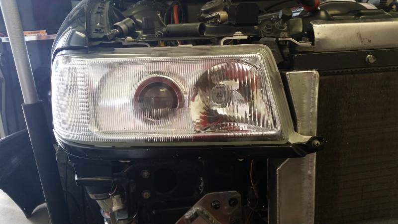

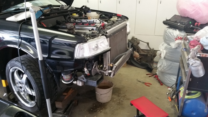

Well, I finally started on the car repairs/upgrades/tweaks after letting it sit over the winter without having it torn down the whole time. When I replaced the Idler pulley with a smaller one I also routed the serp belt differently so I didn't have to replace it with a smaller one. Now, I never thought that doing this would cause my power steering pump to rattle while at idle, but it did. I put up with it for a while because it was around the time for BBQ. After BBQ, I just parked the car and focused on other things in my life putting it off till I could spare the time to deal with it.
So, Saturday I pulled the front end apart to replace the pulley with the original one I had on there, so I drained the radiator and pulled it all off so I had the front of the engine exposed and clear of any obstructions. This is actually the best thing I could have done because I found that the allen bolts in the Harmonic Balancer were loose with one that had completely come out and was draped down against the inside of the balancer. I also had a balance problem I noticed driving the car here and there that needed to be figured out. There it was! I am completely amazed that the bolt stayed put instead of being launched through the one-off radiator I painstakingly built last year and is irreplaceable. Dodged a bullet there! So I put locktight on the bolts and tightened them again. Replaced the Idler pulley with the previous one and routed the belt proper, fired up the car and the rattle was gone. I also blasted an alu P/S pump I removed from a B4 90 at a JY to install on the AAN since it does not have the BOM pump in it, and also blasted my alternator so it would look the same as all the parts on the engine and not be the only dirty part left to be delt with.
20150601_173739 (800x450).jpg (237.35 KiB) Viewed 52449 times
20150601_173919 (800x450).jpg (202.1 KiB) Viewed 52449 times

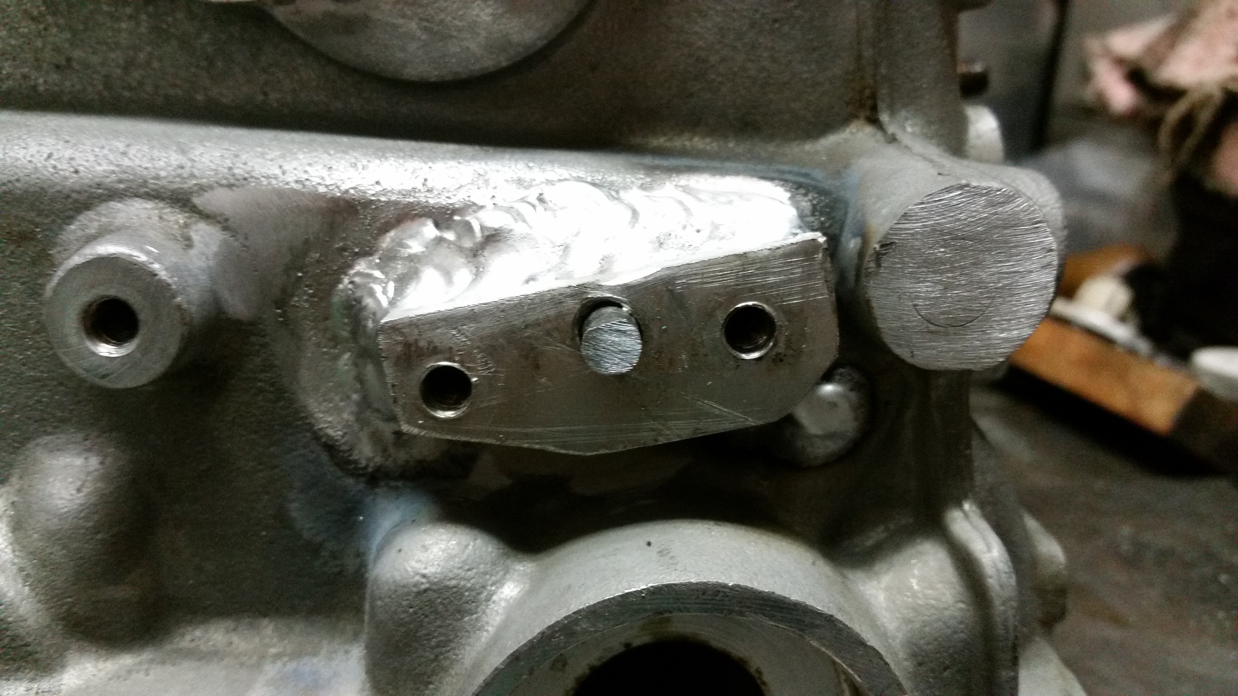

I noticed the engine was sitting on the subframe so I put a washer on the top of each HPR engine mount to prop it up enough to get it off the subframe. worked like a charm.
Then, I had always noticed there was a problem with the passenger fender at the very front hanging over the light was tweaked down and figured it had alwyas been that way since the car had a small fender bender 20 years ago. lucky for me there was no major frame damage, just the hood fender and bumper were damaged at the time. simple replacement fixed the problem, but the guy that repaired it missed that the metal was pulled down slightly. I put a bottle jack between the frame and the corner of the light frame and pushed it back into its proper position. I'm so glad I have been fixing all the little things that have bothered me for the last few years. It looks more better and makes me feel good about it.

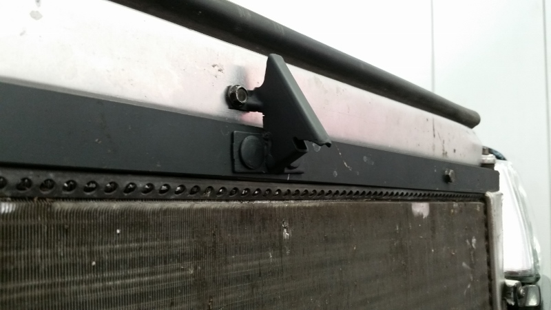

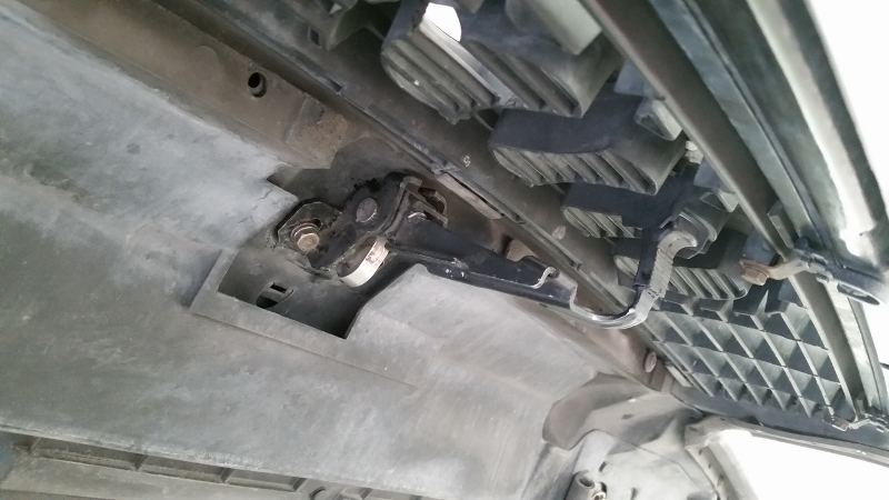

Now, one of the problems I had with moving the radiator to the front of the car was that it lost the secondary safety latch for the hood. It always bothered me to have that inoperable because back in the day on my 4KTQ it was also inop, and one day while going to work the hood popped loose and whipped up and hit the roof. it bent the hood hinges but luckily didn't break the windshield or damage the hood. Ever since that happened, I was nervous about the fact it wasn't working on the coupe. I still had the parts and decided to modify everything to try to get it working like stock, so I bent the latch forward, cut a section out of the handle and welded it back together. Then cut and welded the catch to be a smaller profile and attach to the upper rad support. it actually worked out perfect, and is now completely functional.
20150604_135612 (800x450).jpg (190.84 KiB) Viewed 52449 times
20150604_135544 (800x450).jpg (163.52 KiB) Viewed 52449 times

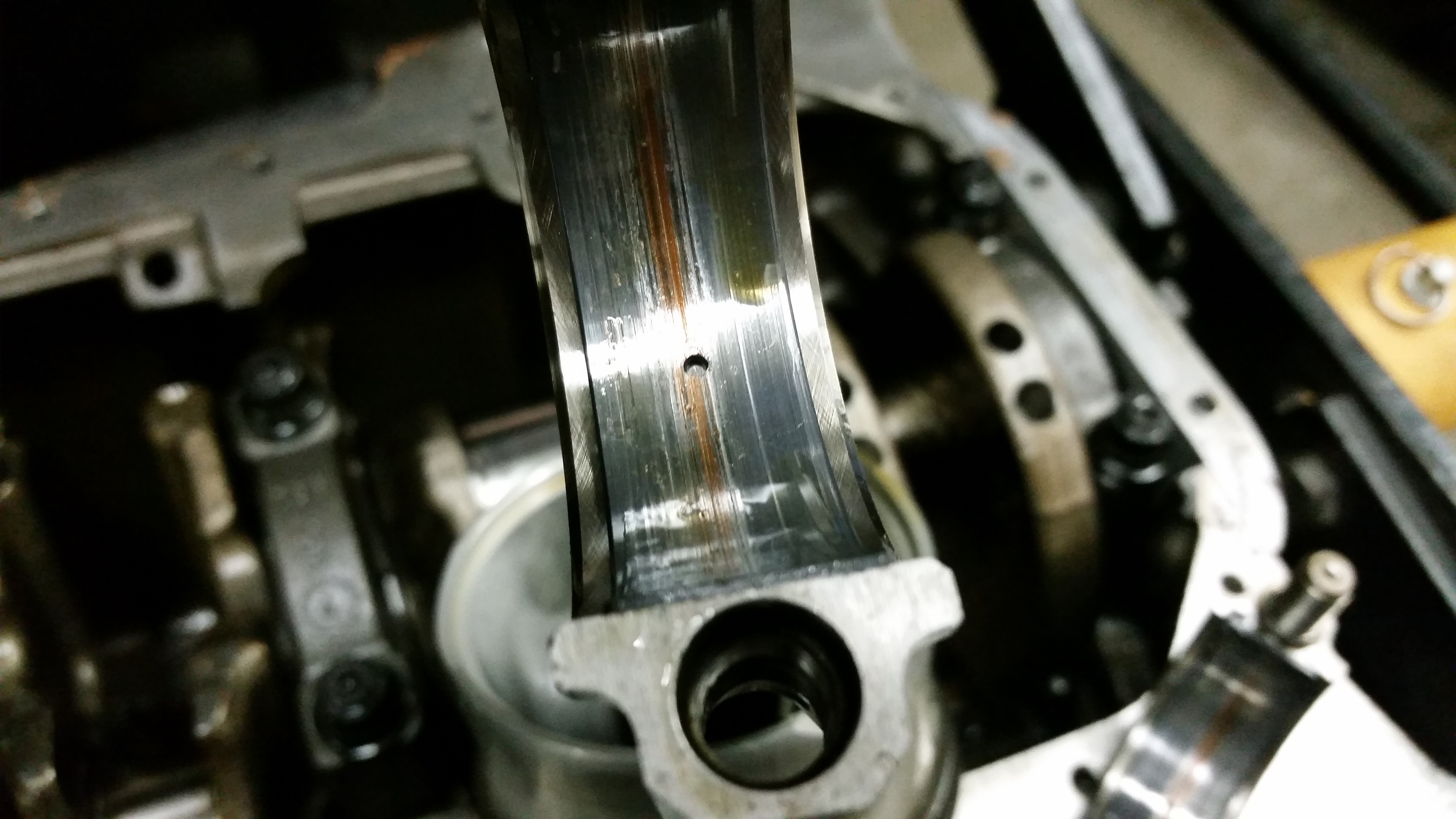

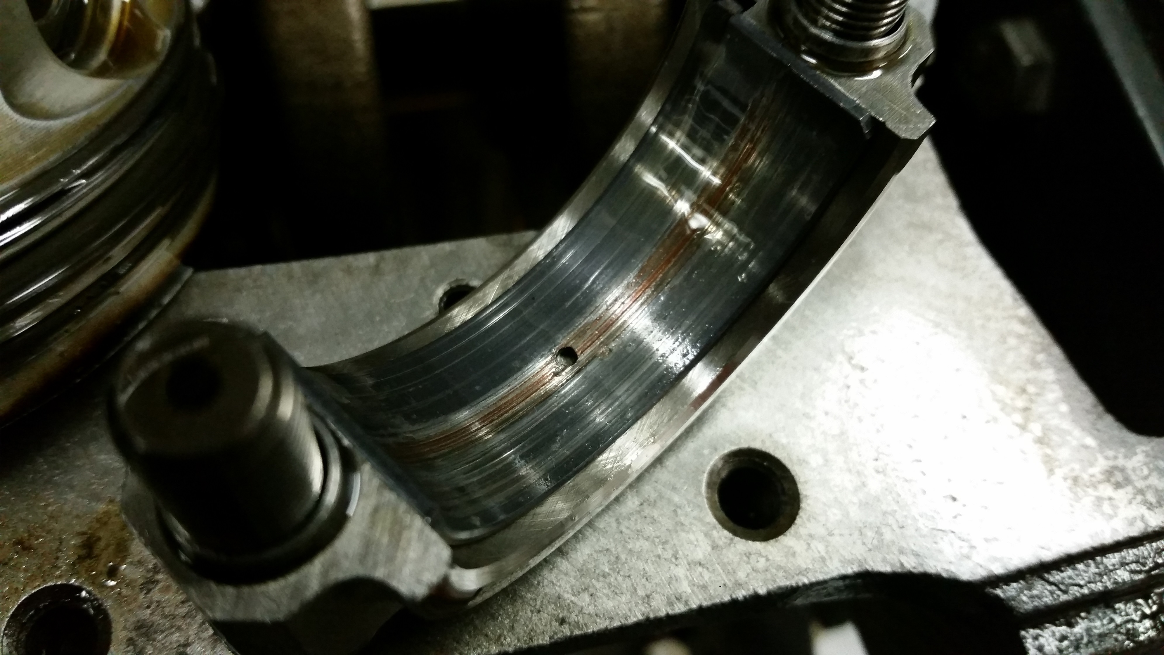

Well, I brought my 7A short block back from storage and tore it down to check the play on the oil pump. it virtually had the same play. So my theory about the oil pump being the issue is wrong. Since I only pulled the first piston/rod and found nothing, I realized I should leave no stone un-turned, so I pulled the rest. Why should I not go through the entire motor and find all that is wrong with it so I don't put it back together again just to fail from something I missed cause I didn't check. Everything looked great up until I pulled #4.
Now this looks bad, but while talking to Nate, he doesn't believe its the cause of the knock. The bearing is damaged, but only in the middle, and not uniform from edge to edge, so it could not be the knock. To describe it, it was an internal knock, lower end, 2 knocks per revolution. This was likely caused at break in, or just after from tuning so early after break in.

by audifreakjim
What does a plastigauge show on that bearing? I would be very suspect of it. Two knocks per revolution almost has to be rod knock. One on upstroke, one on downstroke.

by scubadave
If after I pull the crank and find nothing else, I would agree there could be no other explanation for the knock. By the looks of the other rod bearings, I doubt the crank is going to be any different. Not to mention how would the crank make that noise regarding the main bearings? At this point, unless i find some other rotational smoking gun, there couldn't be any other explanation.

by pkw
I would check the heck out of that! Mic everything to make sure it is round and right and go ahead and check with plastigage too. I would also use feel to get an idea of the relationship going there. All this stuff together gets a bit redundant but there will be some cumulative gain achieved.

by scubadave
Well, based on some conversations I had with Nate, and no other physical findings, it seems that the #4 rod bearing is the only failure point and the result comes down to the combination of a few things. First, stock size calico coated bearings with stock tolerances. Second, much higher power output. Those combinations resulted in oil not being able to wick away the heat fast enough, overheating, and failing, as is explained in Jeff Gerner's engine building thread. Nate had the same thing happen to him in his motor, and had his crank ground to open up the tolerances enough for acceptable heat transfer and oil wedgification. As soon as I get a new set of coated bearings and take measurements, my crank will be getting ground as well.

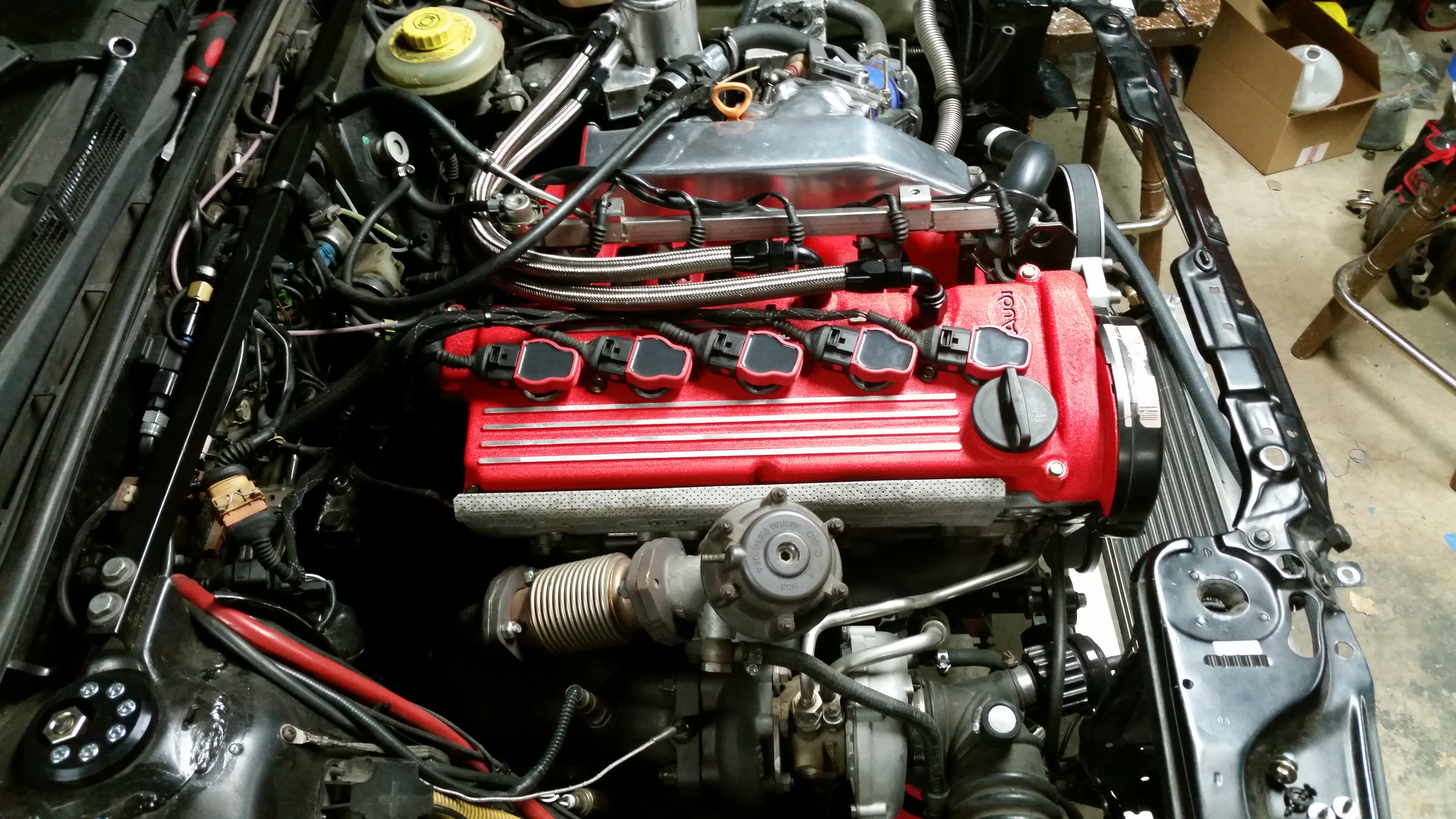

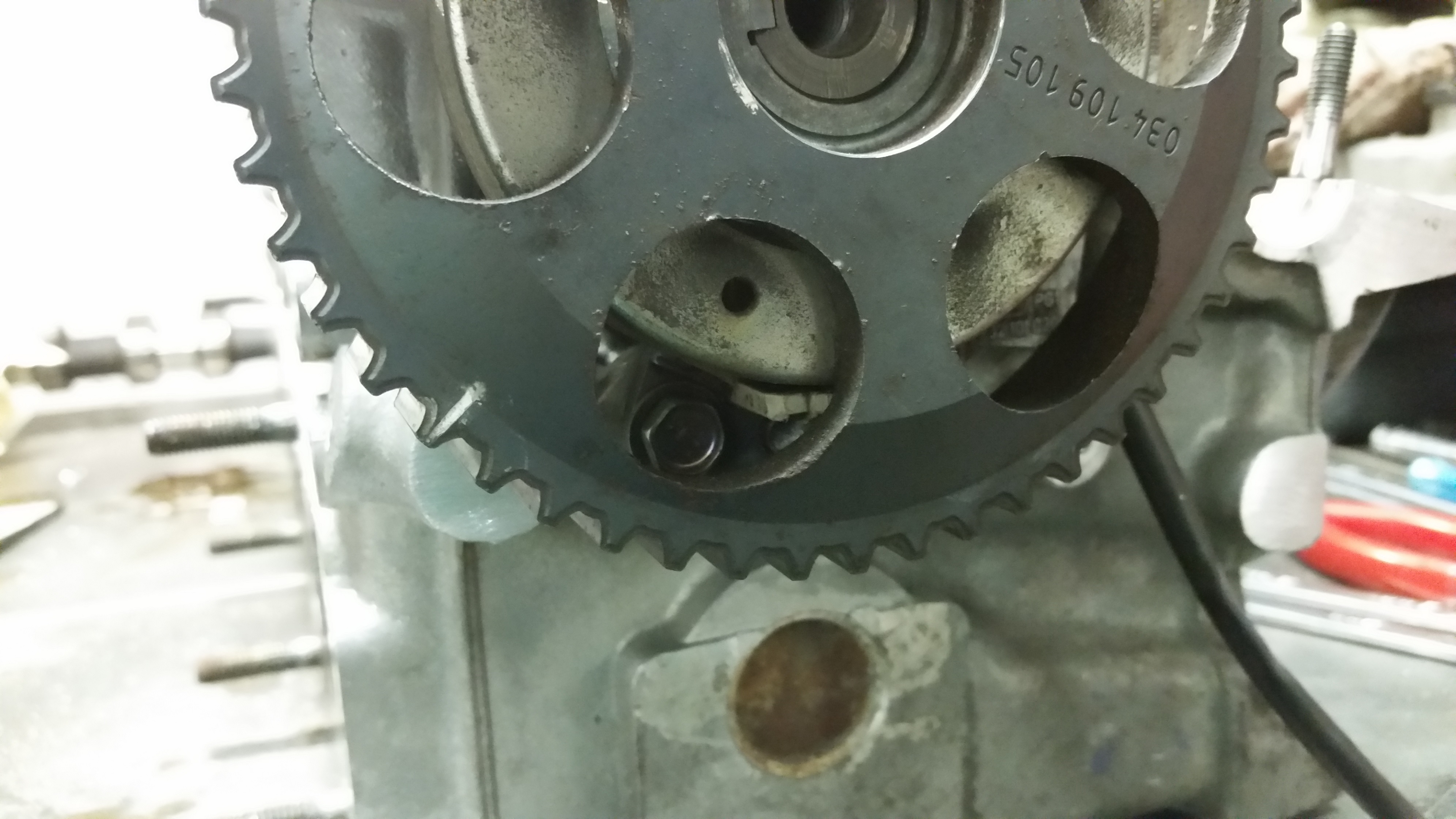

So I decided to come back to the car and try to fix the 2 problems I have been fighting since it got parked. first, the rattle was the newly done head I had a machine shop do work on. needless to say, they were morons when it came to these heads. I may as well have flushed all that money down the drain. I don't know that the head is garbage or not, but I decided to put the original AAN head back on the block. I also took a hard look at the turbo and came to realize the oil was coming from the turbine. I had Industrial Injection rebuild the turbo and put the car back together, changed the oil/filter, changed the fuel, and fired it back up again.
The result was the rattle disappeared, aside from the (anticipated) lifters pumping up. However, the turbo is now pumping oil out the turbine faster than before.
So forgive my bad memory as I have used my brain for testing and debug of electronic devices I cant go into, and the thought processes on the old Audi's gas gotten a bit rusty. I have a feeling the turbo is getting too much oil pressure, but I don't really know where that should be regulated. is it in the oil pump, or the filter housing. I need to connect my pressure gauge up to the feed line of the turbo, but since that is still original, it may be tricky. I would rather not yank the turbo back off just yet to go yell at Industrial Injection before I check the basics. Can somebody point me in the right direction?

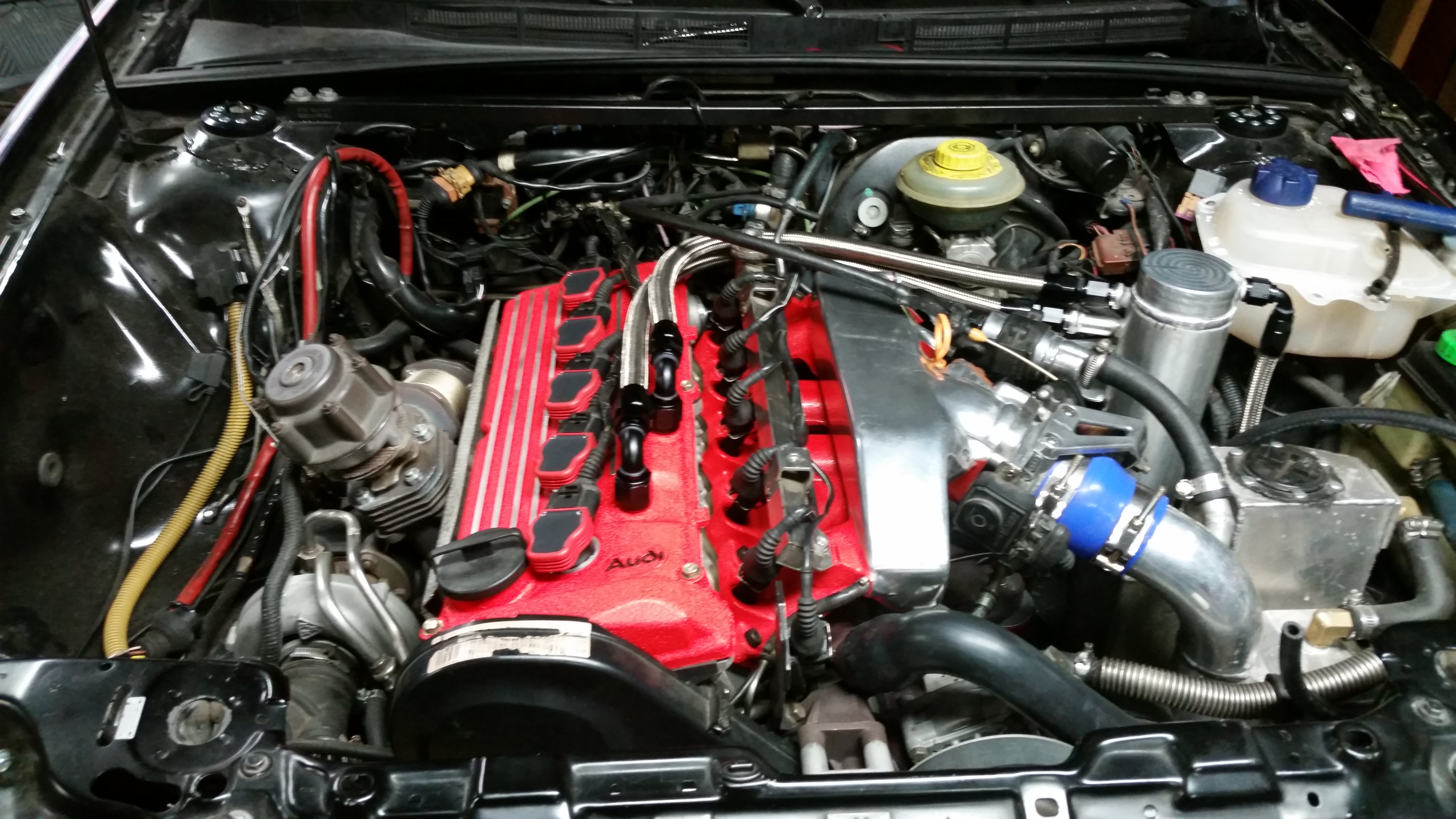

And since everybody likes pictures, here is the latest pretty pictures of the engine.
