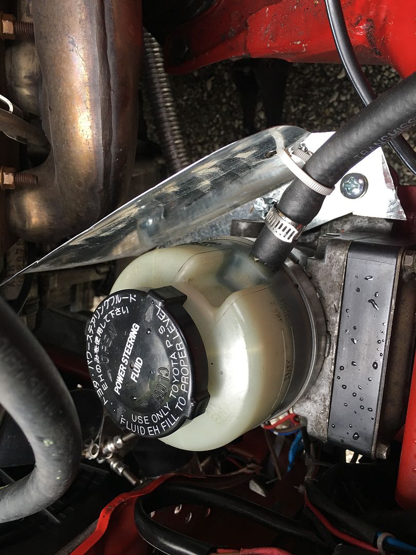

It all works!

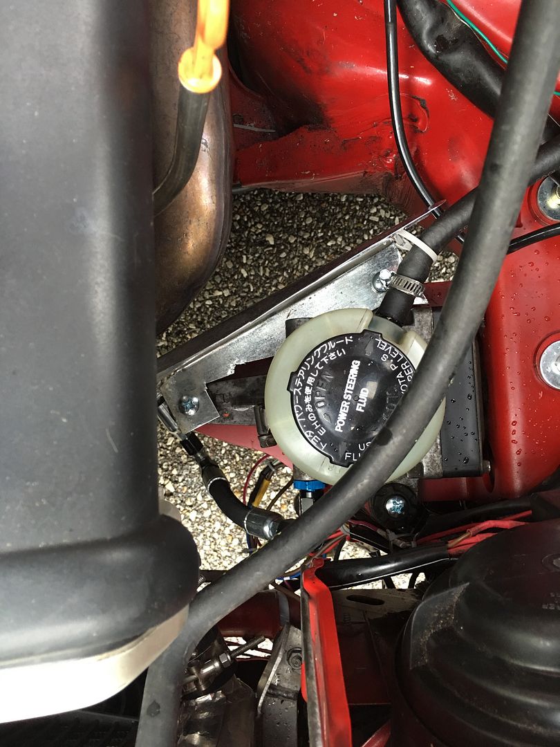

I finally got the last piece I needed today. I ended up going to a local hydraulic shop and having them make a long hose that would replace my existing hose and an 8" extension for the hose in the car rather than a whole new line. I didn't want to make two trips if one approach didn't work.
I ended up using the extension first because I didn't want to pull the intake manifold and all associated stuff again to get to the other end of the hose.
After a quick bleed (all with the engine off too!) I was good to go!
It's a little stiffer steering than stock but no noise and very smooth!

Sweet! Looks great down there, the integrated reservoir is nice. I'll have to explore that route if mine ever dies.

Thanks! That little heatshield works too! I measured 160* on the manifold side and 50* on the pump side with my laser thermometer just now. Crazy!

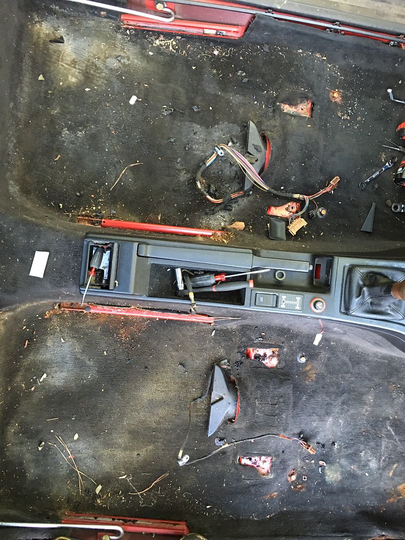

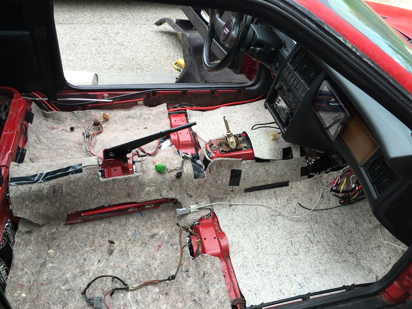

I got a bunch more work done last night and all day today.

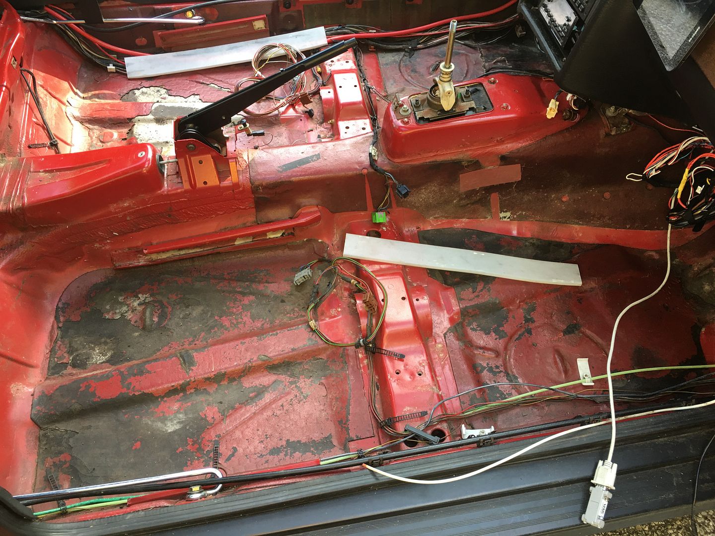

My parts coupe is donating most of its interior to this one.
Carpet, Door Cards, Aux gauges
So I set to swap the carpet out and hoped that the parts car would have the padding intact.
not quite:
This car has been parked in my driveway for maybe 2 weeks and the ants instantly knew something was there:
The padding has all been wet and is garbage.

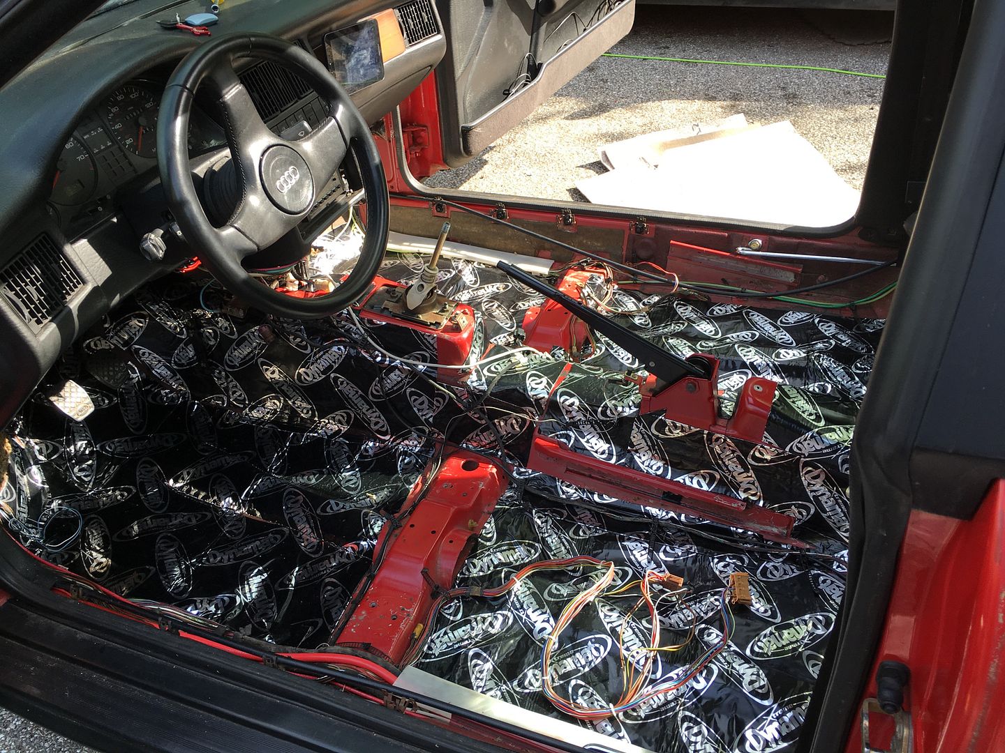

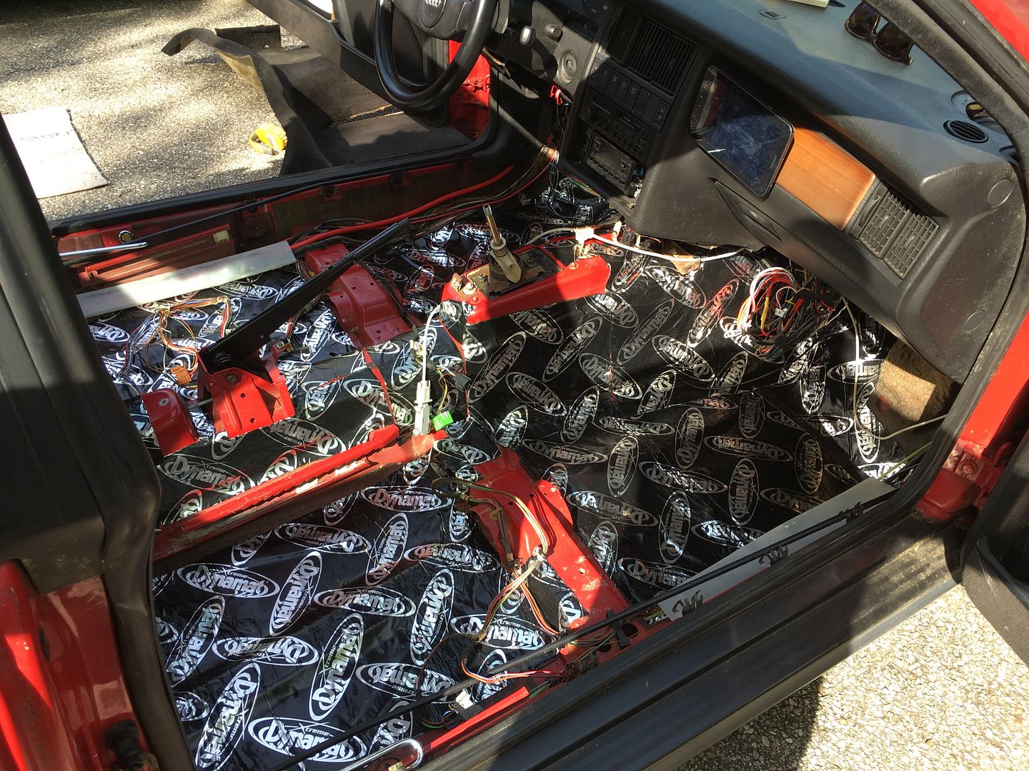

So I went to Plan B which is to make all the padding as I go and put the carpet in.
Firstly, pulled my crappy carpet out:
Installed a bunch of Dynomat:

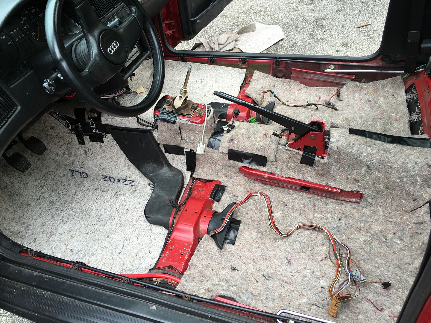

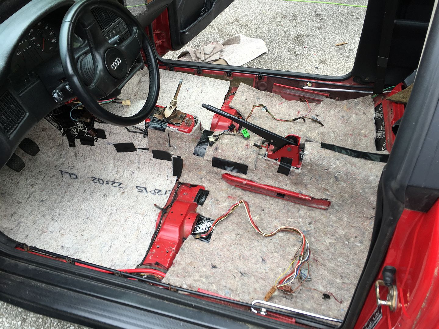

And set to cutting up the padding I bought for this:

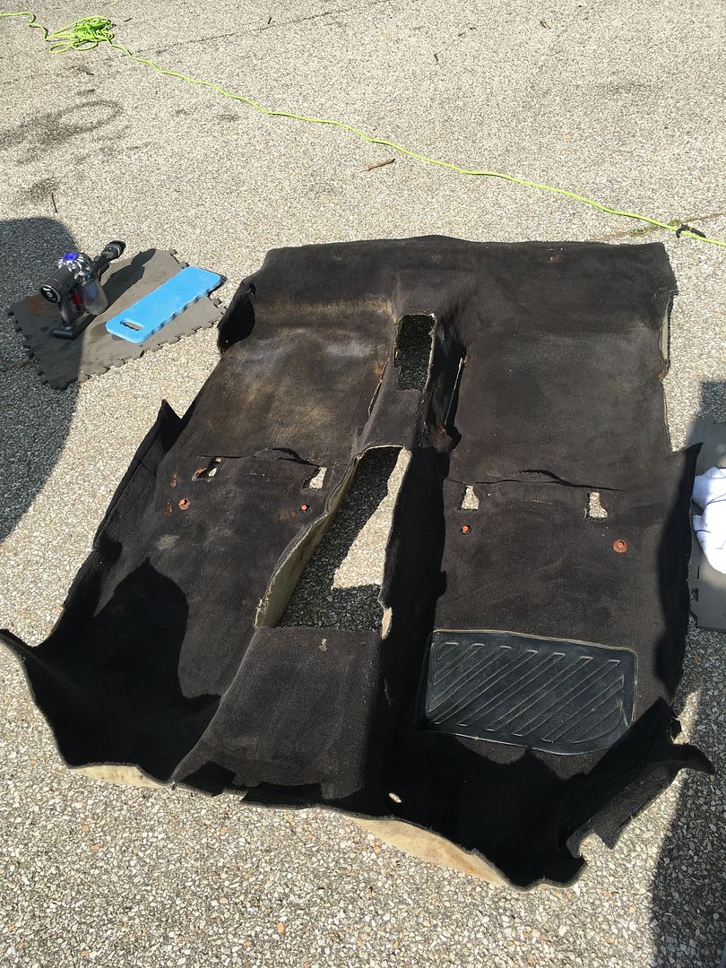

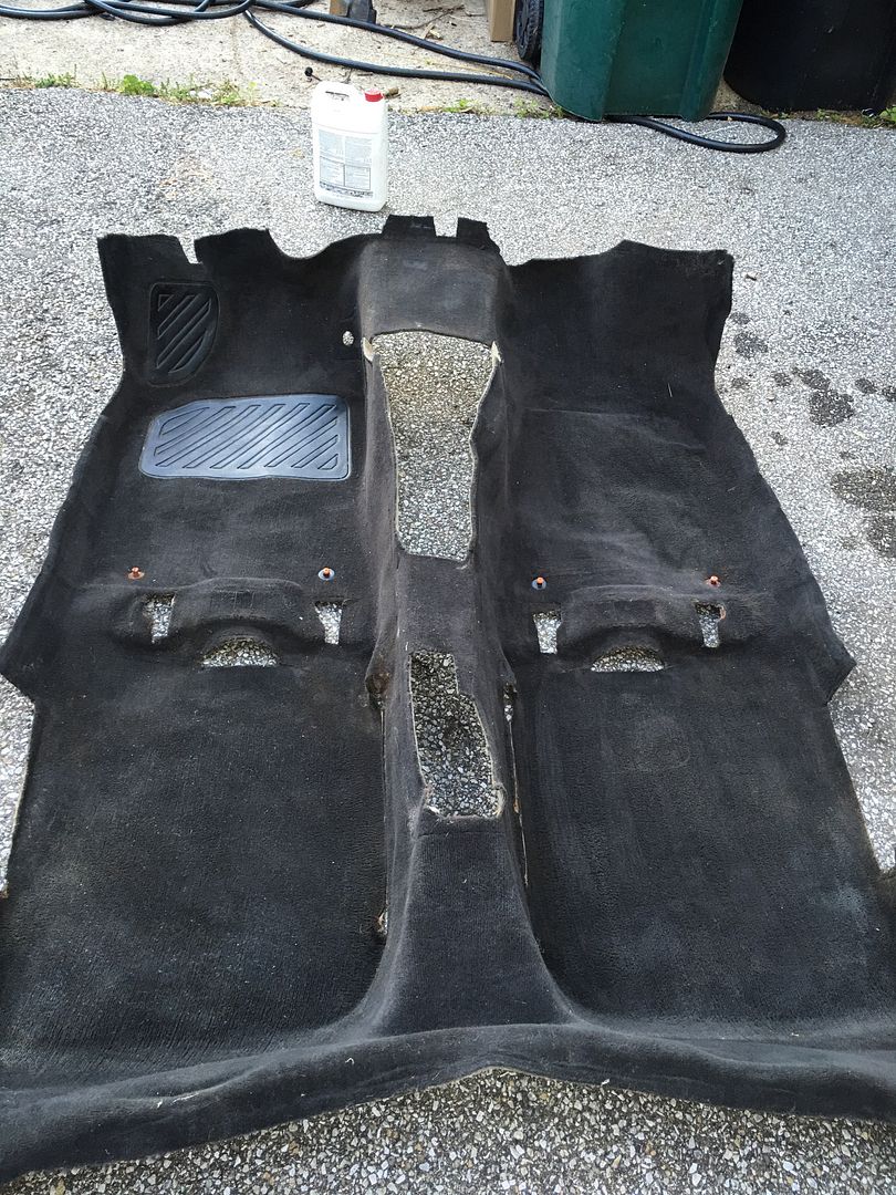

Then I cleaned the carpet from the parts car.

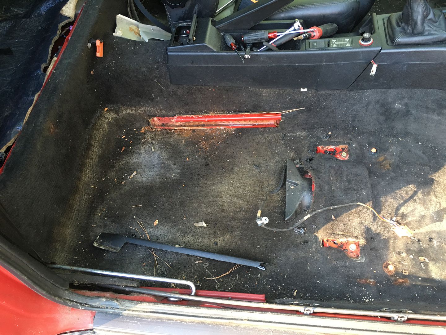

Here it is as it sat in the parts car. It clearly sat very wet for some time:
Despite being super dirty, it has the backing mostly intact which was the problem with the carpet in my car previously. I had pressure washed it which got it super clean but destroyed the backing and as a result it didn't hold its shape anymore.
I bought a portable Rug Doctor from Walmart and got to work. This pic the right side is done, the left is needing done:
All clean:
And installed!
I missed a piece!

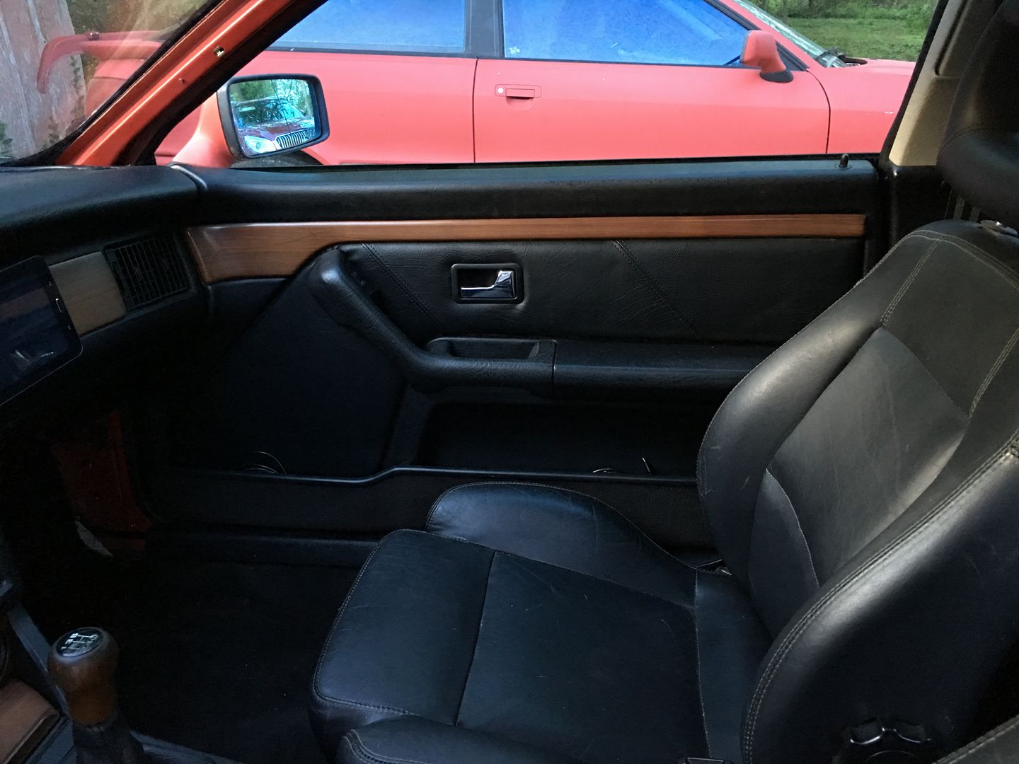

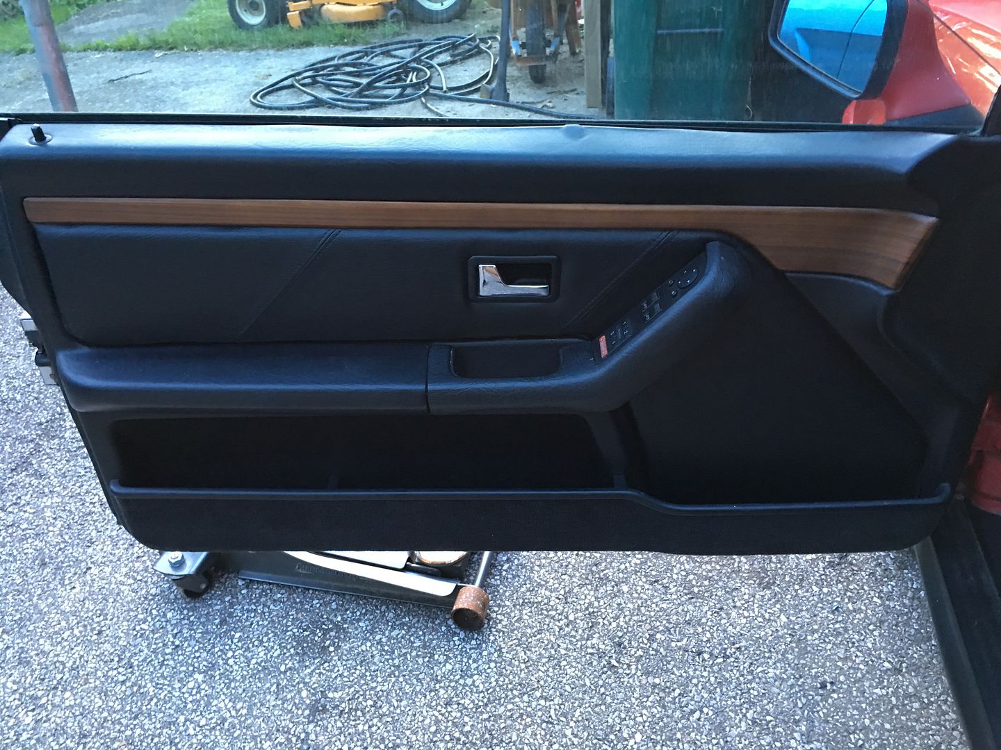

New door cards - Mine had no leather and I removed all the glue so that they were black plastic:
This car looks pretty damn good now! I just need to repaint it!

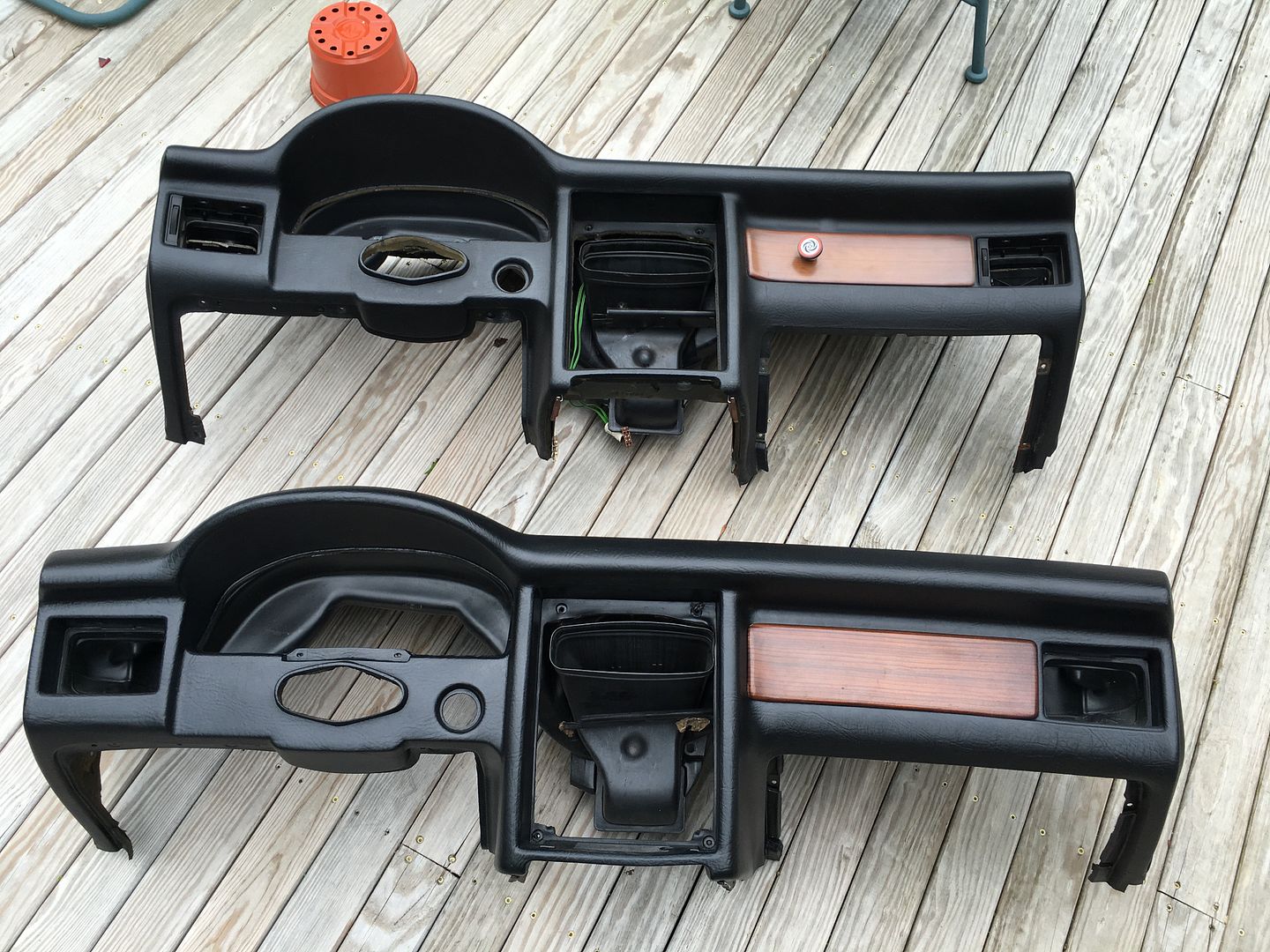

I got quite a bit done the last couple days. I made a list that I mostly completed

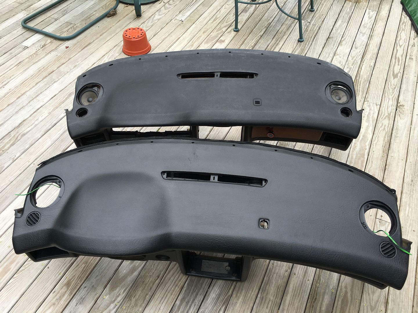

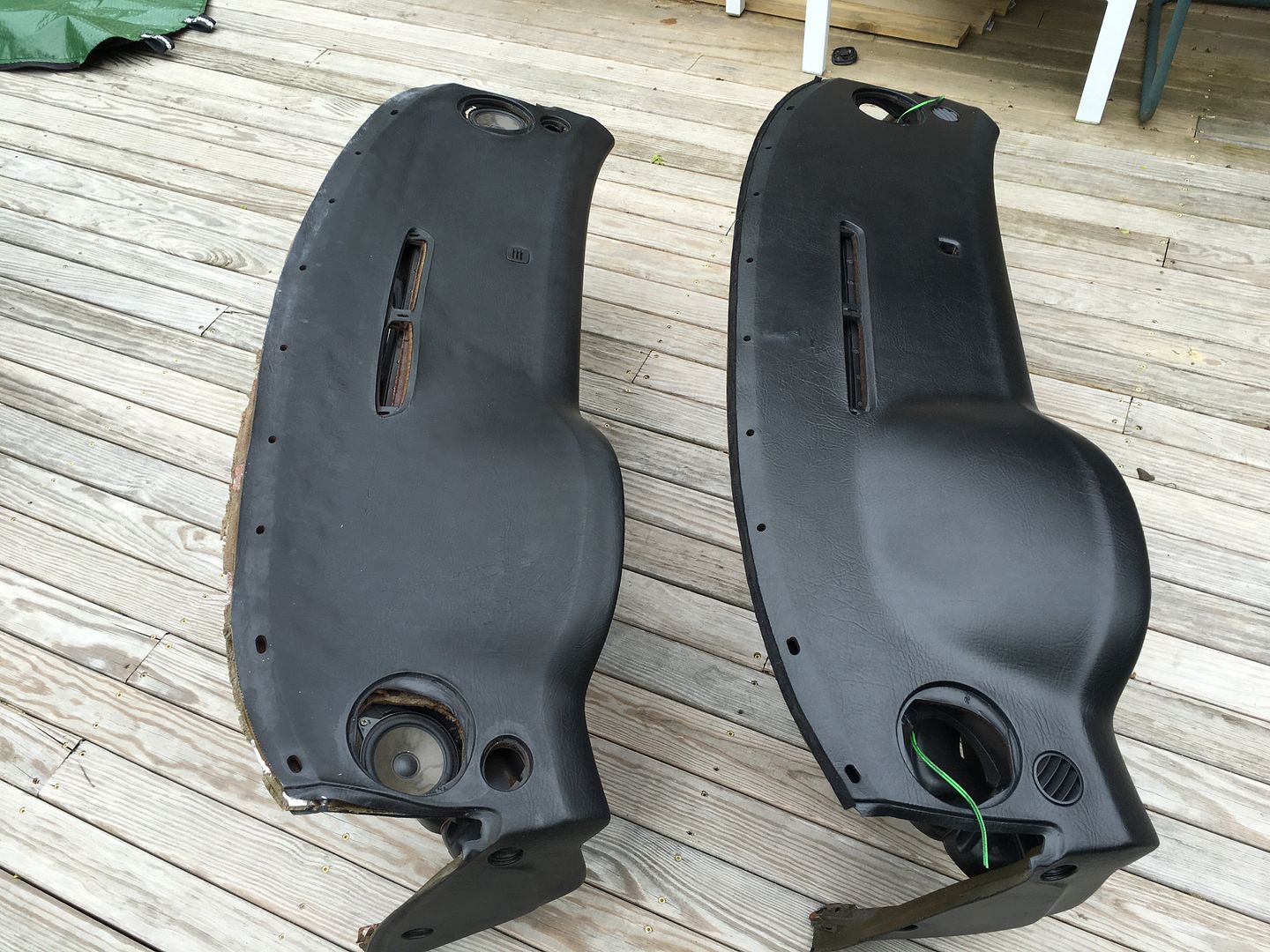

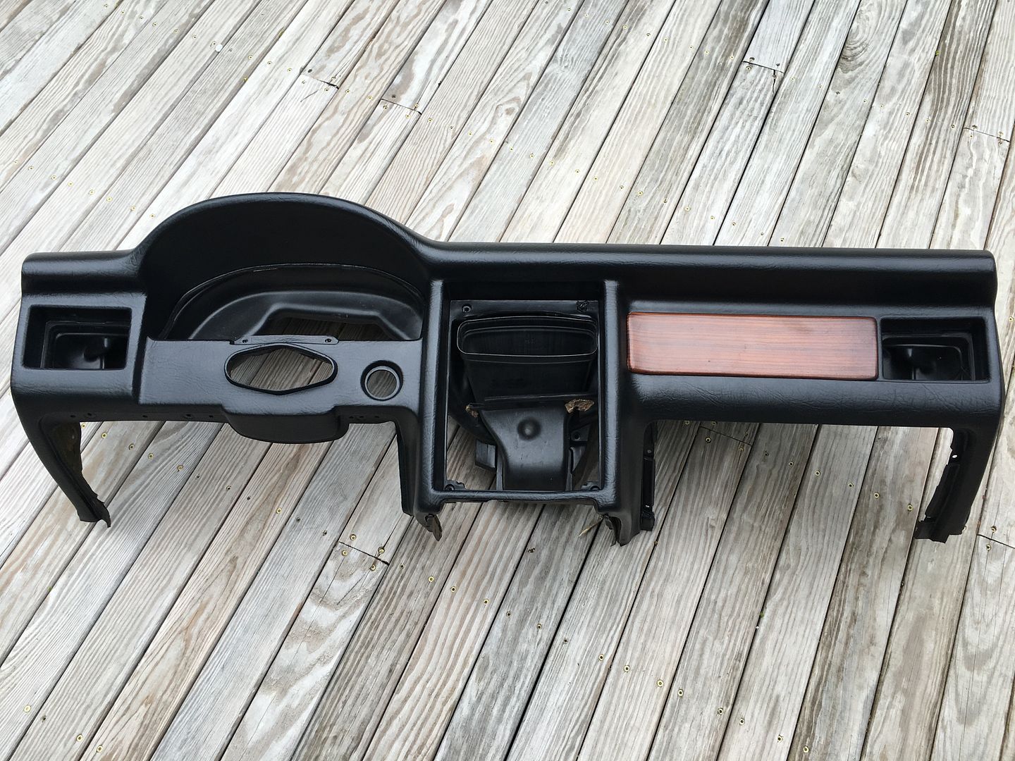

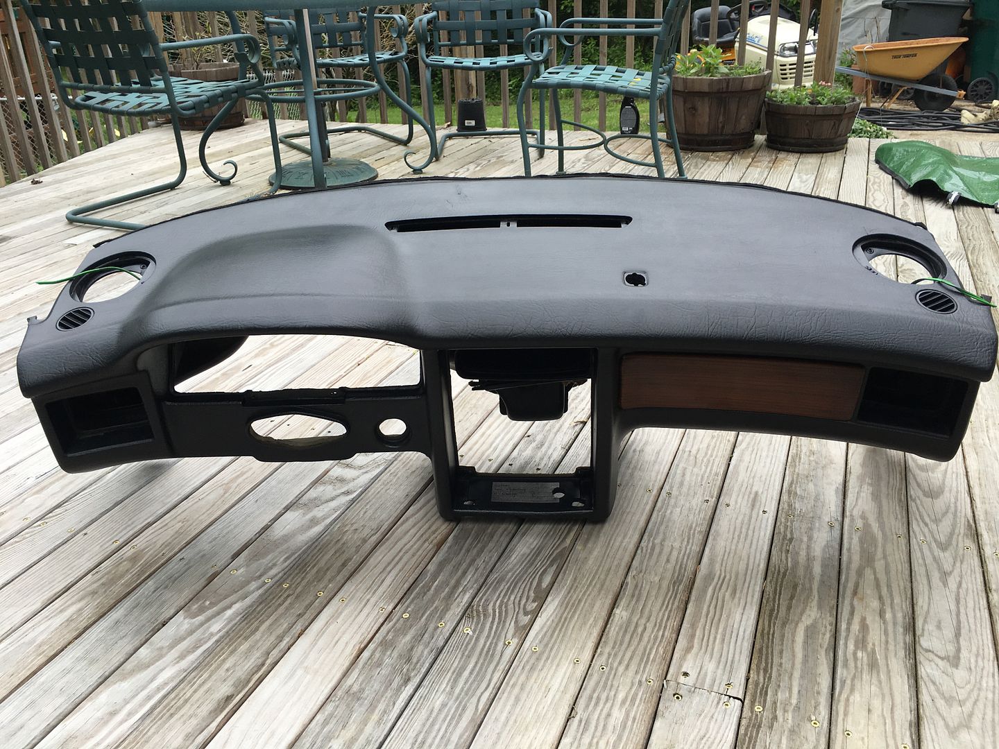

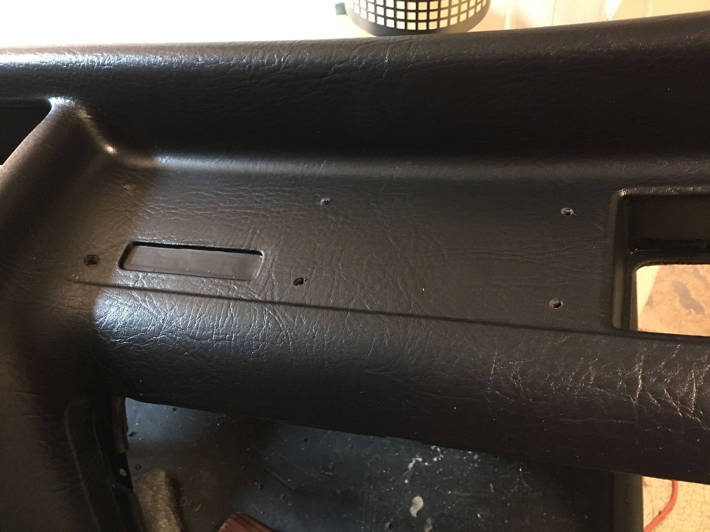

Firstly, I got the new to me dash repaired, dyed and installed!

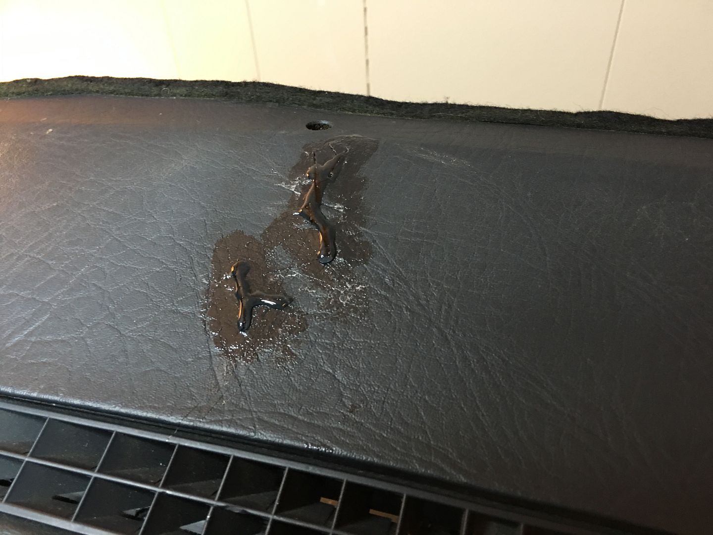

I used this stuff for the vinyl repair, cleaning and dying:

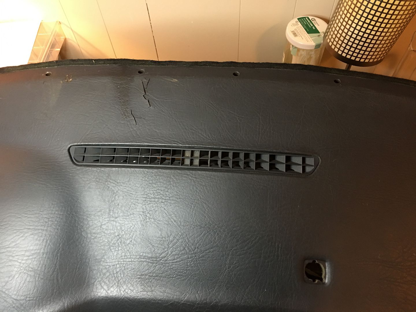

The issue with my dash is that it is starting to crack all over but also has warped and shrunk in the sun. the speaker grills don't fit any more and the vent covers have all popped out too.
The Dash's damage as I got it:
I did a couple applications of the vinyl repair stuff. Sanding in between each time. I know it isn't going to look perfect but it should keep the cracking from spreading and should certainly look better than it did.
After a few treatments I sprayed the dye on.
Then I drilled in a few holes for the dash trim piece:
Then the dash as it is now:
All in all I am very pleased, the dash looks brand new and is as black as it needs to be. If I were nitpicking, I would say it is a little shinier than the old one was.
Here are the old and new side by side:

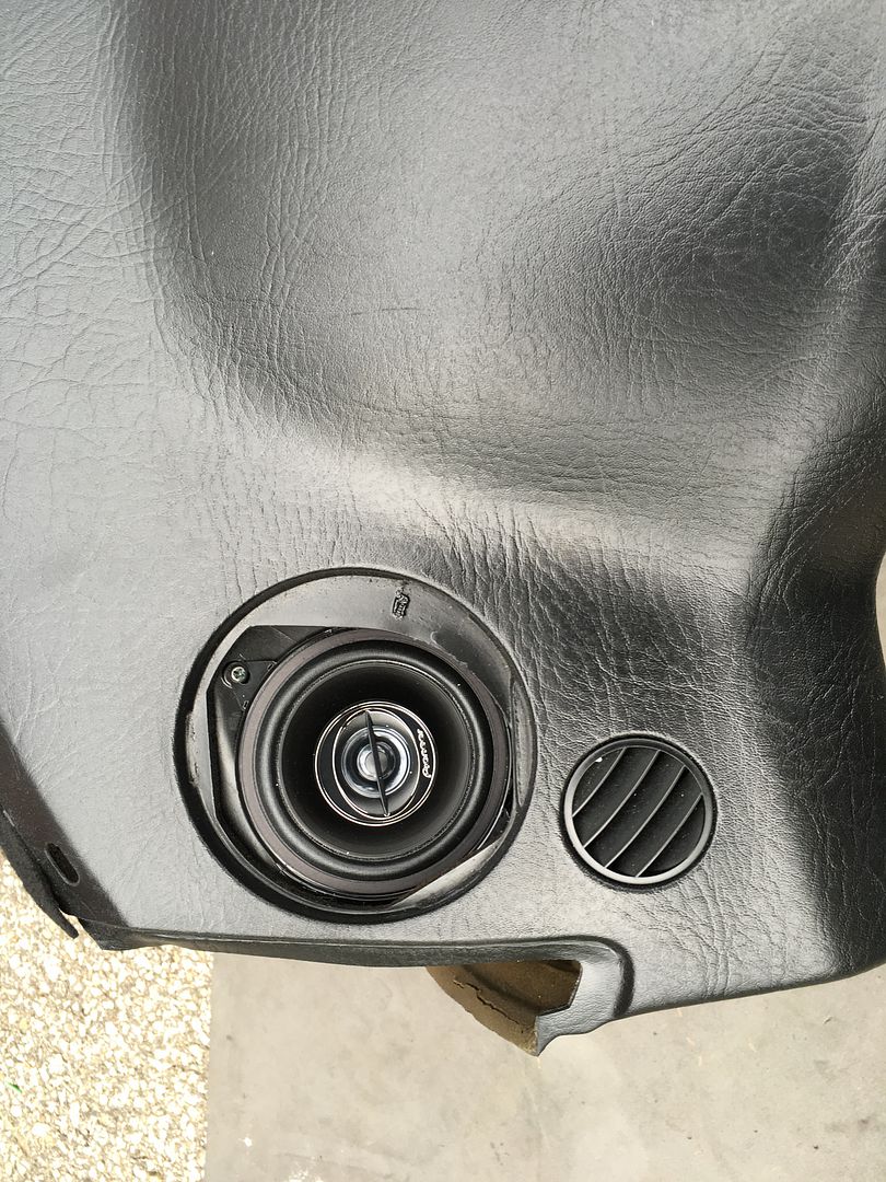

Also, while I had the dash out, I decided to replace the speakers since I could get to them easily. Then I decided to replace the rears since they dont work at all. While I'm doing all that I may as well replace the head unit too so I can listen to music other than the radio.
Got some 4" speakers for the dash piece and 5 1/4" speakers for the rear cards. Took me forever to realize I had to "unscrew" the speakers out of their place
Got it all back together and I had a pin push back in the VEMS harness connector. Took me an hour to figure out why the car wouldn't run. :bangshead:

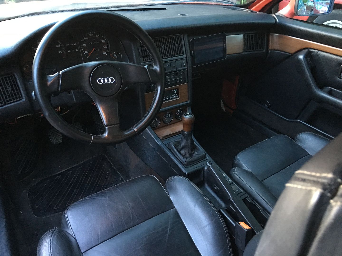

Here's the way it looks as of today:
I removed the ashtray and put in a wood insert from an 88 '90 in its place. I've always liked those.

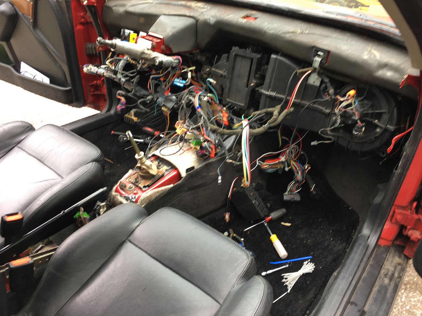

Re: Re: Ben's V8 CQ - Carlisle Prep
That looks great Ben! All that wiring is so crazy lol... Glad I never took the dash off the 4k or I'd probably have taken it all out.

chaloux wrote: All that wiring is so crazy lol...
I read every b3 dash removal heater core replacement how to I could find.
None of them prepared me for the wiring I'd have to deal with.
