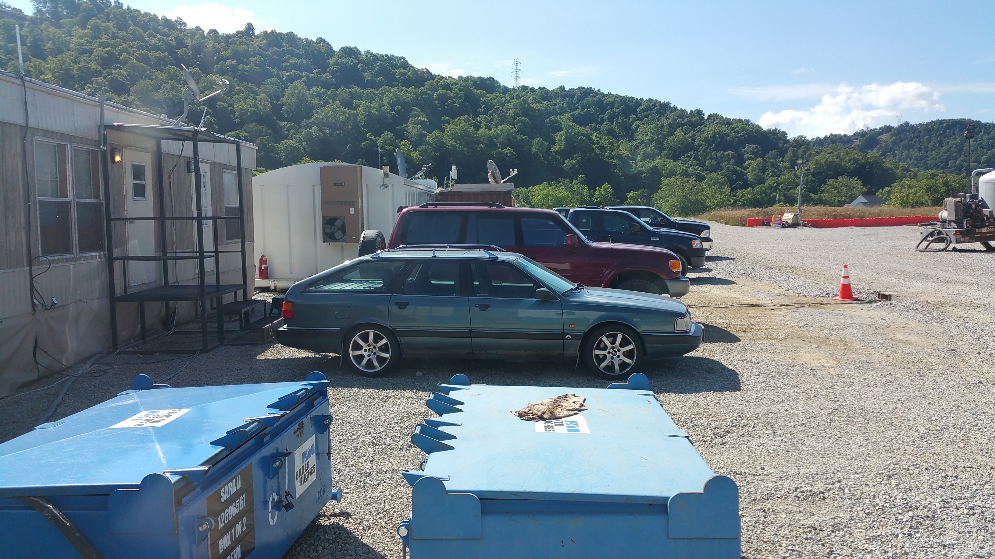

In the meantime, here's a picture of the ole wagon in its broken yet still gettin-it-done state.

Even broken, it still looks badass!

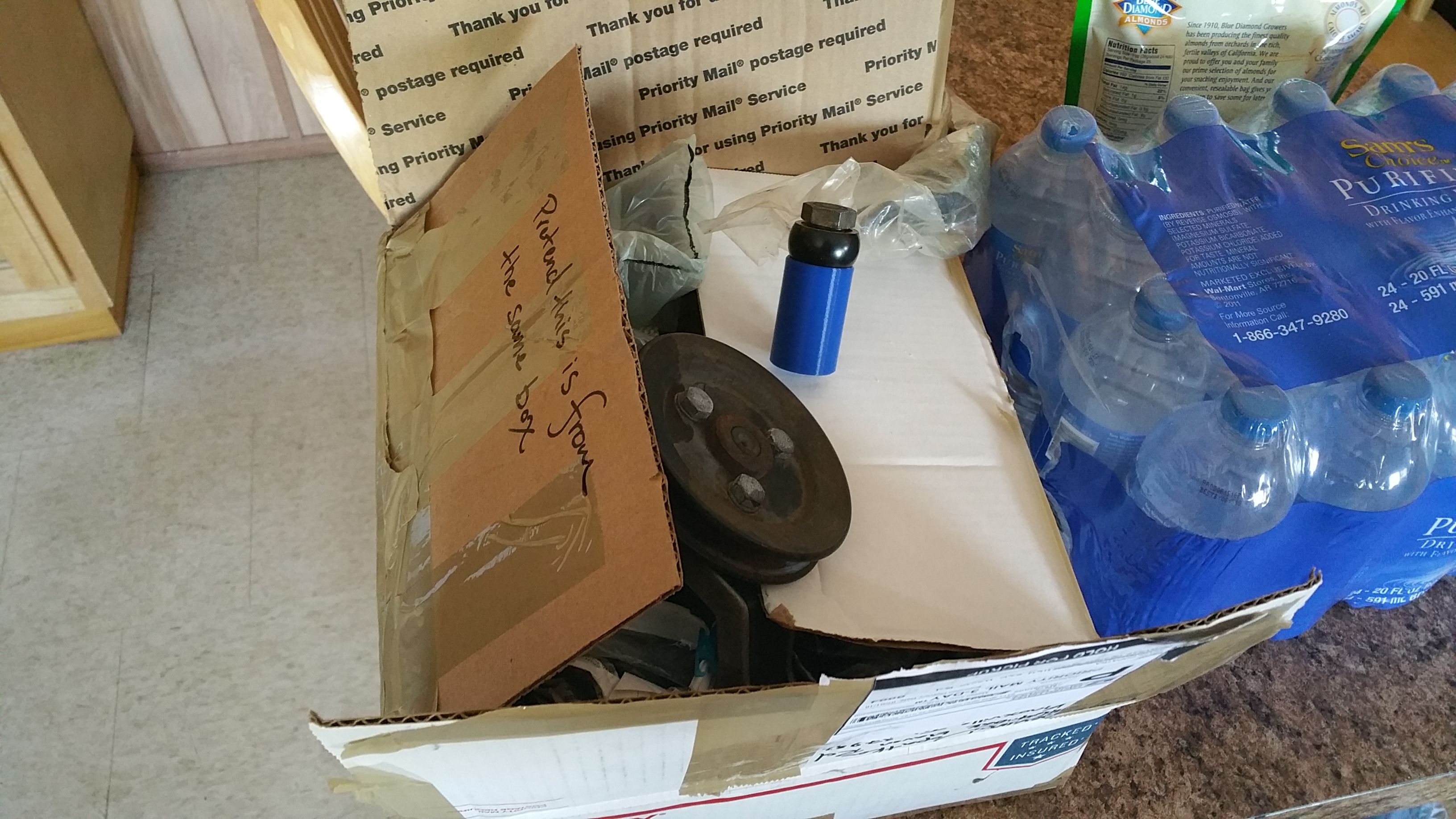

Just got the pumps today along with some of the other parts. I can't thank you enough Kevin!
Love the box lol

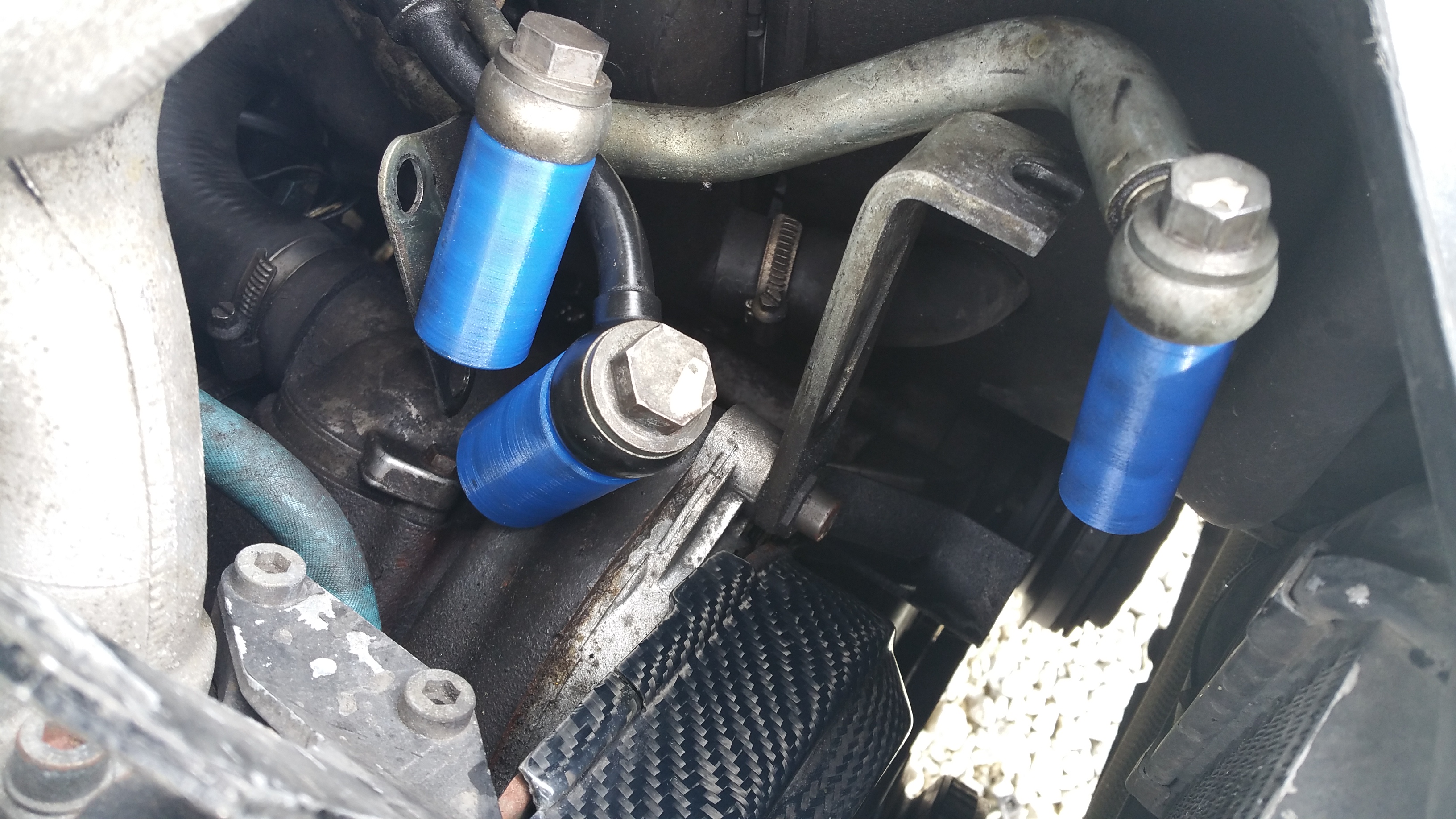

You can also see one of the temporary banjo plugs (blue) I made on the 3d printer so I could plug the lines in between getting the pumps swapped out. I love that printer!

It was pretty easy using the 5k pump on the 200. All went smoothly, especially with the steering line caps. If anyone wants some let me know and I'll print some!

Those banjo caps are pretty nifty, though. Probably beats the classic let-fluid-dump-all-over-everything method
