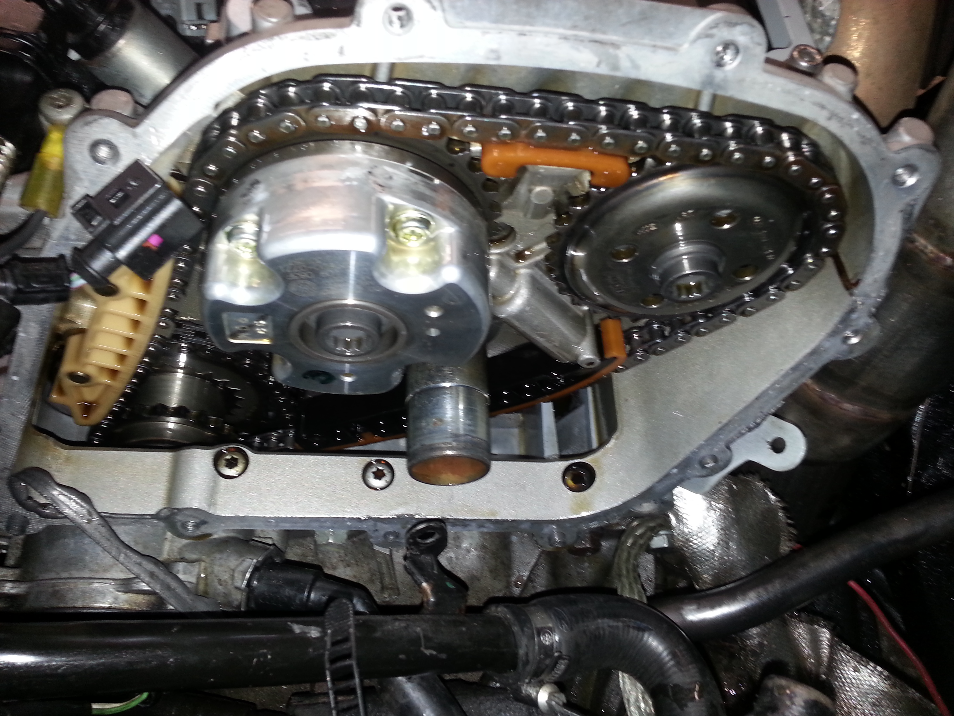

Re: Jims 07K 84 Super HX40 4kq "breakin'"?
What comp are those jes and what'd you do for the piston to wall clearance?

- Posts: 659
Upper chains look ok. Now to check timing...

- Posts: 659
8.5:1 .0035 i believe. If im incorrect its what je recommended for turbo/nitrous setup. Between .003-.005
