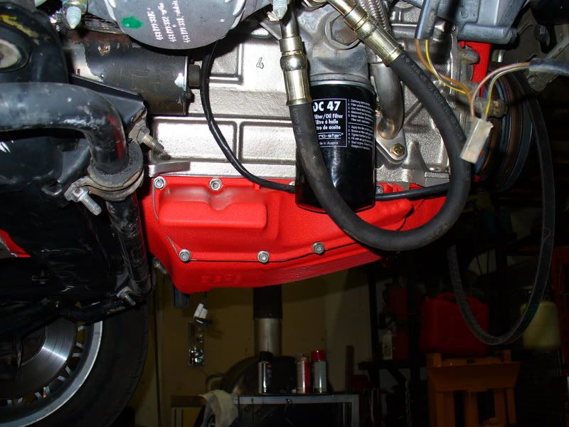

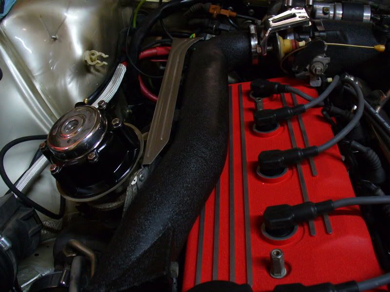

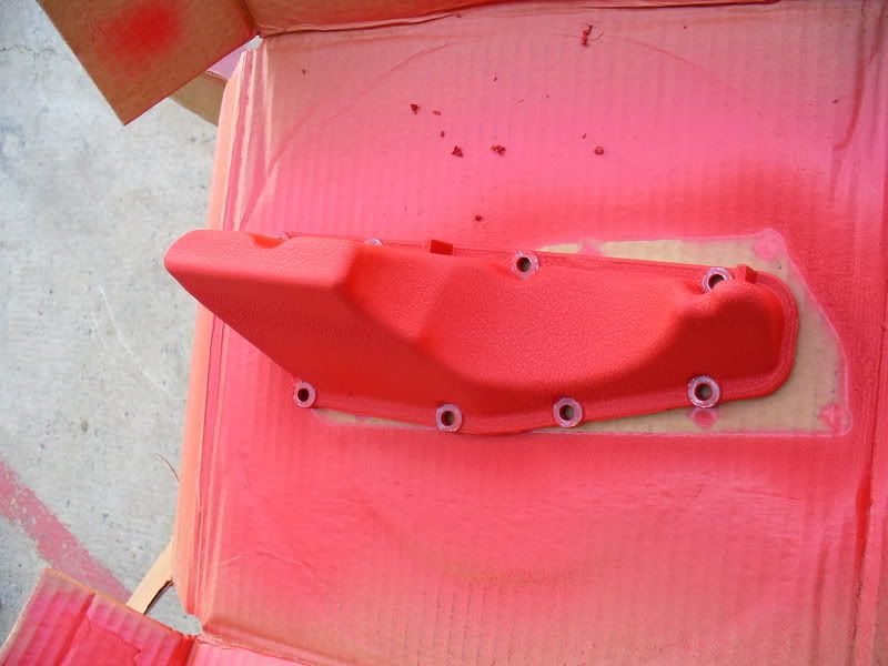

ok! i got the new oil pan extension painted quick like...
installed...
poured the oil back into it for the 3rd time
then hooked the battry back up and cranked it a bit, still cranks easy, this time the oil light went out... that's good right?
then i started it.. oil light out, no weird noises.. whew.... lets hope it stays that way for a long time to come
http://www.youtube.com/watch?v=s-wzU7QdB88

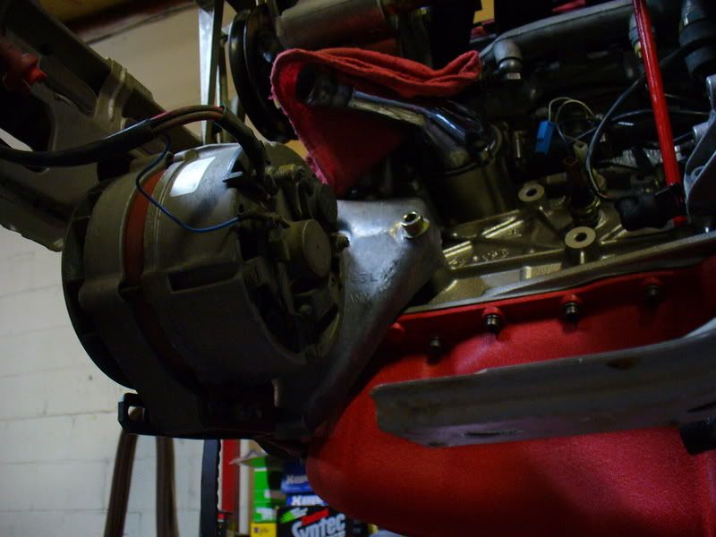

in other news, i got the alternator on and hooked up
finally got to the wastegate tended to so the wiz doesn't have a fit

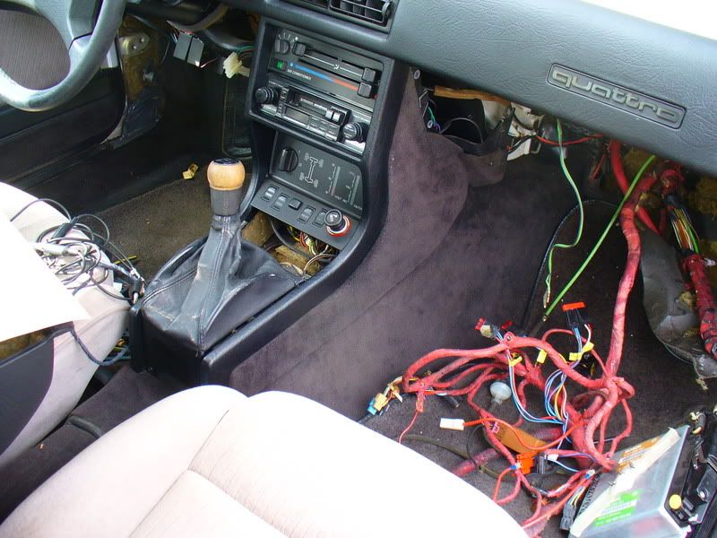

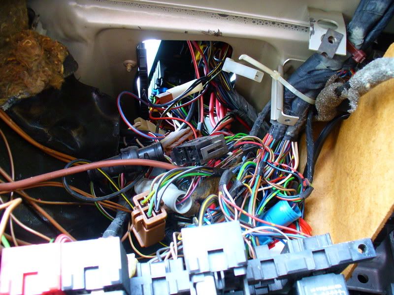

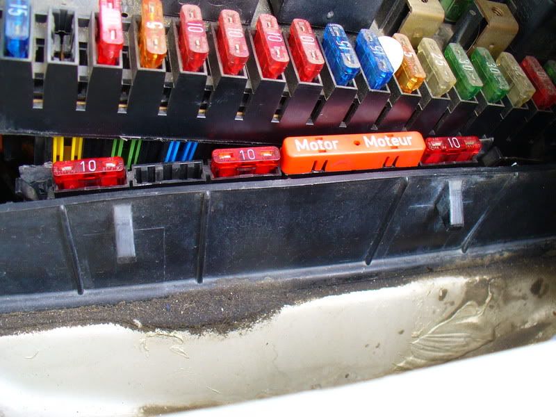

ok! wiring update.... kind of a pain to route everything and do it nicely, but here's my attempt.
started off like this...
then progressed to this..

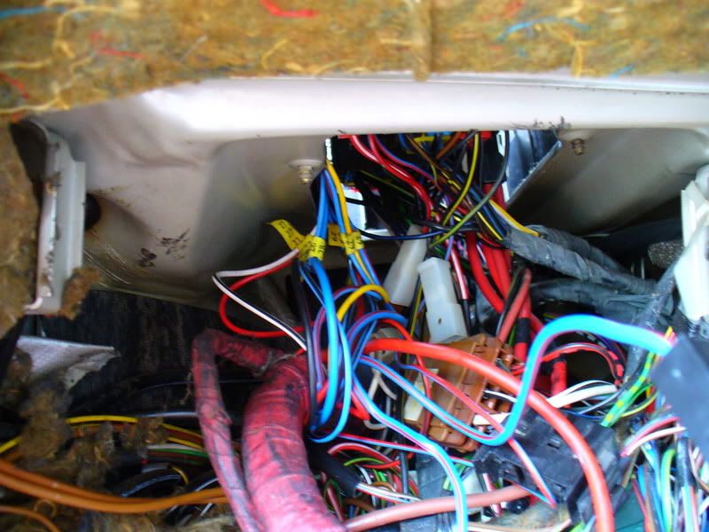

routed the main potion of the harness up over the trans tunneland looped in with the factory wires through the releaseable zipties. i also ran my harness up behind the main 4kq harness/rats nest where there's a little extra space and so that the fuses coming out of the harness reach the fuse panel properly.

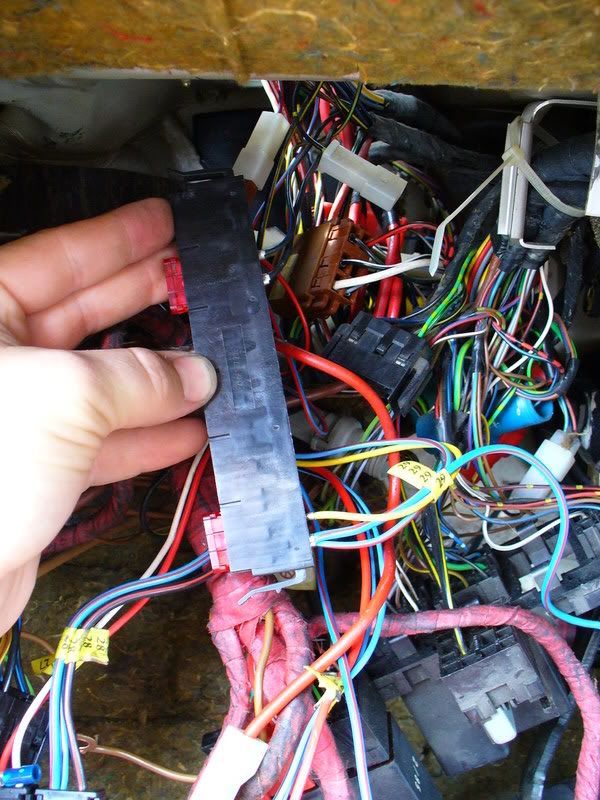

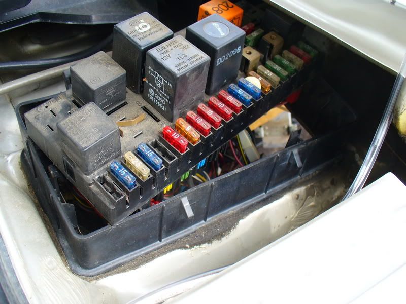

i lifted the fuse panel out so i could access the side strip of fuses..

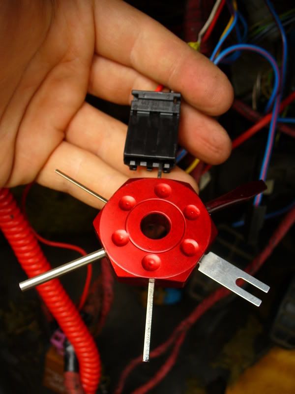

i used a special tool for removing terminals..
so i could snap them into the stock 4kq fuse strip...
had to do 4 in all so that it looks like factory in the fuse box..
shot from underneath with them in place..

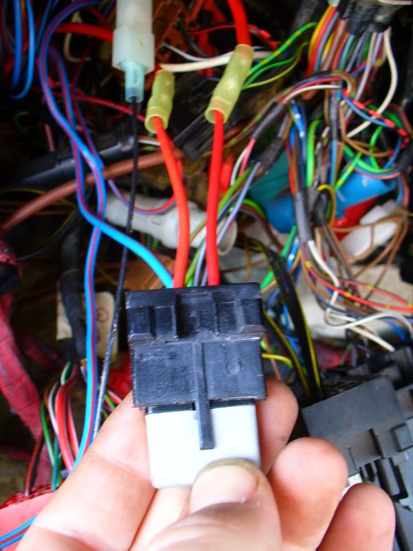

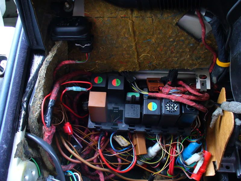

i also used a relay to power up the power sources to the ecu and ran it through this fuse...
...which slides into the stock relay panel under the dash and sits right above the relay i used for the ecu powering duties(third hole in from the bottom left)..
that's a buttoned up look at the harness

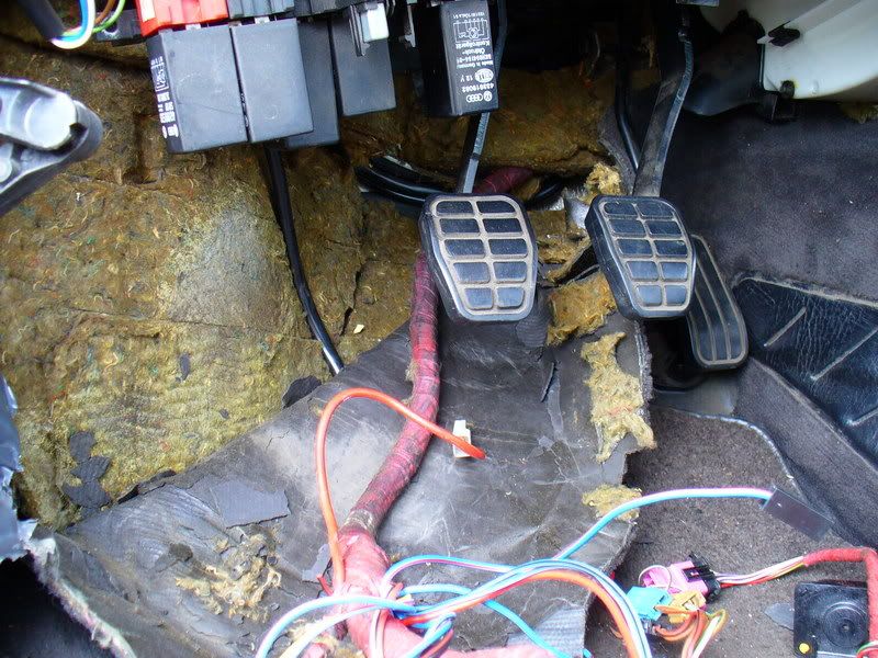

i also spent time on running through the cruise control system to see if i could find anything wrong with it since it didn't work when i bought it, and it's all apart now
found out first, that both pedal switches needed orings, then that the main column switch isn't sending power to the pedal switches.

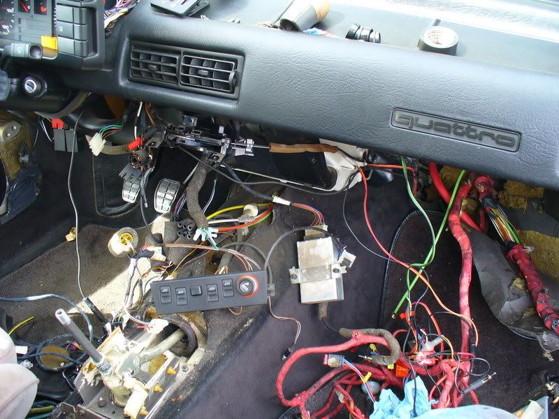

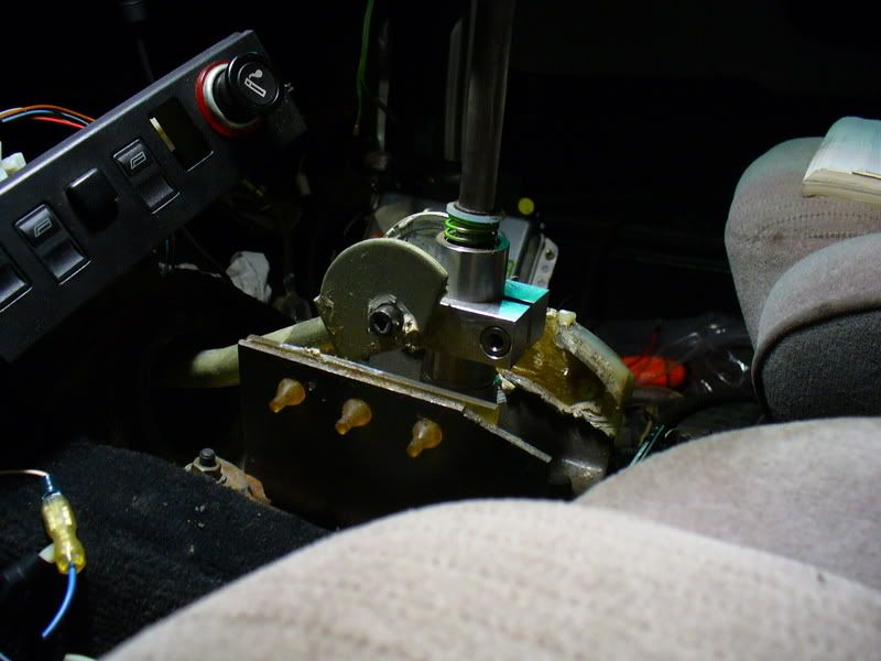

last thing i worked on was the rear diff lock setup from the 200. i mounted the box in the center console next to the cruise control box.

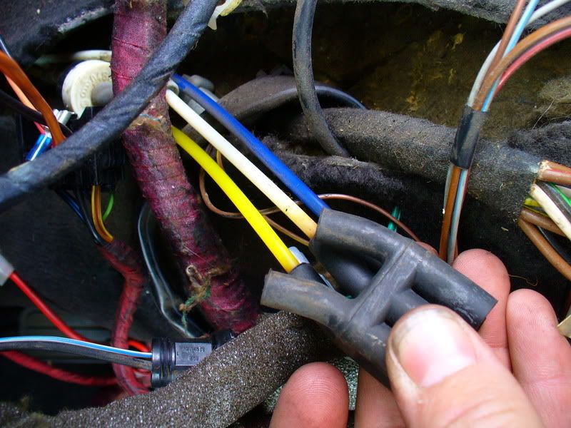

i'm going on my gut here cause i didn't feel like looking it up in the manual, but it would seem that the 200 and the 4kq uses the same color coding on the vacuum lines for the rear diff lock... blue and yellow
so once the lock box was mounted i just cut and looped the rubber hoses to the plastic lines in the center console..
i deleted the front lock lines as well since i don't think i'll be going back...

Sweet action. Where did you get that cool tool for removing the pins from the connectors? I could use something like that.

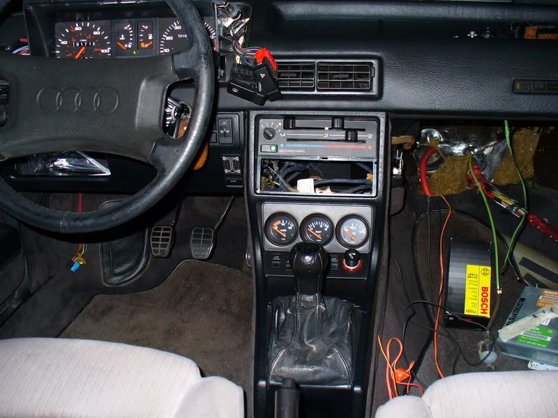

i got the gauge panel installed, wired up the volt meter, oil temp, and oil pressure.. which, using the 200 oil pressure sender works perfectly as one wire is for the gauge, and the other is for the oil pressure drop warning that the 4kq has the same of... so it's all bolt in and performs the same functions 8)
i've almost got the rear diff lock finished, and then i gotta figure out why the ecu sometimes buzzes at me
it also stays warm when the key and power is cut off to it, any ideas?
this is what i'm left with tonight. you can see the diff lock switch mounted in the drivers kick panel, and all the gauges light up and work properly. i'm pleased
