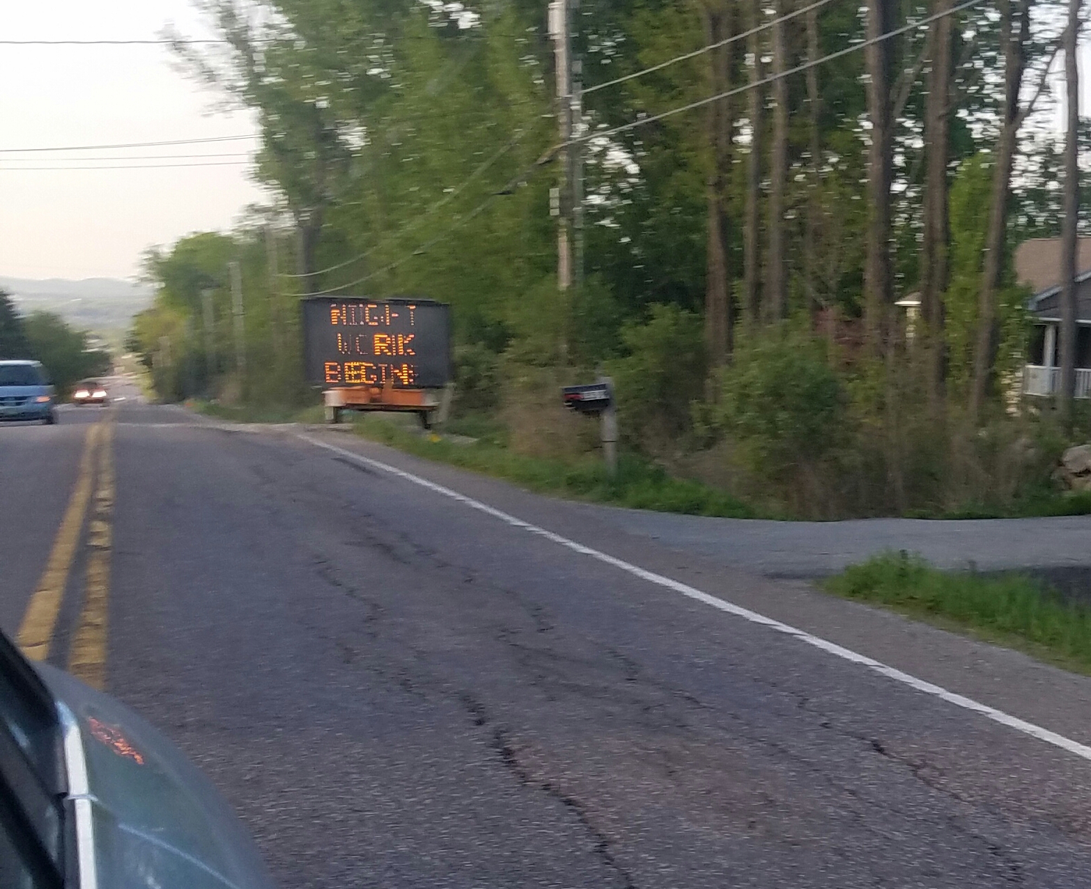

They put up a sign for the part of missing road Dana's brand new wheels found. That crevasse was no joke, I'm really impressed with how well the fifteen52's took it.
- uploadfromtaptalk1464221468364.jpg (1.19 MiB) Viewed 50038 times

awesome pic Ben, thanks!

i still get hot with anger when I think about this. I need to get these wheels straightened. Its ruining the awesome of this car. After this week, it goes back into the shop for cam, lifters, springs, maybe some paint, and wheel fixing. Lame.vt10vt wrote:They put up a sign for the part of missing road Dana's brand new wheels found. That crevasse was no joke, I'm really impressed with how well the fifteen52's took it.
