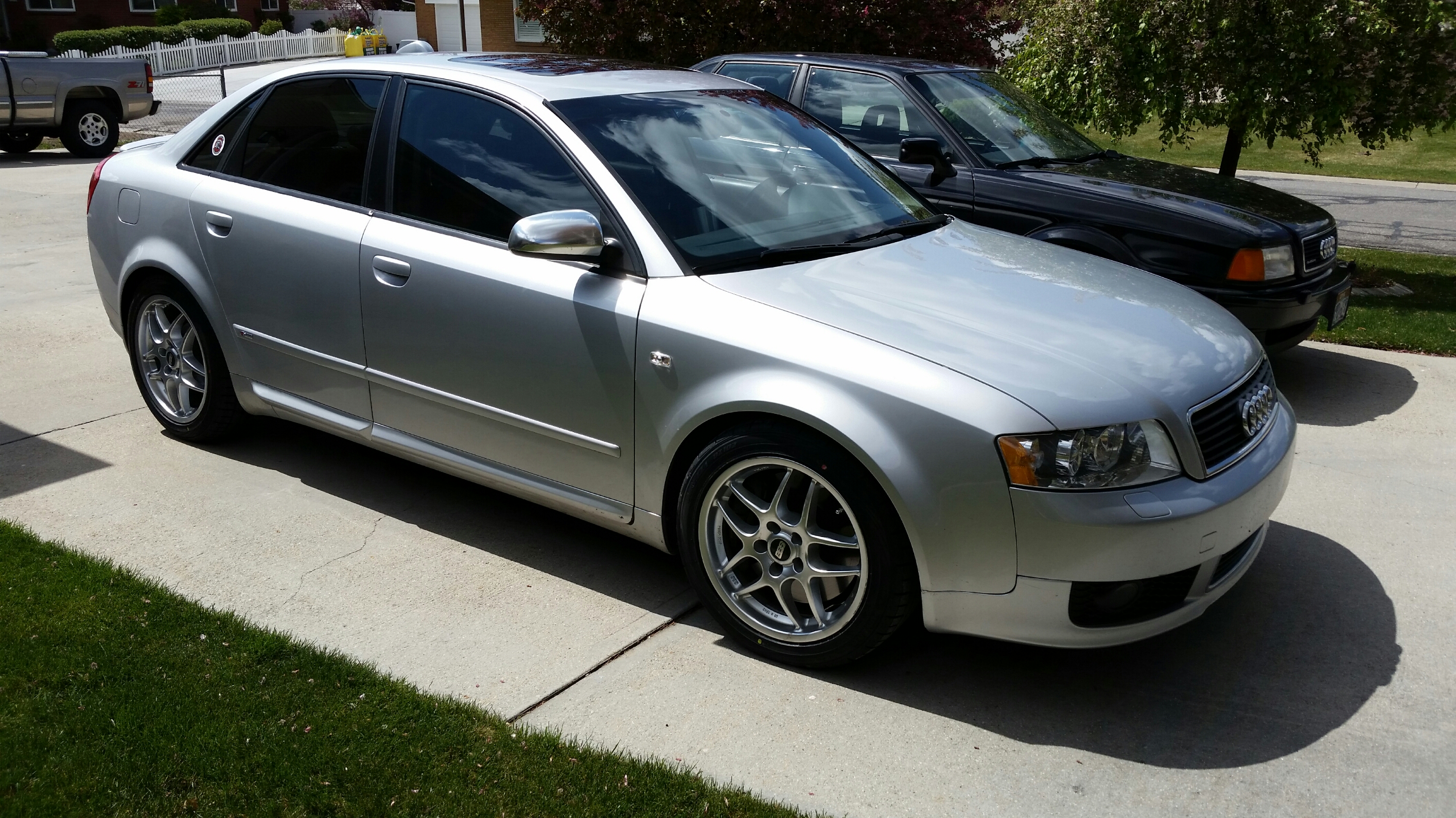

Nice work Shawn. I too bought a B6, for DD service. I got a 1.8t ultrasport with 6spd manual and actually love the car. I would have started a thread on it, but I told myself I wouldnt start that till my B4 sold. I want to build a motor for it to play with, but I got too many irons in the fire atm so it's on the backburner for now. Here is a teaser at least.... I really like the ultrasport bumpers way better than any others.
2015-10-17 14.27.35.jpg (3.19 MiB) Viewed 35715 times

scubadave wrote:Nice work Shawn. I too bought a B6, for DD service. I got a 1.8t ultrasport with 6spd manual and actually love the car. I would have started a thread on it, but I told myself I wouldnt start that till my B4 sold. I want to build a motor for it to play with, but I got too many irons in the fire atm so it's on the backburner for now. Here is a teaser at least.... I really like the ultrasport bumpers way better than any others.
Thank you!! That is a good looking B6 you have there! I like the Ultrasport bumpers a lot, and man does the body matched lowers make it entirely better! I think those look How do you like the ratios on your 6 speed? I'm not sure how I feel about the ratios in my 01E yet...
I was originally going to body match all the lowers on mine, but honestly it is SO low key with the black lowers, I might just keep them. I'm starting to get into the sleeper thing a bit haha If I ever go crazy with the body I think it'd be S4 bumpers and a Nogaro respray :drool:
