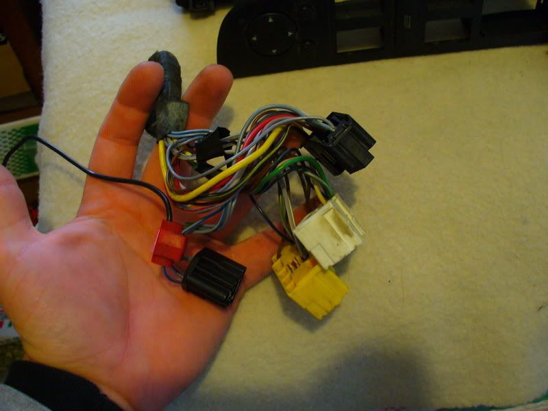

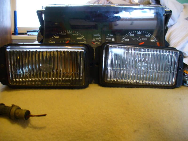

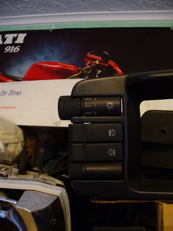

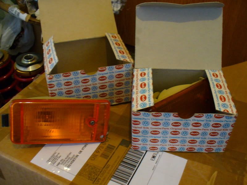

ok, some part updates... i got some euro goodies from my buddy maarten M in the NL. he hooked me up with euro headlights, foglights, indicators, foglight switches, the works. so i have me some good euro parts to help this car really start coming together.
euro indicators
fogs 8)
an unmelted headlight plug :o

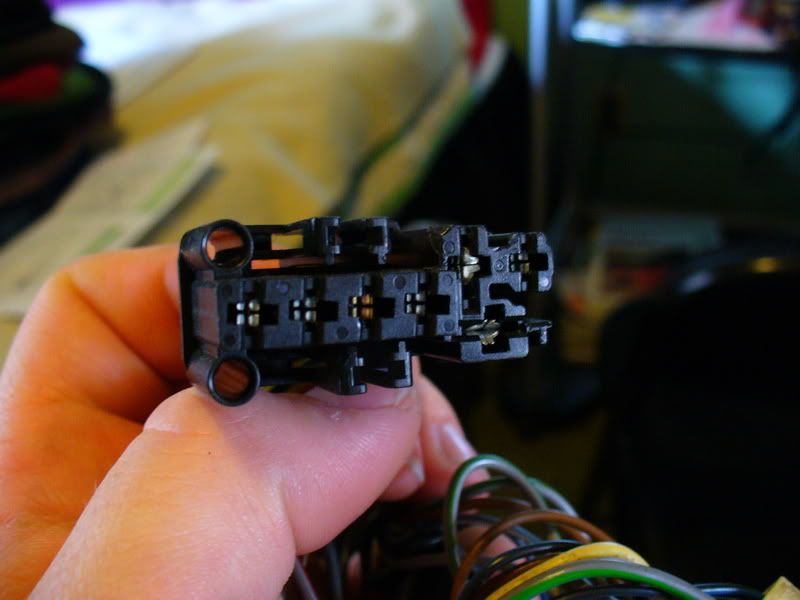

foglight switch plugs..

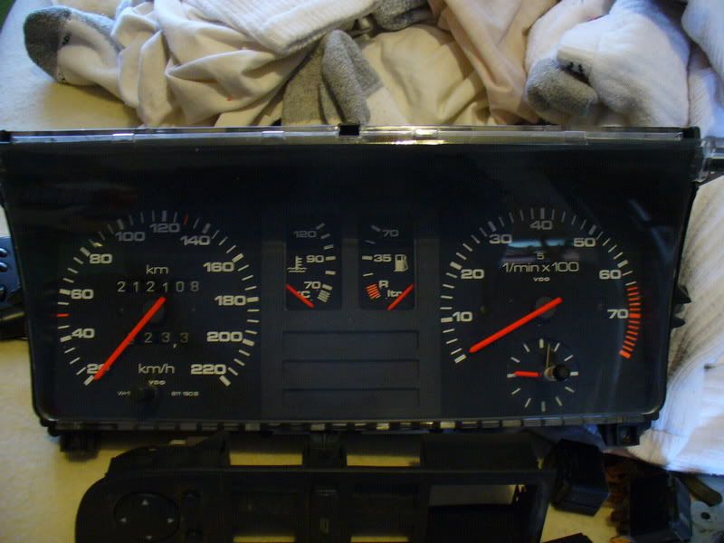

euro cluster (i'm gonna try and see about a higher mph speedo for it and use the rest of it as is. it's nice to have actual #'s on the coolant temp)

i'm missing the foglight switches in this post :)
no problem getting these parts for you, i'm glad they go in a nice car, can't wait to see it finished, also thanks to you, for all the electrical goodies we don't have...
guys. derek is the best :) i think the things he did sent me are cleaner than the parts i sent him, i see now in the pics, that one of the mounting tabs of one of the headlights is broken :(

Looks good. I had a Canadian cluster in my old 4000 years and years ago. I loved having the numbers there for the coolant and fuel, it was nice.
Good score on the fog light switches! I only have some of the front ones. Let us know how it goes installing the fog lights and turn indicators. Thats something Ive been looking to do for a while.

wind that cluster back to 000000 buddy :wink:
derracuda
Post by derracuda »
Wizard-of-OD wrote:wind that cluster back to 000000 buddy :wink:
that's a lasting illegal mod :P

derracuda wrote: euro indicators
fogs 8)
You will need the Euro bumper frame (FG) in order to fit these. Unless you do some innovative surgery to existing bumper/shocks.
I got a complete bumper from Europe along with complete harness for headlights/fogs/indicators. Other than swapping the bumper cover from US to Euro frame the job is a piece of cake. Looks great and is 1/4 of the weight of the NA bumper assembly!

yeah, i realize the difference in the bumpers, so i'm going to take a look at what it will take to mode mine vs. how much it will cost to get me a frame over here from europe.

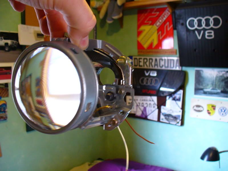

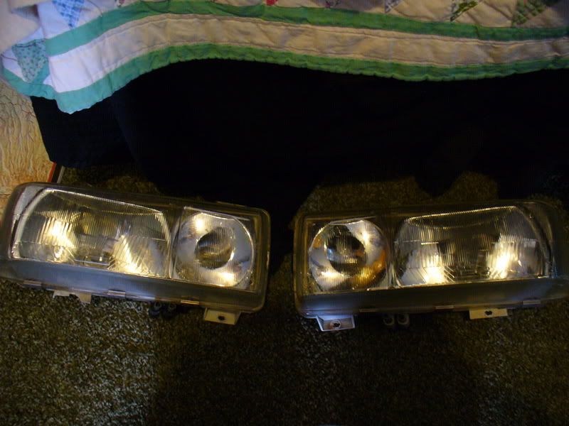

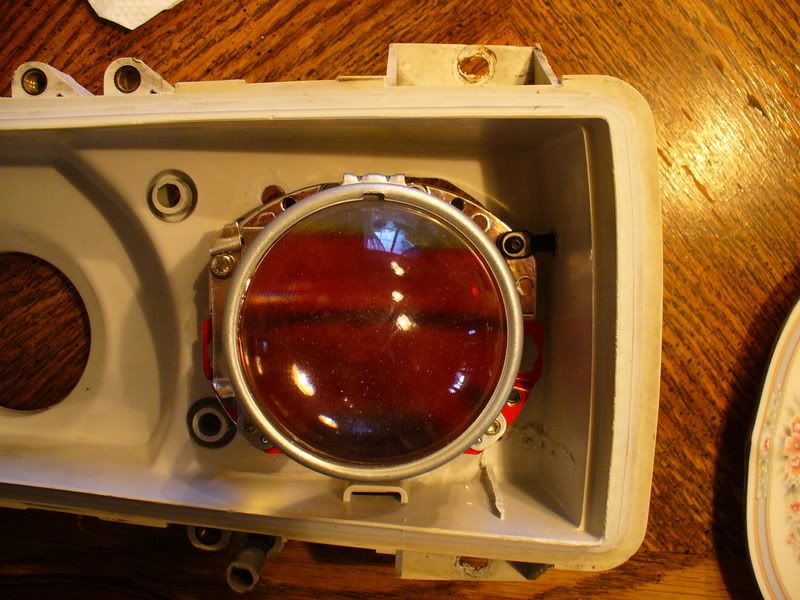

headlight update :) i've been working on retrofitting yet another pair of eurolights with HID projector lamps, but this time it's with bixenon projectors so that i have not only low beam, but high beam 8)

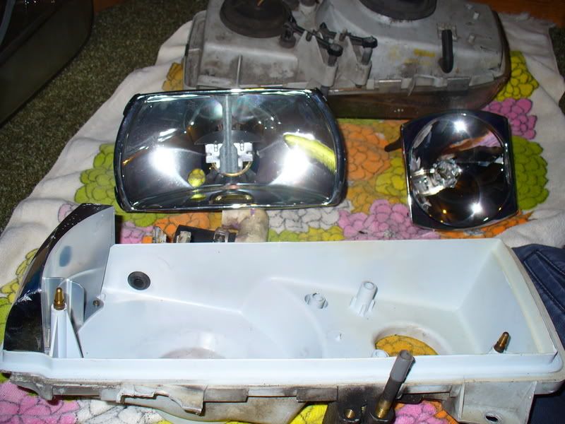

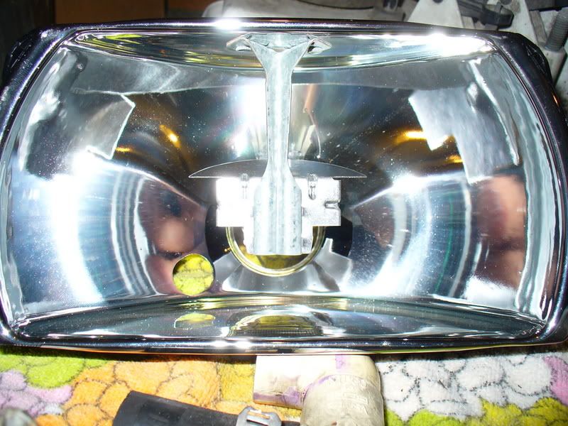

i started off by totally dismantling the headlights as they were really dirty and needed a good cleaning....
the light buckets were in fantastic shape..

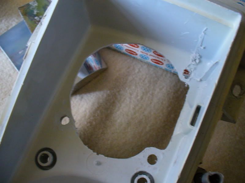

then i used a dremel to cut the back side of the housing out for the deeper projector unit..

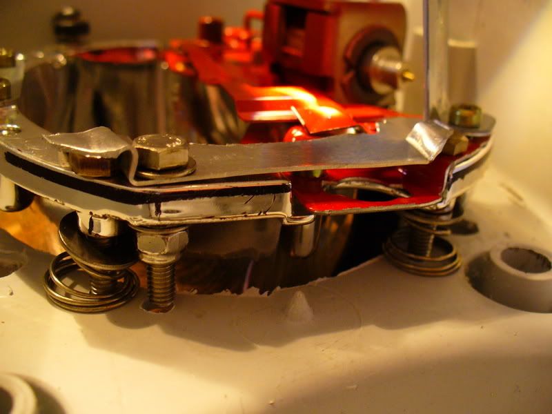

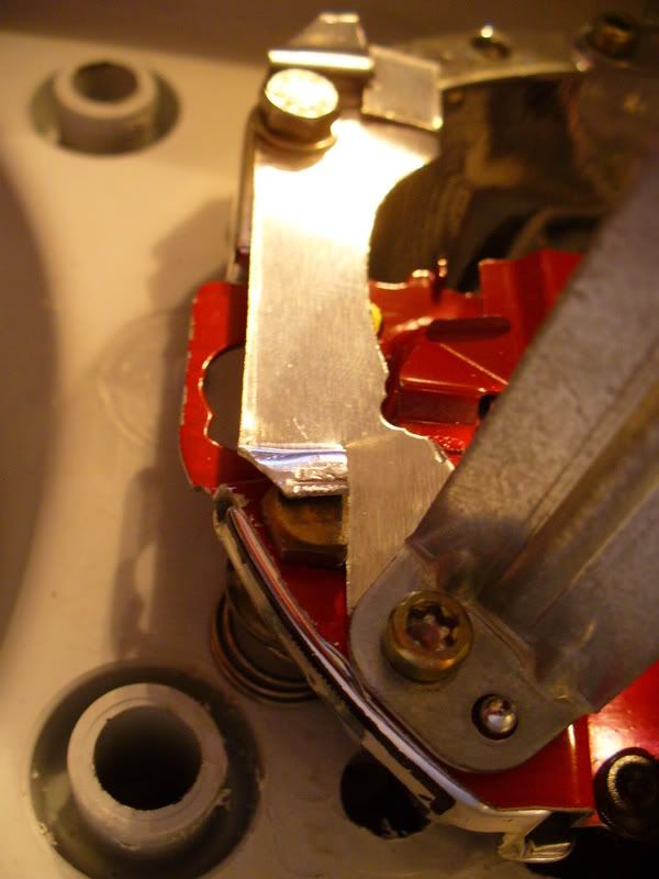

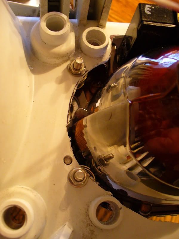

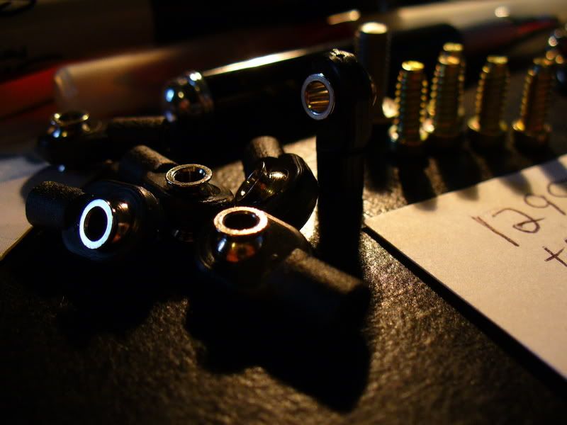

in order to mount the projector in a fashion so that i could adjust the light properly ad not completely dissassemble the housing everytime, i went the route of the factory.... sorta.... i had to make it with a pivot on one corner, and two adjusters on the other side. i had to make a plate to hold the bolt heads in place so that the only thing i have to do is turn the nuts outside the back and the springs keep tension between the projector and the light housing. the most difficult part now will be finding a way to seal the whole stinkin thing up :P
these are RC car tie rod ends 8)
adjuster nuts

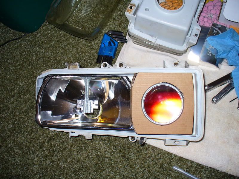

test fit cardboard cover plate. i'll make one from aluminum for the final product
that's it for now!
