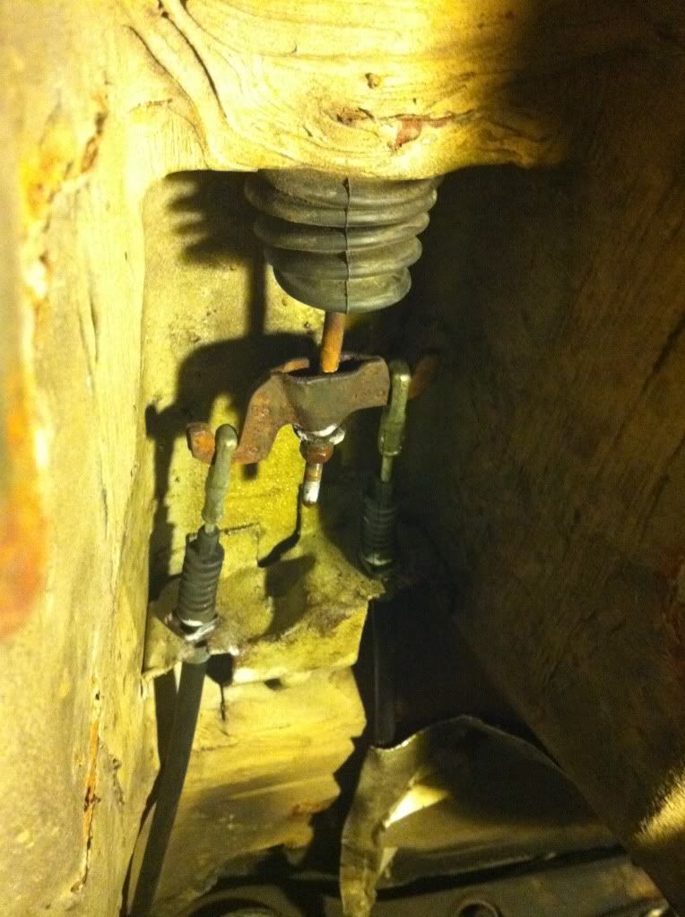

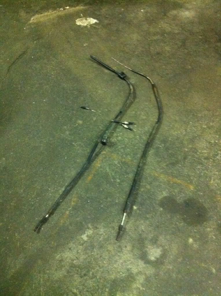

First task was to replace the non functioning ebrake cables...
New
Nice to have an ebrake finally - never did before on this car

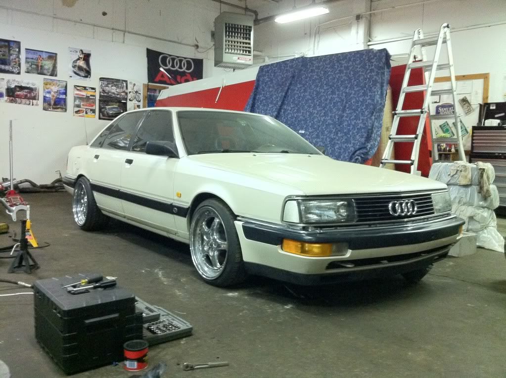

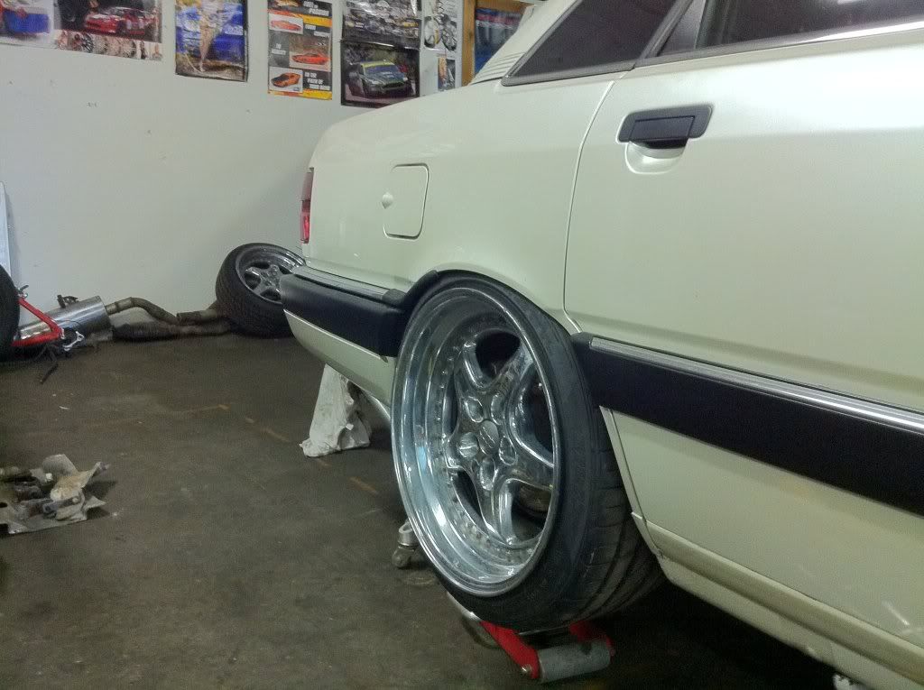

Next up I wanted to swap my springs front to rear, as the car felt unbalanced and rode like a pickup truck.

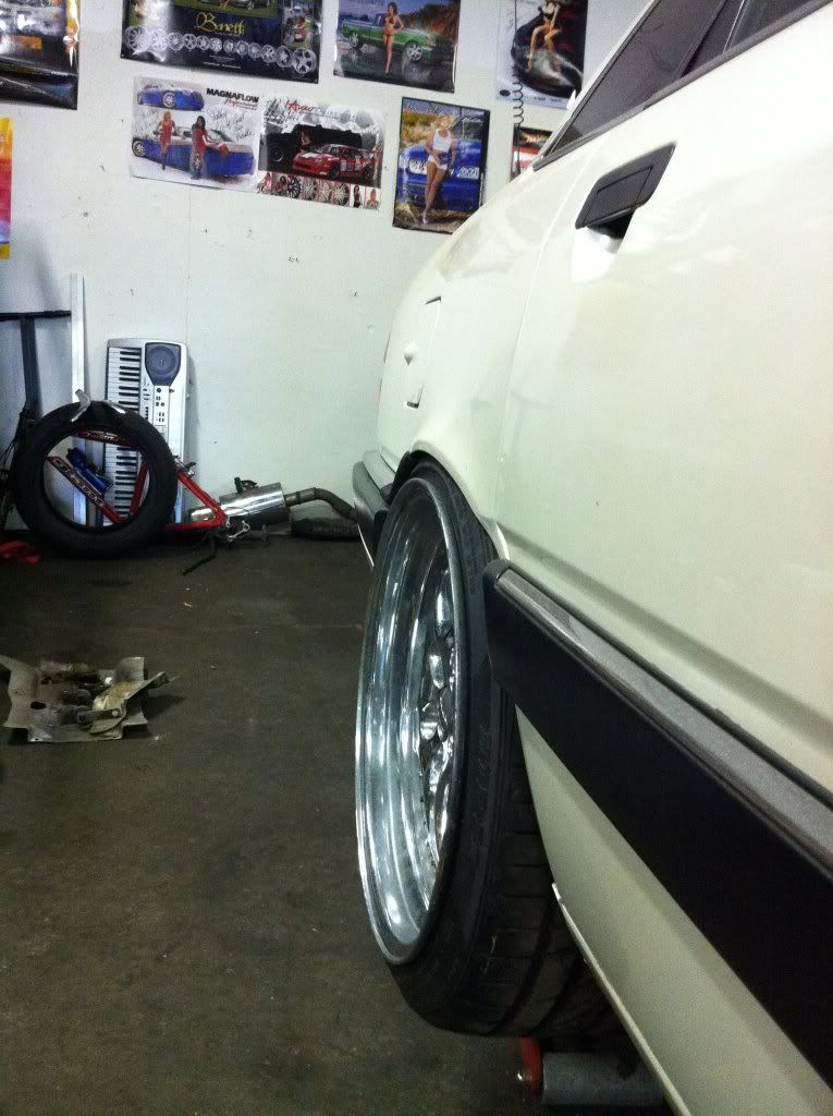

and out of curiosity I wanted to see if my wheels/tires would contact the fender, and it looks ok - even at this level there wasn't contact! But I still wish the wheels were sized properly... some other day when I have funds to throw at it.

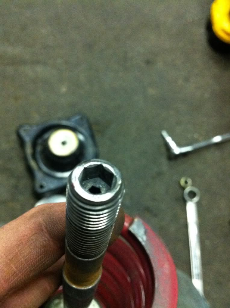

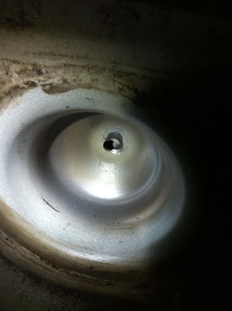

T44 guys understand that when you put Bilstein sport shocks in the back of your car, a mysterious knock comes around and drives you nuts. You replace every suspension component and it still doesn't go away. I have always thought that it sounded as though the strut was hitting the body... welllllllllll yes it is!
smooooshed

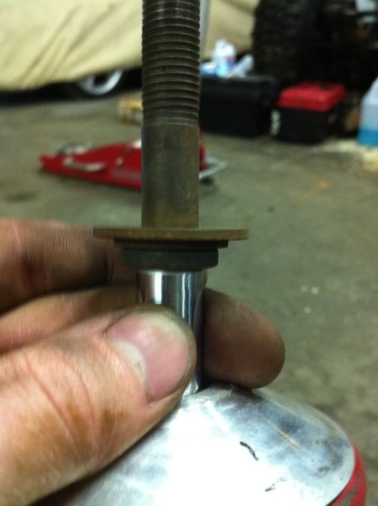

Time to space the struts a bit to lessen the amount of threads above the strut mount!
~20mm
Washer spacers
~16mm. We'll see if that takes care of the knocking.

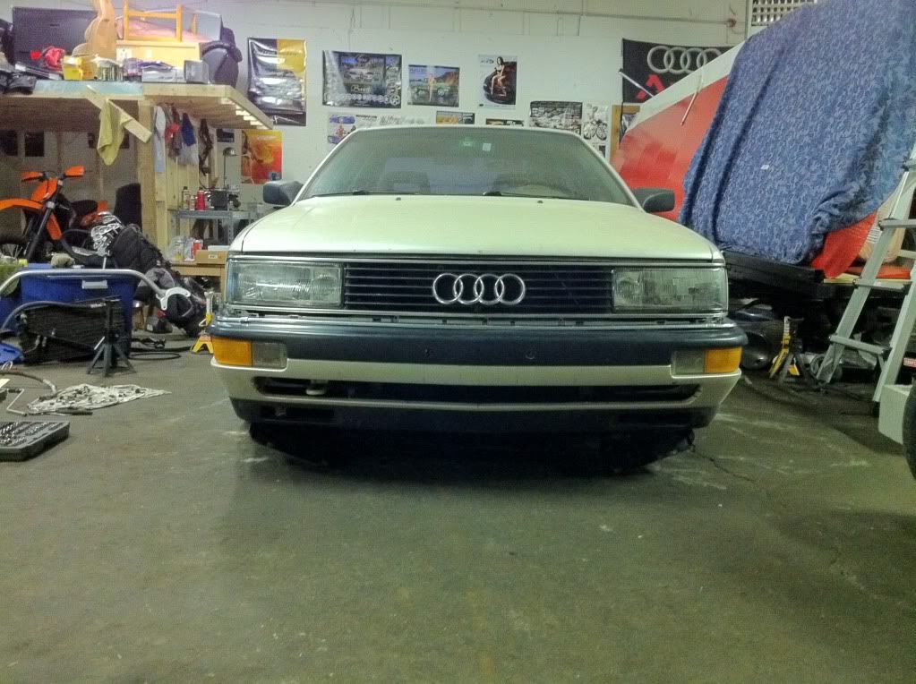

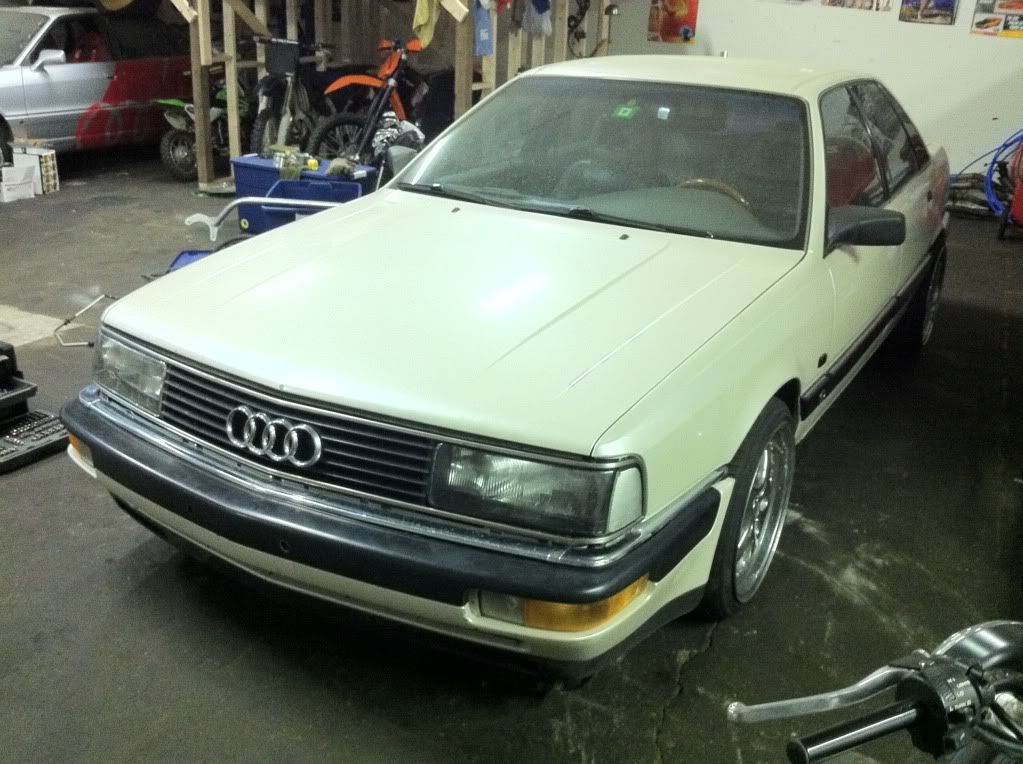

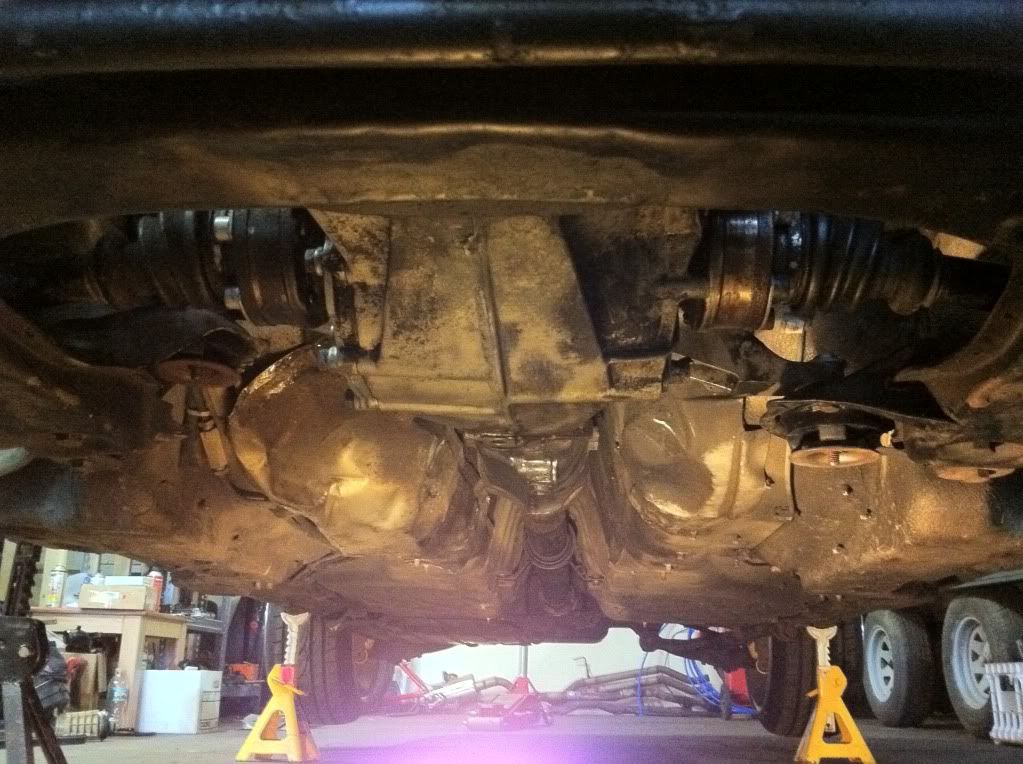

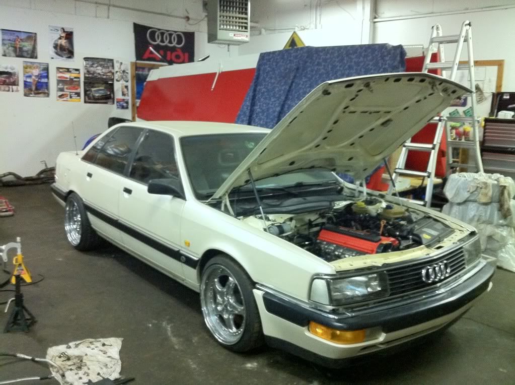

With the car back on jack stands I reinstalled the driveline

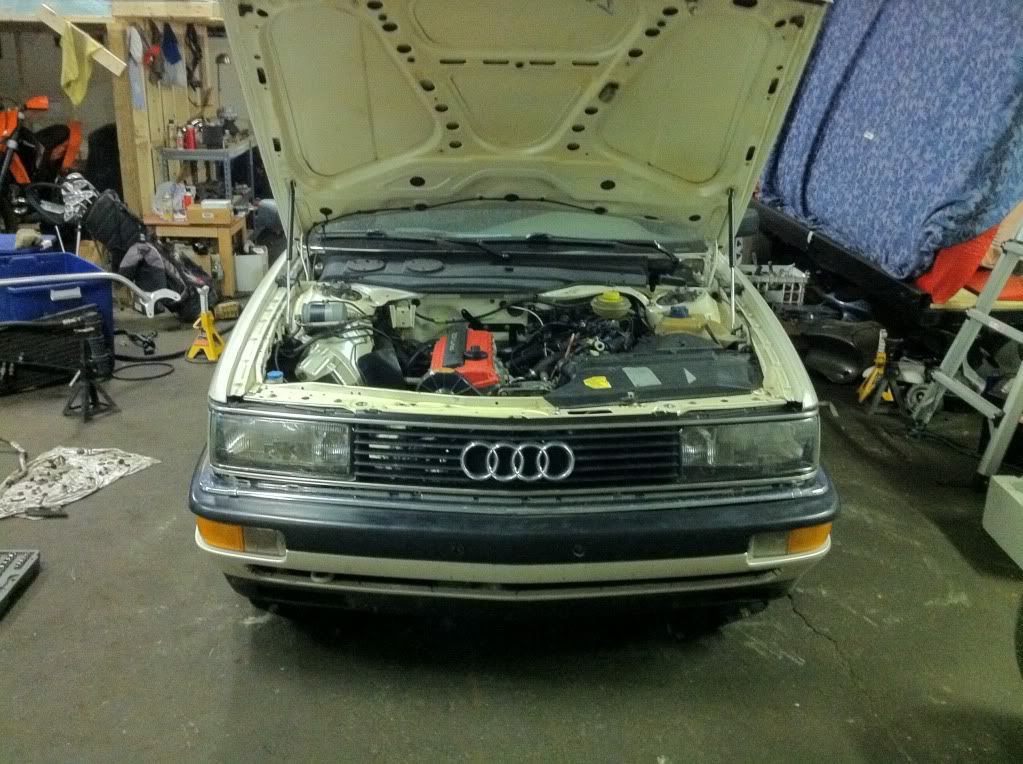

and then spent lots of time getting all of the plastic in the front end back together - the brake ducts, radiator ducting, and making small connections like the horn, oil temp/pressure, etc... I dropped the rear ride height 12mm to lessen the rake. Eventually it looked like a car again!
And a shot of the office... Sure do miss spending time here
All of this push was to get the car in one piece to move out of the shop since we've been asked to vacate, now delayed to Sept. 1st. What remains to be done is the intake/IC plumbing, Turbo back exhaust, ECU, and TIGHTEN THE CRANK PULLEY!!! Can't forget that one.. That's all for now 8)
New

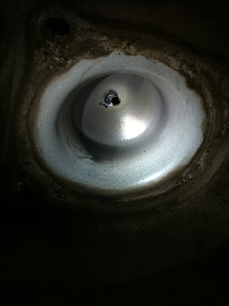

smooooshed

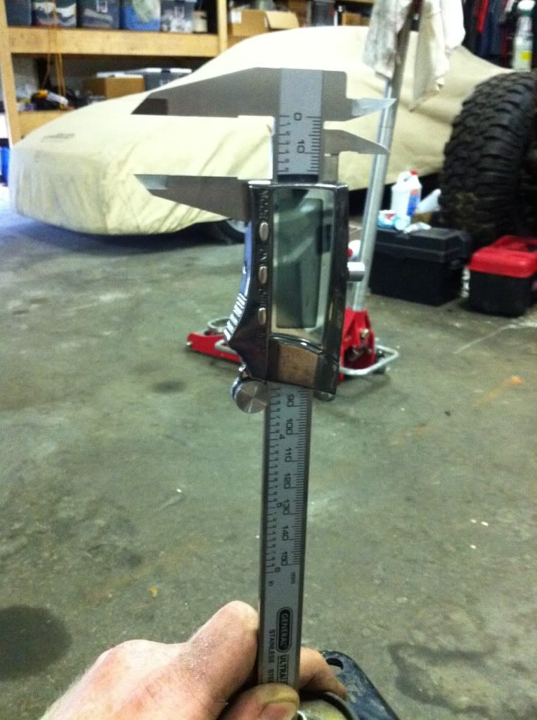

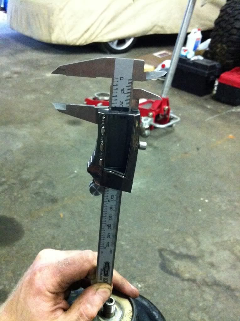

~20mm
Washer spacers

Re: Casey's 200 20v: Motor is in!
is that what the knock comes from!? Cool! It's driving me INSANE!
I wonder if drilling a larger hole in the area where it contacts would work as well?
pilihp2 wrote:is that what the knock comes from!? Cool! It's driving me INSANE!
There is suppose to be a rubber spacer on the rear bilstein's. It sits on top of the washer at the base of the threads, also be careful not to over tighten the top nut with said spacer installed.
yodasfro wrote:There is suppose to be a rubber spacer on the rear bilstein's. It sits on top of the washer at the base of the threads, also be careful not to over tighten the top nut with said spacer installed.
Mine didn't come with any? Well phooey.
Re: Casey's 200 20v: Looking like a car again
which rubber spacer? the big rubber mount? like this?
Edit: oh, at the BASE of the threads.
I don't have that either...
yodasfro
See pic
Attachment ( 27055 ) : W01331604189BIL.JPG
