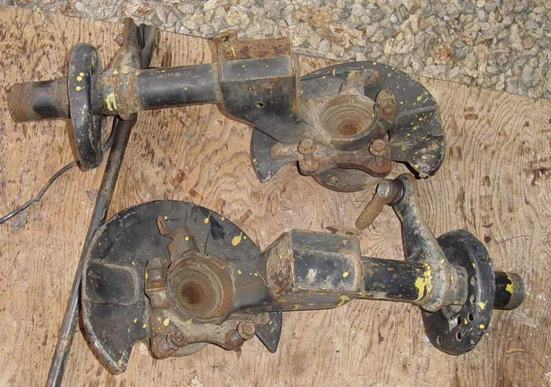

So martin informed me that 88 90q front single piece struts will bolt up and have wider caliper mounting so I can use rs2 etc brackets and my bbk. So the hunt begins... I put in an inquiry with Shokan as well. Anyone here parting an 88 90q?
Or does someone wanna make me some brackets? Haha. If all the kit needs is brackets, SOMEONE has got to want to make some :-) I'll have to play around next time I have my wheels off.

FYI I have an 88 90q that has 2 piece front struts. I even have an early model car with 1 piece rears. Maybe the 80q's used single piece fronts? I just wasnt aware of any 90q's that came with single fronts, but as usual, I am probably wrong

It was very early 90q, I had a set till I threw them out last year, the only difference between them and 4kq and provision for ABS sensor and larger spacing for the caliper brackets. They also had the hubs that used nut on the CV as opposed to later which used a bolt.AudiSport4000 wrote:FYI I have an 88 90q that has 2 piece front struts. I even have an early model car with 1 piece rears. Maybe the 80q's used single piece fronts? I just wasnt aware of any 90q's that came with single fronts, but as usual, I am probably wrong
HTH
