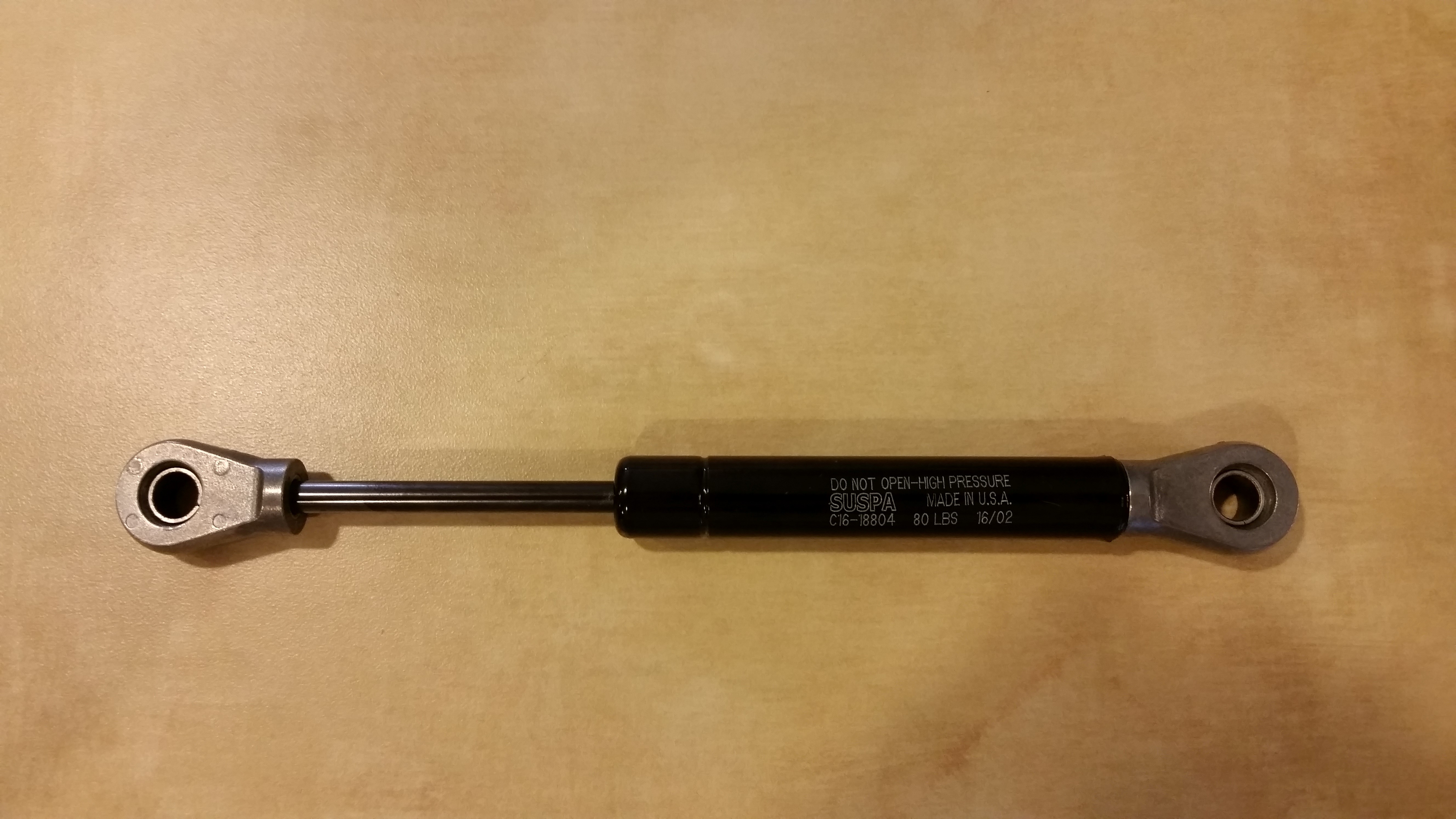

I'm also attempting to make the polyrib-belt tensioning system better. I ordered an 80lbf gas spring yesterday with metric eyelet style ends. I had to order sleeve bushings, as the eyelets are 10.5mm and the bolts are M8. Sleeve bushings are 10mm OD by 8mm ID, so while not perfect they should work out okay. Center to center length of this is 7.56" extended, which I know is quite close. I can make it slightly longer by fitting thin M6 jam nuts if I have to. Hopefully I don't, but we'll see. I had to hazard a guess based on the PT engine sitting on the stand that still has the factory belt and tensioner on it.
NOTE: 7.56" was NOT close at all. I cut a good chunk off, see below...

gas spring arrived today...Ends are separate, the gas spring is threaded on the body and rod end in M6x1.0. The ends have a 10.5mm hole, but the bolts for the tensioner are M8. I could not find any 10.5mm bushings or sleeves, so a 10mm x 8mm bushing will work out okay. Hopefully will have time this weekend to try it out.

Just a note...80lbf may be too much, I had to guess. 40lbf may be plenty. I'll know more when I get the belt on. I guess I could use the PT to check since the serp belt on it is old and crusty (factory belt w/100k on it).
Re: Eric's V8 CQ
That spring is a great solution!

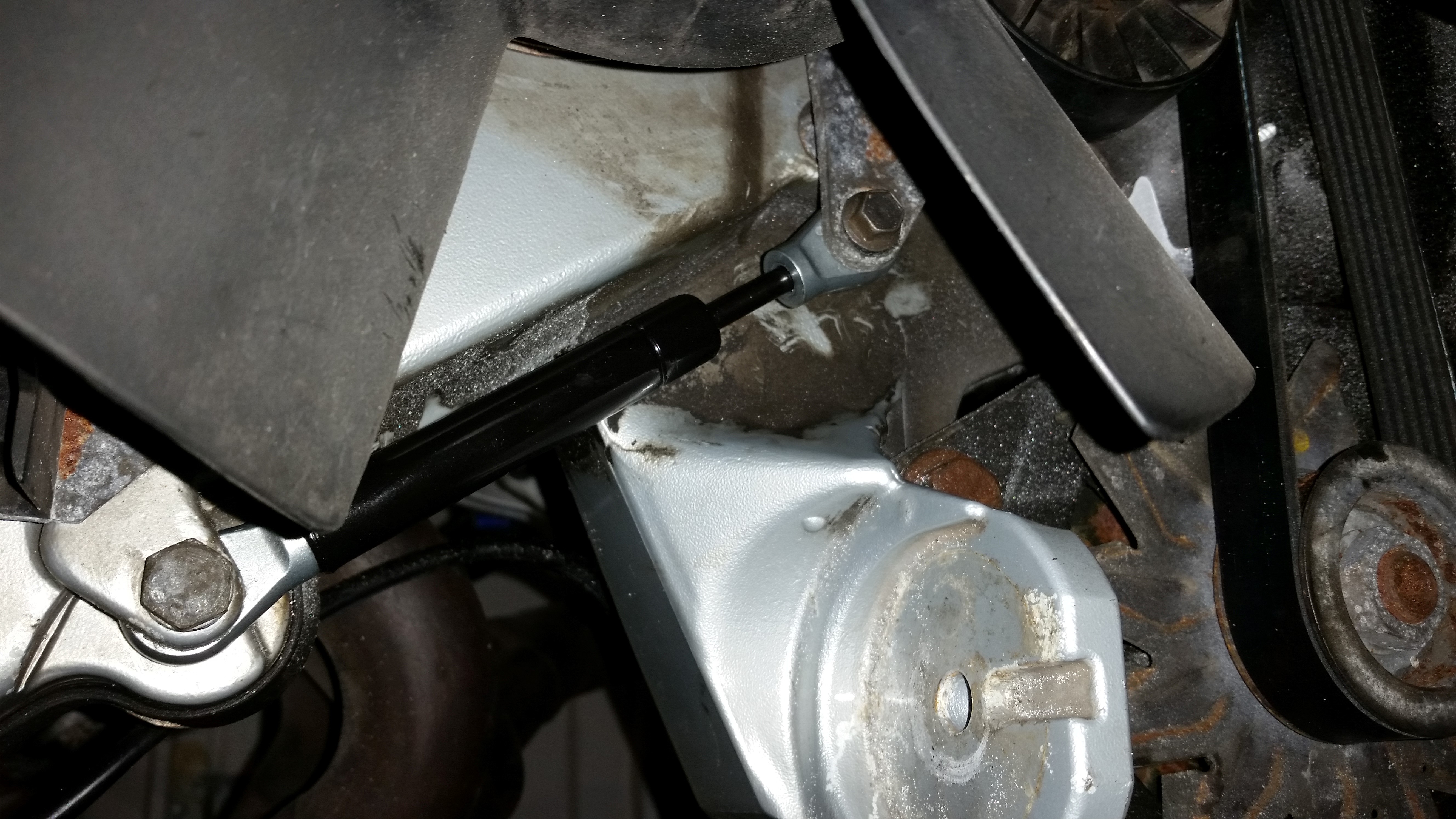

I think my 80lbf guess was correct. I test-fit the gas spring on the PT engine. I had to cut off about 1.125-1.25" from the rod end and re-thread it M6-1.0. I also tapped out the eyelet fully to make sure I had full range of adjustment in case I didn't get the length quite right. Compressed length with the belt on is right around 6.125". Uncompressed length is just a fuzz over 6.25". Belt feels properly tensioned. It is supposed to rain tomorrow, so depending on what we have going on I may swap the CQ into the garage and the 4.2-Q7 out, and pull the nose off the CQ so I can get this tensioner setup on it. Best part is, it looks a WHOLE lot more factory than the turn buckle (which had come loose on me and shredded a belt).

I got the gas spring installed tonight, i was only able to take it up to 4k out of respect of my neighbors, so I'll have to road test it this week. But, the initial results are very promising.
