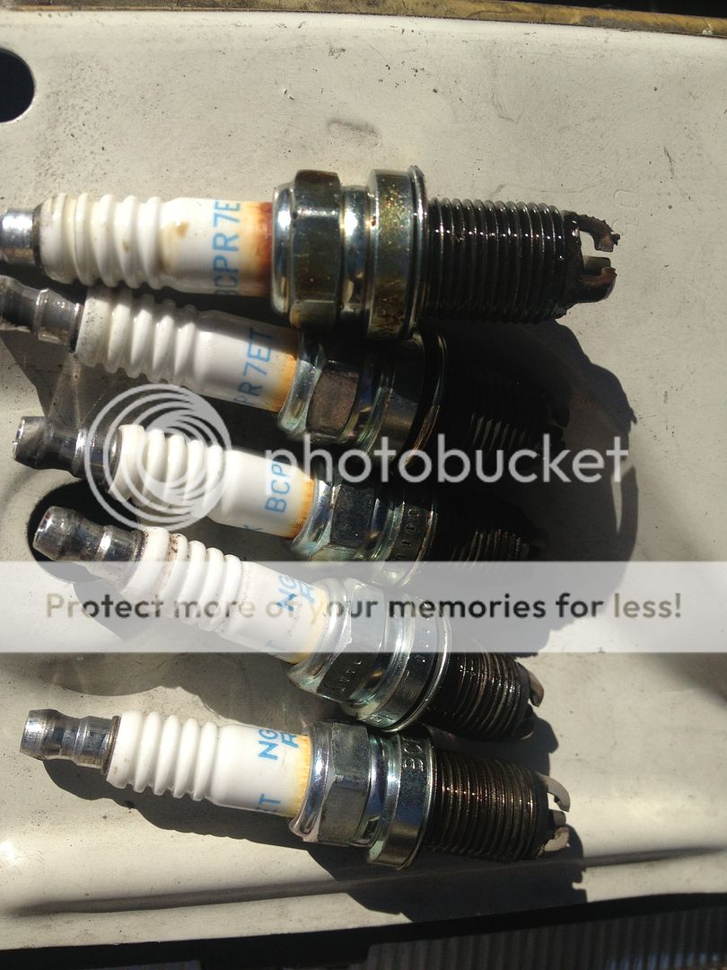

so i replaced my spark plugs. Car runs much smoother.
It was spitting and bogging down and so i changed them out. although, the rear plug had oil on the bottom part and the others did not...
what does this mean? I asked a friend and they said possibly bad valve cover or rings going bad?
anyways, the CQ is more smooth and hasnt begun bogging down again, but i guess i need to order a valve cover gasket soon.
replacing on a 20vt is easy, is it much more difficult on a 20v?
just asking, cause ive never done it on a 20v and the intake is on top of the valve cover.

get some long extension allen sockets and use pb blaster on the allen bolts holding the intake mani down, disconnecte the intake portion, and then kinda fold the whole thing over to the drives side engine bay with the fuel lines still attached. then you can get the valve cover off
oil on the spark plug 90% of the time means a bad valve cover gasket over the plugs
make sure to order a new intake manifold gasket as well

frostyflax17 wrote:get some long extension allen sockets and use pb blaster on the allen bolts holding the intake mani down, disconnecte the intake portion, and then kinda fold the whole thing over to the drives side engine bay with the fuel lines still attached. then you can get the valve cover off
I'd agree with you if the oil was on the upper part of the spark plug (porcelain).
In this case the oil is on the part of the spark plug in the combustion chamber
... oil is getting into the combustion chamber either through the valve stem seals or past the piston rings.
A leakdown and compression test will give you leads to the cause.
BTW, is the engine consuming more than 1qt/1000k miles?
if so, then I suggest a compression and leakdown test to help better diagnose the issue.
If not, change the plugs and have fun with it!
