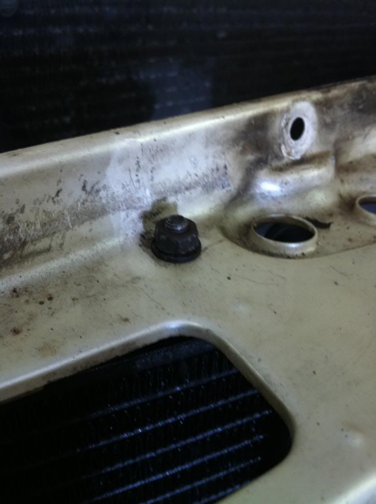

Next rare part - strut tower brace! Hits the hood though, so I will need to persuade it downward.
Re: Casey's 200 20v: Looking like a car again
can it be flipped?
my2000apb wrote:can it be flipped?
Interesting idea.... but no - that would make the mounting surface to the strut towers completely backwards angle-wise
sell it and well weld one in
my2000apb wrote:sell it and well weld one in

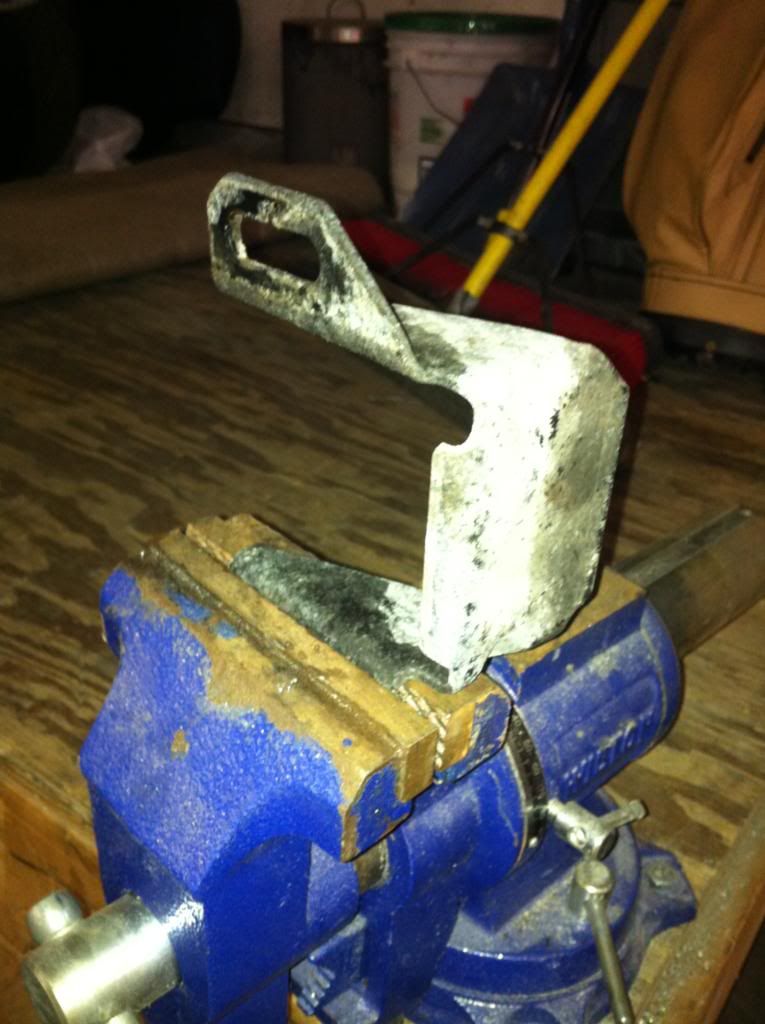

:P All I have to do is put each end in a vice... et voila. Plus I like that it's a TAP piece that is NLA. Welding one in would make it a bit of a hassle to work behind the motor too..

Cut the frame piece that the bar hits on the underside of the hood.
yeah jstu cut the hood
Ronald G Wainwright+
Post by Ronald G Wainwright+ »
Yeah............depending on how much more clearance he needs looks like there is at least 1 1/2 of material that can be cut out before he gets to the hood sheet itself.
Cut out what hits and then box it back in.
heck no! I'm not cutting my hood supports up! Y'all er crazy! But you already knew that.
It's just aluminum... I'll bend it .75" downward to clear the hood.

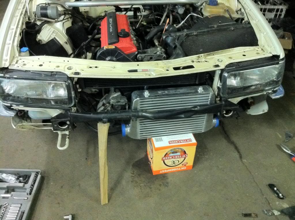

Re: Casey's 200 20v: mounting the intercooler

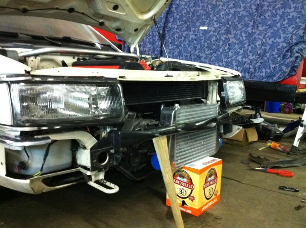

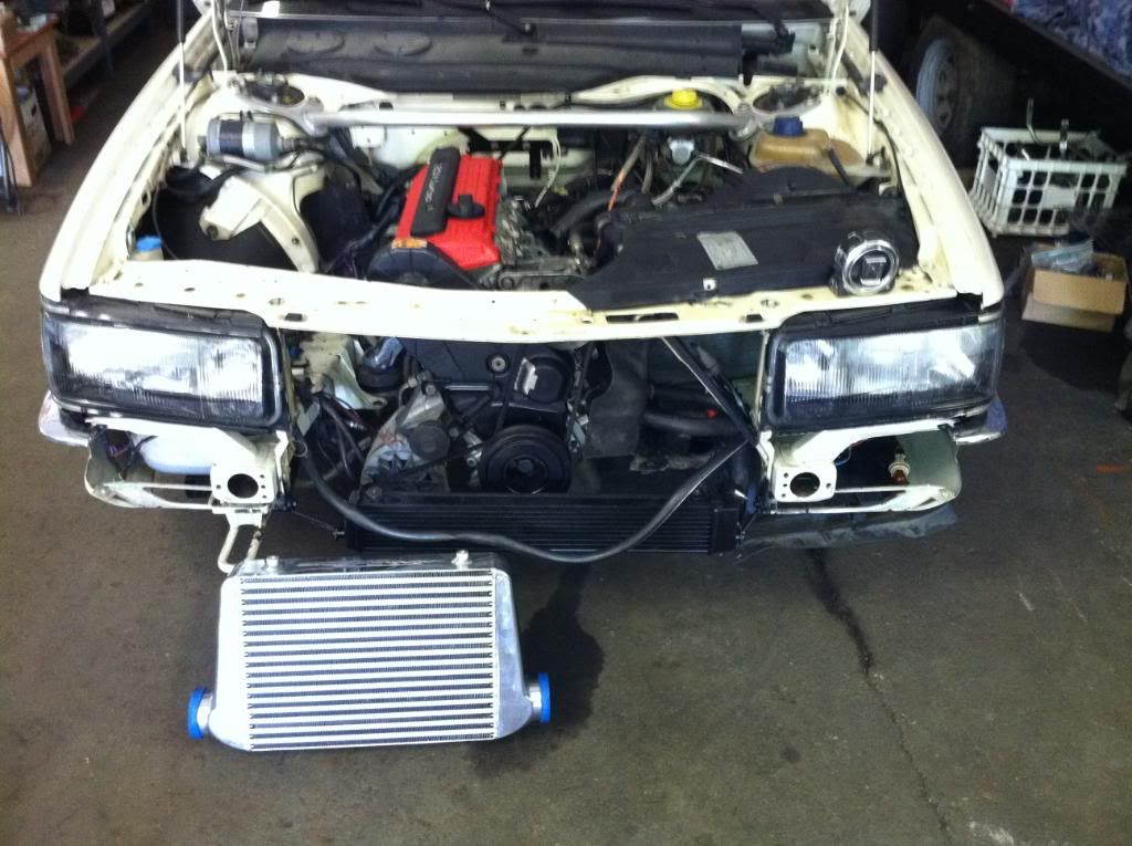

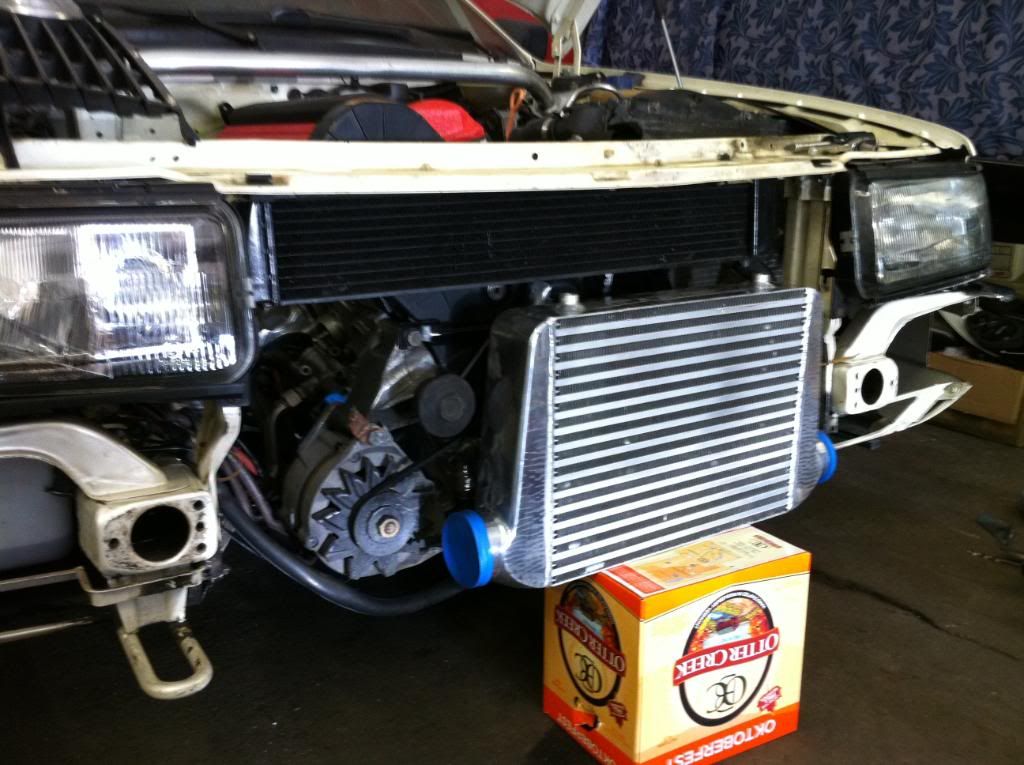

Started working on getting the IC mounted today

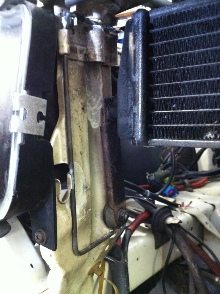

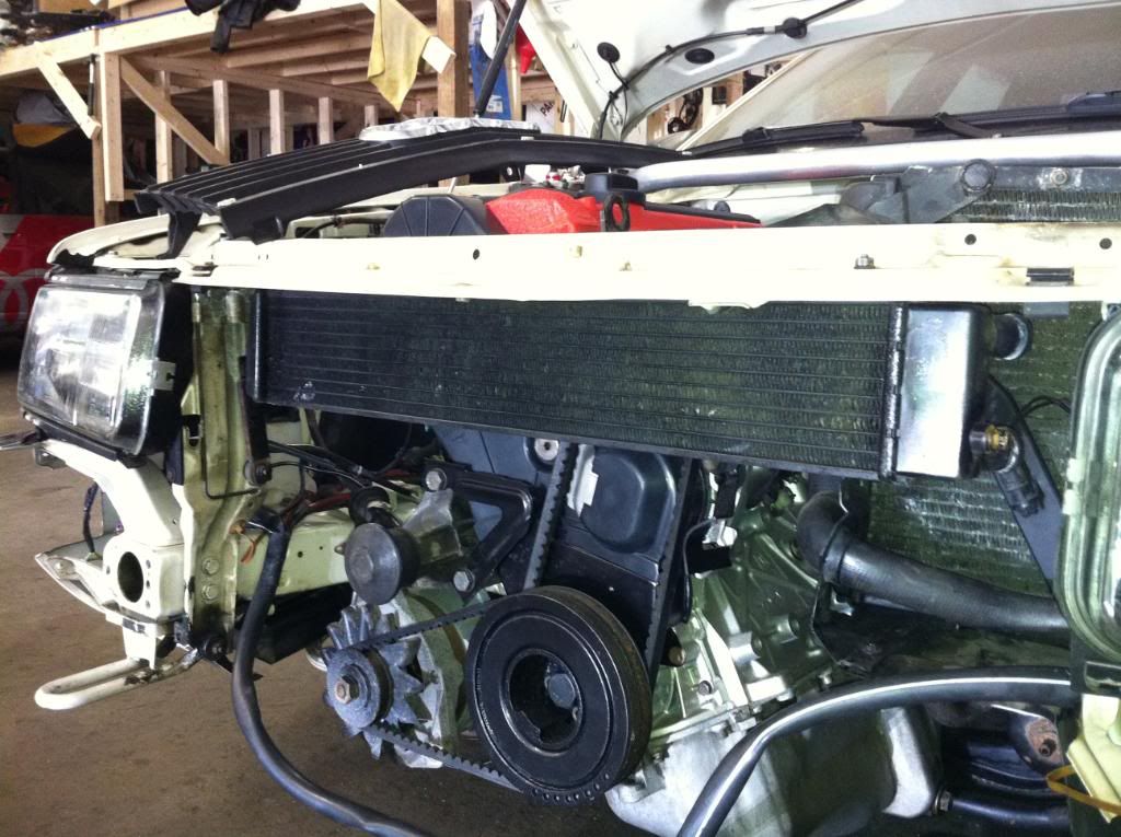

Moved the aux radiator upward to make room for the IC - This also lets me keep the hood latch

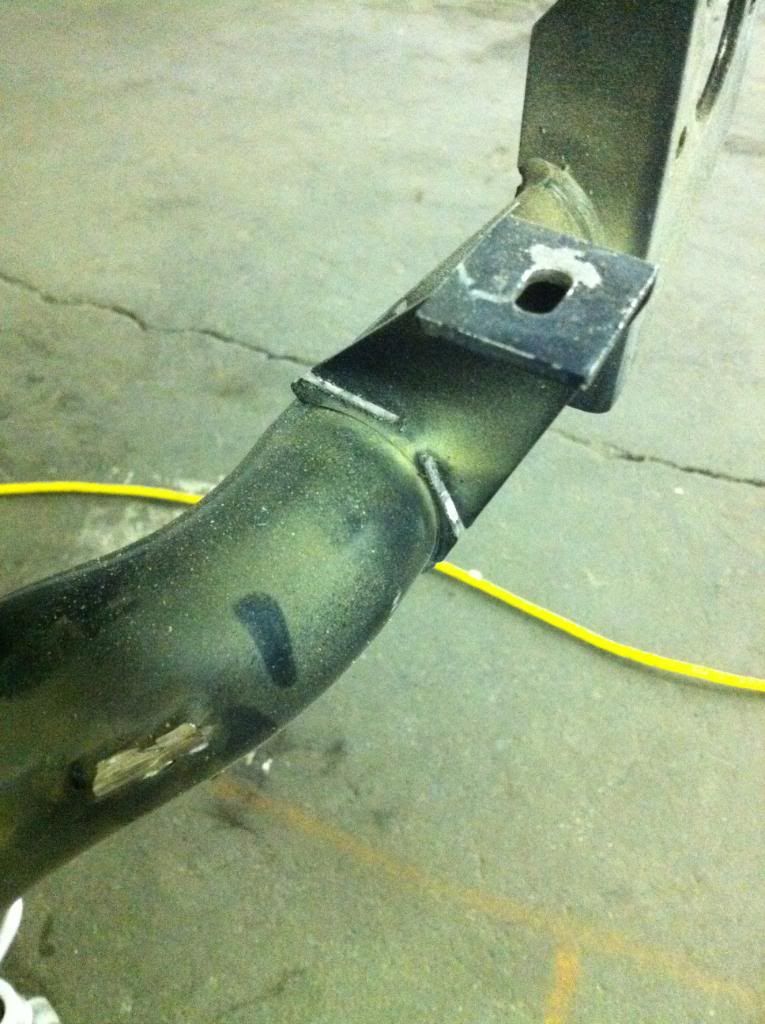

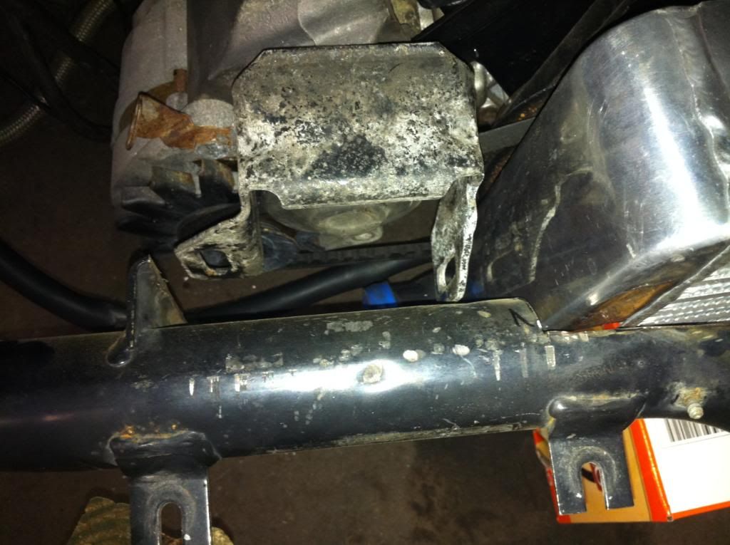

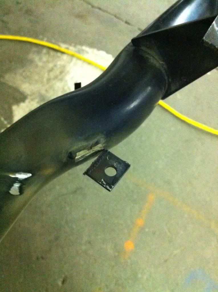

Then I wanted to use the stock crossmember and snub mount, so I had to do some cutting... welding to follow

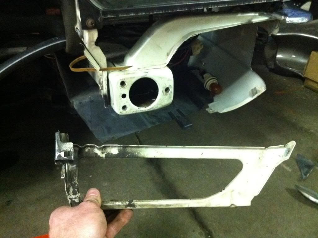

Removed:
Modify snub
Cut the crossmember and will weld in some gusseting

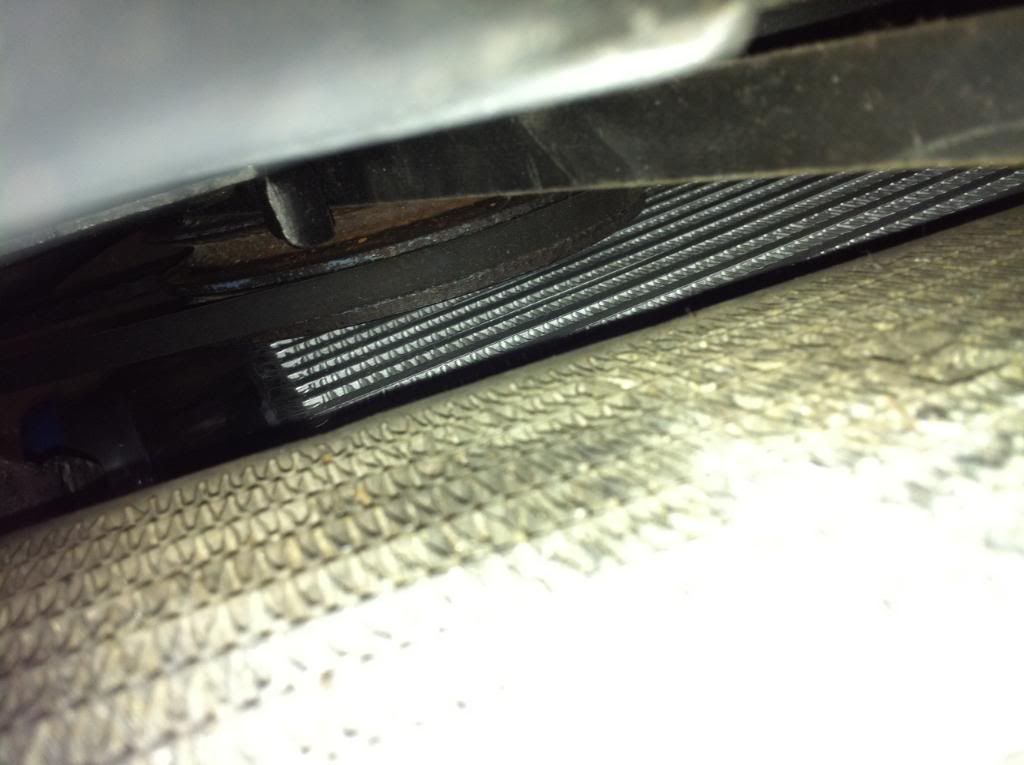

About 3/4" between pulley and IC
Here's where I left off:

What trans and motor mounts u got?
