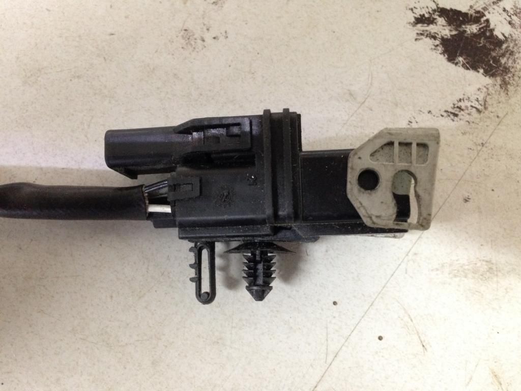

So I think I have the right wideband 02 sensor, it's a Bosch LSU 4.2 but the connector looks different than what I'm seeing pretty much everywhere else. Is it better to just pick up a new one?

That looks right, just like a wideband should. Just has that white retaining clip on it to throw you off.

Yeah that isn't the same connector that VEMS will be using...
